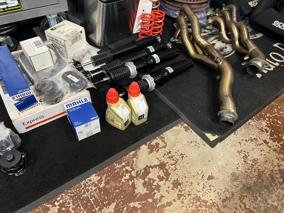

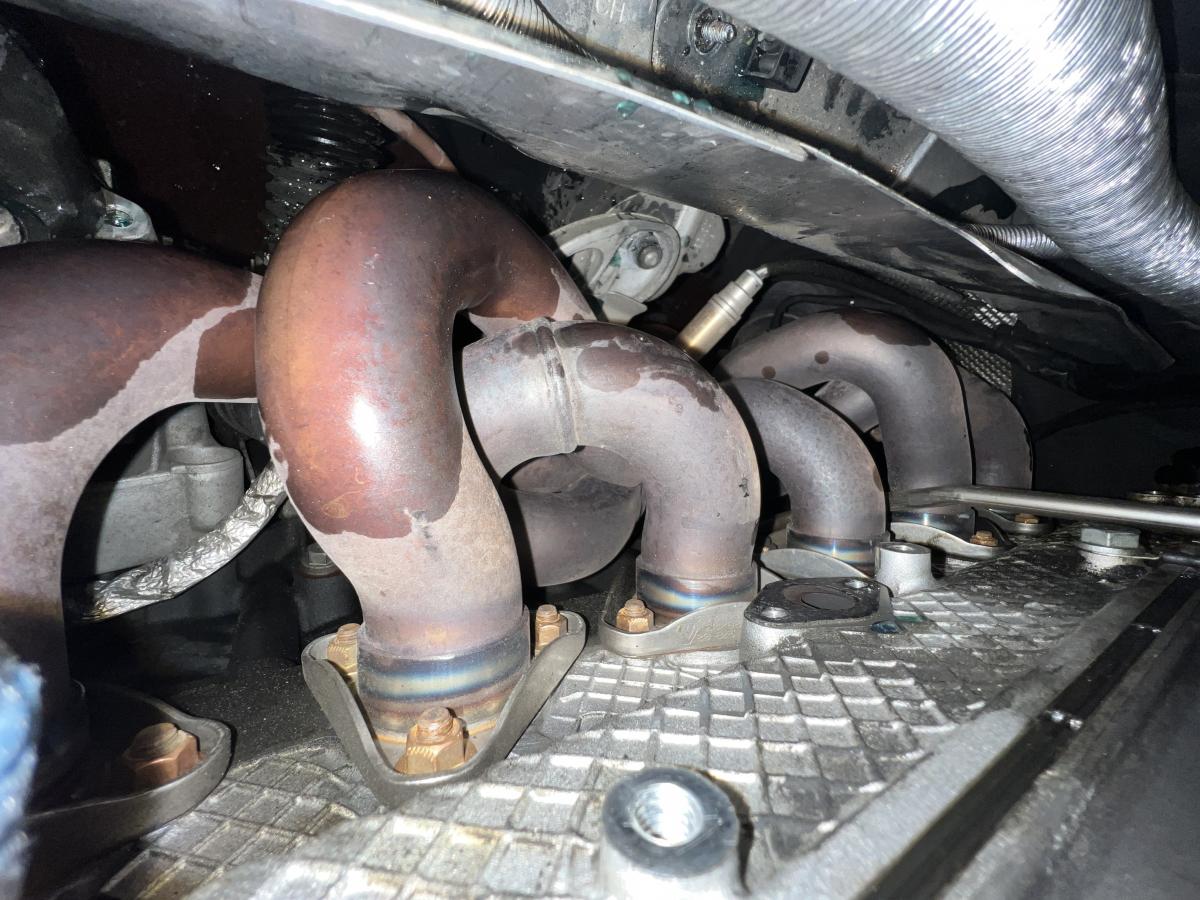

                Well the car is sitting in the garage while I wait on the Fuel Pump Relay so I started to pull parts to access the headers, doesn't seem too tough (yet). I wanted to ask if any anyone had suggestions of critical relays to replace on a 100k mile E46?
                Anyhow my pile of parts is starting to accumulate, here's the list of parts going on this week!
                CPI Headers
                SMG relocation kit
                BW vanos line
                Shaftworks Coilovers
                Turner LCA Bushings
                BW Sport Engine Mounts
                ACL 0.025mm oversized Rod Bearings
                Condor Trailing Arm Bushings
                Fuel filter
                LSD/Trans/Brake flush
                Over the next few weeks I'll get the Spal fan wired up & some sort of oil cooler setup (might just go plug and play with CSF) Click image for larger version
