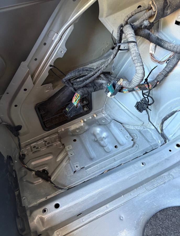

    Anyway, I'm just waiting on a cable for BMWScanner to code my modified LCM to get the x-blink functionality. Seems like 5 blinks is the sweet spot. While I had the LCM out, I noticed the vent and LCM were missing a screw and body nut...so waiting on that as well, even though I'm sure it doesn't need both screws. That kind of stuff just annoys me so I need to have all screws in place.

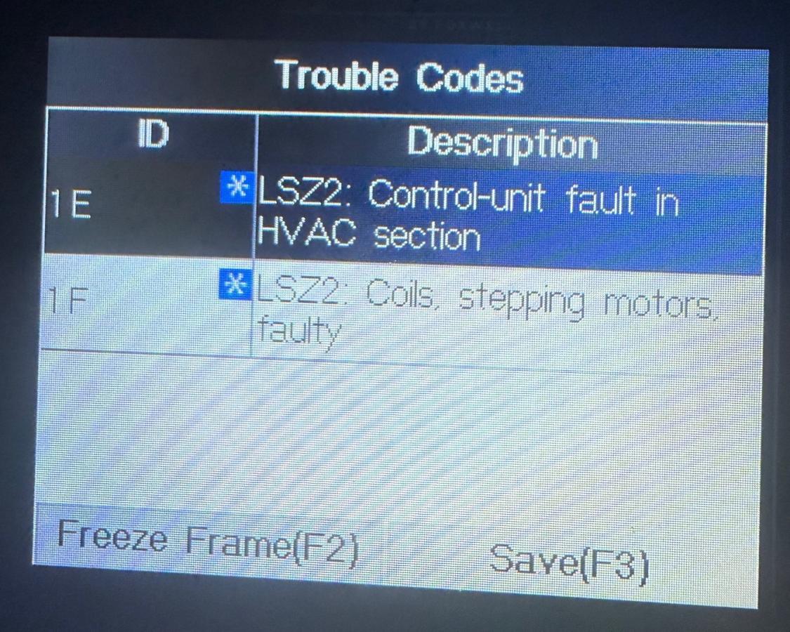

    so I checked the wheel speed sensors and they all were giving a reading and none of them stuck at 0 while moving back and forth in my driveway. I decided to take the car for a drive and it drove very well for the first 30 minutes or so. On my way back home, it gave me SES light. Hooked up my scanner and pulled a bunch of codes. Worst of all, the tank-venting system code is still there which is not going to allow me to pass emissions. I've replaced the vent valve, DTML pump, charcoal cannister, and smoke checked with no leaks. I read somewhere that it needs to go through the drive cycle and turn this code on to eventually turn it off? I'm not buying that one but kinda lost on what to do next to pass emissions. The "trifecta" lights never appeared but the 5E14 and 5E3C codes remain.
    ERROR CODES pulled on 10-11-2024
    E8 – DME: Function check, tank-venting system
    33 – GM: Wipers: interlock active
    3D – GM: Drive for rear-lid unlocking
    74 – GM: Spray-nozzle heater, left open circuit
    76 – GM: Spray-nozzle heater, right open circuit
    5E14 – ABS-DSC: CAN connection to DME/DDE (DSC lamp on until ignition reset)
    5E3C – ABS-DSC: Rotation rate signal
    20 – IHKA: AUC heating -> purchase BMW AUC Climate Control Sensor - Genuine BMW 64116917001
    10 – PDC: Converter, rear left
    C7 – KOMBI: Tank lever-type sensor 1
    CE – KOMBI: Outside-temperature sensor
    F4 – KOMBI: No CAN identification
    F7 – KOMBI: No CAN identification (DME)
    F8 – KOMBIE: No CAN identification (DME)
    1E – LSZ2: Control-unit fault in HVAC section
    1F – LSZ2: Coils, stepping motors faulty

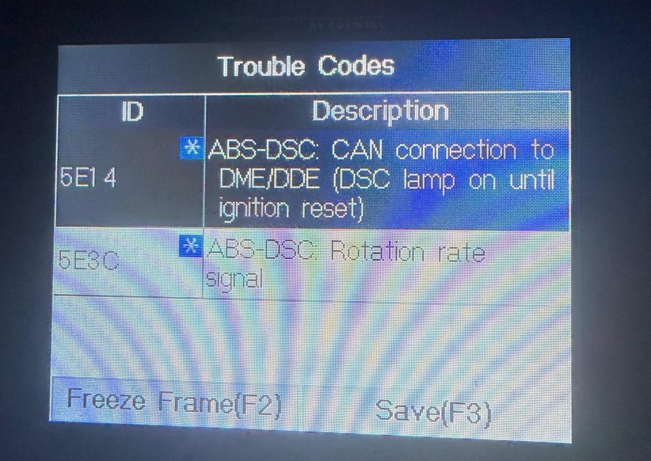

    I used the little foxwell scanner since i couldn't get INPA working right and pulled the following codes:
    5E14 CAN Timeout DME/DDE
    5E3C Rotation rate sensor not plausible
    Click image for larger version  Name:	errorCodes.jpg Views:	0 Size:	52.6 KB ID:	281099
    Before pulling codes and talking to some folks, I think the immediate reaction was to replace one of the wheel sensors but after looking a bit more into the codes it sounds like the 5E3C code could be the yaw sensor under the driver's seat. I'm hoping the 5E14 is just a bad/dirty connection to the ABS unit and I don't have to replace one of the DSC pressure switches. I'm going to use the scanner to see what's going on with the pressure switches later.
    I'm kind of glad that these codes are not pointing to the wheel speed sensors since i was going down the rabbit hole in thinking i would also have to replace reluctor rings, etc. anyway, let's see what happens after i replace the yaw sensor and maybe re-seat the abs connector. it's weird because for a few weeks now i've been experiencing the tcs coming on for a brief second and the car getting squirmy going straight on the highway. and then of course last night, full blown trifecta while on the highway as well.

    went for a little drive last night trying to get my car ready to pass emissions and after jumping on the highway for like 3 minutes, i get the “trifecta” lights; red brake, yellow tcs, abd yellow tps. car felt 100% normal the whole time, but regardless I still turn around to drive back home. Get to the gas station, turn off car, turn back on, all lights are gone.
    I’ve been reading and it sounds like it could be anything from wheel speed sensors to a bad MK60 unit which is worst-case scenario I guess. I tried to run the ASC/DSC test on INPA and I can’t connect to any of the brake checks on through INPA. I have one of those DCAN cables with a switch, and it won’t run in either mode.
