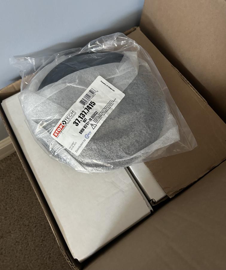

    one of our fellow nam3 members had a st40 zcp front bbk kit for sale that I had to pick up....after going back and forth on brake bias for 100 hours, I decided to pair it up with st40 non-zcp rears. this is supposed to give me 62.5%F/37.5%R brake bias which sounds good to me. I really never had plans for a BBK, but the deal was just too good to pass up, and bimmerworld had the rears on sale for $2k. front calipers are black, and rear calipers are red...so i'll probably get them painted bronze orange or something.

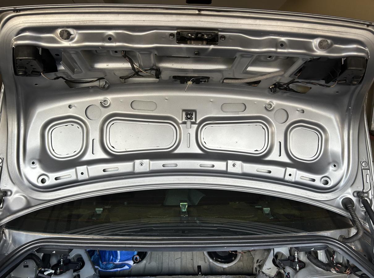

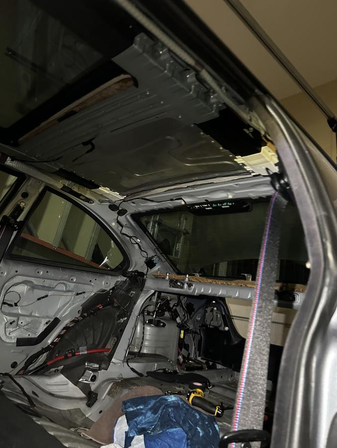

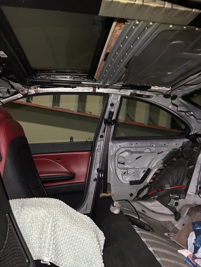

    The car is in really great condition for being as old as Di Caprio's girlfriend. Going to have the resto shop treat the spot rusting in the trunk...due from the leaking sharkfin antenna.

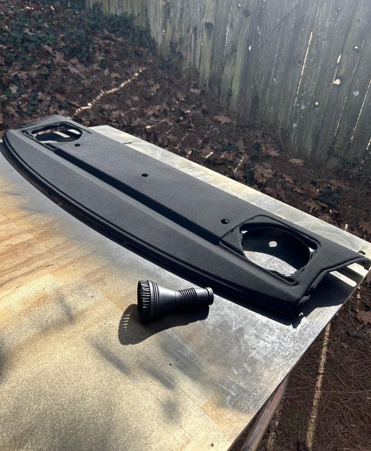

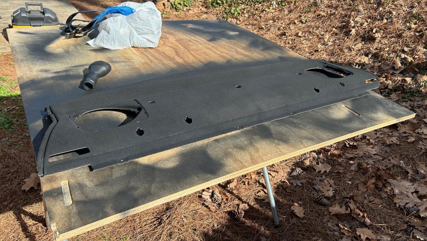

    Figured I'd also paint the rear decklid as well. By the way, I've been basically using this Dupli-Color HVP106 Vinyl and Fabric Coating Spray Paint - Flat Black - 11 oz Aerosol Can for all of the little touchup areas, and it is really great.
    For the decklid, what I noticed is that because it is fabric, you can actually use a little brush to help blend the paint once dried. Also so it's not all hard and crusty. I just had one of these little brushes laying around from some cheap vacuum I probably purchased.

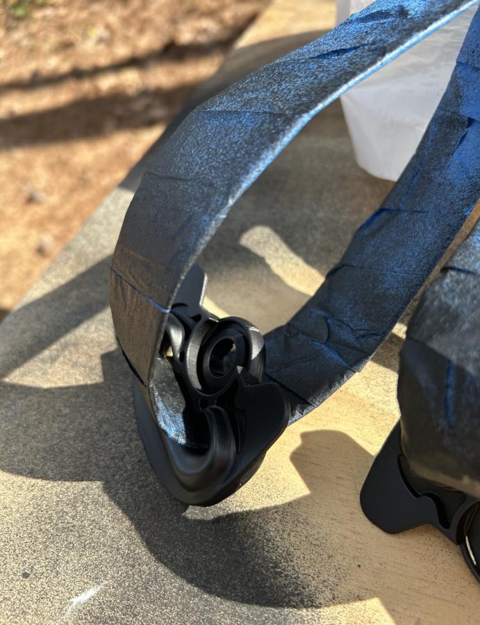

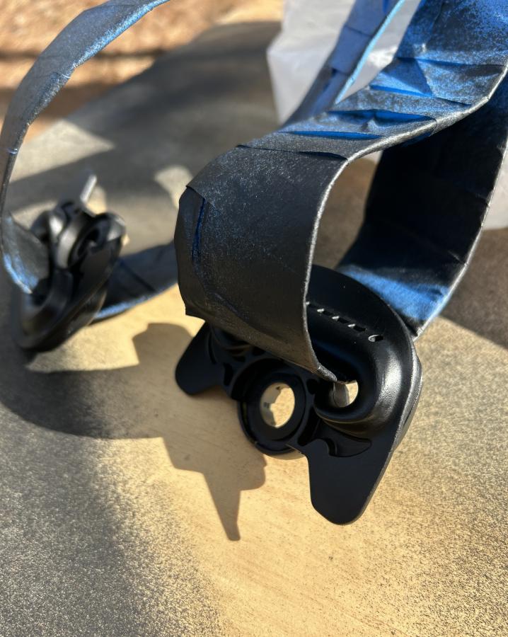

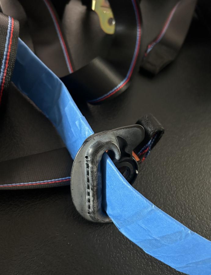

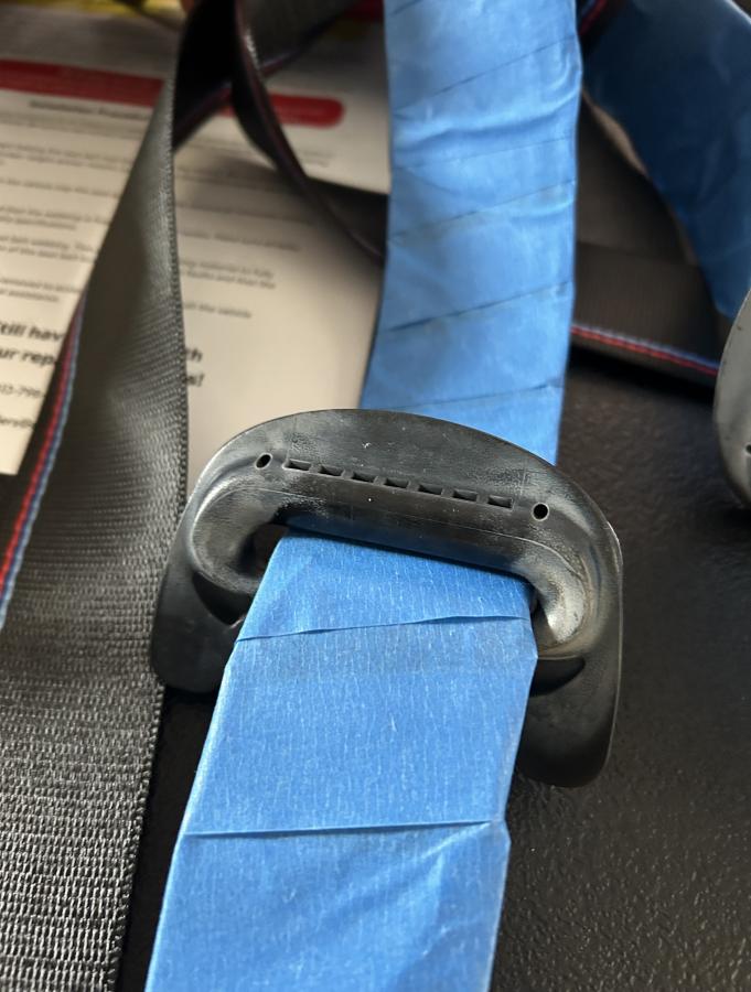

    I've been trying to get the car ready for the body shop the past month, just to make things easier for all parties like removing headliner and what not. Word to the wise, if you plan on getting new nylons for your seatbelts, I would highly recommend painting the little plastic piece that bolts to the sliding portion for the front seatbelts first. As you can see from the pics below, it was sort of an afterthought for me so I had to tape up the new seatbelts to paint those faded suckers. Mine were also cracking so I tried to epoxy it a little bit to prevent it from further cracking.
