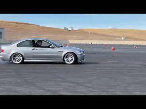

            -I also took it to a skidpad/car control day - it is very reasonably balanced and easy to slide. So much fun.
