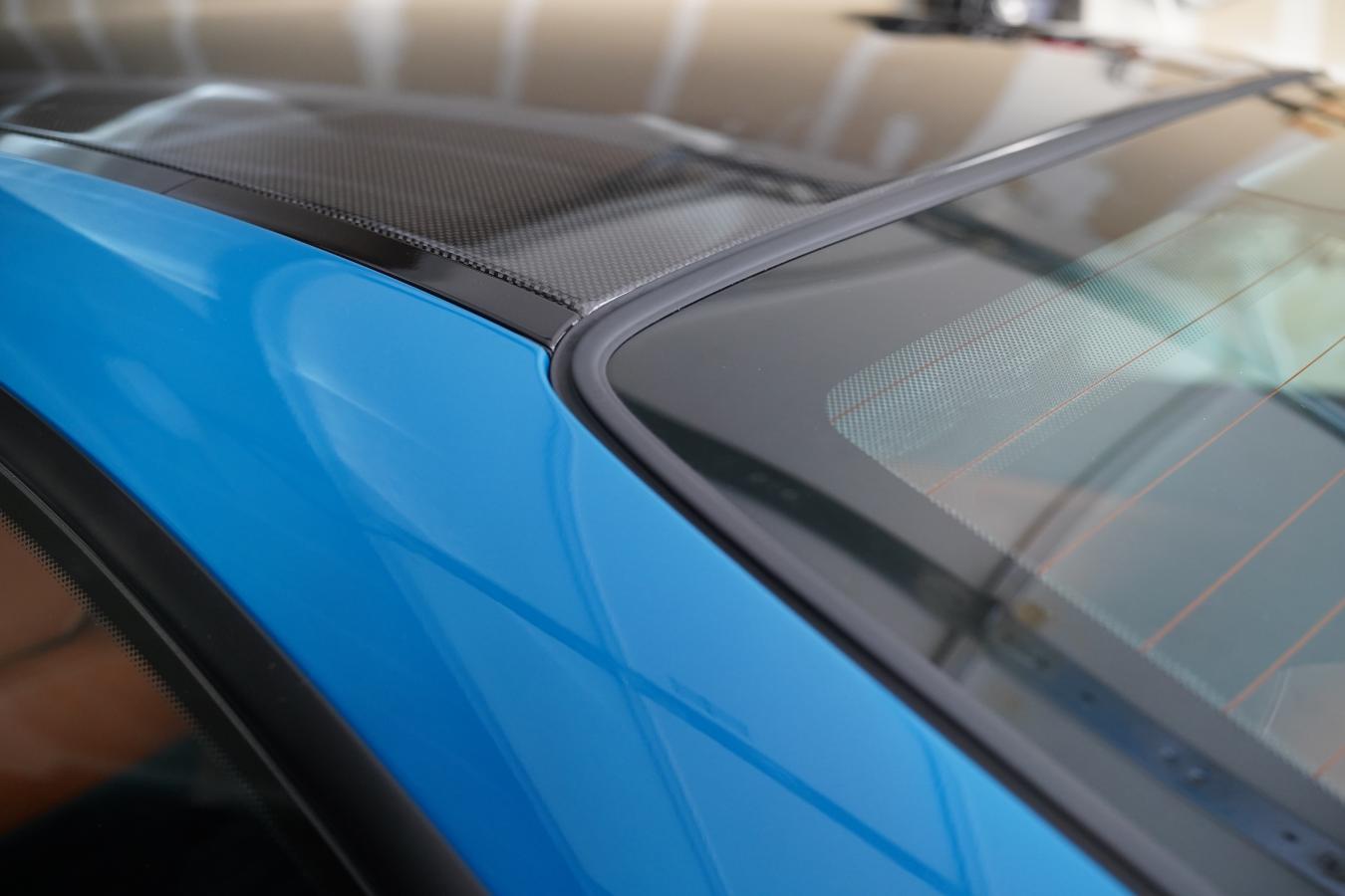

    Beautifully done. Its all in the prep work....
            Thanks. Definitely one that's significantly more prep than install.

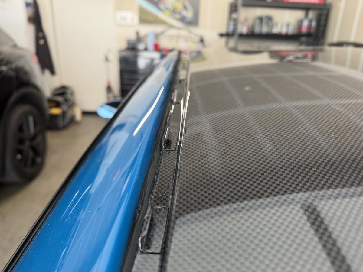

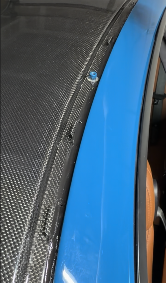

            I didn't see it mentioned, but did you do any trimming to the roof? From the homework I have done, the front protrudes 7mm too far over the leading edge and the rear hits the guide nubs.

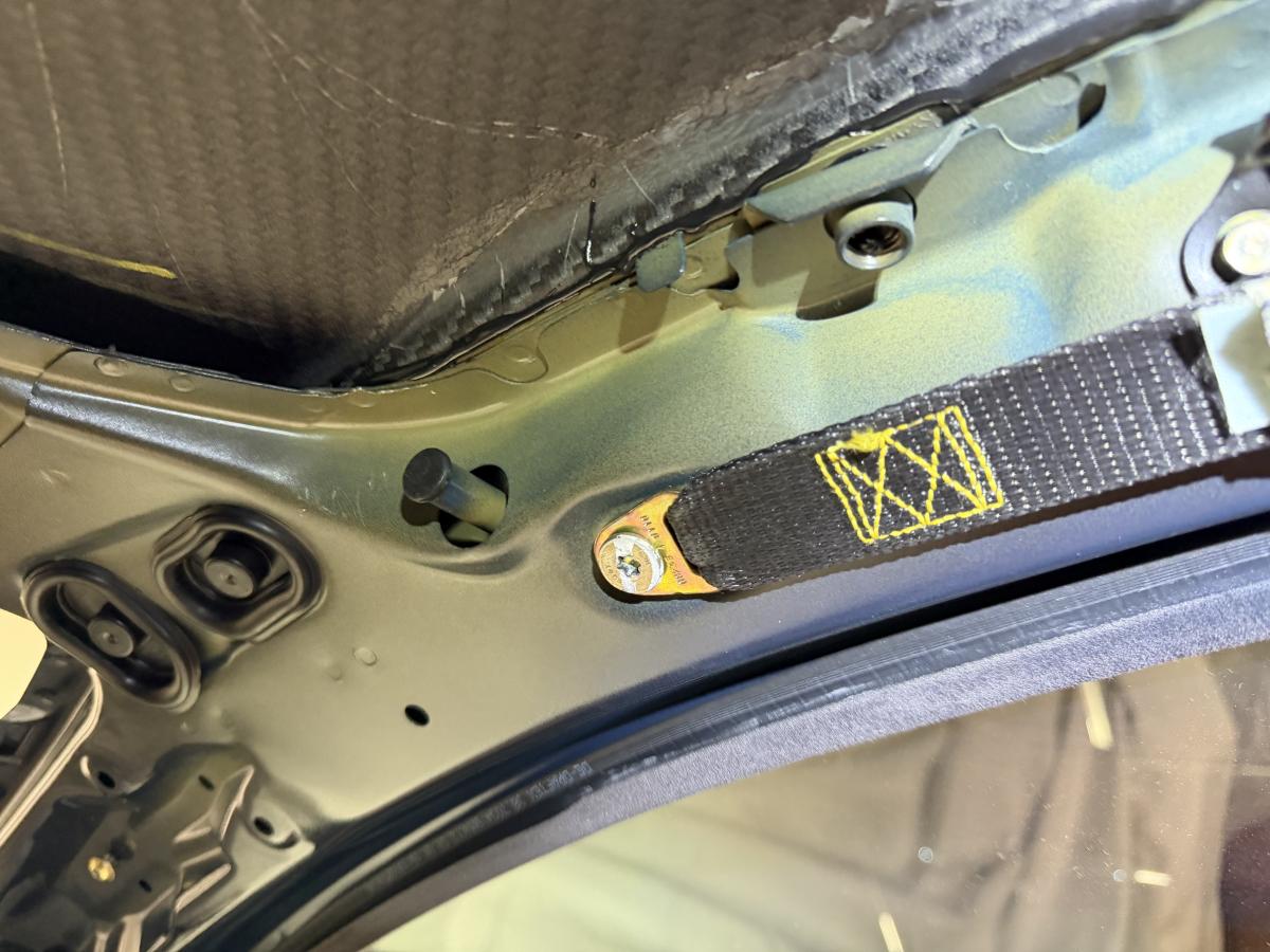

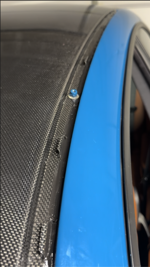

            Thanks! The only trimming to the roof was in this pic marked in yellow to accommodate the roof rack bolts: link, link
            The front does overhang, but it doesn't stop the windshield from being installed correctly, nor can it be seen afterwards. Grinding that much carbon would make a mess of fiber dust(no thanks).
            You could do your alignment(has to be nailed by this point), mark the overhang line on the underside, then trim it slowly with a vac behind the blowoff. Or a less optimal option - is trim it after bonding, but then you'd have to seal the chassis paint you'd inevitable grind off(perhaps not a big deal).
            On the guide nubs that is true. SQ13 highlights this in his diy. I ground mine down as I didn't want any additional parameters for alignment.

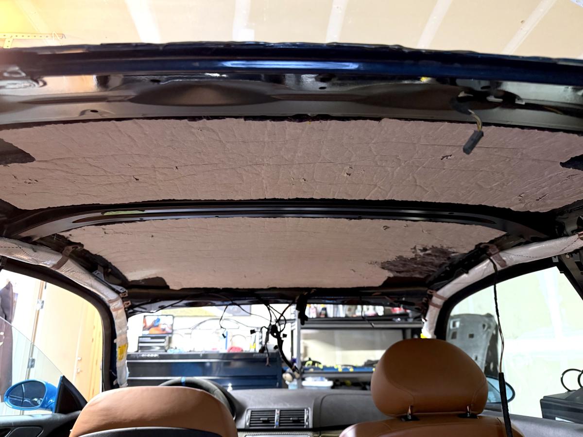

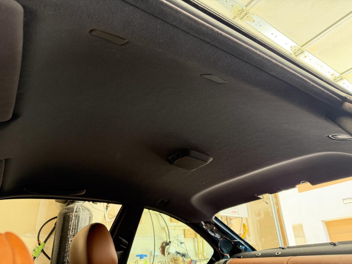

                    Let's work on the headliner first. Install is much easier with a windshield removed.
                    First I plugged the drains for the now deprecated sunroof. Probably unnecessary tbh. Just used some generic amazon rubber plugs with rtv added.
                    ​Click image for larger version  Name:	IMG_2392.jpg Views:	0 Size:	134.0 KB ID:	365874​​
                    Then in went the factory insulation. My dog was nice enough to tear up part of it while I had it stored my office one day.
                    Click image for larger version  Name:	IMG_2398.jpg Views:	0 Size:	127.2 KB ID:	365875​

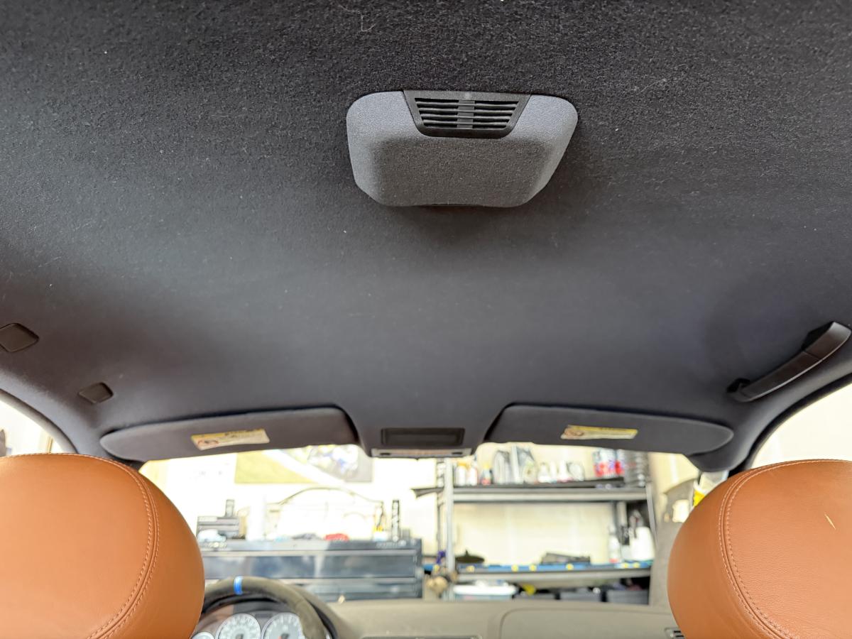

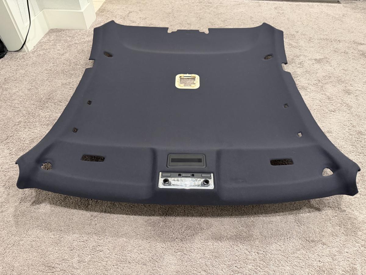

                    Prepping the headliner. New slicktop specific parts.
                    Click image for larger version  Name:	IMG_2408.jpg Views:	0 Size:	198.3 KB ID:	365876​
                    Don't actually install the light fixture till on the car.
                    Click image for larger version  Name:	IMG_2414.jpg Views:	0 Size:	184.1 KB ID:	365877​
                    Install is pretty easy. Don't forget to lower the window moldings to make life easy.
                    Click image for larger version  Name:	IMG_2420.jpg Views:	0 Size:	152.1 KB ID:	365878​
                    Click image for larger version  Name:	IMG_2466.jpg Views:	0 Size:	103.8 KB ID:	365879​
                    Click image for larger version  Name:	IMG_2470.jpg Views:	0 Size:	117.0 KB ID:	365880​

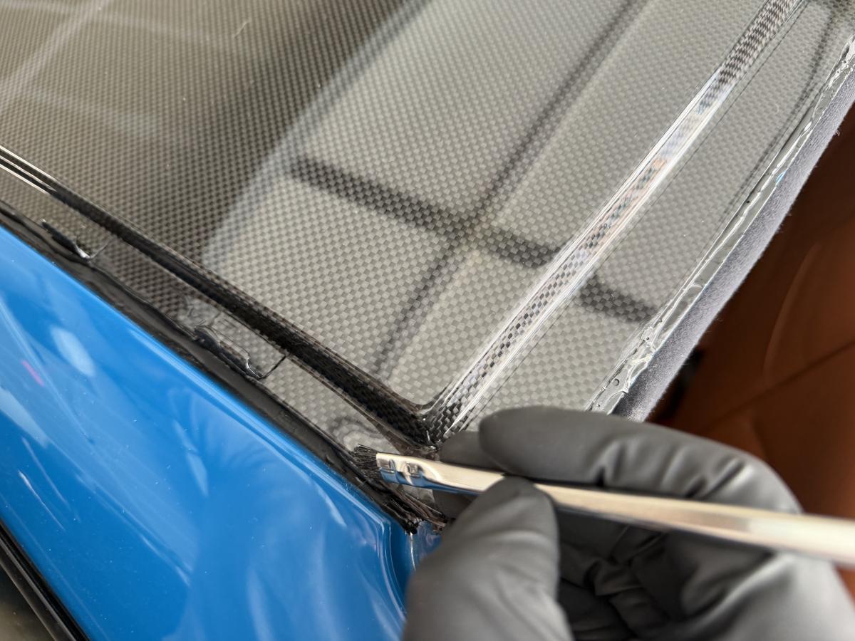

                    Before the glass installer would be summoned, I worked on finishing the roof rail channels.
                    It's good to finish this with sealer like the factory.
                    First I used a primer to finish any remaining exposed steel.

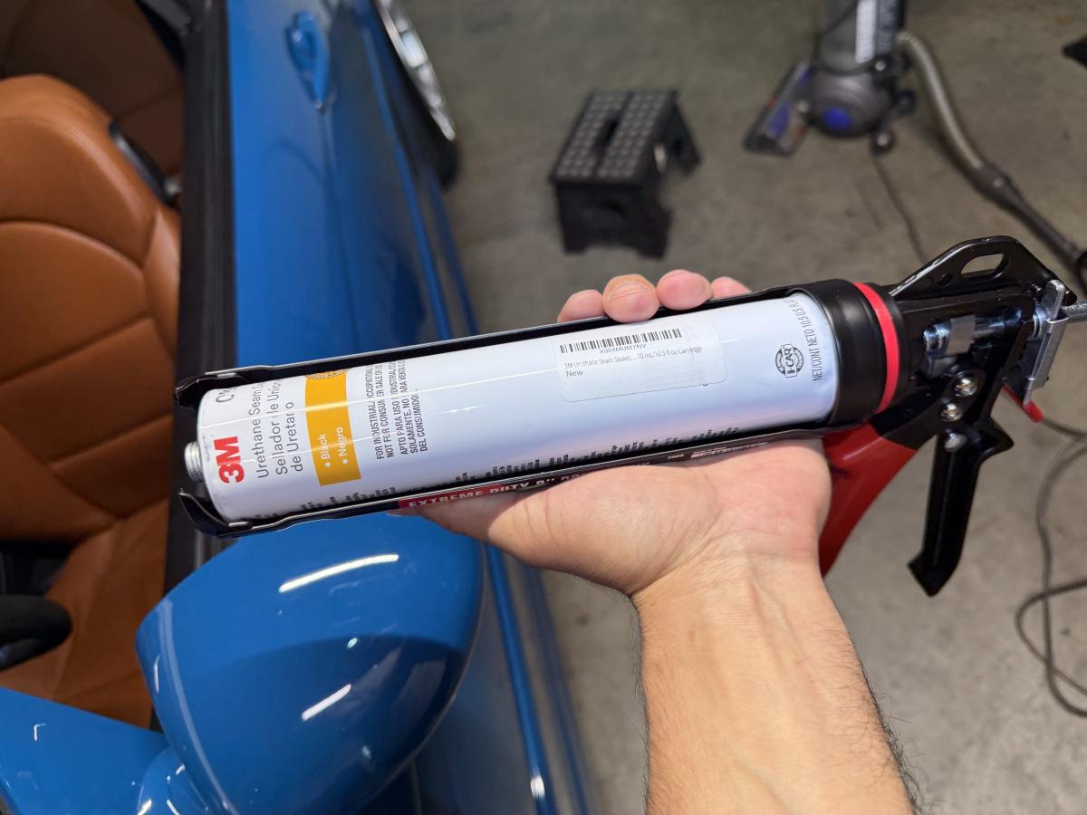

                    After ensuring no exposed steel is left, urethane sealer can be used.
                    Click image for larger version  Name:	IMG_2480.jpg Views:	0 Size:	90.9 KB ID:	365883​
                    Forget to take proper pics, but here are some screengrabs.
                    Basically I just masked off the area and filled in the channel gaps to aid in sealing and complete a factory like finish.

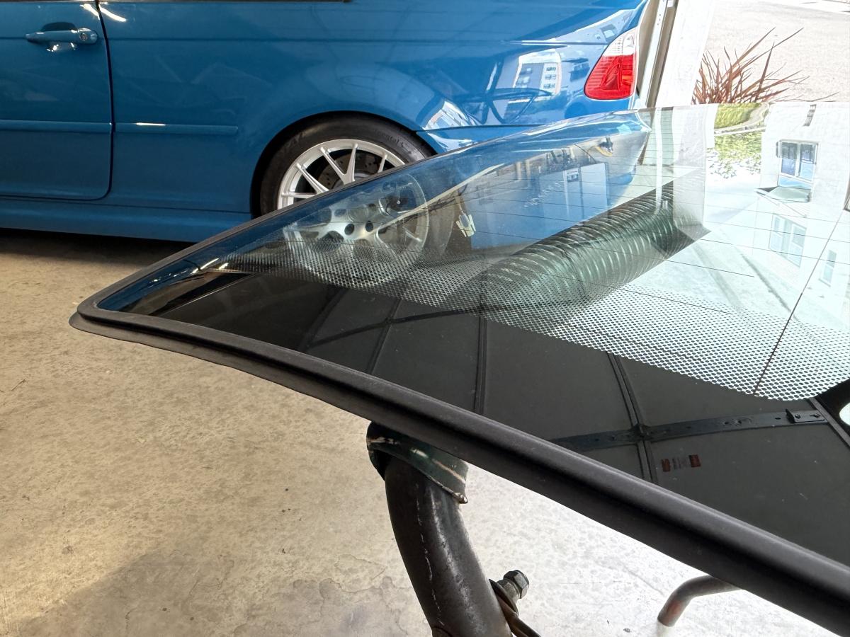

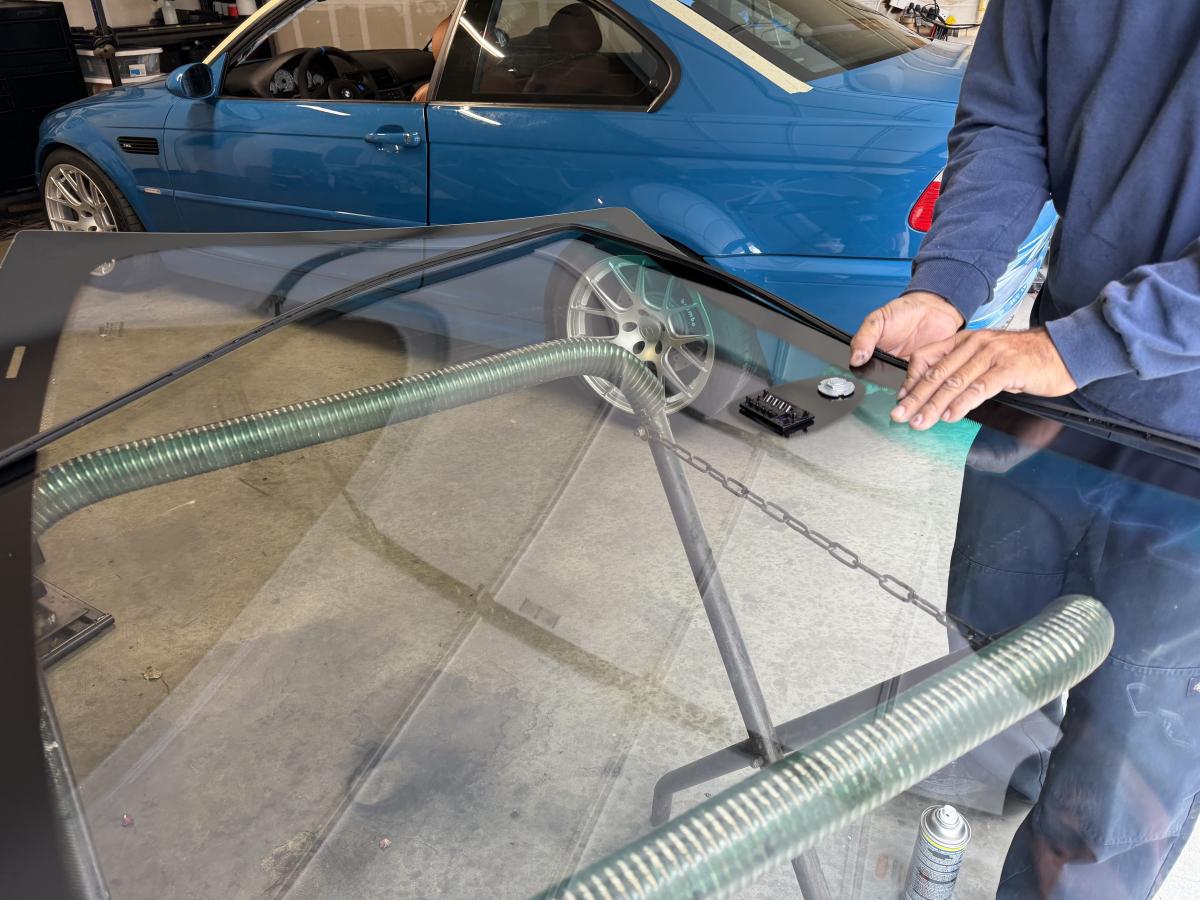

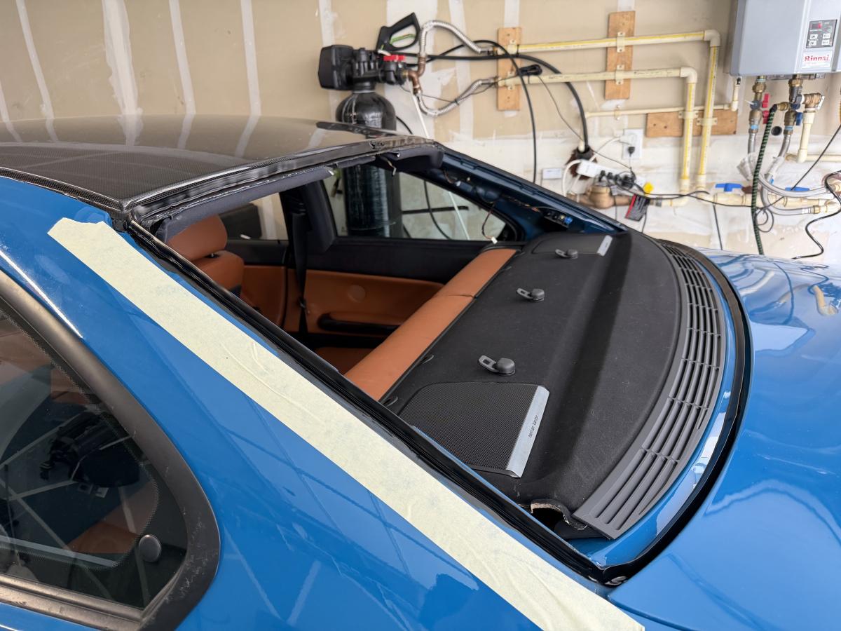

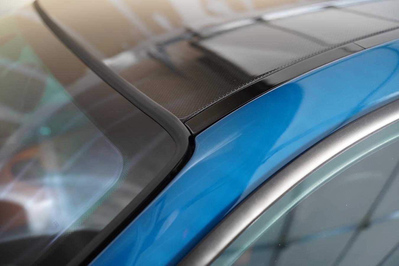

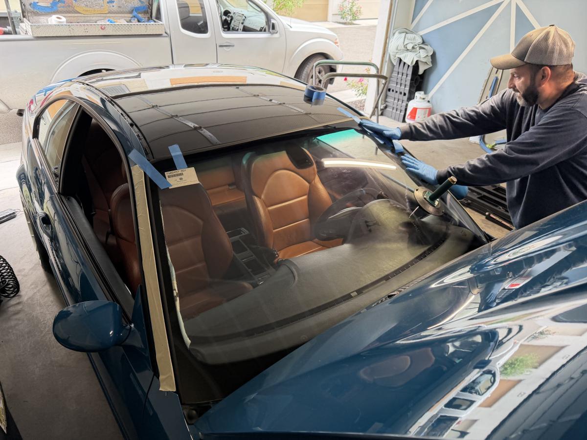

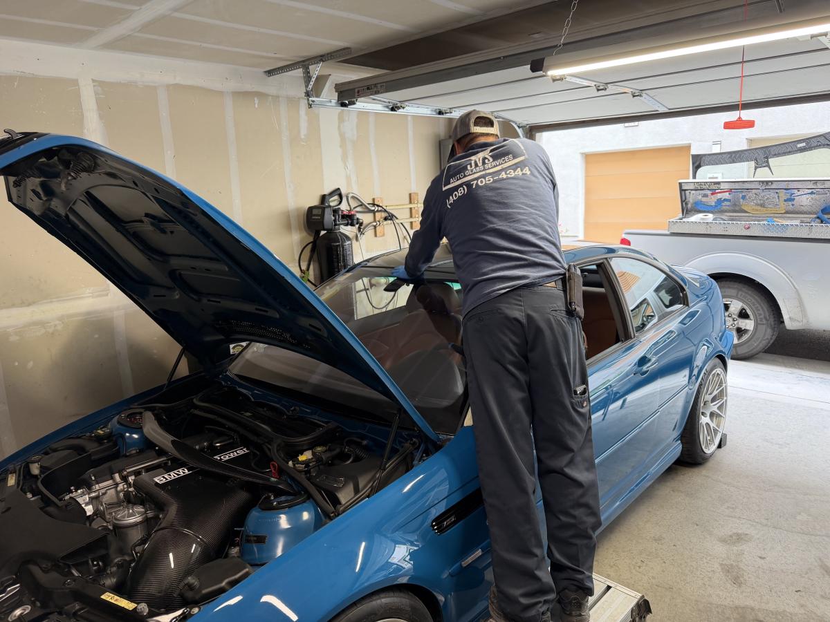

                    Now the glass installer could finally make his return. I was lucky to find someone talented, but also willing to work with my unique project.
                    I explained in detail exactly the expectations I had in terms of gaps, alignment, sealing the roof to pinch weld etc.

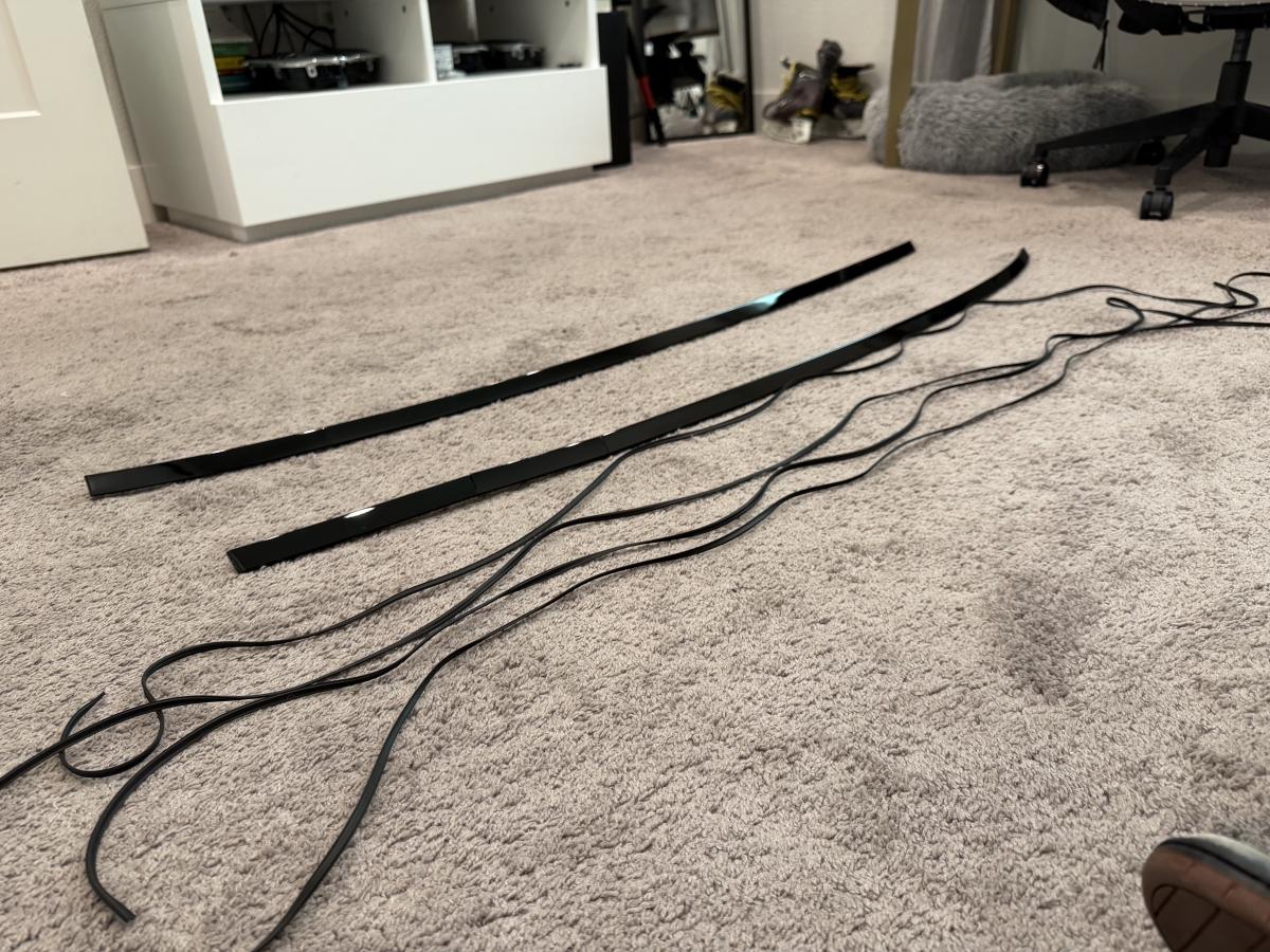

                    New seal trim being prepped.
                    Click image for larger version  Name:	IMG_2500.jpg Views:	0 Size:	156.9 KB ID:	365886​
                    Cool to see a pro grade triangle windshield adhesive bead. I think next time I do a roof install i'll use a powered adhesive tool.
                    Click image for larger version  Name:	IMG_2503.jpg Views:	0 Size:	134.8 KB ID:	365887​

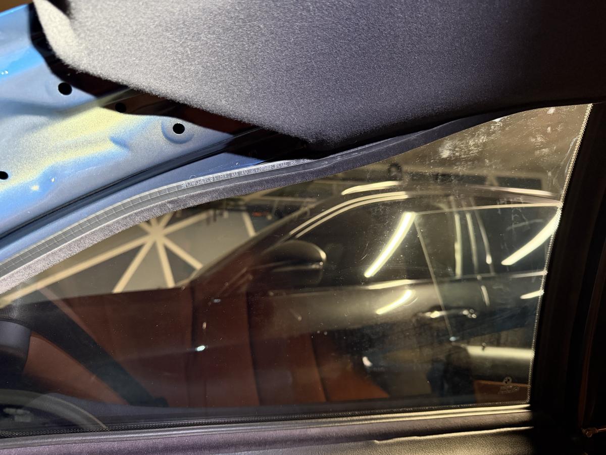

                    Bonus surprise. There's something different about the front glass than where I started with the Safelite junk the car came with =) I was quite lucky to source this unexpectedly.
                    Click image for larger version  Name:	IMG_2504.jpg Views:	0 Size:	144.8 KB ID:	365888​
                    Click image for larger version  Name:	IMG_2510.jpg Views:	0 Size:	149.9 KB ID:	365889​
                    Click image for larger version  Name:	IMG_2513.jpg Views:	0 Size:	148.2 KB ID:	365890​

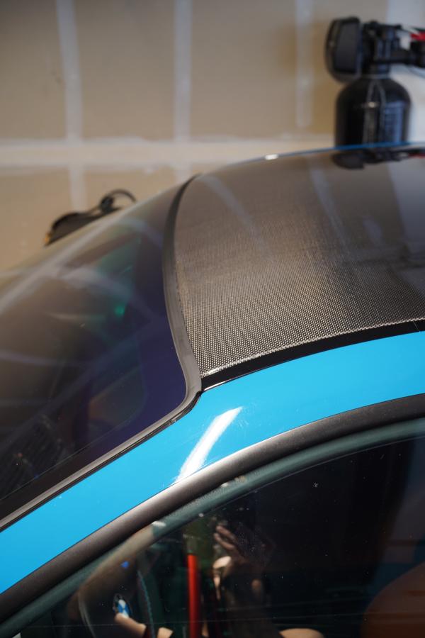

                    For the roof rails I sourced my own junkyard rails to repaint instead of repainting my factory ones. I just had my body shop do "gloss black" though I'd be curious what the exact paint code is for CSL roof rails.
                    Since the seals were junk, I replaced these with an awesome product from a provider matthewnavis.com. These install with no adhesive.
                    Click image for larger version  Name:	IMG_2594.jpg Views:	0 Size:	221.2 KB ID:	365891​

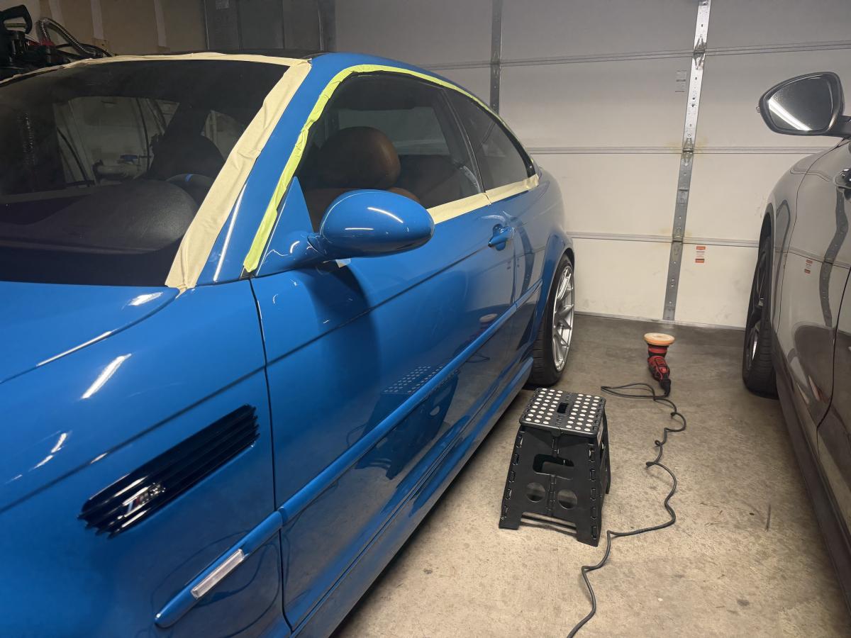

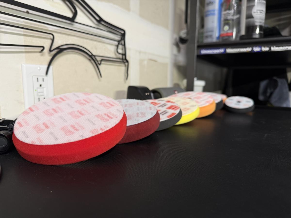

                    After all the grinding, hacking, drilling, the car desperately needed a wash, and a polish.
                    One thing turned to another, and I ended up doing a mild pass on most of the car.
                    Click image for larger version  Name:	IMG_2593.jpg Views:	0 Size:	79.8 KB ID:	365892​
                    Click image for larger version  Name:	IMG_2578.jpg Views:	0 Size:	116.9 KB ID:	365893​
                    Hourrs later, still not done.

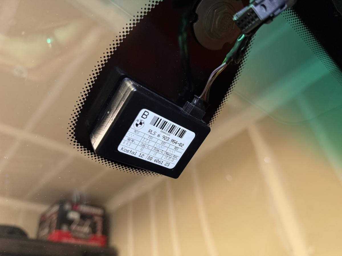

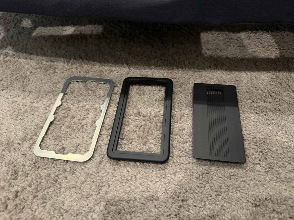

                    One final stage. So about the windshield. I was very lucky to source a NOS Pilkington "infrared". This came with a newer rain sensor style with automatic lights prism spec.
                    Click image for larger version  Name:	IMG_2596.jpg Views:	0 Size:	87.0 KB ID:	365894​

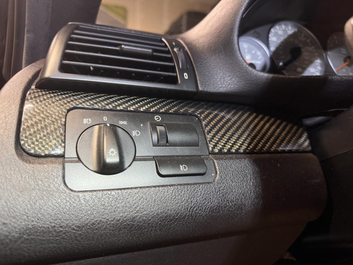

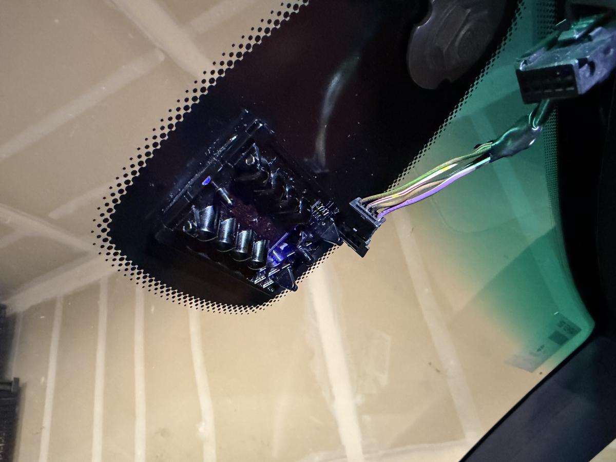

                    My module didn't fit as the spec was different, so another junkyard trip got this done. IIRC, I just had to go into INPA and initialize the module.
                    Click image for larger version  Name:	IMG_2601.jpg Views:	0 Size:	71.1 KB ID:	365895​
                    Since I had LED taillights all this time, I conveniently already had the updated LSZ. All this time, the automatic position (left most) didn't do anything, but now it finally works which is awesome.
                    Click image for larger version  Name:	IMG_2597.jpg Views:	0 Size:	162.5 KB ID:	365896​

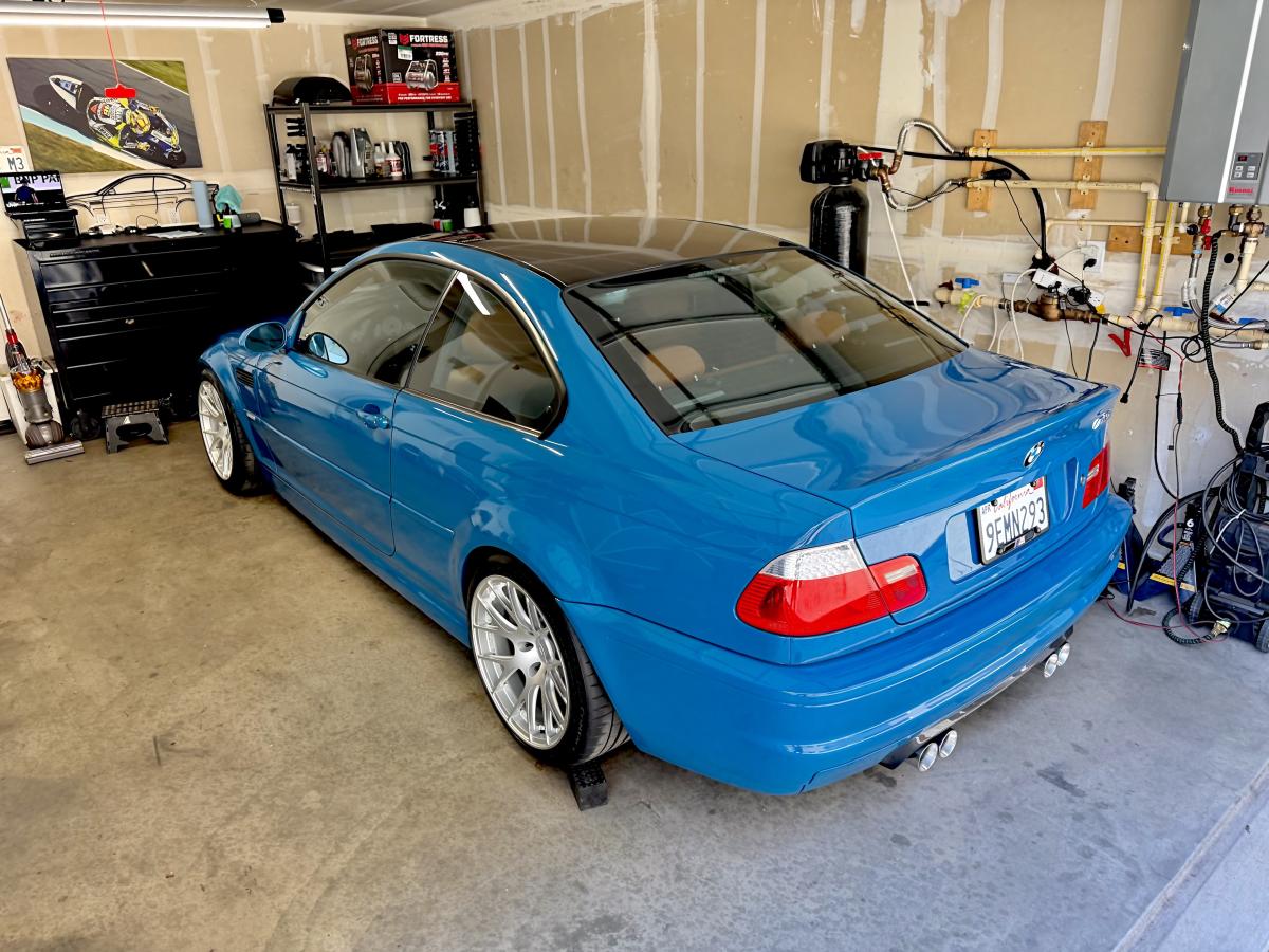

                    Finally 100% complete. What a journey!
                    Here are some final shots.
                    ​Click image for larger version  Name:	06219CDC-9E63-42FB-8EEC-91EC4E66549CDSC00057.jpg Views:	0 Size:	46.6 KB ID:	365897​
                    Click image for larger version  Name:	C945D706-E687-4B15-B392-119762EB9E10DSC09930.jpg Views:	0 Size:	73.5 KB ID:	365898​
                    Click image for larger version  Name:	CCFF5142-435E-487A-A48D-AFBC26F4A61EDSC09909.jpg Views:	0 Size:	74.8 KB ID:	365899​
                    Click image for larger version  Name:	0C3333F7-046D-404B-8E20-FA56B9FC9889DSC09888.jpg Views:	0 Size:	153.6 KB ID:	365901​
                    Click image for larger version  Name:	IMG_2611.jpg Views:	0 Size:	175.2 KB ID:	365900​
                    Click image for larger version  Name:	ruJaHe1PSPqFZ0xZI-d8Ew.jpg Views:	0 Size:	171.9 KB ID:	365902​

                      It looks like you retrofitted the Auto headlights.....Any more info on that? Just for my own info as i recently replaced the windshield any way.....
                        WOW amazing work brother. Car looks stunning.
                        Thanks - glad to explain if you want over DM.
                        In a nutshell you just need the correct windshield prism, then the correct RLS module also pictured. Then the updated/post 03'? lsz (3.6 software) with the auto headlight switch. Code it all in PA soft (easy) or Inpa easy work!
                        🔹 2001 M3 Laguna Seca Blue
                        Instagram: link
                        Build thread: link
                          YEs please that would be awesome. What about the wiring? My car is already 03.5 with the updated Module, The previous owner just didnt tick the auto headlight box.
