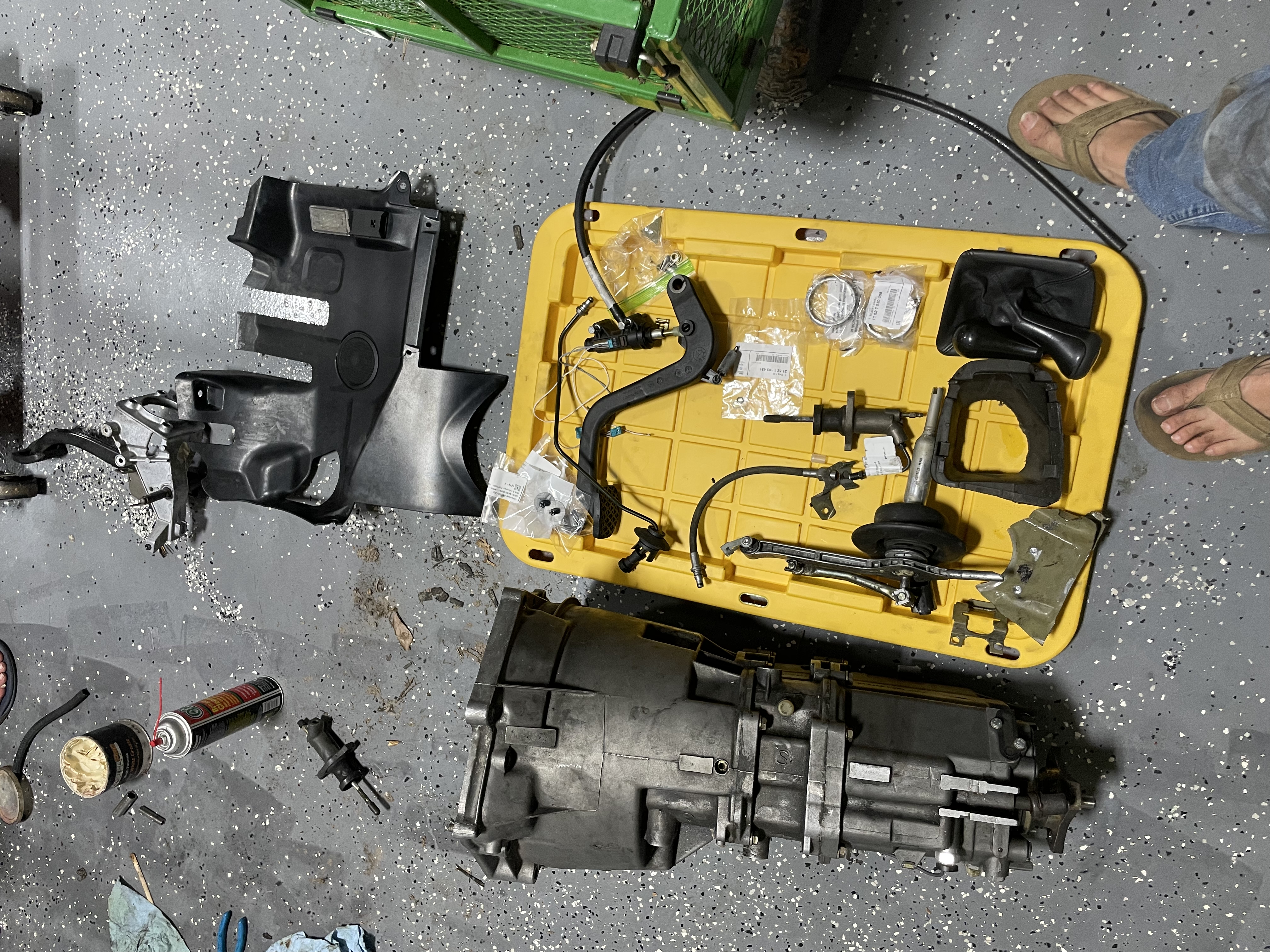

    Ladies and Gentleman, I believe it is time...
    Almost everything here is used, so that's fun but why new when used will do. I refreshed the shift bushings with OE at least.
    I believe I have everything, I did the GPS delete by manually editing the bin file. Than Jay popped it into his Ecuworx for me and did the rest of the manual changes needed.
    I modified the .xdf for this and here is some notes I have as the ones in the manual swap thread were kinda confusing.
    MSS54HP .bin Modications:
    1) Modify K_SKRAFTS_CONTROL to 0x02
    • Location: 0x4028
    • Edit: Set to 0x022 (default is 0x011)​
    • Purpose:
      • The DME currently treats the clutch sensor and Gear Identification Sensor as one, since they are wired in serial.
      • This setting aligns the behavior with how the Z3M is wired, where the clutch switch is directly connected to the DME.
      • With this change, the DME will recognize that the circuit can still be closed even when the car is in neutral with the engine running.
    2) Modify K_S_GANG_LL_ED to 0xFFFF
    • Location: 0x5952 on 2001/2701
    • Edit: Set to 0xFFFF65535 (default is 0x003250)​​
    • Purpose:
      • This prevents the DME from throwing an error when the car is idling with the clutch engaged (up).
      • It essentially adjusts the logic for idle behavior, ensuring that the ECU does not falsely detect an issue when the car is stationary.
    ​3) K_MD_MIN_VERH_KRAFTS
    • Purpose: This parameter defines the minimum torque threshold required for certain powertrain functions to be active.
    • Edit: Set to 0xA0160 (default is 0x80128)​
    • Location:
      • 0x67E0 on MSS54
      • 0x88A2 on MSS54HP
    • Default Values:
      • US cars: 0x80 (128 in decimal)
      • Euro cars: 0xA0 (160 in decimal)
    The plan is to throw it all in this weekend, flash it and see what happens. I am most nervous about removing the Plenum as I haven't done that yet.
