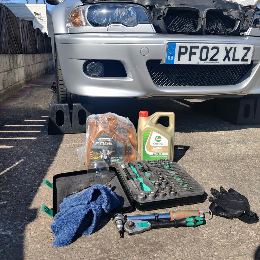

    First job as with all new-to-me cars, an oil change (not needed yet, but...)
    Grabbed a Mahle service kit inc a set of NGK plugs and a few gallons of Castrols finest. It last had an oil change less than 2k miles ago at Redish as part of a trip there. 4-5k will be the OCI for this car going forwards as that'll be close to my yearly mileage.
    The sparkplugs, intake & pollen filter were changed as part of the inspection 2 so I'll leave them & set them aside and the next oil change can be a full service.
    Cost: £160 (with plugs, pollen & intake filter left over)

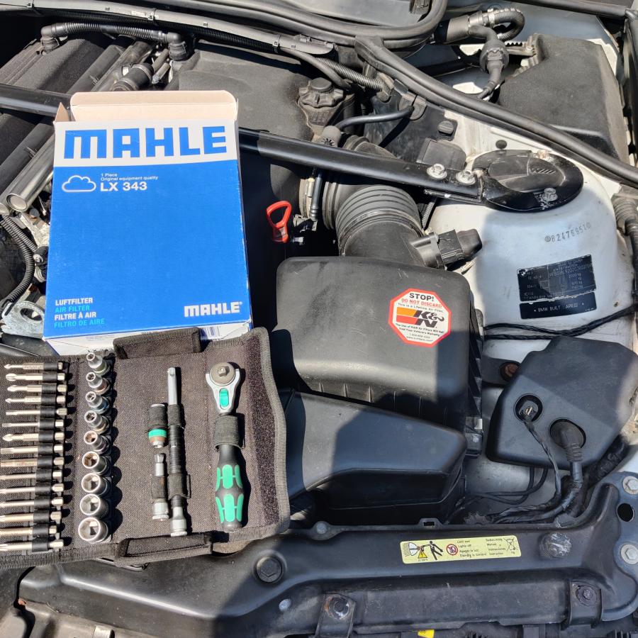

        Bye bye, K&N...
        Just a personal opinion, but I'm not a fan of K&N (or most other aftermarket panel filters) that the previous owner installed. I don't believe they offer better filtration than a regularly changed OE paper filter, the whole oiling process is a faff and can potentially gum up MAF/AFMs etc if overly heavy with the application, plus people rarely clean them out at regular intervals (as evidenced...).
        Swapped out for a Mahle filter, the outgoing filter did not look to have been cleaned for a long time - it was covered in crap.
        At some point I'd like to explore a carbon intake/airbox, but for now the OE setup is fine.
        Cost: Free (filter accounted for previously)

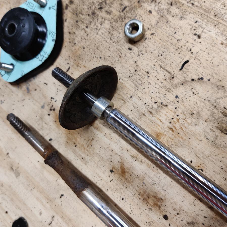

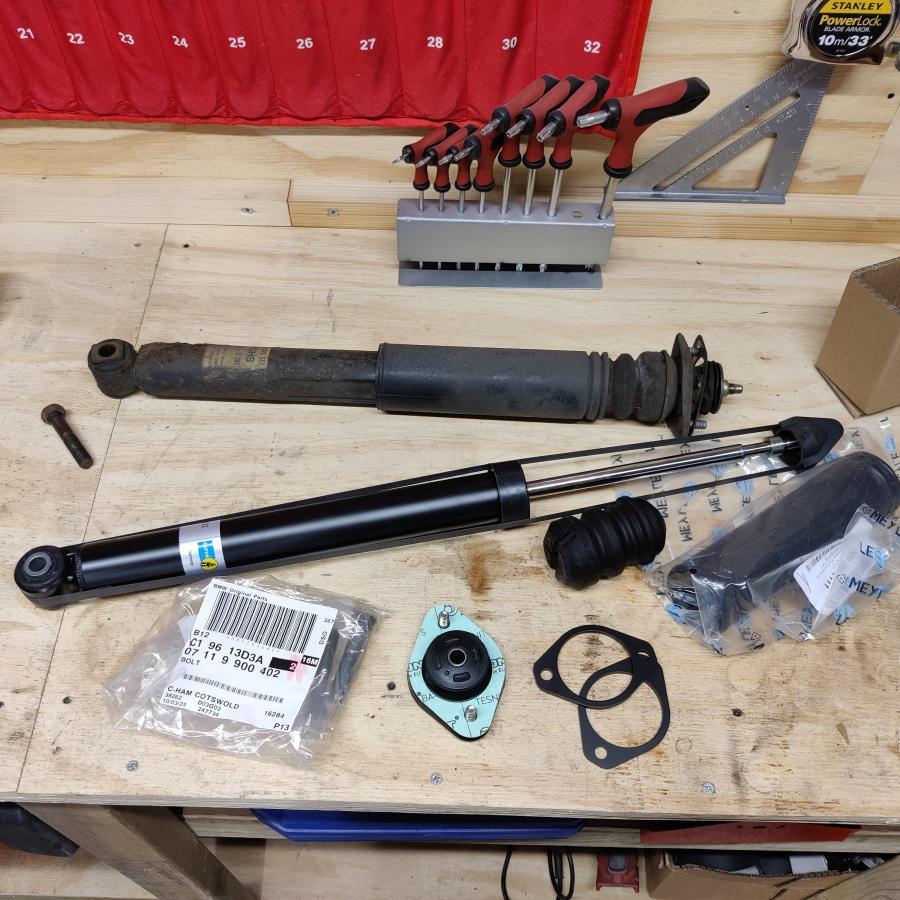

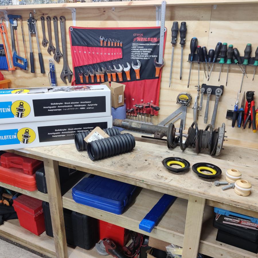

            Rear struts...
            Ordered & fitted the following:
            -B4 struts
            -Bilstein top mounts
            -Z3 reinforcement plates
            -OEM bump stops
            -Shock covers
            -New hardware (lower bolt, upper nuts etc)

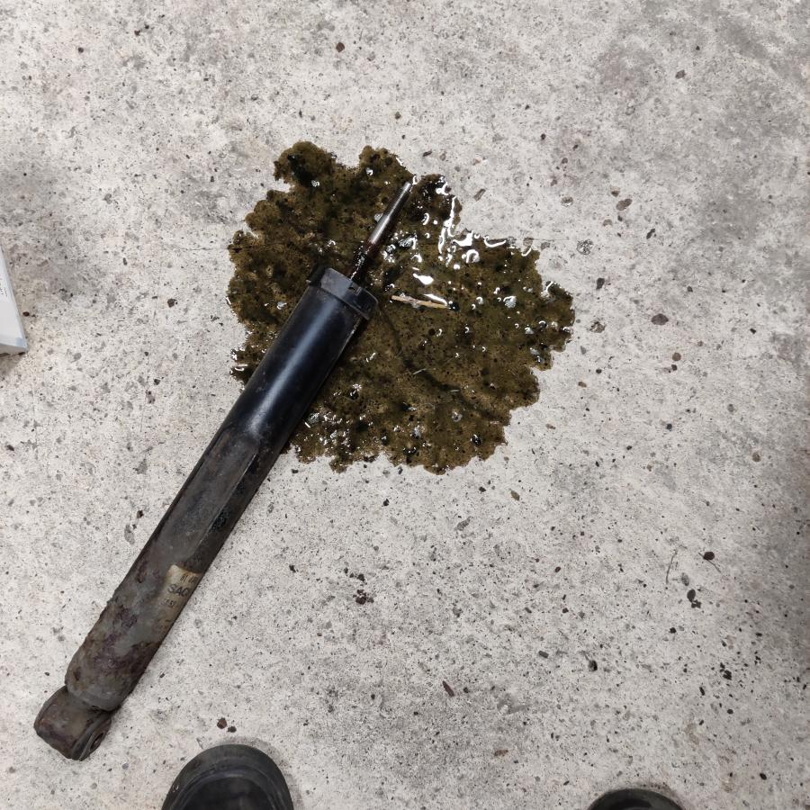

            I plan on a full drive-line refresh (anything rubber or suspension related front to back) but budget and time dictates I do this in stages as and when funds & free time comes available.
            Old shock decided to empty its oil when I tested it off the car, no visible leaks when it was fitted though. Odd wear pattern on the shaft, looks like some crud had gotten in-between it and the bump stop, and had worn it down over time, precariously thin & pitted.

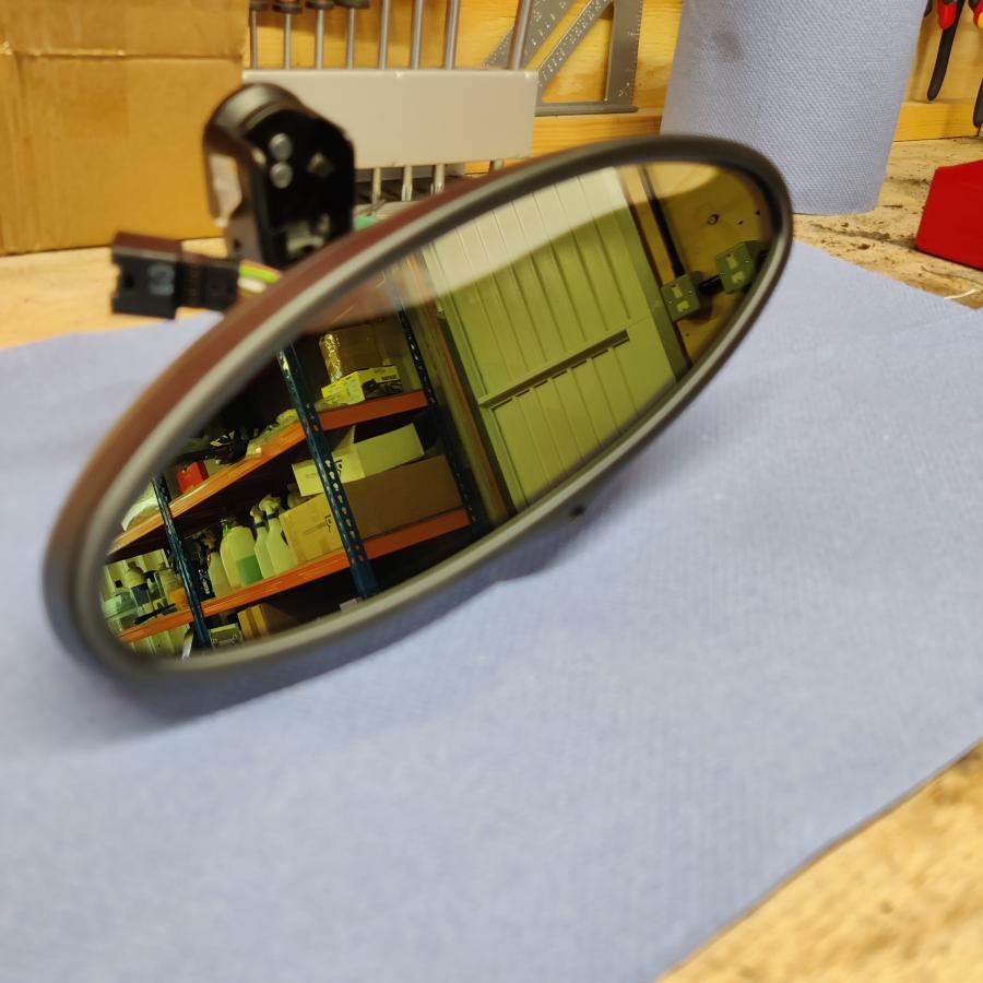

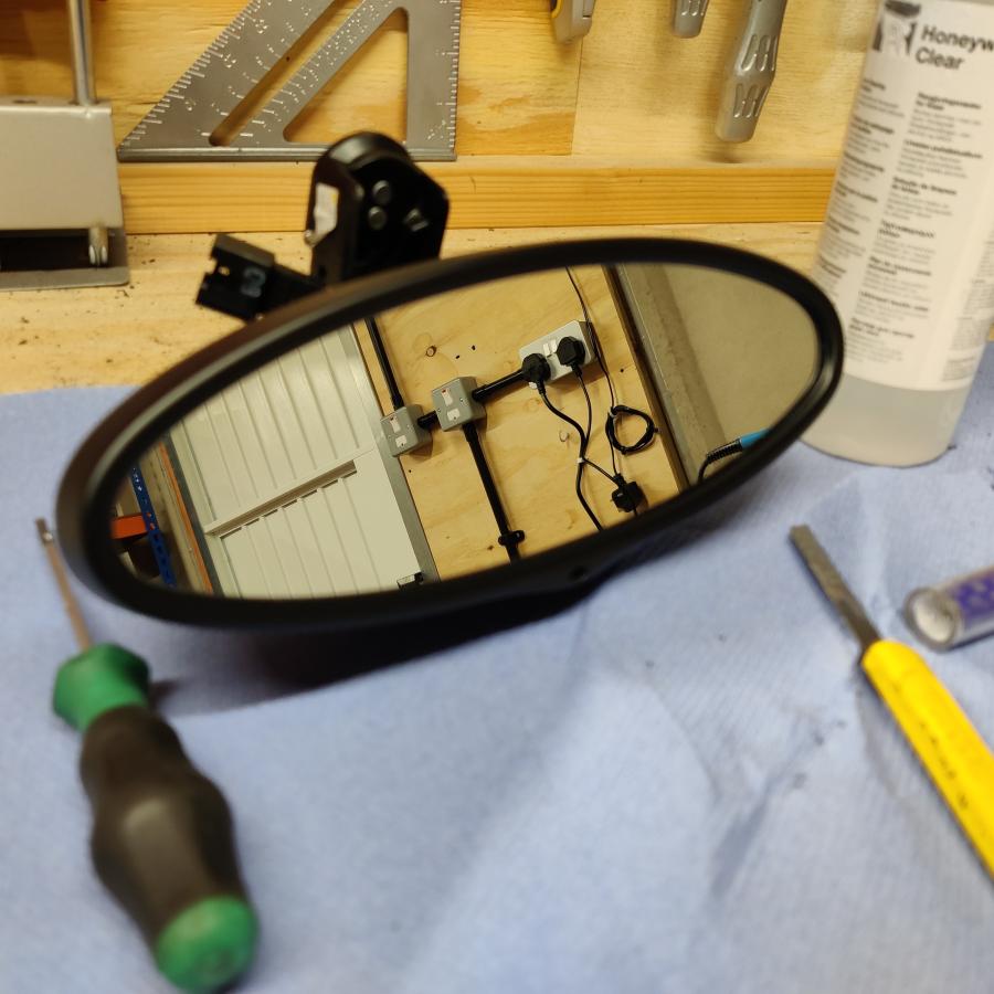

              Rear view mirror...

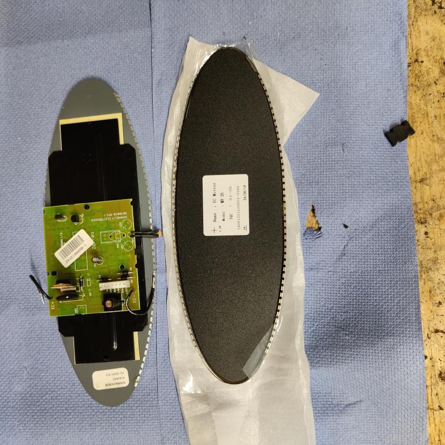

              Rear view crystal had almost entirely failed, leaving a bright strip along the top but the rest of the mirror was permanently dimmed. This car had previously been driven very little & stored in the garage. With the heat of summer I didn't want to put this job off any longer and risk it leaking & damaging the trim.
              Straightforward job, mirror removed & soldered the new one on the bench. Getting the mirror casing apart & back together without breaking any clips is by far the worst aspect of this job.

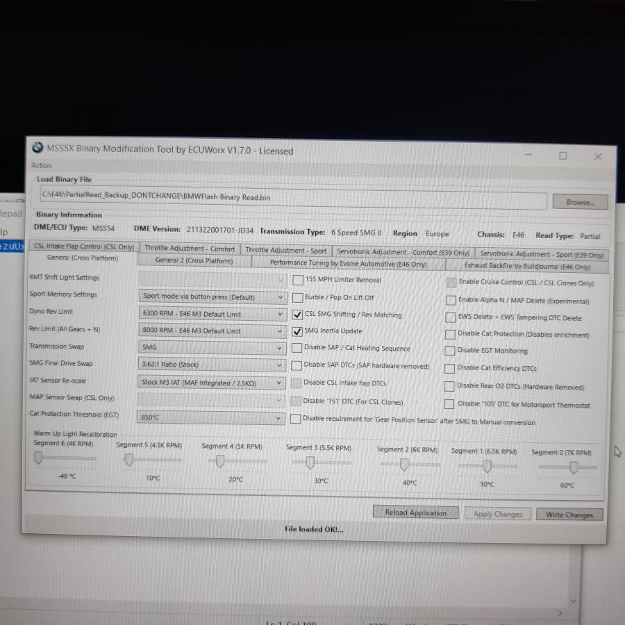

                A digital day..
                The laptop, KDCAN cable and PSU came out today. Flashed the DME with the CSL rev matching & inertia tune for the SMG, as well as the v255 firmware so everything is talking together currently as per a factory CSL setup.
                What a difference this has made - I think had this been setup from factory, the usual SMG slating would be practically none-existent.
                By far the best upgrade & money spent on any car I've had to date. For those familiar with XHP/ZF8s, the before/after is even greater on this - throughly recommended & relatively straightforward to do. Auto mode is genuinely useable now, no hint of the car throwing in a shift midway through a corner now...
                Cost: £20 (Ecuworx license)

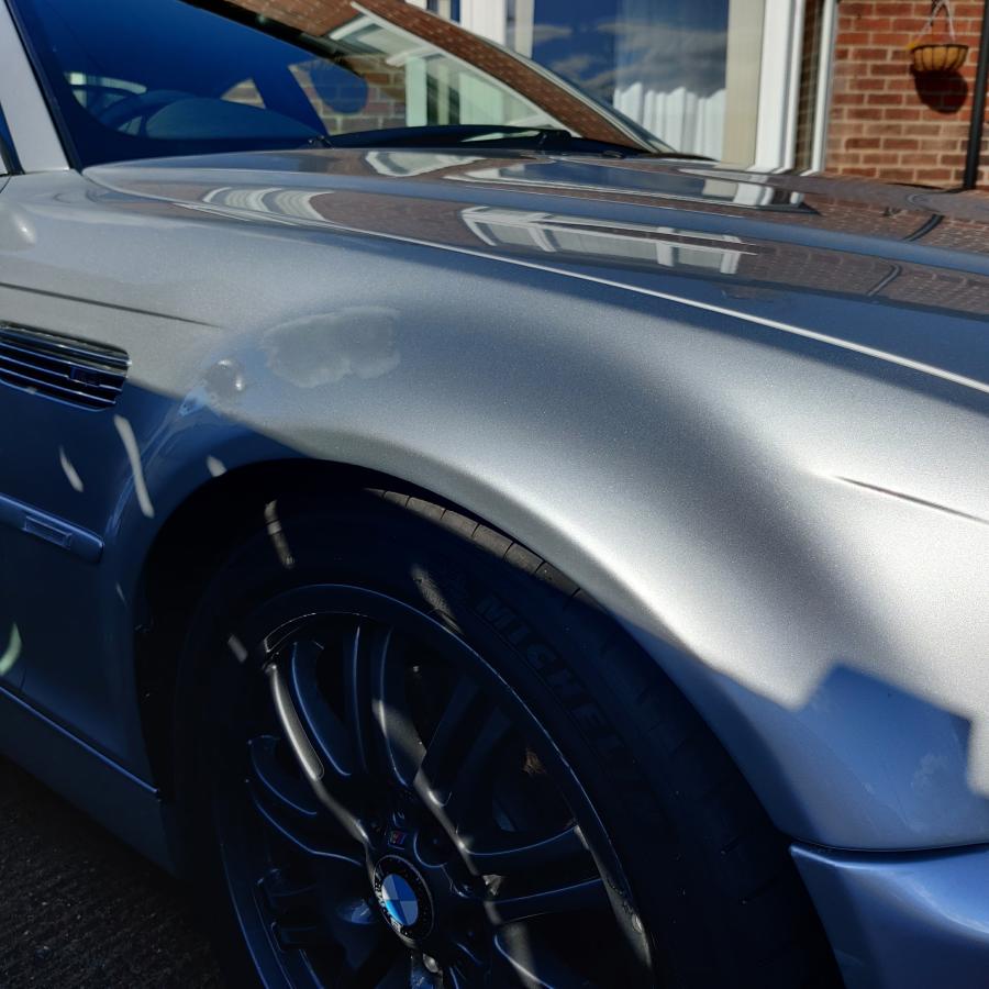

                  Wing crust...
                  As mentioned prior, the only thing now letting the outward appearance down was a dent & some bubbling on the front wing. Inevitable wing crust has started showing since the cars now in use & driven often. Replacement wings are budgeted for in the future but for now I've just had a spot repair carried out - not expecting it to last forever as rust repairs never do, but if it sees me through until later in the year I'll be happy & the guys that carried the work out offer a no quibble lifetime guarantee, so new wings might be further away than initially thought.
                  Really happy with the paint match & overall finish especially considering I'd asked for it done cheap assuming there'd be no warranty/come back due to the nature of the repair, courtesy of Bentley Designs/Bay2Autos in Normanton, Wakefield.
                  Cost: £200

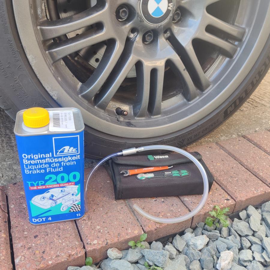

                    Brake fluid flush...
                    Flushed the 2yr old fluid with Typ200. Old fluid looked okay, bit darker than expected.
                    Cost: £20

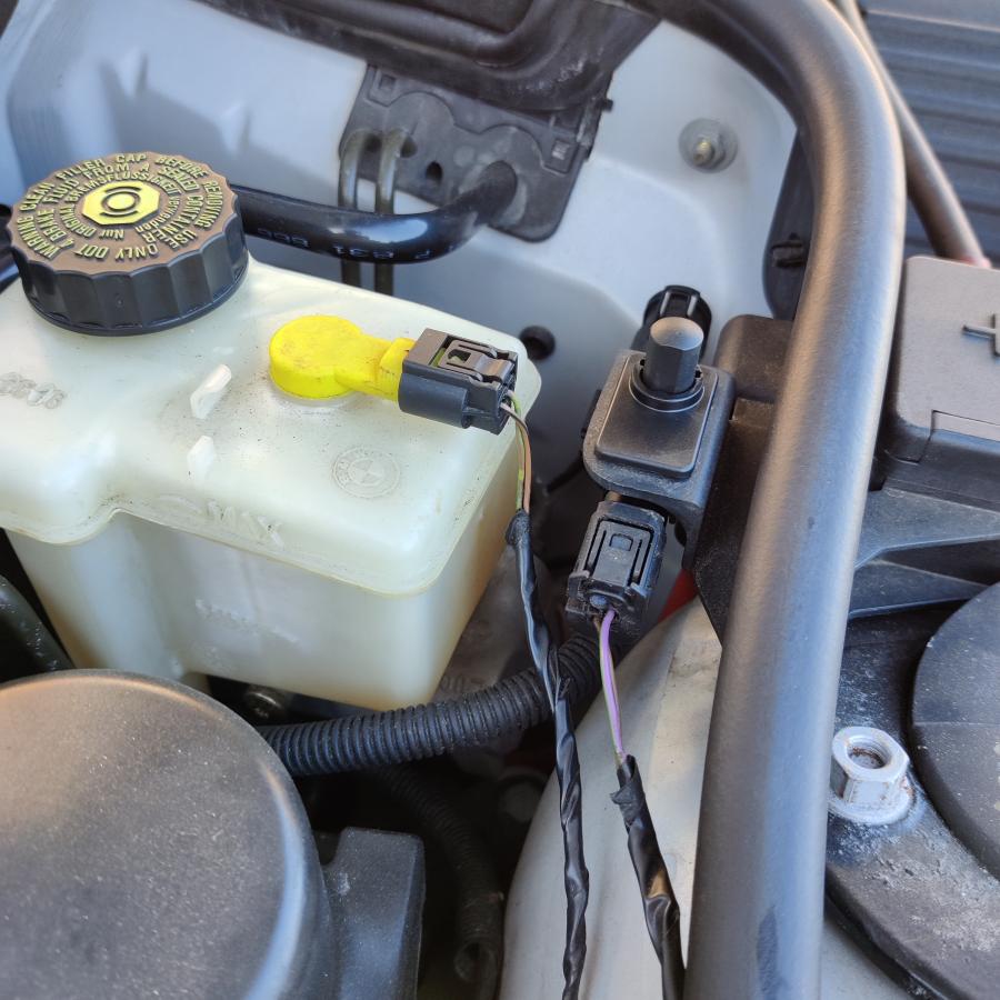

                      The alarm has gone off a few times when the car has been sat. I assumed it was the bonnet switch as it usually is with E46s... There was some dielectric grease on the switch connector, so someone's been here before. Leaving it unplugged proved me right as the alarm didn't go off after unplugging and a new one arrived shortly after from Cotswolds BMW - fitted and no issues since.

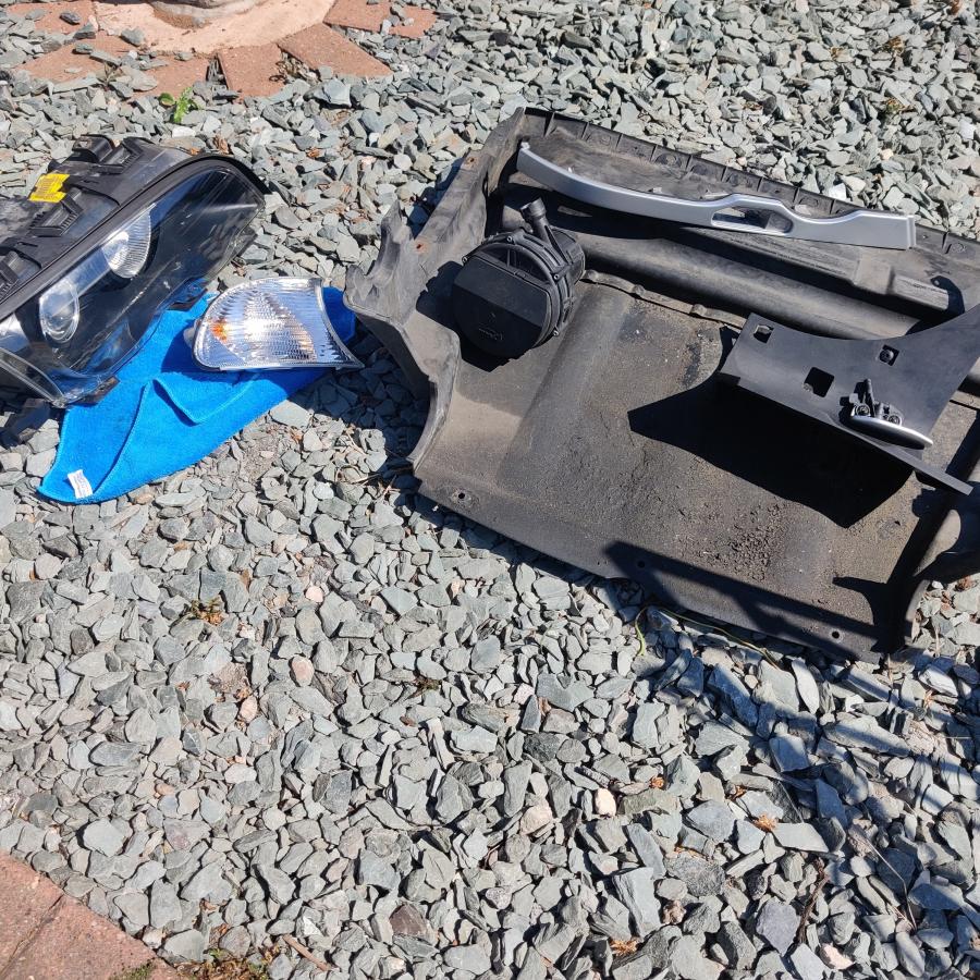

                        To gain access to the drier & compressor I removed:
                        - Engine undertray
                        - Headlight, washer assembly and trim
                        - SAP
                        - Bit of the fan shroud trim
                        Also undid one of the mounts for the oil cooler to tilt it, allowing the compressor to come out. It was either that or the ARB.

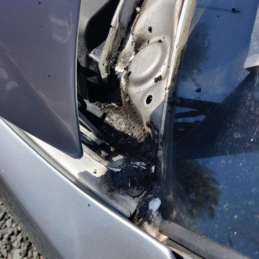

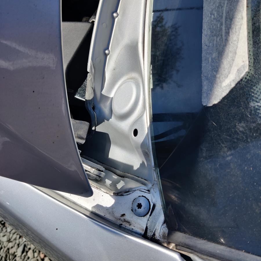

                            Windscreen scuttle/trim...

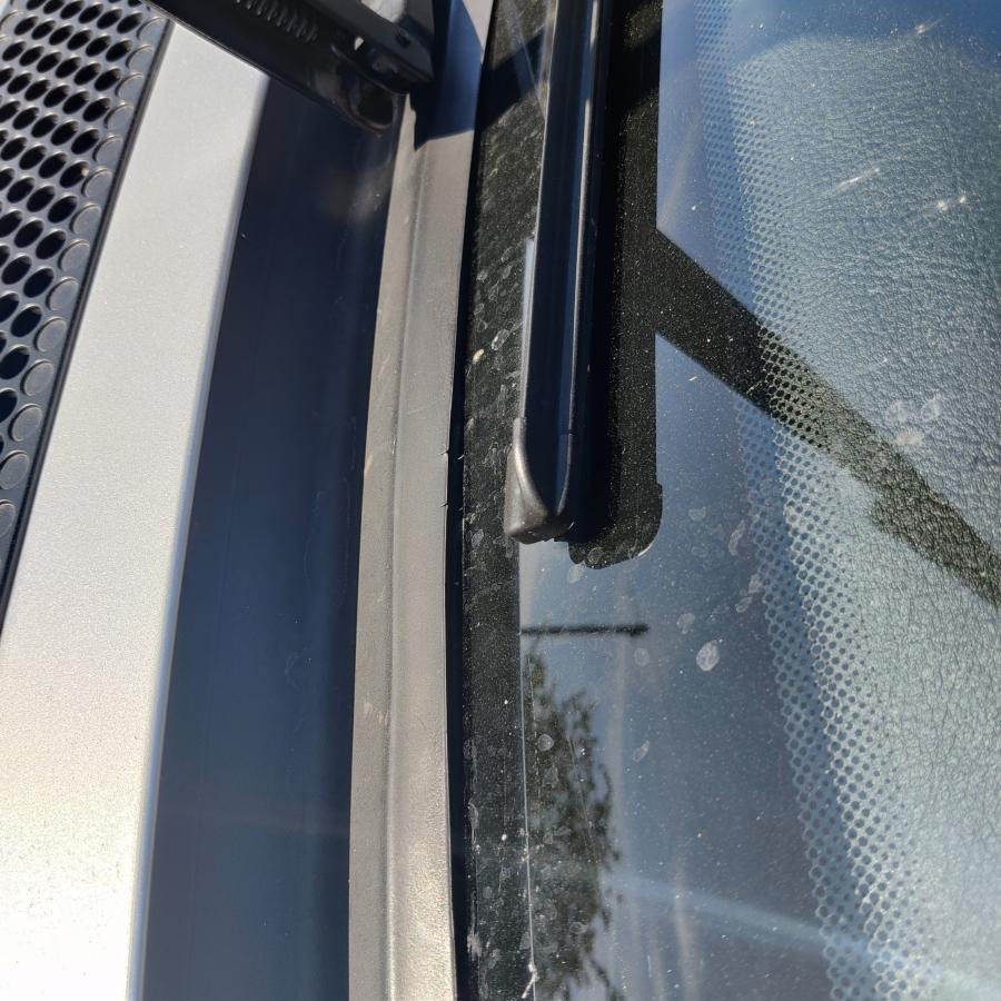

                            Noticed a small gap under the LH wiper, looked like one of the clips that holds the scuttle cover on had broken and wasn't sitting straight, holding the cover off the scuttle to create a gap.
                            Turned into a pig of a job due to seized wiper splines & none of my pullers fitting. Got them off eventually, replaced all the clips & washed 23 years of assorted dirt/road grime from under the panel - scuttle looks almost new now (all paint/seam sealer intact, no hints of rust which I was happy about as I know this can be a common spot) & the cover sits flat again. Changed the pollen filter whilst I was in there.
                            Cost: £12 (7x trim clips from the stealers)
