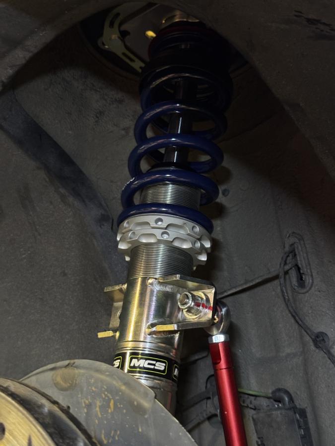

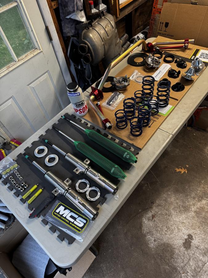

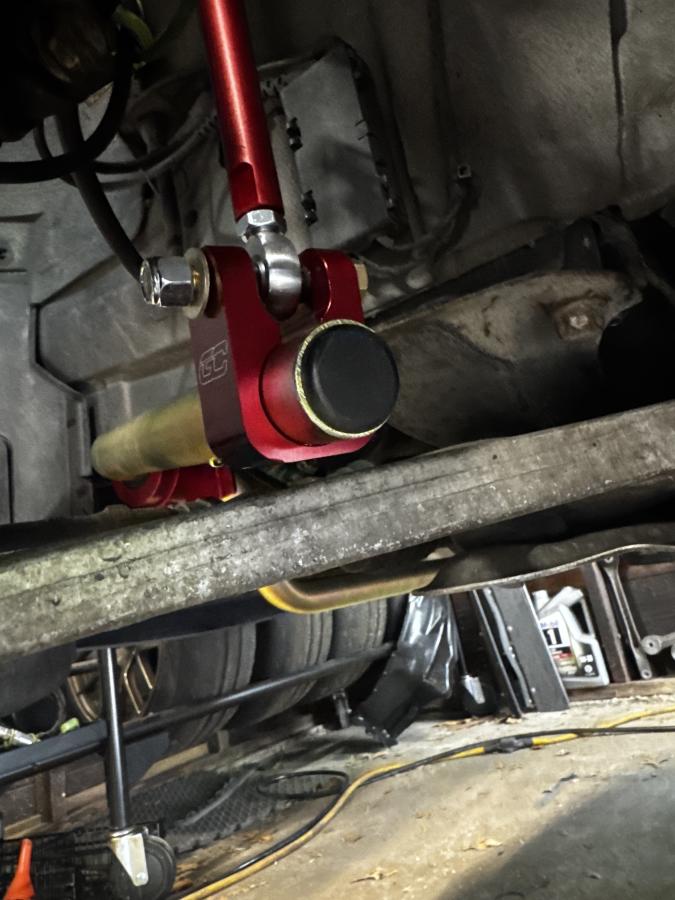

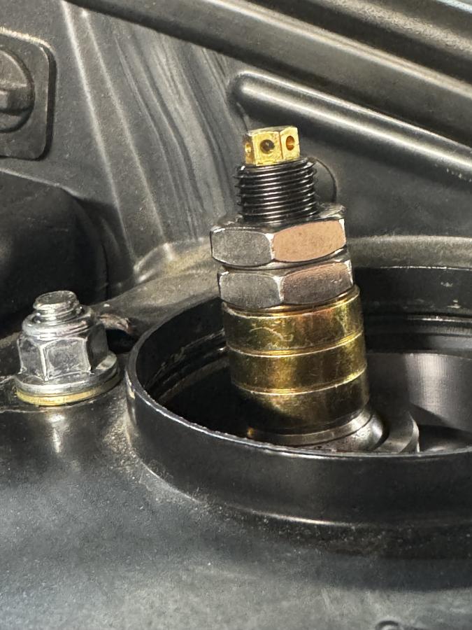

                  Installed MCS 1WNR + Ground Control front sway bar @ 119,500 mi
                  Some installation notes:
                  - Front strut assembly order: small collar, larger collar with spring perch, spring, helper spring perch, helper spring, stepped spacer, camber plate, stepped spacer, 3 supplied washers, two jam nuts
                  - GC sway bar collars will sit about 1/4in above control arm at full droop
                  - No dust boot for rear struts... wonder if intentional
                  - Counted about 19 threads (exposed threads under the height adj lock collar) to achieve 1 finger gap in front.​

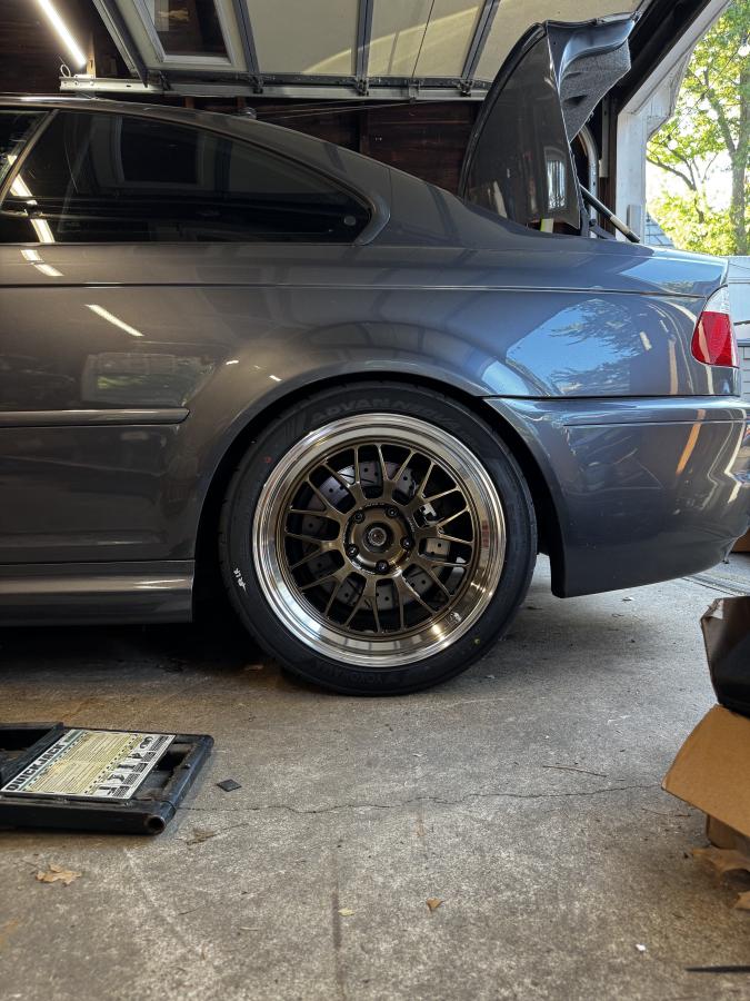

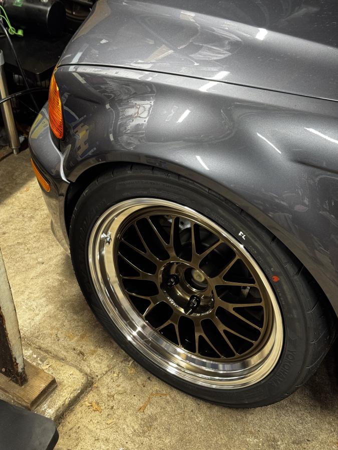

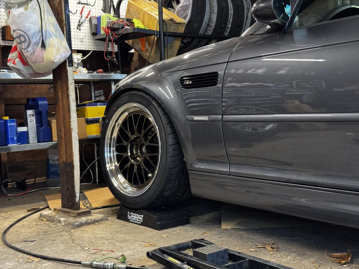

                    - Motorsport Hardware studs + tuner nuts
                    - Volk 21a - 18x9.5 ET22 - square setup
                    - Wrapped in Yokohama NEOVA AD09 265/35/18

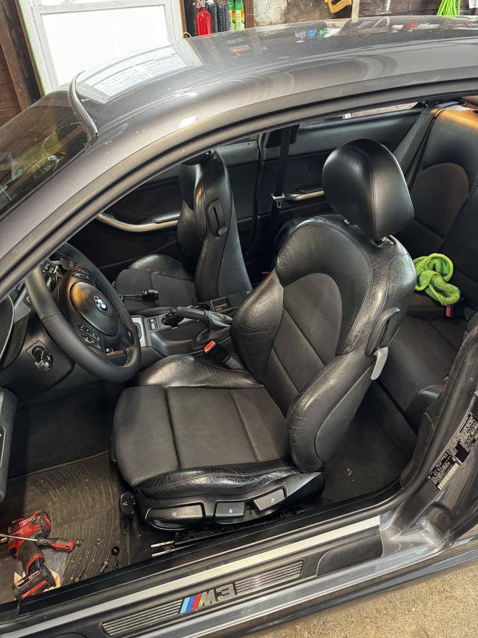

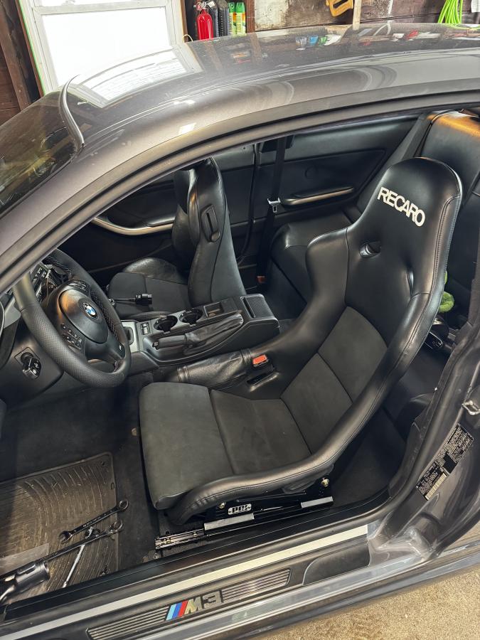

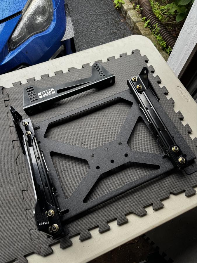

                        How could I forget ... Recaro ABE + PCI rails. Sits a bit offset to the left, but got used to it rather quickly. Car is starting to feel dialed in.

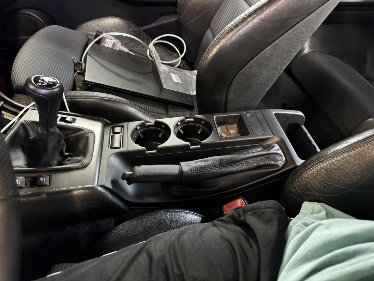

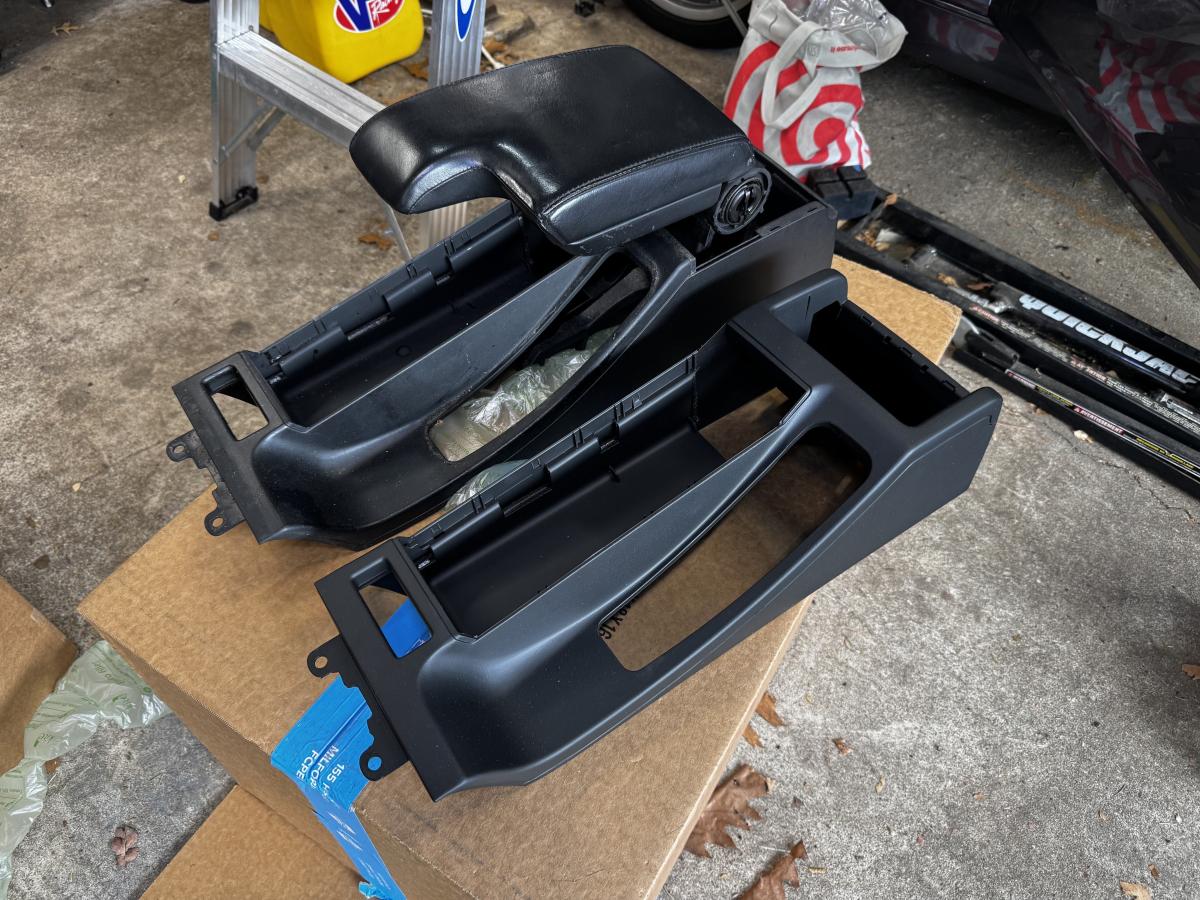

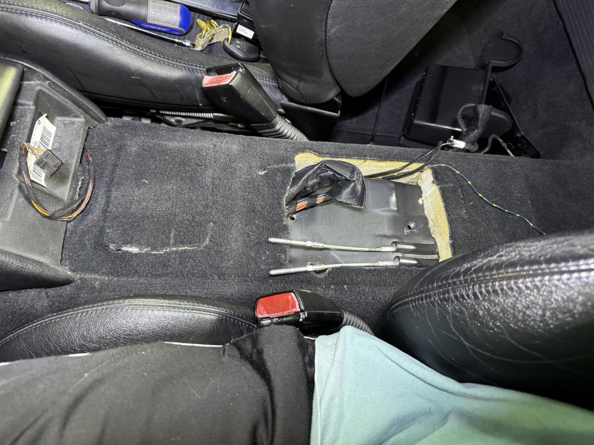

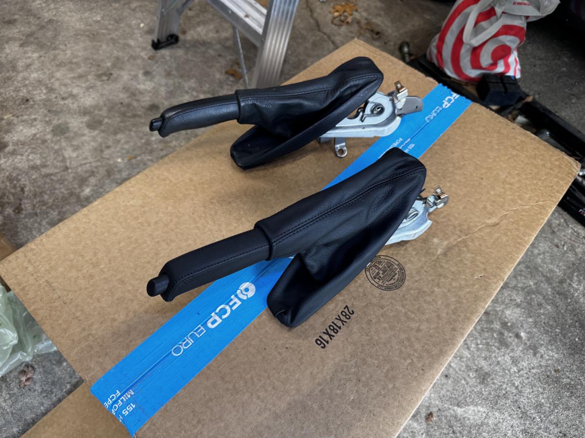

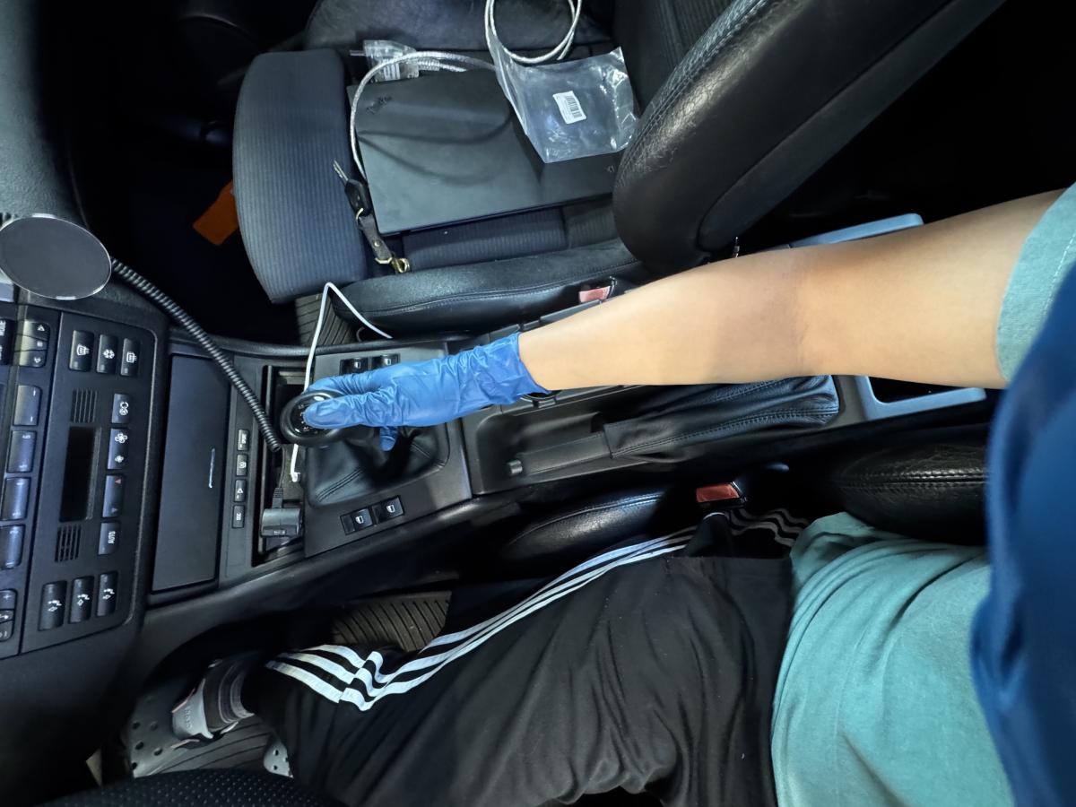

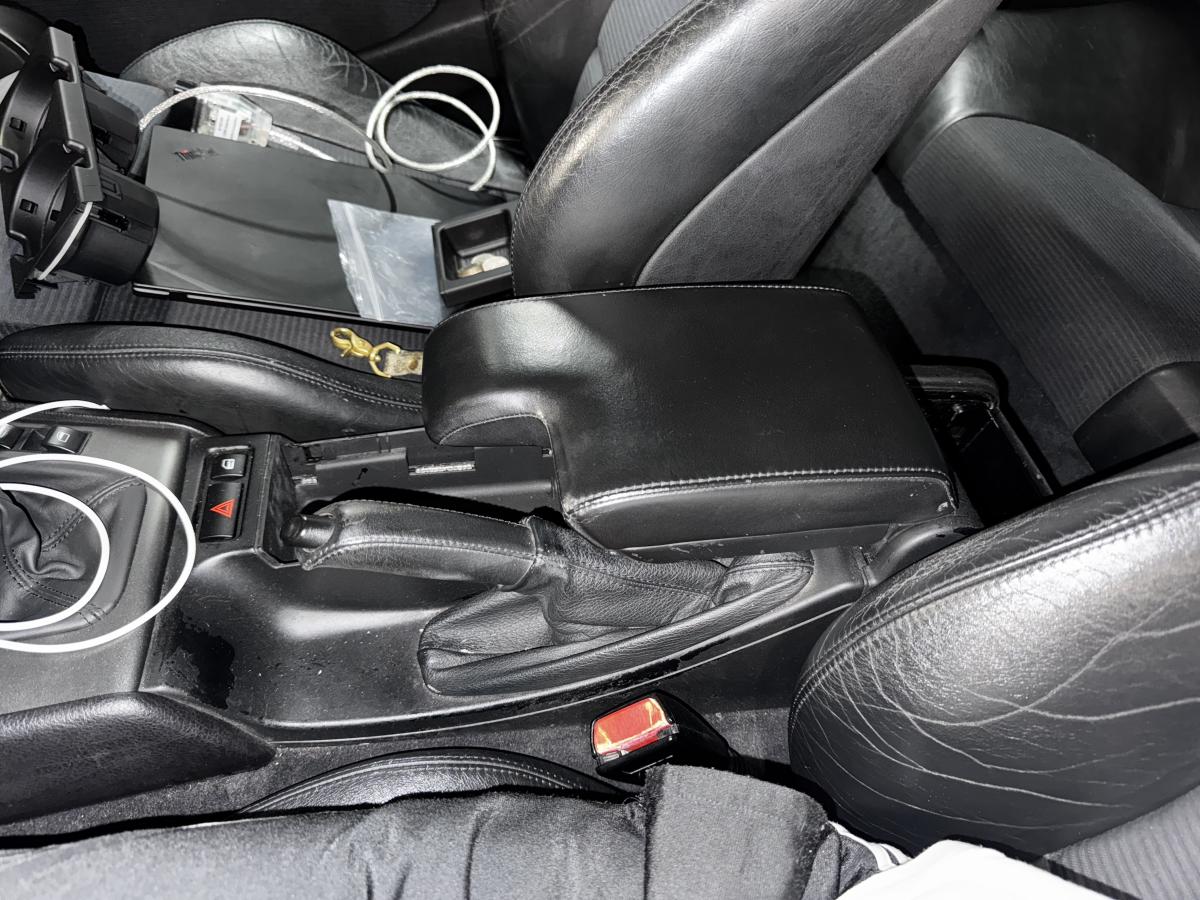

                            A little out of order... short console + new ebrake (courtesy of prev owner 🙏)
