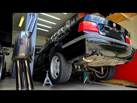

                      It sounds kinda ridiculous but I’ve been really looking at exhaust options too, I’m 17 what can you expect. The car used to be straight piped (Previous owner not me!) and I put an m3 muffler on it, how can I get a noticeable sporty tone out of it on the cheaper side?
                        It might be possible to debaffle part of the factory muffler similar to what people do to E46 M3 and E9X M3 mufflers.
                          I did think about that, a friend has an e46 328 with catless headers and a muffler he said is slightly louder than stock and I love the sound of that thing, would removing the cats on my car do the same thing? It had metallic burbles on decel and a nice tone in the mid to high rpm with no drone
                            Catless is never the answer. The car will smell of unburnt fuel like a boat all the time, not just on cold start.
                            Debaffling the muffler is best option for a cheap solution. That is unless you find a deal on a used Eisenmann or Supersprint muffler where it does not make sense to spend time modifying and welding the factory muffler.
                              Debaffling the muffler is best option for a cheap solution. That is unless you find a deal on a used Eisenmann or Supersprint muffler where is does not make sense to spend time modifying and welding the factory muffler.
                              Makes sense but how expensive is debaffling the muffler and wouldn’t it drone on the highway?
