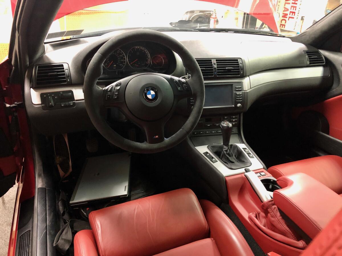

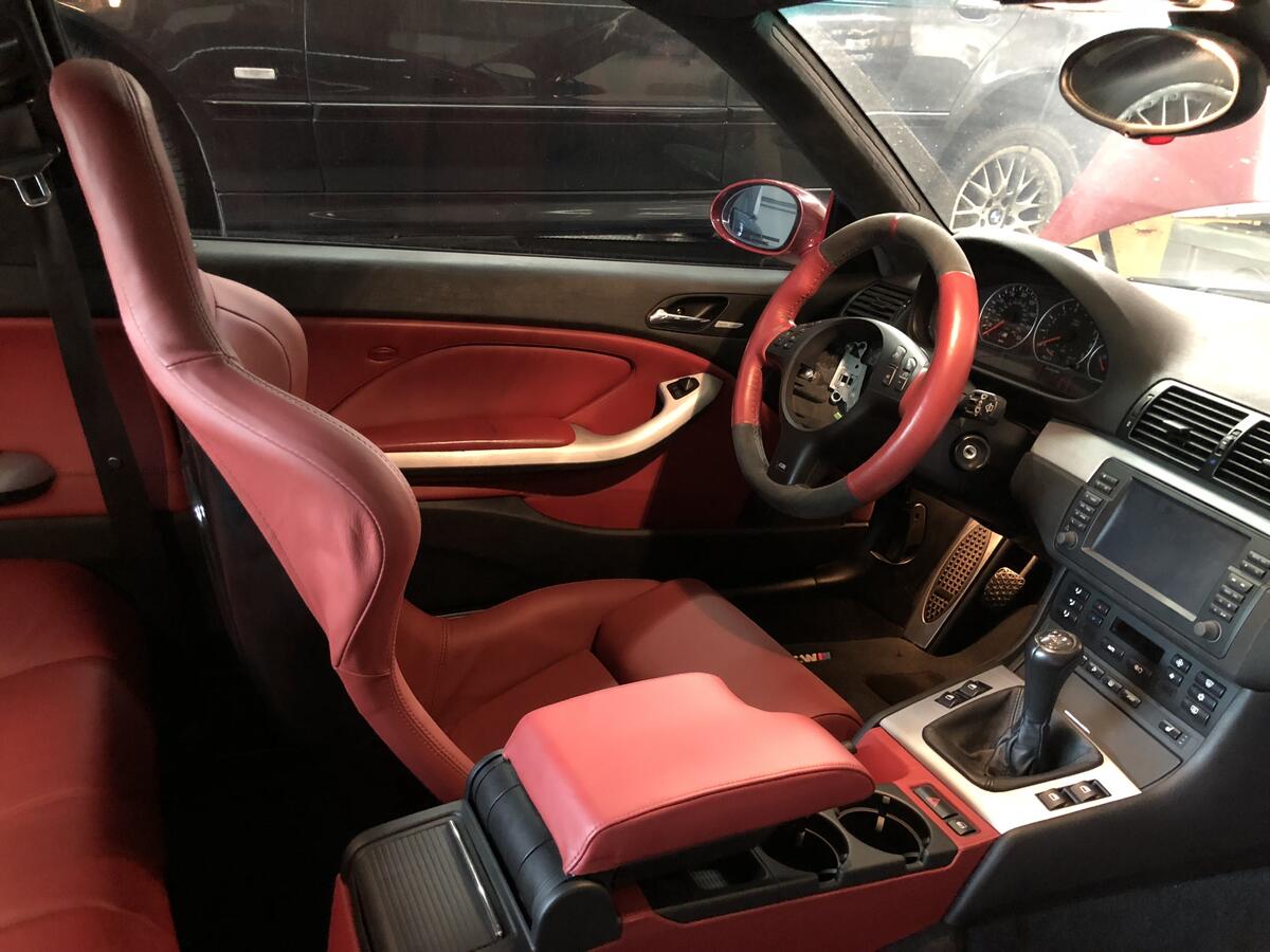

Interior:
Cobra Nogaros in Imola Red leather, with factory heating pads install and adjustable lumbar
Brey Krause Mounts on factory e46 manual sliders
Brey Krause Rear deck harness mounts
Alcantara wrapped header liner
Alcantara wrapped pillars
Alcantara wrapped rear deck
Alcantara wrapped steering wheel
imola leather wrapped center console
imola leather wrapped arm rest
imola leather wrapped ebrake book
Z8 ebrake handle
M3 oval interior mirror retrofit

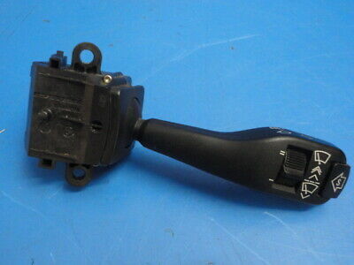

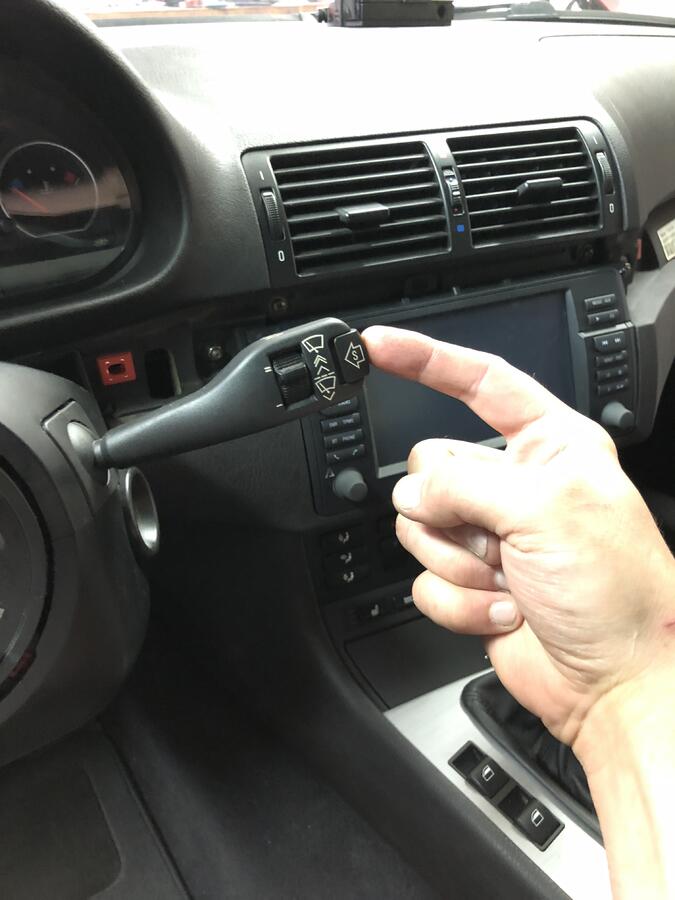

Washer tank swapped for e39 high intensity washer tank
e39 washer stalk for extra button to toggle M Track Mode while preserving on quick DSC off and steering wheel controls
