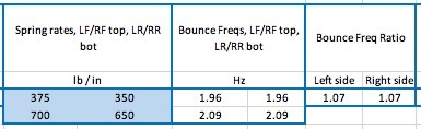

I’m interested to hear your review with that particular setup. When I ran 336/350 F and 675/700 R on FCM elite dampers, I was getting a bad oscillation front to rear over bumps. It was so bad that I had to lower the rear spring rates and ended up reverting back to 500# TCKs I had. I think I could go a bit higher in the rear but haven’t experimented any further.Originally posted by Obioban View Post
Springs are now...
375...350
700...650
FCM is doing the works on my dampers.

Do you end up changing you spring rates? What did you decide in with the new FCM dampers?Originally posted by Obioban View Post
Time for a large project.
Wavetrac diff (stock ratio, because I hate more aggressive diffs) and diff rebuild (seals and bearings)
CMP subframe bushings
Monoball adjustable rear lower control arms
vincebar
Slonik rear plate
... and sort of related, the FCM rear shocks and spring are part of this as well (front, too, obviously)
