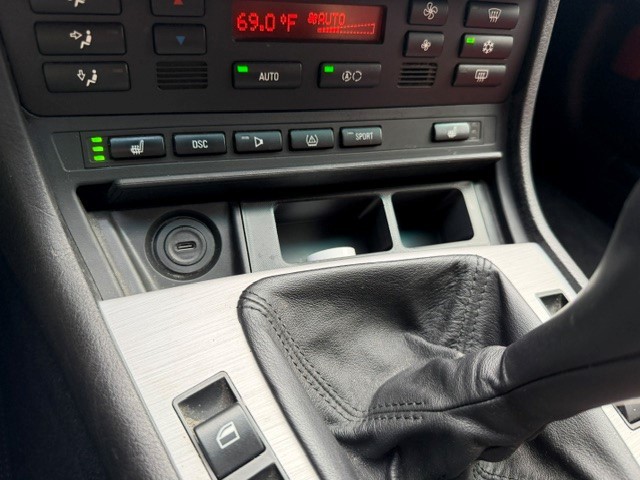

    Did some quality of life upgrades. I've had the Induktiv qi charger for a couple of years, and I like the concept but the actual charging execution sucks a bit. Decided to improve my general charging situation while I was at it.
    Generally, I'm tried chargers that are running near capacity overheating in use and stopping working for periods/forever. Sooo...
    Bought this 167W GaN charger and connected it behind the dash:
    Click image for larger version  Name:	charger.jpg Views:	0 Size:	75.2 KB ID:	360084
    Replaced the cigarette lighter tube with this, and ran it to the 100W port on the charger:
    Click image for larger version  Name:	cable.jpg Views:	0 Size:	57.2 KB ID:	360085

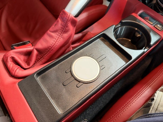

    cut out the qi (1) charger on my induktiv charger and replaced it with a 2nd gen MagSafe puck (and printed it a little trip piece to hide the cut):
    Click image for larger version  Name:	magsafe.jpg Views:	0 Size:	39.2 KB ID:	360086

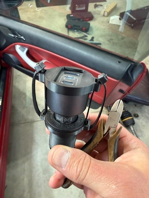

    And printed this ziptie technology to keep everything from vibrating apart:
    Result:
    Click image for larger version  Name:	m2.jpg Views:	18 Size:	78.9 KB ID:	352885
    Click image for larger version  Name:	m1.jpg Views:	16 Size:	93.9 KB ID:	352884
    I'm pretty pleased with the result. Everything is close at hand, but disappears when the armrest is down and ash tray is closed.

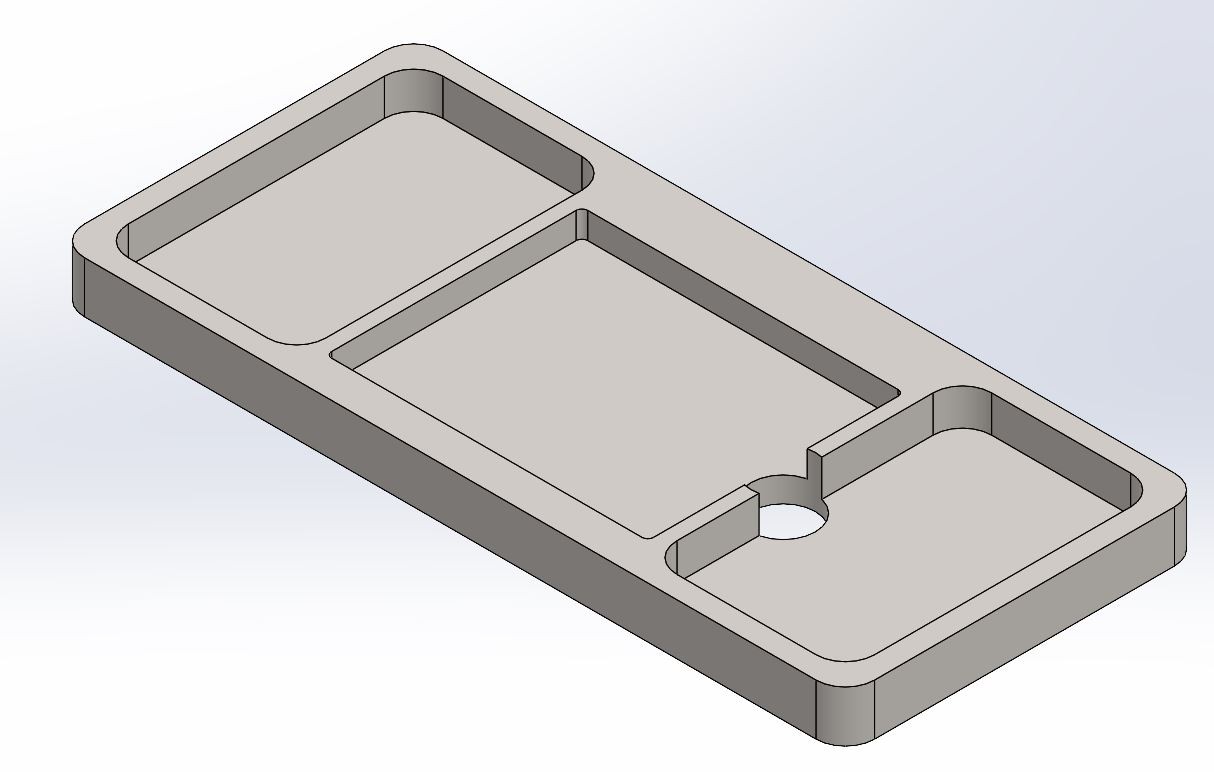

          Ashtray:
          I'm probably going to revise it to have a finger cutout to make removing the airpods easier.

          These use zip ties to make it so the plug can't vibrate apart behind the dash, without obstructing the charger's cooling
          Click image for larger version  Name:	sadf.jpg Views:	18 Size:	75.6 KB ID:	352894

            Ashtray:

            I just updated the ashtray with a bunch of improvements, so if anyone downloaded... download again.

              Update is really just a sport for a finger so they can be grabbed. They were tricky to get out before.
              Still should hold up to a full G force left turn, as the bottom of the case is still braced.

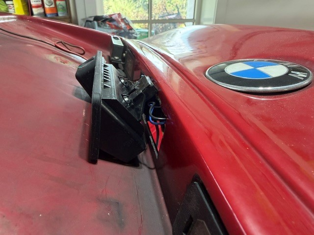

                              Well, did another boring project.... but also kind of a legit upgrade.
                              I did my CSL trunk 19 years ago (vorsteiner). Since then, I've had no trunk opening button on the lid.

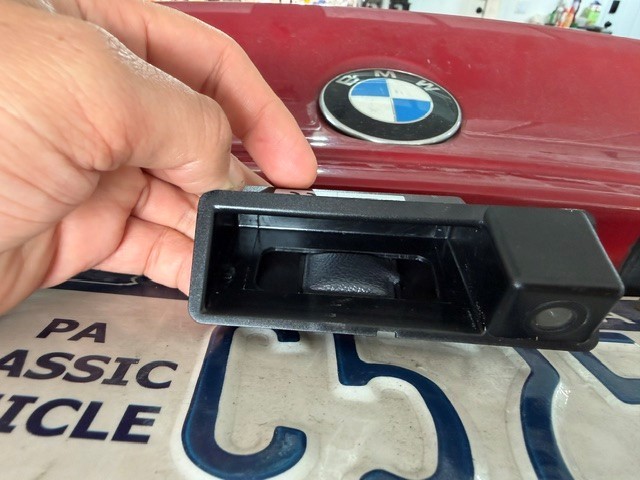

                              I noticed the other day that xtrons sells a trunk opening button/camera unit. When I made the wiring harness for my car, I had already run an RCA cable to the trunk, in case I needed it in the future.

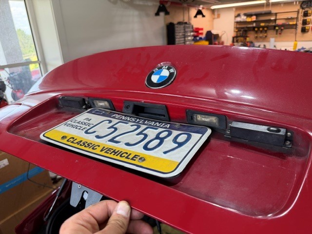

                              So, I 3D printed a cutting template, sacked up, and cut a rectangle in my trunk for the button...
                              ... only to immediately realize that it actually wasn't going to fit. The button spring mechanism wanted to go up into a space that doesn't exist.
                              Click image for larger version  Name:	1.jpg Views:	0 Size:	69.5 KB ID:	362845
                              Said a bunch of bad words, then cut off the button mechanism so I could install it and have a camera, and not have a hole in my trunk.

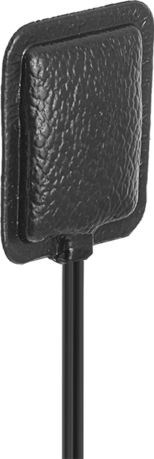

                              But, then I thought about it some more, and decided I could probably fit a touch pad switch in there. So, ordered this:
                              McMaster-Carr is the complete source for your plant with over 595,000 products. 98% of products ordered ship from stock and deliver same or next day.
                              Click image for larger version  Name:	7692k4-@3x_637194521120730249.png Views:	0 Size:	65.9 KB ID:	362847
                              And printed a little bracket in ASA to locate it and indent the rest, so I can easy feel it through the rubber cover

                              Feels wild to be able to open the trunk by button again, after 19 years of CSL trunk.
                                Hey nice work! Glad the hole wasn’t cut for nothing!
