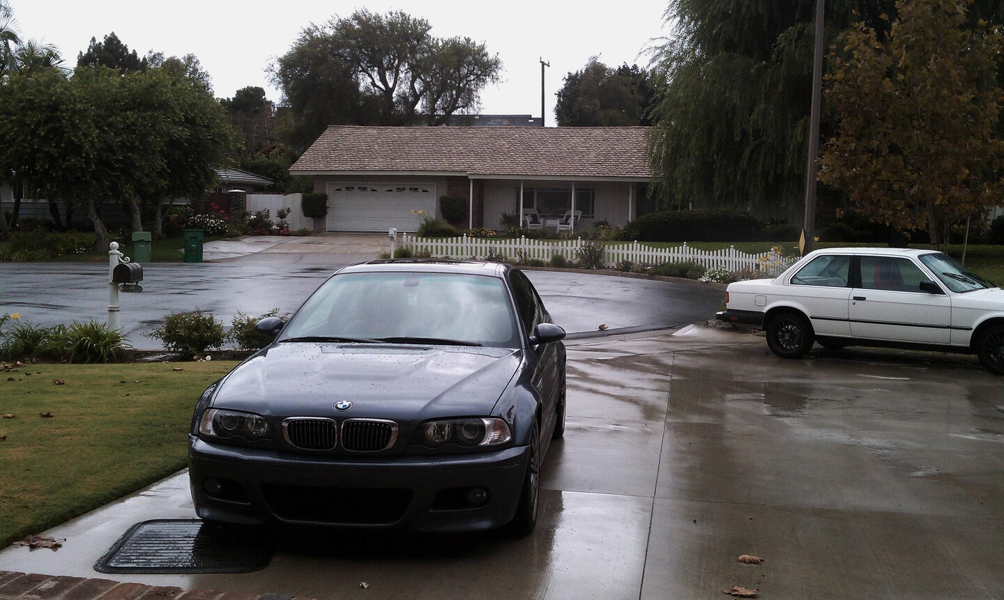

    Here's one of the first pics I took of the car, with my old e30 in the background.

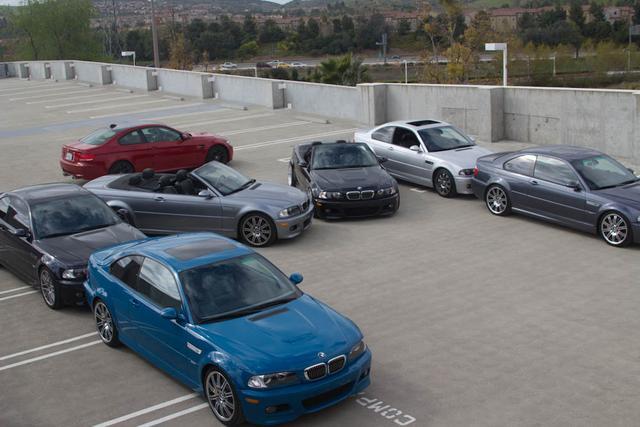

      Here's a shot from an m3f meetup waaaayyy back in the day.

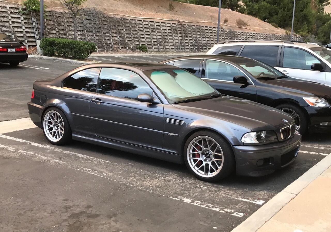

          Next big mod was a set of Apex Arc-8’s that I had always wanted. I got the 18x9.5 et22 as a square set. Knowing this would require significant camber, I went ahead and sprung for the ground control camber plates. I run these with a 20mm spacer in the rear. This also required me to change my strut bar, so I went with the RE bar.
          The wheels were wrapped with the Firestone indy 500s in 255/35R18 all around.

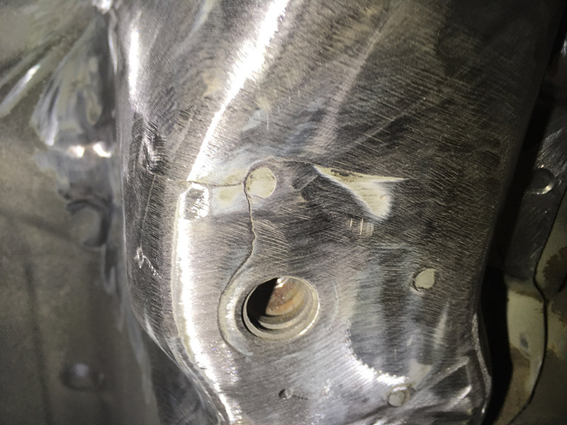

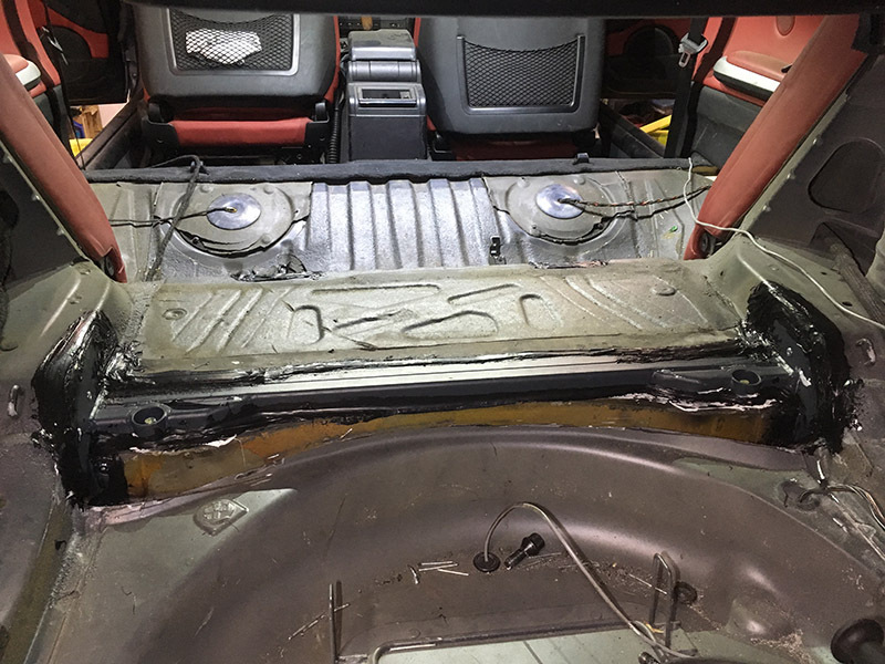

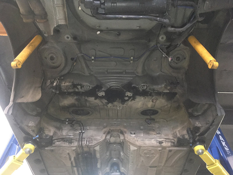

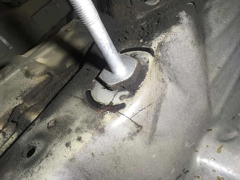

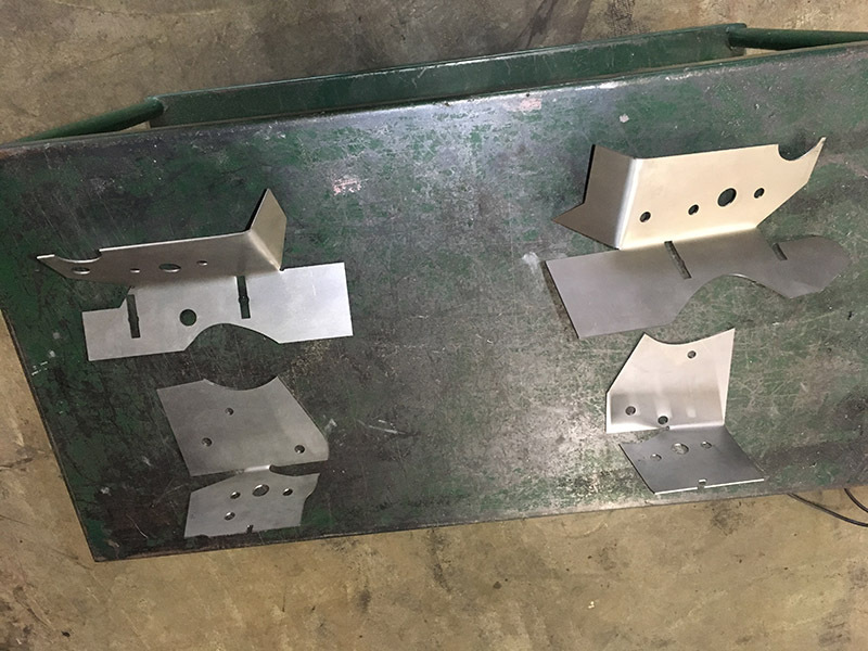

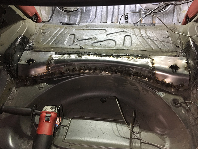

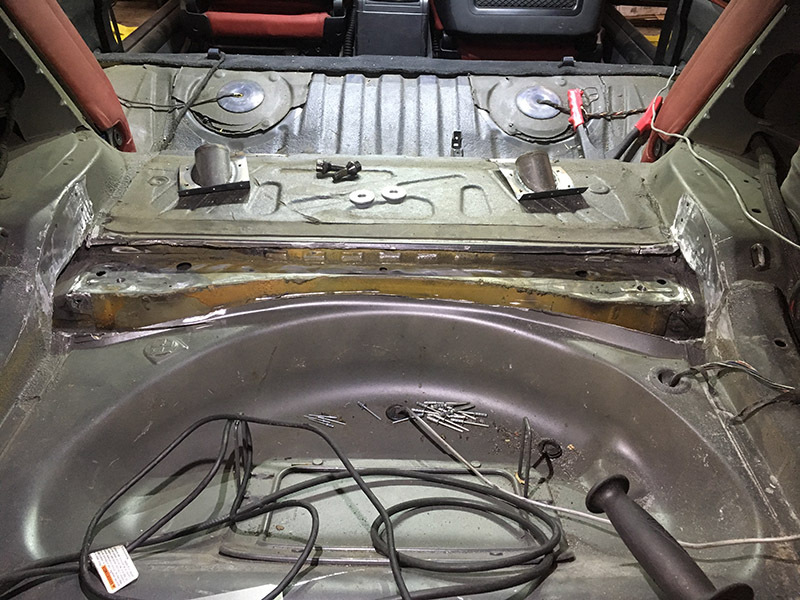

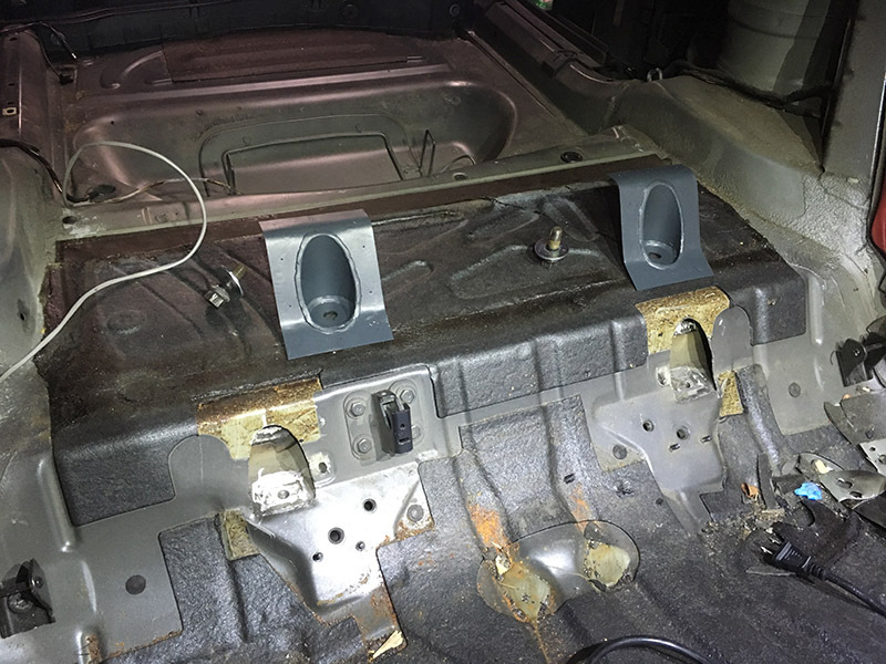

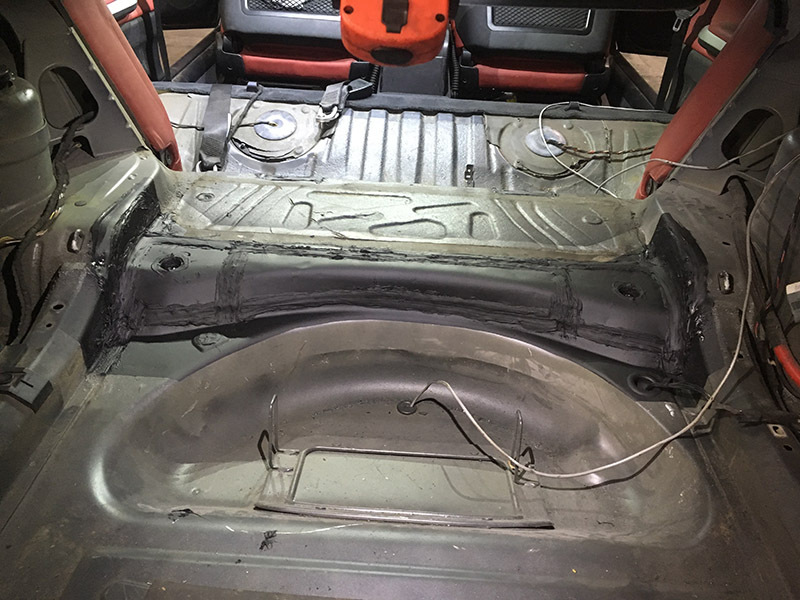

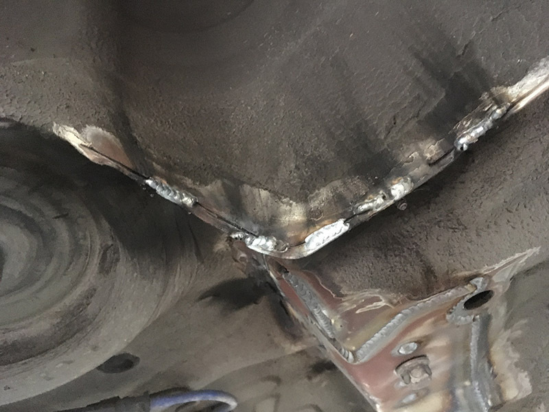

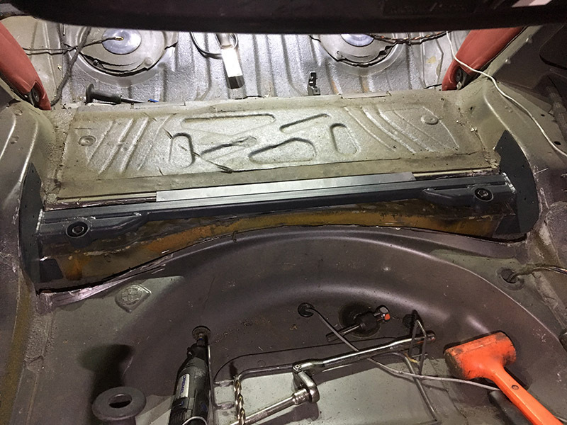

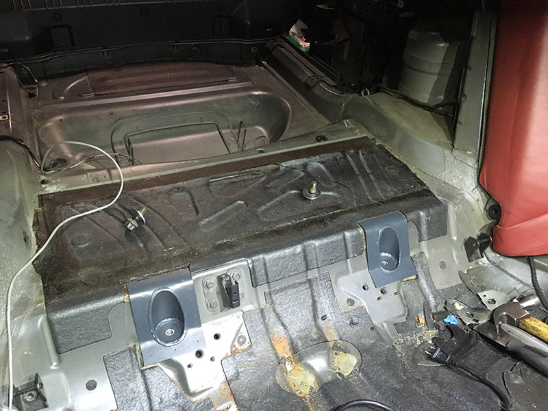

            Around this time, the car had around 100k miles and the shocks were pretty done so I went with the koni yellows and eibach pro kit springs. During the install, my mechanic noticed some cracks in the RACP, so I bought the redish reinforcement plates and the vincebar epoxy kit. I had kaiv perform the reinforcement.

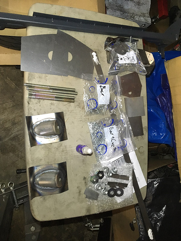

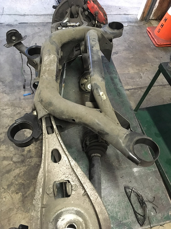

            He did a great job as always and I can sleep easy now knowing my RACP is 100% safe. A funny story about this though- on the way home from the reinforcement, I started hearing horrific metal scraping coming from the rear end when I would accelerate and decelerate. My heart sank as I fear that somehow the reinforcement had failed and my RACP was tearing itself to pieces right before me. I pulled over and inspected and it seemed fine, so I texted Kevin asking him if there was anyway it could be failing. He replied in shock, and stated that he thought it should be ok. I kept driving and the sound only got worse, but I was about 2 minutes from home so I decided to just get home. Once I got home, I opened the trunk and looked in the spare wheel well. I had a spare water bottle and my front license plate that Kevin had moved to this area and the water bottle was rolling around and pressing the license plate against the well as I was driving, thus creating the sound of metal scraping! My heart came back into my chest and I let Kevin know all was good. Sorry for the scare, Kevin!

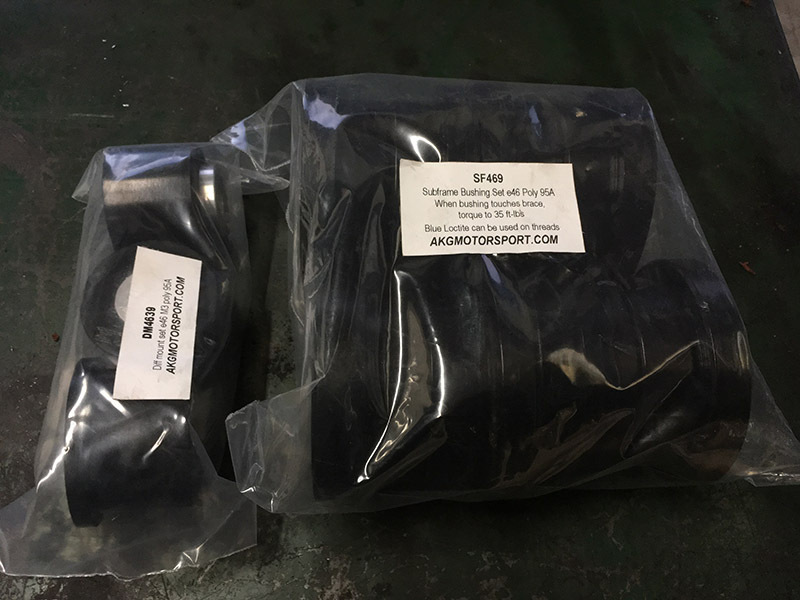

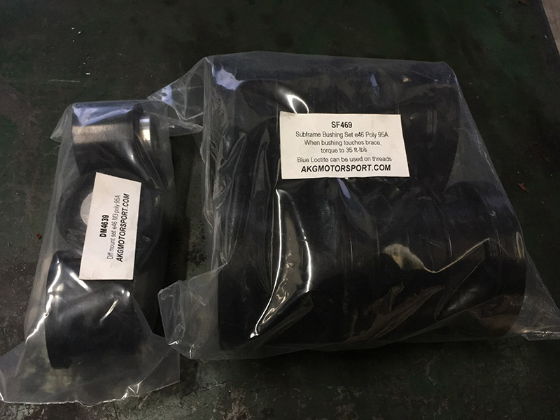

            Bushings:
            Click image for larger version  Name:	19.JPG Views:	0 Size:	110.3 KB ID:	44169

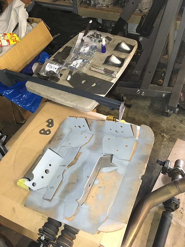

            Vincebar and plates primed:
            Click image for larger version  Name:	15.JPG Views:	0 Size:	165.3 KB ID:	44167

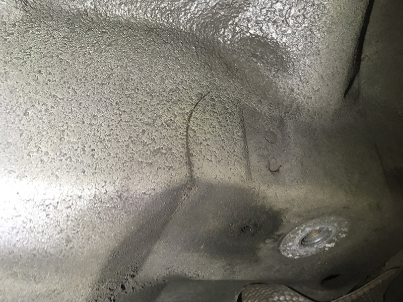

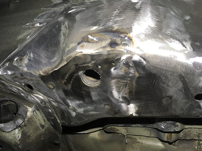

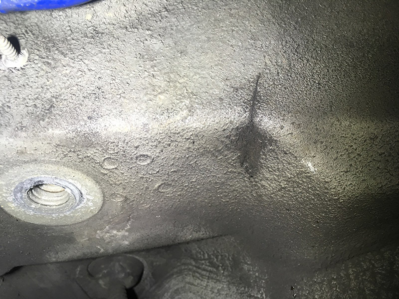

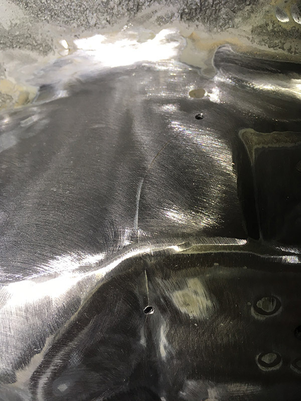

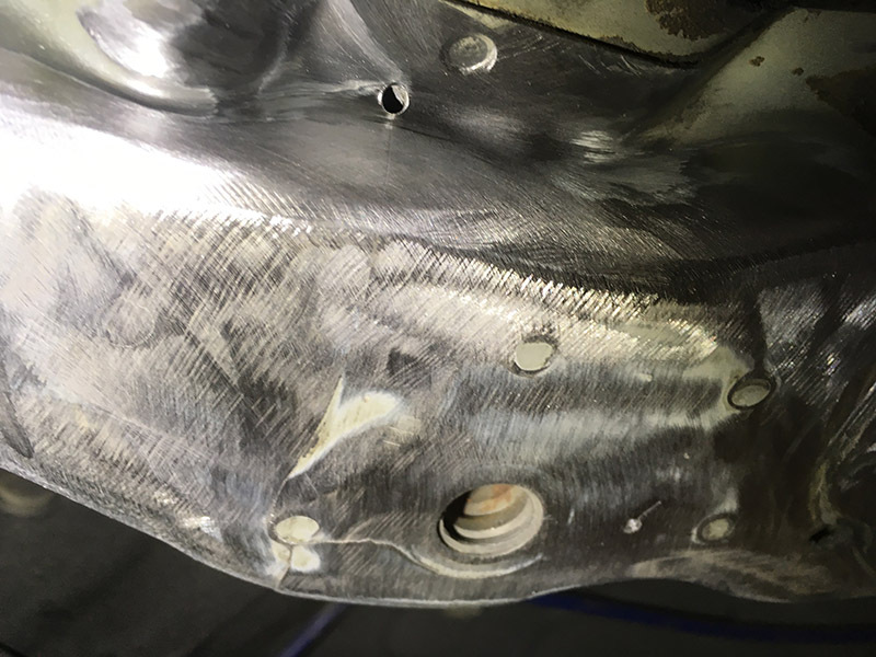

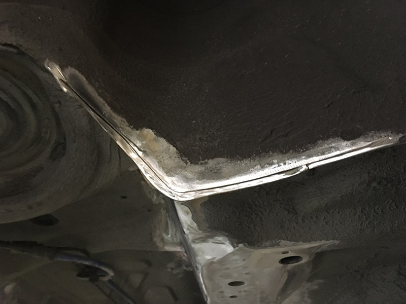

            Cracks forming:
            Click image for larger version  Name:	4.JPG Views:	0 Size:	180.4 KB ID:	44146 Click image for larger version  Name:	3.JPG Views:	0 Size:	167.4 KB ID:	44164
            Click image for larger version  Name:	5.JPG Views:	0 Size:	209.7 KB ID:	44168

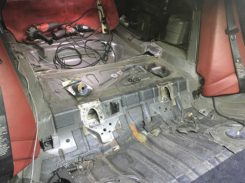

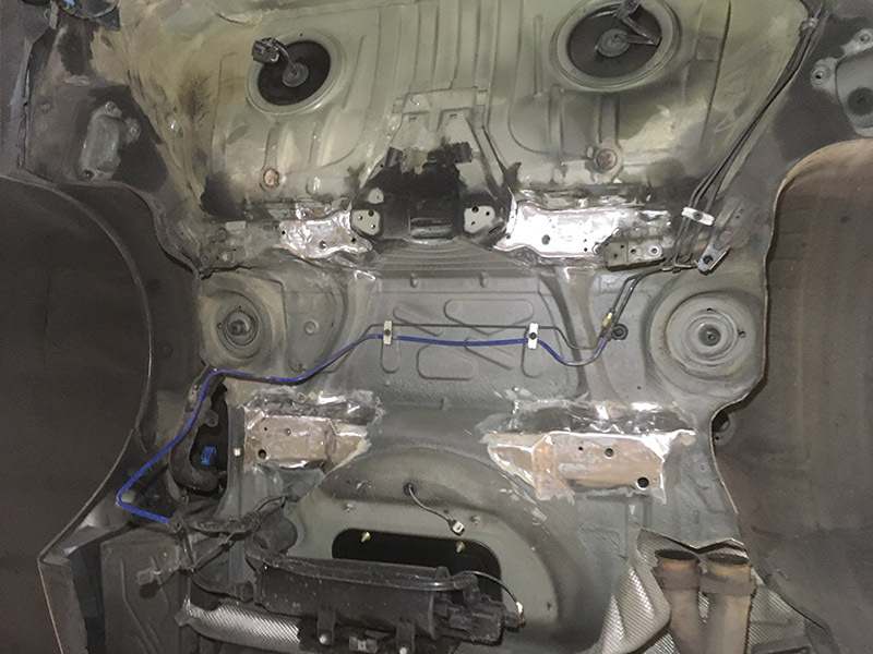

            Prep work:
            Click image for larger version  Name:	12.JPG Views:	0 Size:	147.3 KB ID:	44135 Click image for larger version  Name:	13.JPG Views:	0 Size:	149.7 KB ID:	44143
            Click image for larger version  Name:	14.JPG Views:	0 Size:	98.4 KB ID:	44145 Click image for larger version  Name:	20.JPG Views:	0 Size:	175.6 KB ID:	44155
            Click image for larger version  Name:	11.JPG Views:	0 Size:	162.8 KB ID:	44165

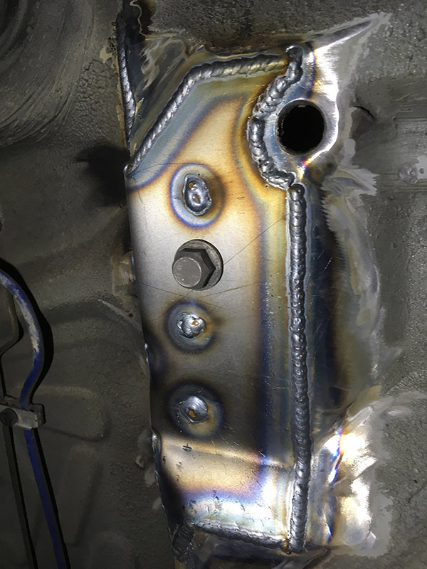

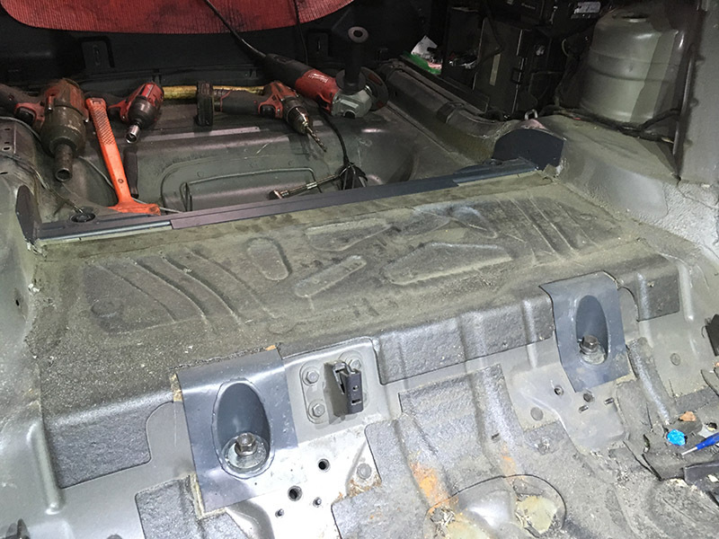

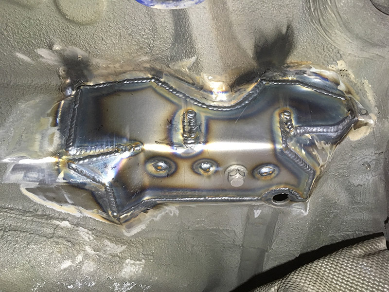

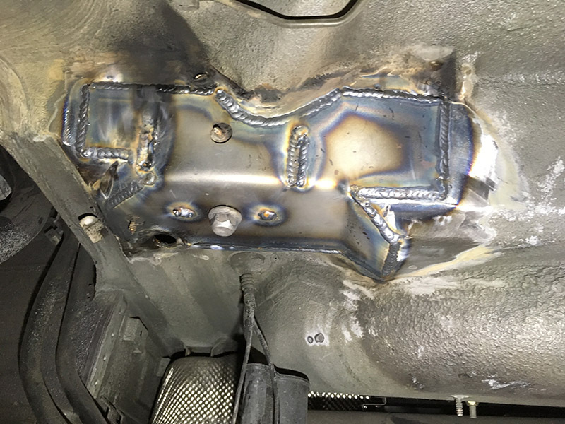

            Reinforcement plates welded on:
            Click image for larger version  Name:	21.JPG Views:	0 Size:	194.0 KB ID:	44137 Click image for larger version  Name:	23.JPG Views:	0 Size:	157.9 KB ID:	44161

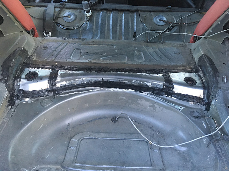

            Vincebar install:
            Click image for larger version  Name:	31.JPG Views:	0 Size:	174.4 KB ID:	44136 Click image for larger version  Name:	39.JPG Views:	0 Size:	172.8 KB ID:	44138 Click image for larger version  Name:	10.JPG Views:	0 Size:	137.1 KB ID:	44139 Click image for larger version  Name:	6.JPG Views:	0 Size:	129.4 KB ID:	44147 Click image for larger version  Name:	28.JPG Views:	0 Size:	181.7 KB ID:	44151 Click image for larger version  Name:	36.JPG Views:	0 Size:	170.3 KB ID:	44144 Click image for larger version  Name:	27.JPG Views:	0 Size:	140.4 KB ID:	44148 Click image for larger version  Name:	32.JPG Views:	0 Size:	190.1 KB ID:	44152 Click image for larger version  Name:	40.JPG Views:	0 Size:	170.9 KB ID:	44160 Click image for larger version  Name:	42.JPG Views:	0 Size:	173.0 KB ID:	44157 Click image for larger version  Name:	37.JPG Views:	0 Size:	179.9 KB ID:	44156 Click image for larger version  Name:	43.JPG Views:	0 Size:	156.7 KB ID:	44149 Click image for larger version  Name:	44.JPG Views:	0 Size:	153.6 KB ID:	44150 Click image for larger version  Name:	38.JPG Views:	0 Size:	191.7 KB ID:	44162

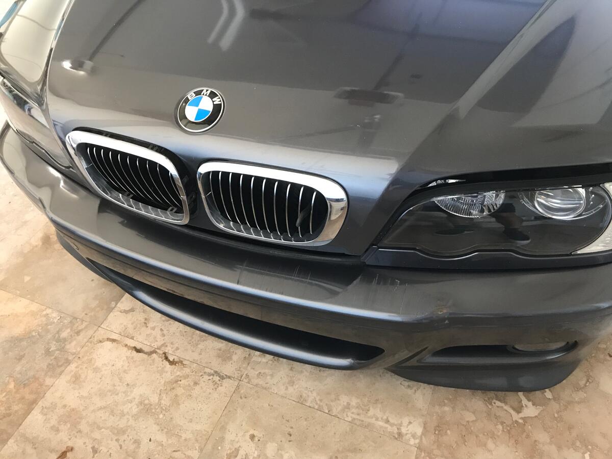

              My front end suffered a minor incident when a truck backed into me on a one way street (guess he didn’t hear me honk), so my insurance let me install a new OEM euro bumper. I love the way this bumper looks without the reflectors, very clean look. Insurance also replaced the hood with OE.
              Click image for larger version  Name:	File_000.jpeg Views:	0 Size:	114.2 KB ID:	44173
              Click image for larger version  Name:	IMG_6257.jpg Views:	0 Size:	156.5 KB ID:	44174

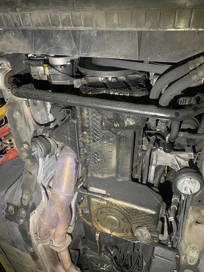

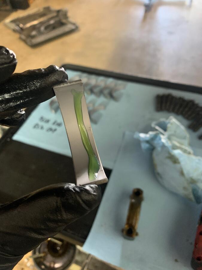

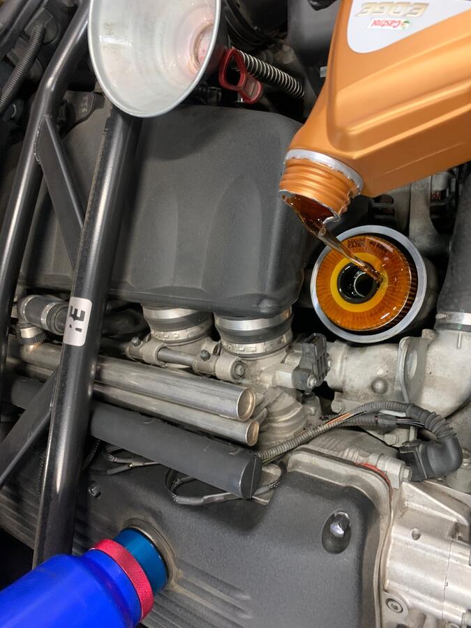

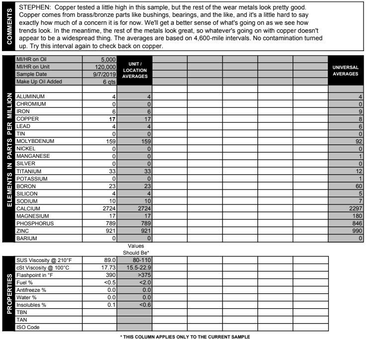

                During my last oil change @120k, I collected some oil to send to blackstone. Here’s the report:
                Click image for larger version  Name:	oil.JPG Views:	0 Size:	107.7 KB ID:	44176

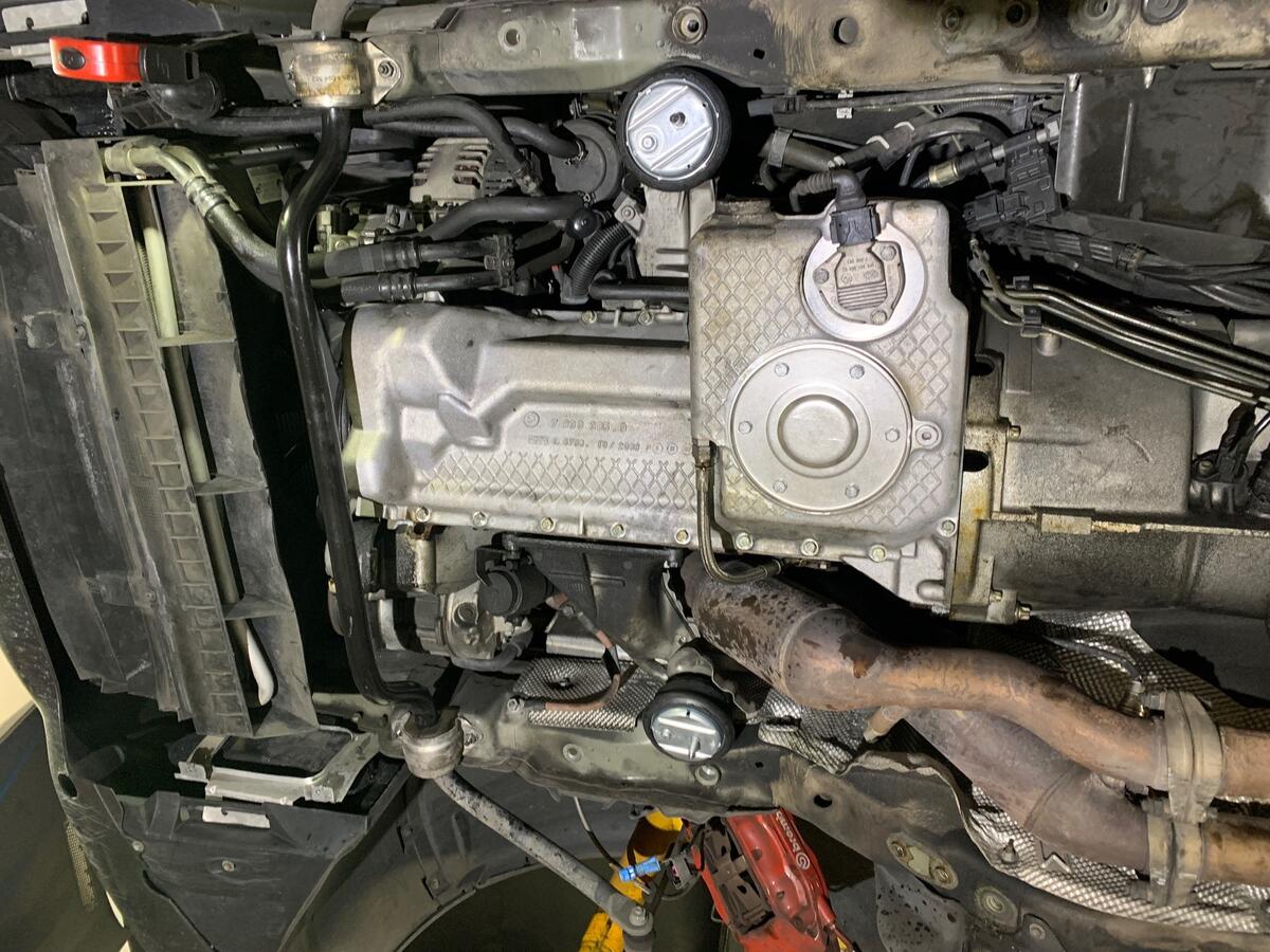

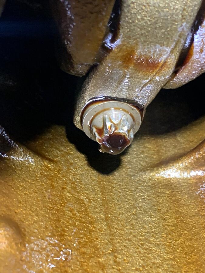

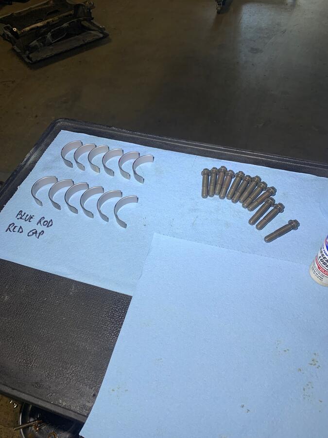

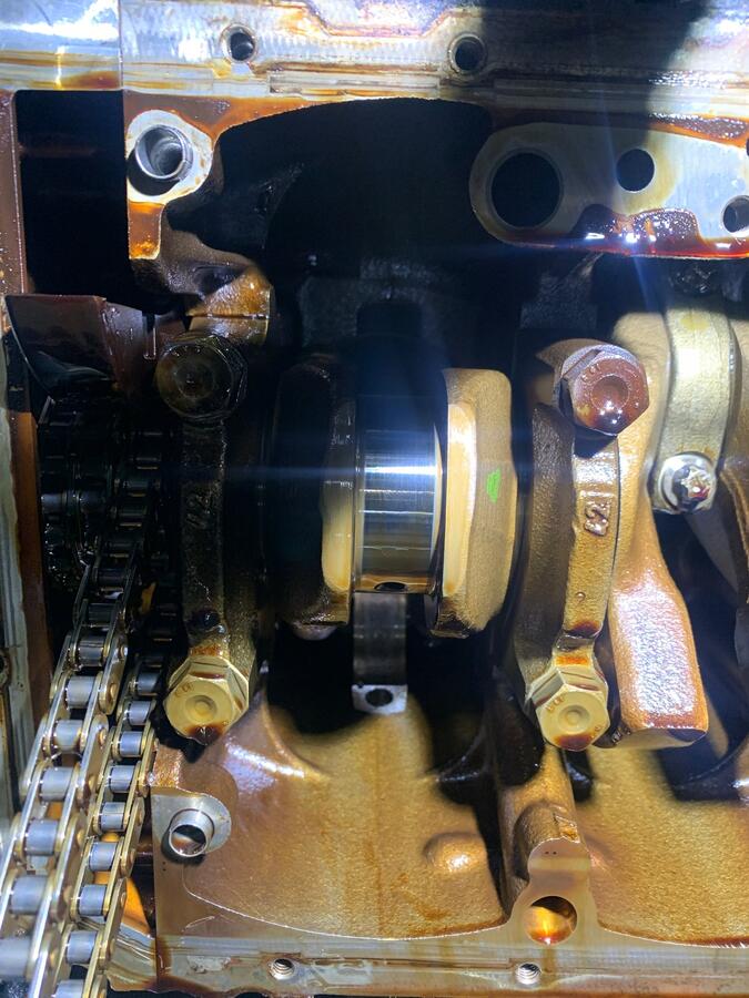

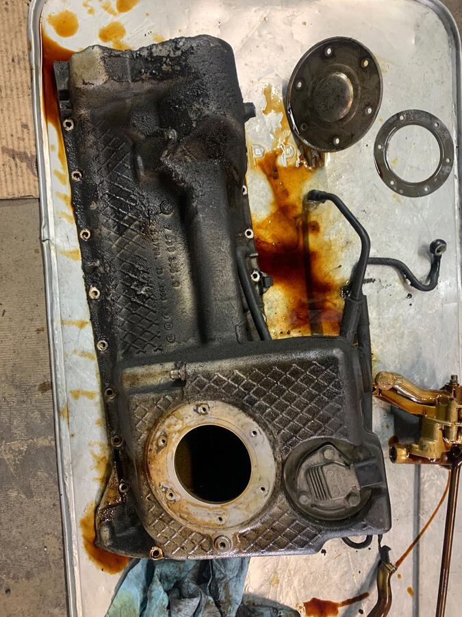

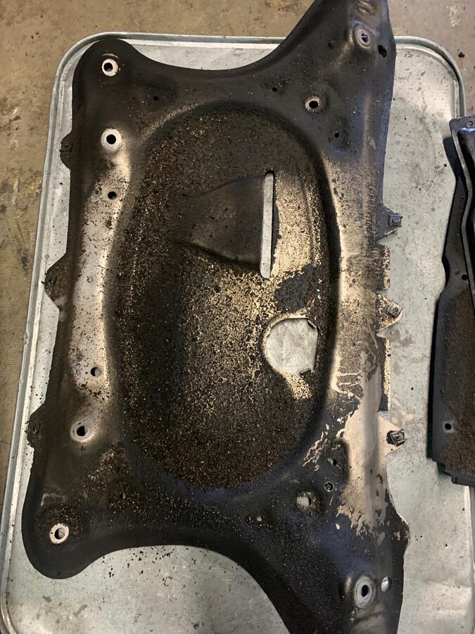

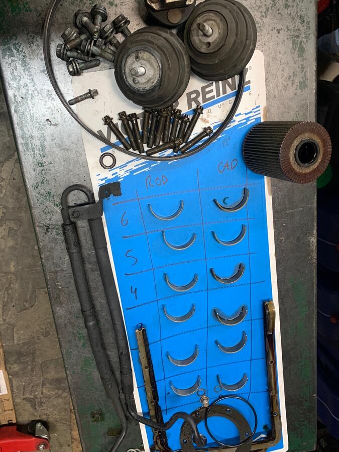

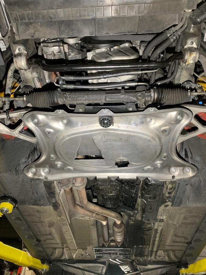

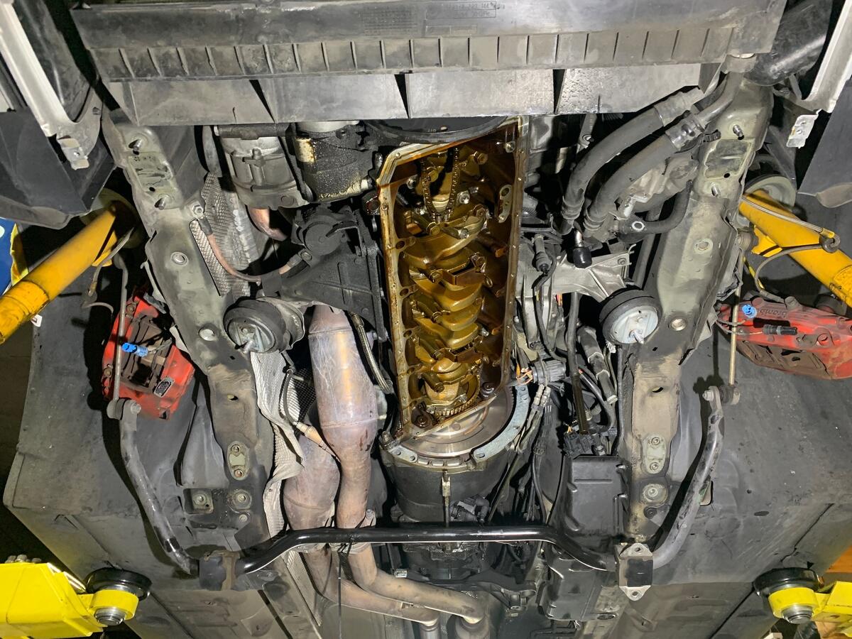

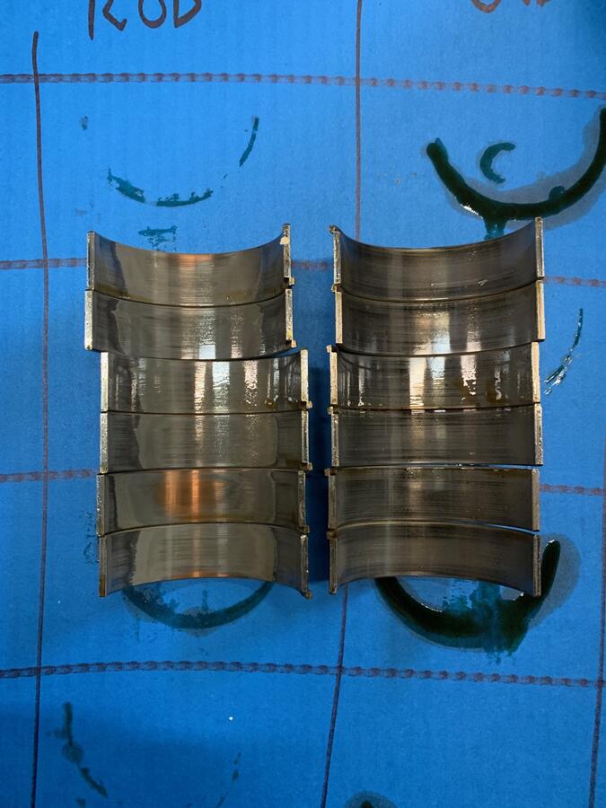

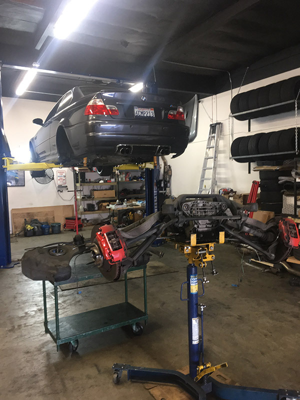

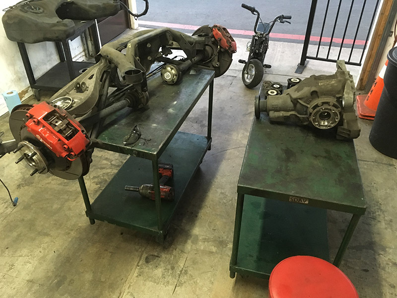

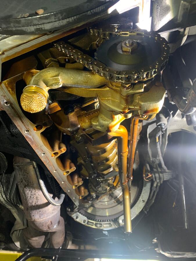

                I was overdue for a bearing job and the report seemed to indicate that there was some copper starting to show, so I had kaiv do my rod bearings just this past weekend. I went with OE bearings without a coating. He also fixed a bunch of other stuff while he was in there. Apparently I had the “leakiest, dirtiest oil pan” kaiv had ever seen. Whoops.
                See below for the old bearings, and it looks like I was not a minute late.
                The crank looked good though so the new bearings went in and off I went.

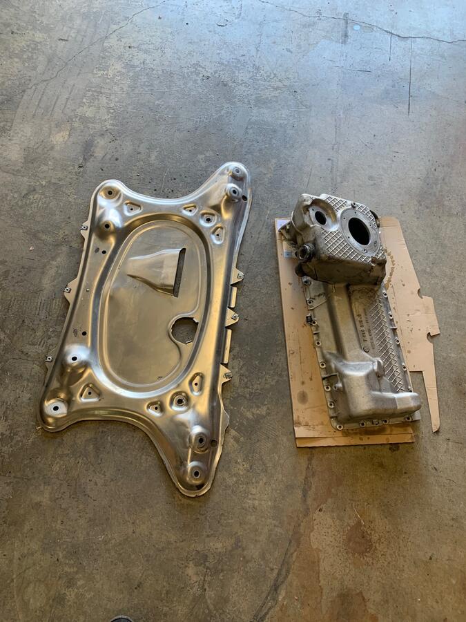

                At the shop:
                Click image for larger version  Name:	IMG_8708.jpg Views:	0 Size:	89.0 KB ID:	44199
                Click image for larger version  Name:	IMG_0317.jpg Views:	0 Size:	75.7 KB ID:	44196 Click image for larger version  Name:	IMG_0295.JPG Views:	0 Size:	99.8 KB ID:	44182 Click image for larger version  Name:	IMG_0282.JPG Views:	0 Size:	118.8 KB ID:	44185 Click image for larger version  Name:	IMG_0301.JPG Views:	0 Size:	148.4 KB ID:	44188 Click image for larger version  Name:	IMG_0294.JPG Views:	0 Size:	101.9 KB ID:	44189 Click image for larger version  Name:	IMG_0292.JPG Views:	0 Size:	65.8 KB ID:	44190 Click image for larger version  Name:	IMG_0299.JPG Views:	0 Size:	200.6 KB ID:	44191 Click image for larger version  Name:	IMG_0300.JPG Views:	0 Size:	94.7 KB ID:	44192 Click image for larger version  Name:	IMG_0289.JPG Views:	0 Size:	127.8 KB ID:	44193 Click image for larger version  Name:	IMG_0287.JPG Views:	0 Size:	127.2 KB ID:	44195 Click image for larger version  Name:	IMG_0302.JPG Views:	0 Size:	103.1 KB ID:	44186 Click image for larger version  Name:	IMG_0304.JPG Views:	0 Size:	189.9 KB ID:	44181 Click image for larger version  Name:	IMG_0307.JPG Views:	0 Size:	108.7 KB ID:	44177 Click image for larger version  Name:	IMG_0303.JPG Views:	0 Size:	85.8 KB ID:	44180 Click image for larger version  Name:	IMG_0316.jpg Views:	0 Size:	109.8 KB ID:	44179 Click image for larger version  Name:	IMG_0311.JPG Views:	0 Size:	86.5 KB ID:	44178

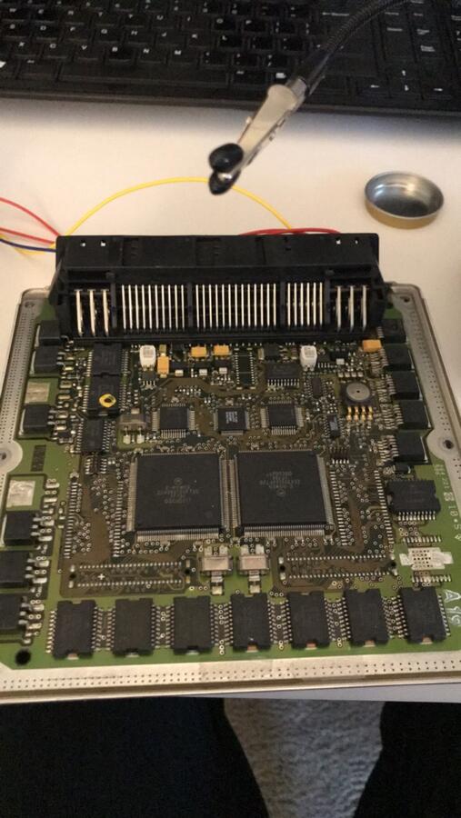

                            I've been getting started on modifying an MSS54 to a full CSL MSS54HP (with H-Bridge and new pressure sensor) for use in my car to run a Karbonius airbox. I ordered a whole bunch of electrical components this week and started prepping my DME. I practiced by removing the EEPROMs from this MSS54 which was bricked and sent to me as a freebie by mleveroni. I used Chipquik to remove them and it was super easy.
                            Click image for larger version  Name:	IMG_8720.JPG Views:	0 Size:	71.7 KB ID:	45363
