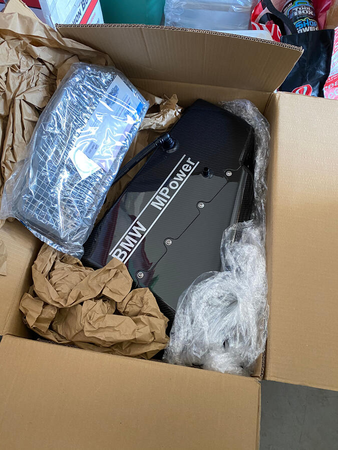

          Ok! Airbox time! Got my map sensor kit from COVID-19 and used an e36 IAT (uses the same CSL scaling, pn 13621739510). The tune is an HTE csl-based tune and I'm running it on my MSS54-hp conversion.
          Unwrapping and sticker applying:

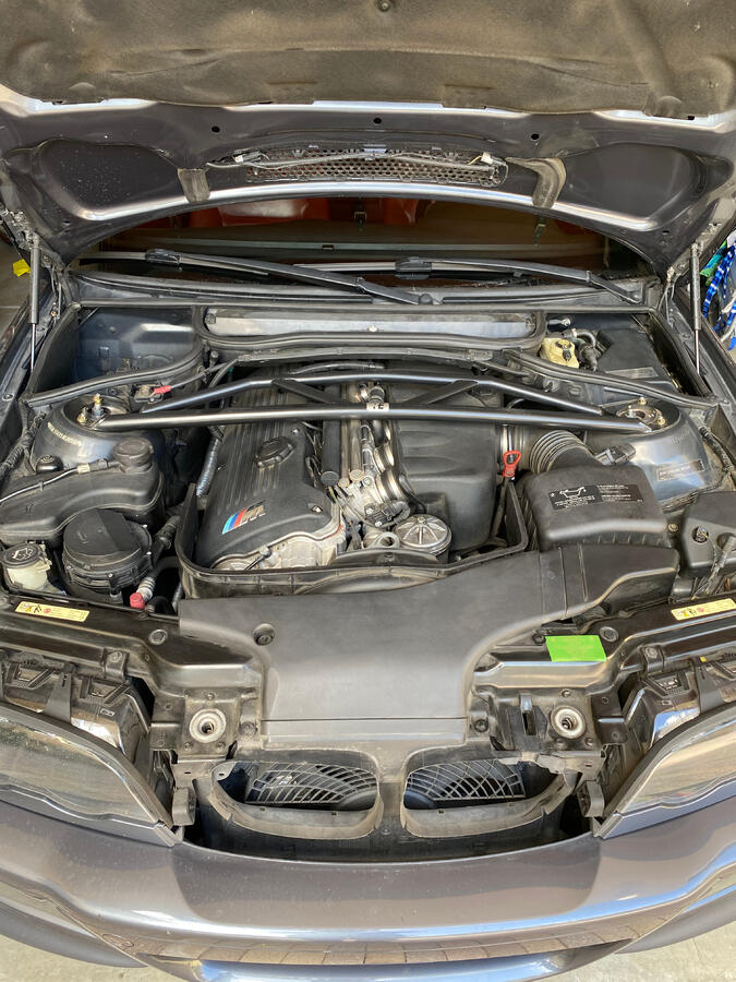

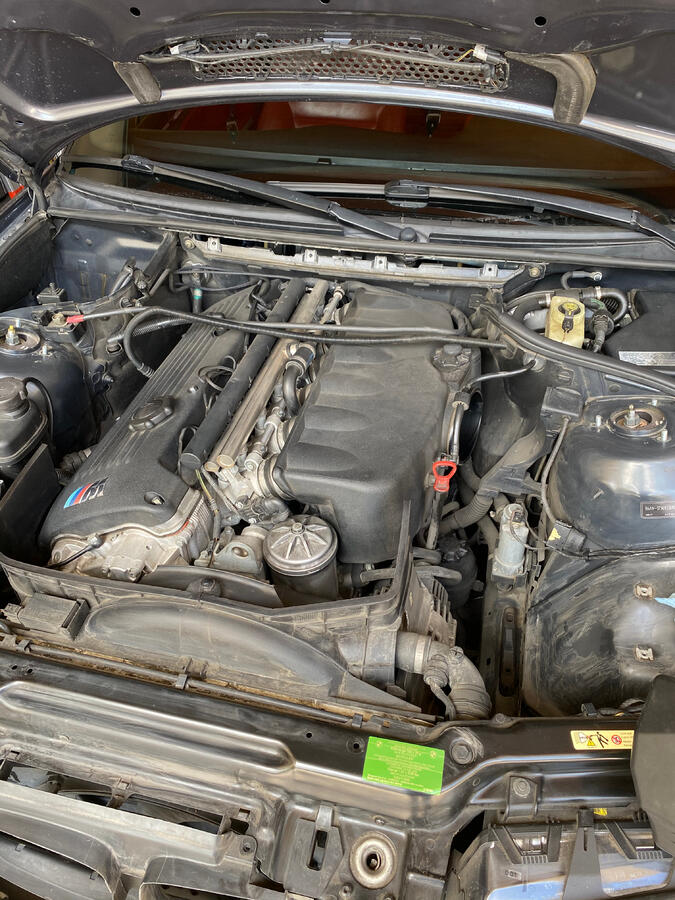

          Engine bay before installation, tried to clean it up somewhat.
          Click image for larger version  Name:	IMG_0213.jpg Views:	0 Size:	131.4 KB ID:	106855
          Click image for larger version  Name:	IMG_0214.jpg Views:	0 Size:	139.8 KB ID:	106848

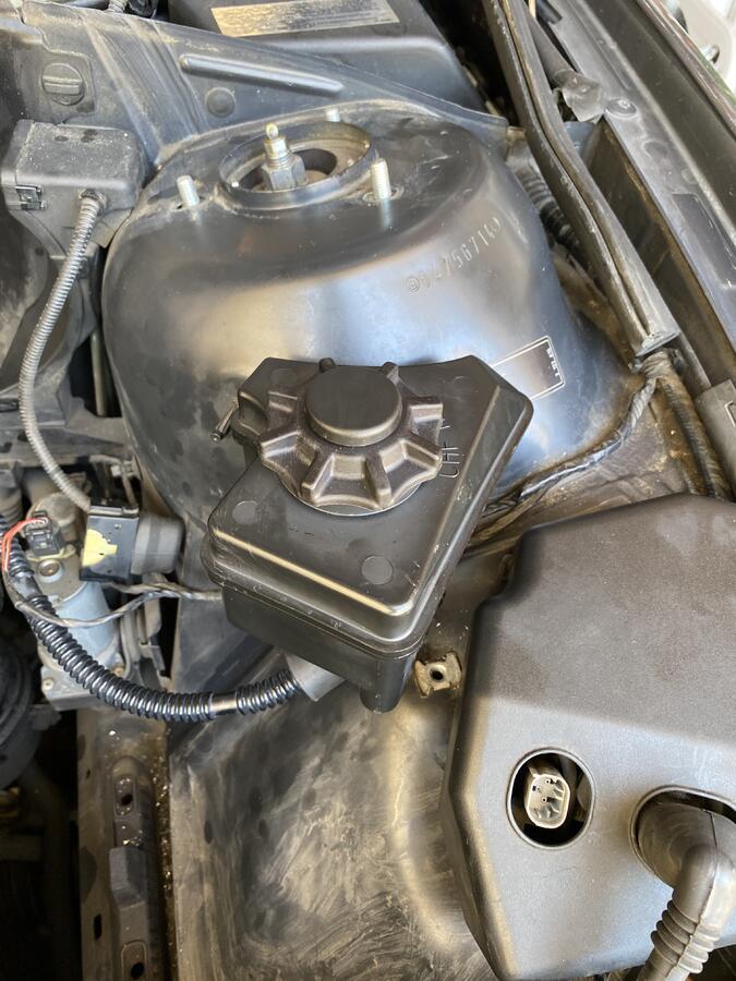

          Got the stock box out. Hardest part for me was getting the stock SMG reservoir line disconnected from the pump. The trick is to push the red clip DOWN, while pulling the line connection UP.​​
          Click image for larger version  Name:	IMG_0215.jpg Views:	0 Size:	100.0 KB ID:	106849

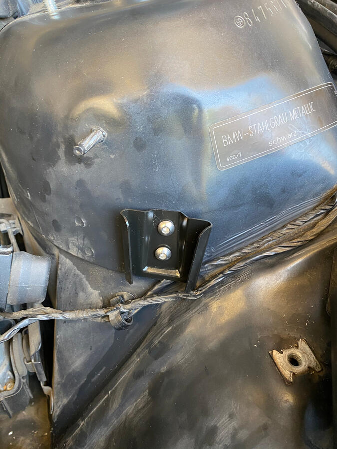

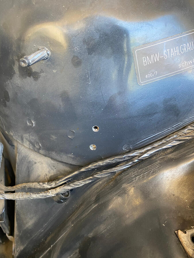

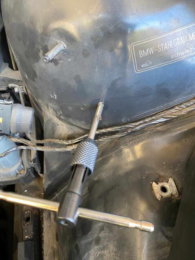

          Not a lot of information on mounting the CSL SMG reservoir out there, but I decided to drill the shock tower with a #19 bit and hand tap for some 1/8 inch hex bolts.
          Click image for larger version  Name:	IMG_0217.jpg Views:	0 Size:	98.8 KB ID:	106856
          Here’s the bracket mounted. It is slightly too close to the box in this configuration as it does just barely touch. I’m going to readjust the bracket to see if I can fix that.
          Click image for larger version  Name:	IMG_0218.jpg Views:	0 Size:	102.4 KB ID:	106852

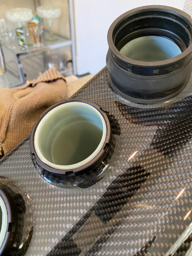

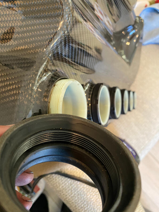

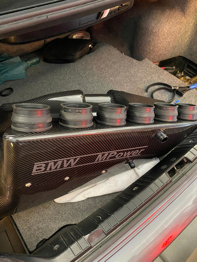

          So here was my biggest road-bump: the karbonius airbox came with these black plastic rings over the threads on the plastic trumpets.
          Click image for larger version  Name:	IMG_0222.jpg Views:	0 Size:	97.6 KB ID:	106854
          My stock 03 airbox had the boots that screw off and I tried putting the boots over the rings but it just did not fit right. I managed to get one off but the rest were glued tight.
          Click image for larger version  Name:	IMG_0221.jpg Views:	0 Size:	113.4 KB ID:	106850
          Went to Lowes to get a strap wrench and put it over the rings and they popped right off. Unfortunately I did scratch the finish with the strap wrench because I only applied painters tape and the screws from the wrench pierced through in one place. I used thicker tape for the remaining rings to prevent scratching.
          Click image for larger version  Name:	IMG_0223.jpg Views:	0 Size:	105.3 KB ID:	106851
          Click image for larger version  Name:	IMG_0224.jpg Views:	0 Size:	132.7 KB ID:	106853

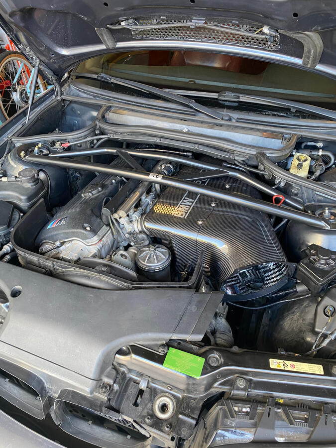

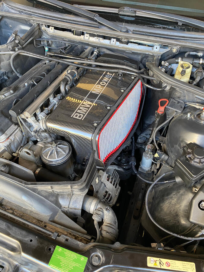

          Placed the box in. Stock CSL air filter.
          Click image for larger version  Name:	IMG_0225.jpg Views:	0 Size:	164.4 KB ID:	106859
          Placed everything back and wired in the iat and map sensors.
          Click image for larger version  Name:	IMG_0227.jpg Views:	0 Size:	153.1 KB ID:	106861
          Started up and stalled twice. Third time was the charm and it was purring along at idle!

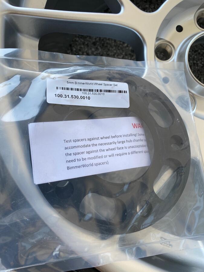

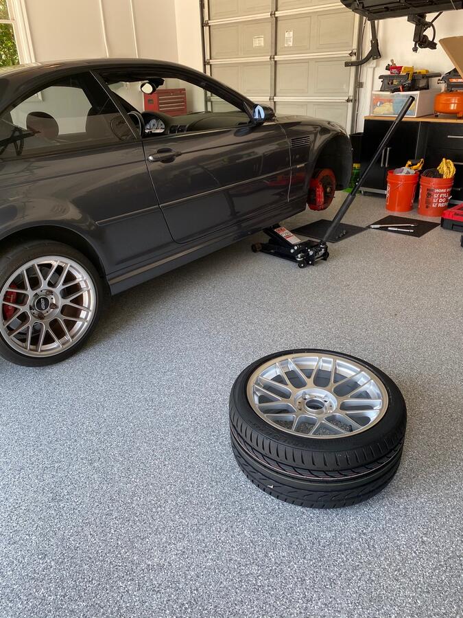

            Decided to swap out my 18x9.5 et22 Arc8s with the 9.5et35s instead because I felt that there was too muck poke in front. The tires are General Gmax RS in 255/35R18

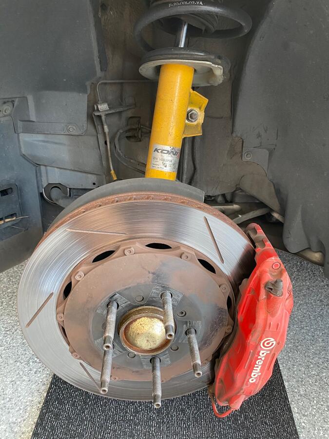

            5mm spacer for the fronts to clear my bbk
            Calipers are going to need a repaint soon...

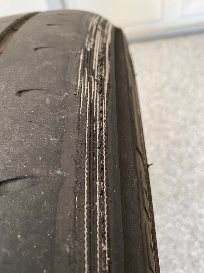

            Here was the wear on the old tires. Both driver side wheels were this bad. I couldn't tell if this is just camber wear (-2.5 F, -1.5 R) or if it's somehow hitting the spring perch. Hopefully I can dial back the camber with the new setup and avoid this.

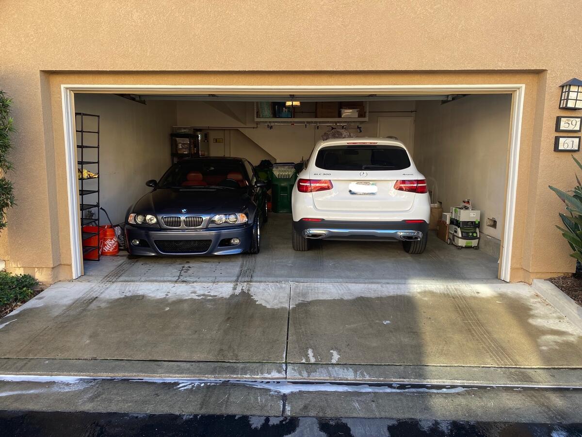

                        No big car updates, but a couple other big updates! My wife is expecting our first baby in July so we finally made the push to get a bigger place! It's just a condo but it has a 2 car garage so I can finally give the M some much needed love. After many years of apartment living and only being able to work on the car at relatives' places, this will definitely let me get a lot of things done on the M that I had been pushing off. Also, being able to wash my car at home is a huge plus. I know a lot of people say goodbye to their fun cars when the babies come but I will be keeping the M3 no matter what.
                        It's a pretty tiny 2-car garage, but definitely enough room for our needs.
