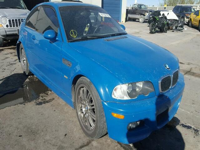

    Back in 2016, I didn't want to go and spend the money to buy a LSB that was already sorted and what-not so I searched everywhere for a deal/project. I had to have LSB, it was the color E46 M3 that I remember seeing all throughout middle school and high school, I absolutely loathed over it.
    Sure enough, after waiting for what seemed like an eternity, I finally stumbled upon a 2002 Laguna Seca Blue E46 M3 on Copart.

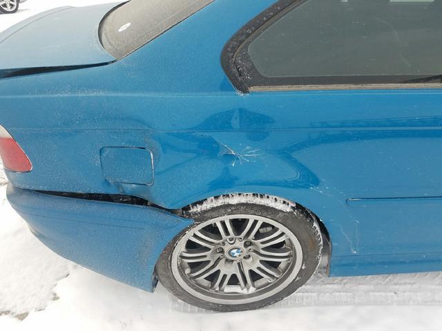

    It had slight damage on the right rear quarter panel of the car that didn't look terrible. I carfaxed it prior to bidding to check owner history and to make sure the car never made its way up to the rust belt. According to carfax, it only had 2 owners and it thankfully lived in Texas all its life so the undercarriage was really clean and didn't have any rust on it.

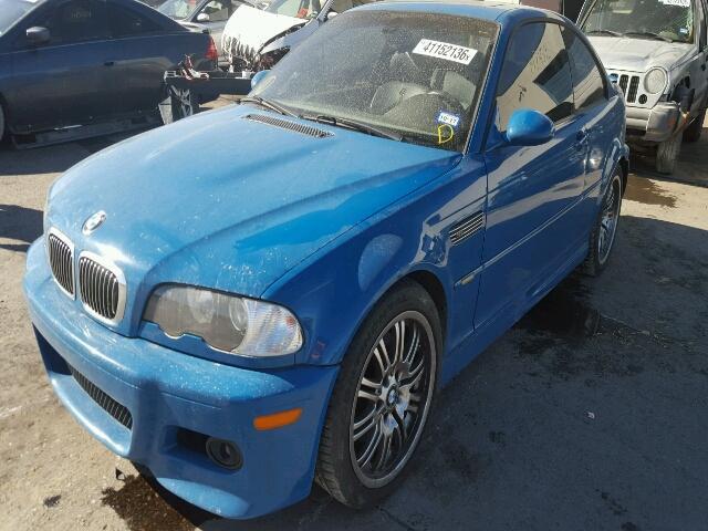

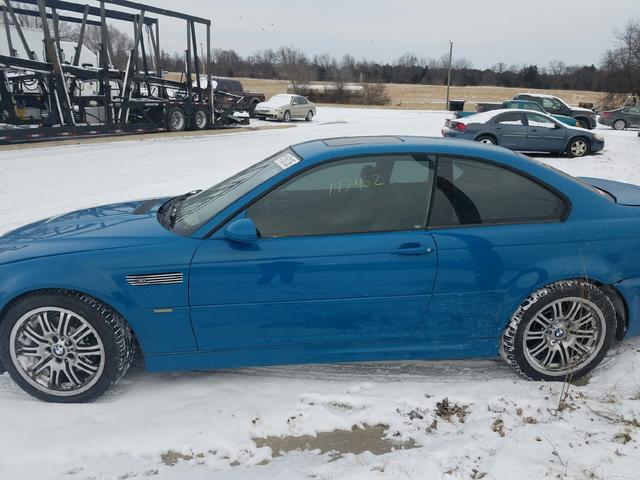

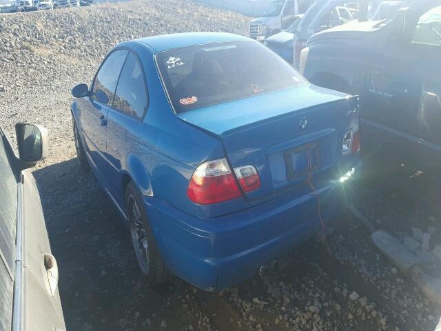

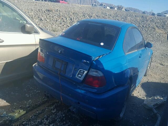

    Here are the only pictures that I had to base my decision off of from Copart. It looked decent, but the interior was trashed. I was planning on swapping it out for black (hopefully m-texture one day) anyway so I bit the bullet and placed my bid.
    Click image for larger version  Name:	41152136_Image_2.JPG Views:	3 Size:	52.5 KB ID:	45694
    Click image for larger version  Name:	41152136_Image_3.JPG Views:	3 Size:	43.4 KB ID:	45695
    Click image for larger version  Name:	41152136_Image_4.JPG Views:	3 Size:	46.9 KB ID:	45696
    Click image for larger version  Name:	41152136_Image_1.JPG Views:	3 Size:	53.4 KB ID:	45700
    I ended up winning the car and having it shipped out to Chicago.

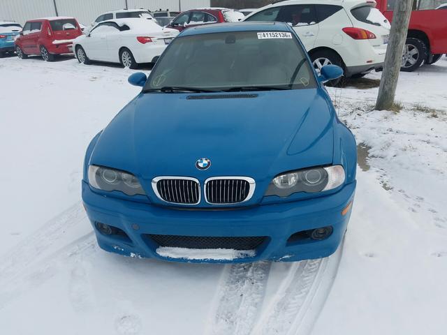

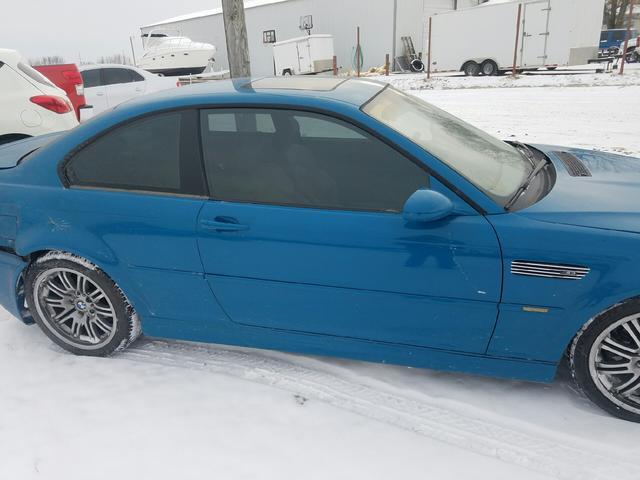

    Here's pics of the car off of the transport truck, the first and only time its ever seen snow! Check out the damage as well, I'm surprised it was totaled out, but being older cars insurance companies go by the KBB amount which is really low and inaccurate for our cars. So a few hours on a frame machine can total these out quick!
