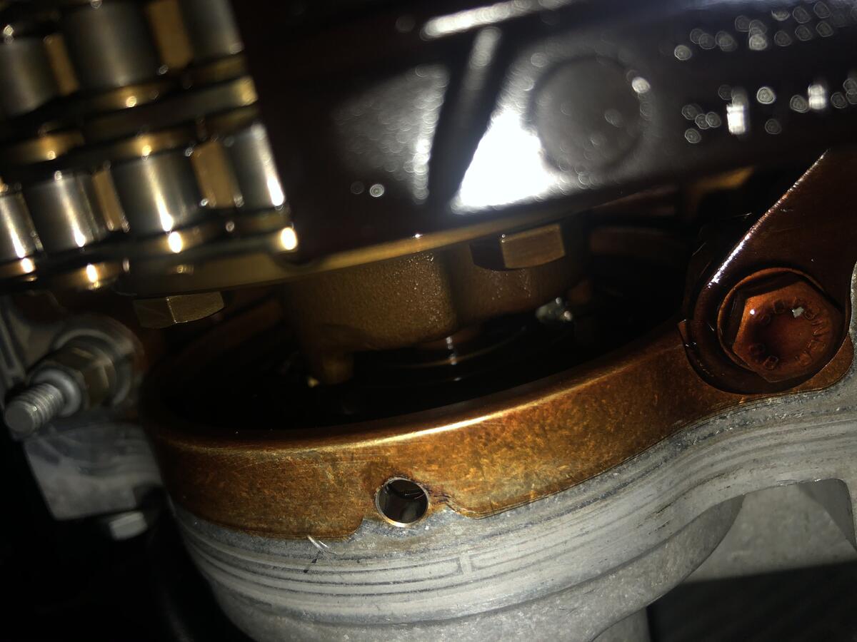

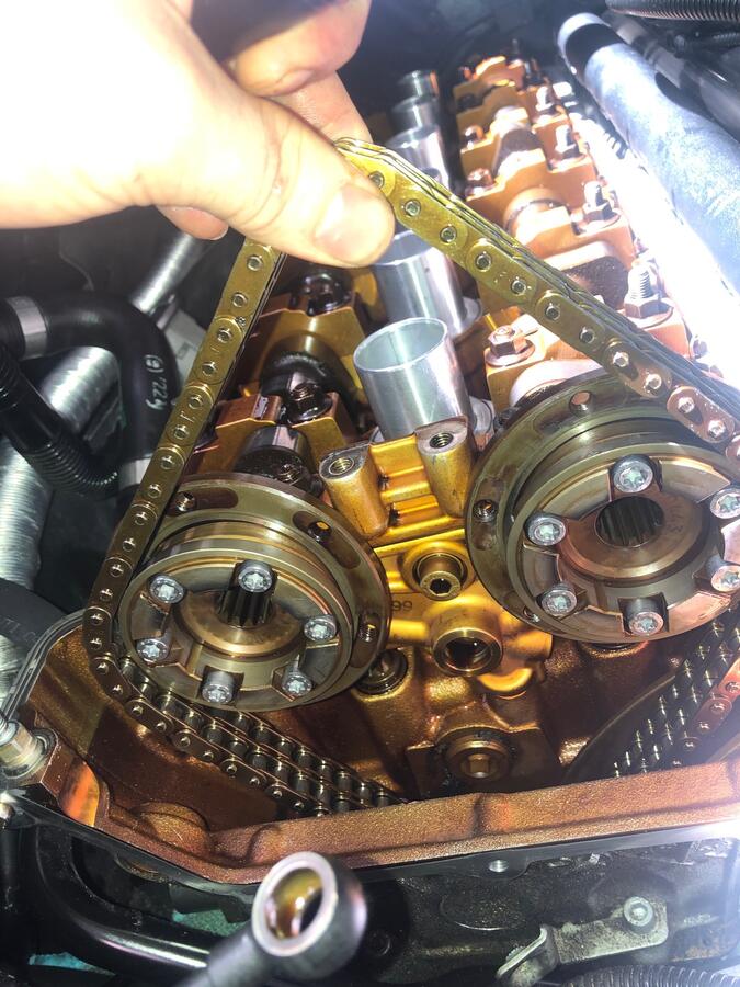

                      Okay, so I had gotten through about everything, and had the exhaust side sprocket removed. This was at about 11:00 PM after 9 hours of work. I was just about done and planned on buttoning things up the next day. Since the sprocket was removed, I needed to attach the timing chain "up" so that the slack did not fall onto the crankshaft, down into never never land. I used a clamp pictured in one of the videos I had watched and it was attached solidly. I covered the cams and everything up with trash bags and made sure to tape around the edges to be cautious in keeping out particulates etc.
                      During the night, a storm rolled through Raleigh which is not uncommon. It is, however, uncommon for the rain to blow at almost a 90 degree angle through the side slots of my carport (old house), and douse the engine bay in water. Now, I had meticulously covered everything up so there was no water intrusion anywhere. Freak occurrence, but we are all good. Wrong. The weight of the water on top of the trash bags apparently put pressure on my clamp, which, when applied to oiled surfaces, can apparently slip. I pick up the clamp, and retrieve the chain. No harm, no foul right? Wrong again my friend. Whether through the manner in which I retrieved the chain, or the manner in which the chain fell, it became snagged or wrapped around the crank.

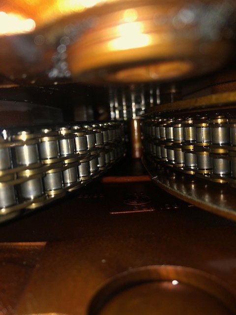

                      I work for days trying to get the thing loose. I have an endoscope down there, I am shaking, I am jangling and the damn thing isn't loosening. It is still snagged. Because it is snagged/wrapped I don't have enough slack to put on the exhaust sprocket. I remove both sprockets to try to get some more purchase on the chain to manipulate it. Shit.
                      No dice.
Name:	Sprocket Chain no tension.jpg
Name:	Sprocket Chain innards.JPG

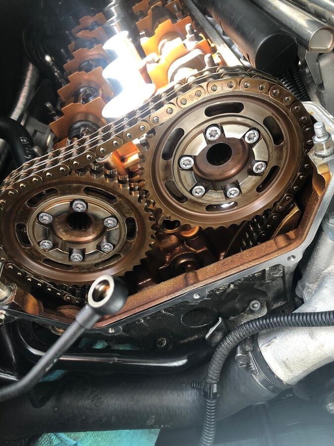

                      Okay. Here comes the happy ending...........I jangle the chain around for a a while and manna from heaven descends upon my car and opens up slack. I don't want to know why it happened, but it happened.
Name:	sprocket back together.JPG
                      God Bless America.
