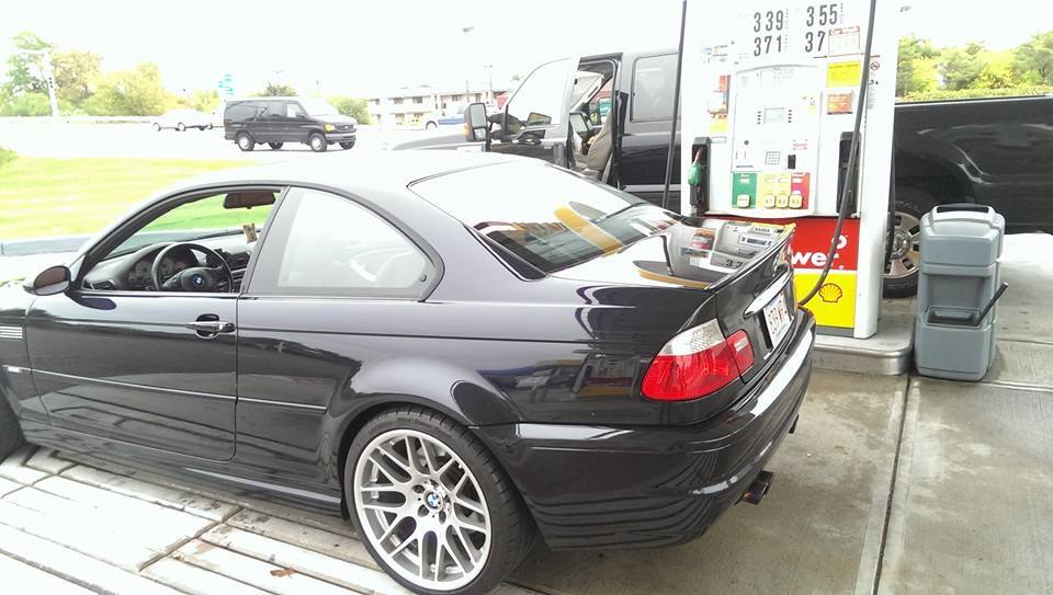

    Bought on 04/27/13
    When I first saw her:
    Driving back home, stopped in CT for Redbull:
    Hit 155k on the way in PA:
    Thought this was funny for some reason (was delirious after 13 hours of driving):
