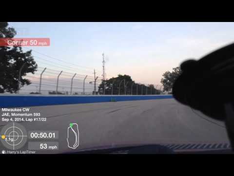

    Here's a flyby from a couple of months ago. My car is LOUD! You can hear it throughout most of the video.
