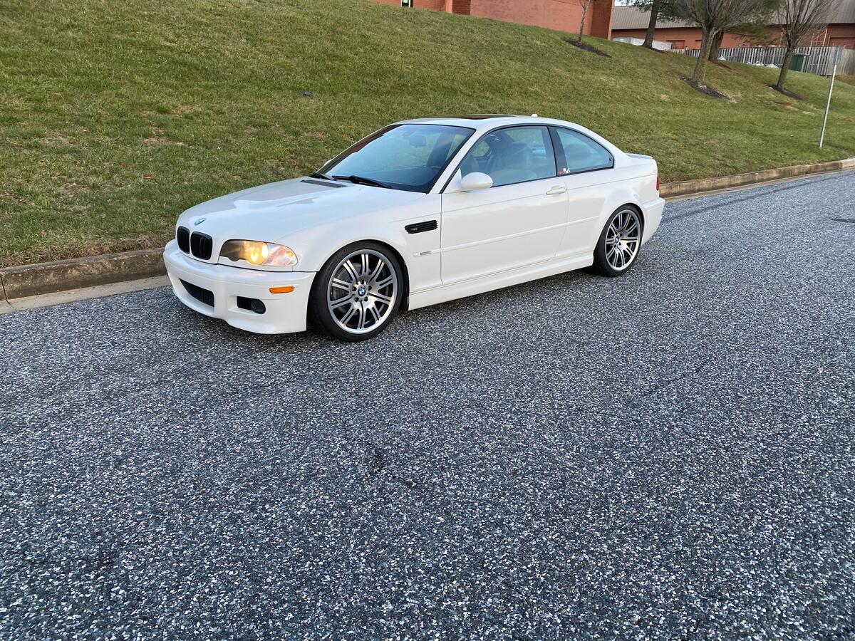

    Two weeks ago, 02_lsb told me that a friend of his was going to sell his Alpine White soon and gave me his number. The seller is the owner of GT Performance, a Porsche race shop in Maryland. The first time I laid eyes on the car it was parked next to his Guards Red 997.1 GT3 and I knew I had to have it. We got the ball rolling and I was able to bring this beauty home.

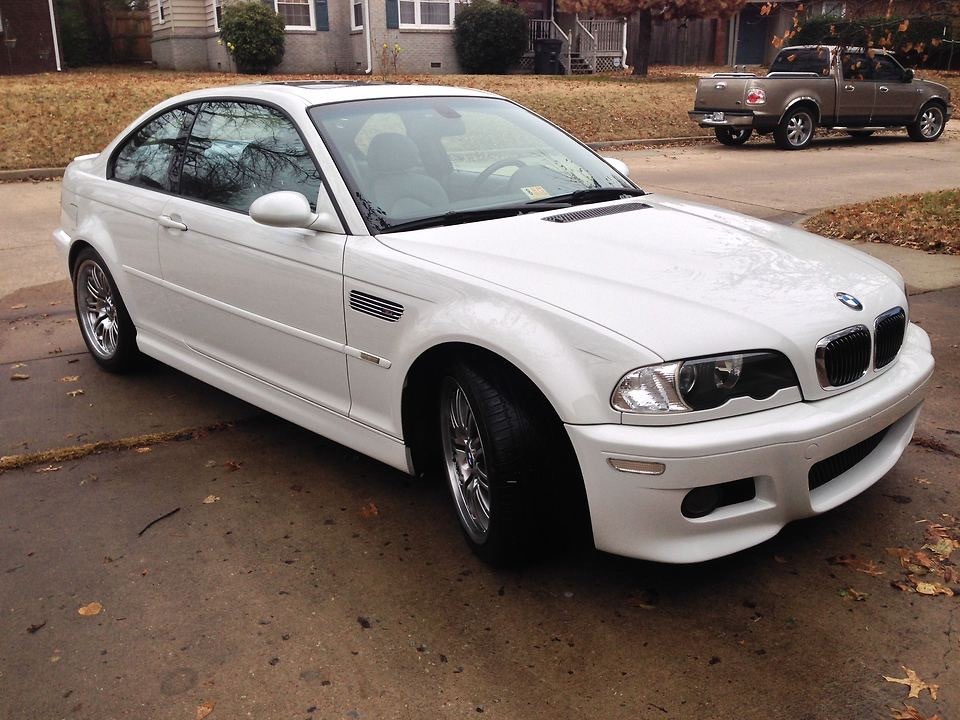

    Threw my vin into VinWiki not expecting anything and found a bunch of pics from 2014. The car was painfully stock back then

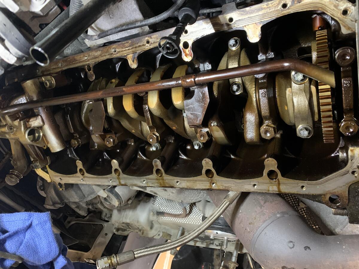

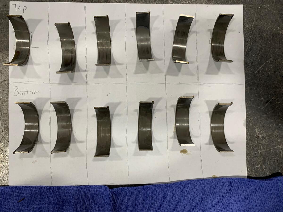

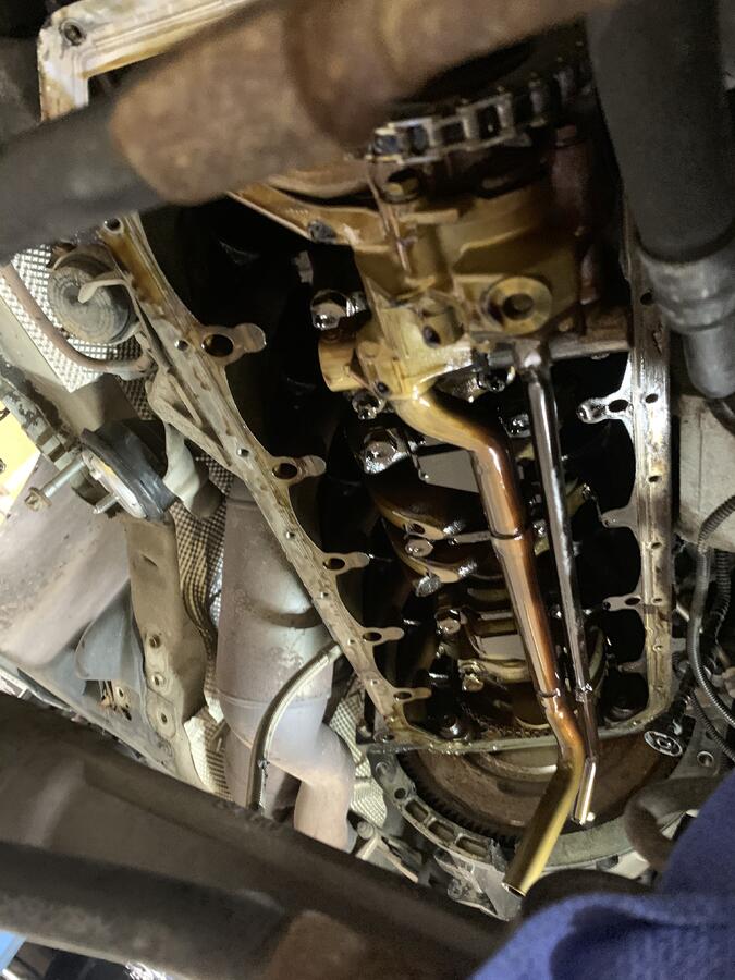

                      Spent Friday the 22nd and Saturday the 23rd refreshing the bottom end of this car. Did the full rod bearing kit from FCP Euro to replace a leaky oil pan gasket, new rod bearings, motor mounts, control arms with bushings, raised the KW V2's a little bit, and aligned the car. The thousand-mile break-in period is going to suck as the car now drives better than ever. Wish I would have gotten pictures while. it was still on the lift, but I sandblasted the Oil Pan and it looks brand new.
                      Shout-out to GT Performance for doing the whole job in two days and letting me watch and help out as much as I could. Wasn't happy with the bill however hopefully I don't have to spend any money on maintenance anytime soon.

                        So I haven't updated this thing in 6 months and a LOT has happened since then so I'll just jump right in. Shortly after my last update of getting the rod bearings and all the other stuff taken care of, my car started losing oil pressure. It got to the point where at warm idle, it literally wouldn't register anything on the oil pressure gauge.

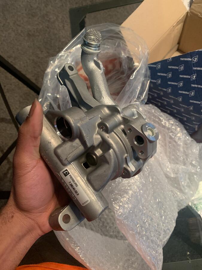

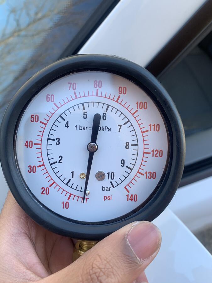

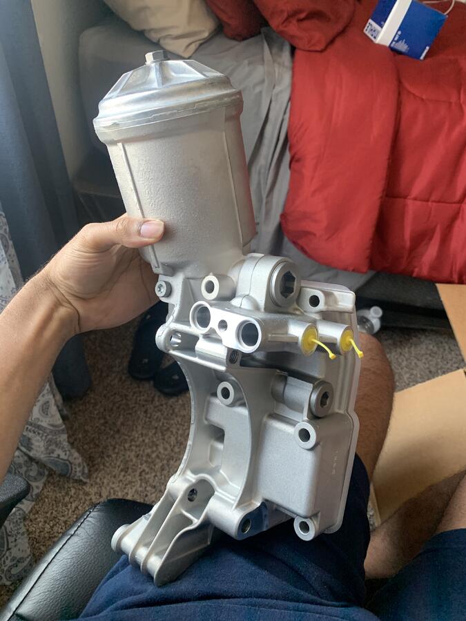

                        Me and my Indy went at it for over a month as I was blamed for supplying bad bearings causing the pressure to drop. I took initiative and began researching and replacing stuff on my own, in my driveway, in the cold lol (no garage, unfortunately). The biggest thing I did was the Oil Filter Housing.
ID:	115808I ended up snapping a water-line during installation somehow and ended up breaking one of the fan shrouds out of rage during the process. I could never be a mechanic lol. After I finished this job instead of getting low pressure at just warm-idle, the red oil light was on at all times no matter what I did. I was committed to dropping the subframe and doing the bearings/pump myself at this point. Eventually, enough was enough and my father stepped in and deal with my Indy. They ended up coming to the agreement that they'd fix the issue free of charge if I came in and helped with the labor. Per the agreement, I had to pony up for all OEM parts-- BMW brand rod bearings are way more expensive than ACL's and a Pierburg Oil Pump set me back yet another $700+ dollars.

                        Towed the M3 up there and we knocked everything out of the park. New Oil Pump, OEM Bearings, fresh gaskets, as well as new tie rods (old ones were shot and I finished them off when I dropped the subframe in my driveway LOL), and an alignment, and the car was running like a top. It wasn't without some hiccups but two days of hard labor and we were back in business.
                        In just 2021 alone this car has had 2 different oil pumps and FOUR sets of rod bearings!! Originals I got the car with, ACL's extra clearance (my mistake ), ACL normal clearance, and OEM BMW lol. My poor poor wallet.

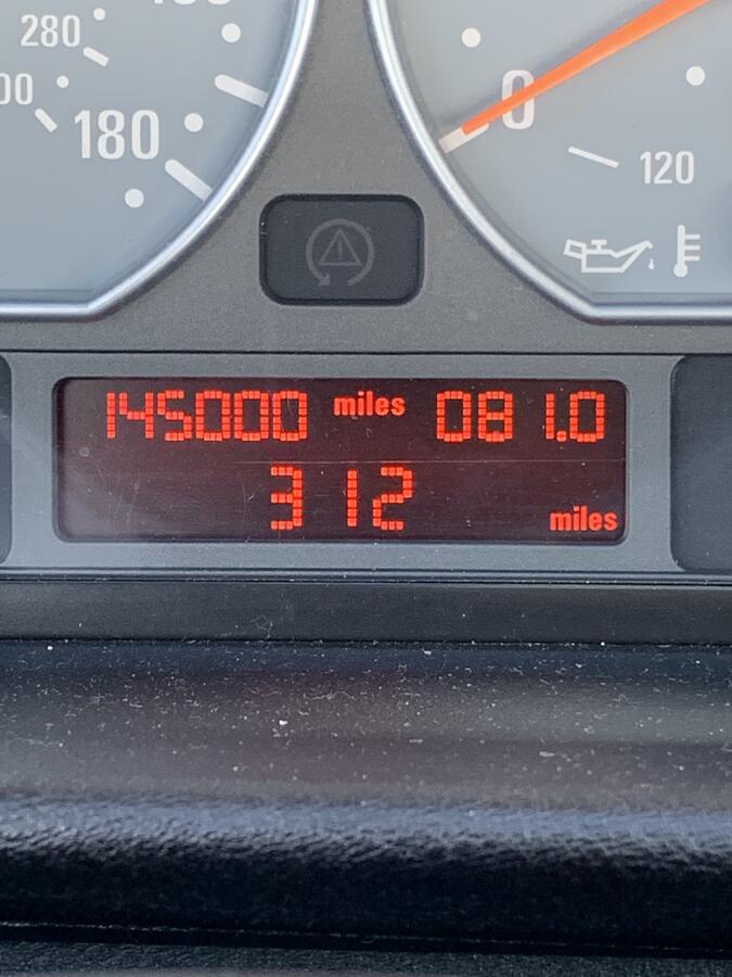

                          Ticked 145k and the 1,500-mile break-in. At this point I was determined to go to all the car meets and drive as much as possible. Small photo dump incoming

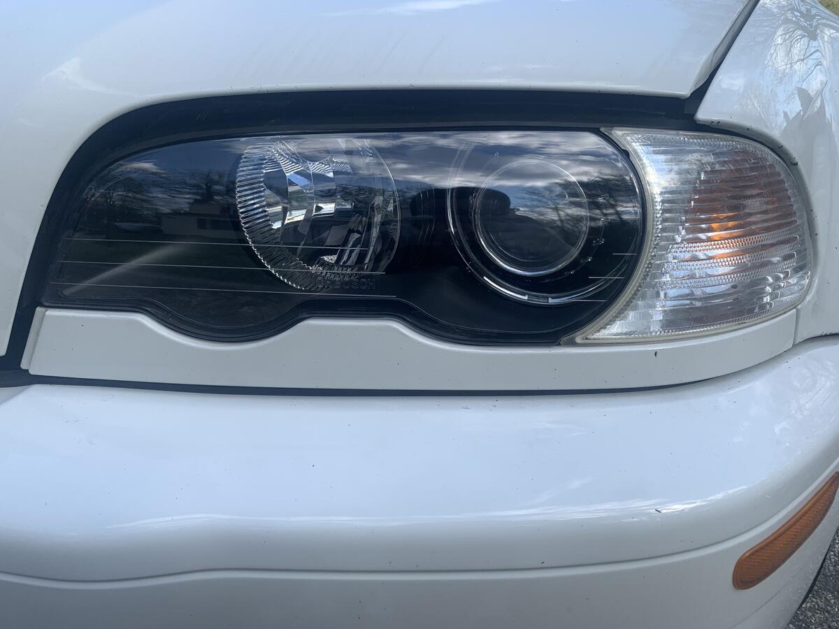

                            At this point, I was ready to start doing some mods to truly make the car feel like mines. I ended up doing tint, new kidneys and side vents, and new headlight lenses all around the same time.
                            Before
                            After. Pics don't do it justice, it made a MASSIVE difference.
