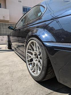

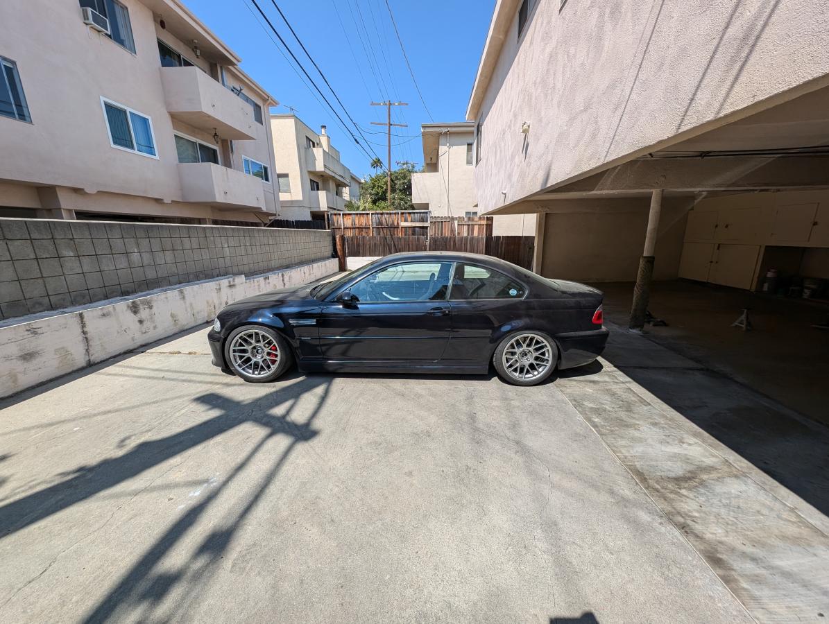

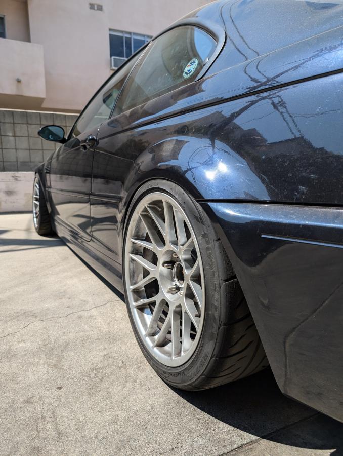

    Ride height dialed in. I'll probably raise it a quarter or third of an inch in the rear. I also need helper springs and/or taller springs in the rear as there is a massive gap between the spring and perch when the car is off the ground.
    Still needs an alignment. Not sure if the popping sound up front is gone, but haven't heard it since tightening the front strut nut (granted I've only driven it in the driveway due to rubbing until I get an alignment or remove the spacers lol)
    Also I think the rubbing from the brakes in the rear might be a sticky piston in the caliper. I have a Porsche kit waiting to go on in the rear so we'll see if that resolves it. Getting closer and closer to finishing it, yet still so far lol.
    Oh and still need to install the do88 stuff and new brake booster.
