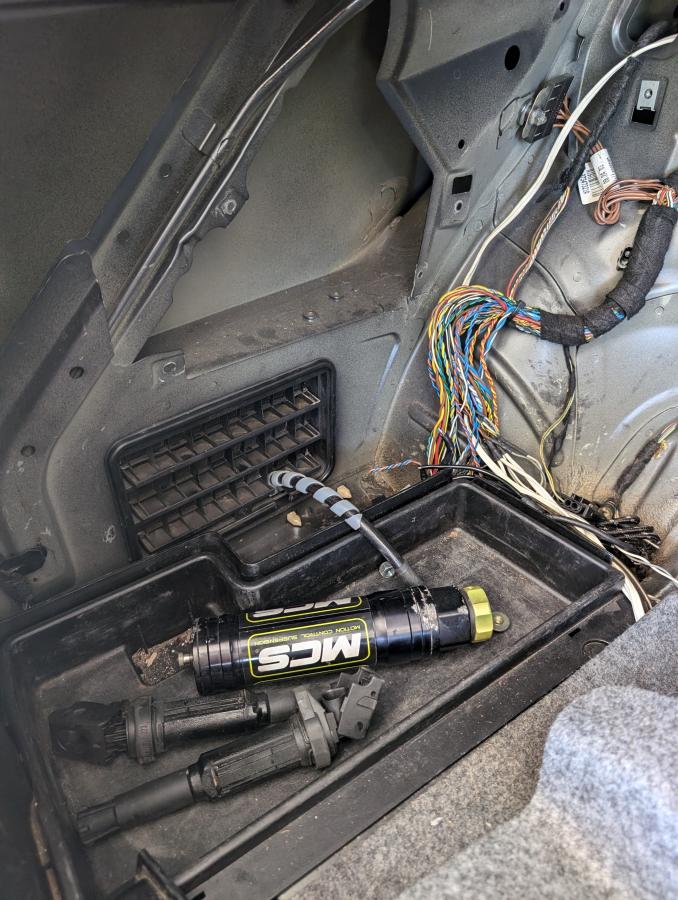

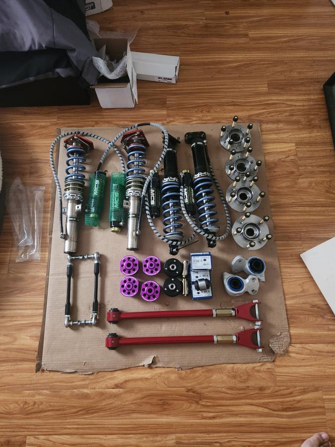

                    Bunch of parts on the way.

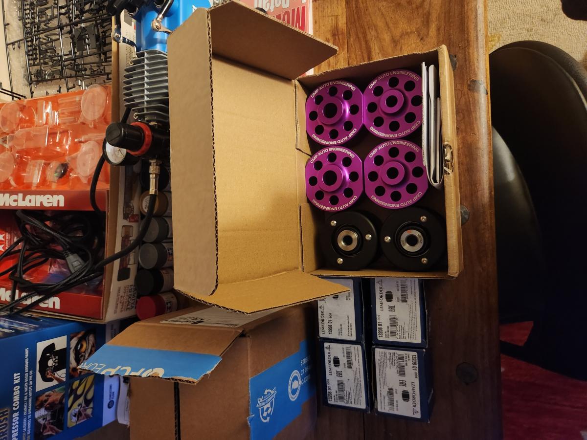

                    Got the CMP subframe mounts, GC rear lower arm with sealed bearing, GC upper inner bearing, Lemforder ball joints, Bimmerworld RTAB + the appropriate Lemforder ball joints as opposed to the Meyle they come with, and the big missing piece, MCS 2 way remote.

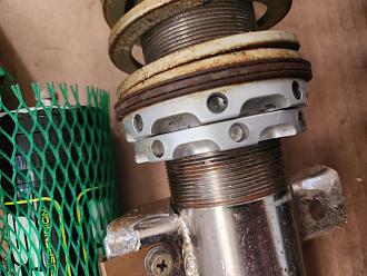

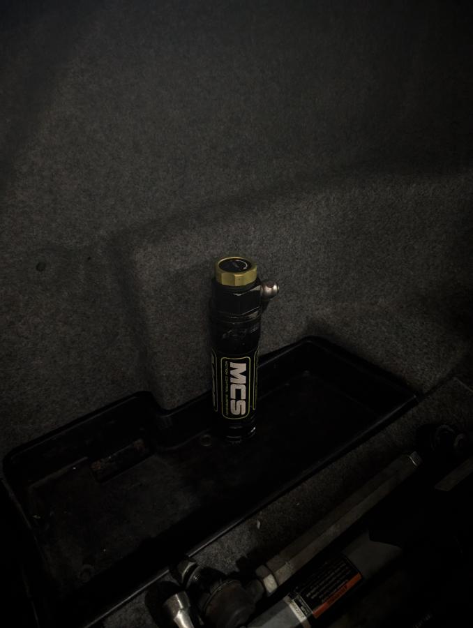

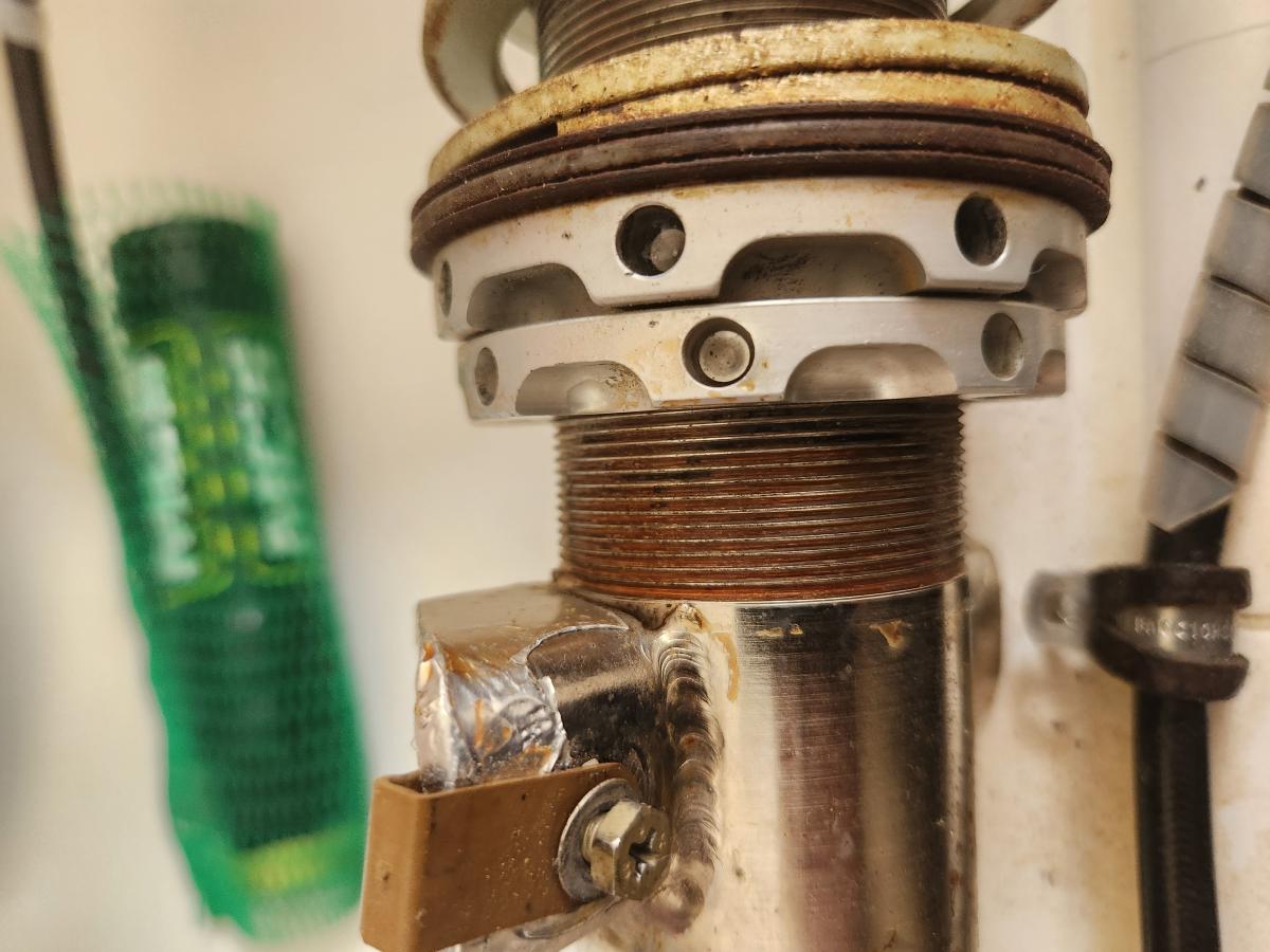

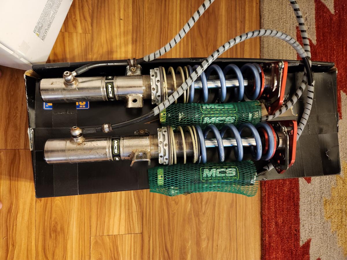

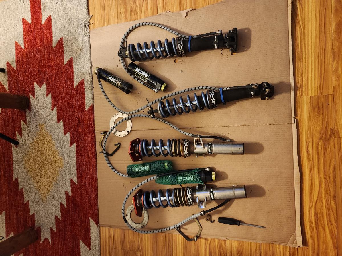

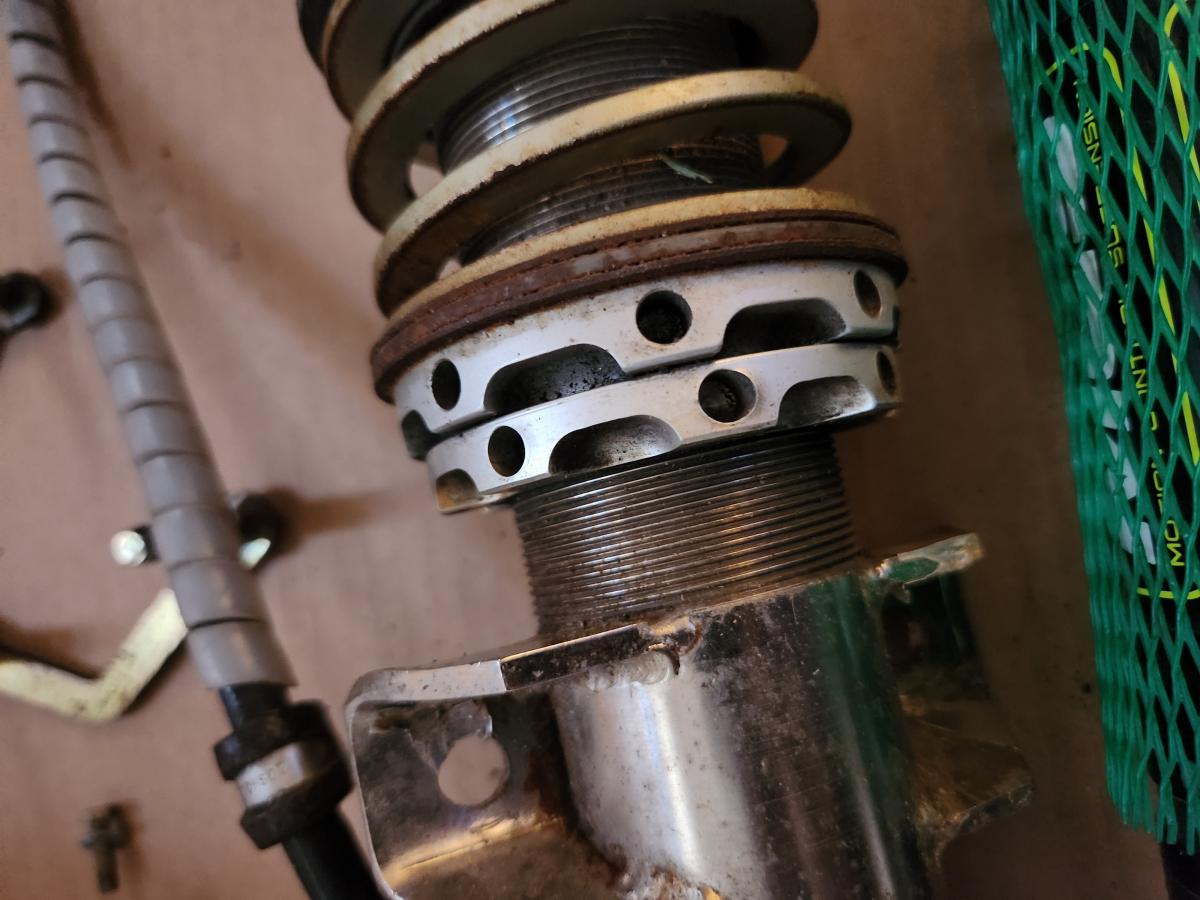

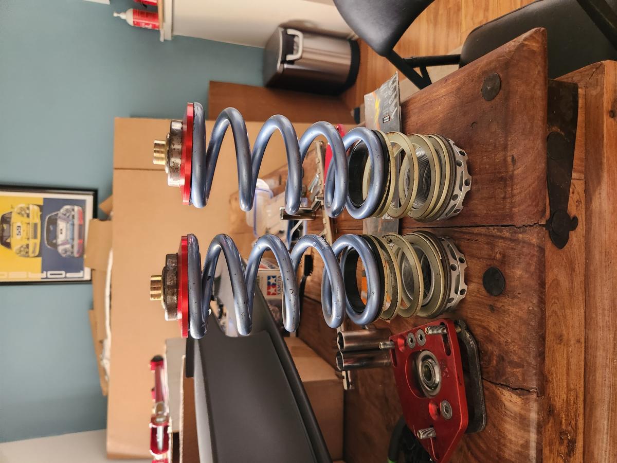

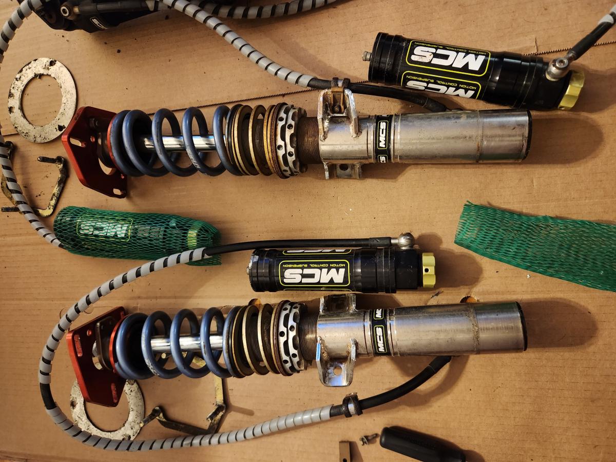

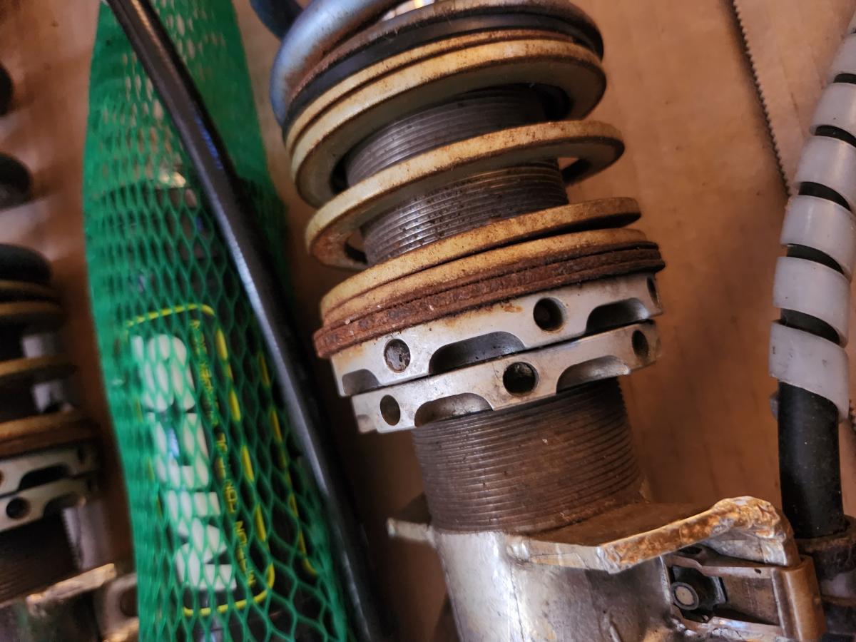

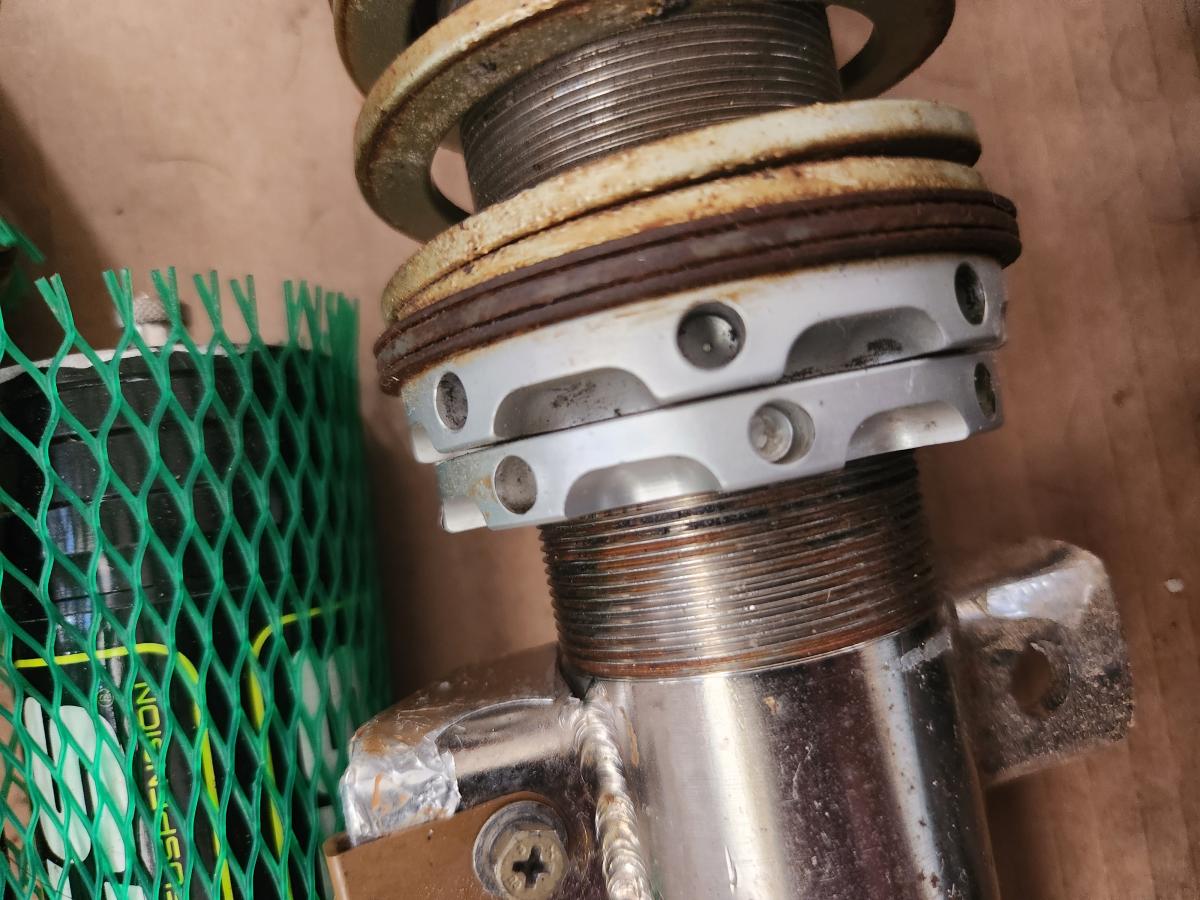

                    Scored the MCS thanks to a forum member. They're a little bit rough due to corrosion from brake dust and the threads will need to be cleaned up to remove some rust. I'll likely have to replace the spring perch for the helper springs and torrington bearings as they also have a good bit of rust. But overall in decent shape, no leaks, somewhat recently rebuilt.
                    Anyone know the best way to clean these up? Just take a wire brush to it? I'm going to rewrap them with aluminum tape to keep the body from pitting/corrosion and throw some anti corrosion wax on the threads, but I want them to look pretty even though the car isn't a show car.
                    I feel somewhat bad throwing this much money on a high mileage car, but I intend on keeping it for a while and driving the hell out of it so it makes it worth it.
                    ​​​​​​Next up are turner Monoball FCAB, turner adjustable end links, Lemforder tie rods, all new hardware for every suspension piece, and a ZHP rack then time for install and to drop the car off at TC for subframe work/cage. It's all coming along!!

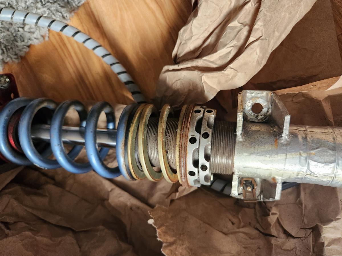

                      So a bit of elbow grease and a wire brush and i made.some progress. Although I realized I have a Dremel so I'll just use that and make my life easier

                        #56
                        Evaporust works great for that kind of rust and isn't abrasive like a wire brush. It's also readily available and reusable.
                        Only issue I see is that normally, you'd fill a container with the liquid and then let the parts sit in it for a while, which won't be doable with the coilovers. Maybe you could soak a rag and wrap it around the rusted areas? Don't know how effective it will be when used like that though.
                          #57
                          Awesome! Thanks for the suggestion, I will look into that. Fortunately the wire brush doesn't seem to be damaging the threads which was my main concern initially. I'm going to disassemble everything this weekend so that it's easier to work on.

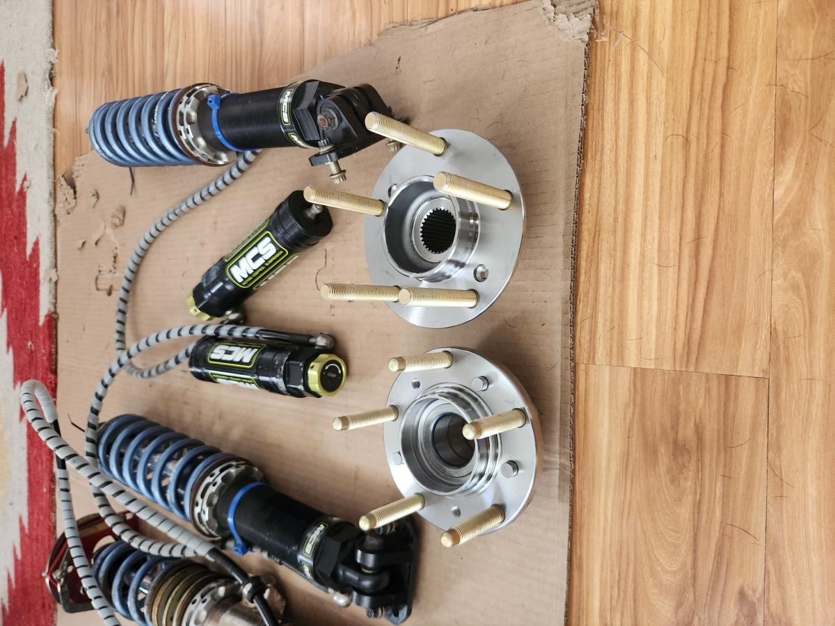

                          My core4 hubs with ARP press in studs also just arrived.
                          Slowly getting there. Also really annoyed of these sideways pics lol. Gonna have to start posting from a computer, or edit my pics and make them sideways before uploading so it orients them the right way.

                            Got the shocks mostly cleaned up. Disassembled them, put the smaller bits in evaporust as recommended. I tried wrapping a cloth soaked in the solution around the threads but it didn't do too much, however I was able to wire brush most of the rust off. They're not perfect, but the height adjuster spins freely now and they don't look like complete ass now so it will suffice. Also, I really need a garage ASAP.

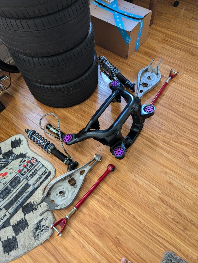

                              And I have everything I need for the suspension refresh. SPL end links came in, along with the turner FCAB, and Lemforder ball joints to press into the Bimmerworld RTAB instead of the Meyle they.come with. Beyond excited.

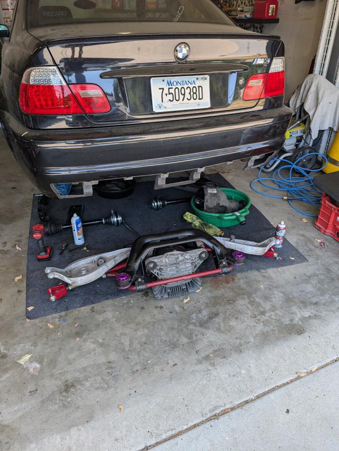

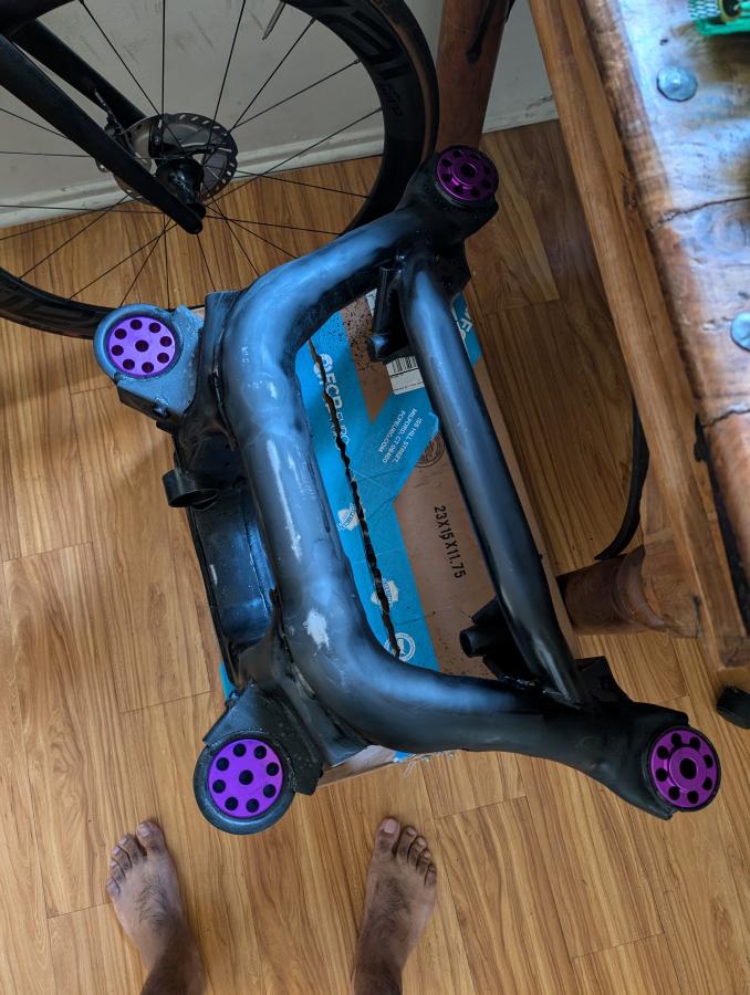

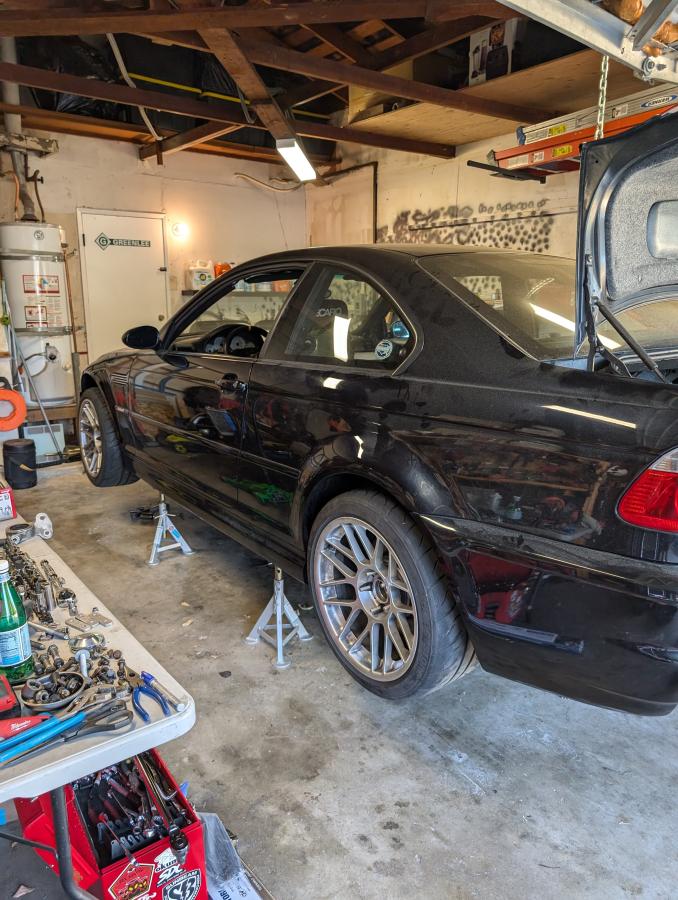

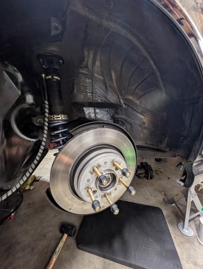

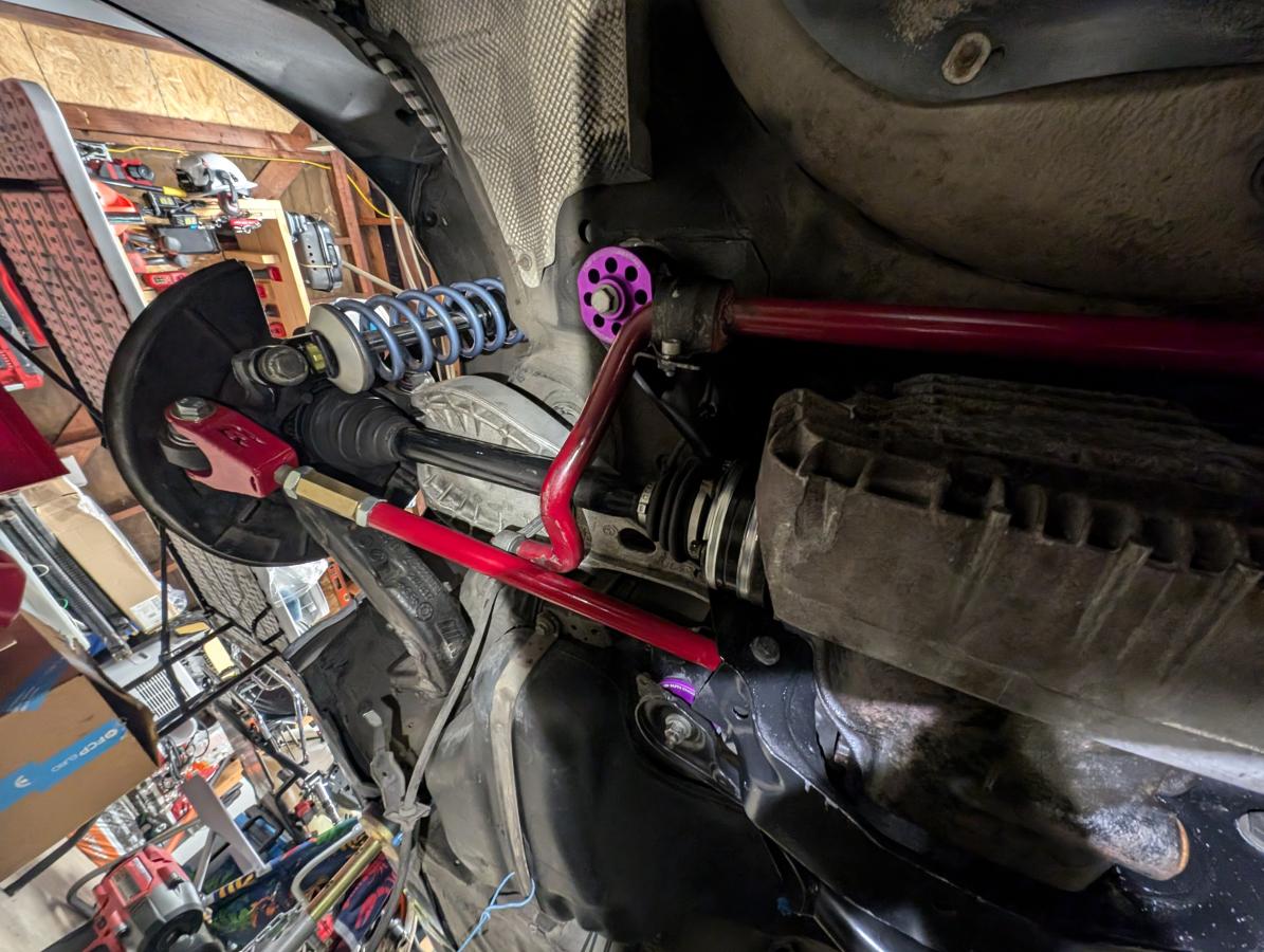

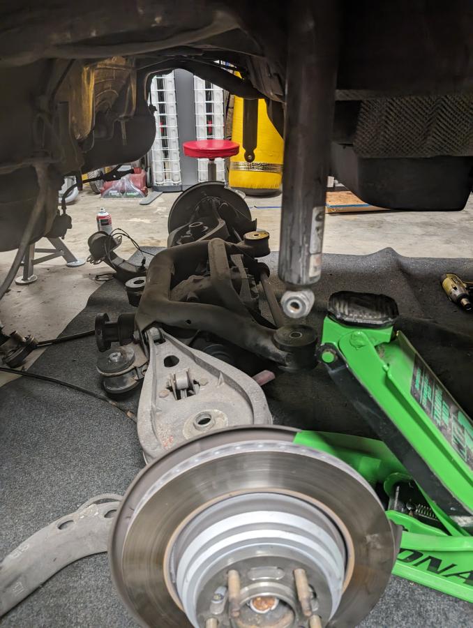

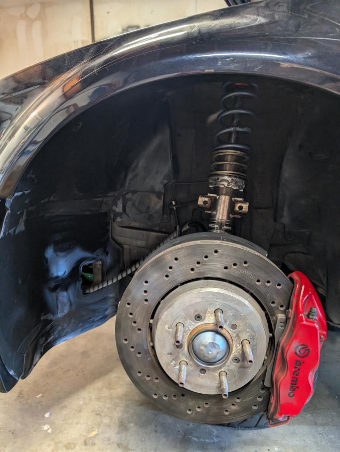

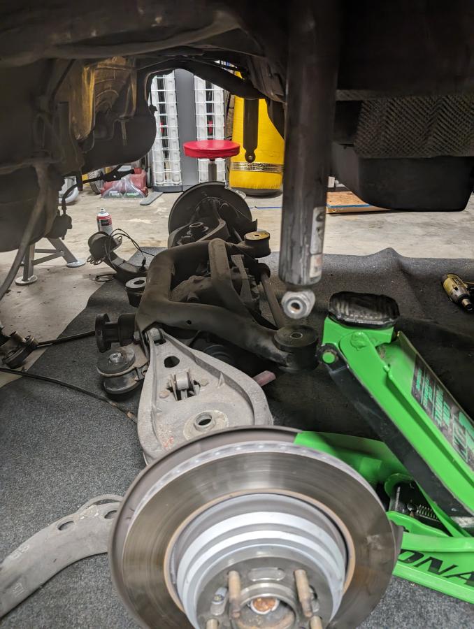

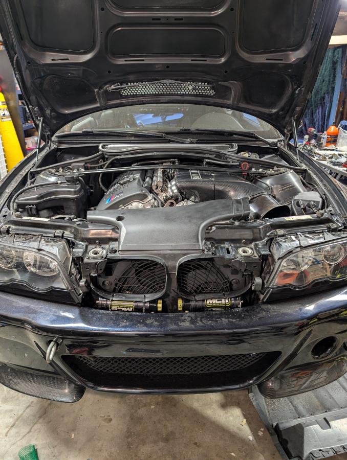

                                Finally got around to installing everything. Old subframe had a bit of rust so I purchased a used one to work off. I still need to make some adjustments. Installed end links wrong so they're making popping sounds, hopefully didn't destroy them. Also have a rubbing sound from what sounds like a brake backing plate or perhaps parking brake dragging. Could also potentially be the exhaust heat shield running on the driveshaft. Also need to fix the 4x4 ride height. Other than that, it was a fun project and I learned a lot. Glad I didn't take it to a shop as I got to address a bunch of small things a shop would have likely ignored. Next up is the half cage from TC design.
