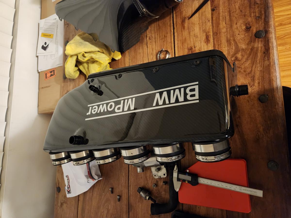

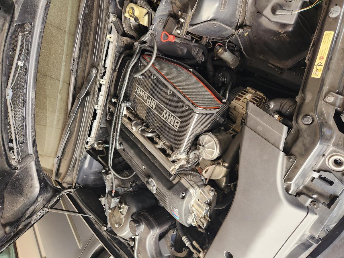

    Got the box back from Karbonius and it looks magnificent. They put on all new fittings and polished it. Installed it on the car, went for a drive, and I stalled as I'm exiting my driveway, and it won't turn on lol. I've been having an issue where the car won't turn on unless it's been sitting for a while. I replaced the ignition switch and coded out the clutch switch, so I'm guessing it has to be the starter. New valeo starter on the way from FCP. I'm itching to drive this thing. And please ignore the absolutely filthy engine bay, it will get a proper detail soon.

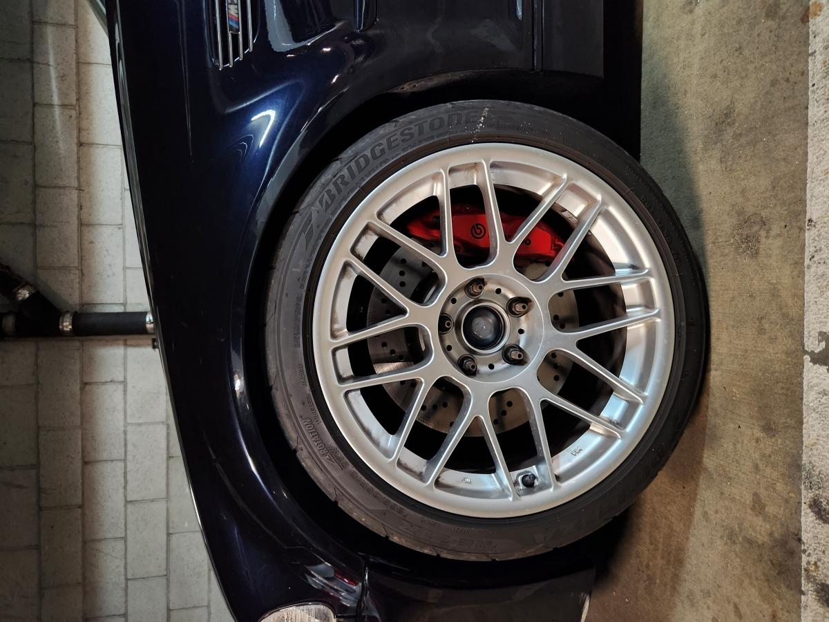

        So brakes are on and all fluids replaced in preparation for a track day.

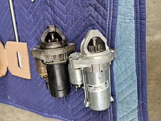

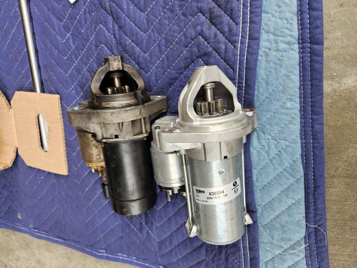

        I also replaced the starter, and whoever replaced it before managed to mangle one of the bolt heads. Took me a cool minute to figure out why the socket wouldn't slip on. Used an e14 instead of e12 and managed to replace it. Also obviously replaced the starter bolts. Also if you're ordering a starter from FCP euro, be weary of the Valeo new starters (not the reman, it's a silver body) as they're a different design and upon installing it was grinding. It had the correct PN and everything stamped.on it. I ordered another Bosch reman from a local parts supplier (it had Valeo written on the side and was the correct design) and had no issues.

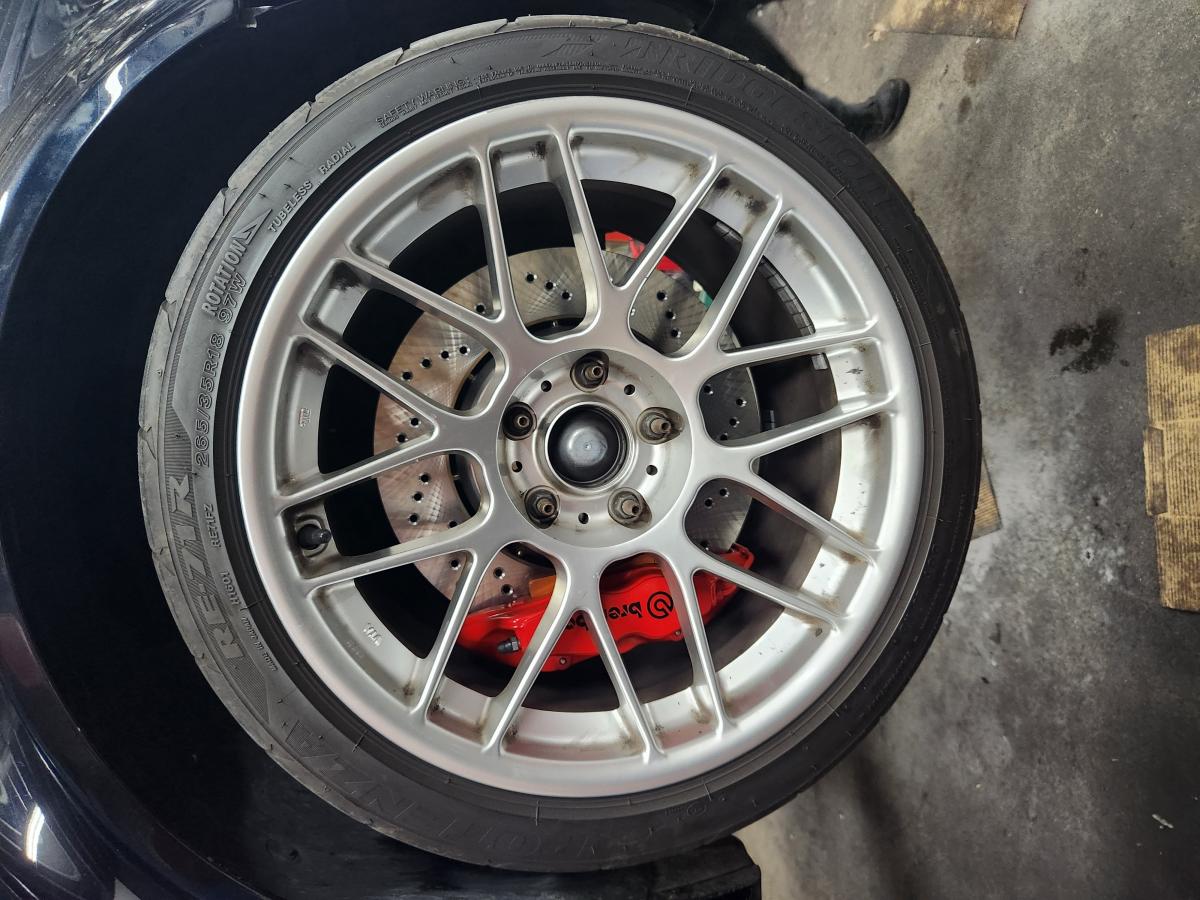

                        Car feels great overall. Pulls hard, engine sounds healthy, valve train sounds good, no ticking, temps stay around 220-230 (and this is without having installed any of the do88 stuff).
                        Suspension is decent (eibach pro street coilovers) however definitely on the softer side and a bit wallowy. But still suffices.
                        Brakes are okay. They're good for 2-3 or so laps before they feel iffy. I didn't have much confidence in them and unfortunately that's what kept me from being consistent throughout the day. My best time was a 2:02, but I was setting anywhere from 2:05 to 2:08 because of my lack of confidence in the brakes. I might have also been overbraking and asking too much from the brakes so that didn't help either. The car is way more capable than I am as a driver, but as long as I improve everytime I go out I'm happy.
                        I will probably end up upgrading the brakes or at least add ducting. I know it's likely a driver excuse, but I feel that before I improve as a driver I need to be able to be consistent, and brakes are probably the most important thing in that aspect.
                          #42
                          ^what pads are you running? You should be able to get a consistent session out of those Brembo 4-pots with the right pads and good fluid. Essex also recommends removing the dust shields before adding brake ducting if you haven’t already done so.
                          I’m using Ferodo DS1.11 compound with 996 calipers right now, really happy with them and my instructors are usually excited about the brakes when they drive or ride with me too.
                            #43
                            I'm on carbotech xp10 w/ SRF fluid, so I'm not sure that is the issue as they're race pads and I have ran the same setup on different cars before, albeit lighter cars. I have not added ducting yet, but will keep that in mind when I do so.
                            Hmm I am wondering if I'm asking too much of the brakes? It just didn't feel consistent to me in terms of bite and stopping power. I might bleed the system again and see if that helps. I know the CSL rotors are notoriously soft as well, so might consider the girodiscs + ducting, but if I'm going to spend that much, I think I'd rather just opt for an AP racing setup even though it's quite a bit more.
                            Fwiw my time at the same track before was 2:03, and I was on some crap pads and pretty much had non existent brakes, so I might have simply been overbraking and roasting them as my time barely improved with much better brakes.
