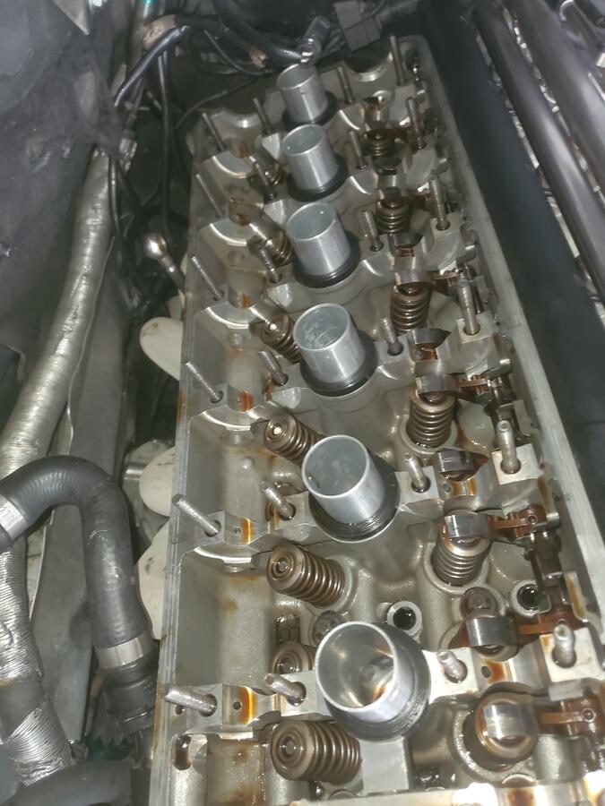

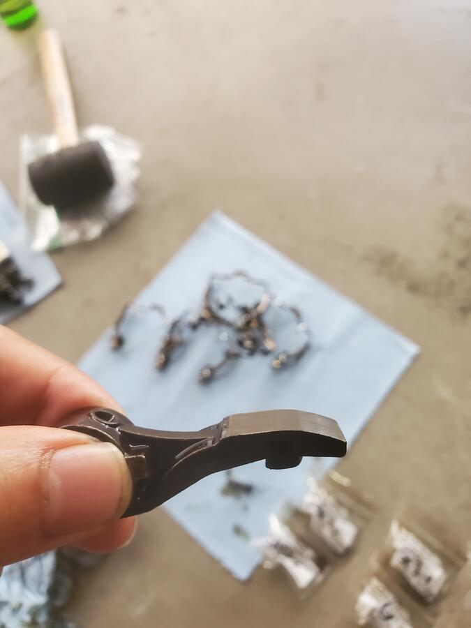

    Took apart the top end again and the followers on the exhaust side are all starting to flatten. I also kept getting oil temps of around 220 after just a few redline pulls. Is it possible that I have some sort of oiling issue on the exhaust side? I.e. when the rocker arm shaft got stuck, maybe the passages got damaged? Or is it more likely that all the followers just more or less decided to give way at the same time since they weren't paired with the cams?
    The reason why I'm concerned is because the intake side seems completely fine. If the cams weren't paired with the rockers, shouldn't I see abnormal wear on the intake side as well? Or would it not wear as fast due to it not seeing as much heat?
    I'm planning on replacing both cams and all followers with Schrick DLC, however I'm a bit nervous that I'll replace everything and it wears poorly again because it's not being lubricated properly.
    FWIW when I opened it everything seemed well lubricated and the 3 failed rockers that I replaced previously don't have any abnormal wear (although they shouldn't after only a few hundred miles, so not sure that says anything)
    Click image for larger version  Name:	20210906_170139.jpg Views:	0 Size:	34.6 KB ID:	125158
    Click image for larger version  Name:	20210906_170055.jpg Views:	0 Size:	84.3 KB ID:	125159

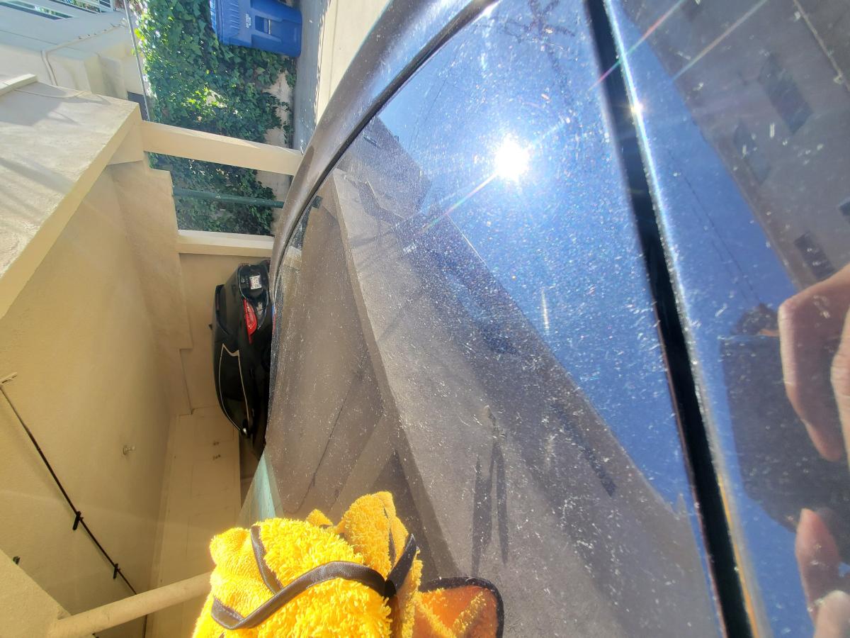

      Also, finally did something I should have done right when I got the car: paint correction!!! Holy crap what a difference it makes. I'll snap some more pics tomorrow, but the before/after of the trunk should give a good idea of how bad things were before.

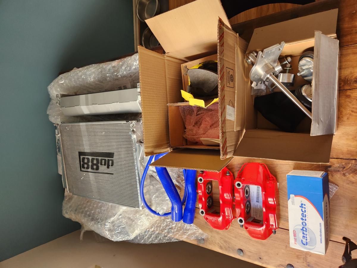

        Few things I will be throwing on very shortly:
        do88 radiator and oil cooler
        Bimmerworld group N engine mounts
        E21 trans mounts w/ AKG cups
        AKG stage 2 solid mounted shifter w/ BMW motorsport knob
        Megane RS calipers (freaky parts adapters) + zcp/CSL 345mm rotors + carbotech xp10. This is subject to change, might switch to an AP racing 8350 kit.
        BBS RIA (also might just sell these, arc8 will suffice and I can use the money elsewhere such as coilovers)

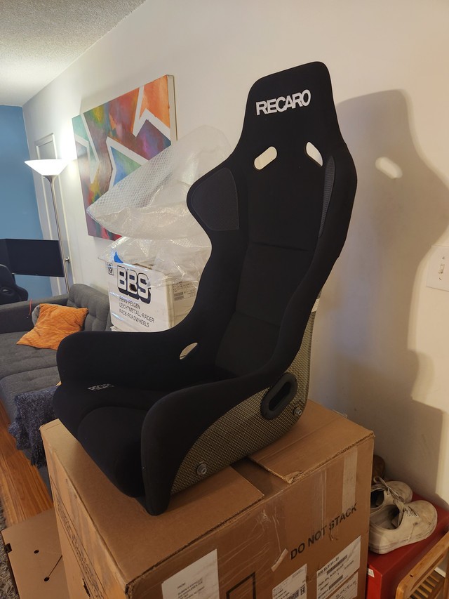

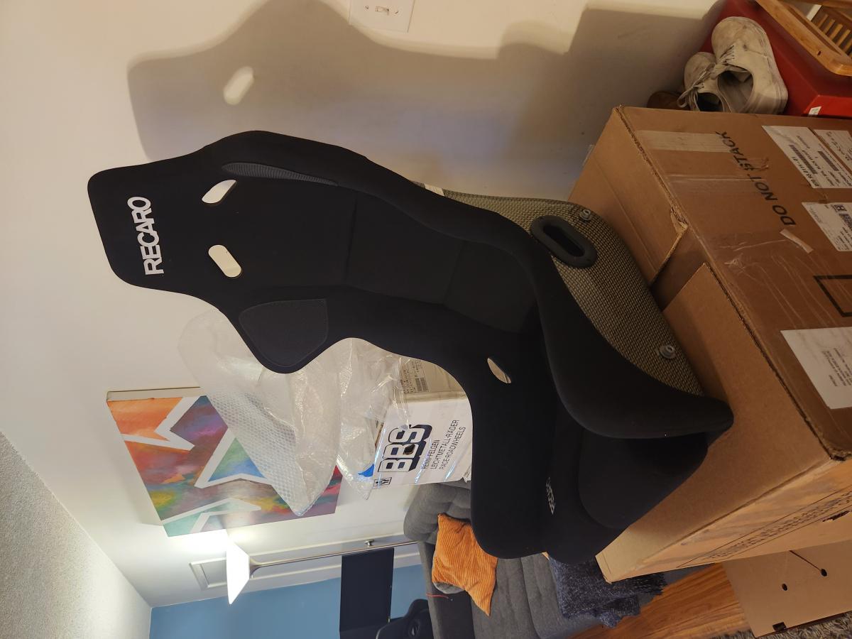

        And the thing I'm most excited for: recaro profi spa carbon kevlar courtesy of a forum member. That means one of my pole position ABEs is up for sale.
        Ill have some better pics of everything this week.
          Recaro SPAs are my grail. What a great find! Hope to see this car around, such a great build.
            thank you, very lucky to have found them on here. Shame that they are no longer available.

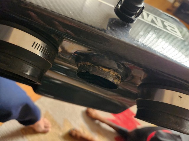

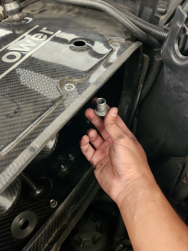

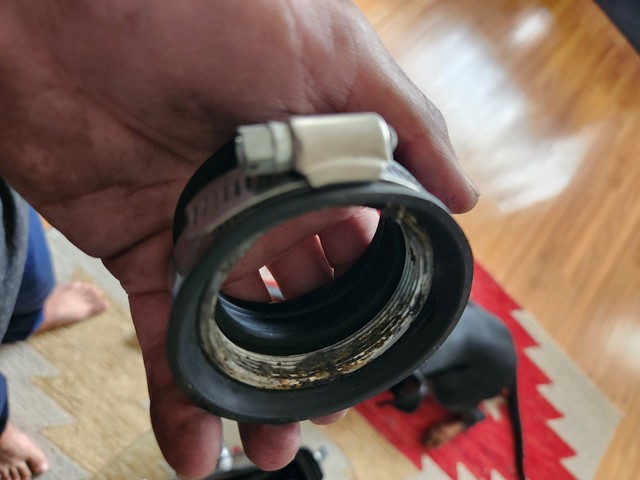

            So first off, I noticed that the fitting on my airbox was loose. Given it is post filter, I didn't want to risk it coming off and getting sucked in. I decided to take the airbox off to properly repair it with some commercial grade epoxy. Unfortunately, even though I was being as gentle as possible, the airbox wasn't having it. One of the threaded metal pieces that holds the trumpet decided it had enough. I am not surprised as this is airbox #58, one of Karbonius' earliest pieces. The heat and age seem to have had its way with it. I contacted them, and they said they will happily fix it for me free of charge, and I just have to cover shipping. Talk about excellent service! I am not even the original purchaser of the box.
            Click image for larger version  Name:	20221105-131725.jpg Views:	0 Size:	121.0 KB ID:	192006
            Click image for larger version  Name:	20221105-134431.jpg Views:	0 Size:	53.1 KB ID:	192007
            Click image for larger version  Name:	20221105-134415.jpg Views:	0 Size:	64.4 KB ID:	192008

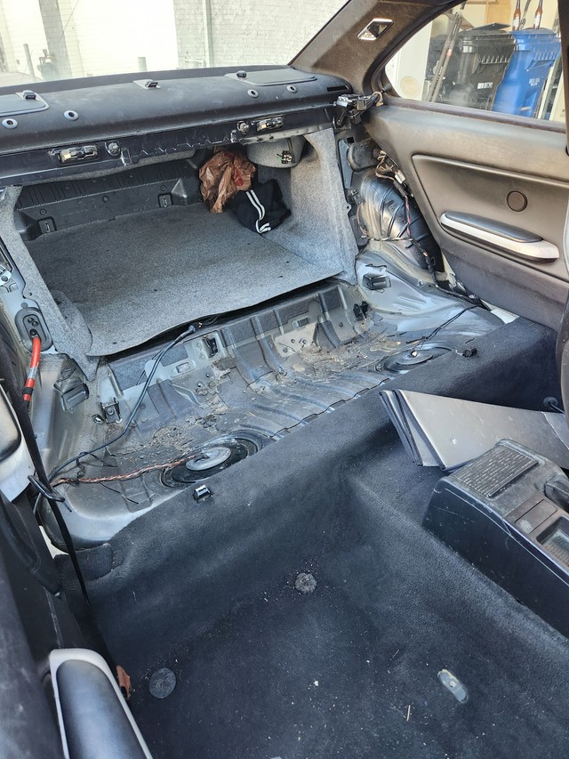

            I also did a bit more weight removal. Removed rear seats, rear seat belts, and some sound deadening material. I still have more material to remove from under the seats. After that is gone, I will likely create a rear seat delete panel after the car gets a half cage from TC Design. Goal is to keep the weight of the delete panel to a minimum, but perhaps add some sound deadening material to the back of it. The car came with poly diff mounts, and without the backseats the whine from the diff is pretty damn loud. Hoping the car will be as close to 3k as possible with the half cage. So far lightweight mods include seats, sunroof delete, lithium battery, wheels, windshield washer delete, back seat delete (+ belts), secondary air pump delete, tire pump and trunk tools removed, arm rest removed, and some small bits and pieces here and there. All this should equate to around 250+lbs gone. On the weight removal shortlist is a Karbonius trunk, lighter door panels, lightweight flywheel, and maybe a muffler (although I hate the sound of almost every muffler available). I'll also likely end up removing the headliner as well as the curtain airbags.

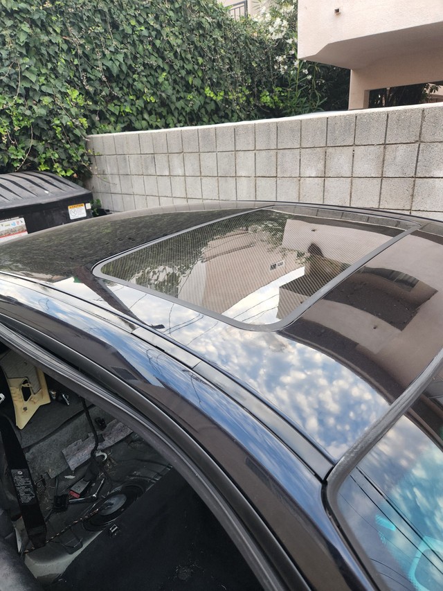

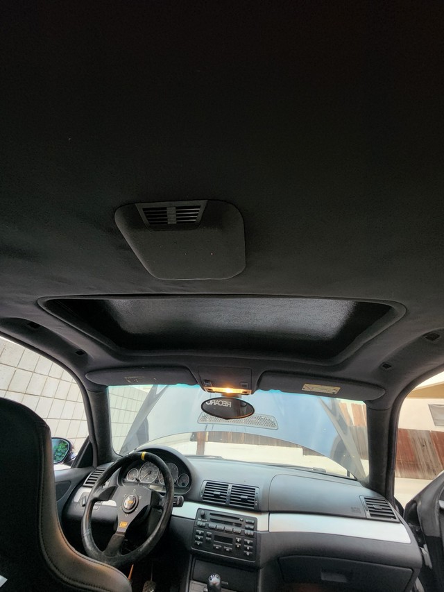

            Also thanks to a forum member, I picked up a sunroof delete panel. Although I really wanted to do a carbon roof, I couldn't justify spending 3k+ when I could achieve almost the same result for $400. And given that my car is carbon black, it doesn't stick out like a sore thumb either. If I am feeling spendy, I might still opt for the carbon roof whenever I get around to dropping the car off for the half cage.
            Click image for larger version  Name:	20220730-174840.jpg Views:	0 Size:	126.6 KB ID:	192010
            Click image for larger version  Name:	20220731-191649.jpg Views:	0 Size:	179.3 KB ID:	192011
            Click image for larger version  Name:	20220801-193245.jpg Views:	0 Size:	100.4 KB ID:	192012

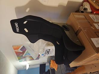

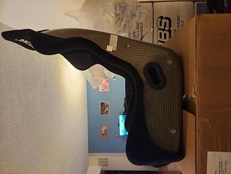

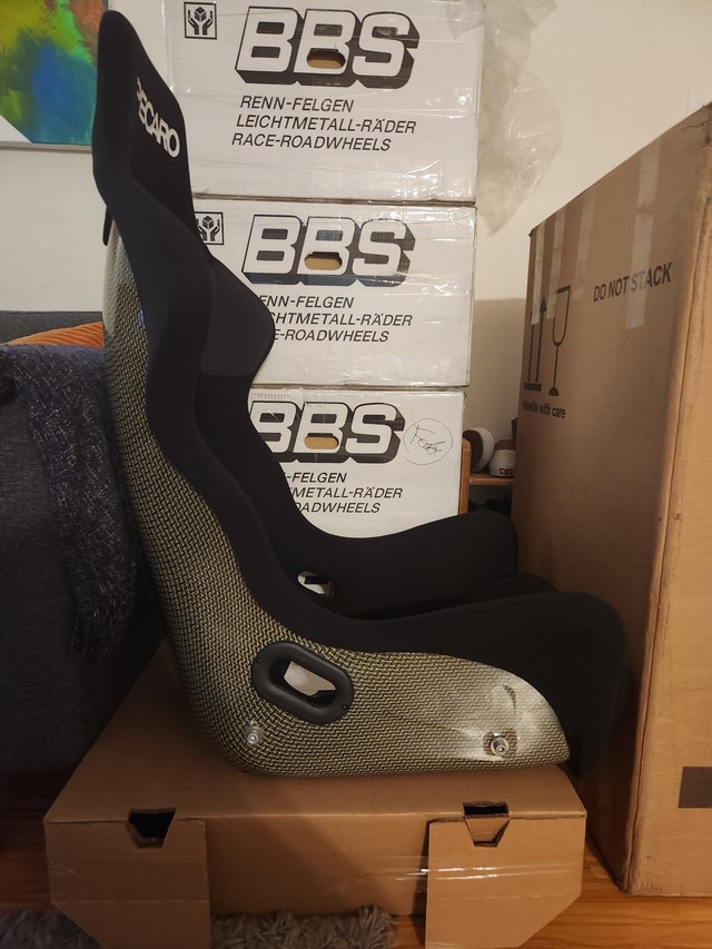

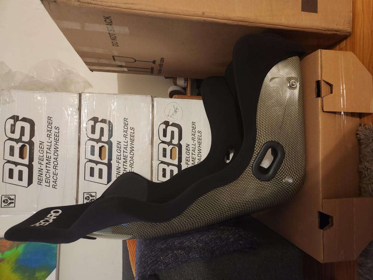

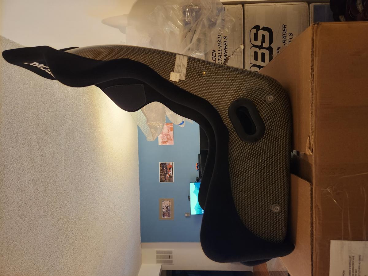

            And some more pics of the seats for good measure:
            Click image for larger version  Name:	20221017-195950.jpg Views:	0 Size:	93.3 KB ID:	192013
            Click image for larger version  Name:	20221017-191732.jpg Views:	0 Size:	115.7 KB ID:	192014
            Next to the fat boy ABE seat
            Click image for larger version  Name:	20221019-193904.jpg Views:	0 Size:	118.8 KB ID:	192015

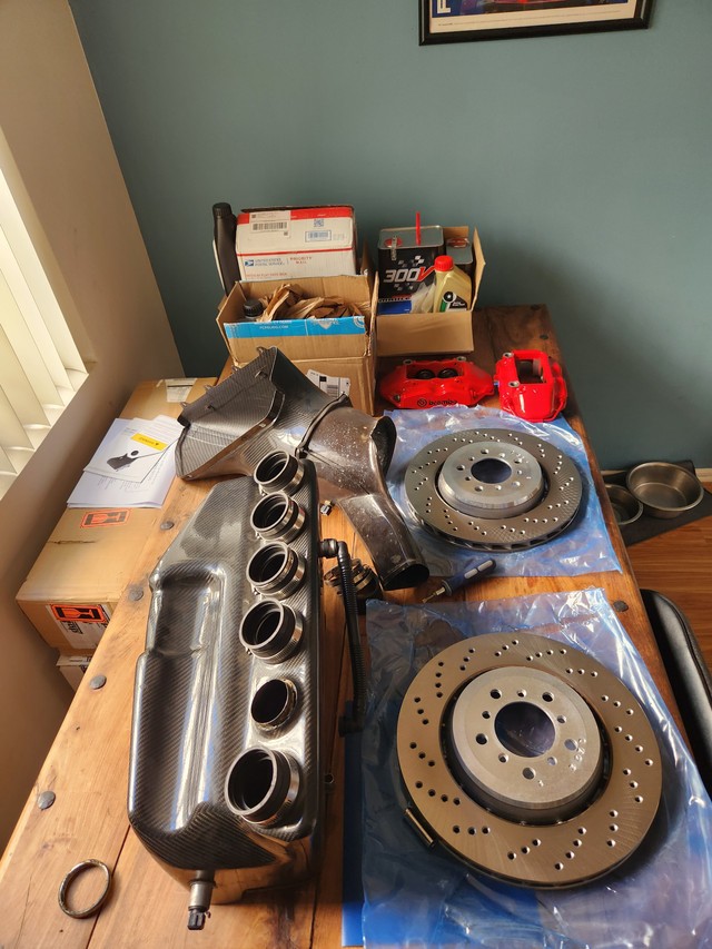

            And of course the ever growing pile of parts:
            Click image for larger version  Name:	20221105-150956.jpg Views:	0 Size:	136.7 KB ID:	192016

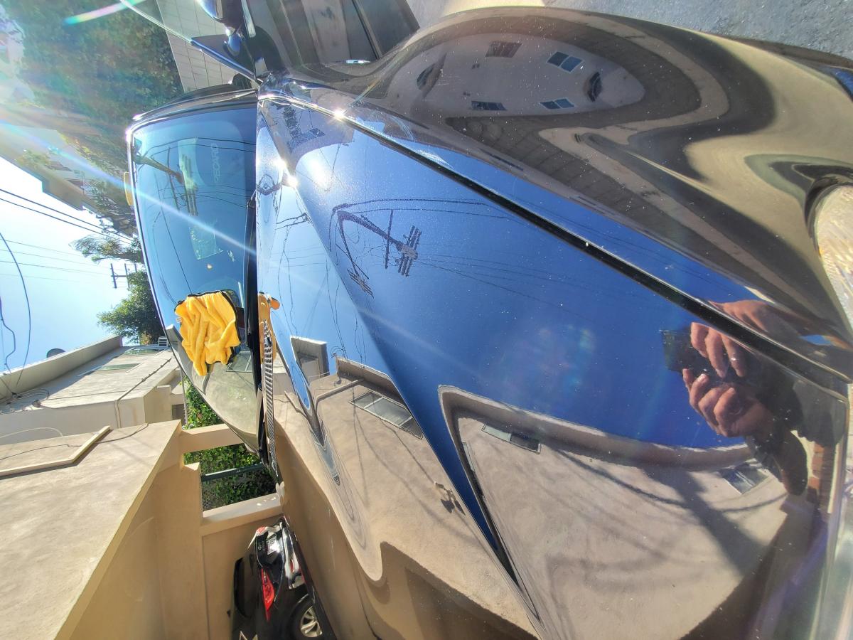

            Oh and I realized I haven't actually posted any good pics of the car post paint correction (that aren't sideways) so here you go. Although the car looks good, it is very much in rough shape overall IMO. There are quite a lot of things that need to be addressed, for example: extremely shoddy stereo wiring, luke cold AC,, sagging headliner, potentially failing starter or ignition switch, cracked quarter panel window weather stripping, misaligned bumper, and a bunch of other little things I'm probably forgetting. However, I have no doubt that all these items will get addressed soon.
            Click image for larger version  Name:	20220710-193234.jpg Views:	0 Size:	170.5 KB ID:	192018
            Click image for larger version  Name:	20220613-160015.jpg Views:	0 Size:	166.3 KB ID:	192019
