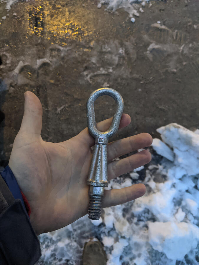

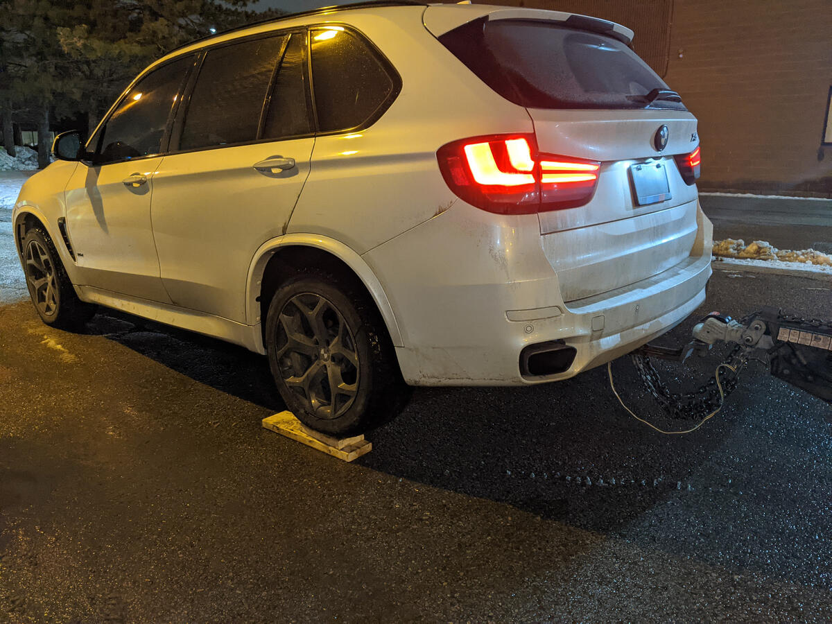

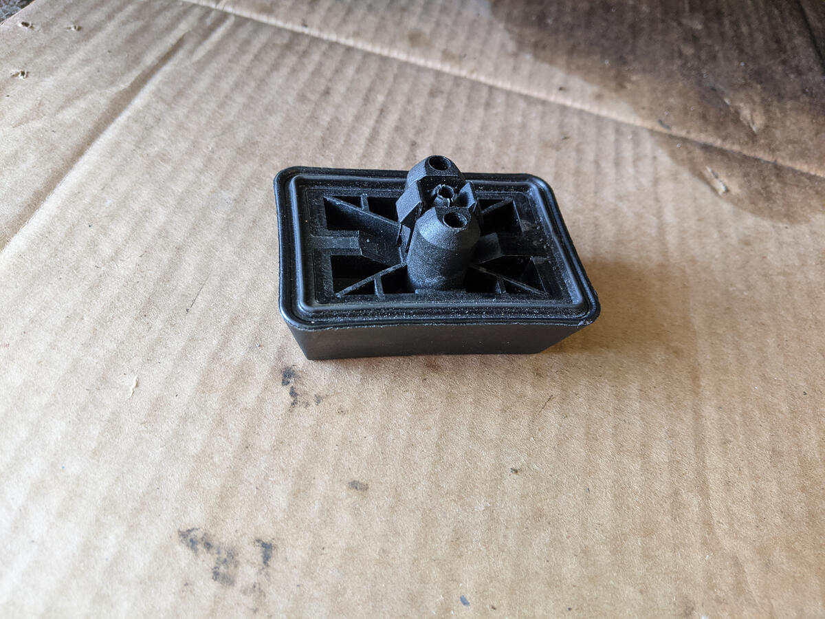

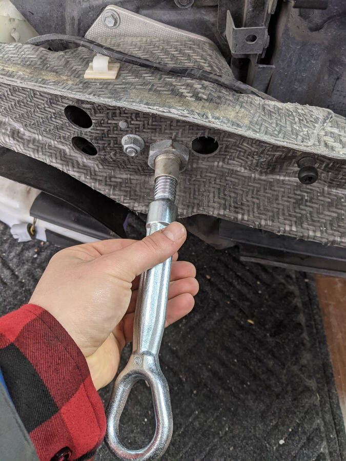

      One problem though. I don't have the E46 tow hook - because of course the PO didn't include it. So I go try my F15 hook
      Click image for larger version  Name:	PXL_20210222_184647919.jpg Views:	0 Size:	115.3 KB ID:	86811
      RIP.
      So now I'm sitting here. My car won't start. My tow hook doesn't fit. I'm not pushing it on - especially when its this low. You can't grab a subframe or anything substantial to tow from otherwise [Danke!]/ And this guy has some high profile clients coming in I need to get my car out. I've already extended my stay as he's let me keep the car there for quite some time. What the hell am I going to do?

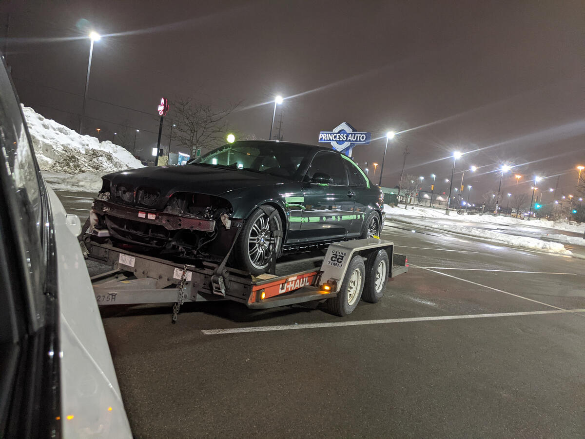

      What are the freaking odds? I just spent like 3 hours trying to track down a tow hook. I called BMW, I called some speed shops. Everyone has to order it in. As might be able to tell from the photo above, i'm pretty much out of daylight at this point. Back to Elevated we go to winch this thing onto the trailer.
      Click image for larger version  Name:	PXL_20210222_235436101.jpg Views:	0 Size:	196.0 KB ID:	86813

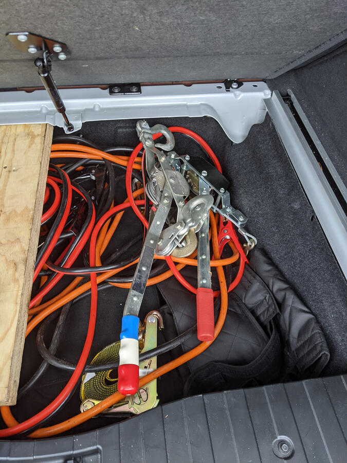

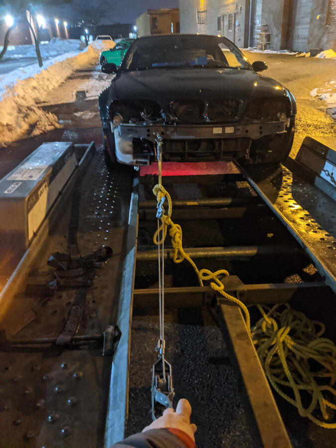

      With some wood to raise the rear of the X5, and some wood under the trailer ramps, we reduce the breakover angle to help this lowered ///M get onto the trailer. Last time I drove it on, I shaved a plastic mount off. We push the M3 out of the shop, line it up with the trailer and get to work:
      Click image for larger version  Name:	PXL_20210223_001610531.jpg Views:	0 Size:	107.4 KB ID:	86814
      After resetting the come-along 4 times, its finally on. Some blocks of wood under the front wheels to help the bumper bits clear the massive uhaul wheel stop at the front. taped up the holes so the interior doesn't fill with road grime during the tow (did you see how dirty the X5 was up there??)

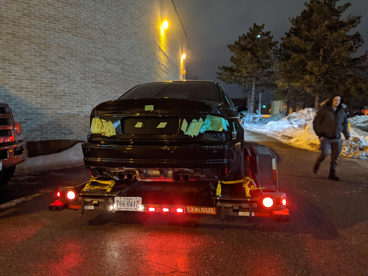

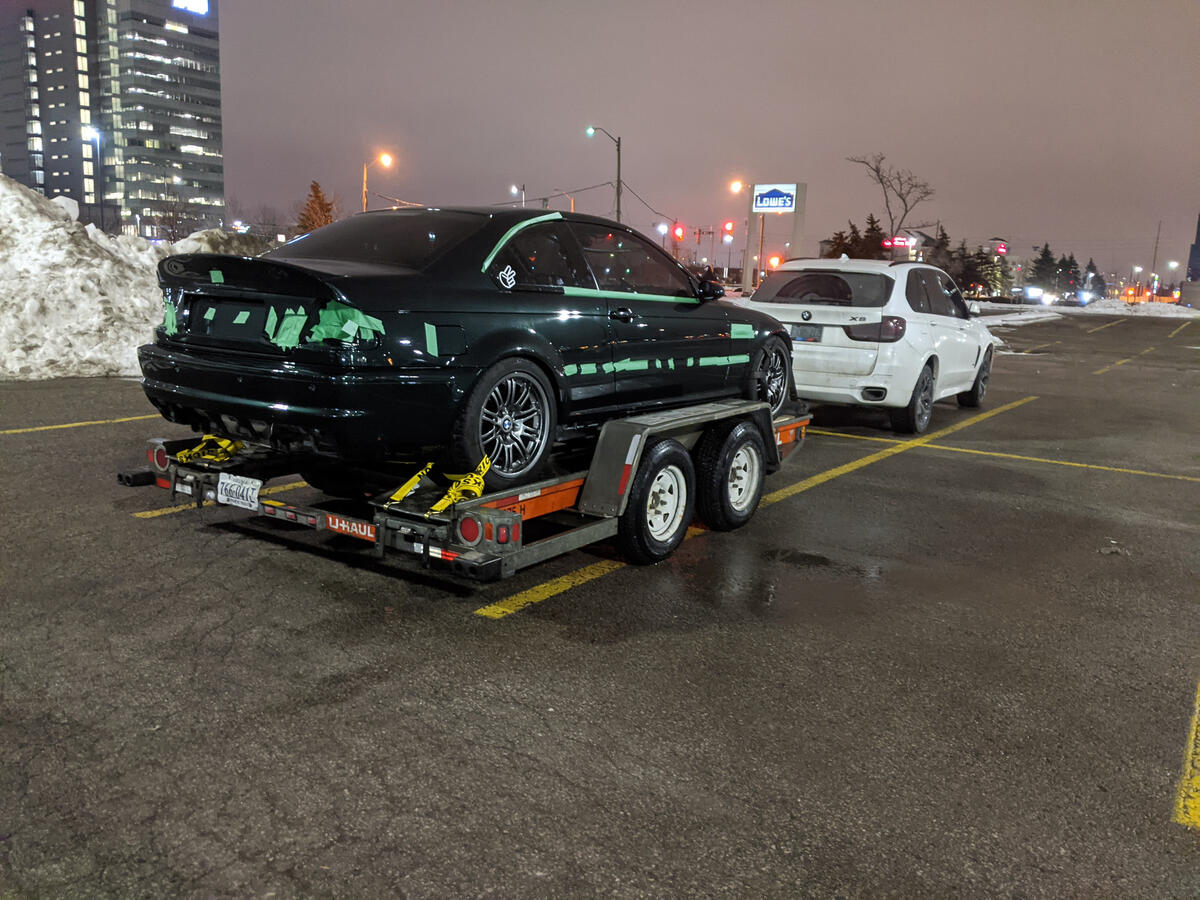

      At this point its like... 9:30pm? I still have a 4 hours drive + stops for the doggo + unloading the car + returning the trailer to go. I've been so stressed all day I haven't even eaten. So I set off on my way home, with a small detour to drop my friend who helped me off at home. 30 minutes into my trip, Elevated calls me to let me know that i've left the M3 keys at the shop. F&#$! But being the legend that he is, and understanding my situation, he drives them out to meet me 30 minutes away where I wait by my friends place. Took this opportunity to walk the doggo a bit, poor guys been cooped up most of the day and he's active.
      Click image for larger version  Name:	PXL_20210223_013936271.jpg Views:	0 Size:	178.8 KB ID:	86816
      Click image for larger version  Name:	PXL_20210223_042627923.jpg Views:	0 Size:	140.5 KB ID:	86817
      Once I've got the keys, I can finally start heading home. But now its like 10:30.. I end up making it home at 1:30am. keep in mind, i've been going since 6am and at this point i've eaten exactly 1 bagel.

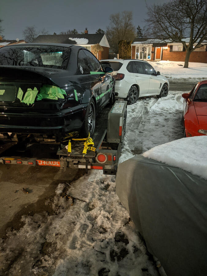

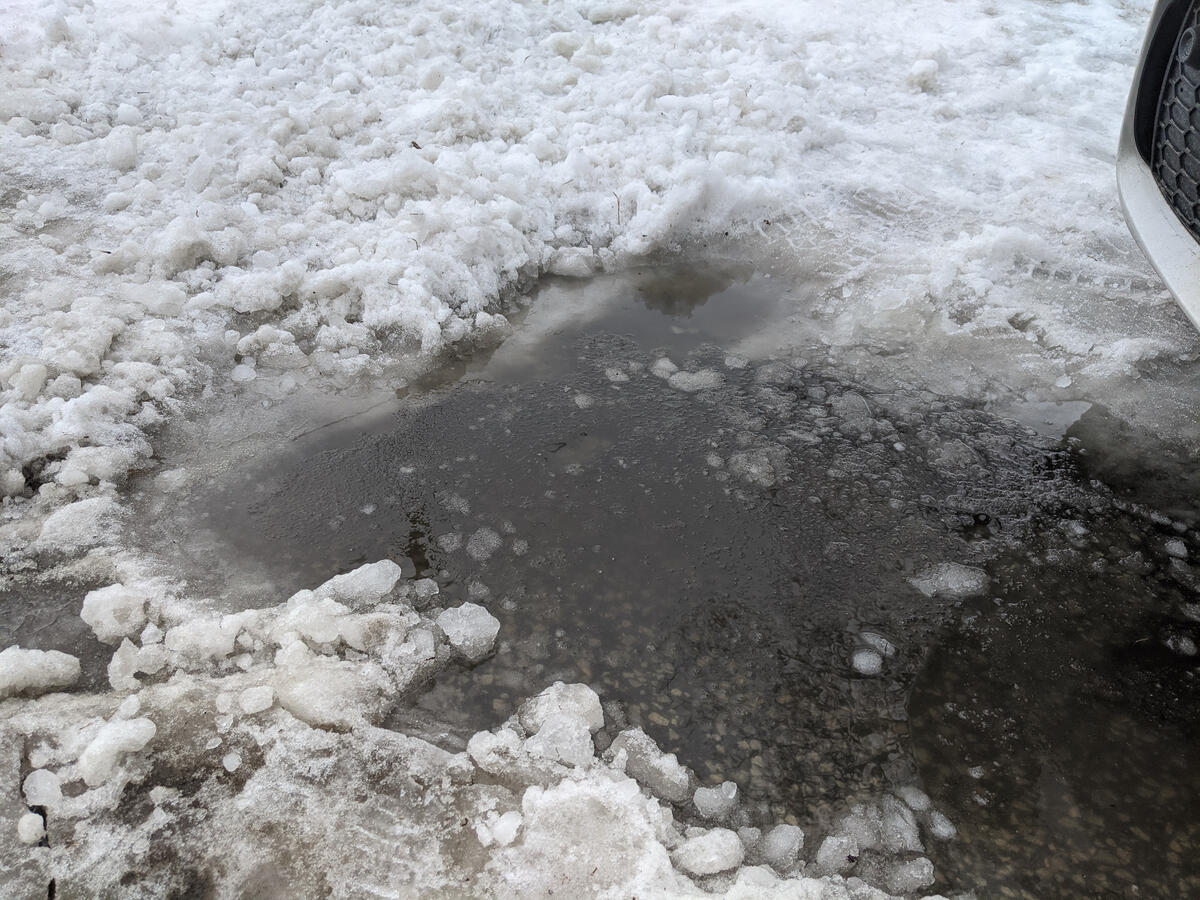

      Now, in typical fashion, nothing is easy. I get home and i'm trying to back the trailer into my driveway and i have some problems:
      1.) In my brilliance, I decided to park my Camaro on an angle cause I thought angled cars on my driveway looked cool. And it does. But I did not leave enough room for the width of a trailer - just a car. This meant I couldn't get my X5+ trailer completely onto my driveway
      2.) If it hadn't snowed (and the snow stayed) I could circumvent the Camaro using the grass a bit. But, of course I'm doing this in February and its one of the few times snow actually stays on the ground for a while where I live. We also recently got alot of snow.
      3.) My driveway is on a decline which is counter-productive for unloading a lowered car off these trailers (worse for breakover angle).
      4.) The snowplows have left me a generous helping of canada's finest in the form of a slushy river at the base of my driveway.
      Click image for larger version  Name:	PXL_20210223_064358875.NIGHT.jpg Views:	0 Size:	108.1 KB ID:	86818
      Click image for larger version  Name:	PXL_20210223_154946235.jpg Views:	0 Size:	207.7 KB ID:	86819
      I have to wait until tomorrow morning for a buddy to come help me push this thing off the trailer. without it starting, I can't unload it on the street (like I would have liked to) - and even if it started, that slush river I'll have to fjord will be an obstacle. I can't push and steer it off the trailer myself. So much for returning the trailer "on time".

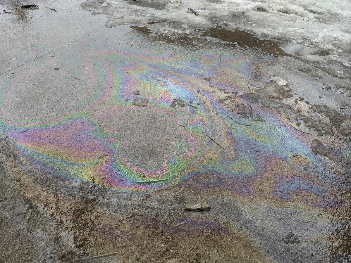

      F&#% me man. I'm thinking I cut a fuel line, or worse, cracked the oil pan or something. At this point i'm at my wits end with this damn uhaul trailer. They are so woefully inadequate for sports cars. I may have been a bit rude on the return tow. 😶
      Fortunately, after I got the car in the air and crawled under - it seems like it PS fluid coming from the top of the reservoir. My guess is the manual steering action pumped some fluid out.

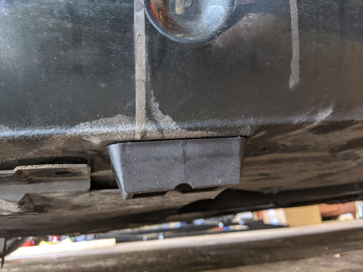

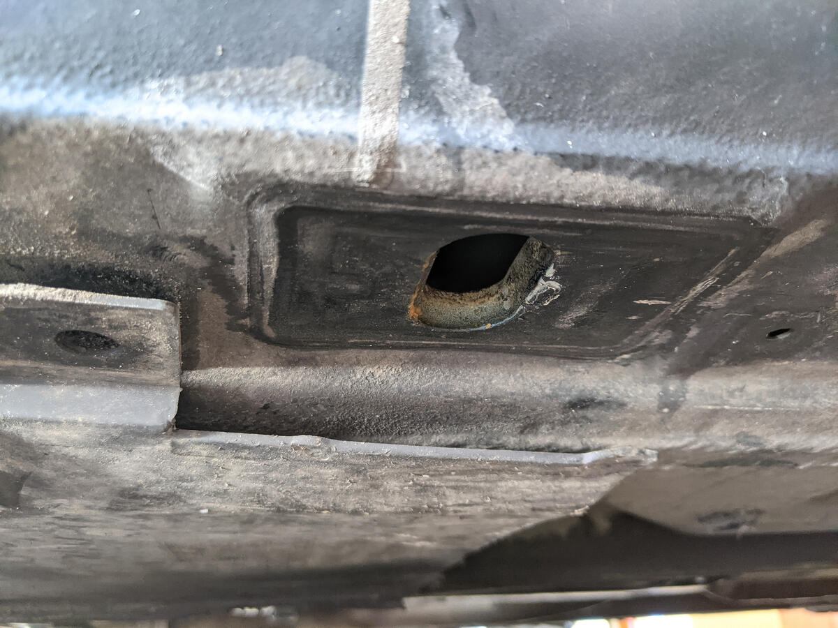

      Speaking of U-Haul trailers - on the way up I mentioned I sheared off a lift point. Fortunately, when I had just bought the BMW I was researching the aftermarket. I bought one of these lift pads thinking you needed to buy them separately to properly lift your BMW or something. I didn't realize they were factory at the time LOL. I've learned alot since them days. This had to be taken care of in order to lift the car to check out the leak.
      Click image for larger version  Name:	PXL_20210223_165456529.jpg Views:	0 Size:	154.3 KB ID:	86821
      Click image for larger version  Name:	PXL_20210223_165505401.jpg Views:	0 Size:	172.7 KB ID:	86822
      Click image for larger version  Name:	PXL_20210223_165532816.jpg Views:	0 Size:	162.4 KB ID:	86823

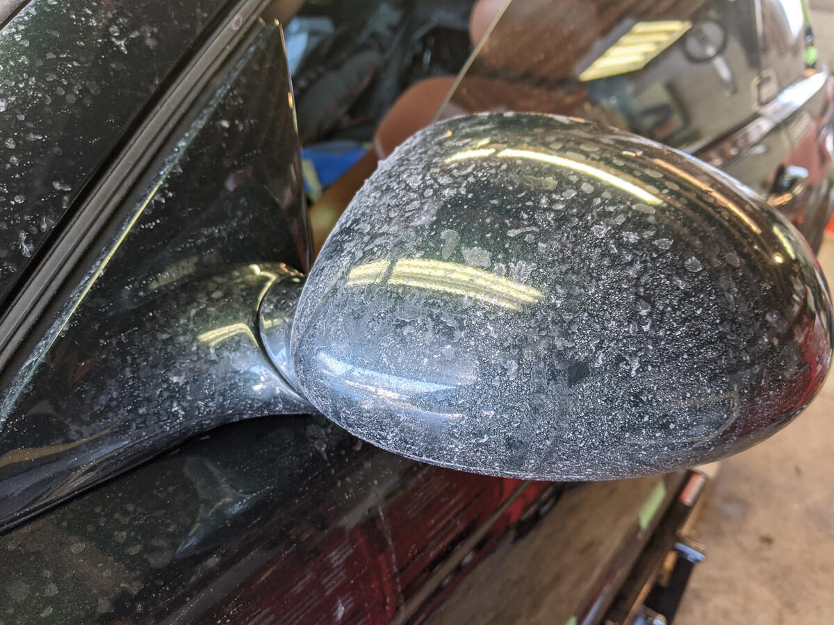

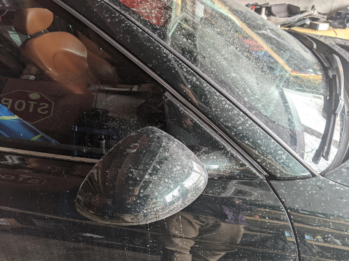

      After towing the car down during this time of year, it gives you a good visual as to why I've PPF'd the car. Not that I plan to drive it in the winter, but the same "patterns" happen in the summer they just don't leave salty trails behind.
      Click image for larger version  Name:	PXL_20210223_154103889.jpg Views:	0 Size:	222.6 KB ID:	86824
      Click image for larger version  Name:	PXL_20210223_171213274.jpg Views:	0 Size:	278.4 KB ID:	86825
      Click image for larger version  Name:	PXL_20210223_171219469.jpg Views:	0 Size:	213.8 KB ID:	86826
      Now I can look at pictures like this stress free, knowing my fresh paint is completely fine. I probably would have got stone chips already towing it home otherwise.

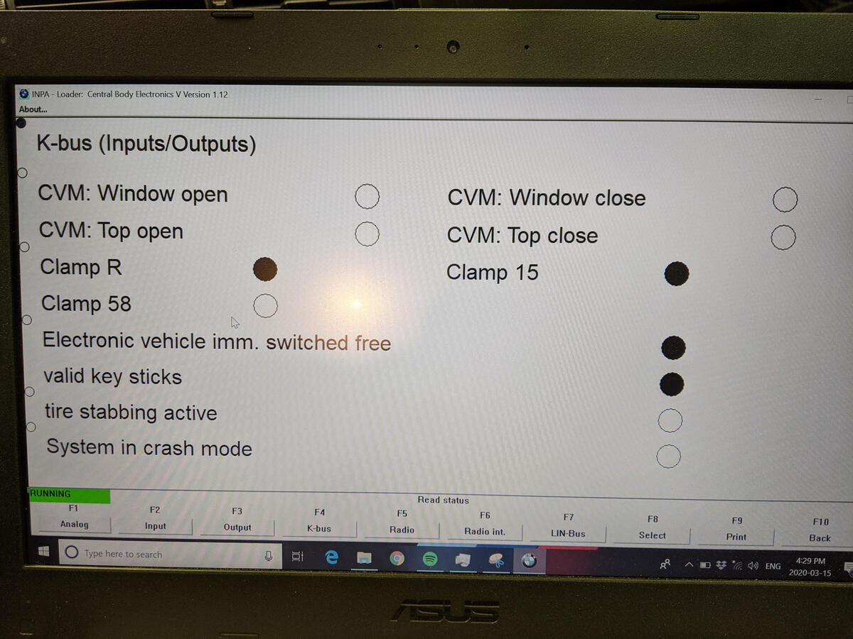

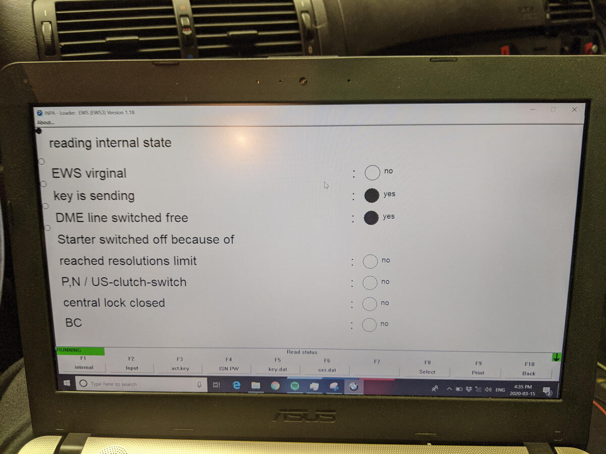

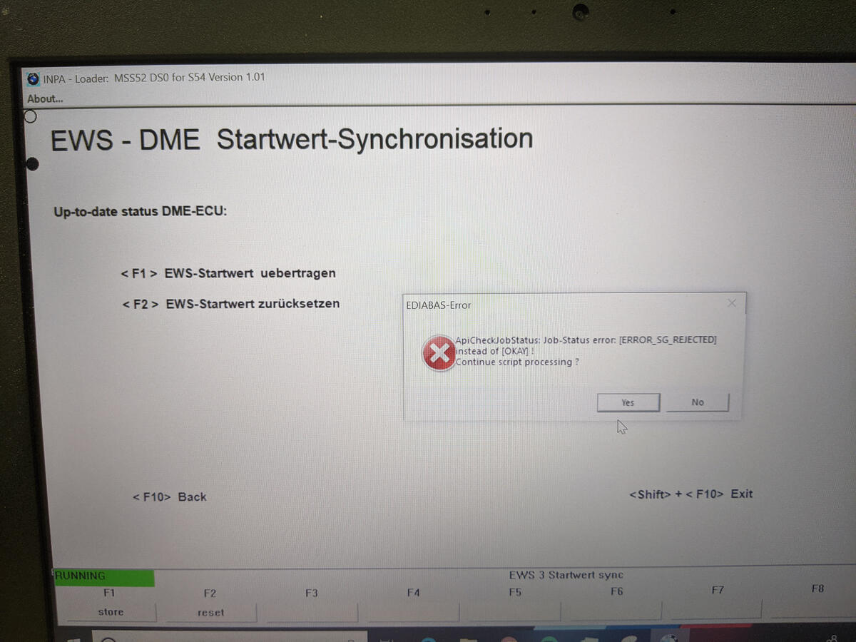

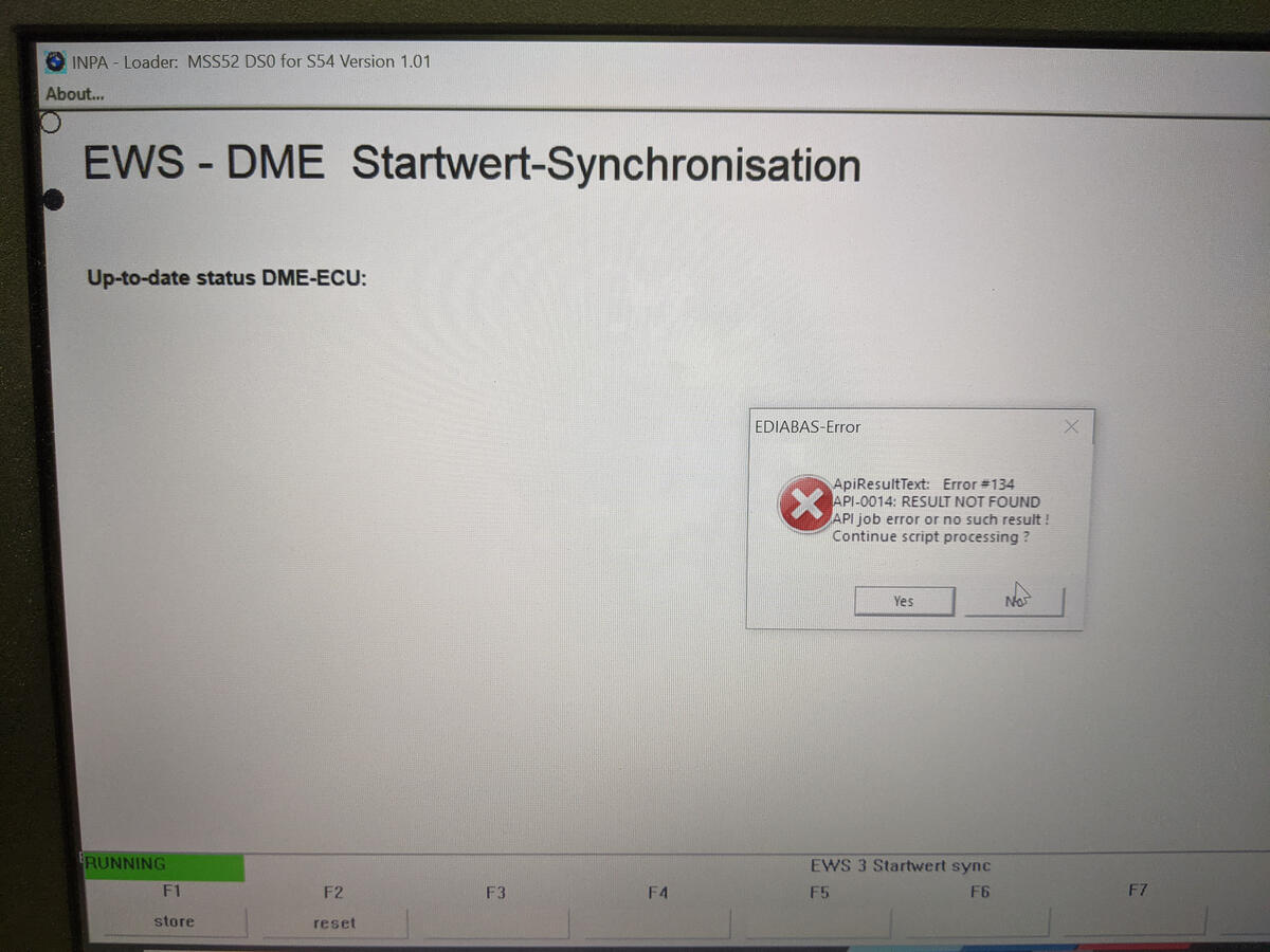

          I've left the car on the charger with the key in the ignition for 2 days now. The car still won't start. I connected INPA to verify the key was being read. I also tried re-initializing the key but that didn't work. Even through INPA I can see that the remote on the key fob isn't transmitting. The thing is i'm not sure yet whether the key battery is just completely toasted, or whether the functions have been coded out. But even if they were coded out, I would expect INPA / computers to register the signal and simply chose to do nothing about it. Remember, PO installed a aftermarket security system and the key fob appeared disabled when In got it.
          Here are some INPA Readings:

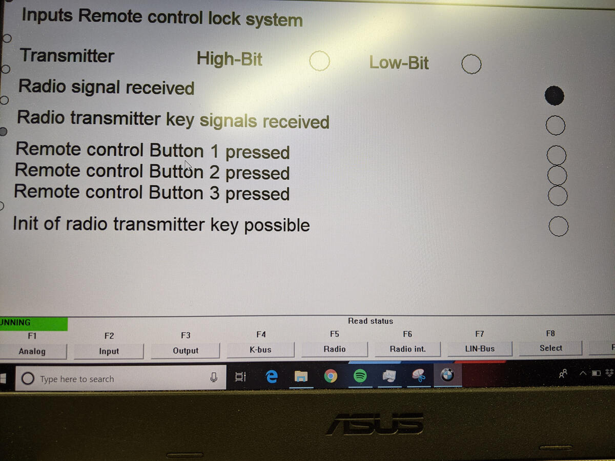

          Below, I Think "Radio Signal Received" illuminates when you press a button. And below it will tell you which is registered. But i find it interesting that "initialization of radio transmitter key possible" it not illuminated.

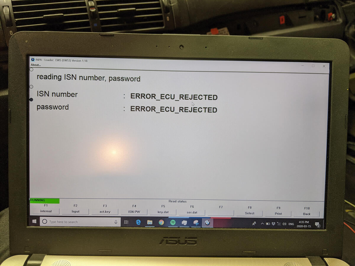

          But here is the fun one:
          It seems like the EWS isn't communicating the ISN with the DME. When I try to sync the rolling codes - I get error messages. I've seen guys who've had problems here when the signal wire from EWS->DME breaks or gets corroded. Mine seems ok but has also bee subject to the PO's molestation.
          For anyone who's interested, heres a great read on how EWS works in older BMWs:
          I've seen people who have had a cut or pinched wire throwing a similar code. I will check the connection with a multimeter later - there are solder joints along it from the PO's wiring job. Does anyone have experience with this error though?

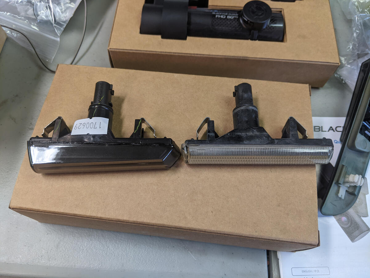

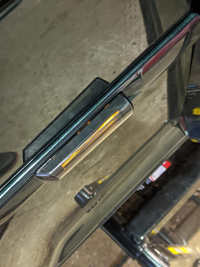

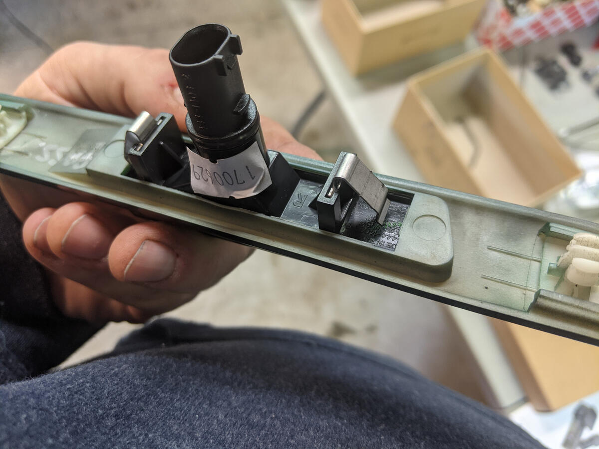

            quick post about side markers.

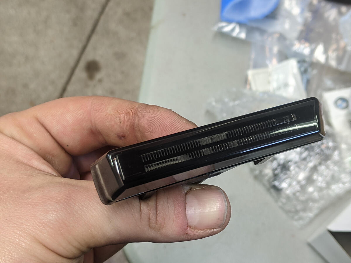

            I got a set of DEPO side markers, the original ones were looking a bit old and dated. I liked the smoked look and LED style.
            For anyone who hasn't installed these - They. Are. Fat. I'm not even sure why. But they are and I'm not a fan of it.. :

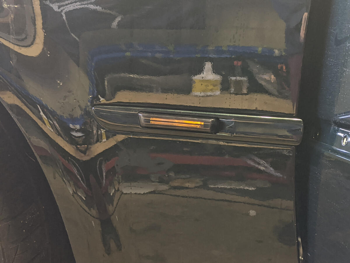

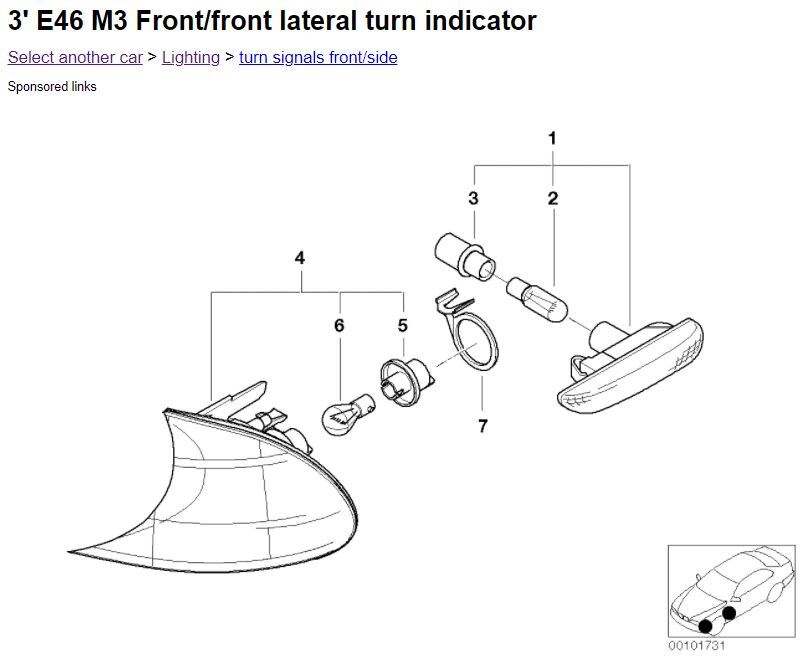

            Also, Somebody please comment. I put the Original one back because this just can't be how its done... Am I missing a piece or something????
            It does kind of wedge itself in there in place. but there is no way this is how its intended to work. I thought there might be an insert there so I check RealOEM and only saw this 😅
            I might craft something myself, maybe epoxy in a little plate or something so it clips in completely if this doesn't get resolved.
            In the meantime, they look like this:

                Alright, I'm dead in the water at the moment. I'll be posting this in other areas/forums to try and resolve it but at the moment I'm stumped. In the off-chance someone reading this has the solution.
                The car still won't start. It cranks fine but just won't GO.
                Here is a list of where I'm at.
                - Tried resetting the computers by letting the car go to sleep, disconnecting, and shorting the leads.
                - Tried charging the key for 2 days on a trickle charge
                - With INPA I've verified EWS is satisfied, key is read.
                - Can smell fuel out the tailpiped - but for good measure I checked fuel pressure. No guage but the fuel squirts out. Although, the pump doesn't try to build pressure up again once I relieve it?
                - Engine fuses and relays have been checked.
                - DME and EWS disassembled to look for damage. none found.
                - Continuity between DME and EWS verified. Pins inspected for corrosion. none found.
                For context, the car ran fine when parked. No rough idle, no stutter, nothing. Only hard starting due to super low battery but did fine with a jump (yes, i've tried that too and measured voltage while cranking and used a load tester).
                The biggest clue at the moment is that the DME and EWS Don't appear to be communicating the ISN. And, if I attempt to sync the rolling codes I get errors. I thought this would be connection between EWS and DME but perhaps it wasn't. OR I've checked the wrong lead (also possible, OP has been up to some no good wiring down there).
                I'm nose deep in my Bentley manual at the moment trying to learn what all the pinouts do for the DME and EWS.
