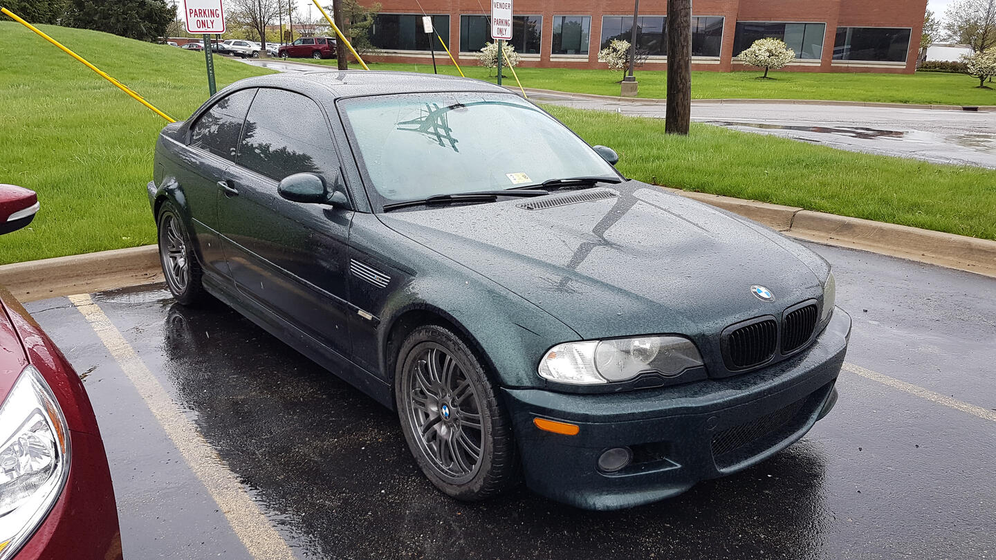

    Here is the car as it showed up to me. a 2003 OG/Cinnamon 6spd coupe with ~95k miles.

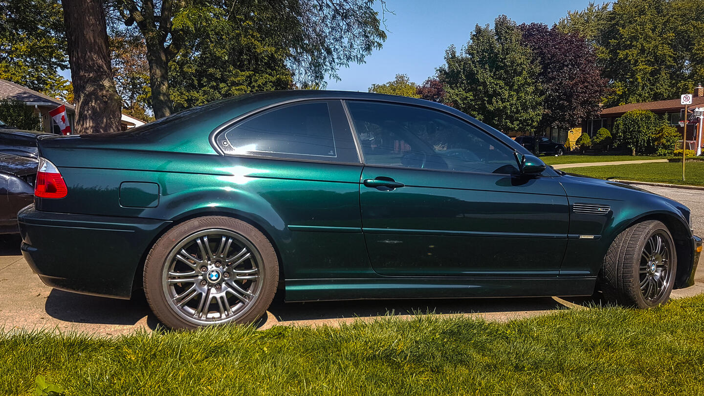

    Here is the M3 home in Canada. with the Z/28 in the background.

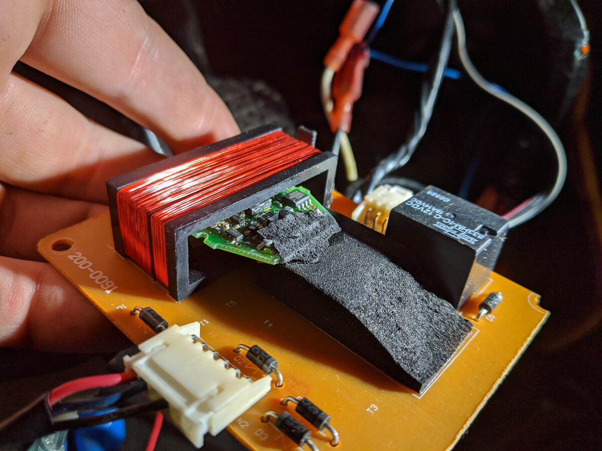

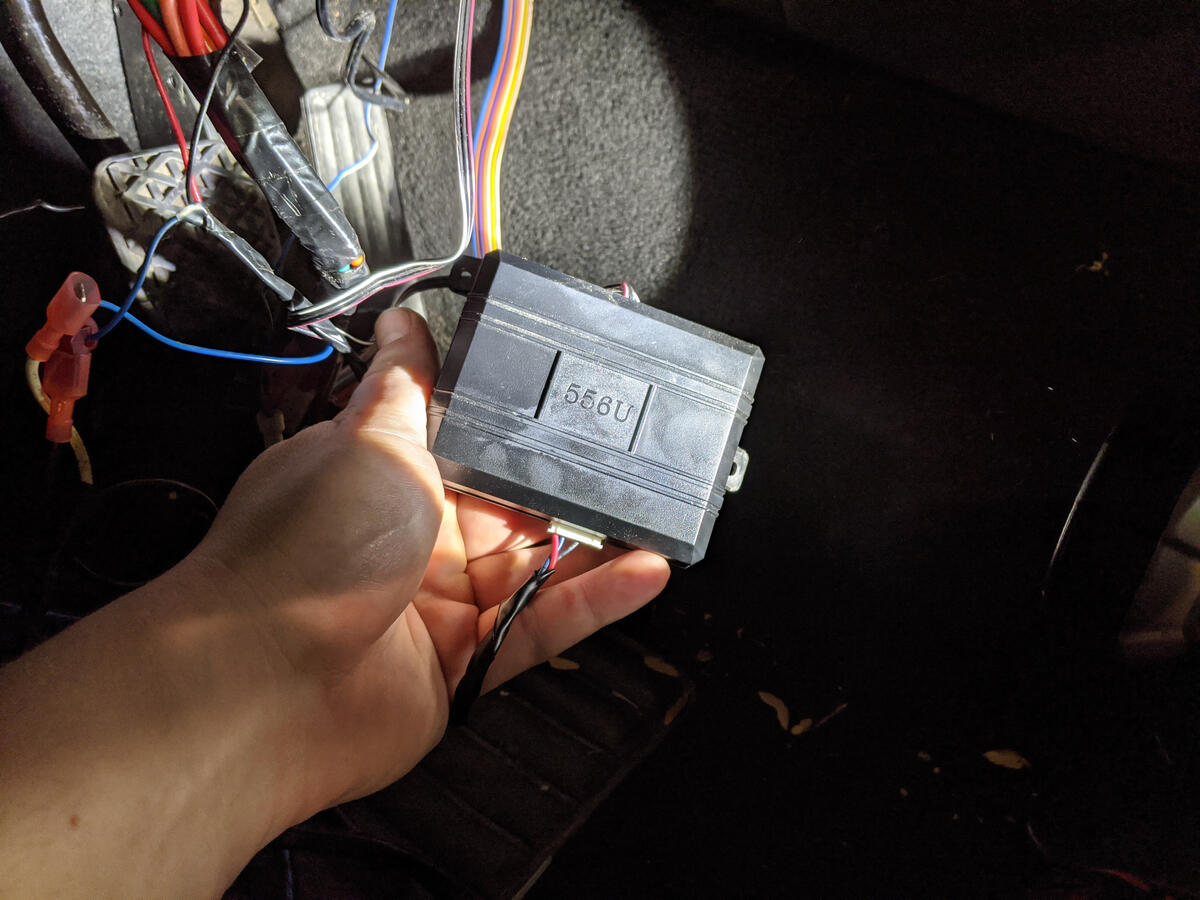

    You see - the seller failed to disclose that this car has a remote starter installed. Moreover, the clutch lockout and EWS have been bypassed. ... So, one day, while working on a friends car we were rolling around on the ground when the Lock+Unlock combo on the keys in my pocket were pressed and the car started while in gear. The more unfortunate part is that it drove forward into the car we were working on, while it was on jackstands and knocked it off. I got out but my friend got badly injured. This is where the name Bad Om3n begins. Without getting into details - the car was effectively off-limits for the next 3 years for legal reasons. My friend has made a miraculous recovery given the context in the meantime. you may have noticed the damage to the hood/grilles in the picture.
    Over this time, I wasn't allowed to work on the M3. I wasn't allowed to sell the M3. I wasn't allowed to do anything and so I researched and researched and researched. I learned about INPA and NCS. I learned how to perform the SMG conversion and went over his work. I learned about the M3's weak points and how to address them. What parts were available. I looked at all of your builds for inspiration while I hoarded my money and got deals on parts where I could. Here's the thing; this M3 was supposed to be what I enjoyed while I worked on the Camaro. Now the M3 has become its own full blown project.

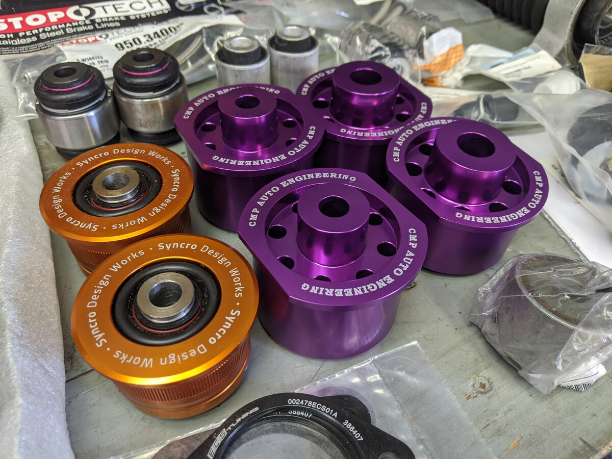

    At this point, I've resolved to re-enforce the rear subframe. And, since this thing is so buried, it has spun off a bunch of other small mods and upgrades which sent me down the rabbit hole as you'll see. But then again, I suppose thats all relative. Some of your builds are unreal.

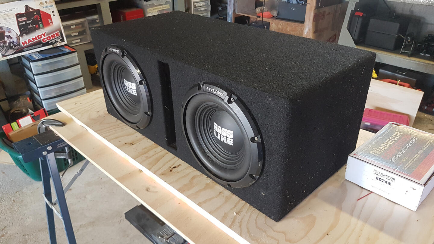

      Lets start at the trunk. You see, the PO, or someone before him, was trying to build this into a "show car". so the trunk was a custom mess of MDF and "suede". this had to go - unfortunately he also glued directly to the metal beneath AND I had no oem carpeting for the trunk. the twin 12" subs had to go too.
      I can't find any old pics of the MDF pieces but.. they weren't really like.. attached to anything while they were in there.

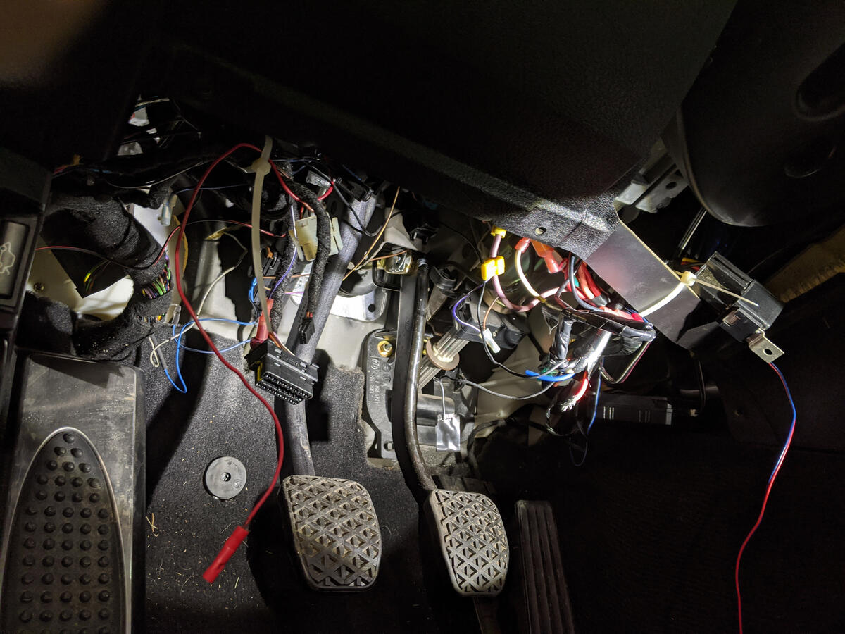

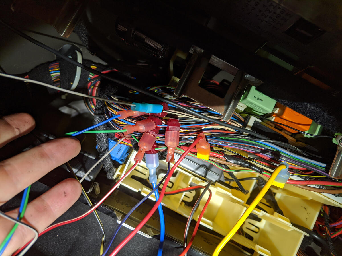

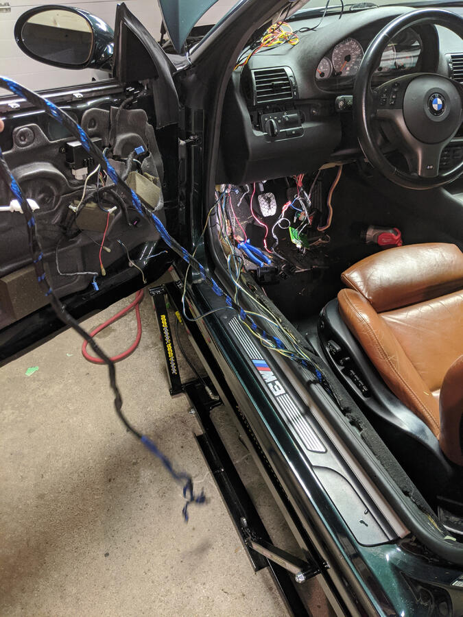

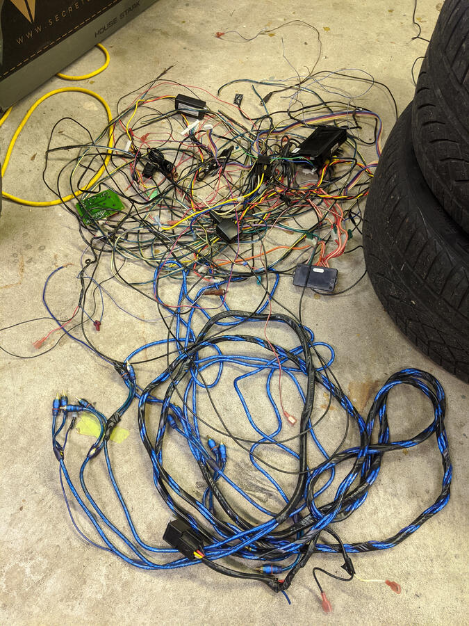

      Then I moved onto removing all the wiring that this guy had put in. Between rewiring the trans, rewiring the speakers, and wiring in this aftermarket security / auto start thing it was a mess.
      Here is the mess under the steering column. In fact, my foot nudged one of these and the brakes went into failsafe / full-on mode. Cop wasn't too thrilled about this.
      This is what the EWS bypass looks like. The guts of the second key are dismantled and put into this box so that the car can satisfy EWS during a remote-start. "Sekurity"

      Here are most of the wires (some have already been removed and tossed before):
      Although it felt quite nice to have removed all this cancer from the car and to see it in a pile here. I still have to get the key remote working again, I haven't attacked that yet. Not sure if its going to throw any other electrical errors or codes yet but we'll see. At least this is all out and the car still starts and drives normally. But I also have some loose wires so that's pretty suspect.

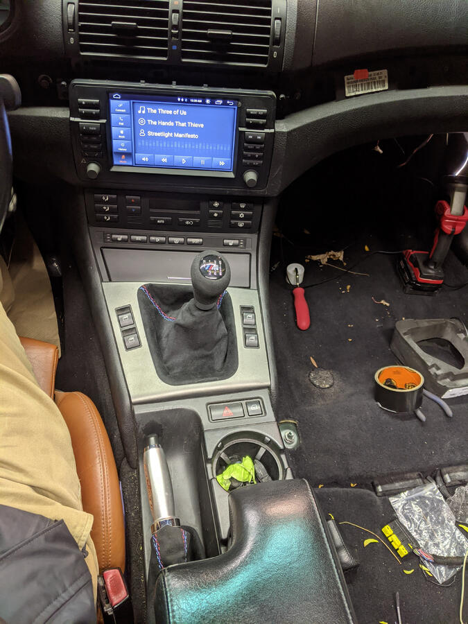

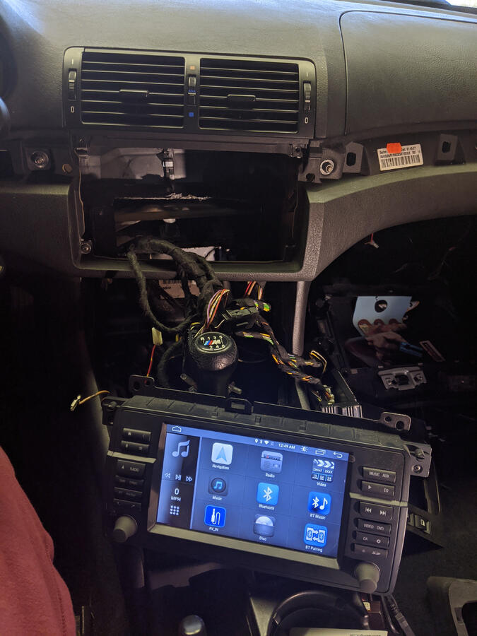

          The center console of this car was a mess. The Radio was gone, The bezel/console trim was cracked. the storage door thing was shot and the tray wouldn't stay in the console. Window switches were broken. The guy had cut up the HVAC box for his double din setup or whatever.

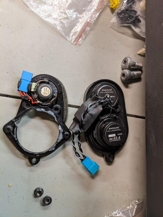

          I ended up picking an AVIN Avant 3 head unit with the backup camera option to replace the dead unit. Picked up the correct console trim with the button relocation for a double-din and new storage door. "Repaired" the HAVAC box.

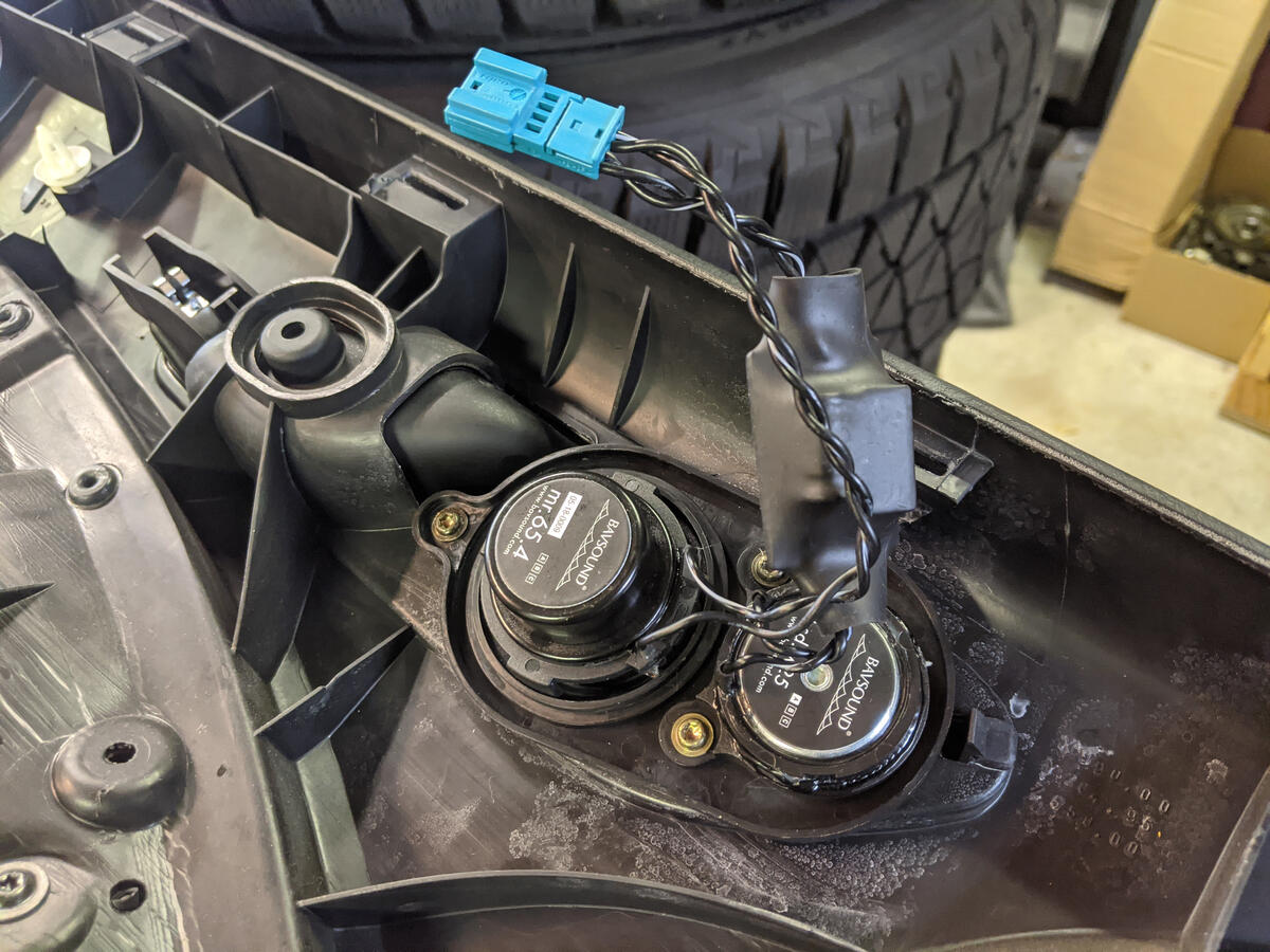

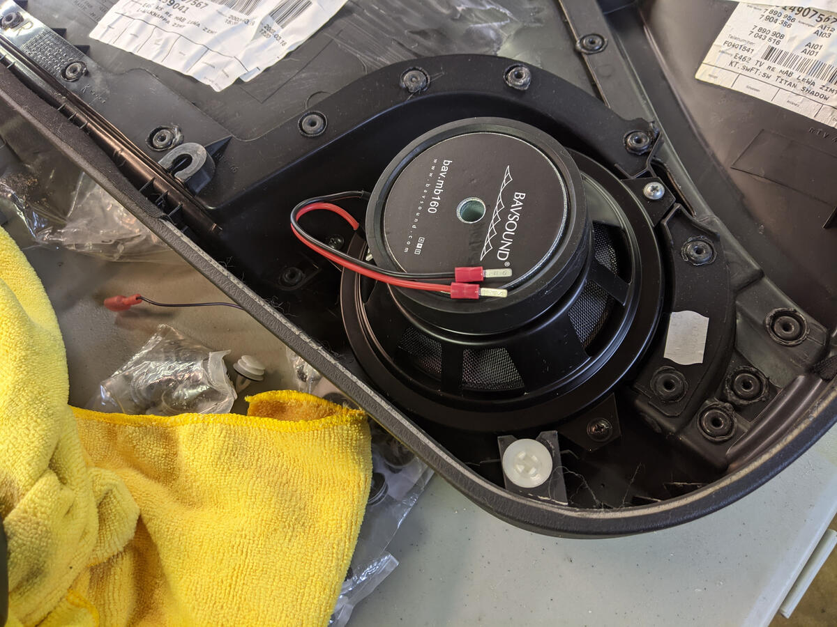

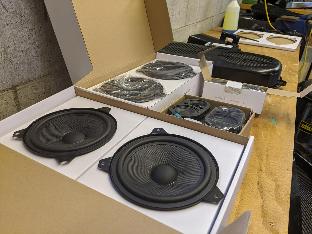

          Decided to go with bavsound speaker upgrades. A good middle ground for an improvement without diving into the deep end with a custom setup. You can get better sound yes, but keep the goal in mind - this is a *clean* solution. You'll also see the ebay sub box and amp I picked up since they were MIA.
          Test run of the Avant 3 unit to make sure I've got my connection right. After installing one of these AVIN units on an E38 WITH the DSP and the Resler iBus app this went pretty smoothly. However, the E38 was running an Avant 4 and after using that for a bit I'm going to upgrade this unit. The step up in software is rather dramatic.

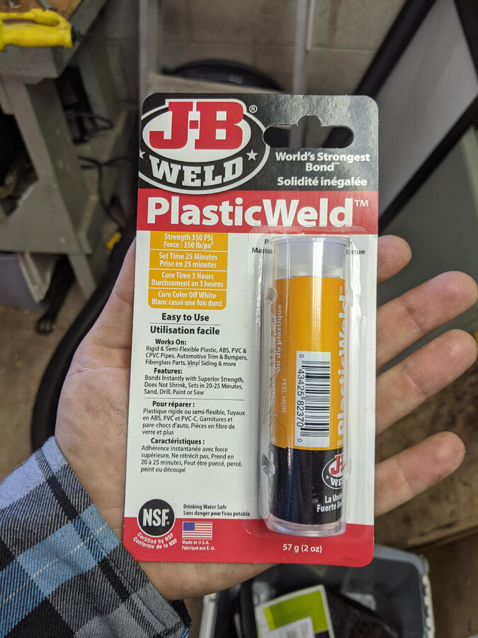

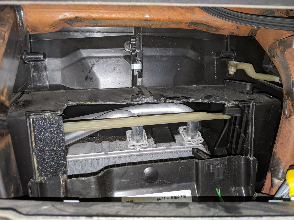

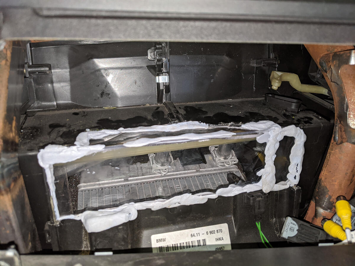

          To "repair" the hvac box, I used JB Plastic Weld, and some Lexan I had laying around. Its not.. the prettiest. but the original pieces were all hacked up and I didn't have any black plastic. At lease you don't see it!

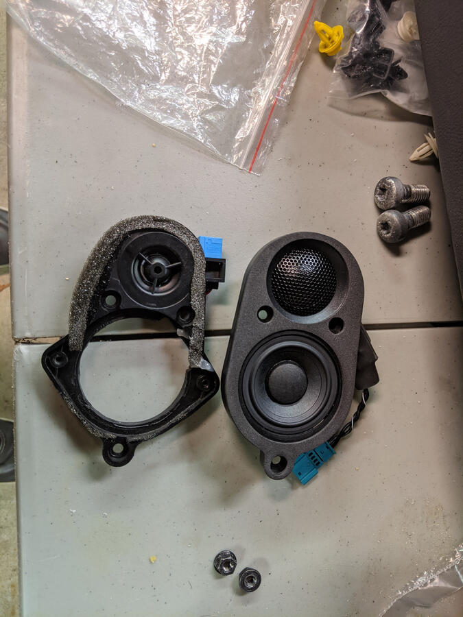

          I had to order a new set of HK Rear speakers. They come attached to this plastic bracket that the grilles screw into. You have to separate the bracket and then glue the BavSound speakers in. The PO had done this with some cheap MTX speakers and housings so I needed new ones. These are them, and honestly they're in solid shape. I don't even know if its worth it but i'm still gonna swap them.

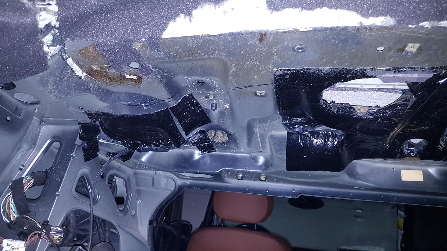

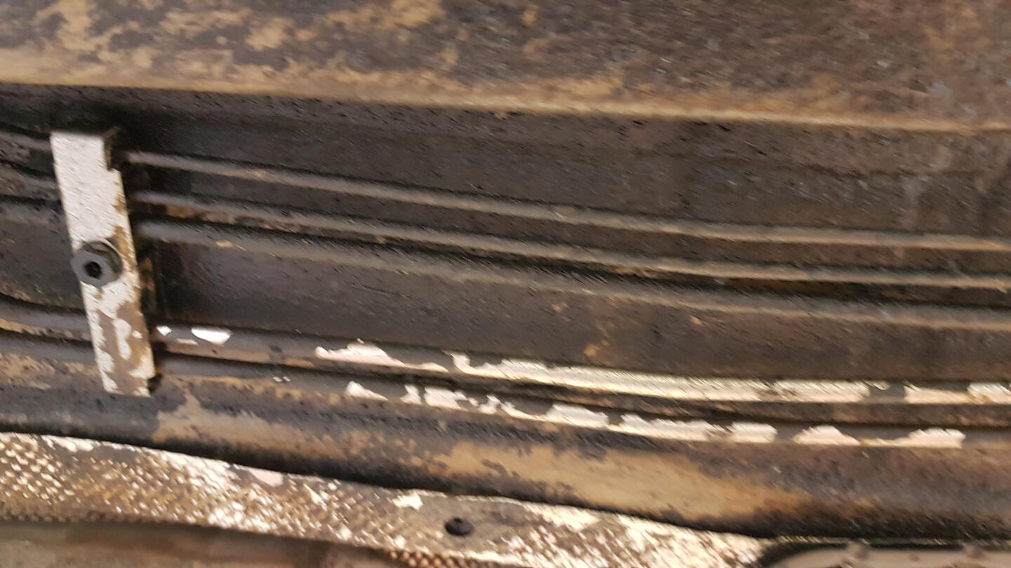

                          At this point I've got the interior out. I was fortunate enough to find someone who was turning his E46 into a track car and basically sold me all of the interior from the beltline up. This way I don't have to deal with the PO's suede covered mess.

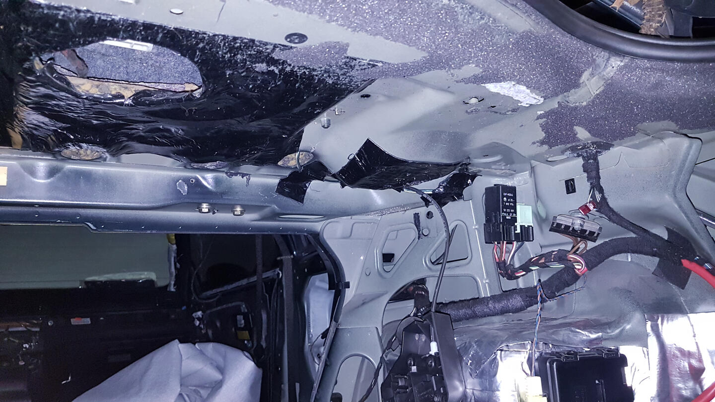

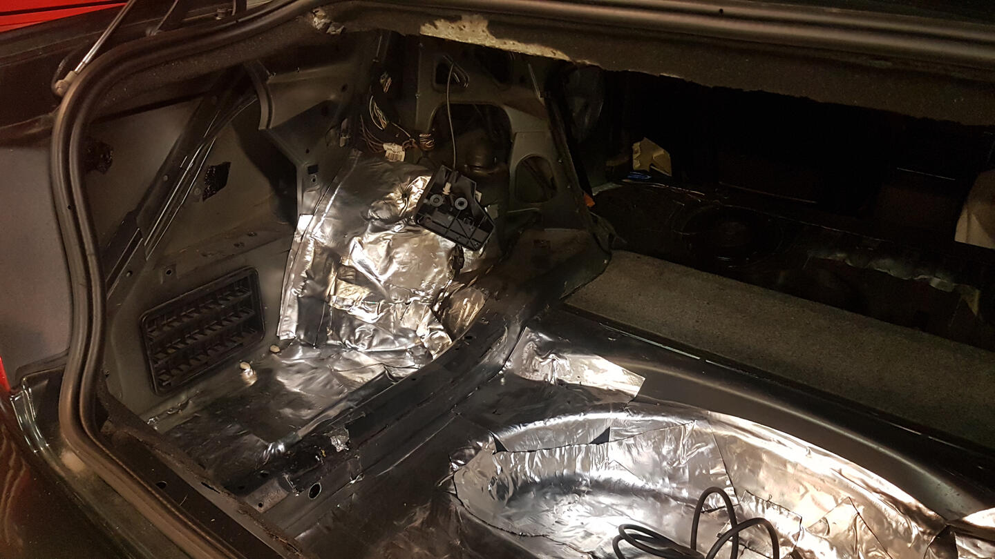

                          The PO also put a bunch of sound damping everywhere in the trunk, pulling that off was a challenge - but I didn't do it all at once. I just kind of wrestled with a piece at a time with each trip out to the Garage.
                          Click image for larger version  Name:	20181031_190008.jpg Views:	0 Size:	206.1 KB ID:	85869
                          Click image for larger version  Name:	20181031_190018.jpg Views:	0 Size:	201.7 KB ID:	85870
                          Click image for larger version  Name:	20181024_191413.jpg Views:	0 Size:	167.5 KB ID:	85871
                          Generally, quite a pain. But we'll get through it with some patience.

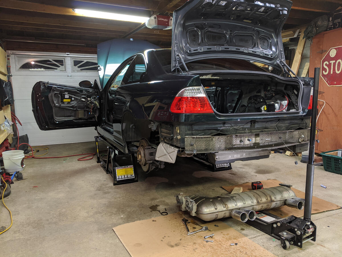

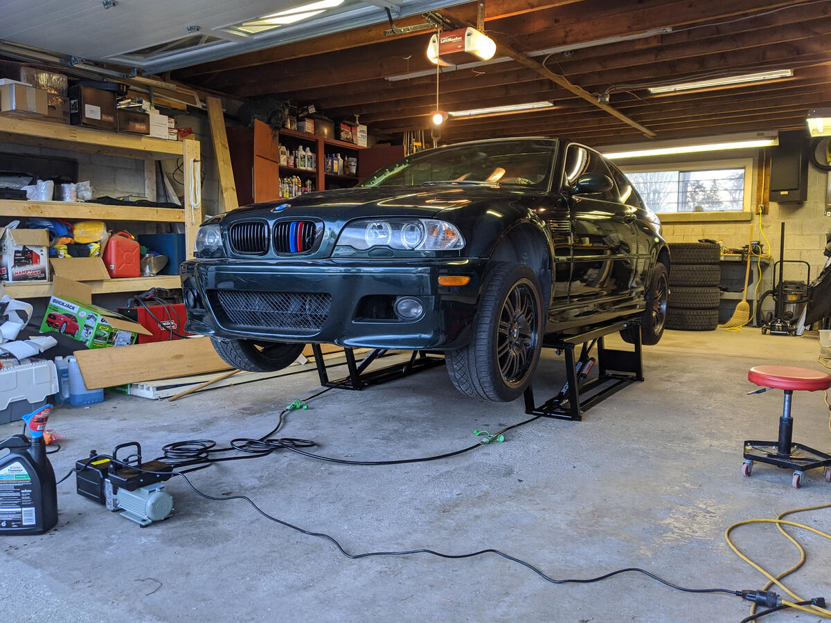

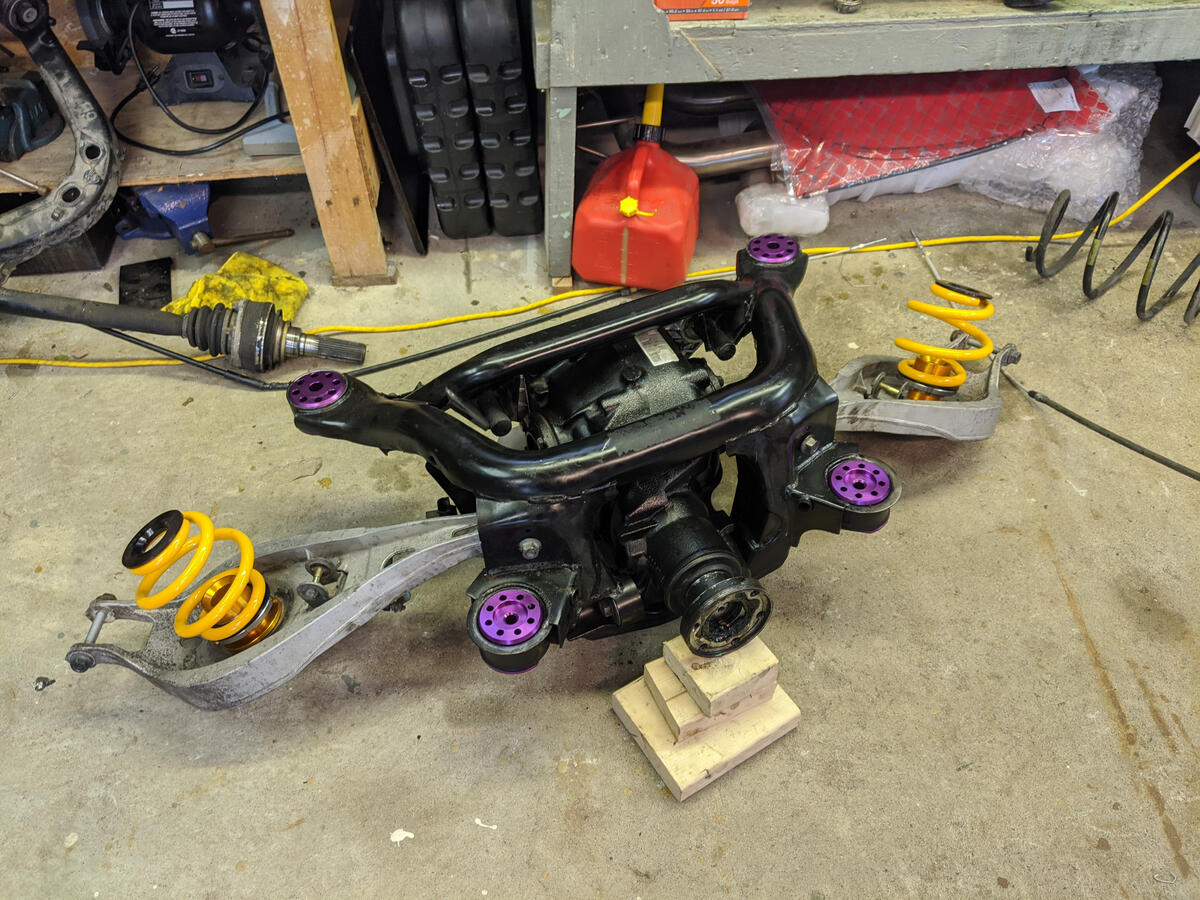

                          Next, my plan is to get the subframe out of the car for the rear reinforcements. So I get to work removing the exhaust, heat shields, driveshaft, rear suspension bits, all the trims and whatnot. I know while I'm in there, that I'm going to replace the shifter. It didn't feel too great, and the mechanic who inspected my car at the BMW dealer told me the PO shaved the guibo and stuff (presumably a non-M shifter arm). I also decided to upgrade the shifter because as I mentioned, the goal here is to focus on how the car feels - and I rather enjoy it when a cars shifts feel right. I ended up going with a AutoSolutions kit which i'll talk about in more detail later.

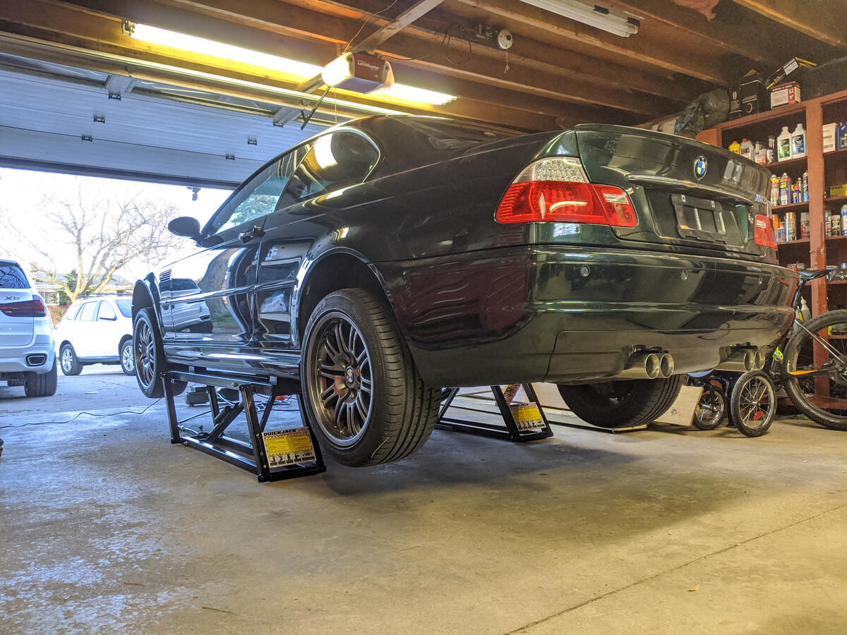

                          Below, I'm removing the drive shaft. I want to talk about the jack in that picture for a moment. I did some research on a good jack to try and find something better than the crap I grew up using. I settled on this Arcan XL2T. I don't think they're in production anymor but I noticed Sunex and other now selling jacks with the same frames. Two things must be said
                          1.) This frame is amazing. Fantastically low and long, amazing lift height, made removing these parts possible/easier as a solo guy.
                          2.) The hydraulics are garbage. This thing leaked from like week 1. I've been feeding it more and more jack oil because its a relatively cheap way to kick the can down the road but damn I need to find a solution here.
                          Click image for larger version  Name:	IMG_20200421_200730.jpg Views:	0 Size:	166.1 KB ID:	85872
                          If that leak is solved I'll content this is The Best jack to work on car.

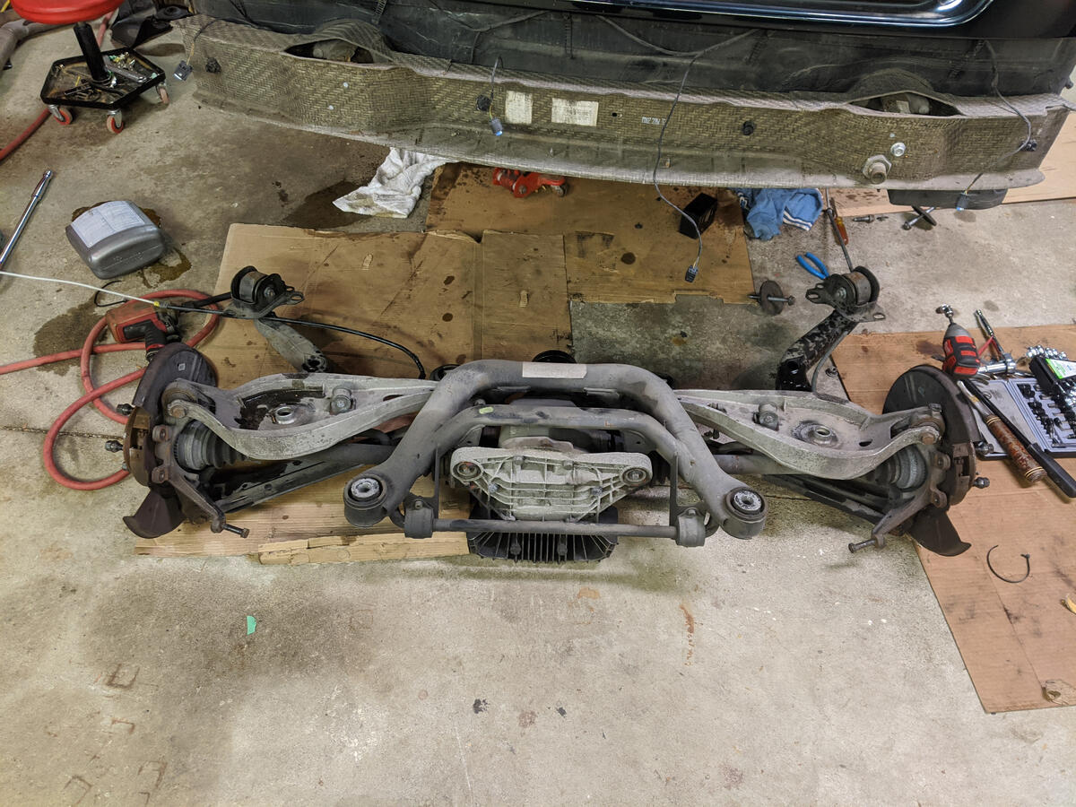

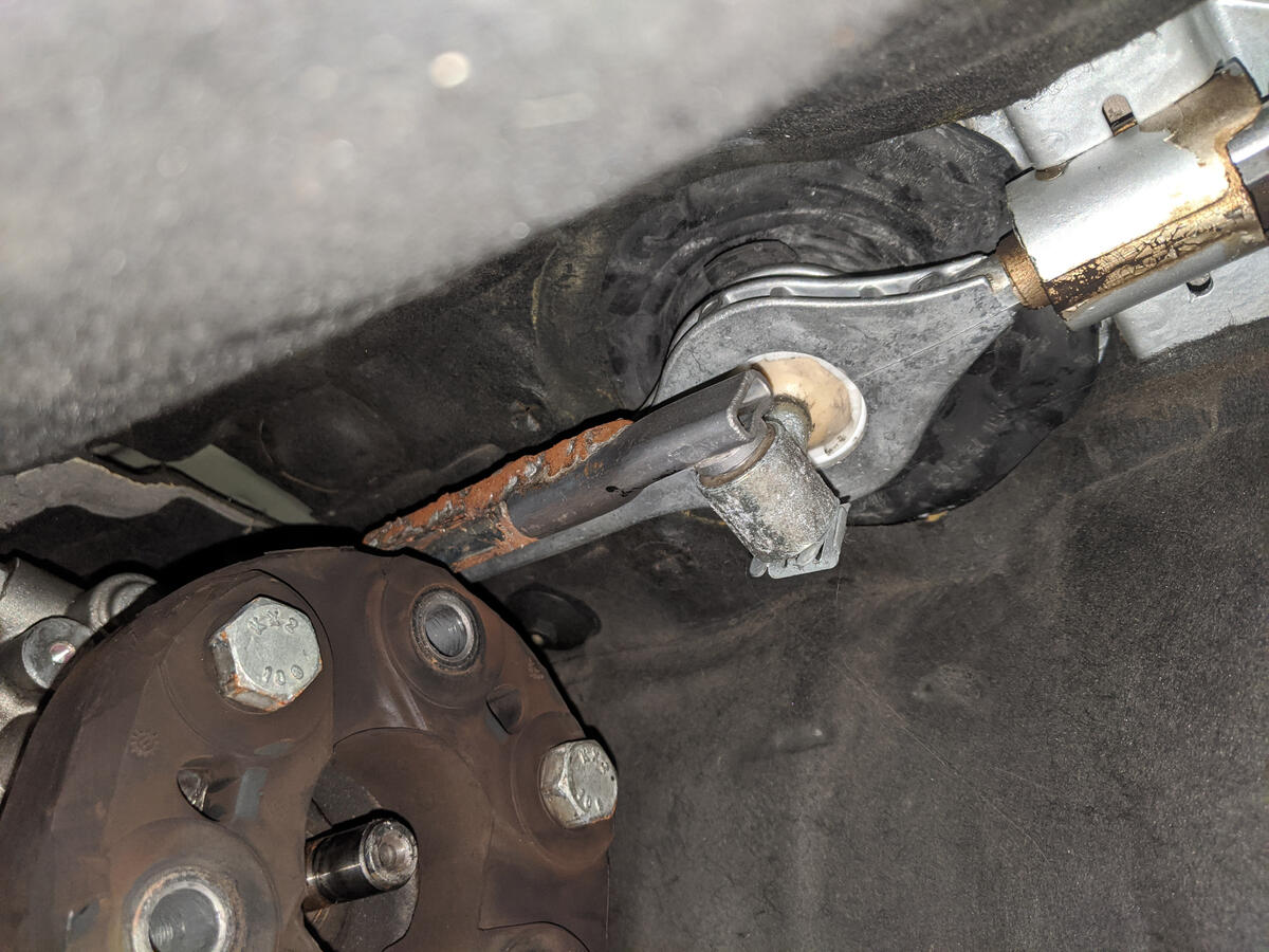

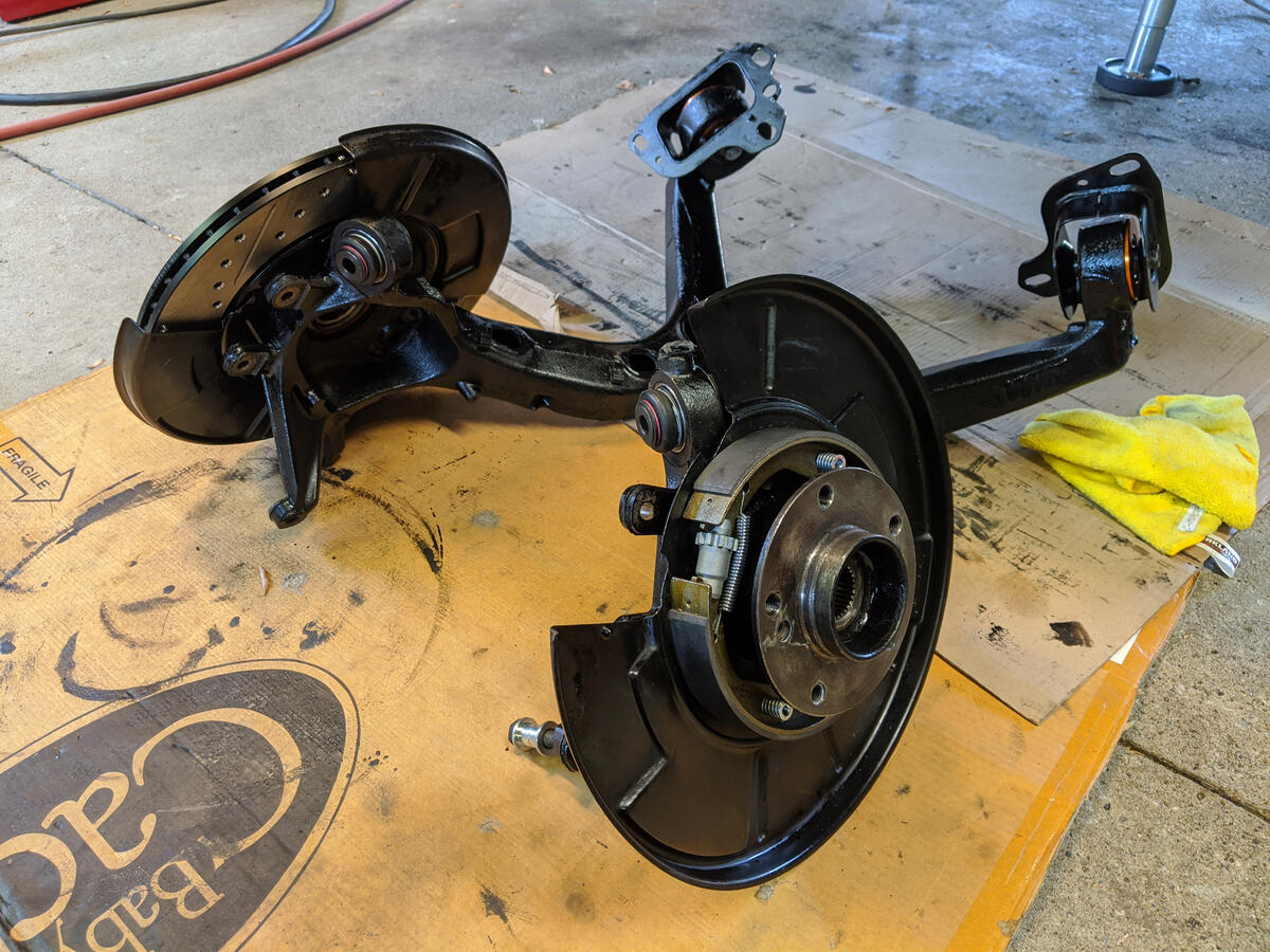

                          Eventually, I got the rear subframe out. Working on a car from the states (this one spent some time in the south, too) it was pretty refreshing to see all the bolts just like... come out. remarkably drama-free experience! Although, wiggling the subframe down was a bit sketch as I was afraid to bend the long bolts it mounts to. This is much better with a friend. Thanks Covid!
                          Click image for larger version  Name:	IMG_20200419_212645.jpg Views:	0 Size:	198.9 KB ID:	85876

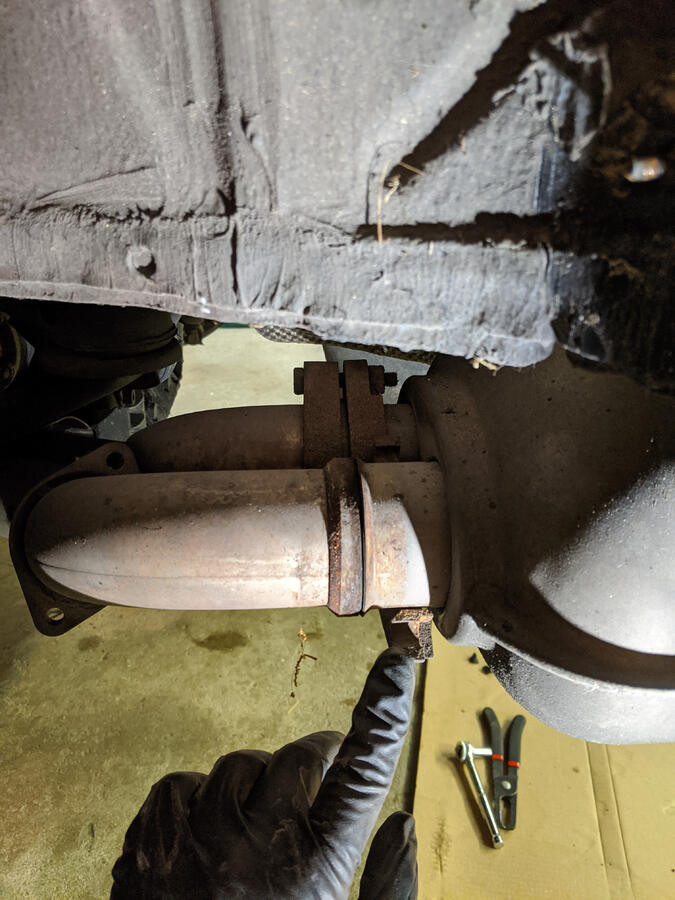

                          The exhaust was loose in several places, sounded rickety whenever you'd turn the car off. Unsurprisingly.
                          Click image for larger version  Name:	IMG_20200419_210110.jpg Views:	0 Size:	92.6 KB ID:	85878
                          Victory!
                          Click image for larger version  Name:	IMG_20200421_220342.jpg Views:	0 Size:	215.0 KB ID:	85877

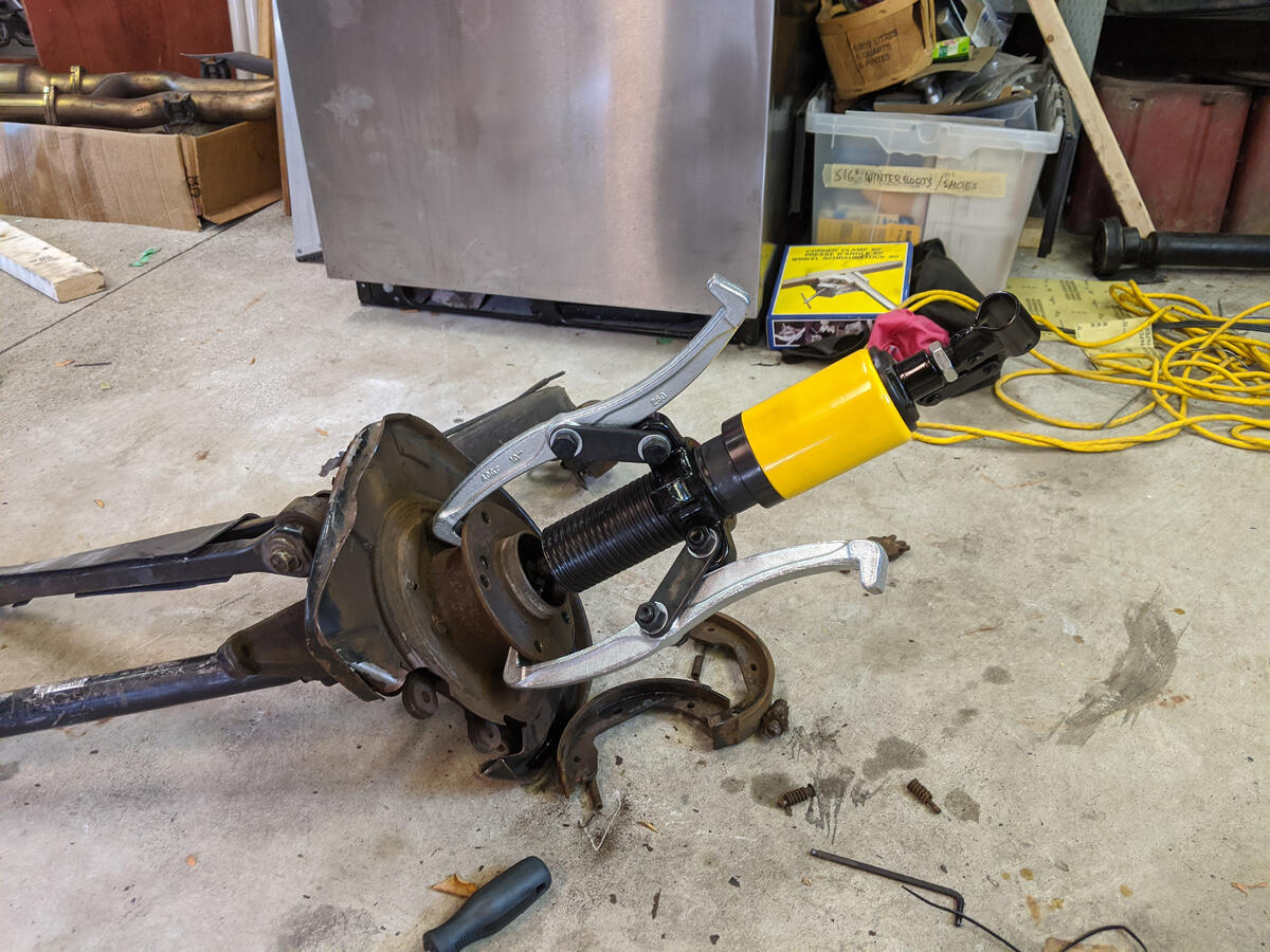

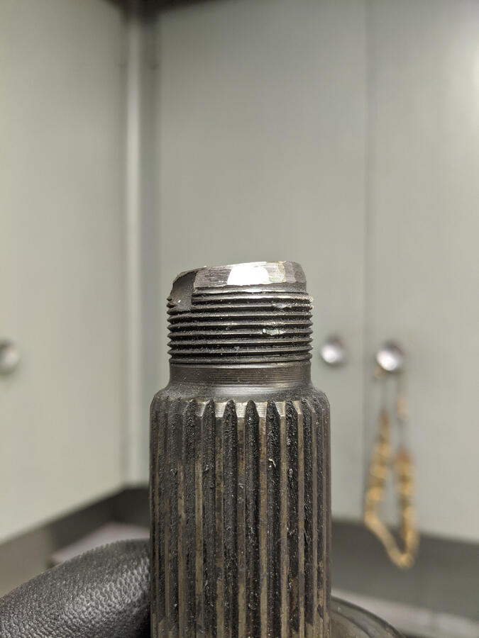

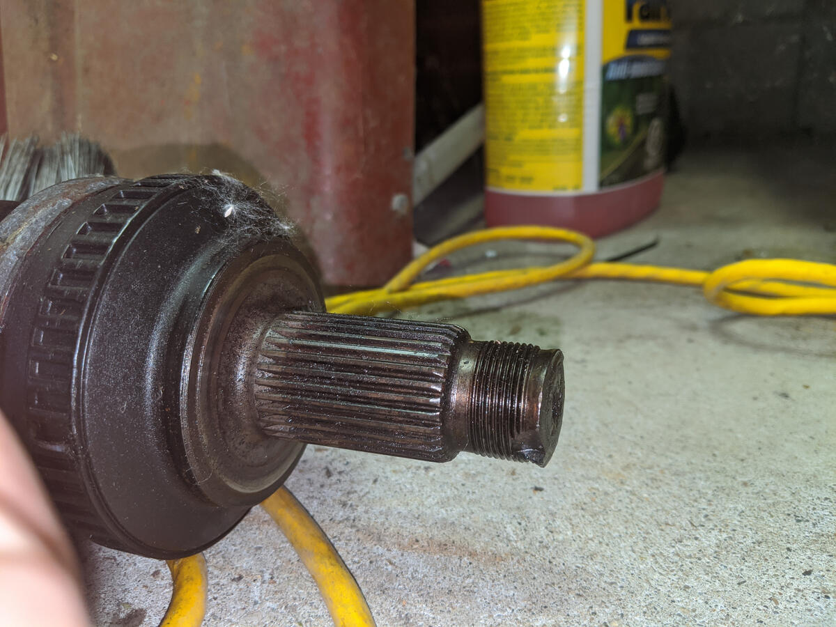

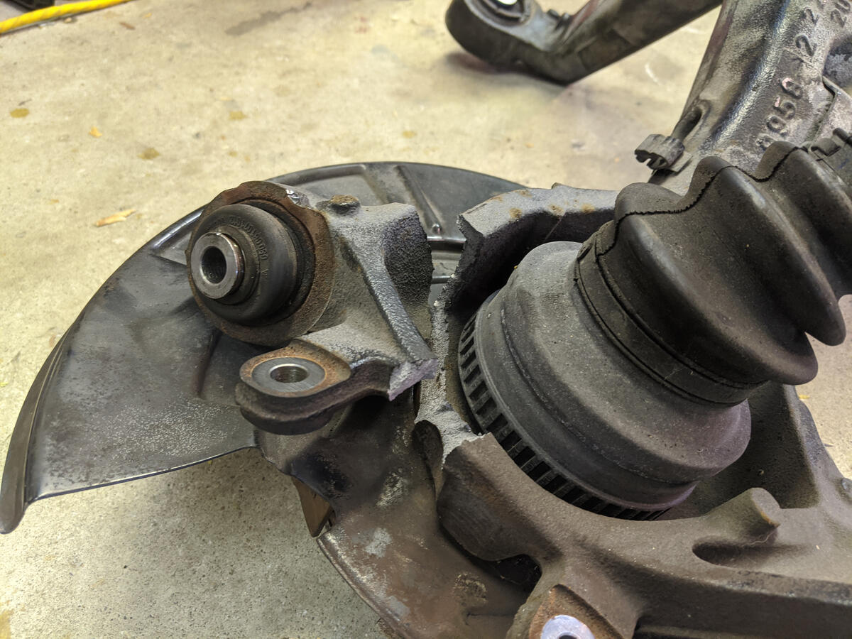

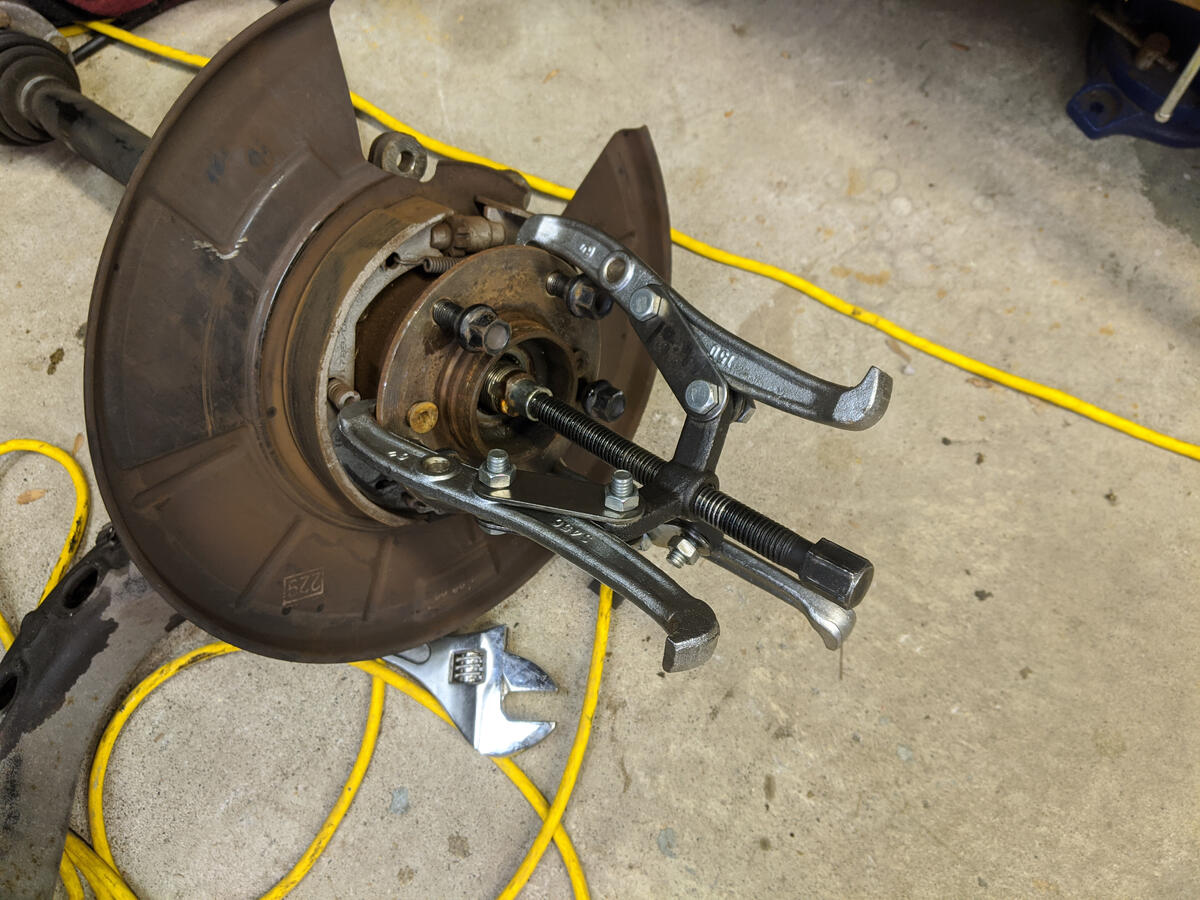

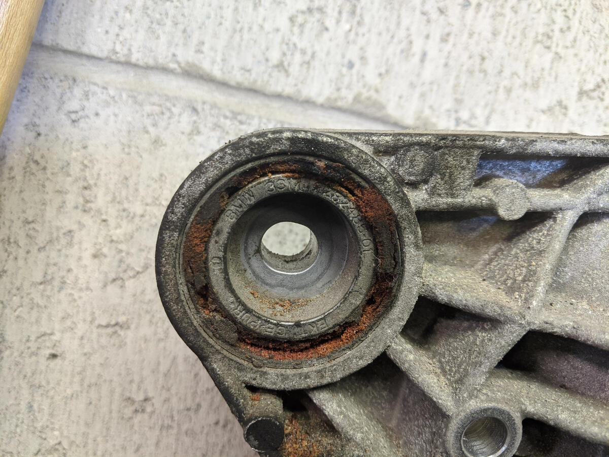

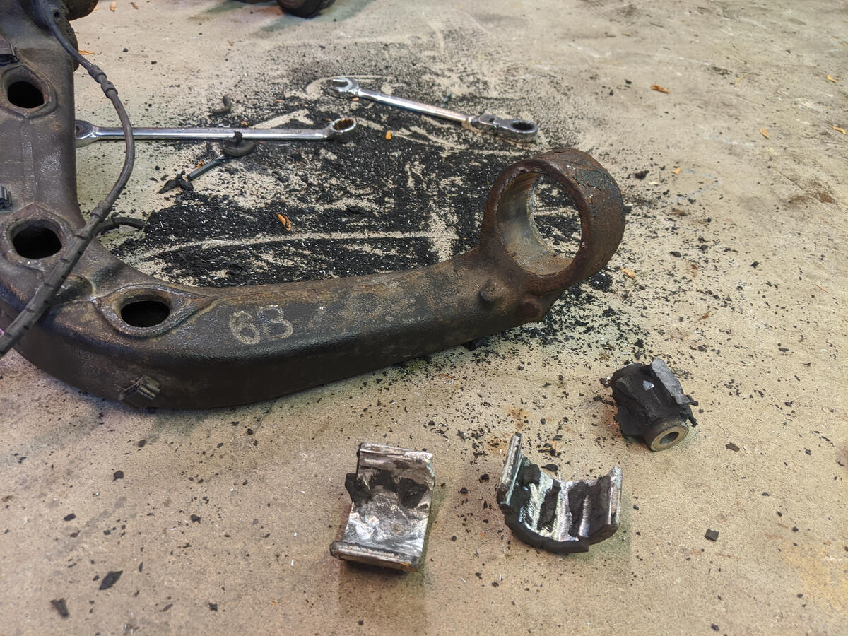

                          So now I have to disassemble this rear subframe / suspension combo and I'm about to learn all about BMW splines. I don't know how many of you reading this have ever had to pop your rear axles out but holy hell I've never encountered anything like this. Allow me to tell you a short story.

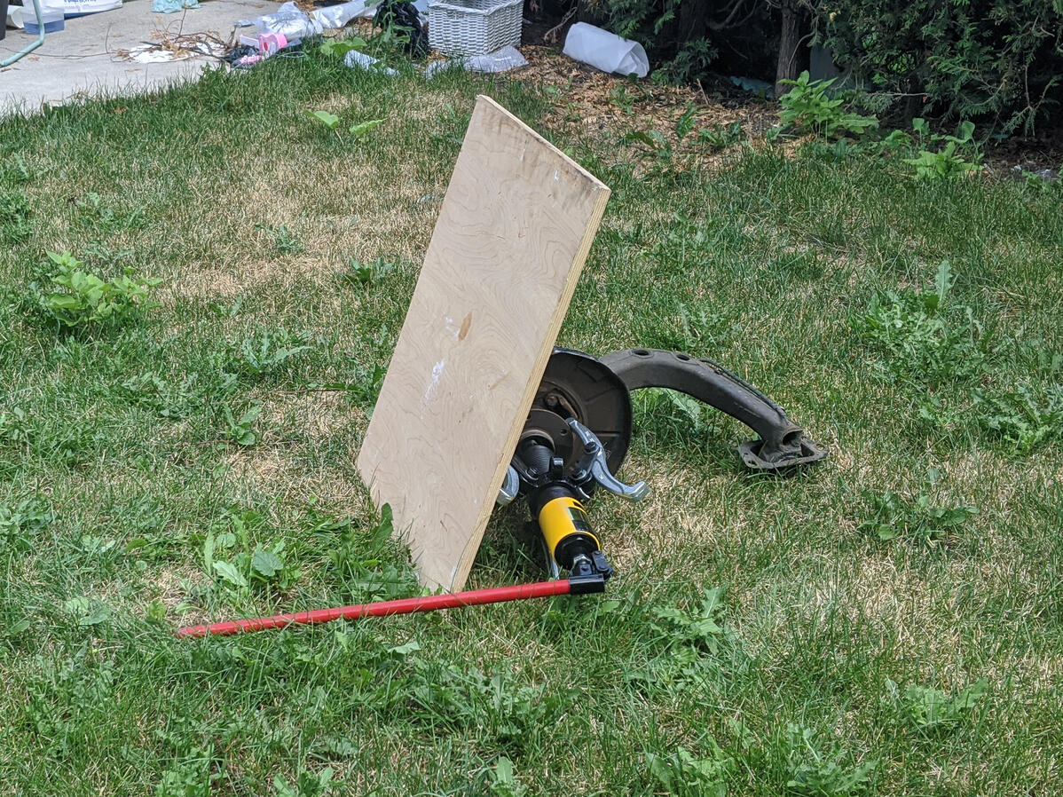

                          So, I try to pop the axles out with a deadblow, maybe even a small sledge with some wood as is par for the course with every other axle i've removed. This was not working. Fine, time to get serious and bust out the puller to pop this thing out of the hub flange.
                          Click image for larger version  Name:	IMG_20200423_183305.jpg Views:	0 Size:	172.2 KB ID:	85879
                          NOPE, after tightening it up as far as I was comfortable, and THEN reefing on it with a full blown sledgehammer, I end up here:
                          Click image for larger version  Name:	IMG_20200423_183938.jpg Views:	0 Size:	104.8 KB ID:	85880
                          At this point my mind is blown, and the internet tells me this is a thing. Ok, fine. I decide to find a local BMW indy to press these bad boys out for me. While I'm at it, I bring them a host of other bushings to press in. At this point I'm rebuilding the entire rear suspension with all new bushings and mounts. I'll talk more about those later. I bring them all the parts and ask them to do all the presses. a couple days go by and I call them since I figure this should take them an afternoon to just do the pressing. They complain that my parts "broke their 30T press". and that they can't get the bushings out. Not only that, but they broke my rear trailing arm too. They then proceeded to charge me for all their hourly time regardless. I was going to cause a shitshow over this, but It just wasn't worth the time. I ordered the tools to do it myself for less money than their hourly rate added up to... and did it myself. Rather embarassing. Here is how that went.

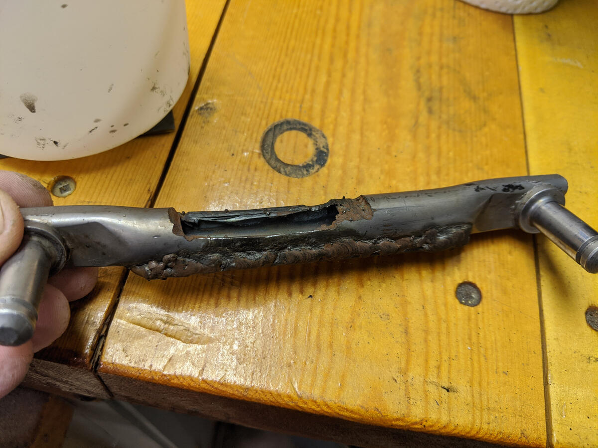

                          Here is the broken part:
                          Click image for larger version  Name:	IMG_20200622_190938.jpg Views:	0 Size:	172.2 KB ID:	85881
                          They didn't support the bushing bore from the opposite side. they just clamped the whole arm somehow and let the bushing ear bear the entire load. Rather amateur. No wonder it broke.

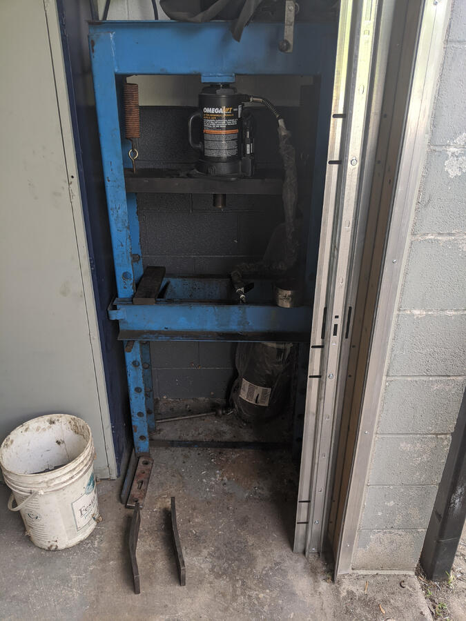

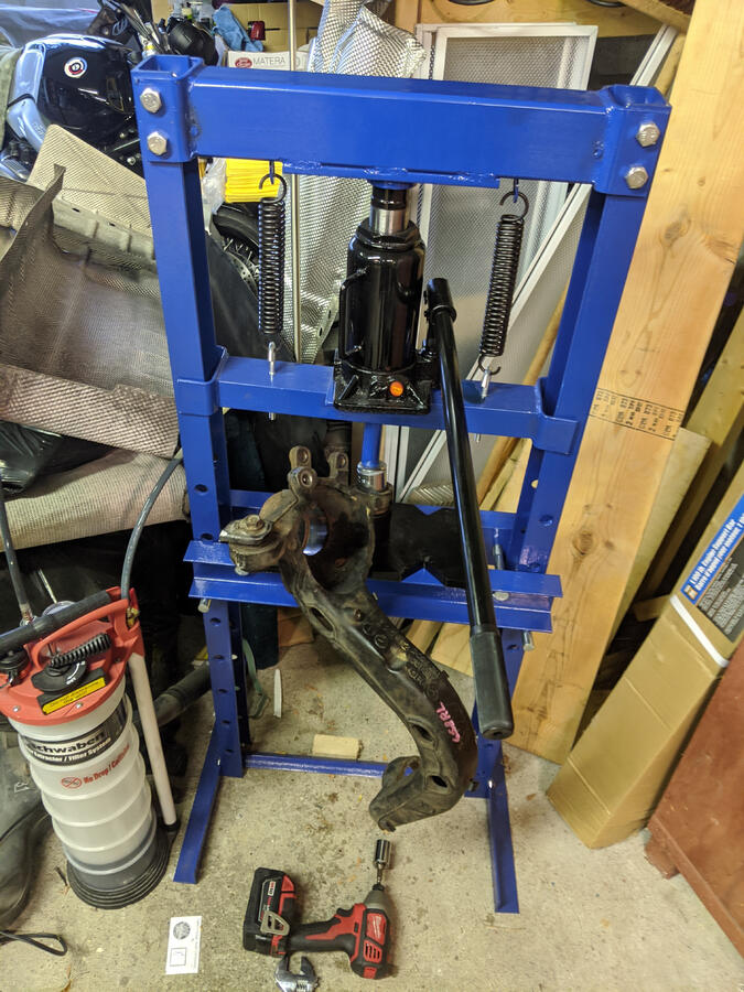

                          Here is the "broken press":
                          The press didn't break, but the tech bent the plates he was using. I'm not even a mechanic and I did it with a press 1/3 the size easily.

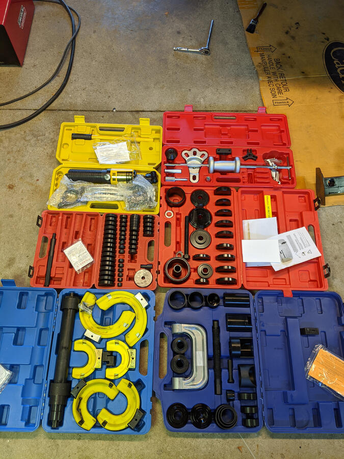

                          So I took to Amazon and this is my haul:
                          Click image for larger version  Name:	IMG_20200717_183744.jpg Views:	0 Size:	154.0 KB ID:	85882
                          Bearing Press Kit
                          Bushing Press Kit
                          C-Clamp Press Kit
                          Spring Compressor
                          5lb Slide Hammer

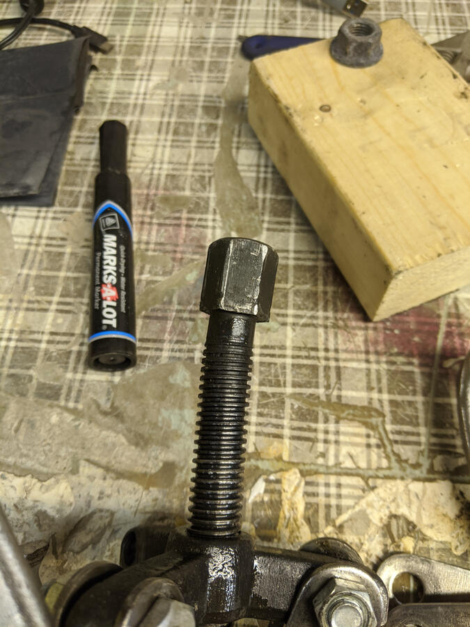

                          10T Hydraulic Gear Puller *****
                          That last tool is the secret sauce to this axle-removal recipe. If anyone is stuck, this is the tool to use. But even then, I needed to use an extended lever from something else and it made me uncomfortable. I ended up hiding behind a plywood shield until it let go.
                          Below is the replacement Control Arm + Axle off eBay to replace the broken one from the shop. Hence the mangled dust shield.
                          Click image for larger version  Name:	IMG_20200718_144558.jpg Views:	0 Size:	196.7 KB ID:	85883
                          Safety Third!
                          Click image for larger version  Name:	IMG_20200718_150310.jpg Views:	0 Size:	405.7 KB ID:	85884
                          I got myself a 10T press from Princess Auto (Canadian Harbor Freight). I use all the dies from the press kits with this instead of the c-clamps. It all ended up being less than the tech's hours! Of course, just like my jack, the hydraulics on this press are dying the moment its assembled. I ended up replacing the bottle jack with a 12T husky unit and everything's been peachy since. I've used these on like 5 or 6 other cars by now so money well spent.
                          Click image for larger version  Name:	IMG_20200718_202623.jpg Views:	0 Size:	140.2 KB ID:	85885
                          So now I noticed that the ends of my axles are peened over from all this fighting:
                          Click image for larger version  Name:	IMG_20200624_114531.jpg Views:	0 Size:	162.2 KB ID:	85886
                          I figured I might be able to grind it down. Did some research to see if anyone's done this, apparently its common. The internet will have you think grinding down the peened over part is hard but it really wasn't. This area is also beyond the threads so I figure it isn't being stressed the same.
                          Click image for larger version  Name:	IMG_20200624_172219.jpg Views:	0 Size:	56.6 KB ID:	85887
                          Now that everything is finally apart. Its time to put things back together! Here is how I approached this:
                          -Differential Mounts -> OEM [From my research, any stiffer mounts translate significant gear whine NVH - this aligns with my understanding and I don't want such NVH]
                          -Subframe Mounts -> CMP Auto Engineering Solid Aluminum. [Solid subframe mounts will improve response and *Feel without dramatic NVH increase *(depends on how other parts are connected to the subframe) - CMP Mounts actually compensate for the lower mounting plane as a result of reinforcing plates. This helps maintain suspension geometry.]
                          -RCAB -> Synchro Design Works Isolated Monoball. [Isolated monoballs appear to be the move here from all my research. Improved response with minimal NVH
                          -Control Arms -> OEM [If you study the OEM design, you'll notice that the outboard "bushings" are actually monoballs. They have no play and are solid. No aftermarket bushing is going to improve upon this. The inboard bushings are rubber. And this is where all the compliance comes into play. I left these OEM rubber in order to help soak up some of the crap roads we have over here. But to be honest, after doing a full poly swap on my buddies STi it really didn't seem too stiff and I may consider poly inboard mounts in the future.
                          Of course, I'll replace the wheel bearings and parking brakes as well! Lets take a look at some of that part candy 🤤🤤
                          Click image for larger version  Name:	IMG_20200609_161028.jpg Views:	0 Size:	193.2 KB ID:	85888

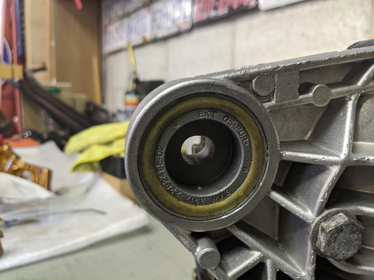

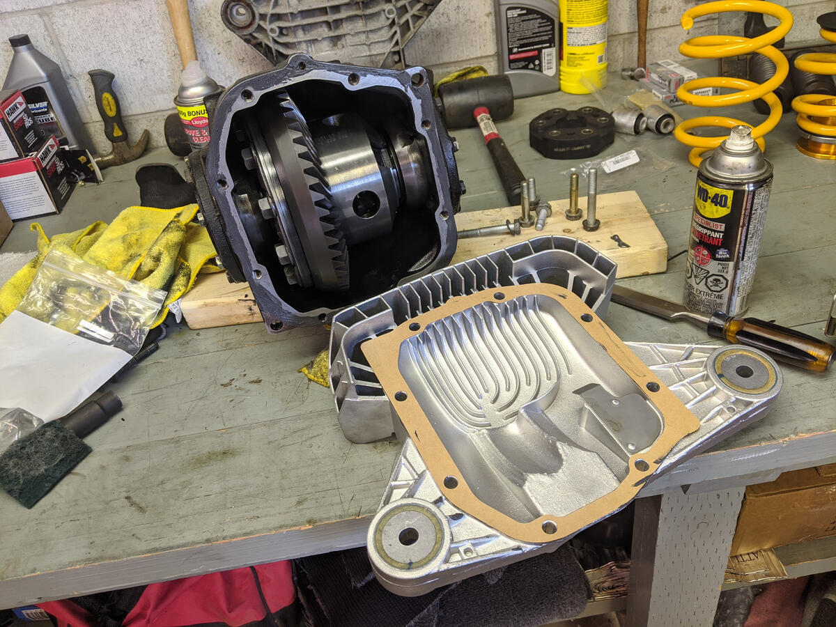

                          Old Diff Bushings
                          Click image for larger version  Name:	IMG_20200620_172812.jpg Views:	0 Size:	198.5 KB ID:	85889
                          New Diff Bushings:
                          Click image for larger version  Name:	IMG_20200620_172824.jpg Views:	0 Size:	140.4 KB ID:	85890
                          In this case, unless you go for poly I think you have to buy the bushings with the case if I remember correctly. At least it feels real nice putting this together.
                          Click image for larger version  Name:	IMG_20200620_172136.jpg Views:	0 Size:	230.3 KB ID:	85891
                          Standard DIY bushing removal:
                          Click image for larger version  Name:	IMG_20200718_192307.jpg Views:	0 Size:	266.3 KB ID:	85892

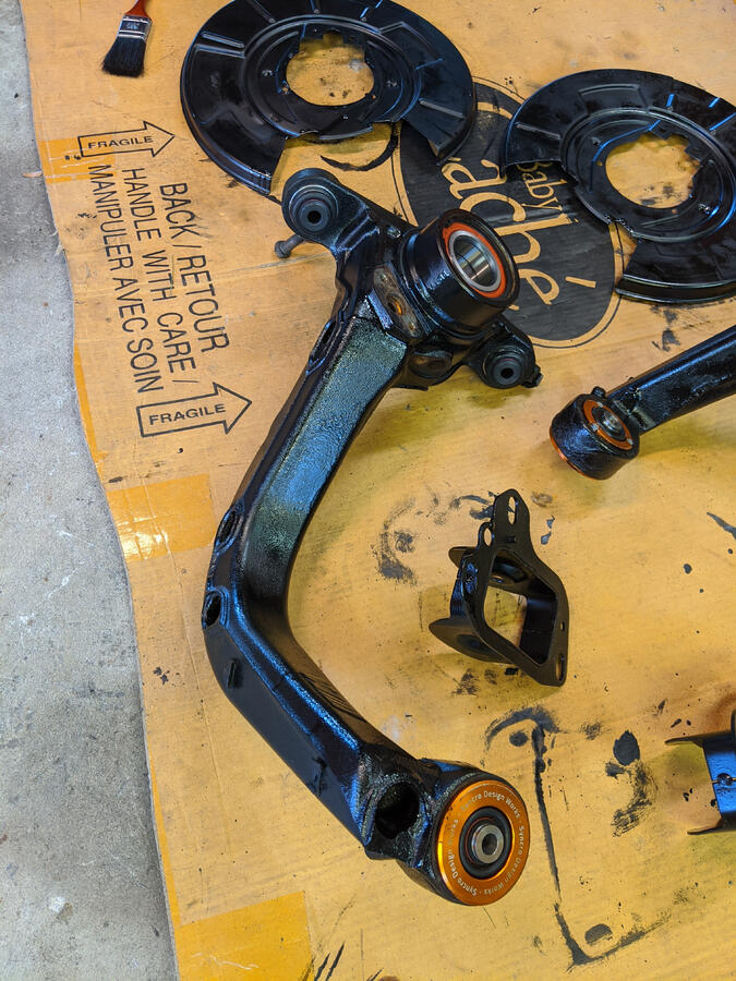

                          Cleaned up and POR15'd the parts before pressing in the new bearings.
                          Click image for larger version  Name:	IMG_20200720_111605.jpg Views:	0 Size:	150.2 KB ID:	85893

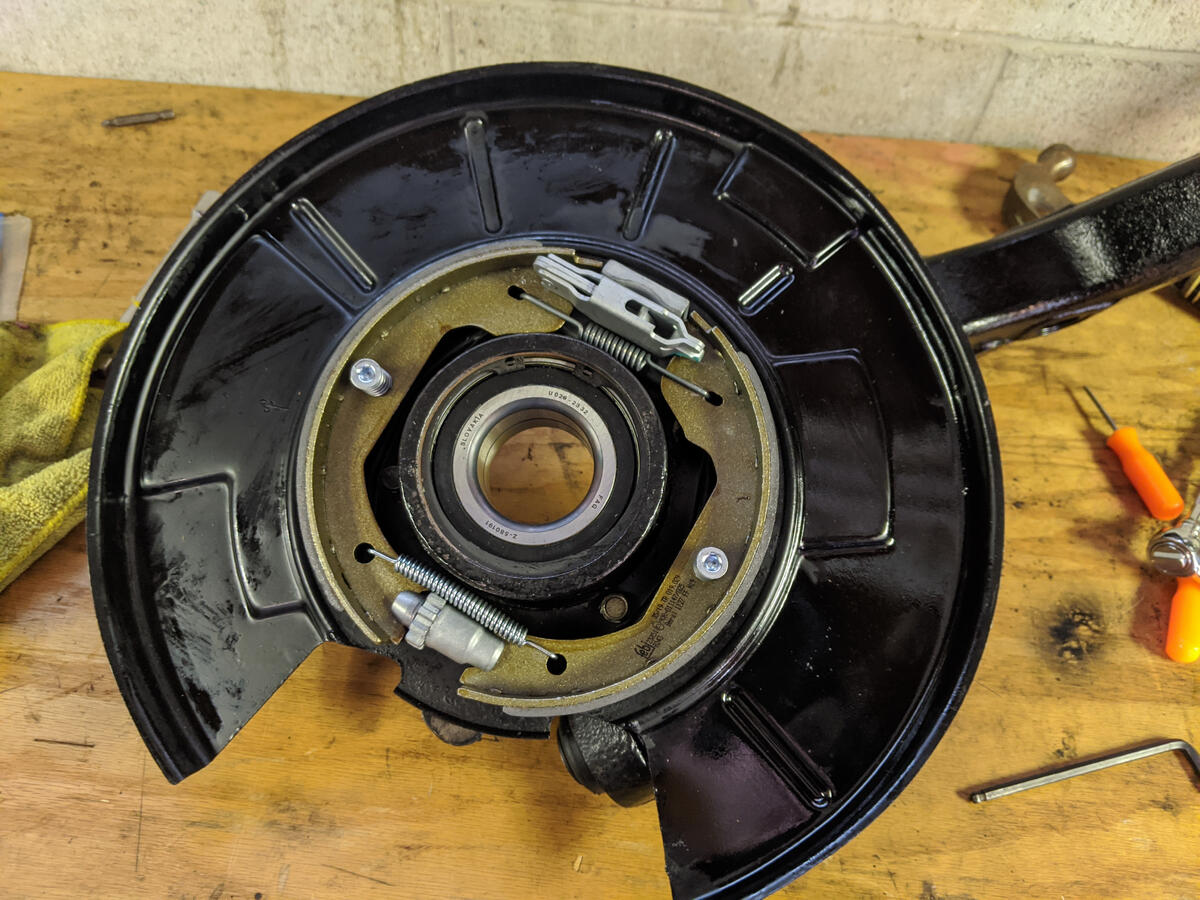

                          New parking brake hardware:
                          Click image for larger version  Name:	IMG_20200720_190005.jpg Views:	0 Size:	190.0 KB ID:	85894
                          Trailing Arms Ready to Go:
                          Click image for larger version  Name:	IMG_20200720_192322.jpg Views:	0 Size:	221.1 KB ID:	85895

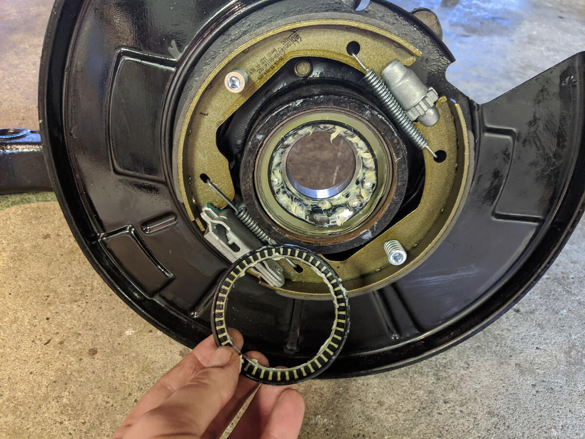

                          OOPS - Pay attention to the orientation of your Bearings! Encoder Inside!
                          Click image for larger version  Name:	IMG_20200807_163235.jpg Views:	0 Size:	217.3 KB ID:	85896
                          Was very frustrating to have to do that over. Not only do you have do disassemble the entire trailing arm again. But once those bearings are pressed in, they don't come out without getting destroyed. Had to buy another rear wheel bearing (pricey bearings!). Make sure they're in right!!!!

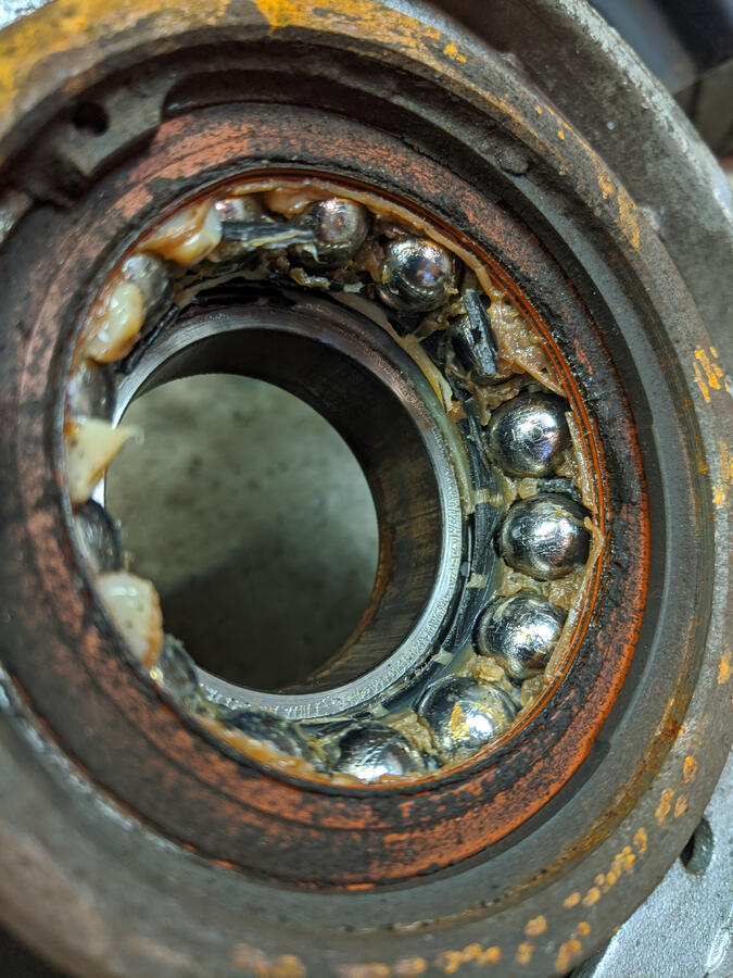

                          Here are the old wheel bearings for reference. They didn't make any noise or anything, but they sure look crusty.

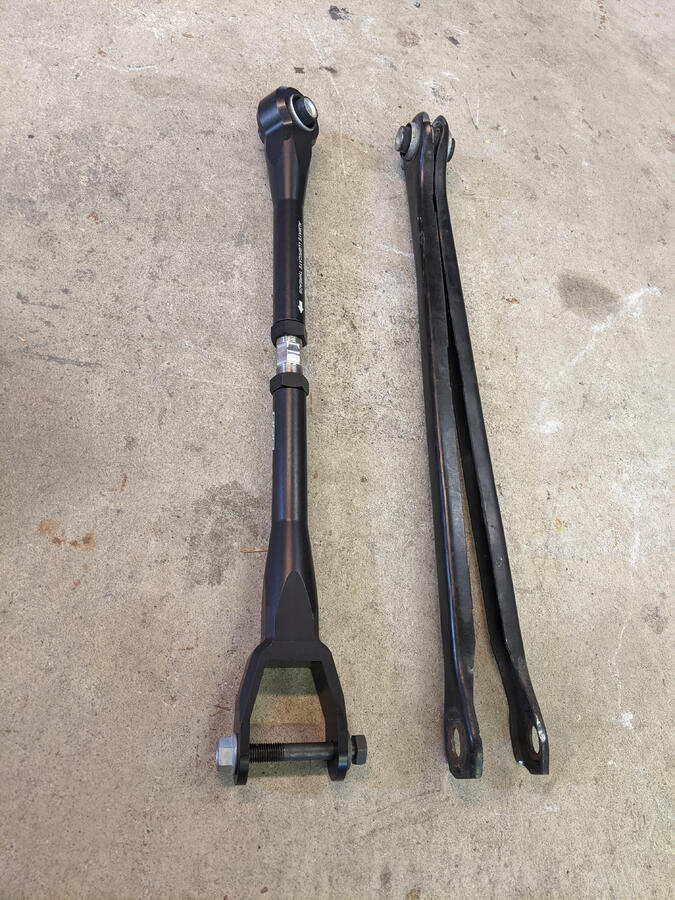

                          I decided to throw a set of ECS adjustable rear lower control arms in. I ended up deciding to put coilovers on the car. We'll get to those soon - but the point here is that I realized there would be no way to properly align the car after it was lowered without a set of these. Once I got them it was very clear how much stronger and stiffer they were than the OEM ones. Keep in mind that the OEM ones are likely designed this way to collapse on purpose in an impact. But this means there may be some Feel Gains on the table! I mean, I can squeeze this thing with 2 fingers...
                          Click image for larger version  Name:	IMG_20200626_152512.jpg Views:	0 Size:	126.6 KB ID:	85897

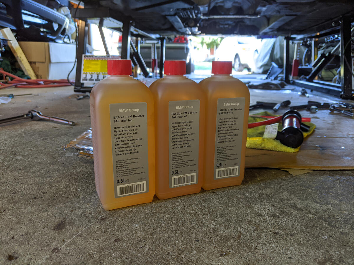

                          OK I *Think* that covers the rear subframe! I'll be filling the diff with OEM Spec fluid - at the end of the day you don't change diff fluid often. and considering how finicky some LSD's can be I decided to trust the engineering at BMW on this one.
                          You know, when I put this together and looked at it before slapping it in the car. I thought it looked pretty good! But then I saw some of these other build threads. I need to step my game up 💪
                          Click image for larger version  Name:	IMG_20200627_174743.jpg Views:	0 Size:	222.5 KB ID:	85898

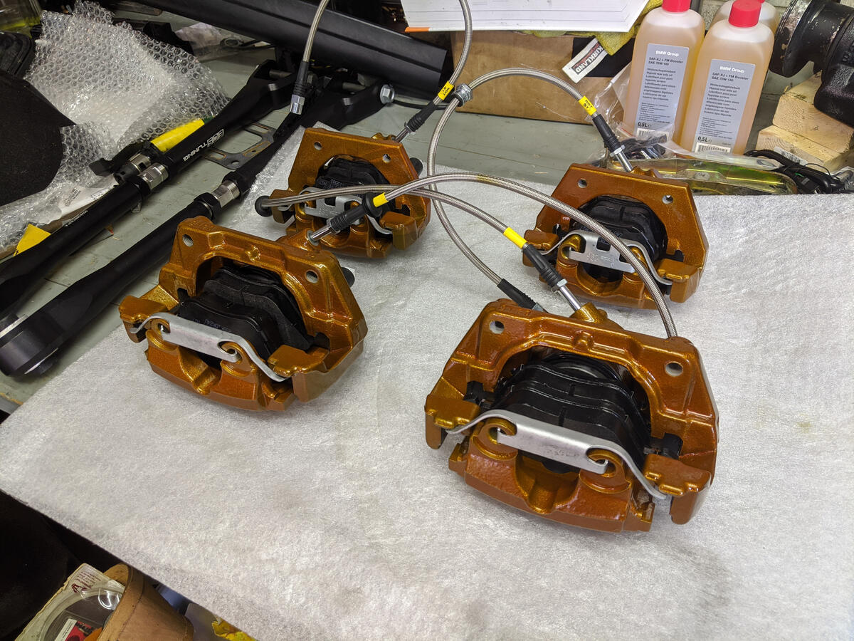

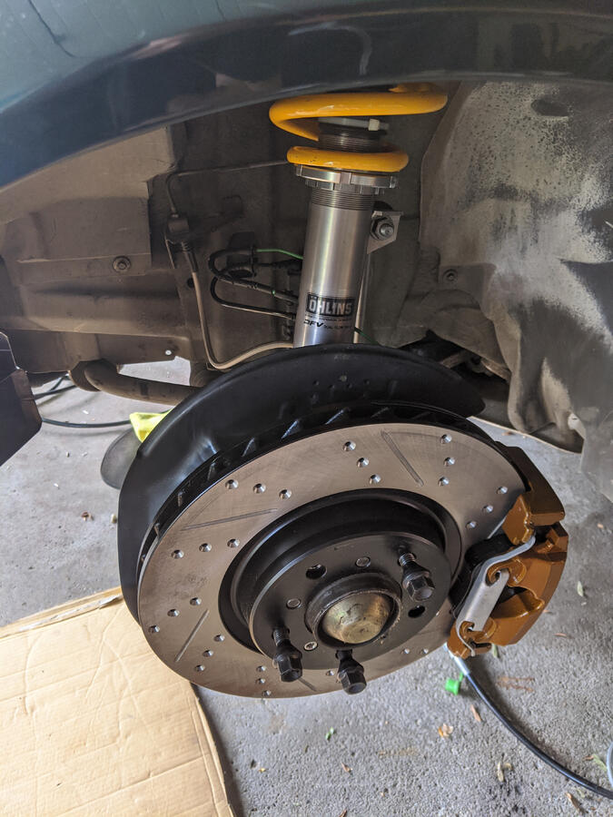

                              Ok, I've been avoiding talking about Brakes the whole time I discussed the subframe. I took the brakes off when I disassembled everything and it would have been easy to get lost on a tangent.
                              At first, I knew I would be upgrading the pad setup to improve brake feel and performance. I also knew I would be switching to braided lines in pursuit of that "feeling" goal. I also know that "caliper rebuild kits" [two seals] are pretty cheap so I figured I'd rebuild the calipers while I'm at it.

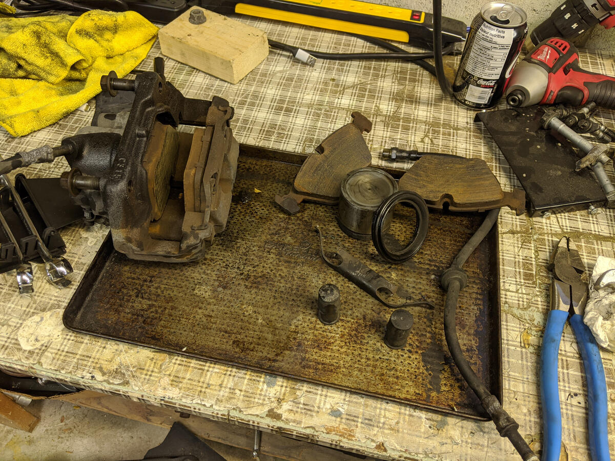

                              Here are the calipers as removed:

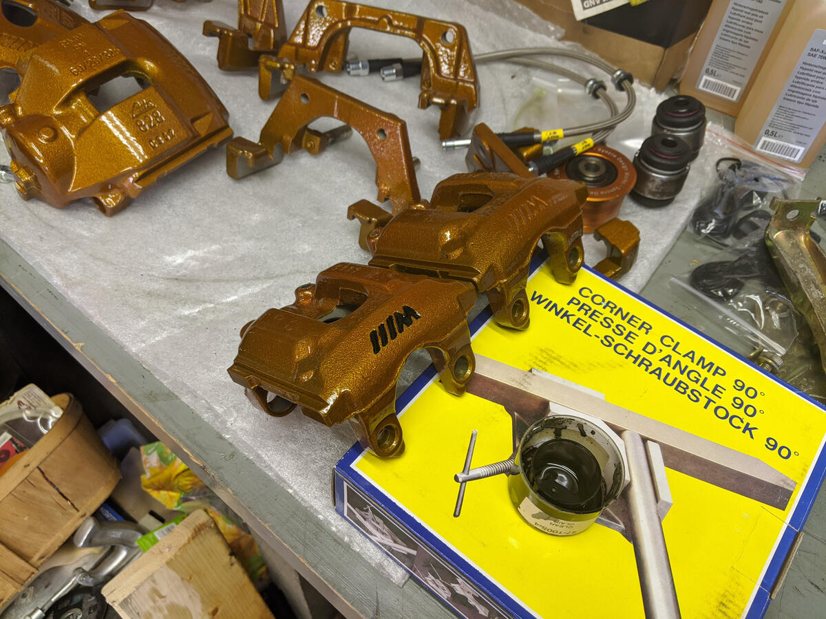

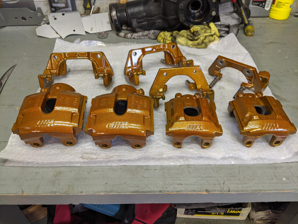

                              Nothing wrong with them. Could us a cleaning I suppose. BUT, I had time on my hands now. With all the other work going on, and the delay on components during pandemic, I decided to have them powdercoated! Still wayy cheaper than a big brake kit (which, hey, one day I'd like to do the Porsche swap).
                              I decided to go with a bronze/copper colour to try and tie into the Cinnamon interior and contrast the Green nicely. The shop sold me who their suppliers were and I settled on something called "Dorado" and it looks like this:
                              It actually ties into the SDW rear monoballs - too bad you'll never see em! Also, nobody was going to pick up on that ///M from behind the wheel. something had to be done!

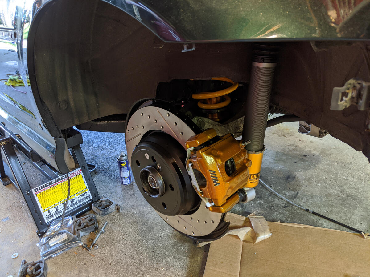

                              Once assembled, the calipers were loaded with a set of HAWK Street 5.0 pads, plumbed with Stop Tech stainless braided lines, and assembled over a set of StopTech drilled and slotted rotors.
                              Once it all comes together it looks like this:

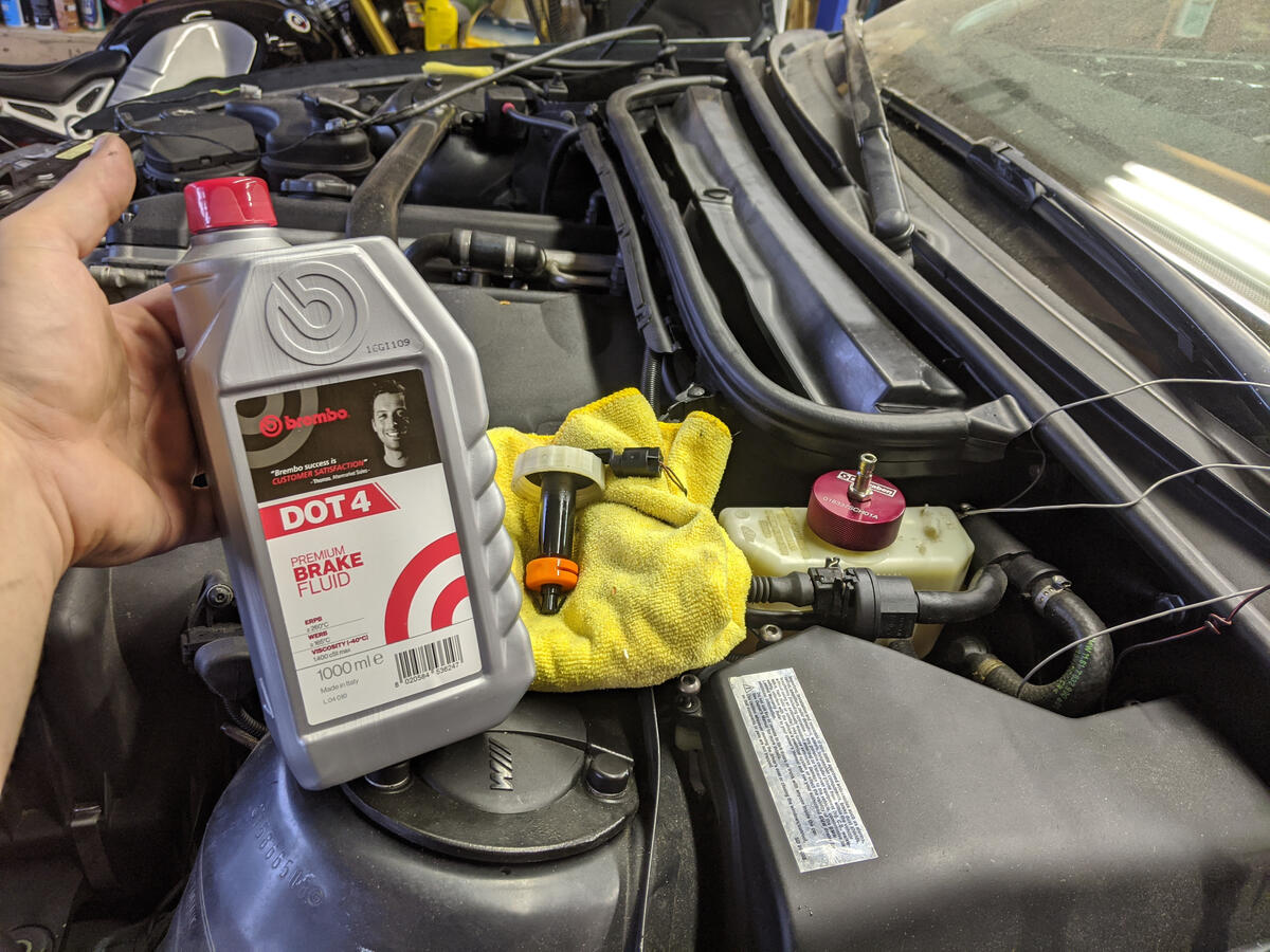

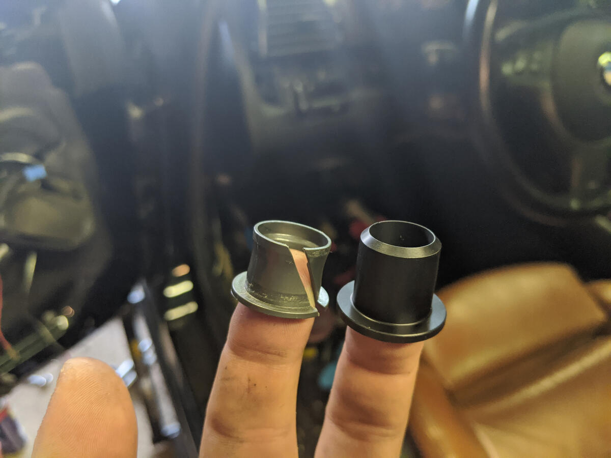

                              All of this was power bled with Brembo DOT4 fluid, and the brake pedal bushings were upgraded to delrin units which help eliminate side-side slop of the pedal and make it feel solid. Again with all the feelings.
                              OE Bushing on the left, Delrin on the right. Without the split, the delrin ones are much harder to install! I can report improved pedal feel.
