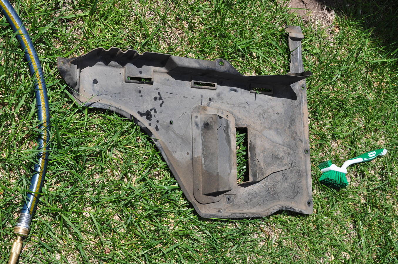

                    Cover was dirty, so hosed it off and cleaned/treated it with the protectant.

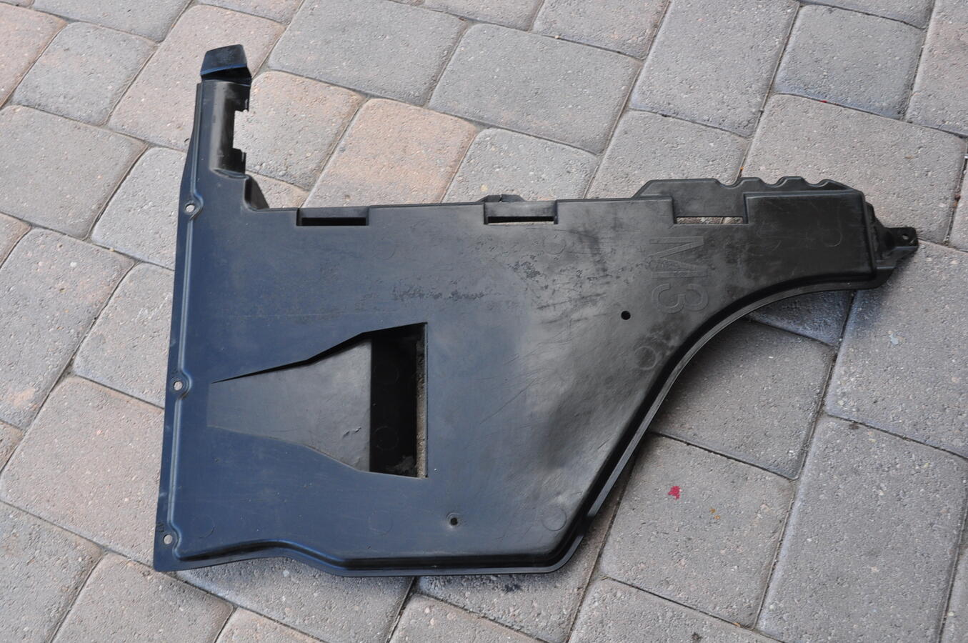

                    Dropped the sect 2 cross members. Even dirtier. Never seen so much dirt/rocks. When people joke about accumulating dirt adding weight to the car, it ain't a joke lol
                    Click image for larger version  Name:	Tranny4.JPG Views:	0 Size:	183.6 KB ID:	116264 Click image for larger version  Name:	tranny5.JPG Views:	0 Size:	198.6 KB ID:	116265

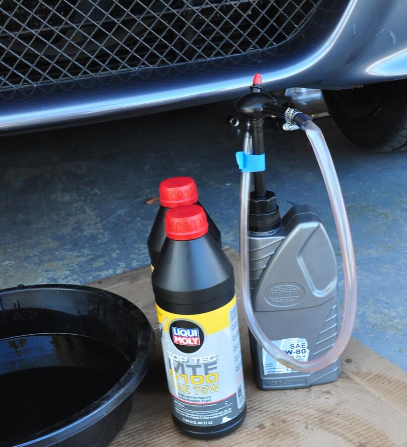

                    Next, drained the tranny. What came out looked original, not fresh. RIP synchros As far as feel, the tranny doesn't feel much different than most. Never pops out, never doesn't go in, but getting into 2nd is tough when cold. Overall, not as smooth as my 180k silvergrey (poster child), but not too much worse. Pretty positive this is 123k mile, 19 y/o lube:
                    Click image for larger version  Name:	Tranny7.JPG Views:	0 Size:	114.0 KB ID:	116268
                    Like the tranny, I'm not putting in OE fluid yet. If pentosin MTF2 was still easy to get, I would have, but I'm trying a MTF3 fluid, a straight 75 weight, still the proper GL4 spec. The idea here is that the slightly lower weight will make shifting a little easier for this daily driver where I don't need as much high heat protection as I'm not jamming it into gear like I do on my silvergrey in the canyons.

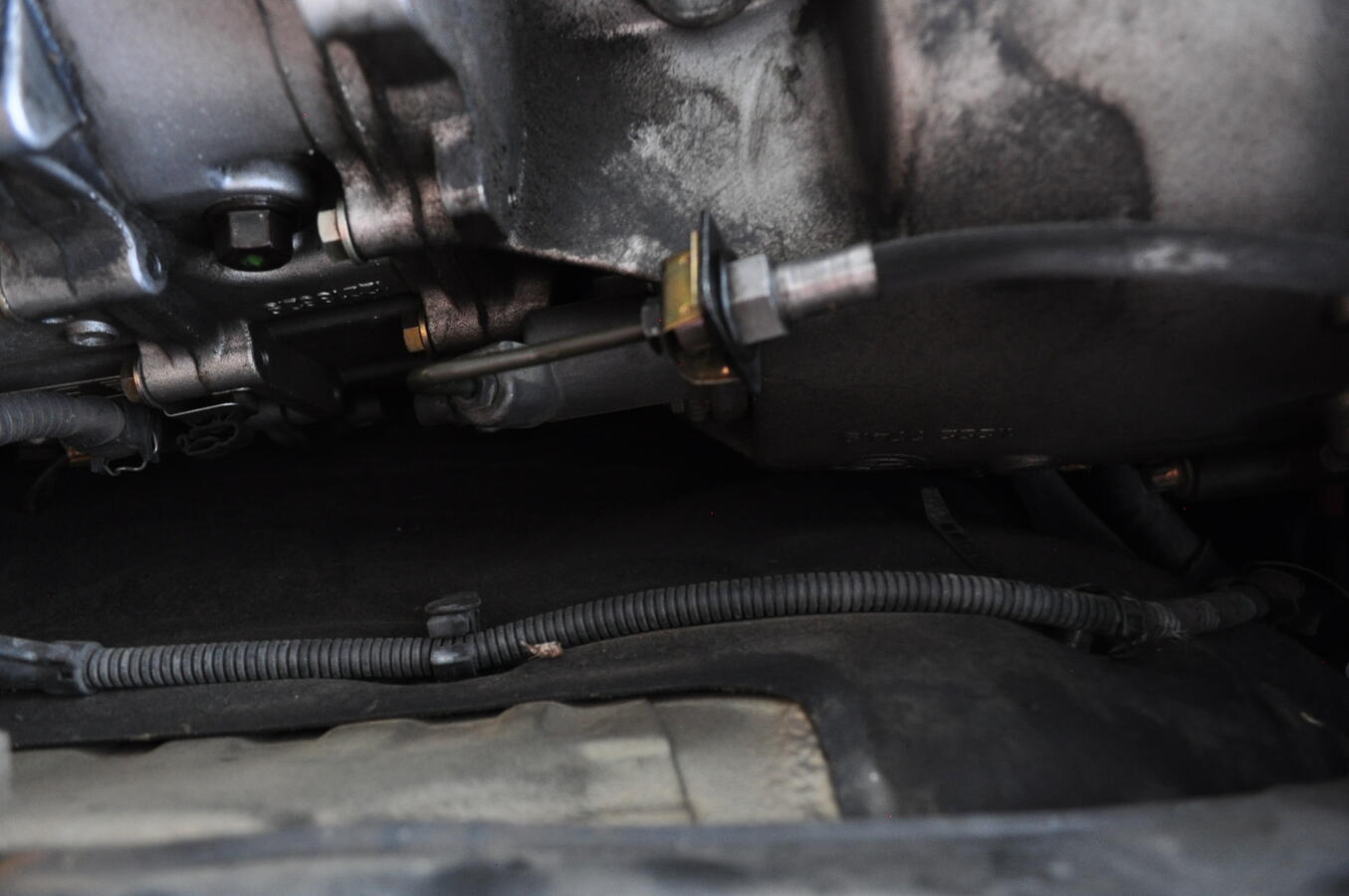

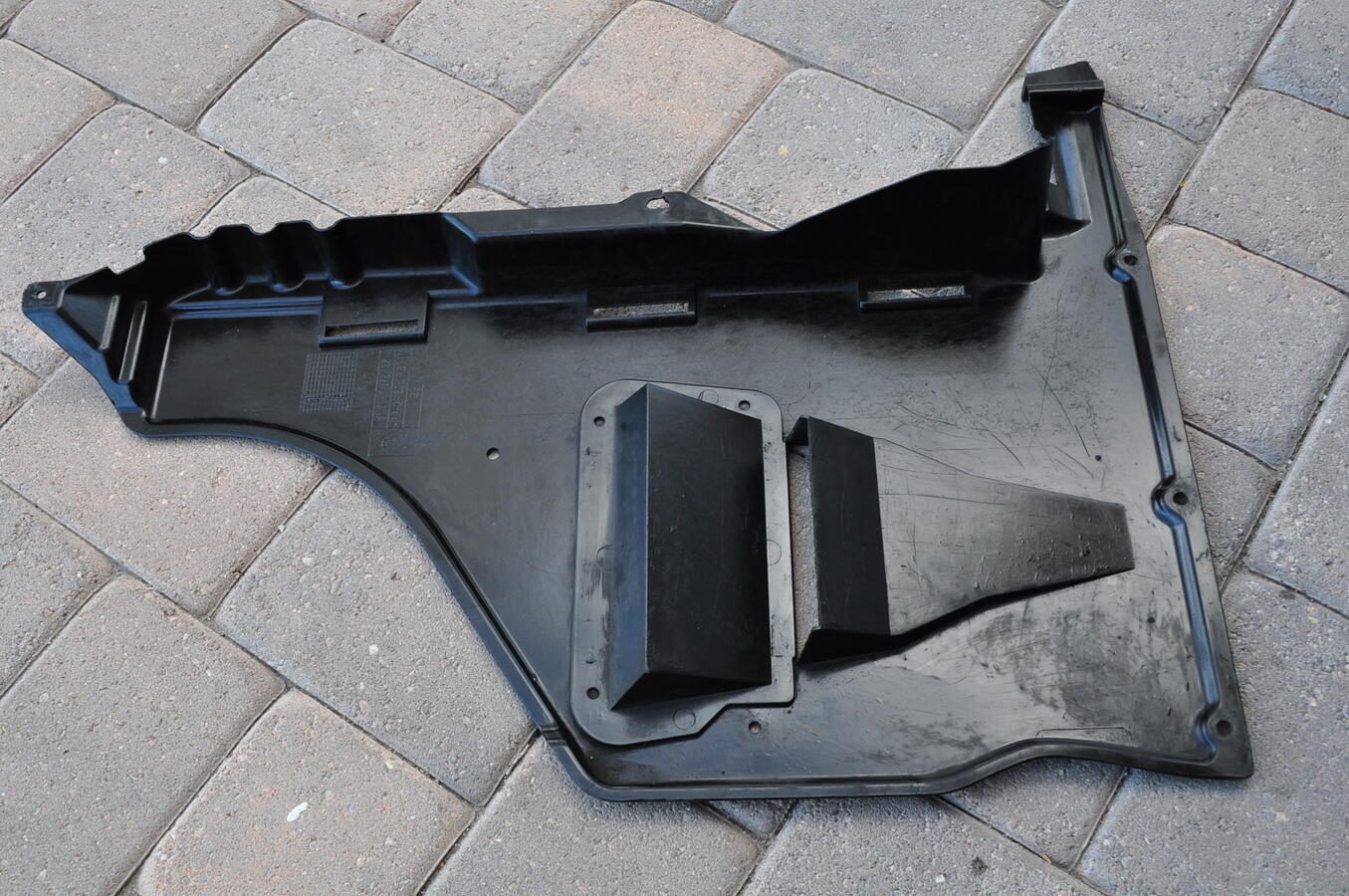

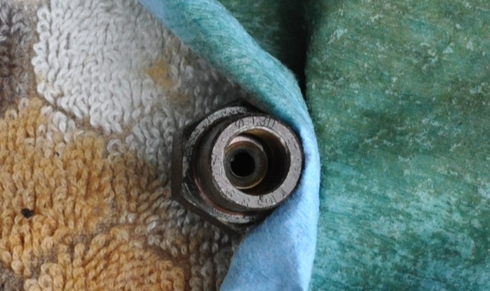

                    As most know, our cars got a restrictor/governor in our clutch line to slow the slave action. Well we don't like that. One of the first things you should do to the car is remove it!
                    Here it is, you can see the orifice that fluid passes through.
                    Click image for larger version  Name:	Tranny9.JPG Views:	0 Size:	106.6 KB ID:	116266

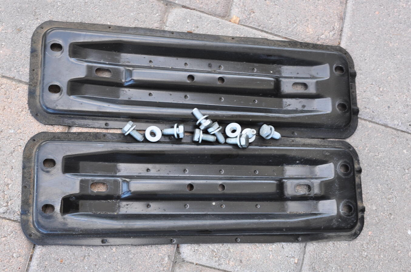

                    You can actually punch it out, or you can simply remove the unit, and thread the line back onto the hard line fitting seen here (what I did):
                    Click image for larger version  Name:	tranny10.JPG Views:	0 Size:	87.6 KB ID:	116269

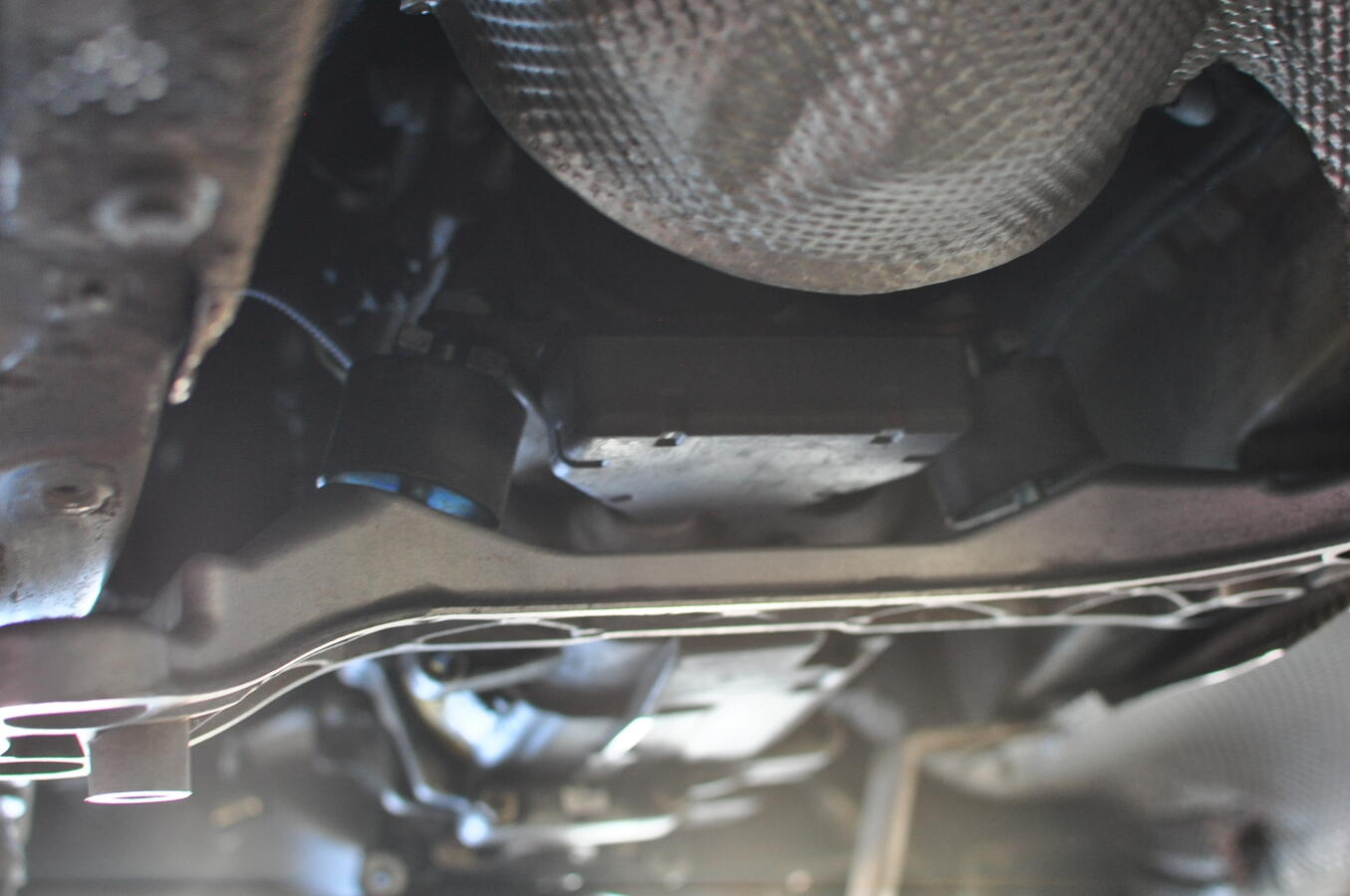

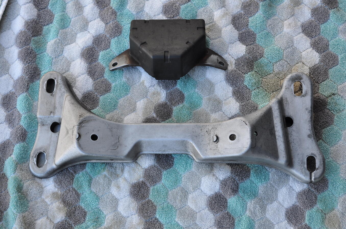

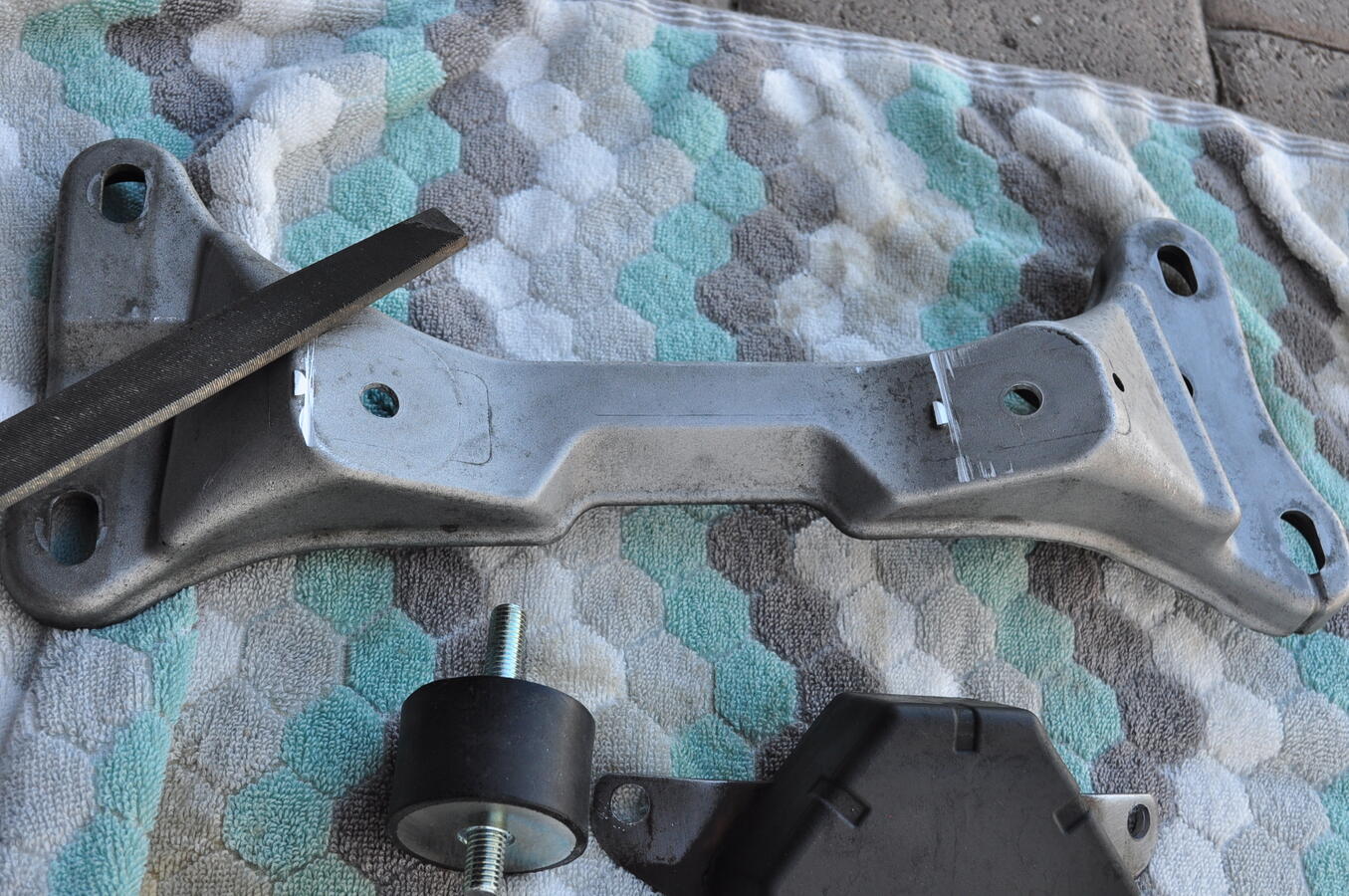

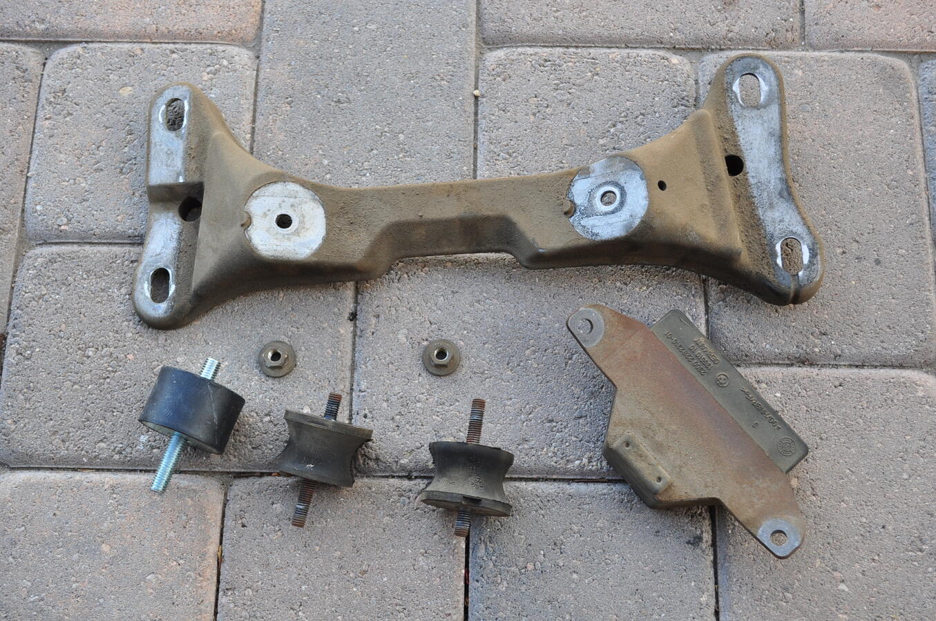

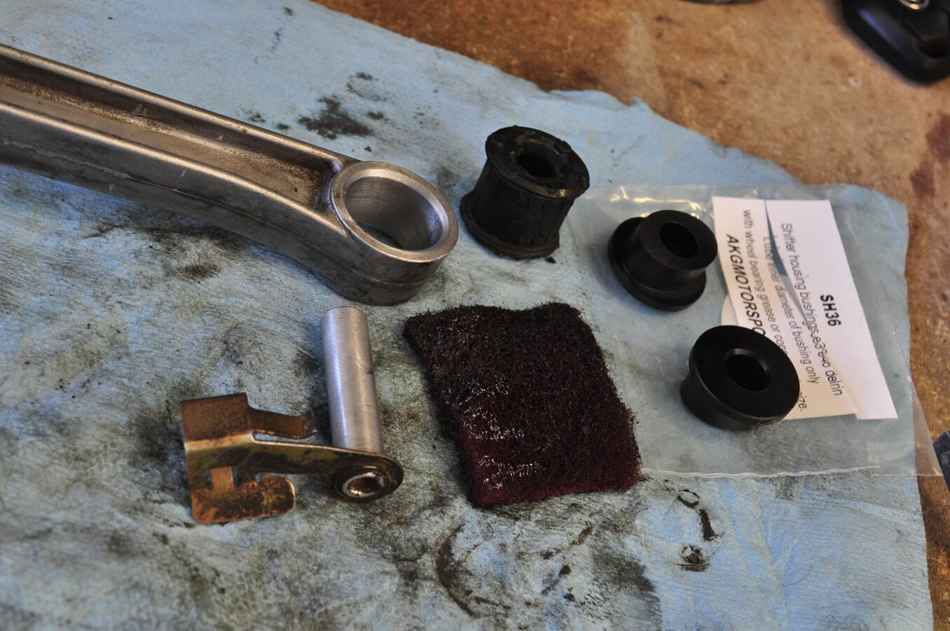

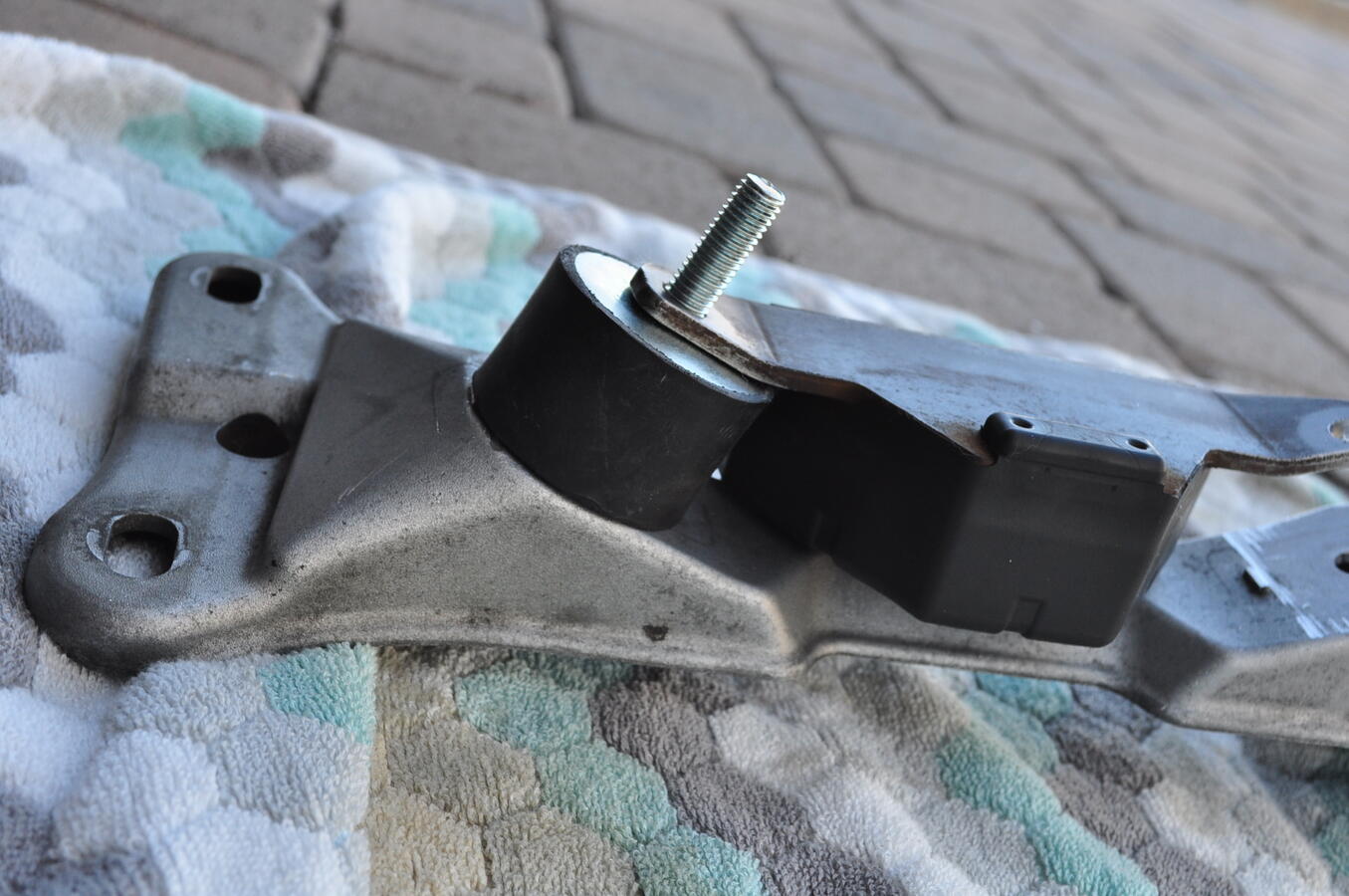

                    Next, I support the tranny w/ jack and drop the brace with dampener and bushings, To the left is my replacement bushing, a BMW part from E21! Much beefier, similar to my favorite the Rogue Eng versions. This one requires some modifications which I'll show, but I also did a DIY thread about this - see here: https://nam3forum.com/forums/forum/m...mission-mounts
                    Click image for larger version  Name:	tranny11.JPG Views:	0 Size:	283.2 KB ID:	116270
                    Cleaned up
                    Click image for larger version  Name:	tranny12.JPG Views:	0 Size:	283.3 KB ID:	116271

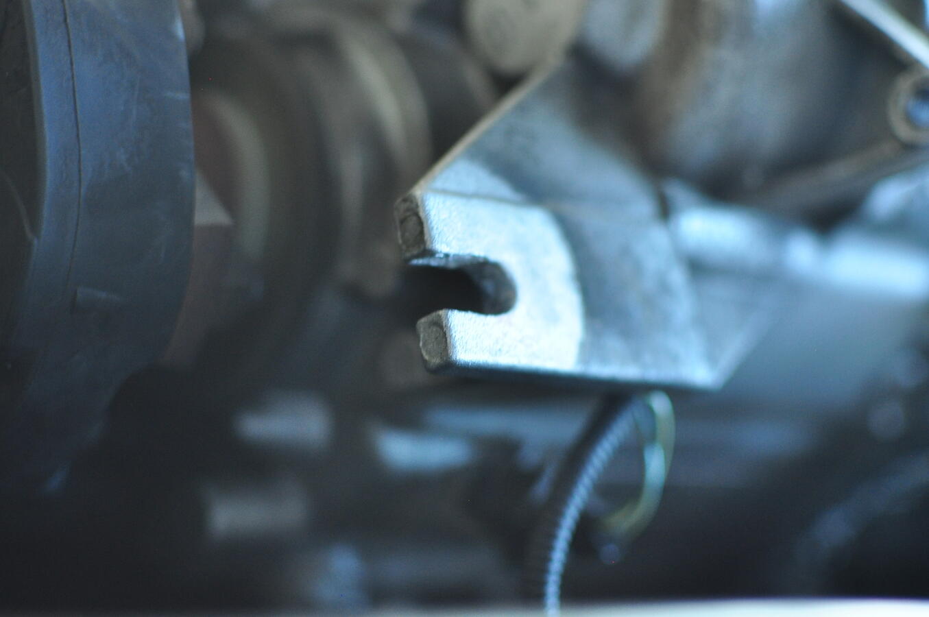

                    The E21 bushings aren't notched to fit our brace, so notch them or file/grind off the notch (or, at least, enough of it)
                    Click image for larger version  Name:	tranny13.JPG Views:	0 Size:	238.6 KB ID:	116272
                    There we are. The holes in the brace and the dampener need to be enlarged by 1.xmm to accept the larger M10 stud vs stock M8. Takes a second with a drill bit or even a reamer.
                    Click image for larger version  Name:	tranny14.JPG Views:	0 Size:	137.8 KB ID:	116273
                    The slots on the tranny's "feet" also need to be opened up by a hair over 1mm:
                    Click image for larger version  Name:	tranny15.JPG Views:	0 Size:	69.0 KB ID:	116274

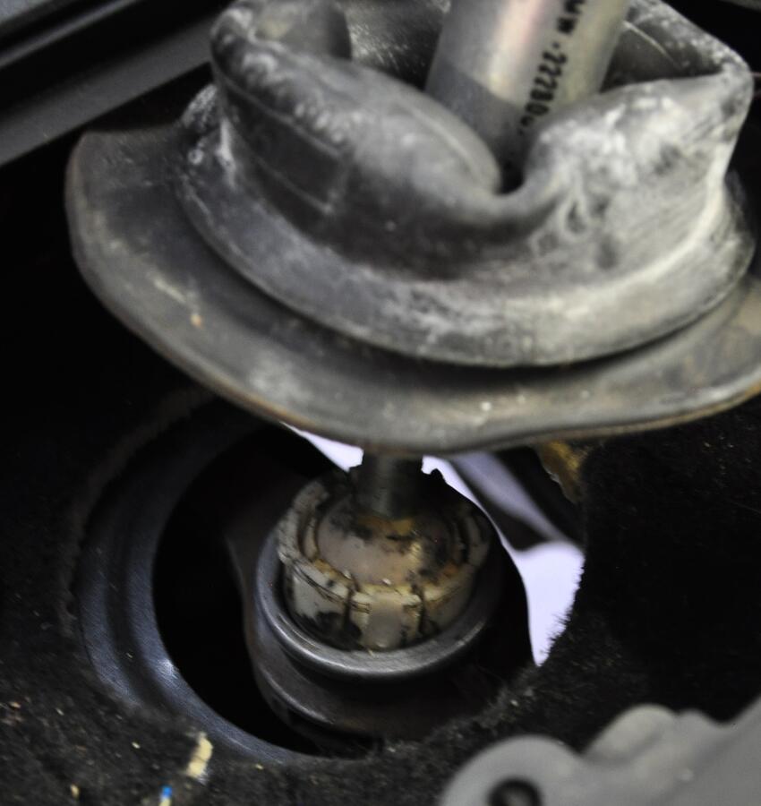

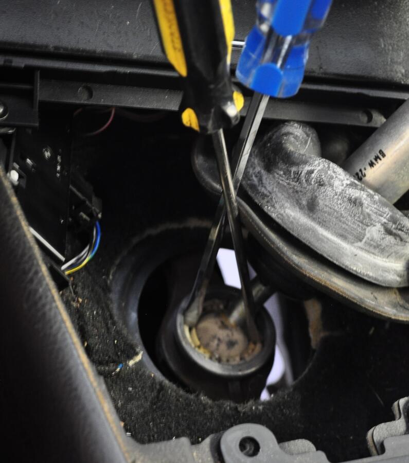

                    Not installing it yet as I need access to the shift linkage. I don't drop the driveshaft, so this job (underneath part) fucking sucks.
                    Removing shifter. I use two long flat head drivers, against each other, to clock the shifter cup enough to pop out:
                    Click image for larger version  Name:	tranny16.JPG Views:	0 Size:	72.0 KB ID:	116275
                    Click image for larger version  Name:	tranny17.JPG Views:	0 Size:	56.9 KB ID:	116276

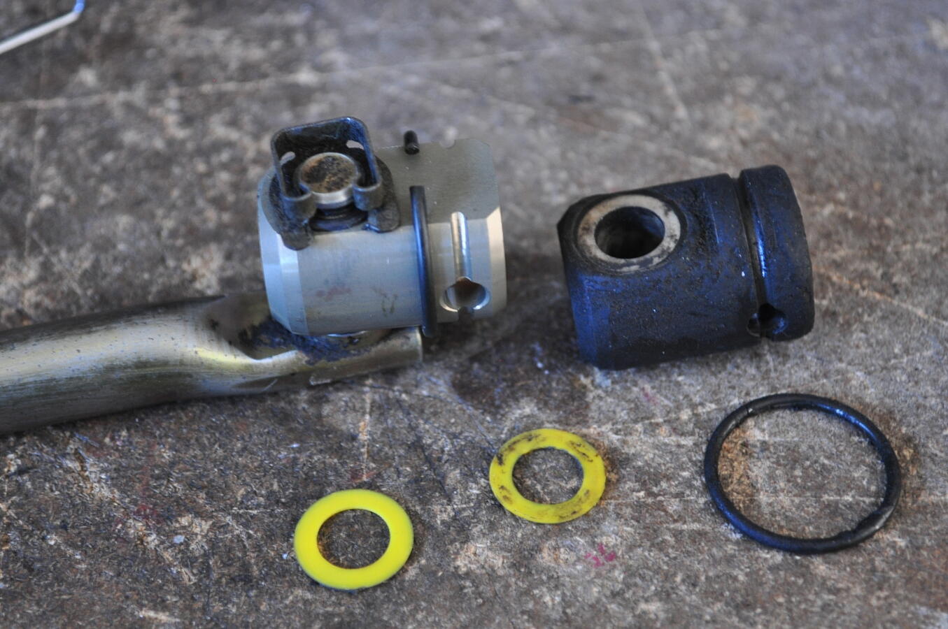

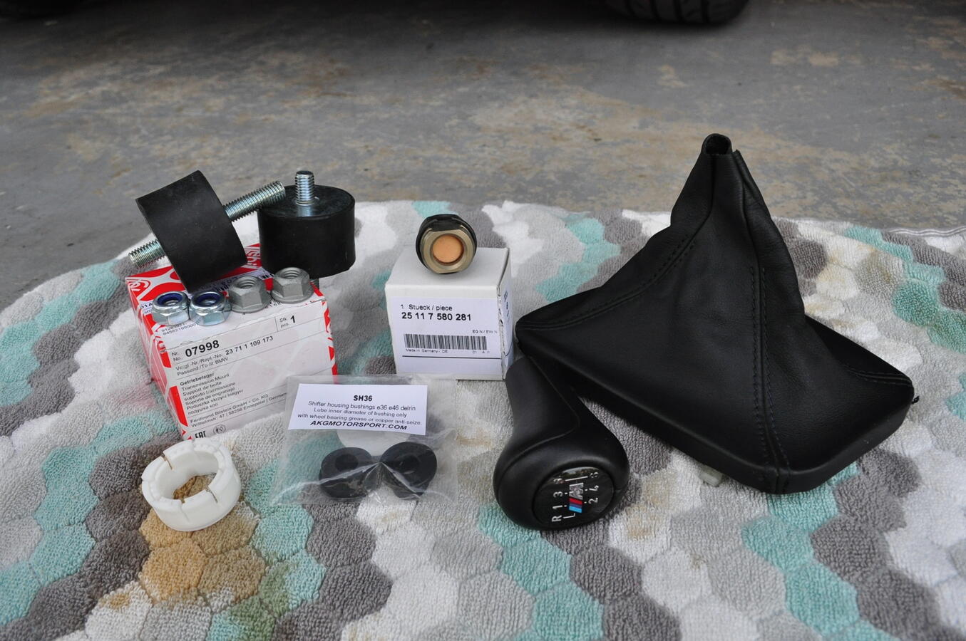

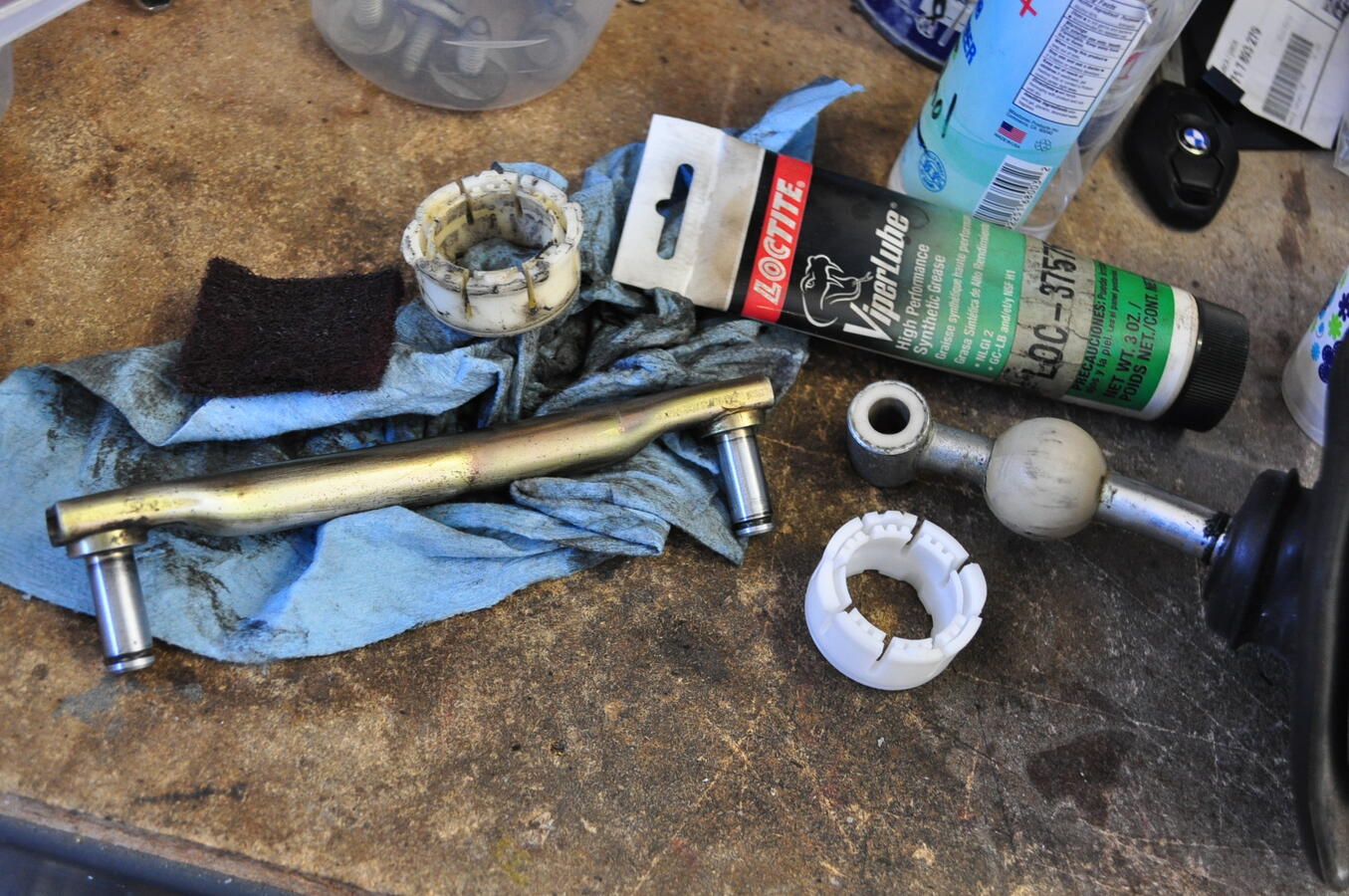

                    Here's my little "refresh kit." New OE/M parts; the selector joint is very important, but also a key aftermarket part I love- the delrin/nylon front carrier bushings
                    Also pictured is my favorite shift knob which I'll speak about farther down.
                    Click image for larger version  Name:	tranny18.JPG Views:	0 Size:	174.3 KB ID:	116277

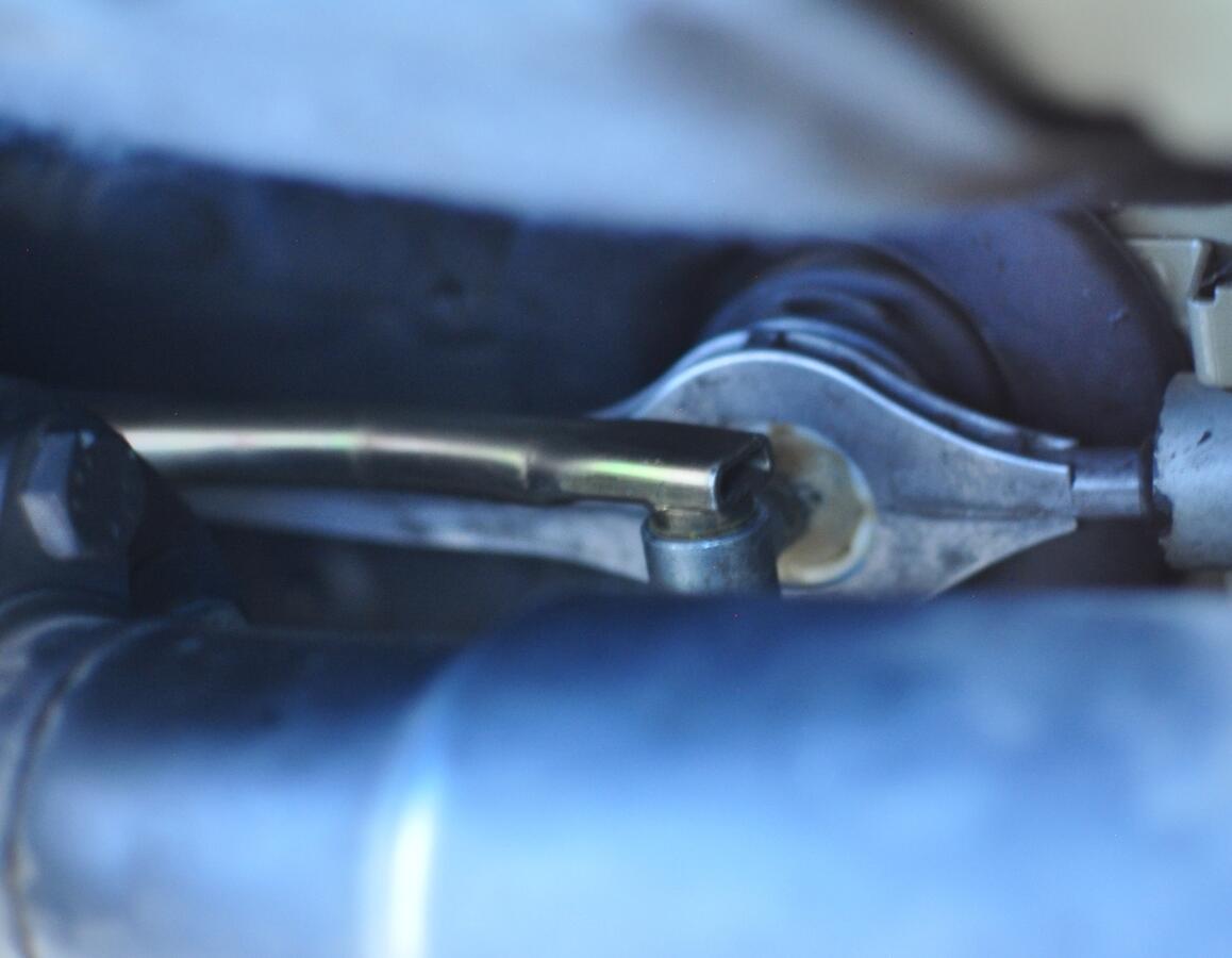

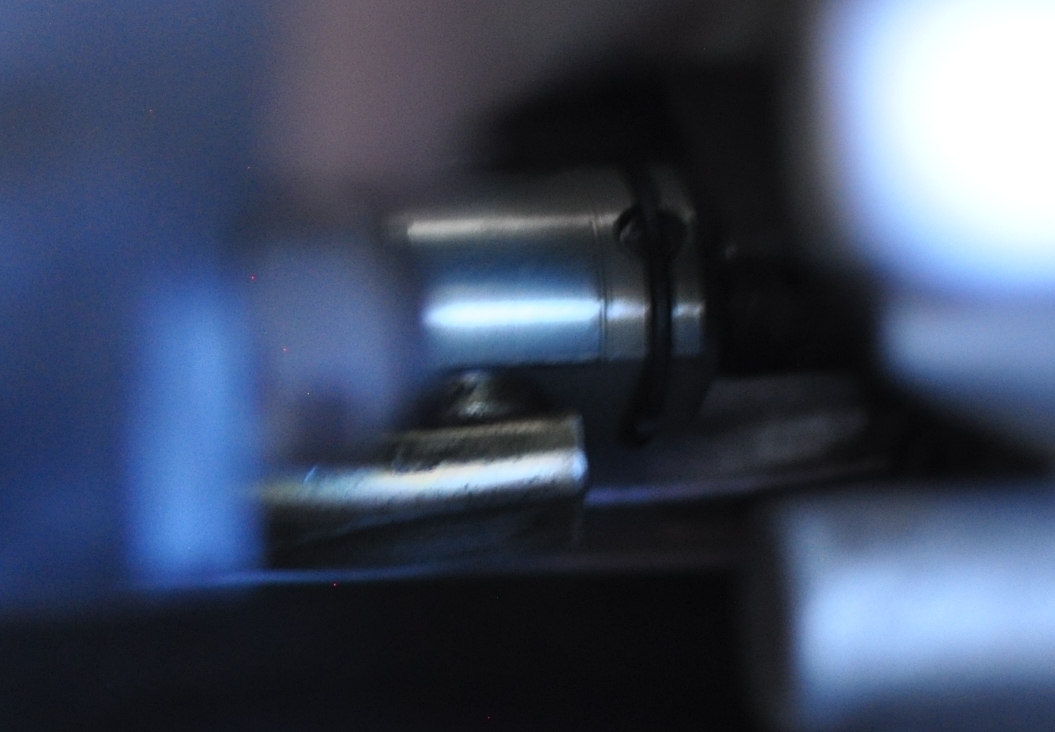

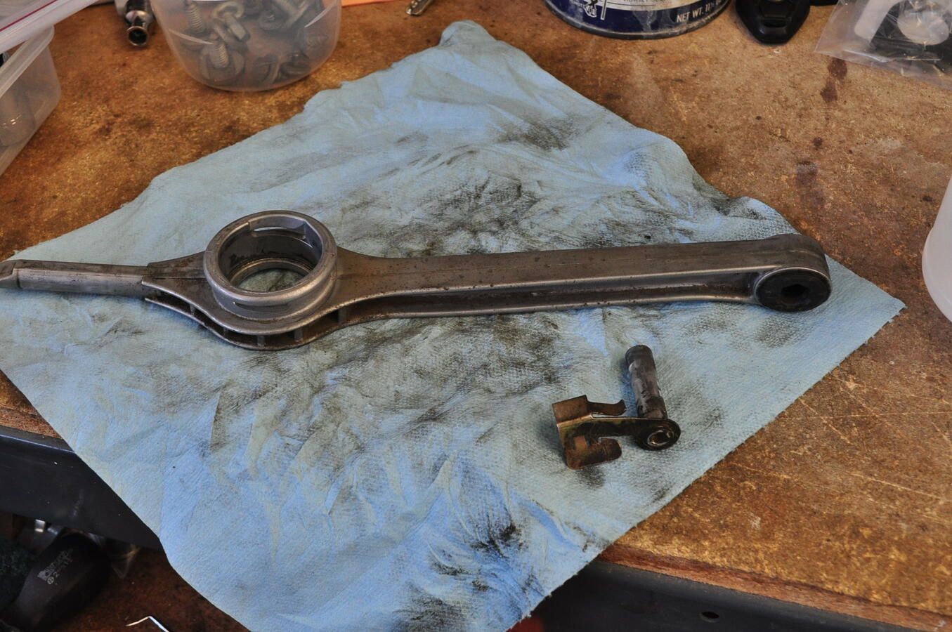

                    Removing the linkage. Hard to get pics. It's dark, tight, and generally unpleasant getting this stuff out with tranny in place.
                    Click image for larger version  Name:	tranny19.JPG Views:	0 Size:	199.9 KB ID:	116278 Click image for larger version  Name:	tranny20.JPG Views:	0 Size:	178.9 KB ID:	116279 Click image for larger version  Name:	tranny21.JPG Views:	0 Size:	227.3 KB ID:	116280 Click image for larger version  Name:	tranny22.JPG Views:	0 Size:	167.2 KB ID:	116281

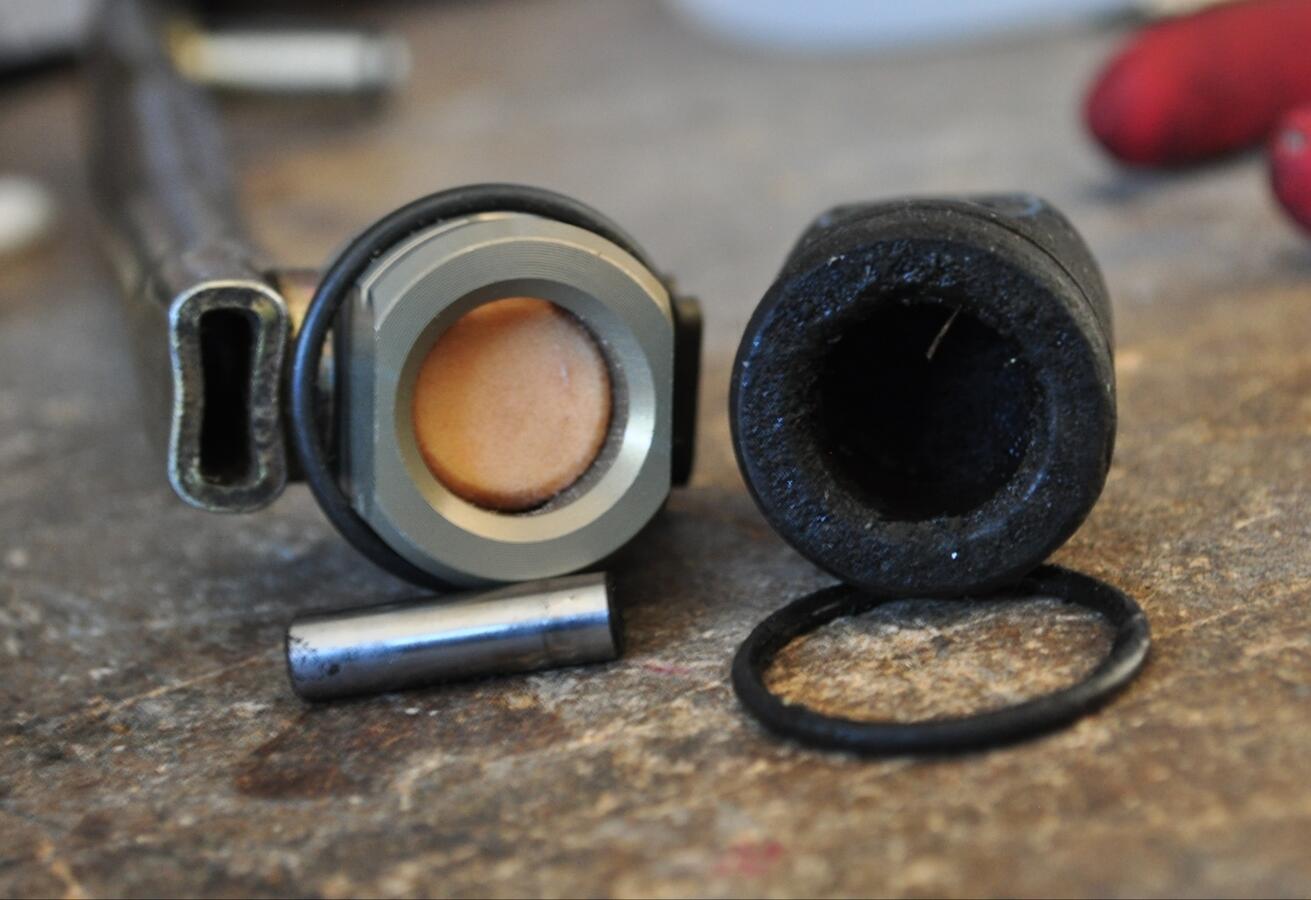

                    As you can see, I pre-installed the selector rod onto the joint. I hope this saves me some work. It's hard enough to install the damn joint.
                    The foam in the joint was obliterated lol. A new one is largely responsible to tightening up the slop (along with the carrier bushes)
                    Click image for larger version  Name:	tranny23.jpg Views:	0 Size:	97.1 KB ID:	116283
                    FUCK YOUUUUUUUUUUUU. Hardest thing I've ever done on these god damn cars. Took a while. The selector rod actually even helped, giving me more to use to push the foam onto the tranny's rod end. Getting it in far enough AND the little pin through was a nightmare. I even beveled the pin to make life easier. I shudder to think what if I hadn't.
                    Click image for larger version  Name:	tranny24.jpg Views:	0 Size:	376.4 KB ID:	116282
                    Rod attached to shifter that's back in the car with fresh lube and cup

                    Tranny brace, dampener and bushings going in. Those damn M10 nuts on top were a bitch to tighten. Ended up having to use a ratcheting end wrench to get any swing - socket wouldn't fit!
                    Click image for larger version  Name:	tranny26.JPG Views:	0 Size:	93.9 KB ID:	116285

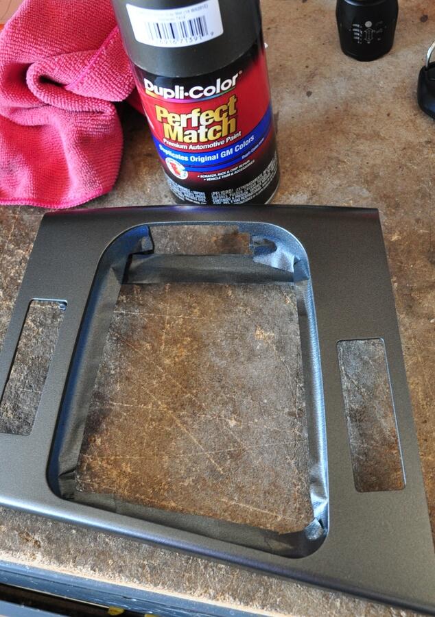

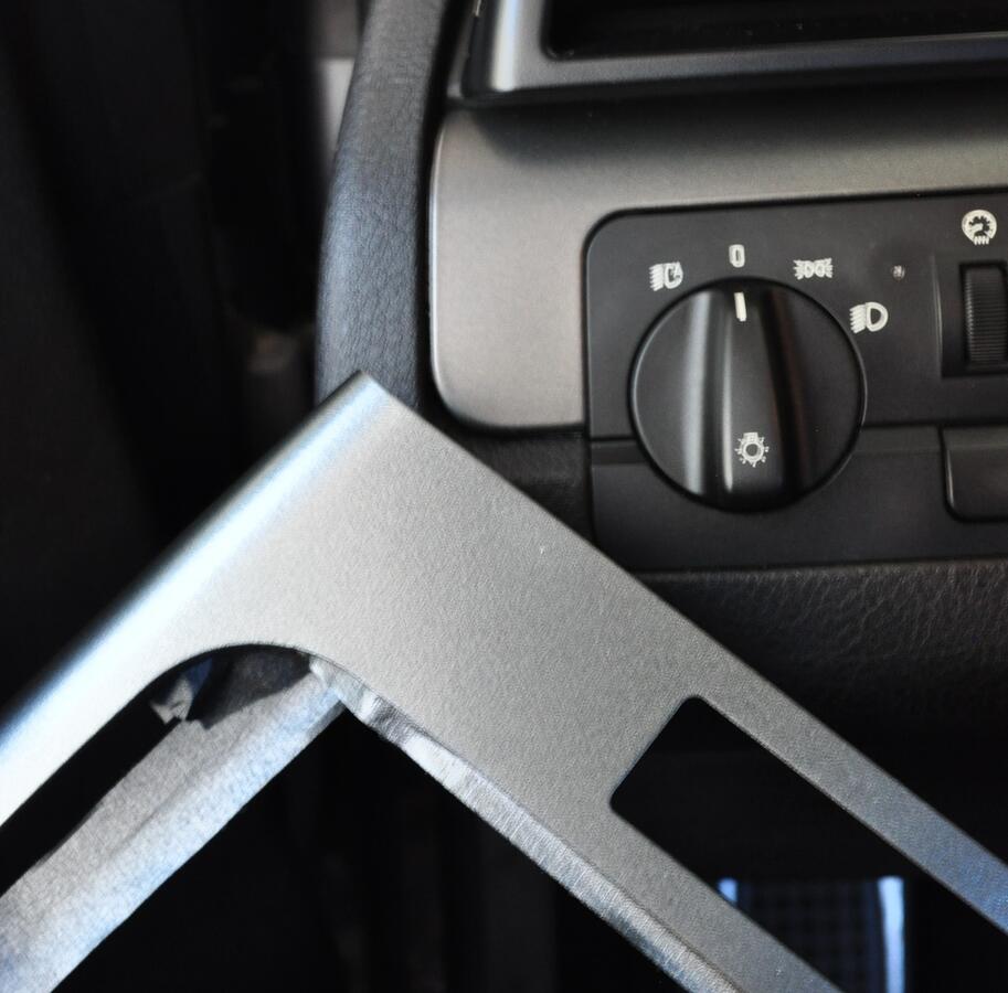

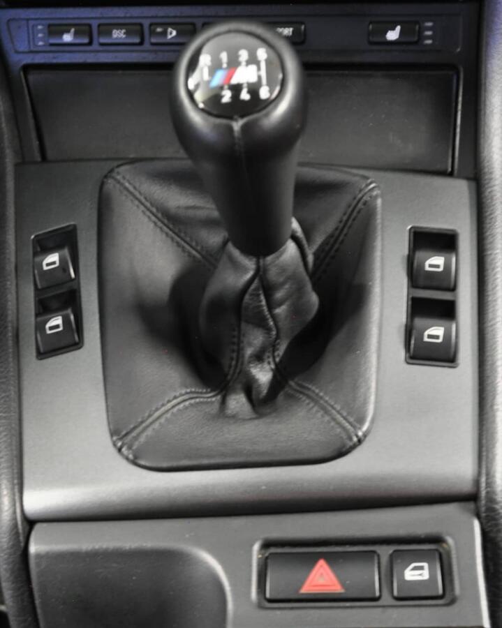

                    Before I finish the inside, I wanted to DIY the trim. I actually had found a new trim for $30 (they used to be $17 on ECS like a year ago!), but when the price shot up to $60, the seller "lost" my package. Seems like the best match to Titan is the "storm grey met" from Dupli color's perfect match system:
                    Click image for larger version  Name:	tranny28.jpg Views:	0 Size:	111.8 KB ID:	116286
                    It's a very good match, but it lacks any hue of color. Titan has a gold tint to it. I didn't think it was that far off, but once installed, it's more noticeable. I have a plan that I'll document later.
                    Click image for larger version  Name:	tranny29.JPG Views:	0 Size:	68.3 KB ID:	116287

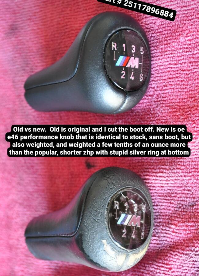

                    Here's more detail on the shift knob for those interested. I run it in my other car too. It's the best of everything- looks, height, weight, design/feel. But it isn't lit.
                    Click image for larger version  Name:	tranny30.jpg Views:	0 Size:	107.7 KB ID:	116289

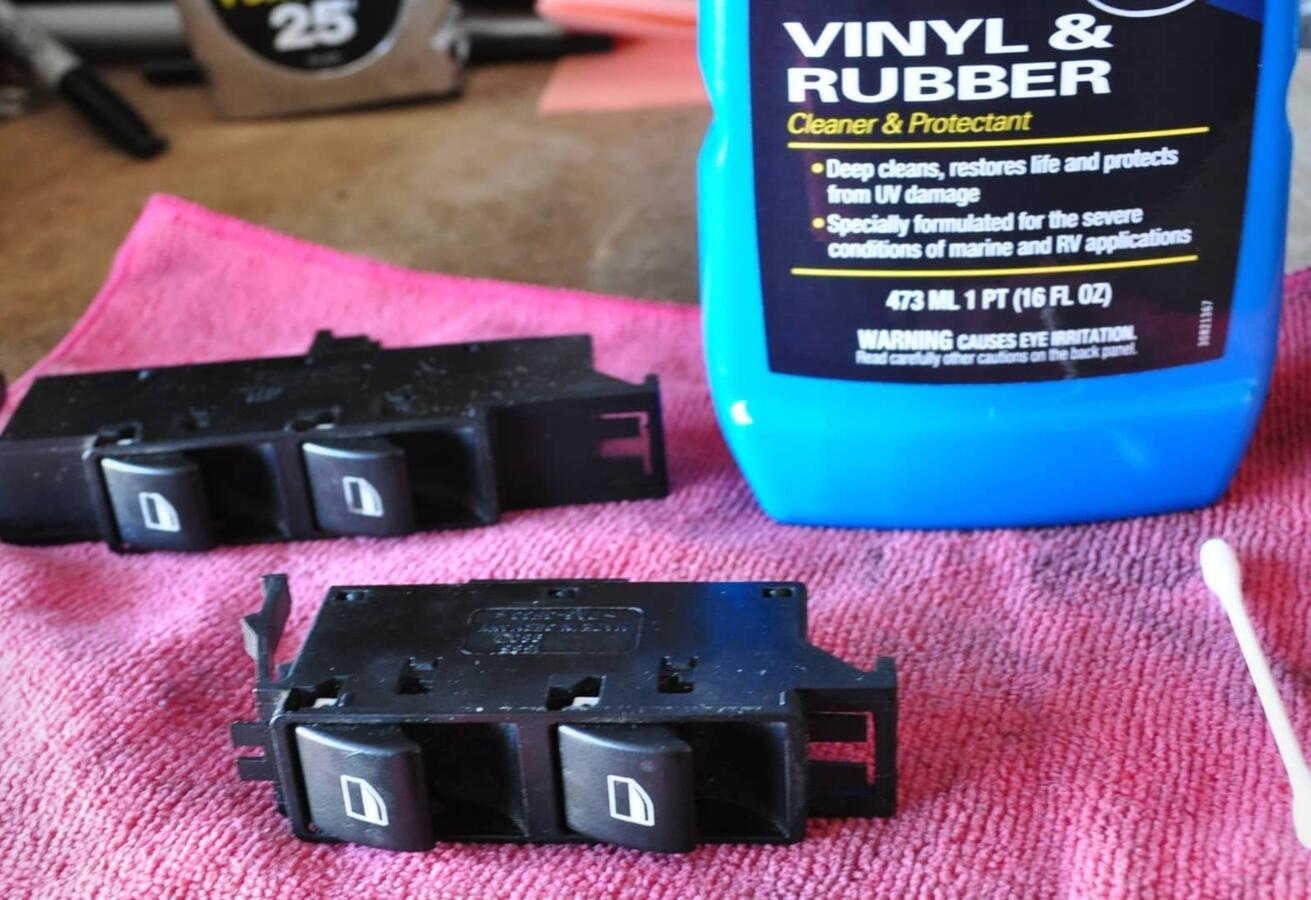

                    Cleaning (protectant & a Q-tip) window switches before re-install:
                    Click image for larger version  Name:	tranny31.jpg Views:	0 Size:	145.3 KB ID:	116292
                    Click image for larger version  Name:	tranny32.jpg Views:	0 Size:	54.6 KB ID:	116290 Click image for larger version  Name:	tranny33.jpg Views:	0 Size:	56.0 KB ID:	116291

                          I thought me and my buddy were the only ones who hated the silver ring on the zhp knob LOL!!!
                          Man props to you for doing that shifter bullshit, no way could I man fuck that.

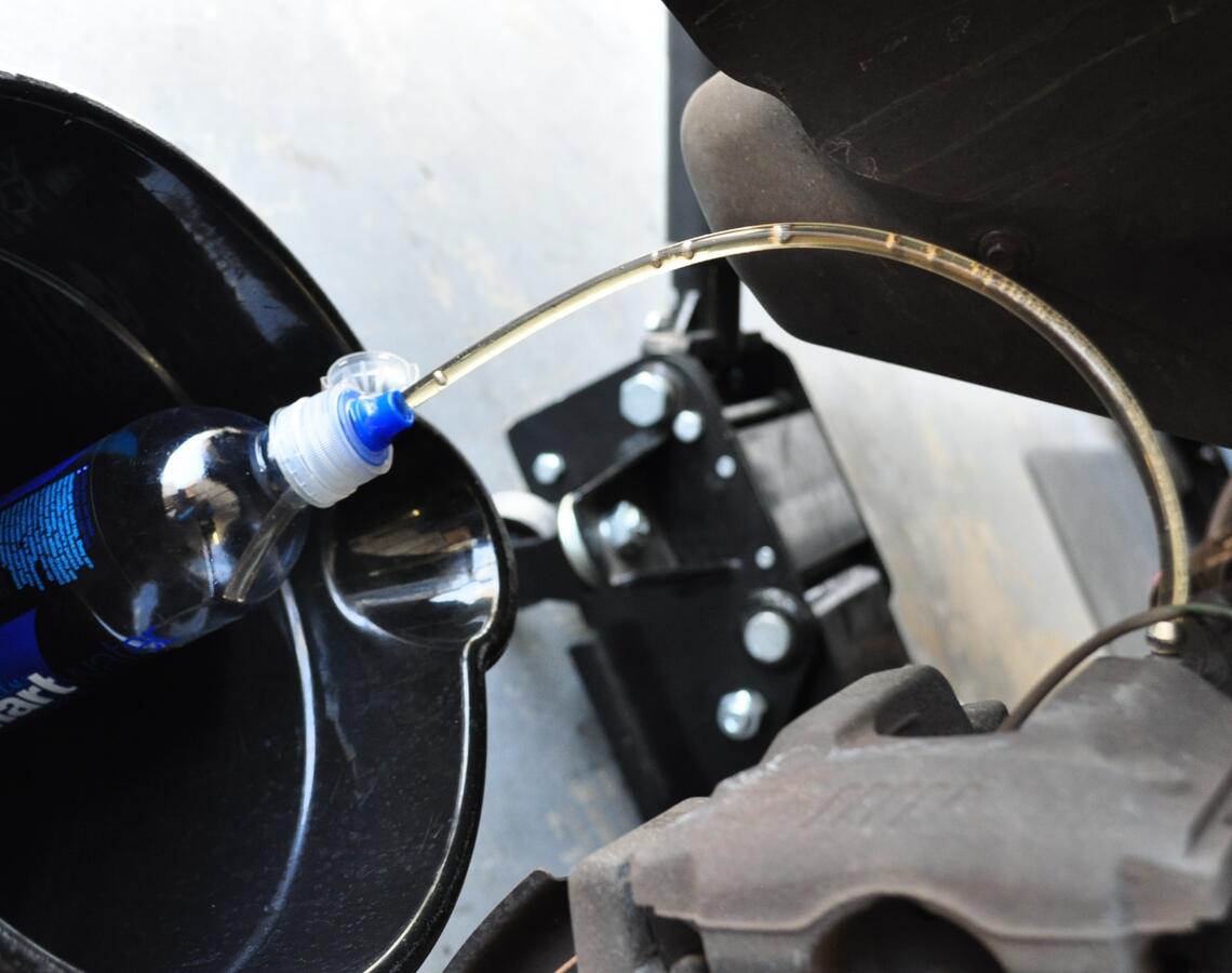

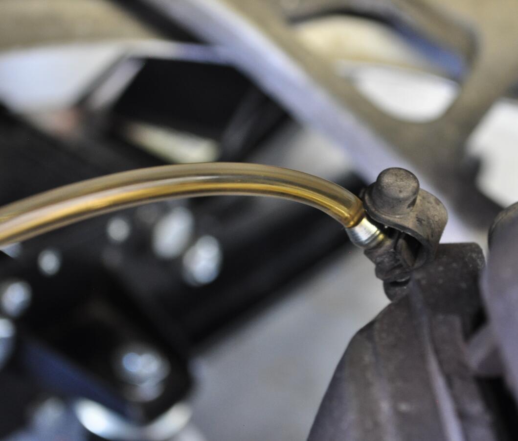

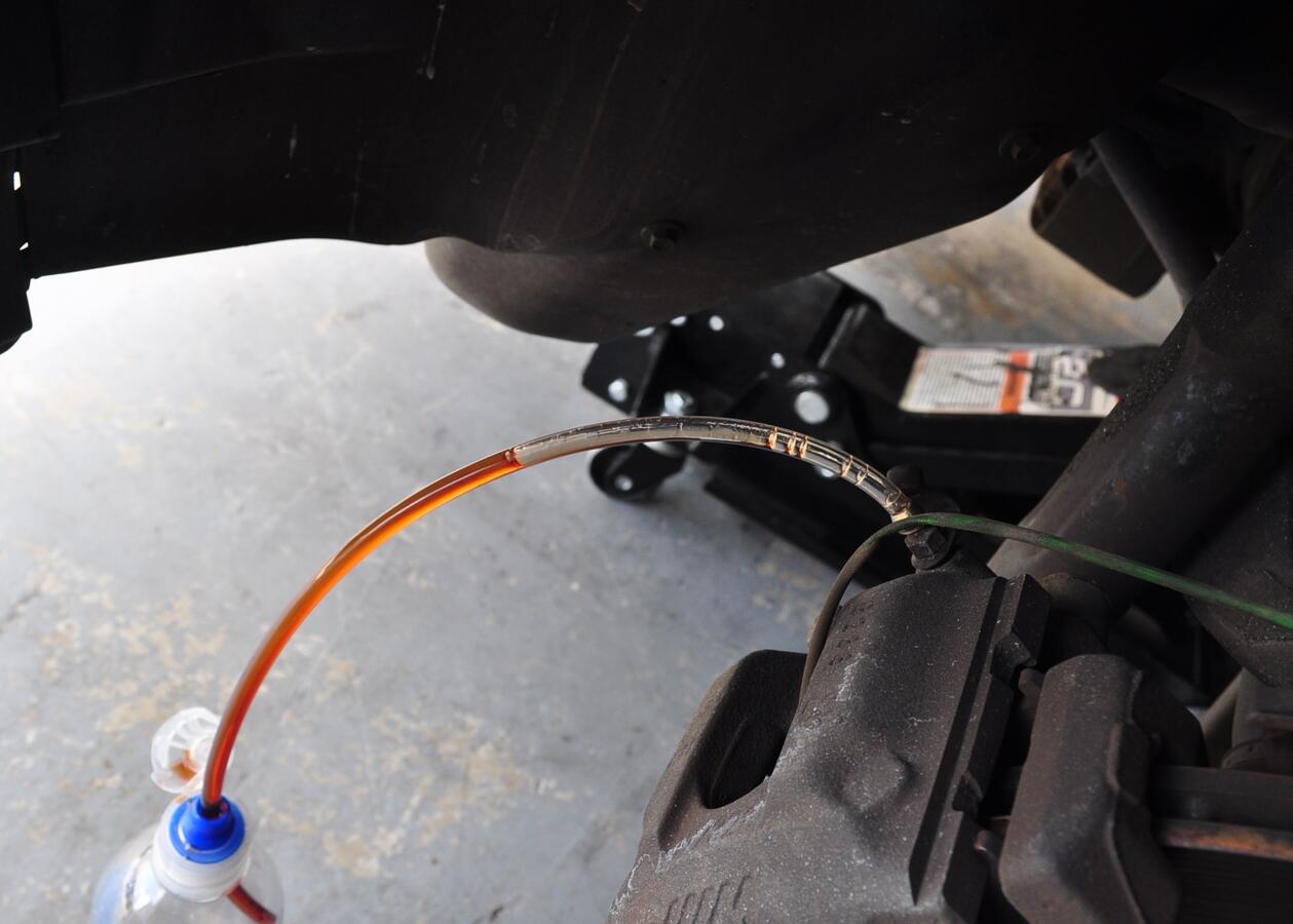

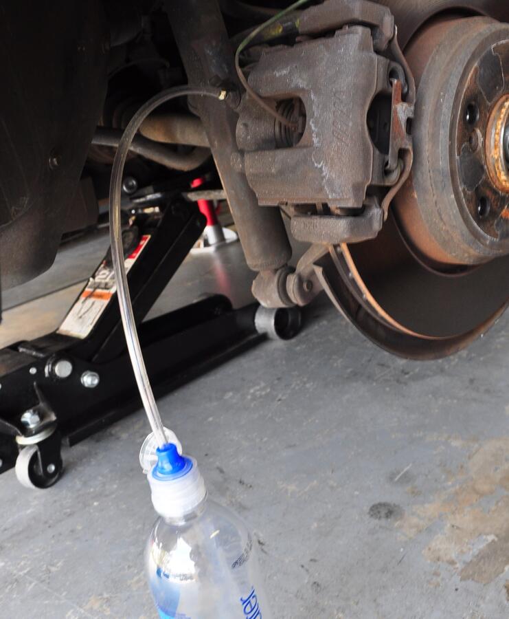

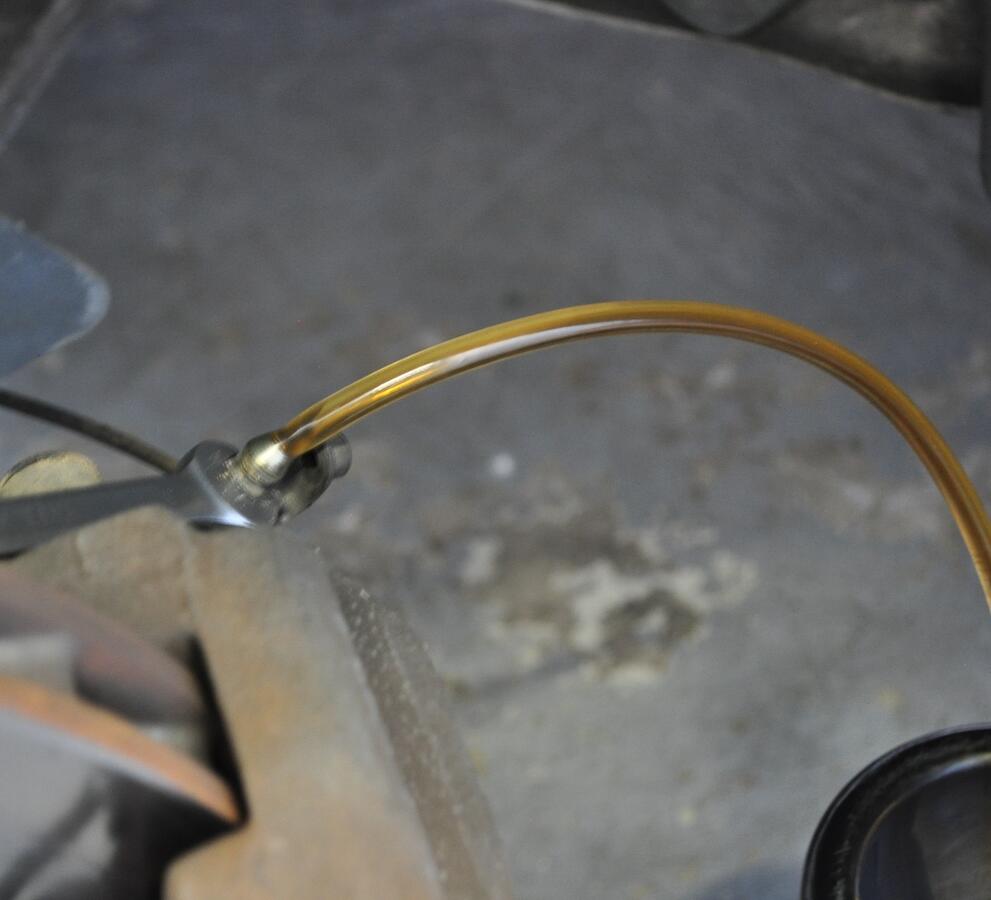

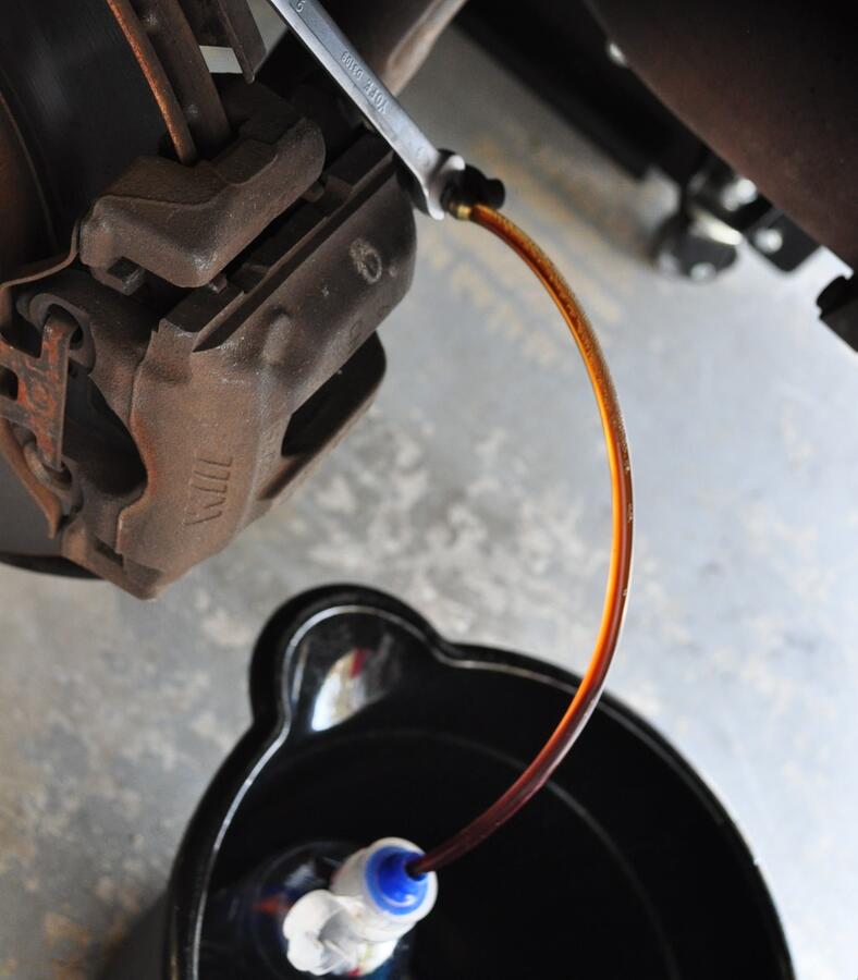

                            Brake flush/inspection

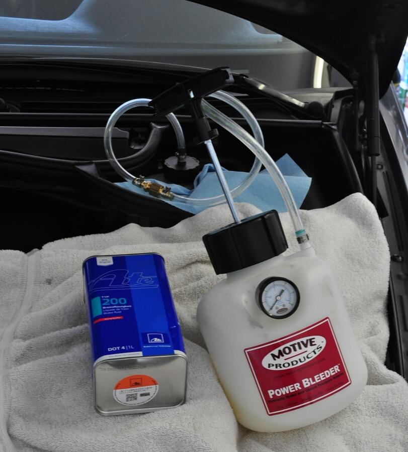

                            The brakes work very well as far as grab/bite, but the pedal was spongy and would depress too far before grabbing well. I was pretty sure it just needed a flush.
                            Used a motive euro bleeder and my go-to ATE typ200 fluid.

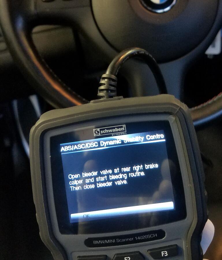

                            Used the schwaben scanner tool to activate ABS routines (proper bleeding proceedure)

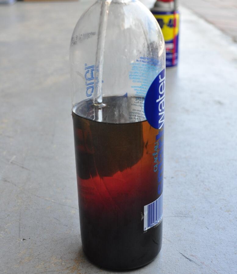

                            Starting at passenger rear. A SMART water bottle's cap fits the 1/4" hose perfectly! There's enough tension that the hose won't slip in or out while bleeding

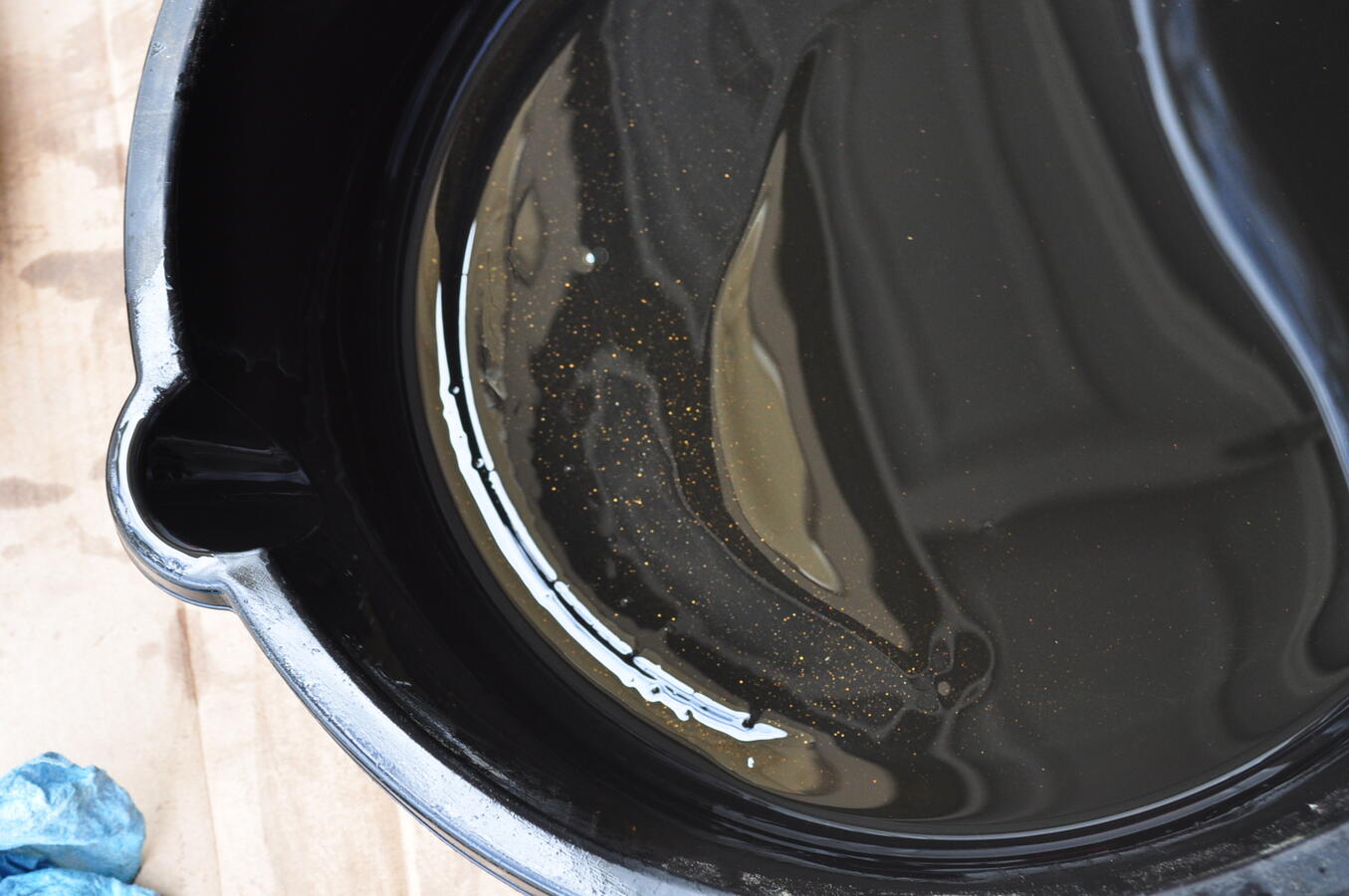

                            Wow, did someone use ATF as brake fluid? The dirtiest fluid I've ever seen!

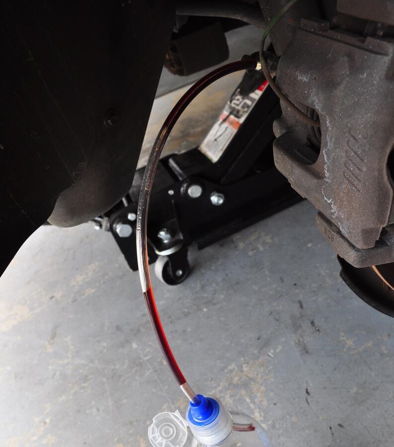

                            Getting clearer, lots of air
                            Finally. Took about 3/4 of a liter to get here!

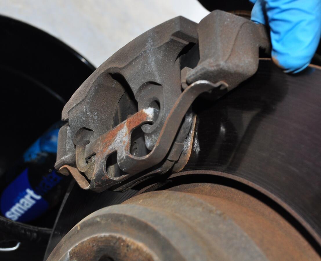

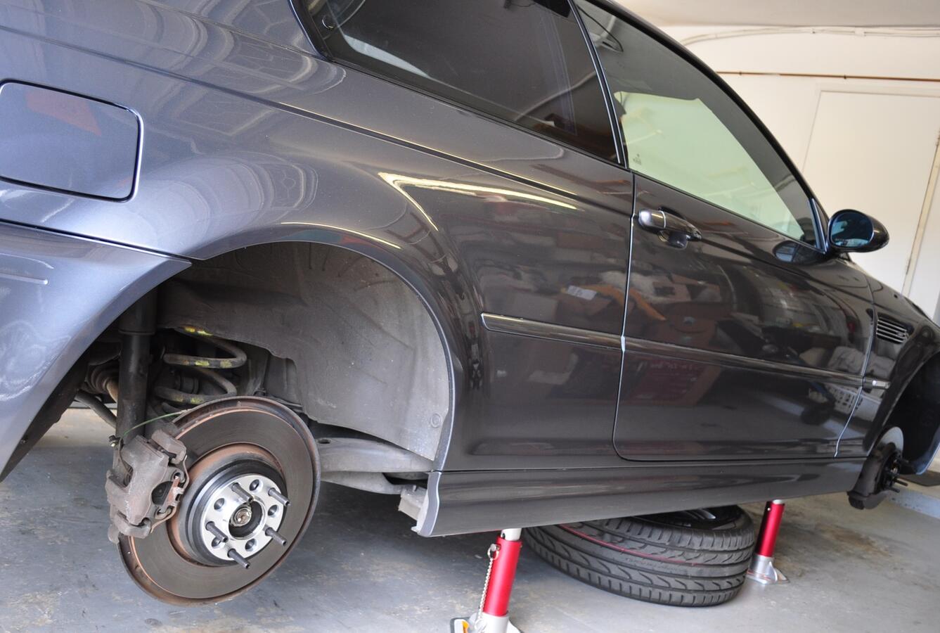

                            Rear rotors have no lip and aren't too grooved. Pads are at least at 50%. Not a priority to rebuild the seals/slider pins, glad to have plenty of life as I don't plan on modding brakes on this car.
                            This was just from passenger rear

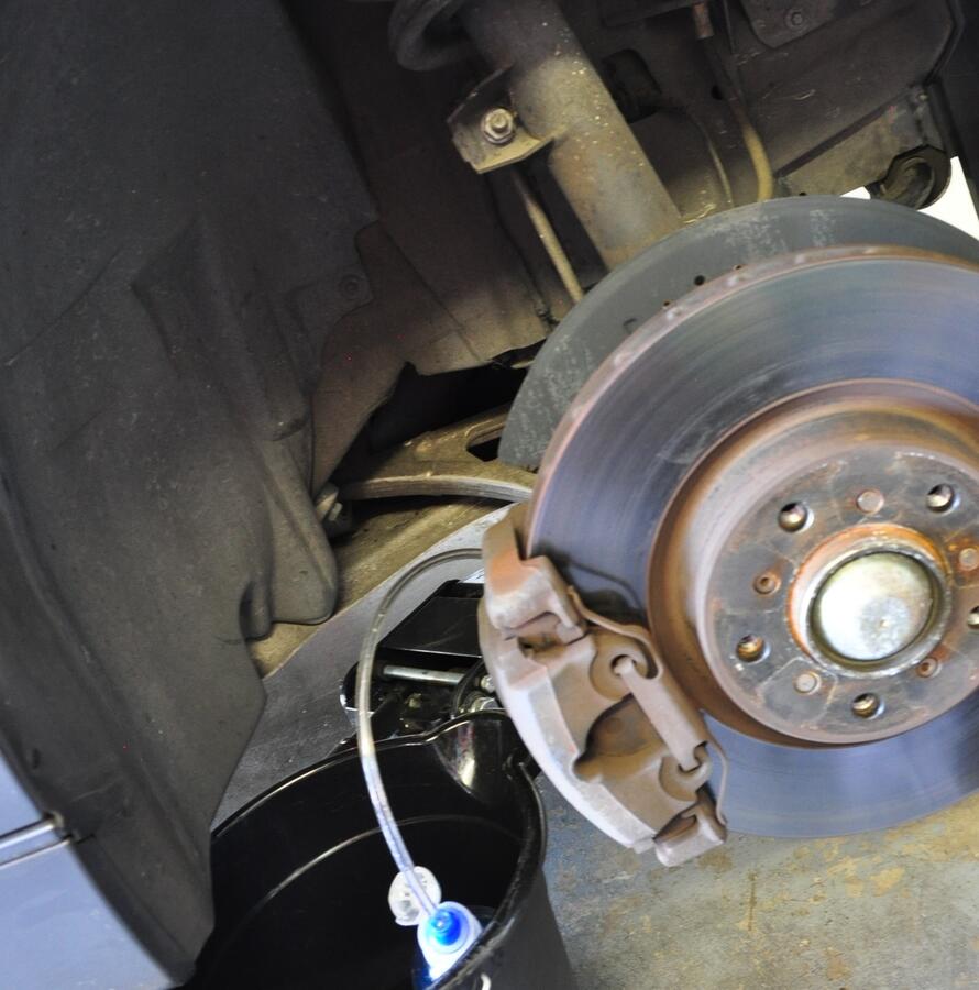

                            Fronts

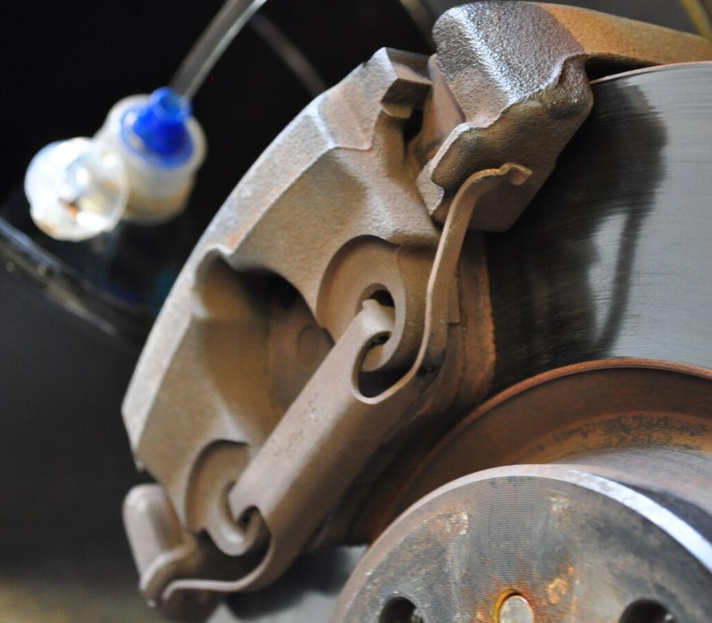

                            Fronts similar to rears. Rotors are about as smooth, not much grooving, a slightly larger lip, but pads are at like 60%. The rotors both front and rear look OE, so at least P.O. didn't cheap out on the replacements.
                            Driver, now clear, no air, all done.

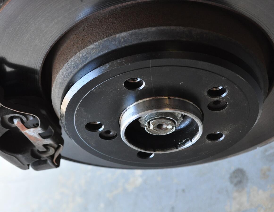

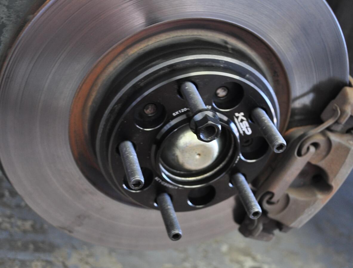

                            Good time to install the wheel studs. Just some generic 75mm (for spacers up to 15mm) with the hex head for easy install. I much prefer my Apex bullet nose, but installing the hex head ones is so easy.
                            Cleaned the rotor hubs' faces, hub lips, and threads.
                            Used red loctite, and let them sit overnight before reassembly.
ID:	117188 Click image for larger version
                            12mm spacers up front, 10mm rear. Going to move to 15mm up front; hoping 12mm will fit in the rear. It's already tight with 10mm, and I will not grind, cut or pull fenders.

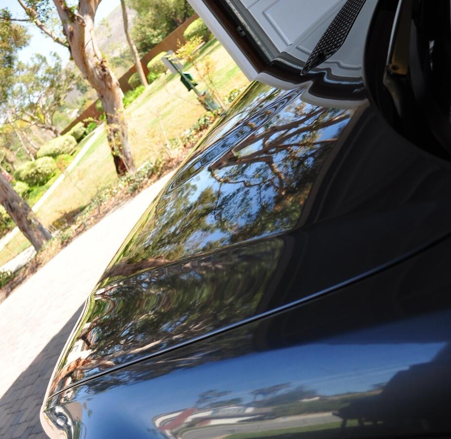

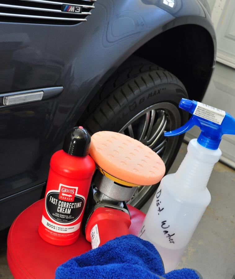

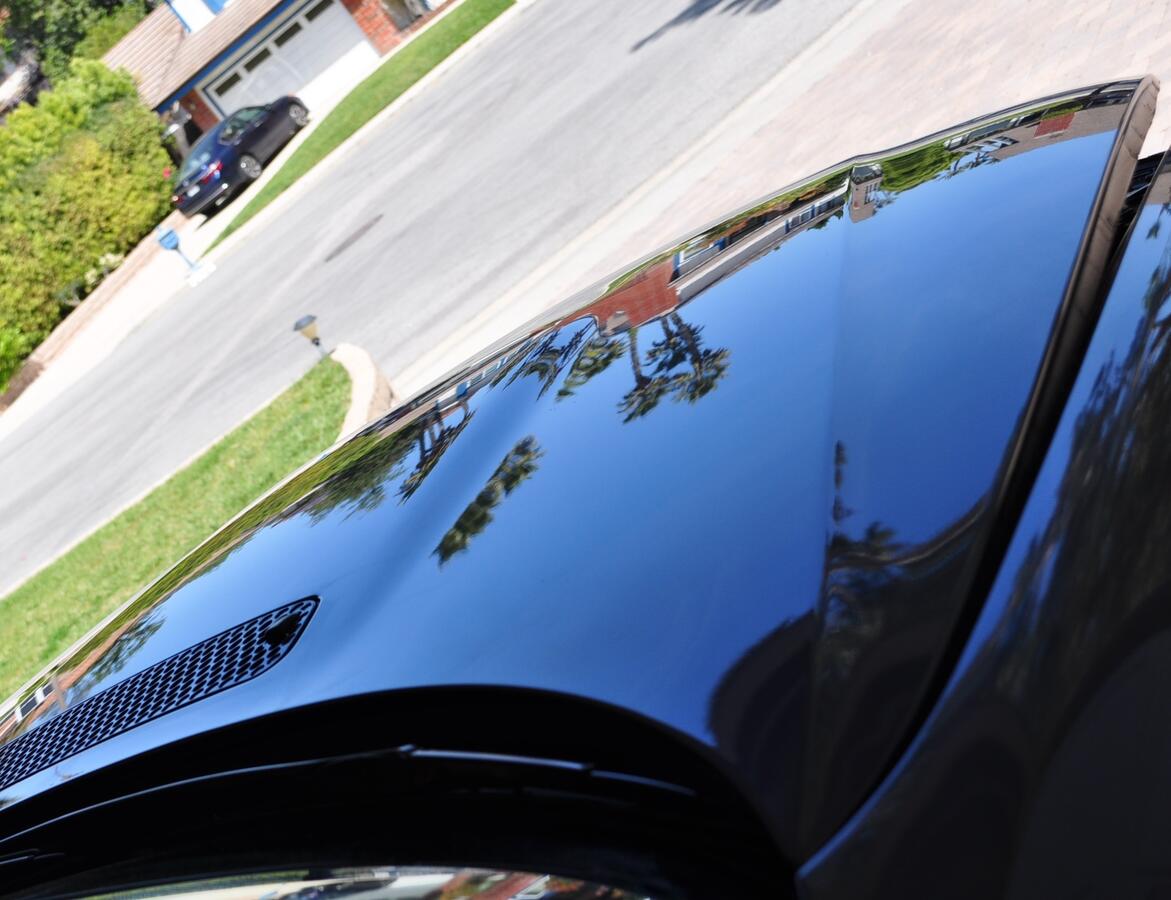

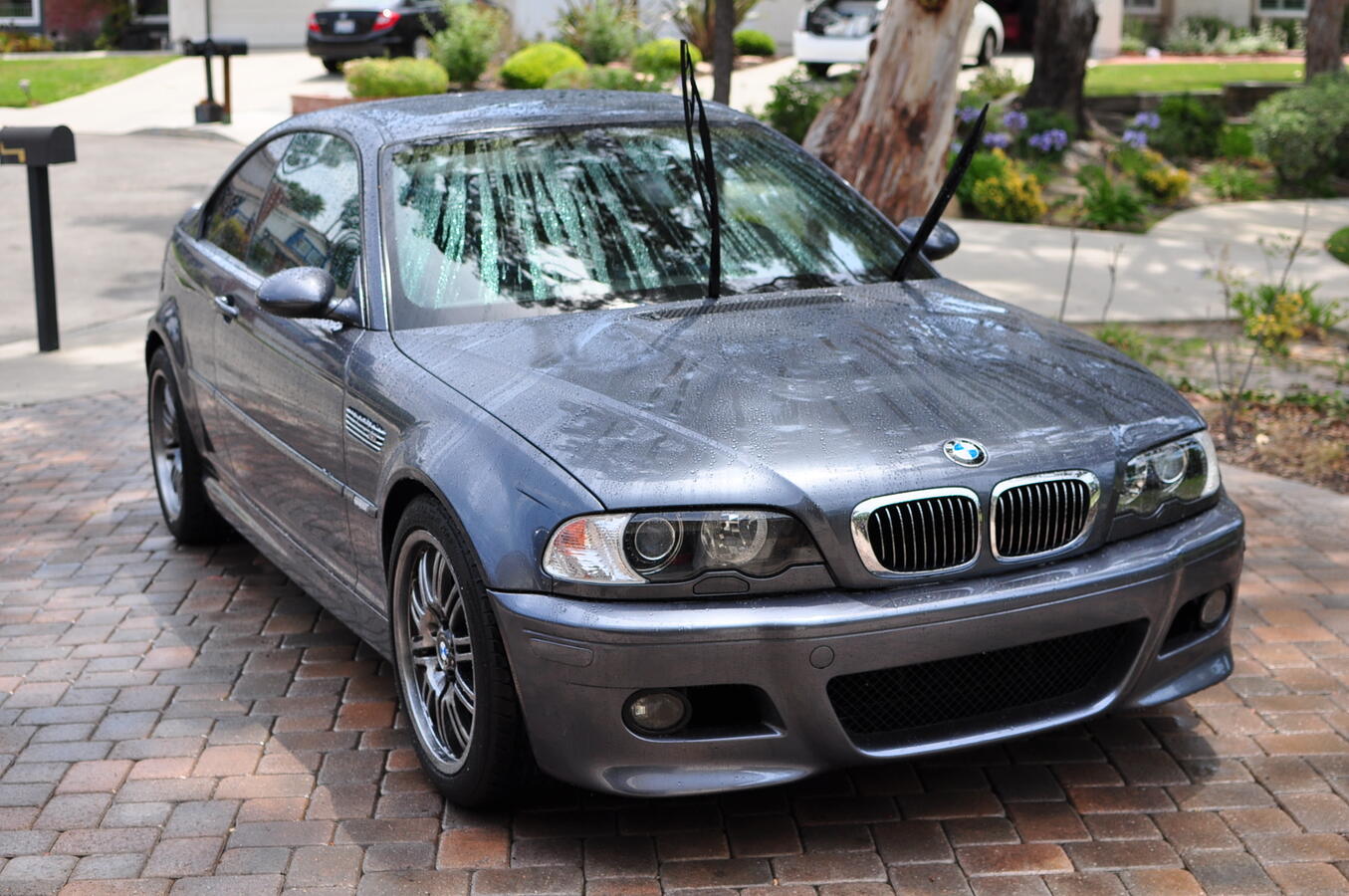

                              Paintwork

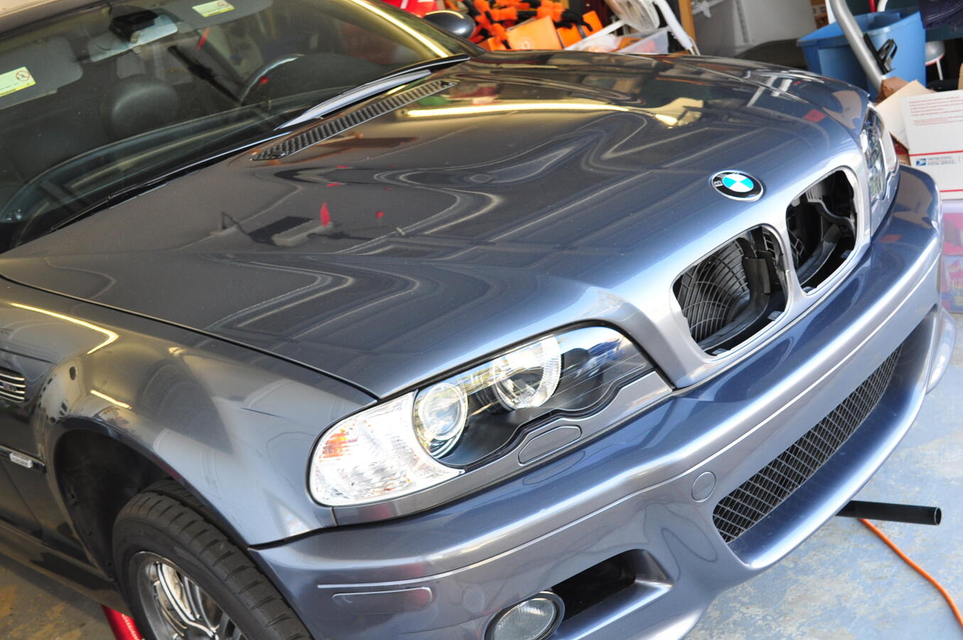

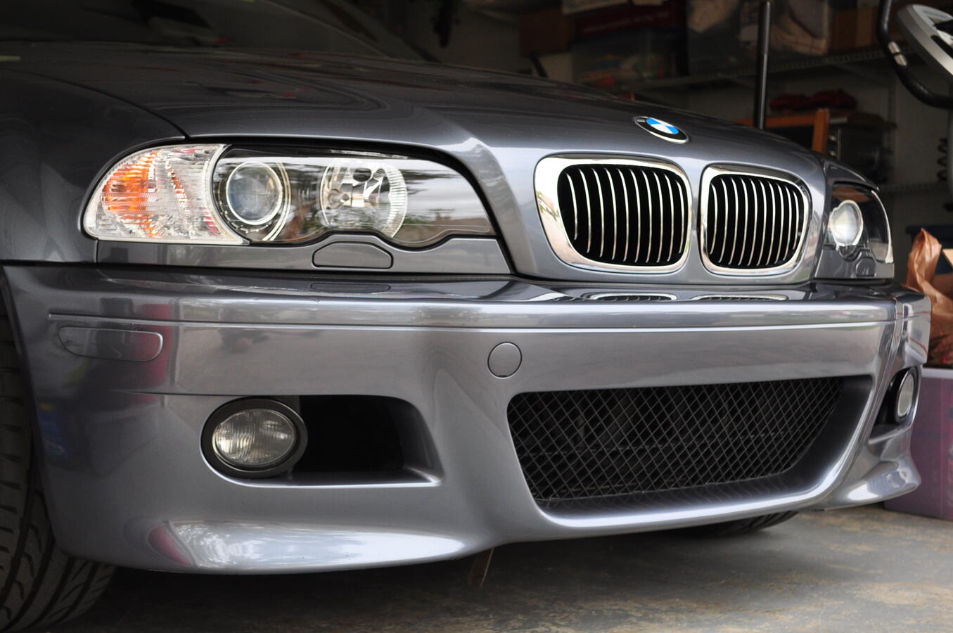

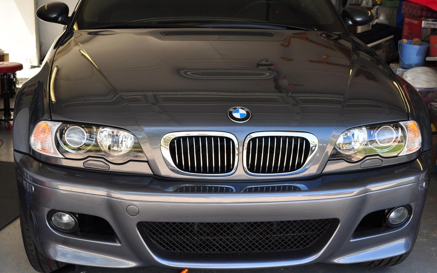

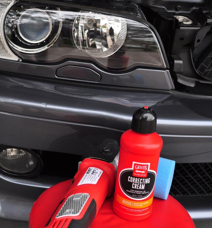

                              Alright, time for some fun! I love polishing paint and seeing the improvement. This isn't a DIY and I don't have pics for everything, but I'll speak about the products used how it went.
                              I don't correct a car's paint in 1 go. I'm in a nice situation where I WFH and the car can sit in the garage while I work. This time, I'm tackling the panels with the most defects: hood, roof & trunk lid; the flat surfaces.

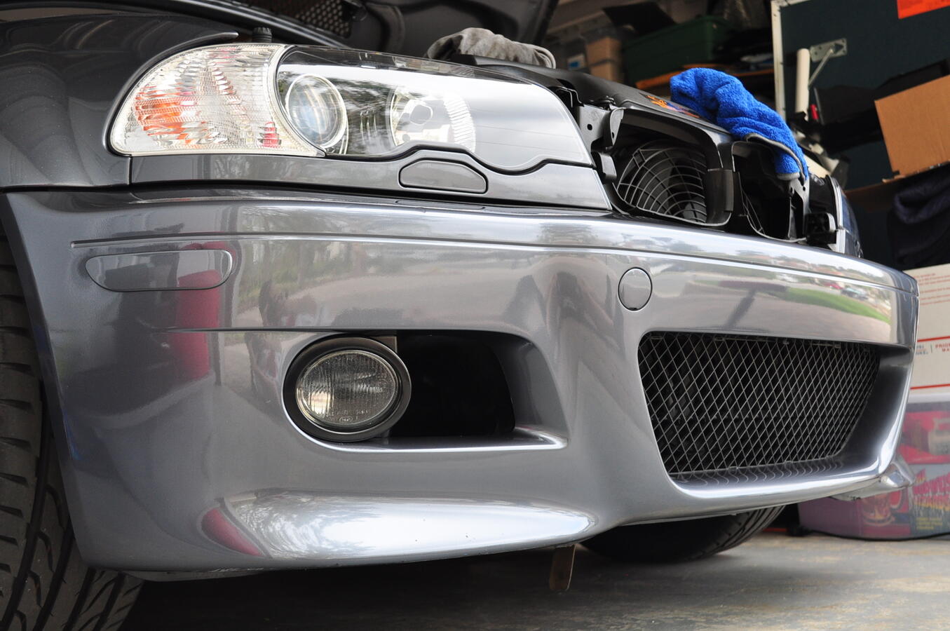

                              Car already washed, got it in the garage and I took the grilles off. The hood vent is old and will be replaced at some point, so not concerned with that. I leave the roundel so that it gets polished (hoping to restore it; don't think I need a new one). I've washed the car a few times now, and use Zymol soap that has wax/polymers in it, so the paint actually already looks better with no decon or polishing simply from the washes (car had zero wax/protection on it when I bought it).
                              Click image for larger version  Name:	PaintCor1.JPG Views:	0 Size:	172.4 KB ID:	117524

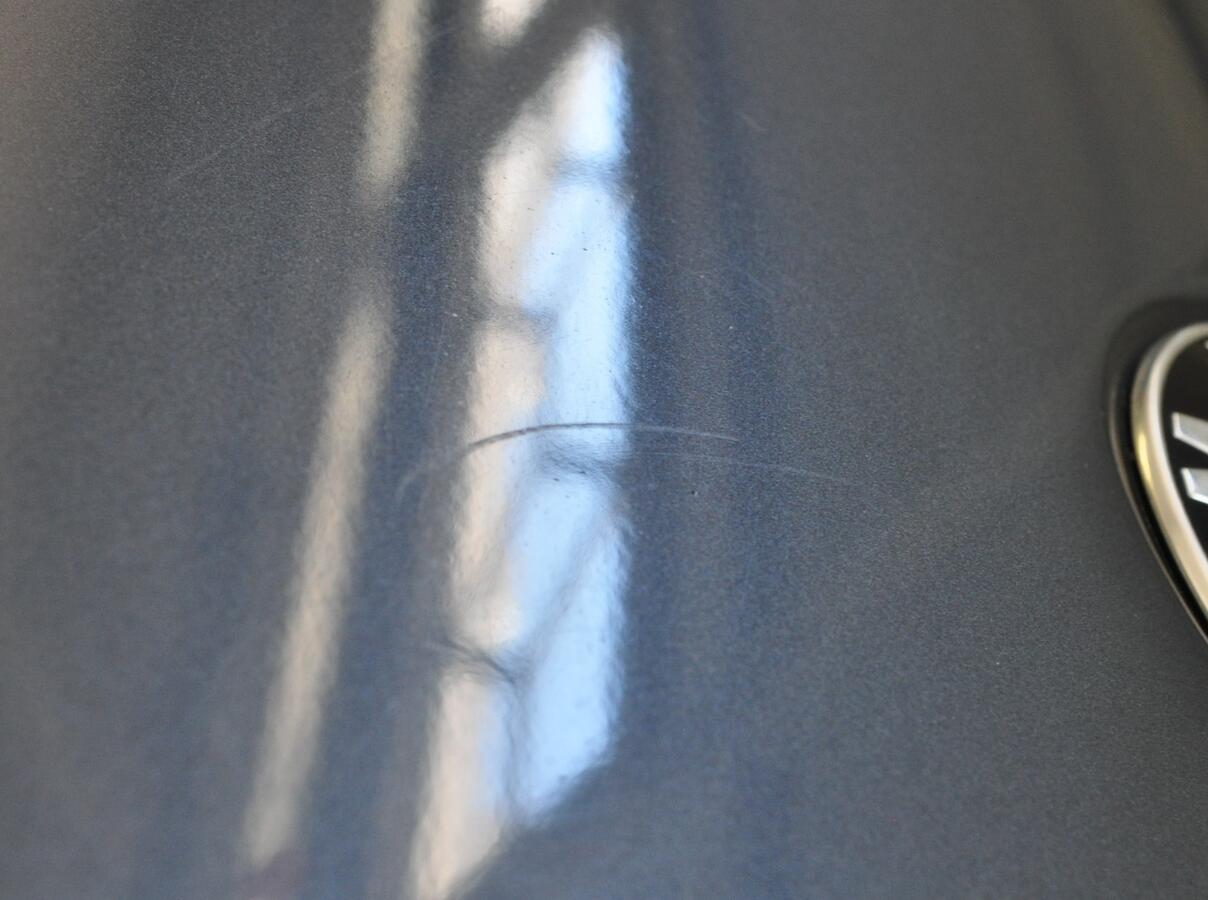

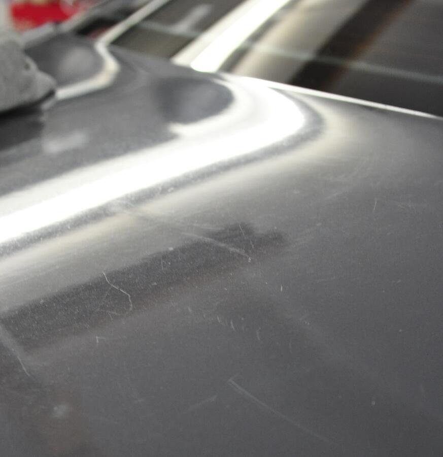

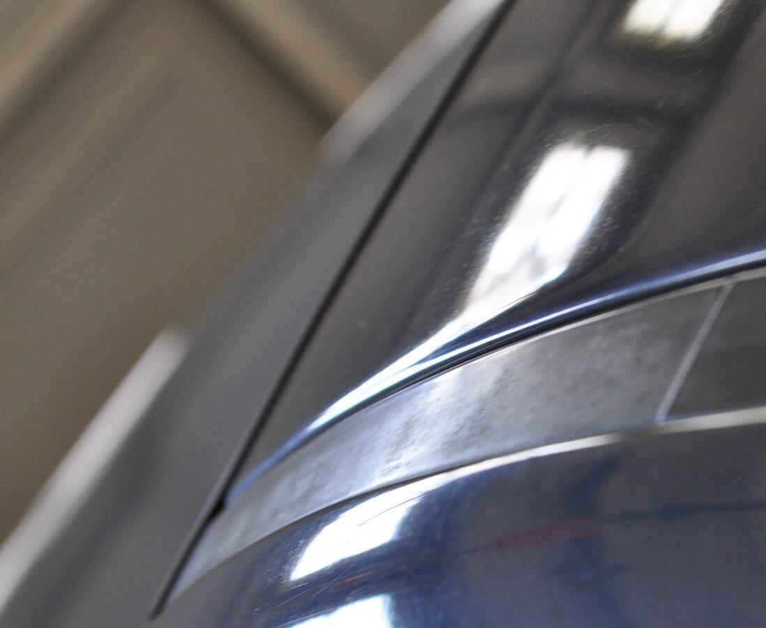

                              Let's look at the defects I'm dealing with:
                              Click image for larger version  Name:	PaintCor2.JPG Views:	0 Size:	37.5 KB ID:	117521

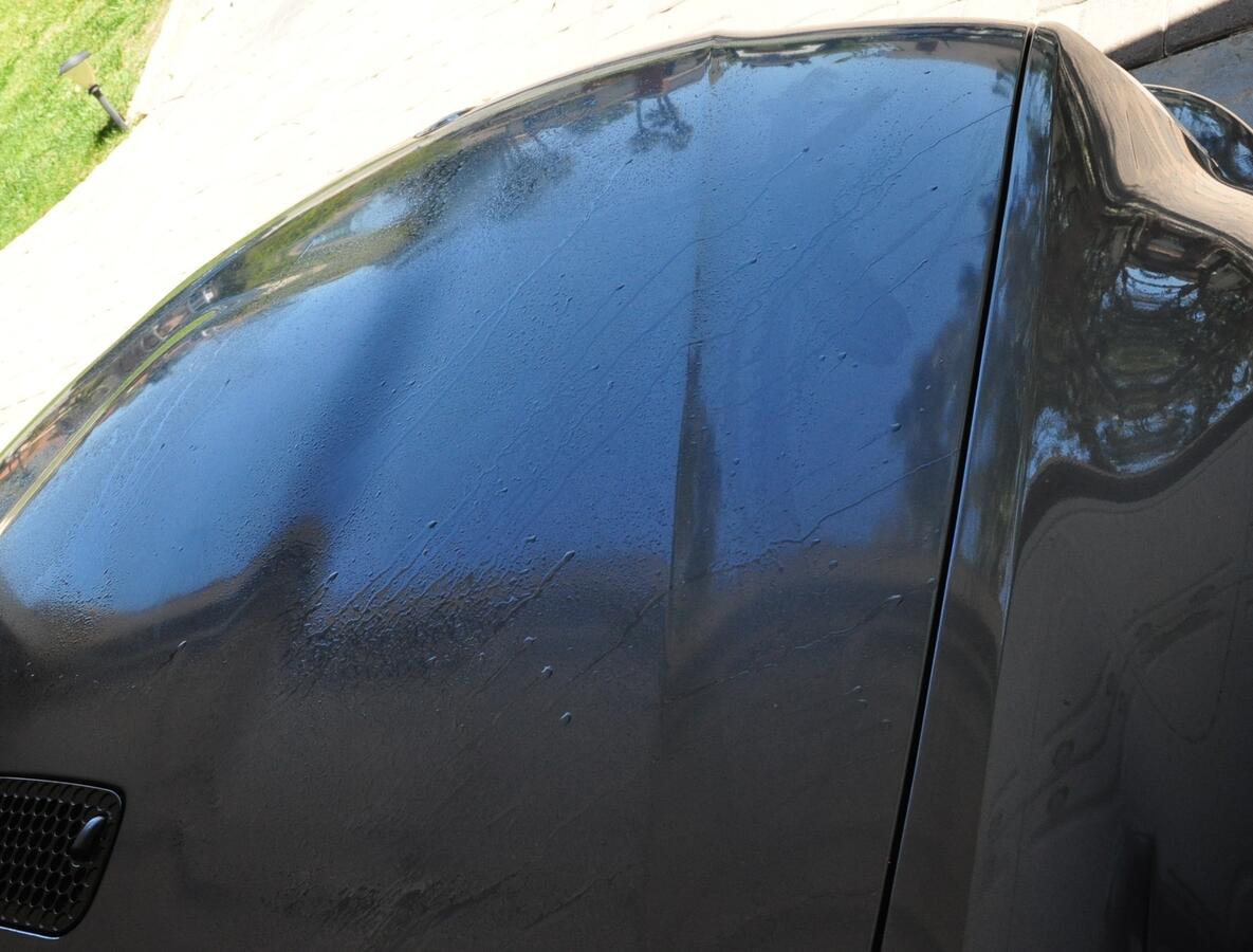

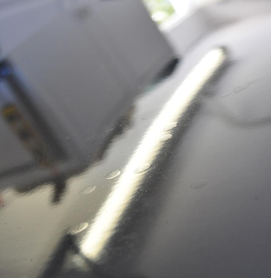

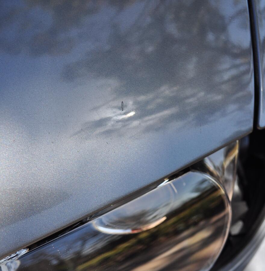

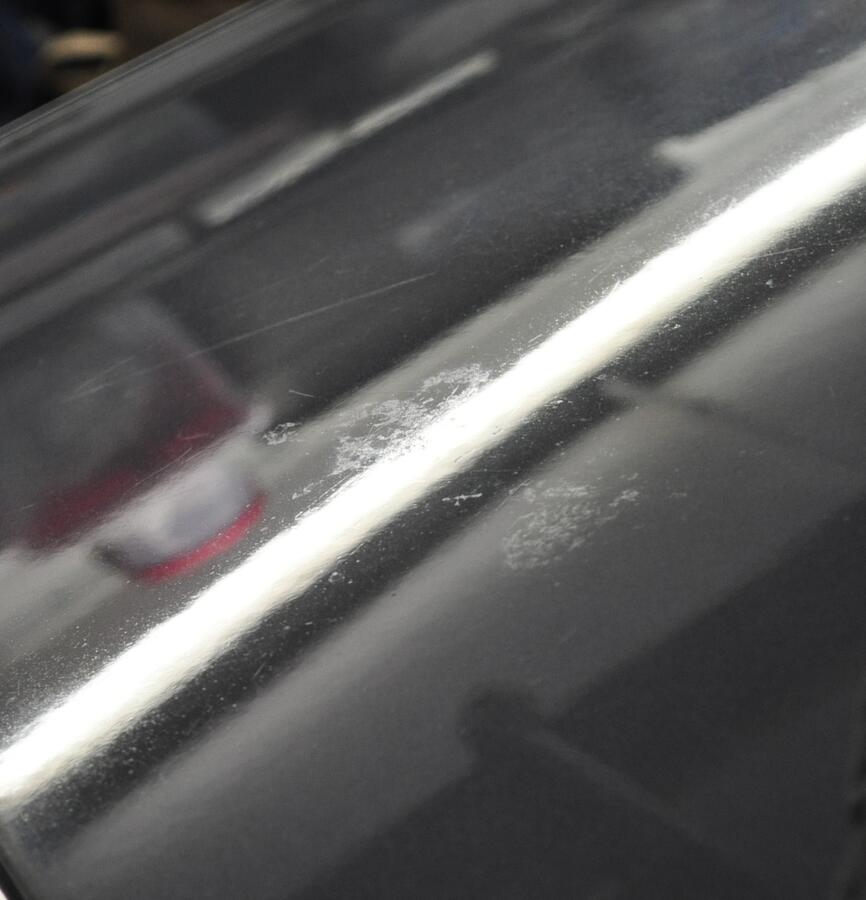

                              Biggest eye sores are (I think) pine tree sap etchings. I was hoping they were recent enough (P.O. parked it under a pine tree at his new house he bought), but it was long enough that the damage is permanent . They're mostly in the front/middle of the hood, maybe about a dozen of them. Oh well.
                              Click image for larger version  Name:	PaintCor3.JPG Views:	0 Size:	84.1 KB ID:	117523

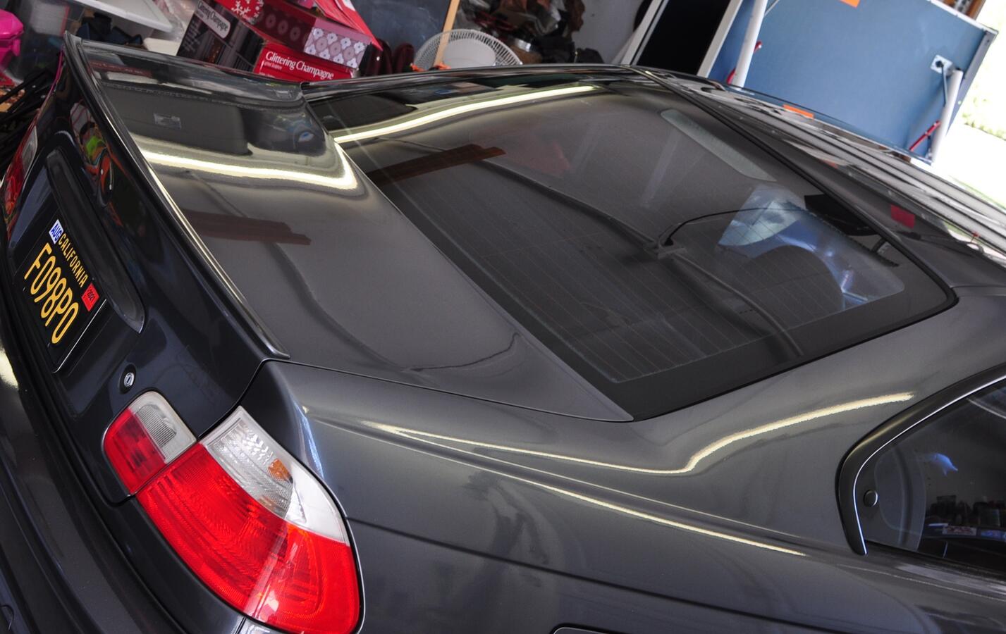

                              Otherwise, it's mostly RIDS like this. There aren't actually any swirl marks really, a consequence of P.O. never washing the car. There is one small bird poop etching, not too bad. The roof and trunk also have some bird poop etching that have penetrated the clear.
                              Click image for larger version  Name:	PaintCor4.JPG Views:	0 Size:	68.5 KB ID:	117522
                              The only part of the car that will need respraying, are the roof rails. They're just done. I'll do a light polish to make them look as good as possible, but the clear is pretty gone.
                              Click image for larger version  Name:	PaintCor5.JPG Views:	0 Size:	41.7 KB ID:	117525

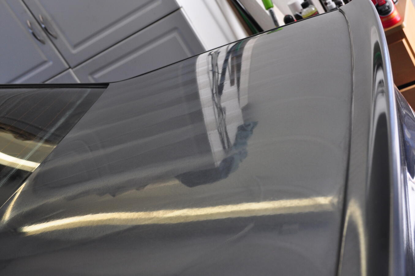

                              Trunk lid is the most scratched up
                              Click image for larger version  Name:	PaintCor6.JPG Views:	0 Size:	53.9 KB ID:	117526
                              Here's the etching on the trunk lid. As transformative as a paint correction usually is, there are certain things that don't get much better. This is the worst IMO. You can see it in most lighting/angles. Oh well. I'm not going to wetsand it down to nothing.

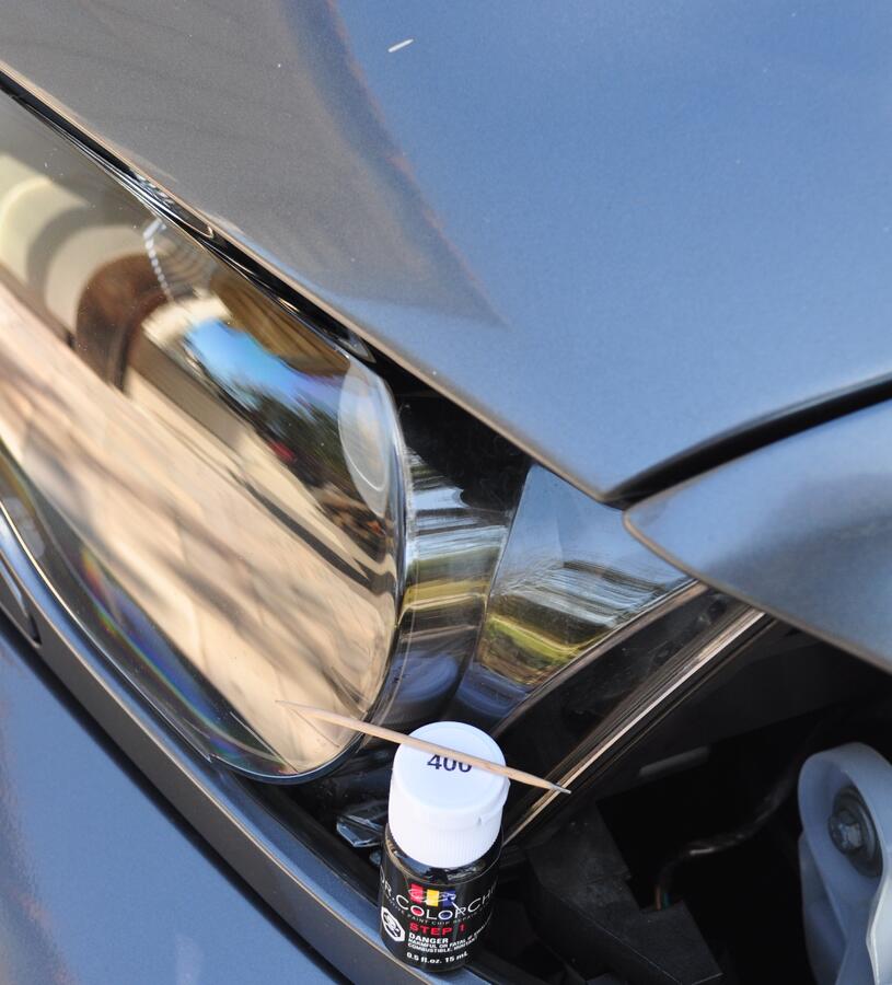

                              Let me take a minute to show how I touch up chips before paint correction:
                              Click image for larger version  Name:	Painttouchup.JPG Views:	0 Size:	76.0 KB ID:	117537
                              You can see the pretty large, long chip (into primer) on the hood here. I clean with IPA, then fill the "valley" using a toothpick and Dr. color chip paint. I found BMW touch up paint to dry too dark and not match well. I find Dr. Color chip to be a little lighter and a better match.
                              I do this days in advance so it can dry. That said, a paint correction will remove some, so do at least 2 coats imo.
                              Click image for larger version  Name:	Painttouchup2.JPG Views:	0 Size:	85.8 KB ID:	117538

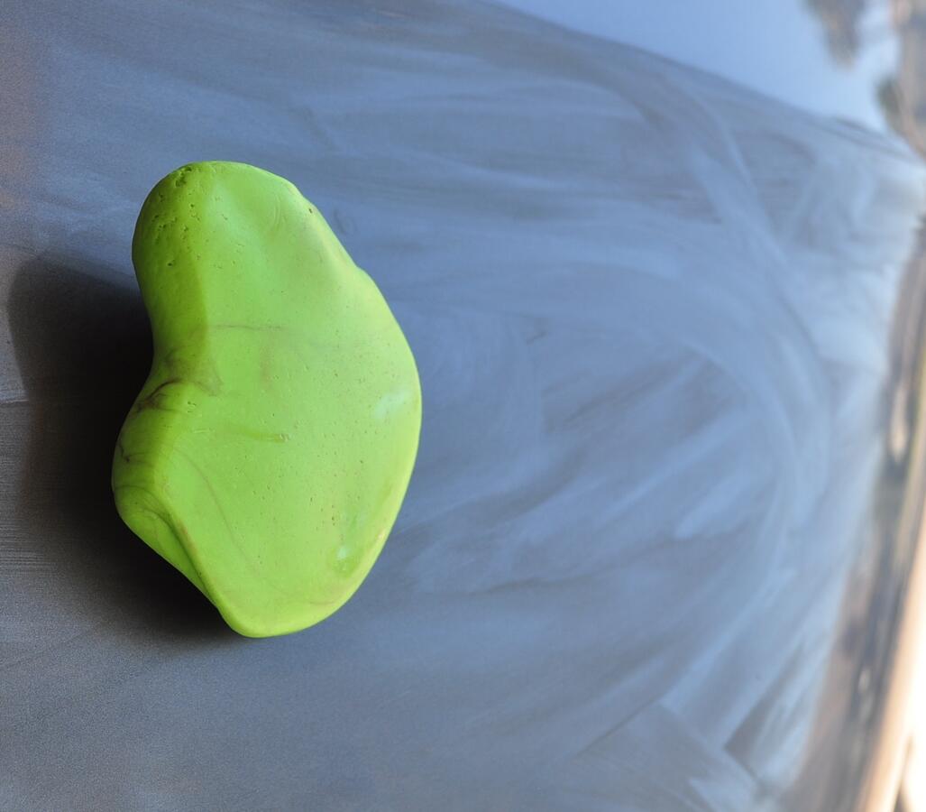

                              Back to the correction. I decontaminated the paint using 2 products. An iron/fallout remover (this one doesn't change color) and clay bar.
                              Click image for larger version  Name:	PaintCor7.JPG Views:	0 Size:	105.3 KB ID:	117527

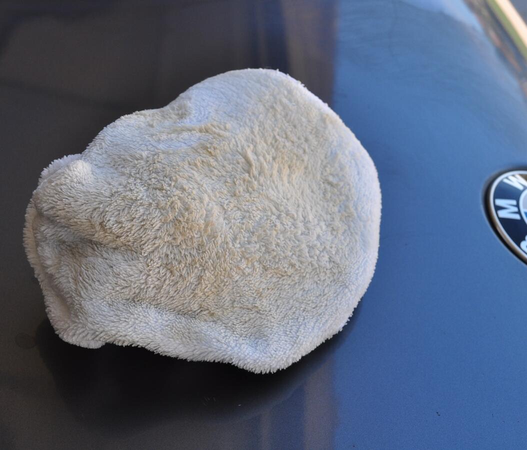

                              Didn't pick up too much, though you can see more dirt in the MF towel:
                              Click image for larger version  Name:	PaintCor10.JPG Views:	0 Size:	87.0 KB ID:	117530
                              I'm doing a 2 step with a 6" (that I put a 5" BP on) D/A for use with 5.5" pads. First step is with a medium cutting foam (orange CSS) and Griot's compound. I love love love the Griot's BOSS line, the creams don't dust and barely dry out so you can work as long as you want. Every once in a while, I have to spray some water to get it off - moreso in the summer. Great for someone like me, not a pro trying to cut fast. It's also one of the few retail compounds that goes down to p1000 where most do 1200 or 1500. They have a medium cut polish that is around 2k-2500 that gives you more flexibility depending on defects, plus the they have the perfecting polish. With paint that's never been touched, I'm using the fastest correcting cream, then the finishing polish. Using a D/A and a foam pad means I won't cut right through high spots and edges.
                              Click image for larger version  Name:	PaintCor11.JPG Views:	0 Size:	71.4 KB ID:	117531
                              Click image for larger version  Name:	PaintCor12.JPG Views:	0 Size:	102.4 KB ID:	117533
                              Here are those sap etchings. They got flatter, so I'm happy, but they're not gone and there is some slight discoloration if you look directly down. :/
                              Click image for larger version  Name:	PaintCor15.JPG Views:	0 Size:	49.9 KB ID:	117534
                              Polish step. This time, the medium polish white CSS pad and the BOSS perfecting cream
                              Click image for larger version  Name:	PaintCor13.JPG Views:	0 Size:	51.2 KB ID:	117532
                              Boot lid:
                              Click image for larger version  Name:	PaintCor14.JPG Views:	0 Size:	84.1 KB ID:	117535
                              Hood done:
                              Click image for larger version  Name:	PaintCor16.JPG Views:	0 Size:	113.9 KB ID:	117536

                              Click image for larger version  Name:	PaintCor20.JPG Views:	0 Size:	152.9 KB ID:	117542
                              Look at the depth and gloss of the hood, and the water beading. The other sealants I've used give similar hydrophobic beading, but the clear doesn't look this deep. I love carnauba, and will top it over sealants to try and get a warmer/deeper look. This CMX doesn't even need anything, just add more the next day if you can.

                                For the rest of the body, I shouldn't need to remove too much clear as the defects are very minimal. I already mentioned there are like no swirls. Most of the defects are permanent RIDS and etchings. There are some scratches that I think will come out (or almost will), so I plan to use the middle Griot's BOSS cream, correcting cream, for moderate defect removal.
                                For the front bumper, I'm using a 3" BP and 3" pad. In this case, a Cyan hydrotech pad from LC that supposedly has good cut AND good finish - this is a 1 step

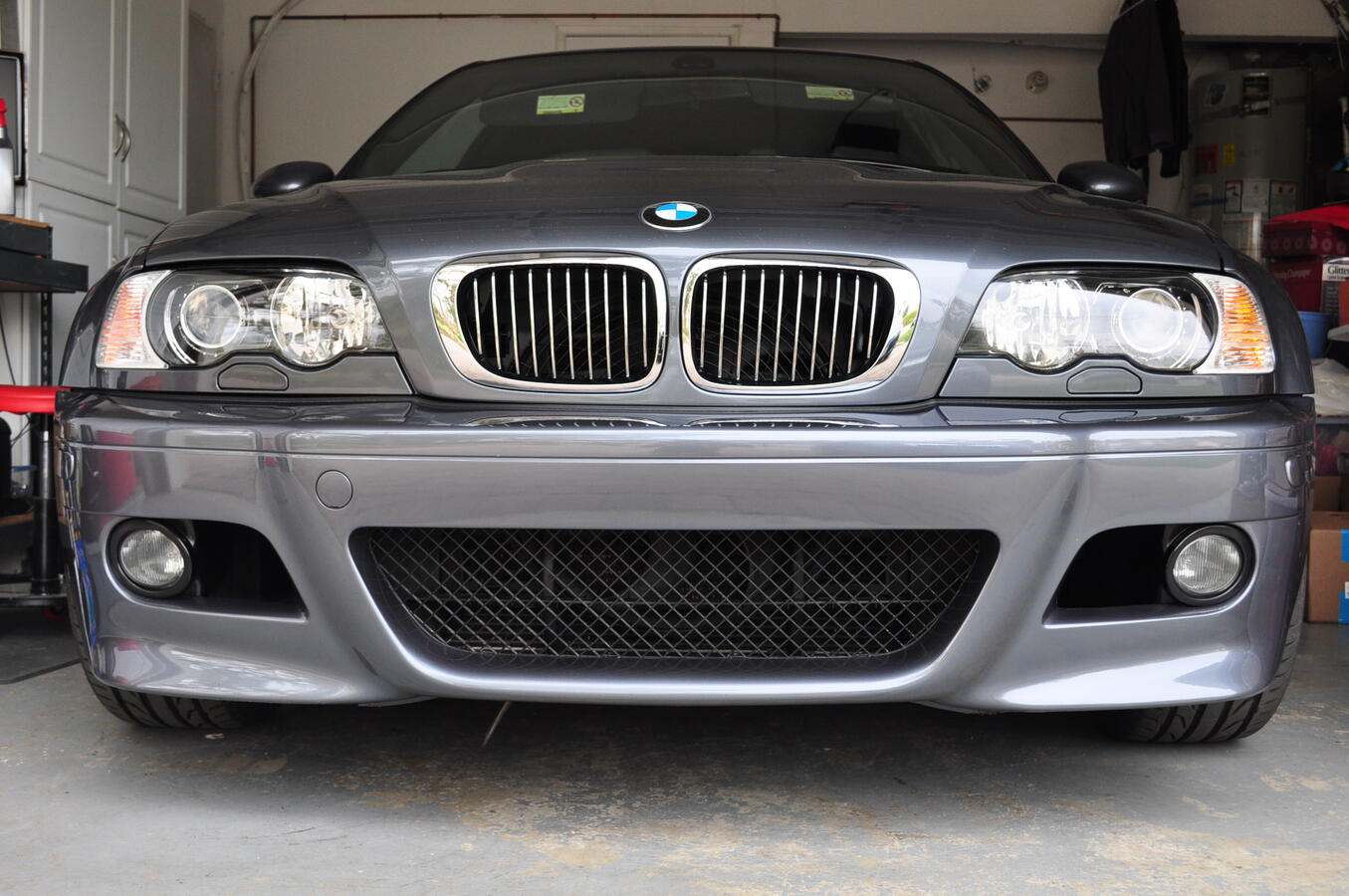

                                I did the bumper and foglights. Headlights were already done with hood.
                                I mentioned it much earlier when re-fitting the bumper, but I'm sure it's a respray. The color match is good, but that was my first clue. The real give away is the level of orange peel. It's hard to see in a photo, but there's too much texture and not enough reflectivity.
                                Ostensibly, you might think that orange peel will diminish with a paint correction as you cut through the clear, but because you're using a foam pad with a soft backing, you're actually evenly removing clear, so the peaks and valleys (orange peel) remain. What you need to do is wetsand. There are some firm pads (Car pro denim) that are orange peel specific, but I also read that they're not always that great, and esp so in smaller, tighter arears or arears with high spots/curves.
                                I'll look into teaching myself to wetsand at a later time.
                                After CMX sealant applied:
ID:	117556 Click image for larger version
