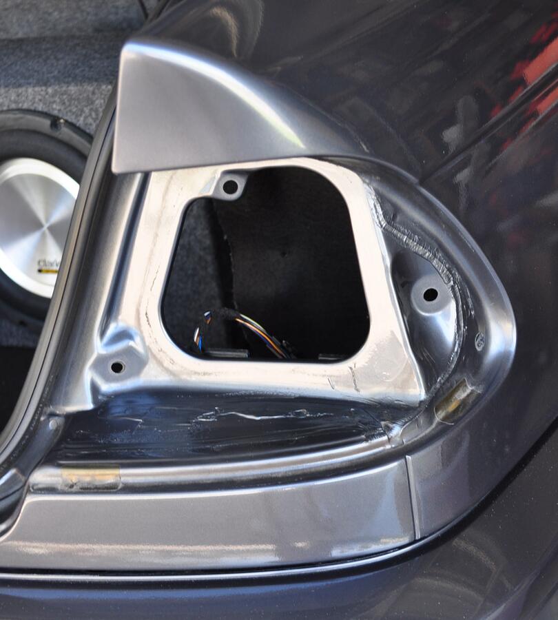

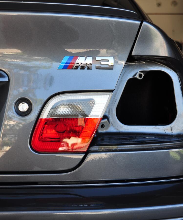

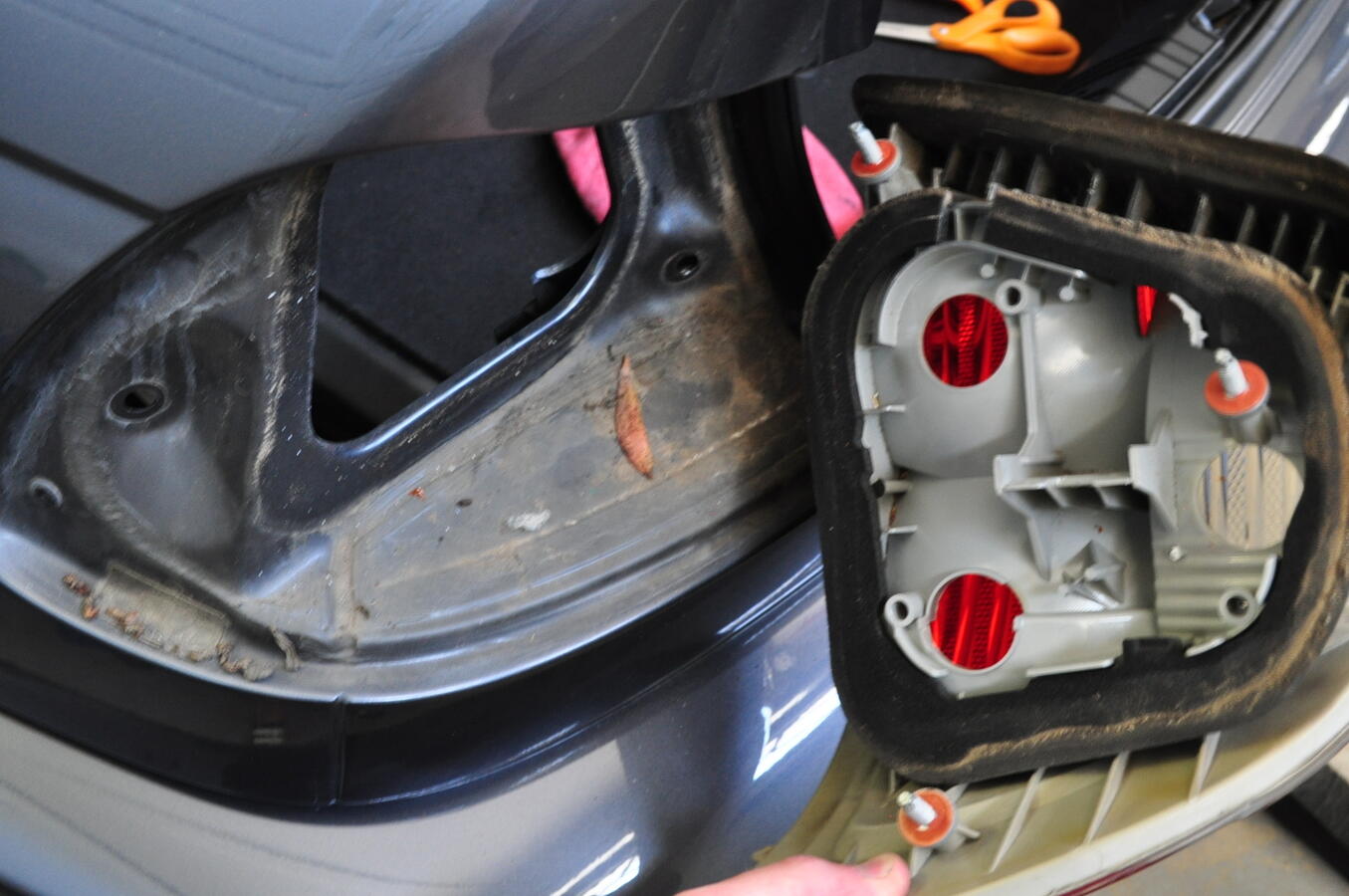

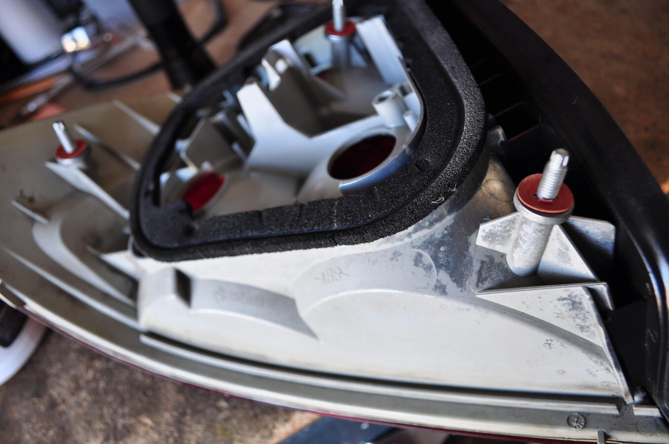

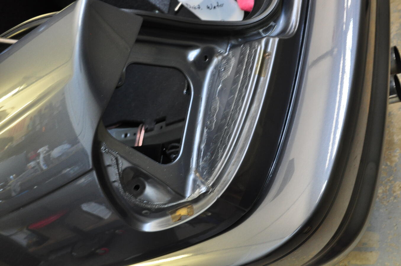

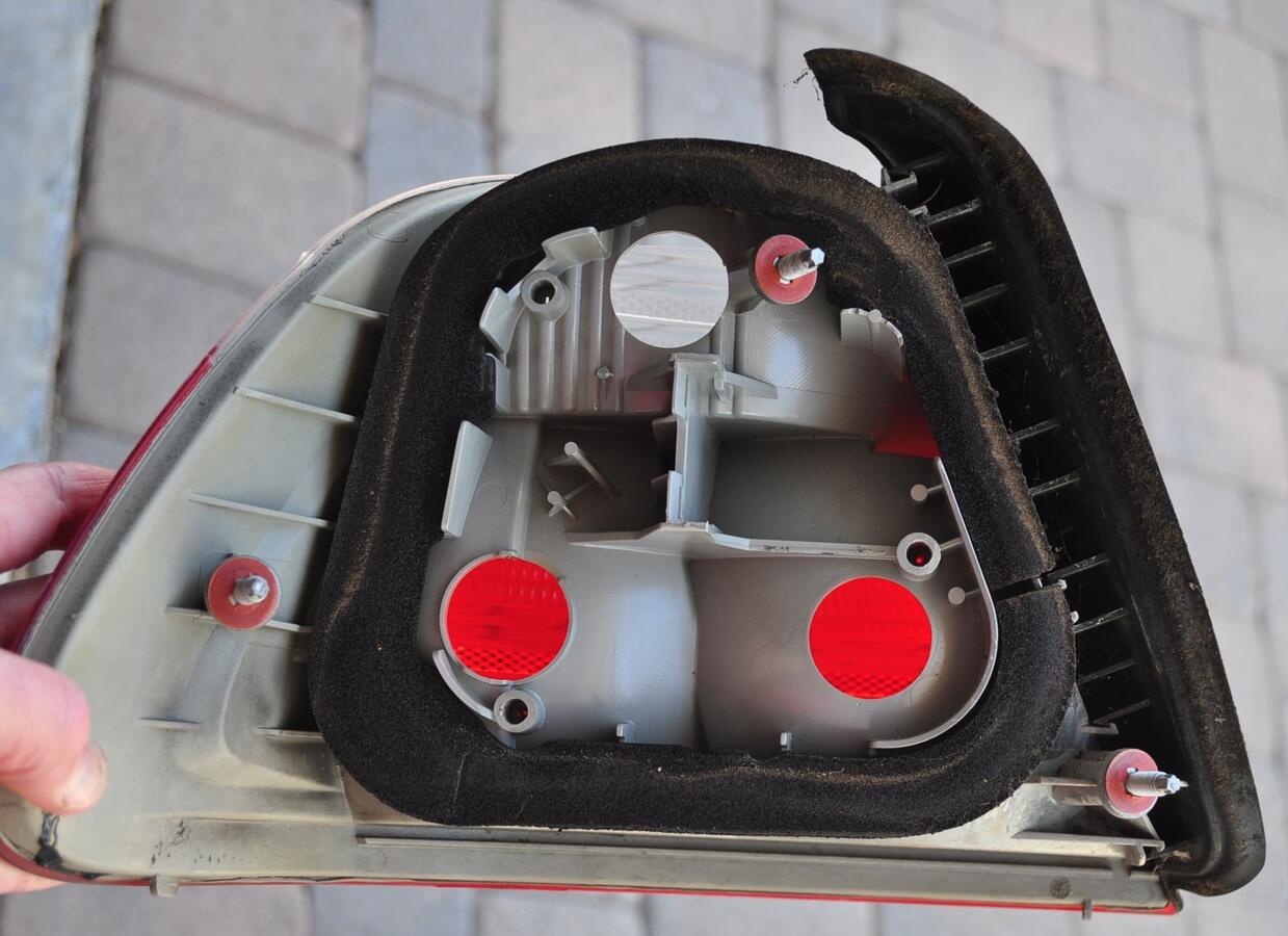

        My pass rear tail was letting water into battery area after a car wash, so I removed the light, cleaned up the area
        Click image for larger version  Name:	boot03.JPG Views:	0 Size:	78.3 KB ID:	117953
        You can see the gasket split. It's actually split and connected (glued) during manufacturing. So I just superglued the split back together.
        Click image for larger version  Name:	boot02.JPG Views:	0 Size:	112.2 KB ID:	117954

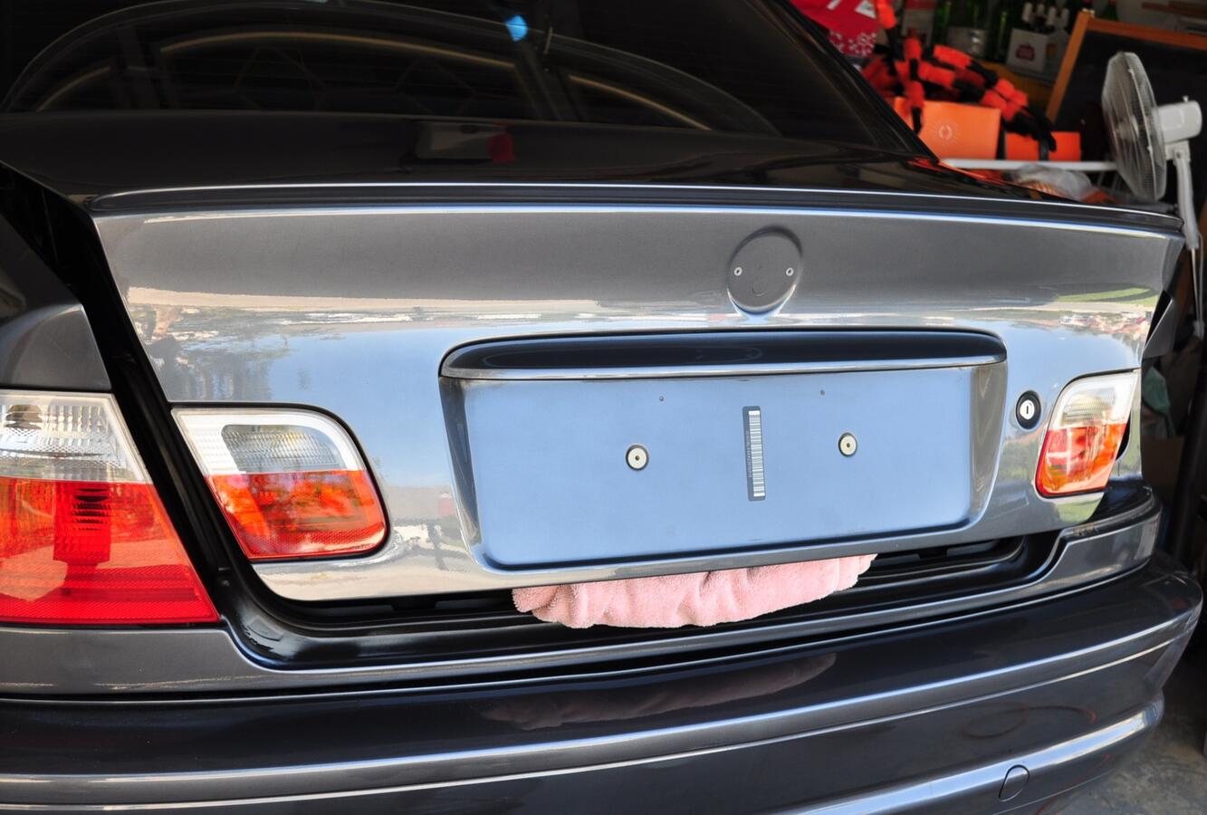

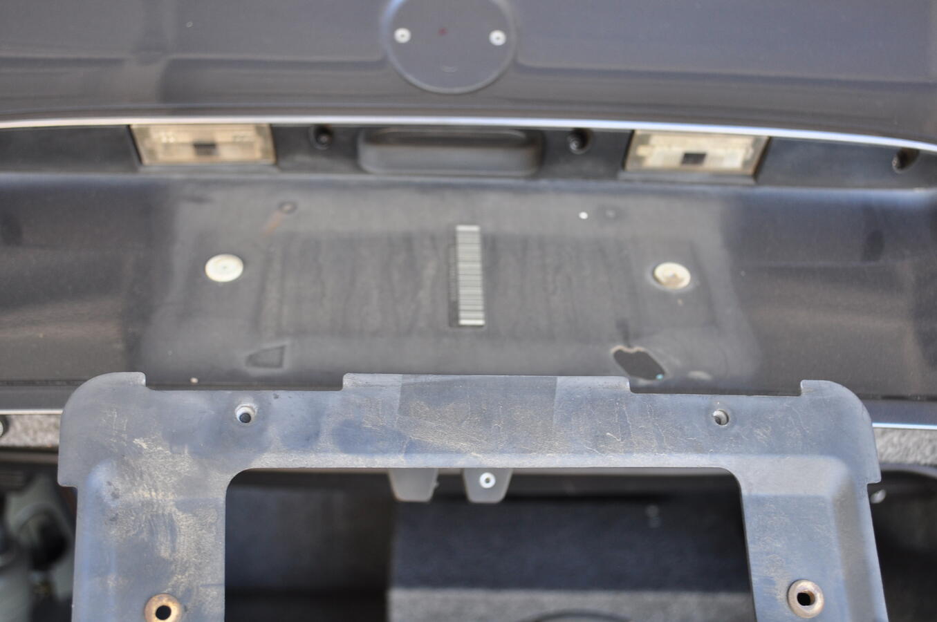

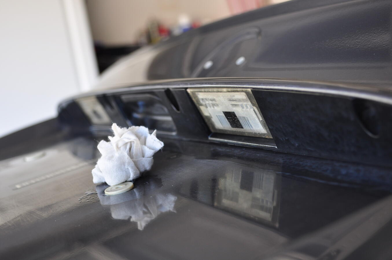

        Decided to remove the license plate, emblem and roundel in reparation for correcting the boot's paint.
        Click image for larger version  Name:	boot04.JPG Views:	0 Size:	78.4 KB ID:	117955
        This car's nickname: "Dusty"

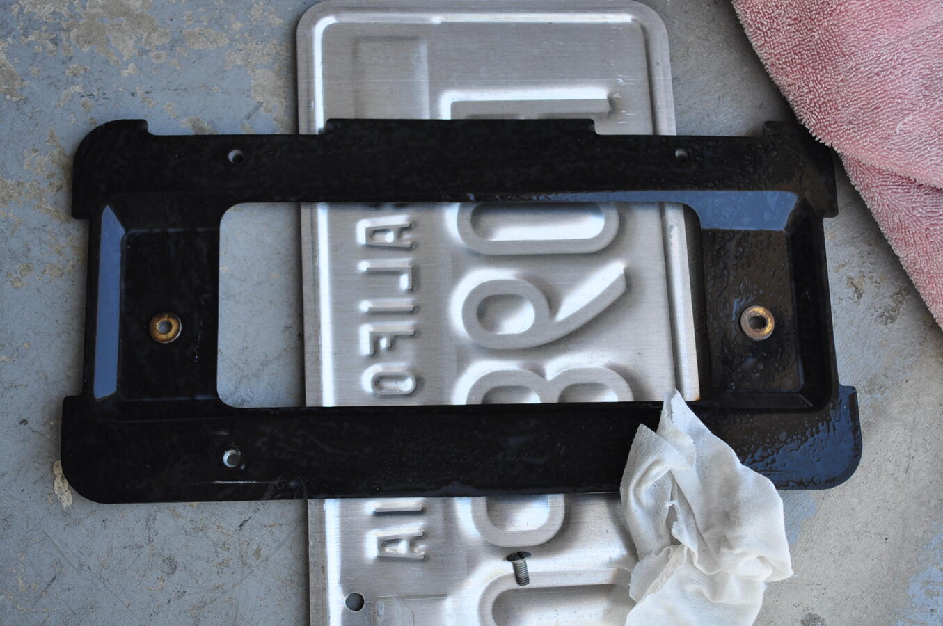

        Cleaning/dressing the plate holder; it's in good shape. The hardware (looked like kitchen cabinet hardware from chyna lol) was trash. Once screw was so long, it bit into the paint behind it doh.
        Click image for larger version  Name:	boot05.JPG Views:	0 Size:	153.7 KB ID:	117957

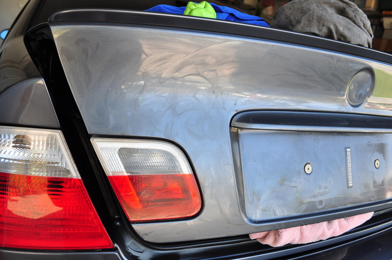

        Clay bar
        Click image for larger version  Name:	boot07.JPG Views:	0 Size:	163.3 KB ID:	117959

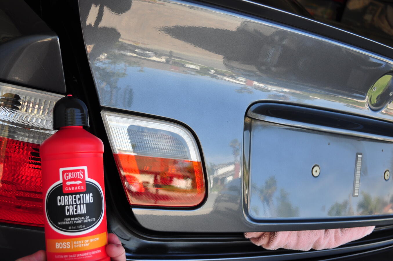

        Like the front bumper, I'm only doing a 1 step with the medium correcting cream since the vertical surfaces don't need much cleaning up. I'm using the orange CSS pad which is meant for more cut, though it finishes okay enough IMO. I'll be coming around again 3-6 months later and doing a finer polish, a maintenance polish you could call it (annually or semi-annual)
        Click image for larger version  Name:	boot08.JPG Views:	0 Size:	151.5 KB ID:	117960
        Click image for larger version  Name:	boot09.JPG Views:	0 Size:	130.1 KB ID:	117958

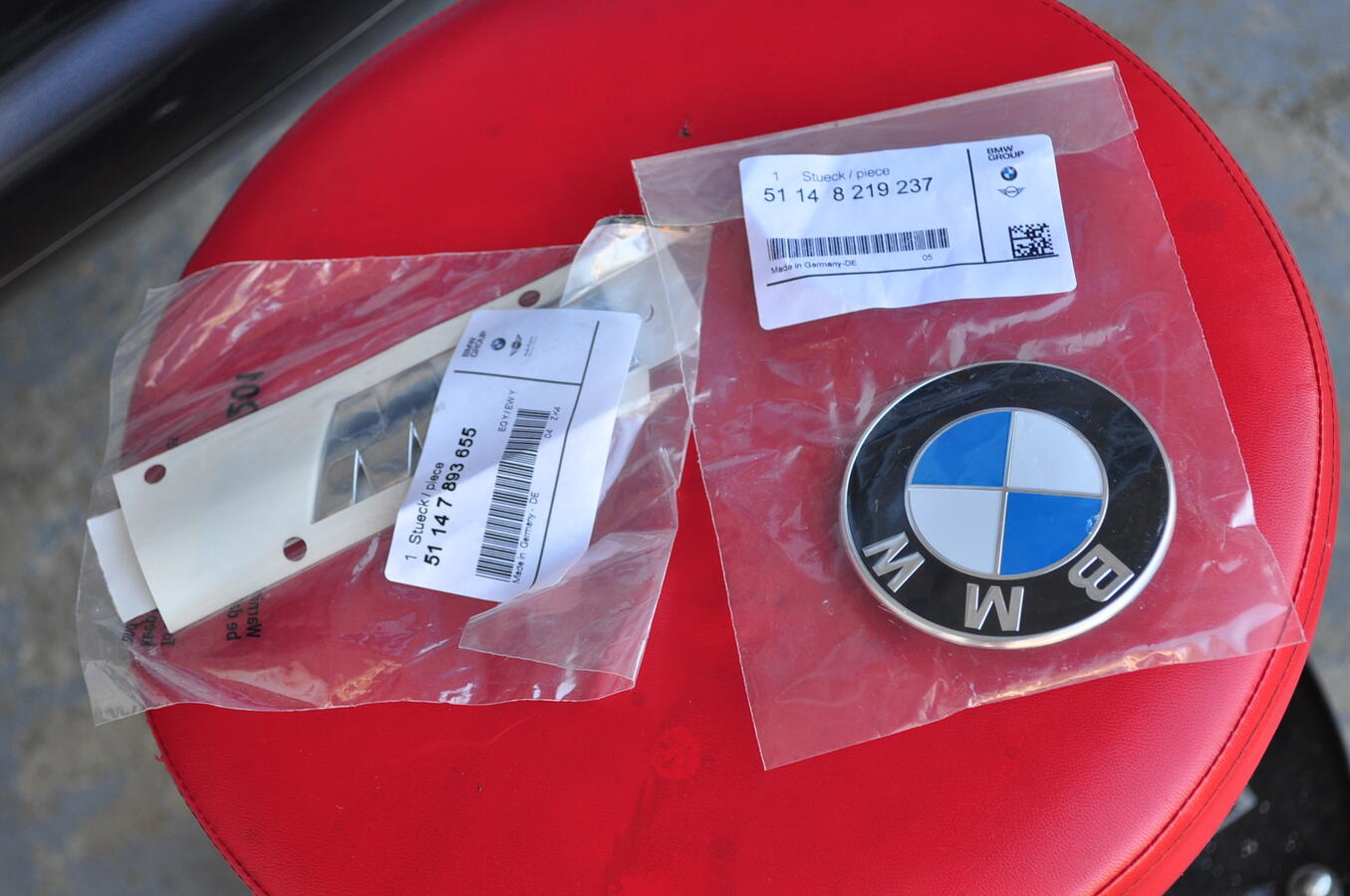

        Got new emblem/roundel from FCP:
        Click image for larger version  Name:	boot10.JPG Views:	0 Size:	128.7 KB ID:	117962
        I measured, but also had a little "evidence" left behind of where the old emblem was, so I was able to put it exactly where it should be. Curiously, the "3" is just a hair shorter than the "///M", so you can't line them up perfectly. You could put the bottom on the same plane, but I chose (believing it was like this originally) to center the 3 to the M, as in, put their midpoints on the same horizon. in this pic, it looks like the "3" is too high, but it's not actually.
        Click image for larger version  Name:	boot13.JPG Views:	0 Size:	80.0 KB ID:	117961

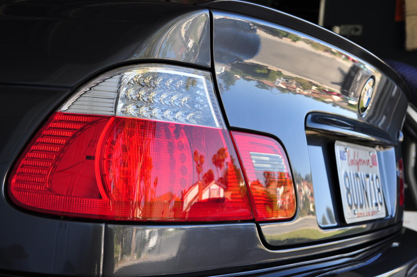

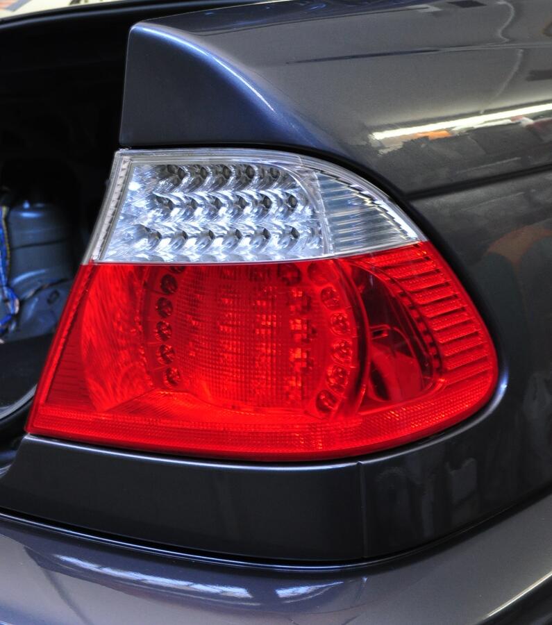

        Here's the taillight gasket glued back together:
        Click image for larger version  Name:	boot14.JPG Views:	0 Size:	116.7 KB ID:	117963
        Back in:
        Click image for larger version  Name:	boot15.JPG Views:	0 Size:	149.4 KB ID:	117964

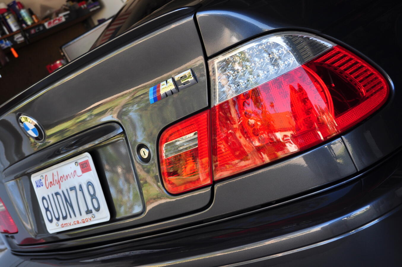

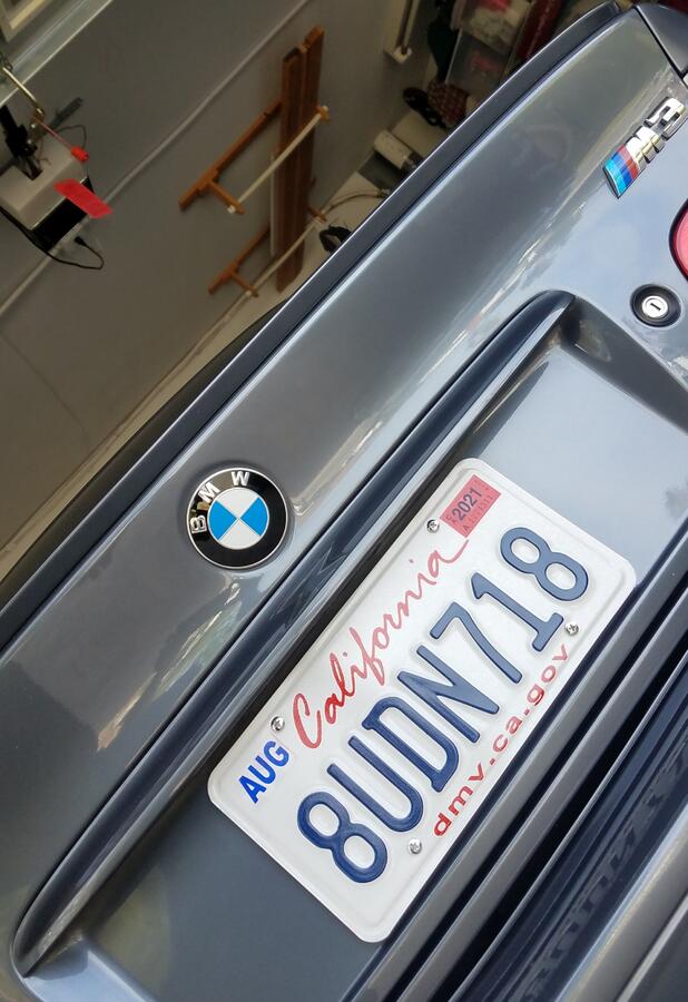

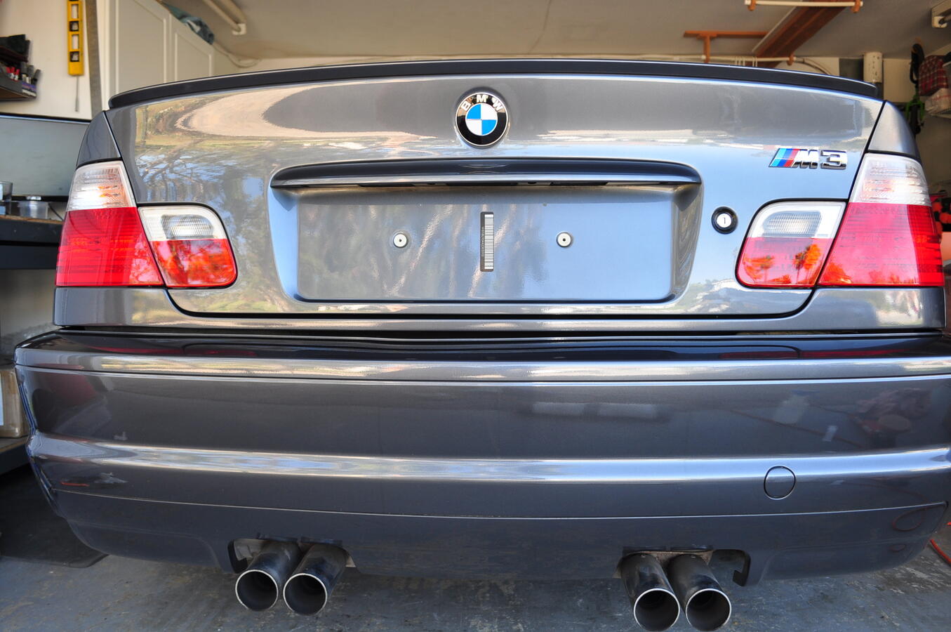

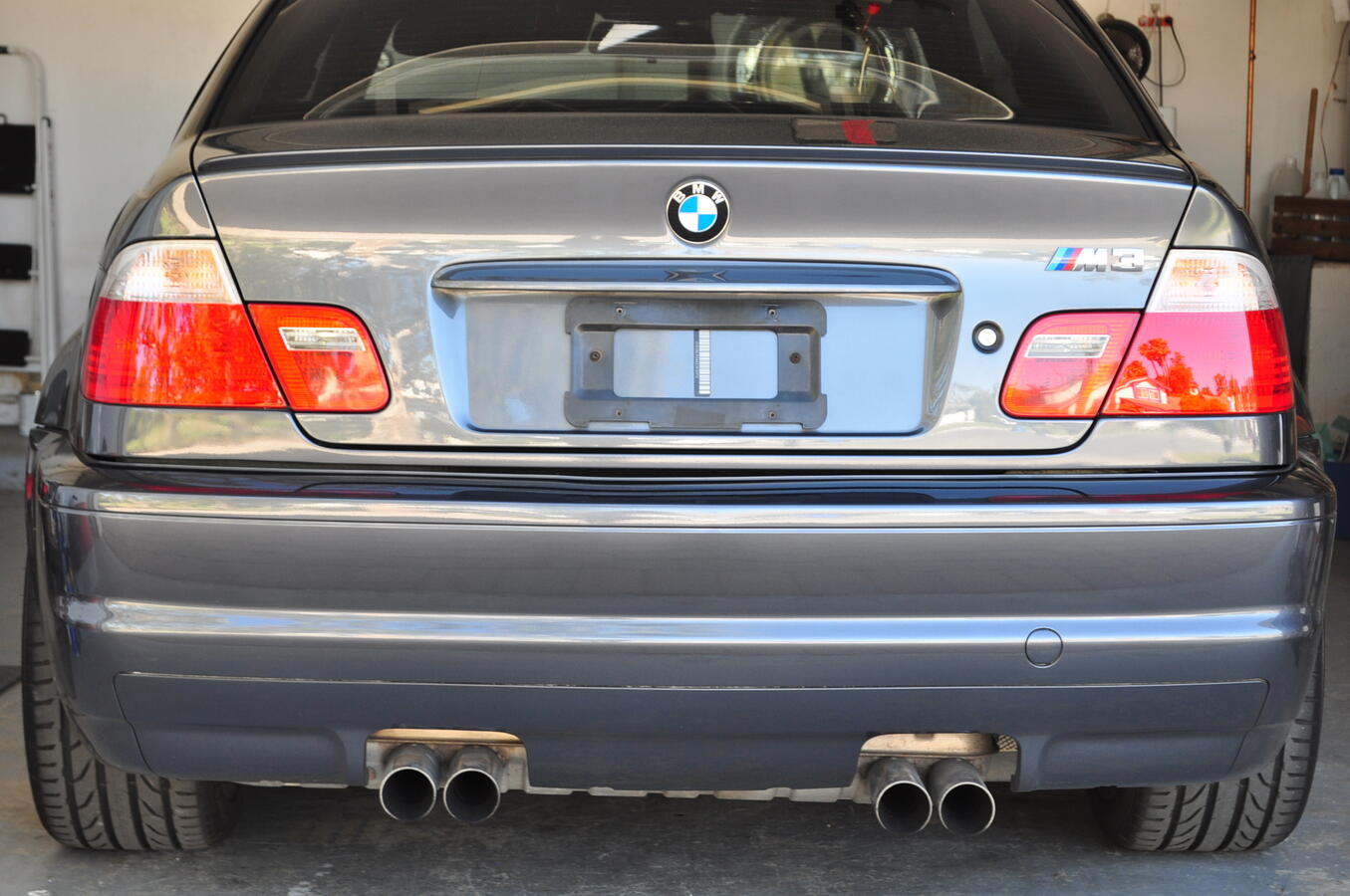

        Plate holder, refreshed, back on: Look at those exh tips lol
        Click image for larger version  Name:	boot16.JPG Views:	0 Size:	144.0 KB ID:	117965
        Finally got the car tagged and opted to get brand new, random plates. I really don't like the retro black plates. Even on a black car, but certainly not on metallic grey - just made the car look old/dumpy (the car also did look dumpy when I bought it, so perhaps that's at play in my mind). Notice the factory plate screws @ $1 each lol
        Click image for larger version  Name:	boot17.jpg Views:	0 Size:	80.9 KB ID:	117966

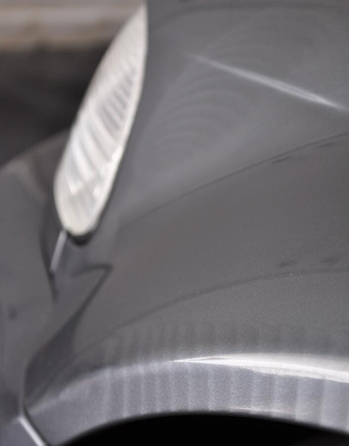

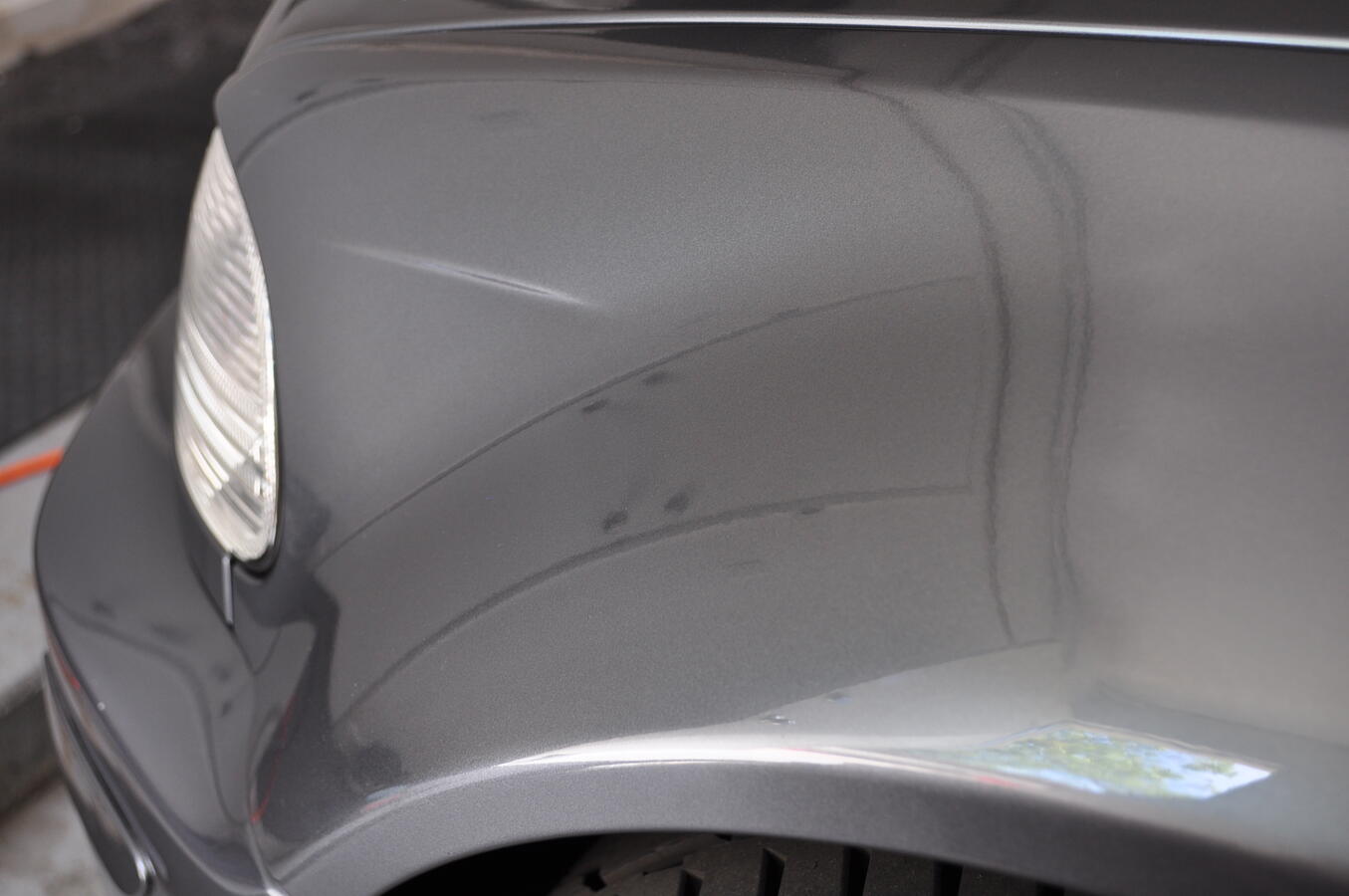

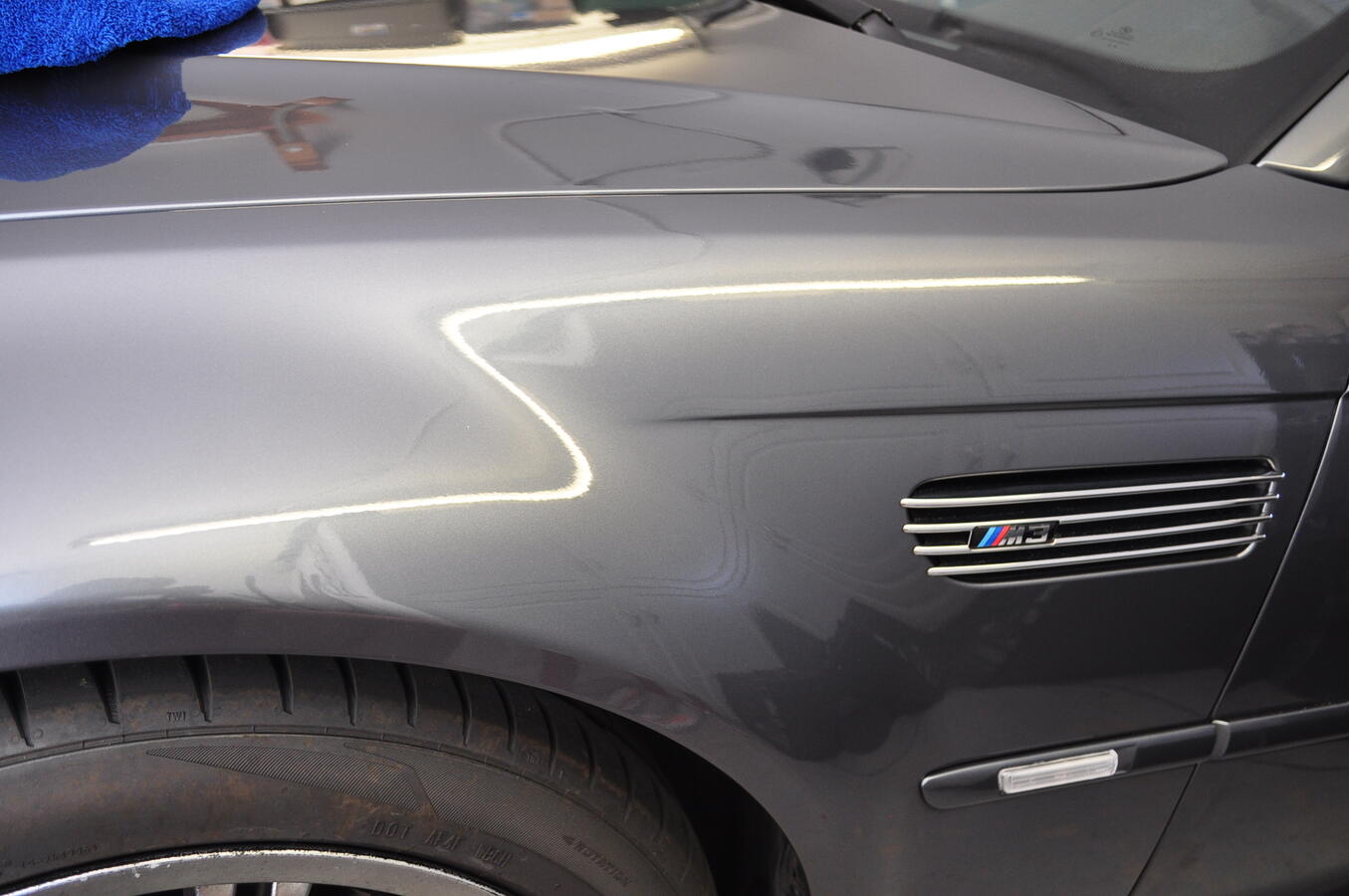

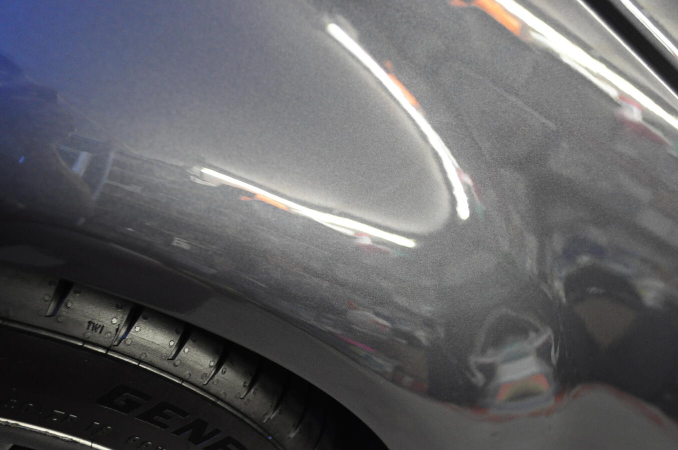

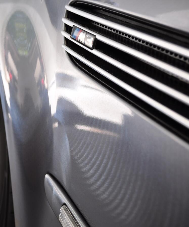

        Worked on the fenders as well, same 1 step process with the BOSS correcting cream and an orange pad:
        Click image for larger version  Name:	fenders05.JPG Views:	0 Size:	29.8 KB ID:	117967
        Click image for larger version  Name:	fenders06.JPG Views:	0 Size:	57.1 KB ID:	117968
        I love our metallic paints so much. And if you look closely, I really don't have many rock chips. Bad luck that the bumpers and pass QP are resprays, but at least the rest is factory and is in pretty good shape (besides those damn tree sap etchings)

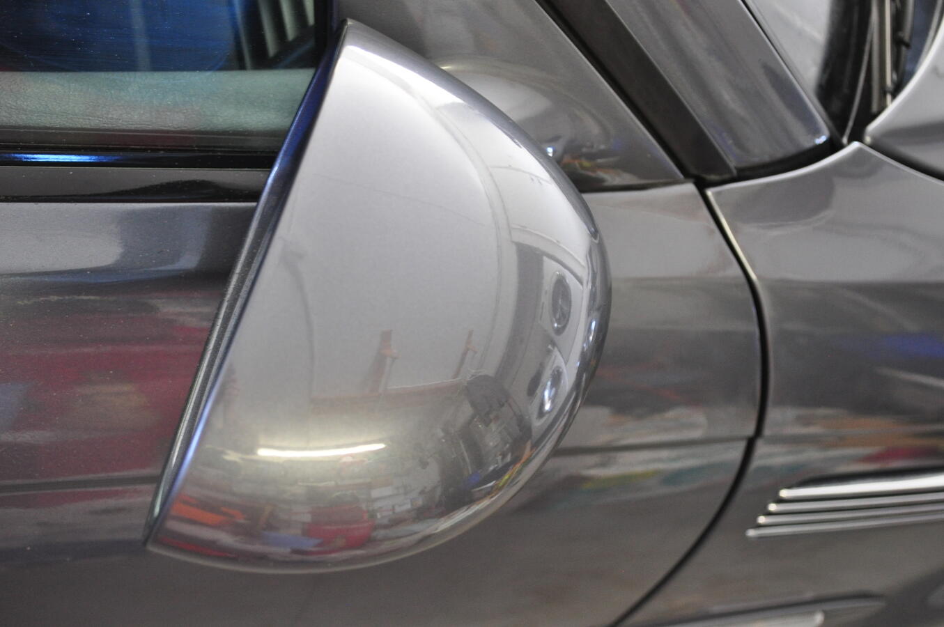

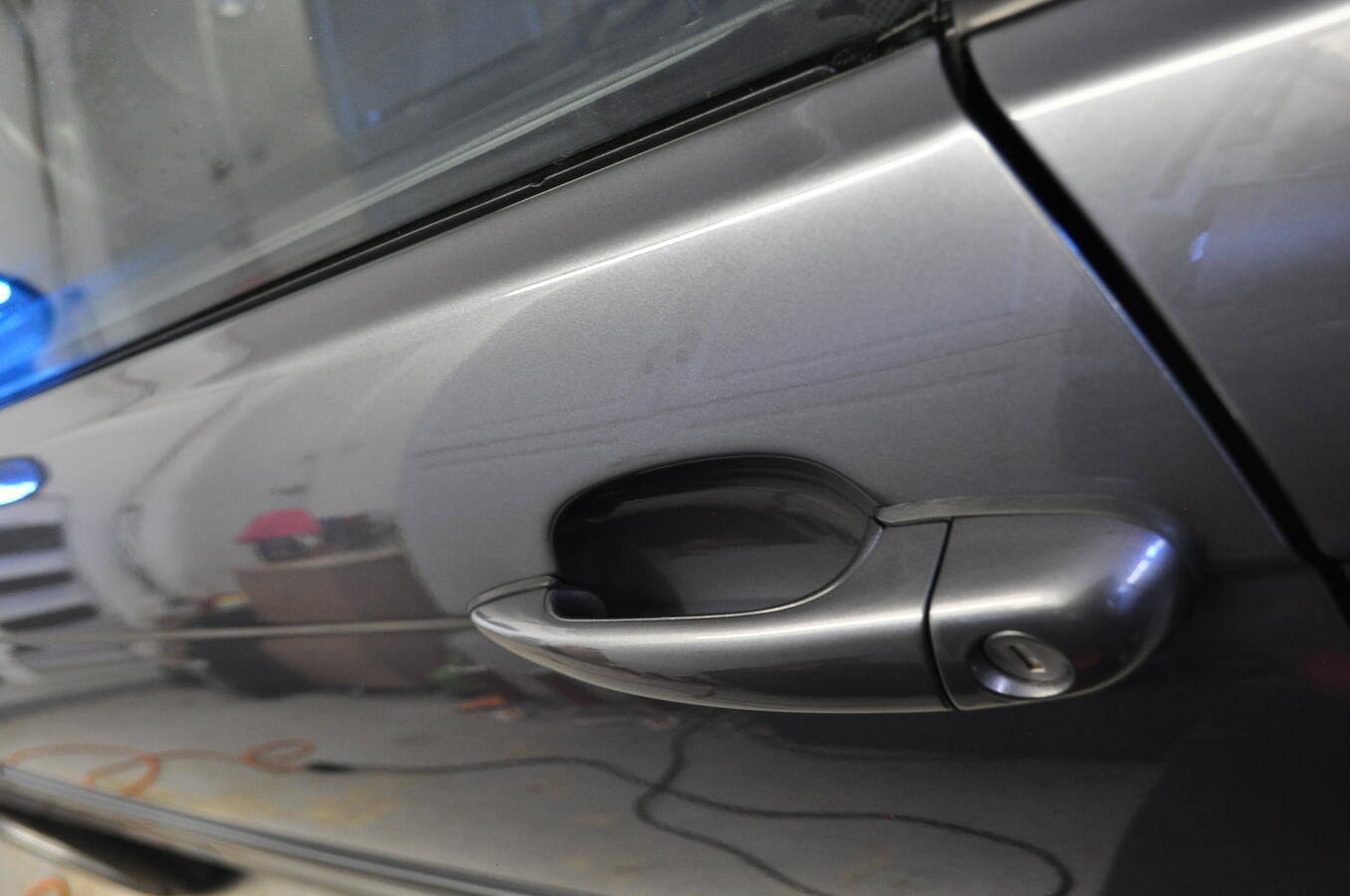

        Did the mirrors too cause it's easy. Still have doors/QPs and rear bumper left.
        Click image for larger version  Name:	mirrorL.JPG Views:	0 Size:	71.8 KB ID:	117973 Click image for larger version  Name:	mirrorR.JPG Views:	0 Size:	92.5 KB ID:	117974

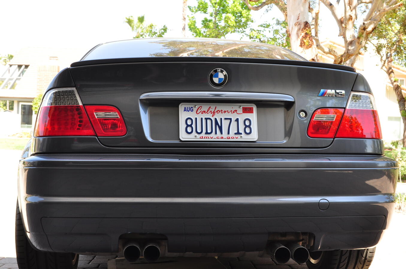

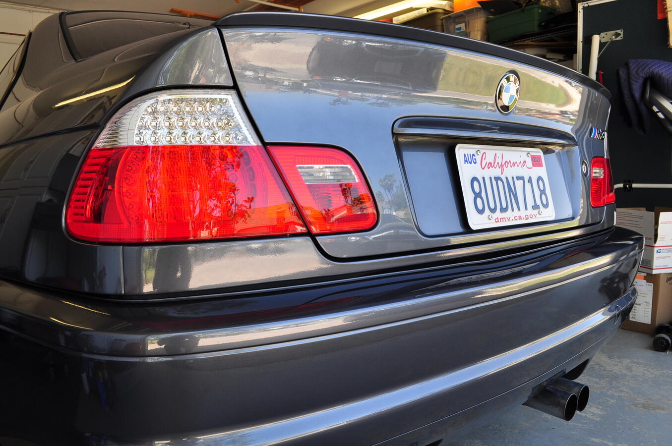

        And lastly, since we haven't seen the car much, here's a decent shot. Still not where I want it, but so much better
        Click image for larger version  Name:	SteelApril.jpg Views:	0 Size:	188.2 KB ID:	117972

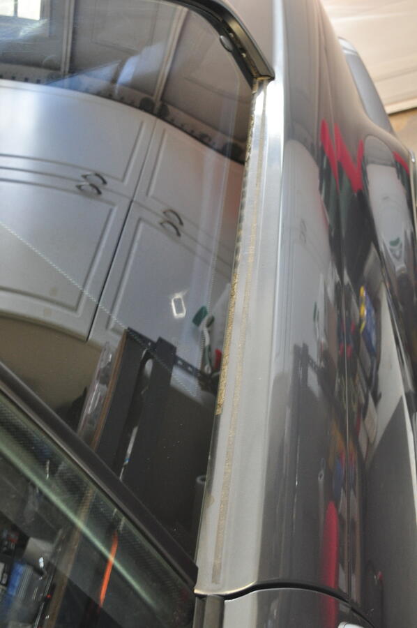

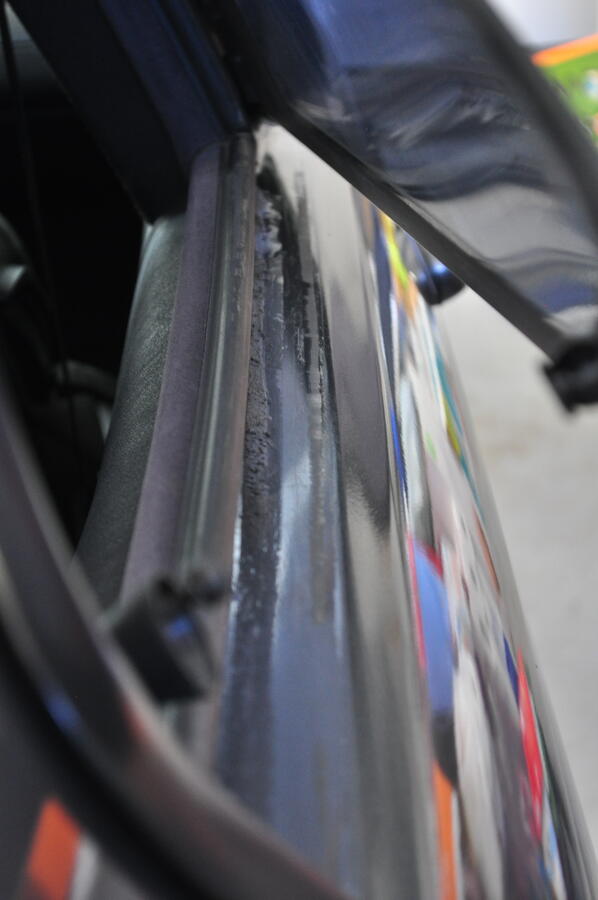

              Is it just the pics that make it look like the sap is on top of the paint and not etched?
                Thank you, it sure does. I also want to remind ppl, I'm behind in updating the thread. All of this content so far happened in only 2 months. I have at least this much more to dump before catching up to present day.
                No, they look like that in real life too, very frustrating. Spoiler alert* I'm skipping ahead, but I already wetsanded various parts of the car, almost completely the resprayed parts, but I did have a light go (2k) at the sap spots on the factory hood, and it made no difference. They're permanent It's the greatest eyesore on the car, moreso than the little dents in the upper pillars (that can't come out via PDR). There are also some bird shit etchings mixed in with the sap spots, and a few heavy RIDS. It's by far the worst panel.

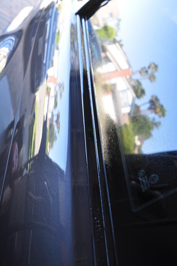

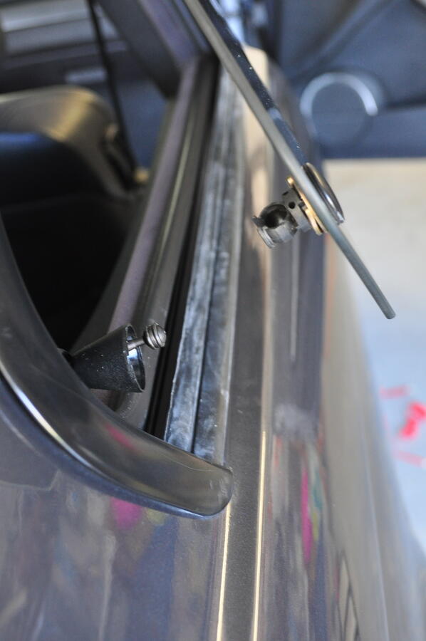

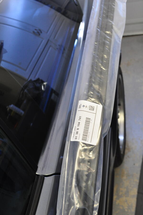

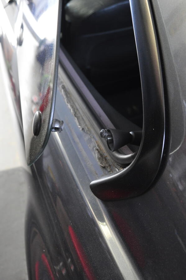

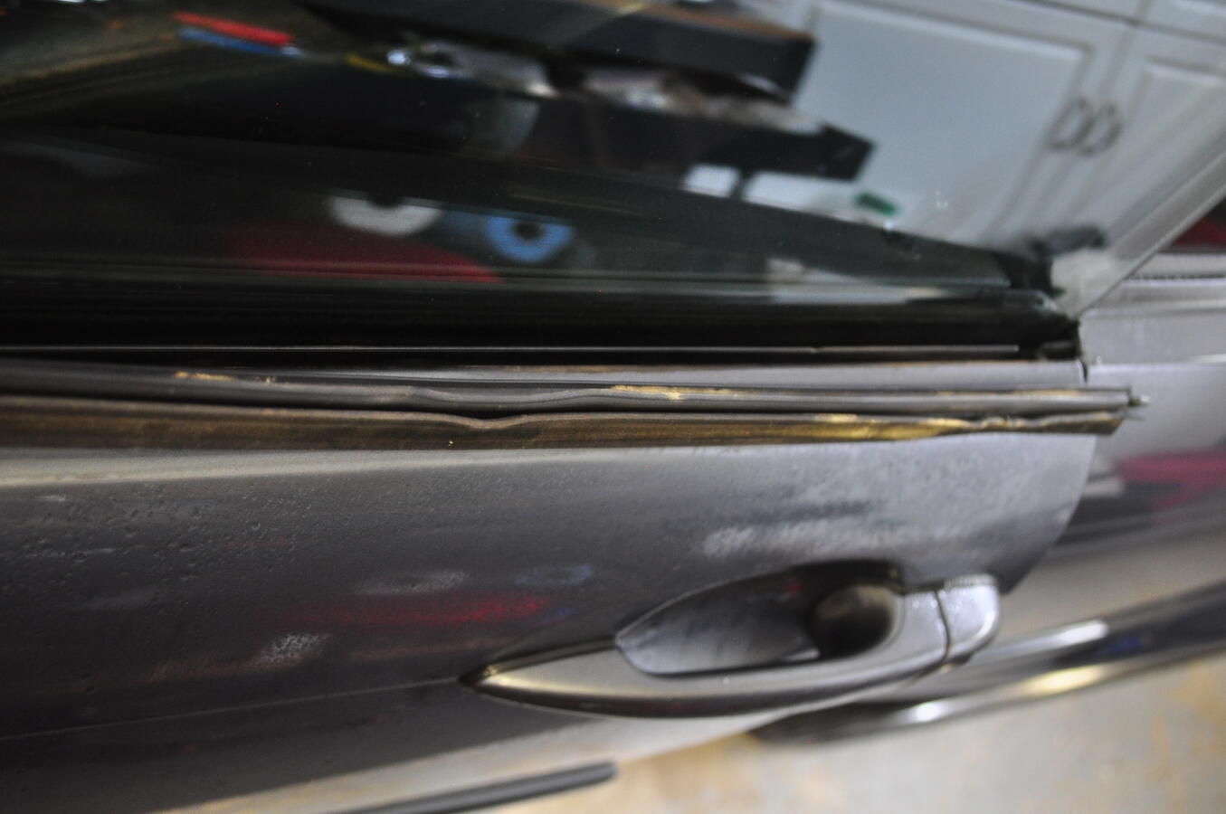

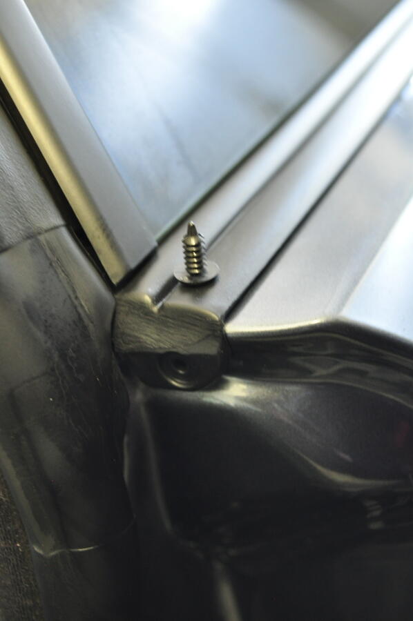

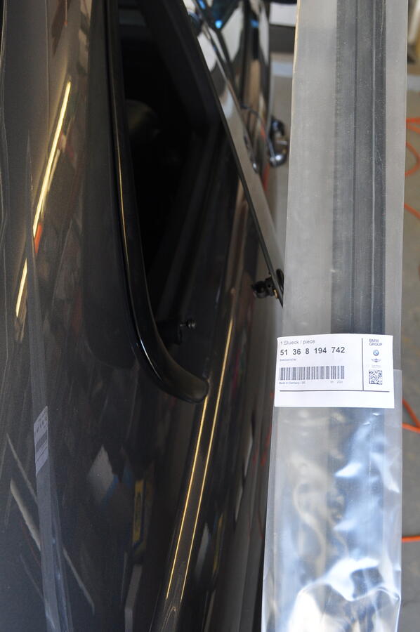

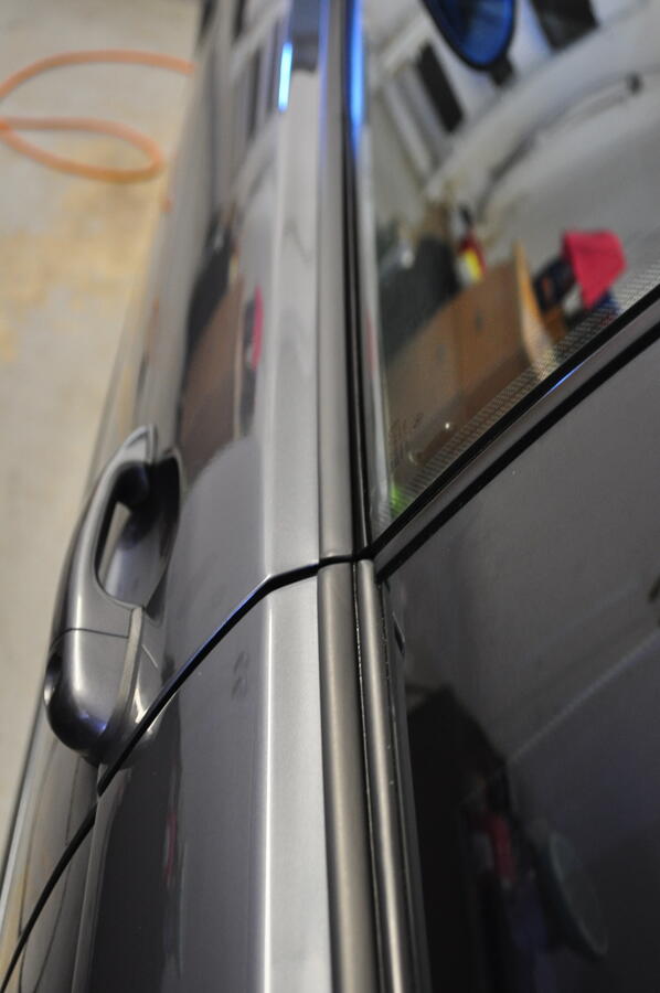

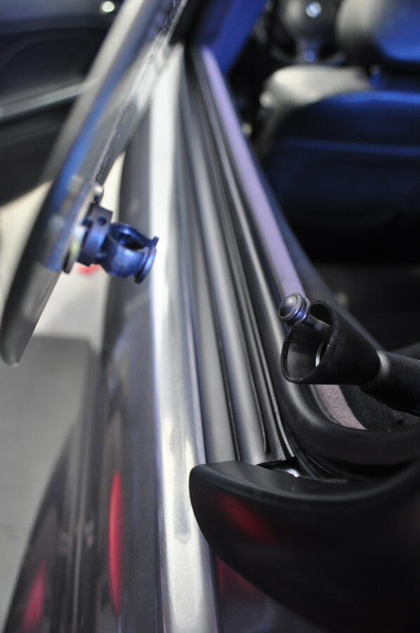

                  New seals! Already did the passenger door when I took out the glass for the regulator, but here are the other 3:
                  While the trims were off, I polished the paint where the edge of the rubber would sit. I'll still polish the doors and qp later, but wanted to get the top flat surfaces done now
ID:	118895 Click image for larger version
ID:	118898 Click image for larger version
ID:	118900 Click image for larger version

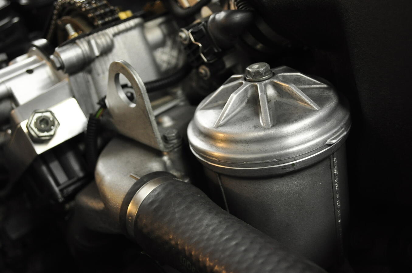

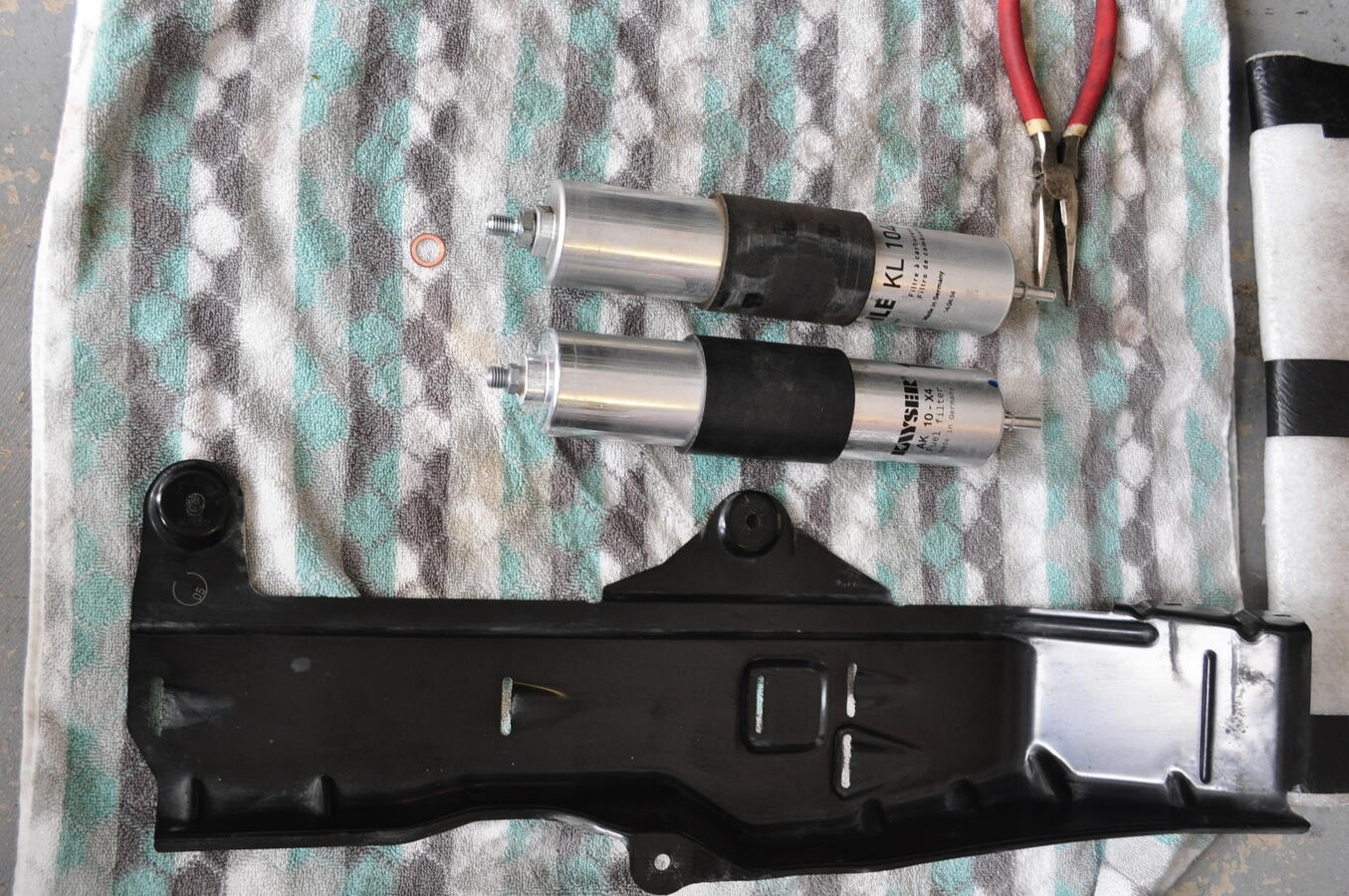

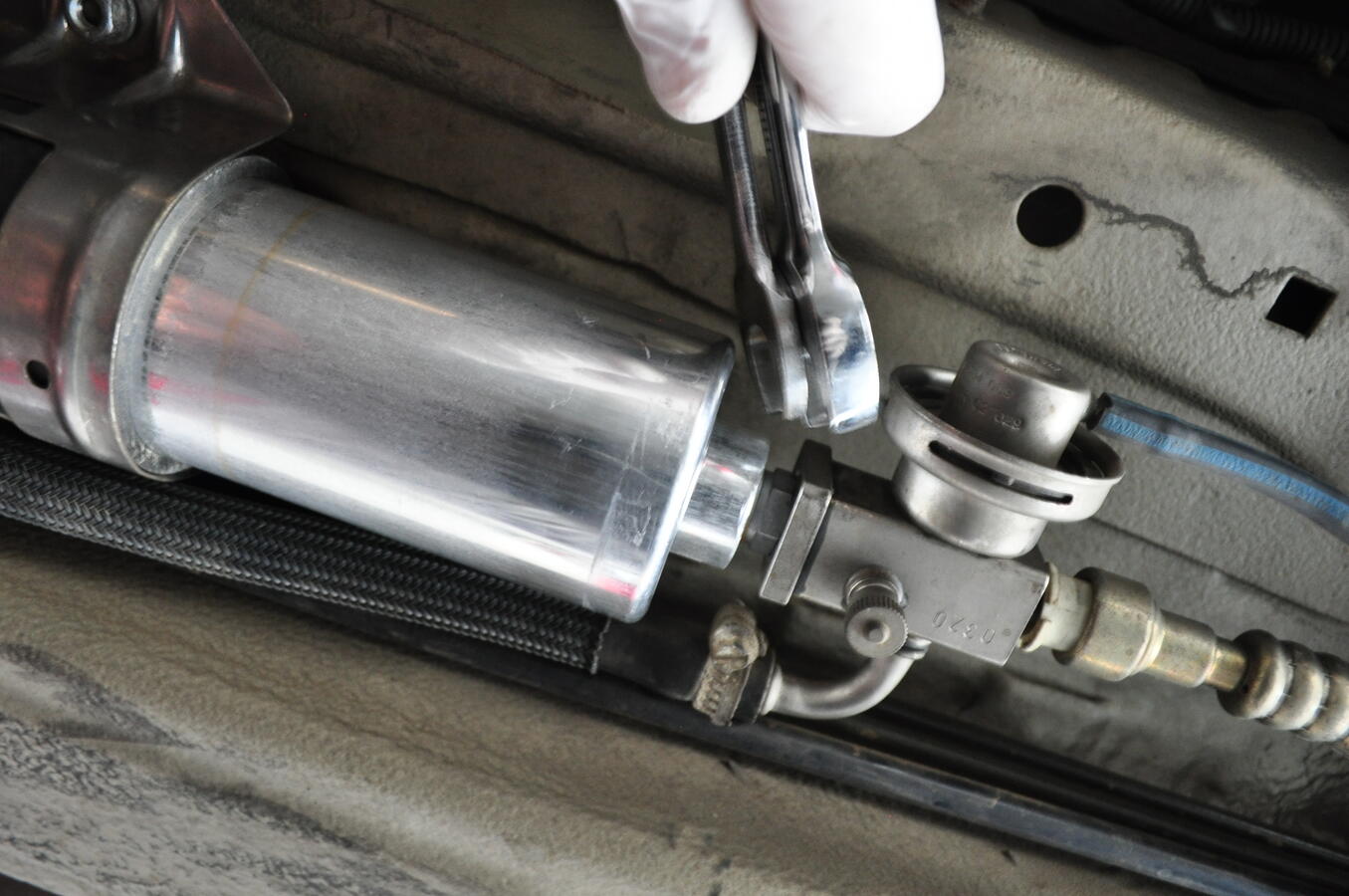

                      Fuel filter time
                      Click image for larger version  Name:	fuel02.JPG Views:	0 Size:	232.3 KB ID:	119375

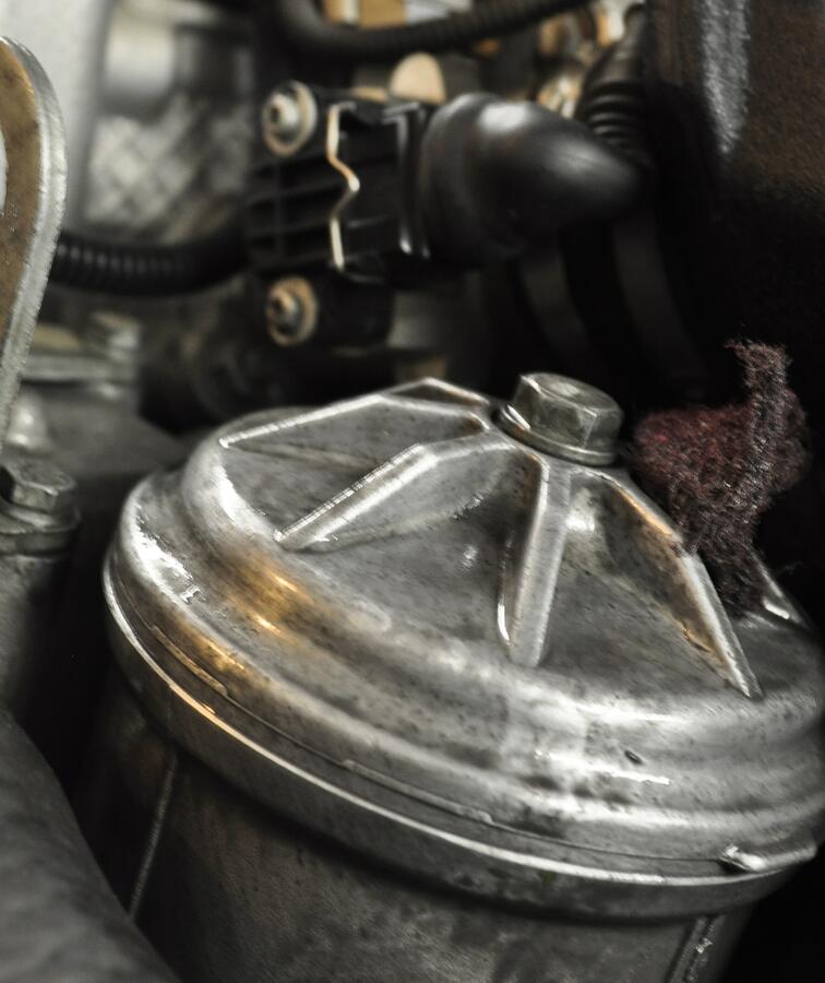

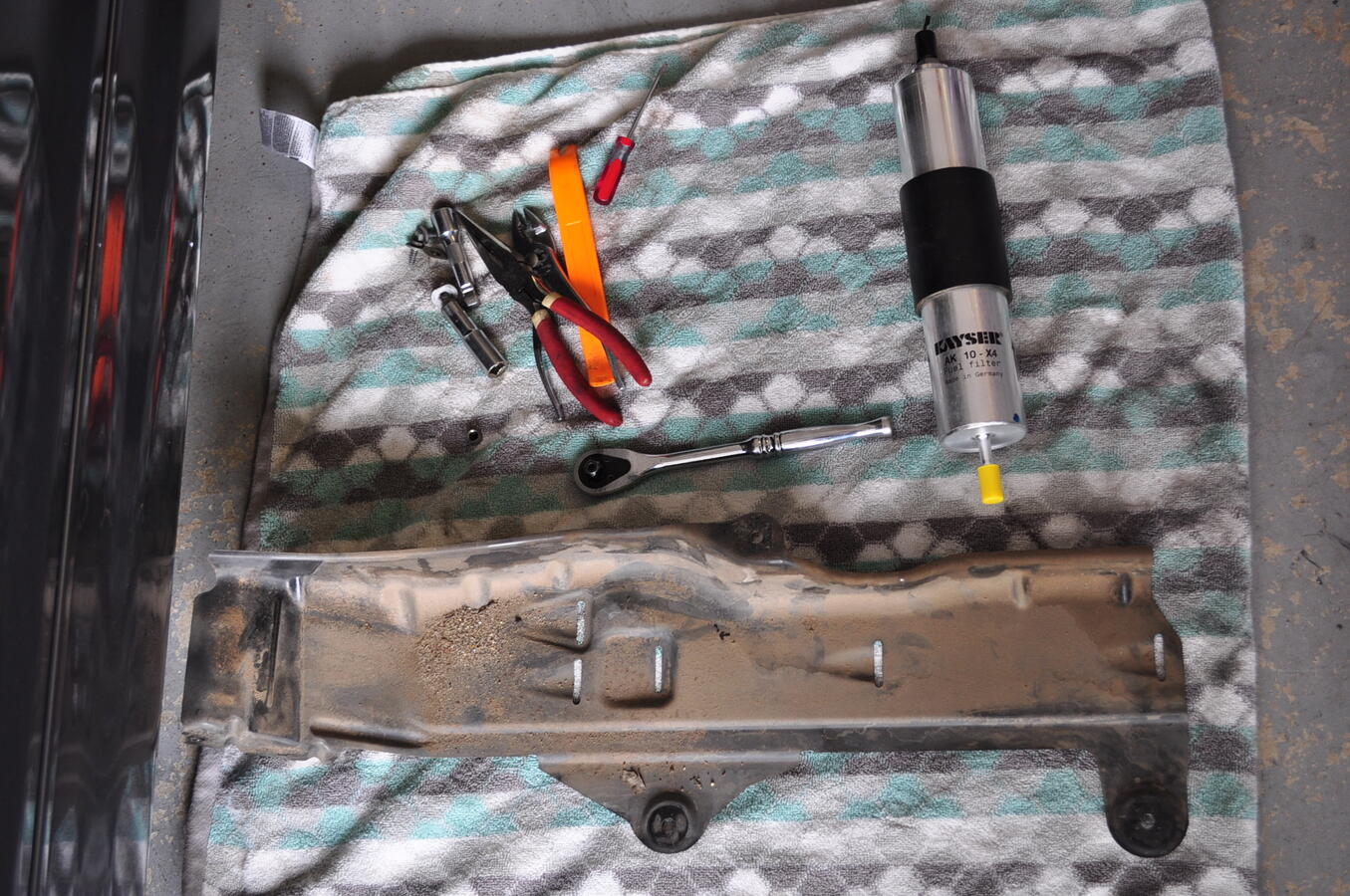

                      Did you think there wouldn't be dirt in this cover? The new filter is pictured - Kayser is the OES part for BMW, not the commonly available Mahle. The Kayser doesn't require an extra copper crush washer like the Mahle does (same size as oil plug I believe).
                      Click image for larger version  Name:	fuel03.JPG Views:	0 Size:	62.8 KB ID:	119376
                      Click image for larger version  Name:	fuel05.JPG Views:	0 Size:	131.9 KB ID:	119374

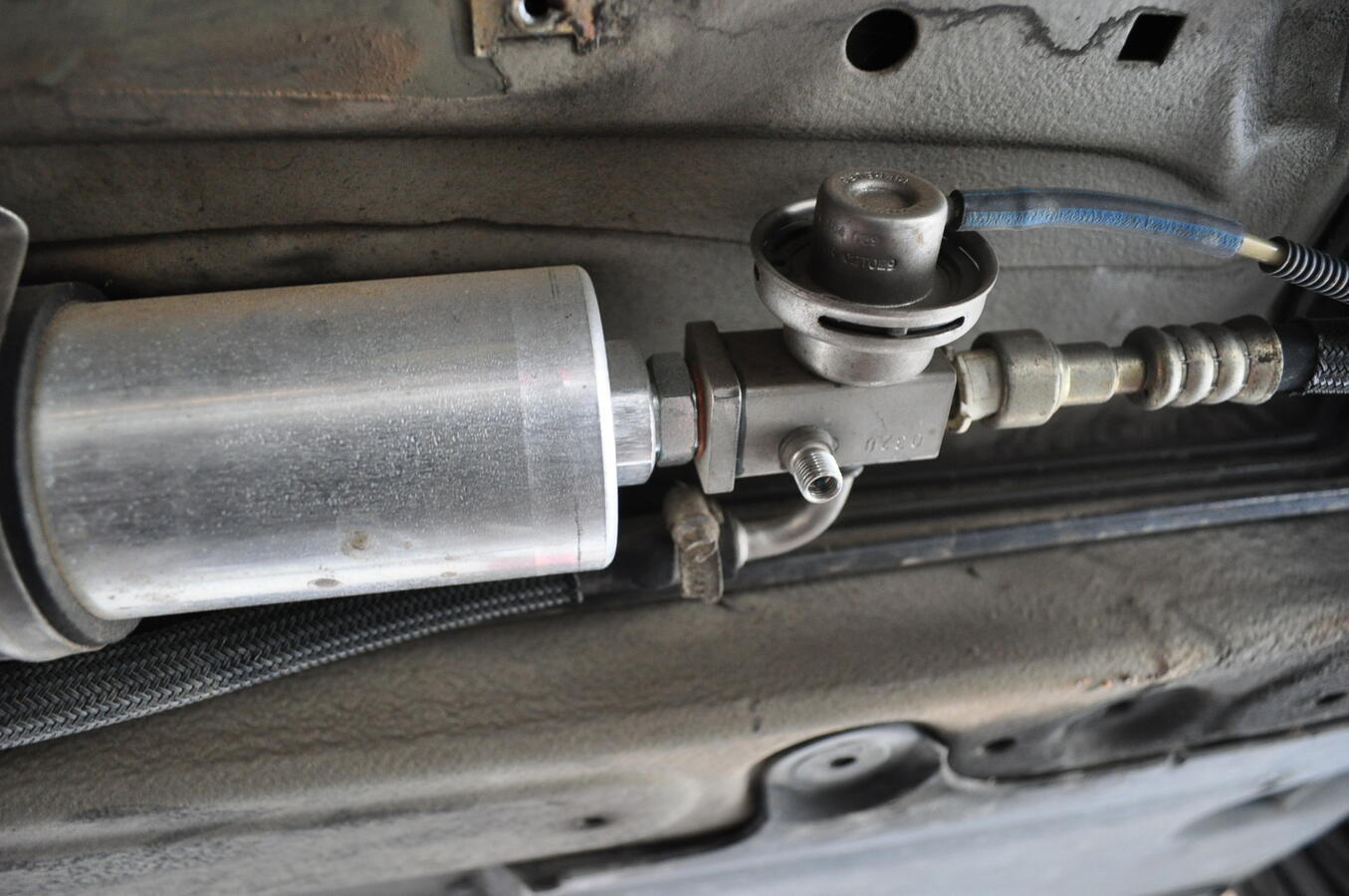

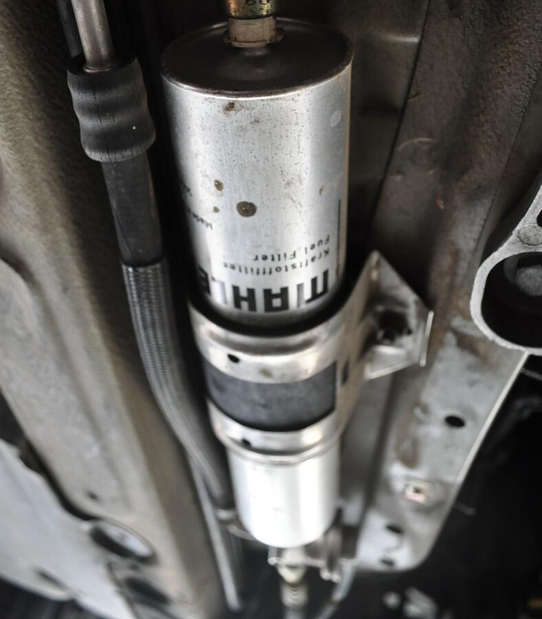

                      Hey look, a Mahle, so at least I know it was changed at some point. See the copper washer?
                      Click image for larger version  Name:	fuel12.JPG Views:	0 Size:	90.3 KB ID:	119377

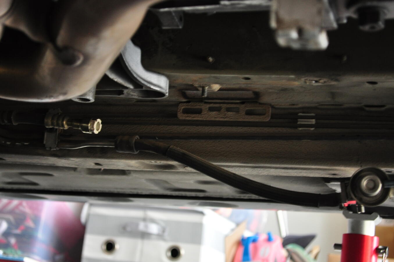

                      I start by undoing the front connection as the rear connection is free to spin, allowing you to unthread the filter from the block. Then I use needle nose pliers to wedge between the quick disconnect plastic and the filter body to pop it off. I lay a towel down to catch the fuel that will come out. In my experience, it doesn't really help to pull the fuse and let the car die to use up the fuel, fuel will still pour out the filter anyway. Besides that, you can undo pressure at the schrader valve at the regulator, but when I did it, no pressure was released anyway.
                      Click image for larger version  Name:	fuel13.JPG Views:	0 Size:	233.9 KB ID:	119378
                      New vs old, cleaned up the cover.
                      Click image for larger version  Name:	fuel14.JPG Views:	0 Size:	131.4 KB ID:	119379

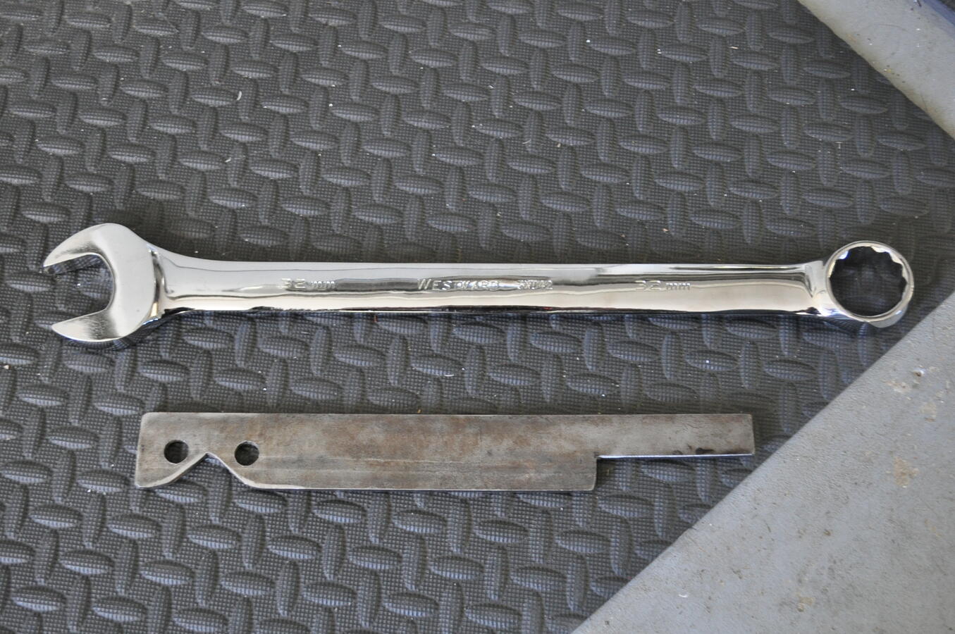

                      Install reverse of removal. I custom made a set of thin wrenches out of some cheap standard open end wrenches. You wouldn't be able to fit a standard wrench in here

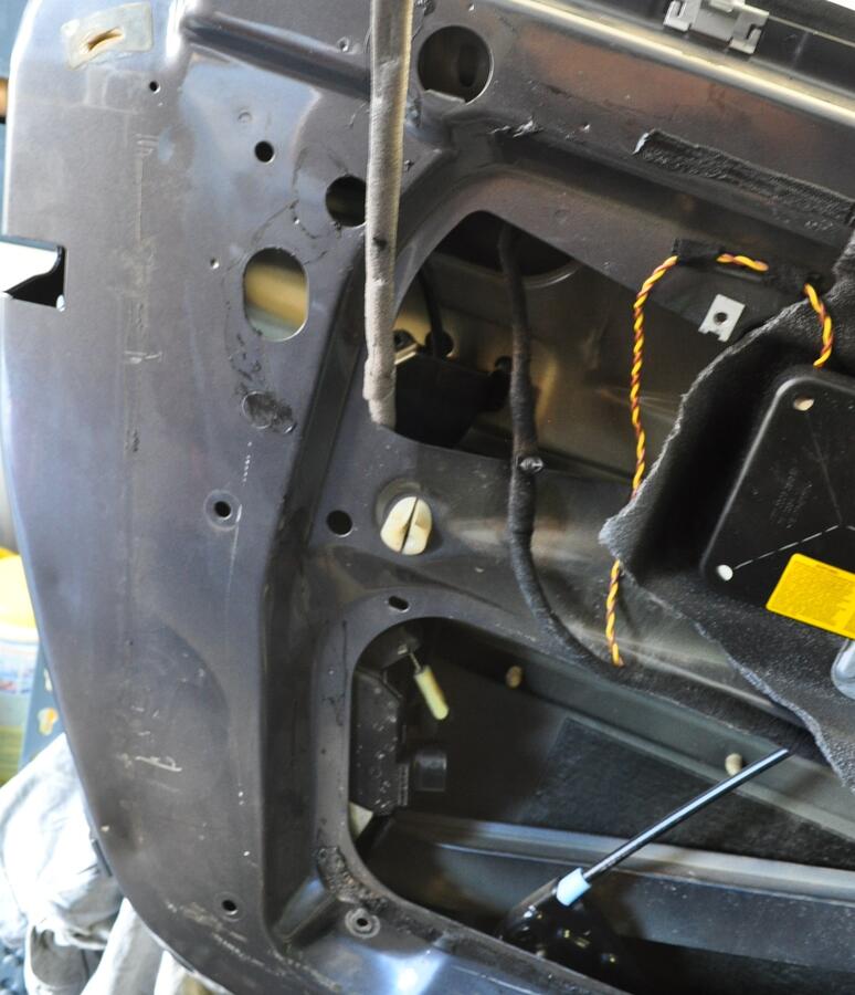

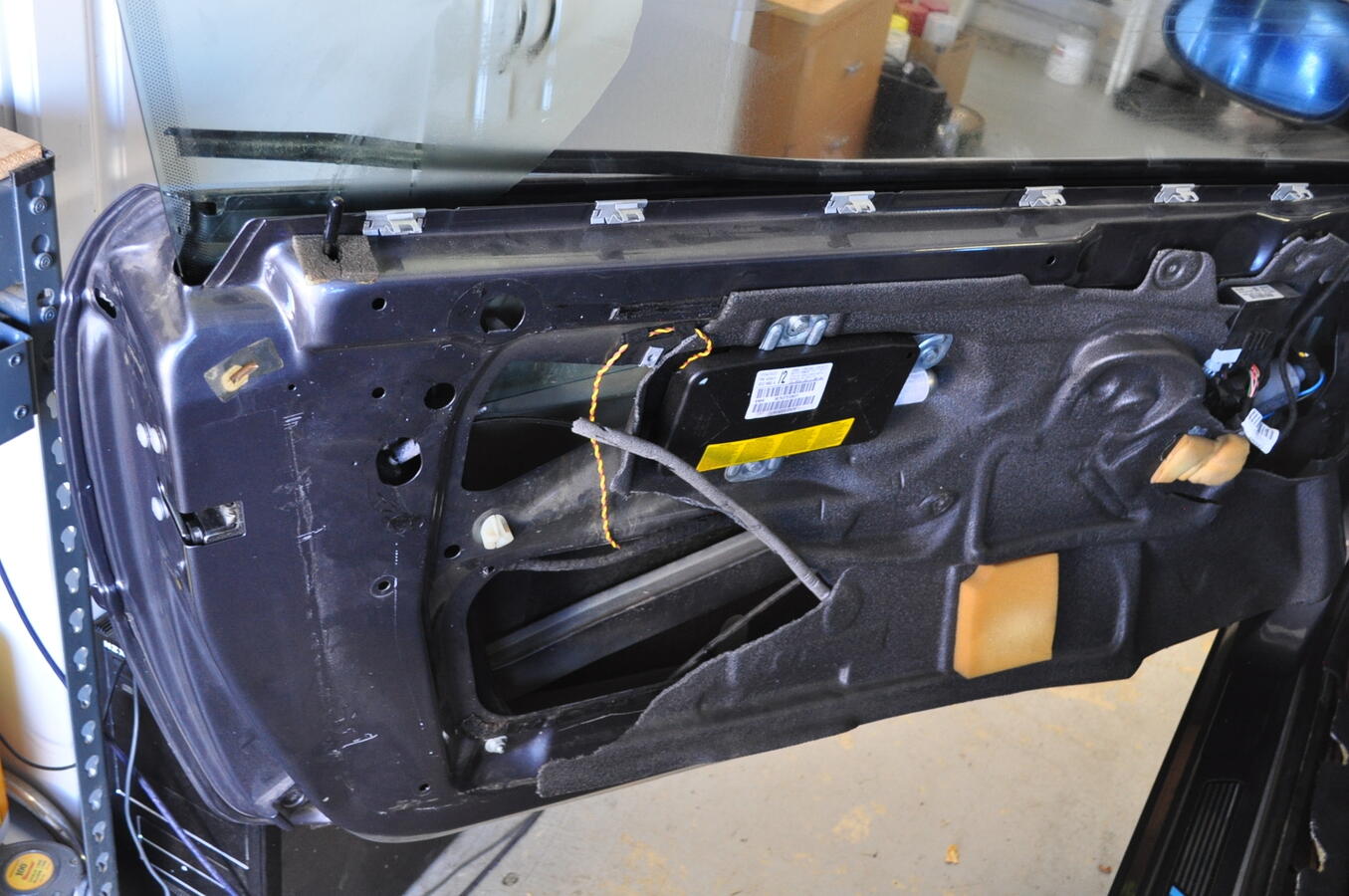

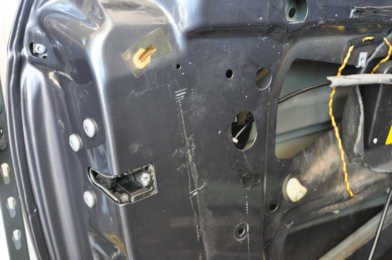

                      I previously documented the regulator swap on the passenger door, but on the driver door, while the window worked fine, the door would not drop the window to exit or raise it to seal. Nor would the center lock button open or lock the door.
                      Click image for larger version  Name:	drvactu1.JPG Views:	0 Size:	159.8 KB ID:	119380
                      Got the panel off, of course the driver vapor barrier is torn as well lol. The deep scratches from getting the panel off are not from me
                      Click image for larger version  Name:	drvactu2.JPG Views:	0 Size:	182.3 KB ID:	119381

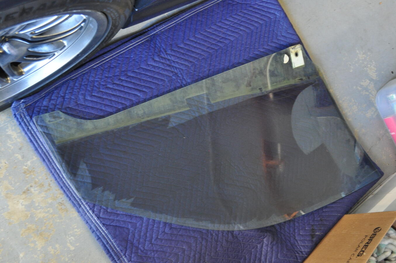

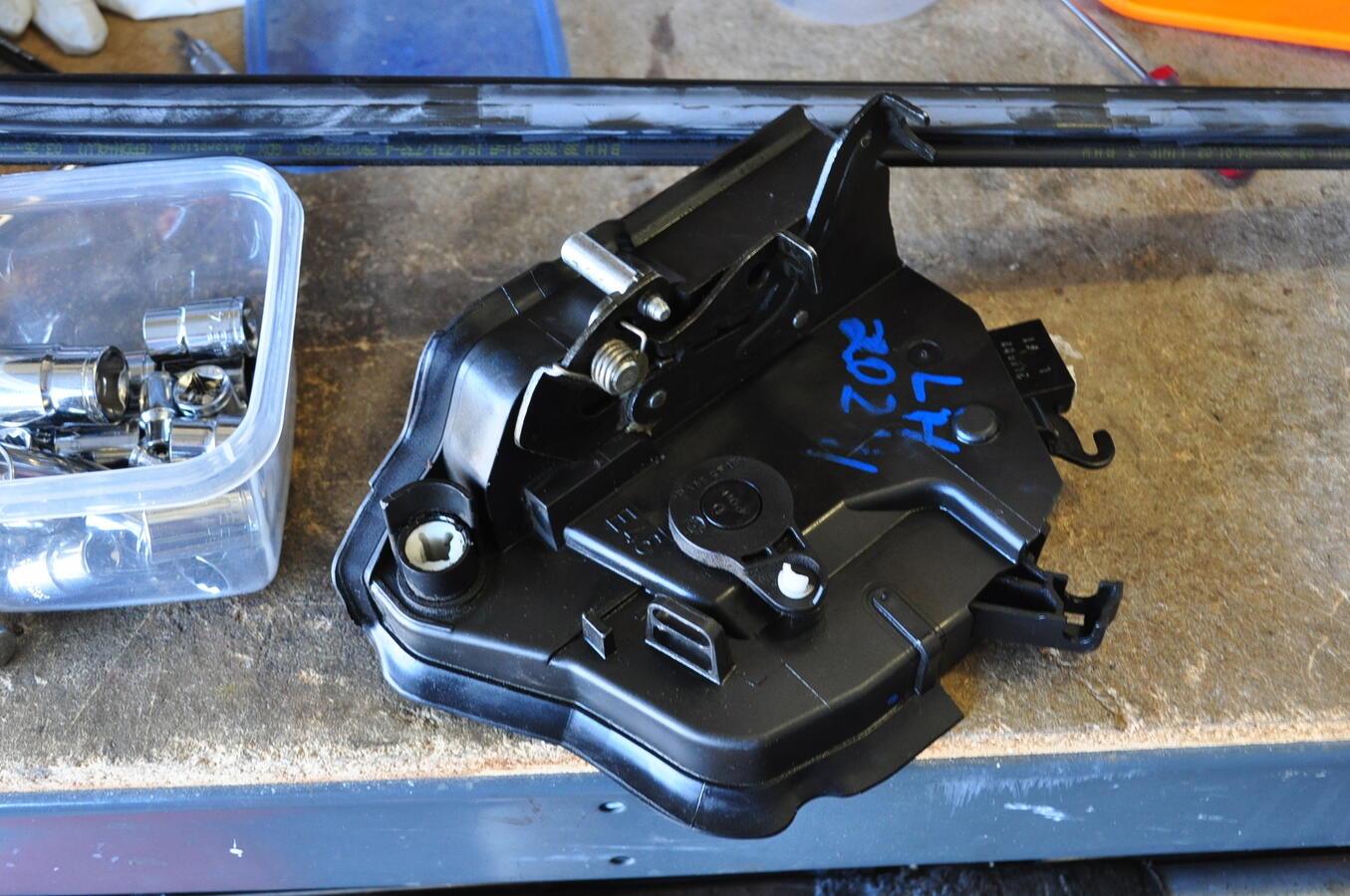

                      Found a nice looking actuator on ebay, also from a 2002, with fairly low mileage. Unfortunately, seller didn't disclose that the lock push pin's (don't know what to call it) clip was broken, but I was able to swap my original over.
                      Click image for larger version  Name:	drvactu3.JPG Views:	0 Size:	153.0 KB ID:	119383
                      You can see my previous attempt to remove the tint was frustratingly futile.
                      Click image for larger version  Name:	drvactu4.JPG Views:	0 Size:	184.3 KB ID:	119382

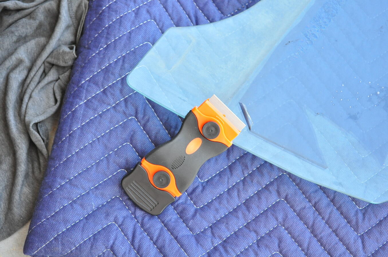

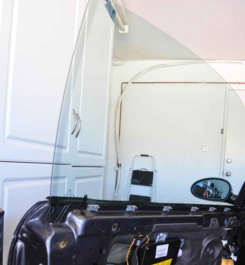

                      Sprayed it with windex, and let it sit out in the hot sun for a while. Then it came off easily.
                      Click image for larger version  Name:	drvactu5.JPG Views:	0 Size:	76.8 KB ID:	119384
                      I found that it's possible to remove/install the actuator without removing the regulator is you just loosen the back 2 nuts and move it out of the way a bit.
                      Click image for larger version  Name:	drvactu6.JPG Views:	0 Size:	148.6 KB ID:	119386
                      New one in. A little tricky getting everything connecting in there.
                      Click image for larger version  Name:	drvactu7.JPG Views:	0 Size:	58.1 KB ID:	119385

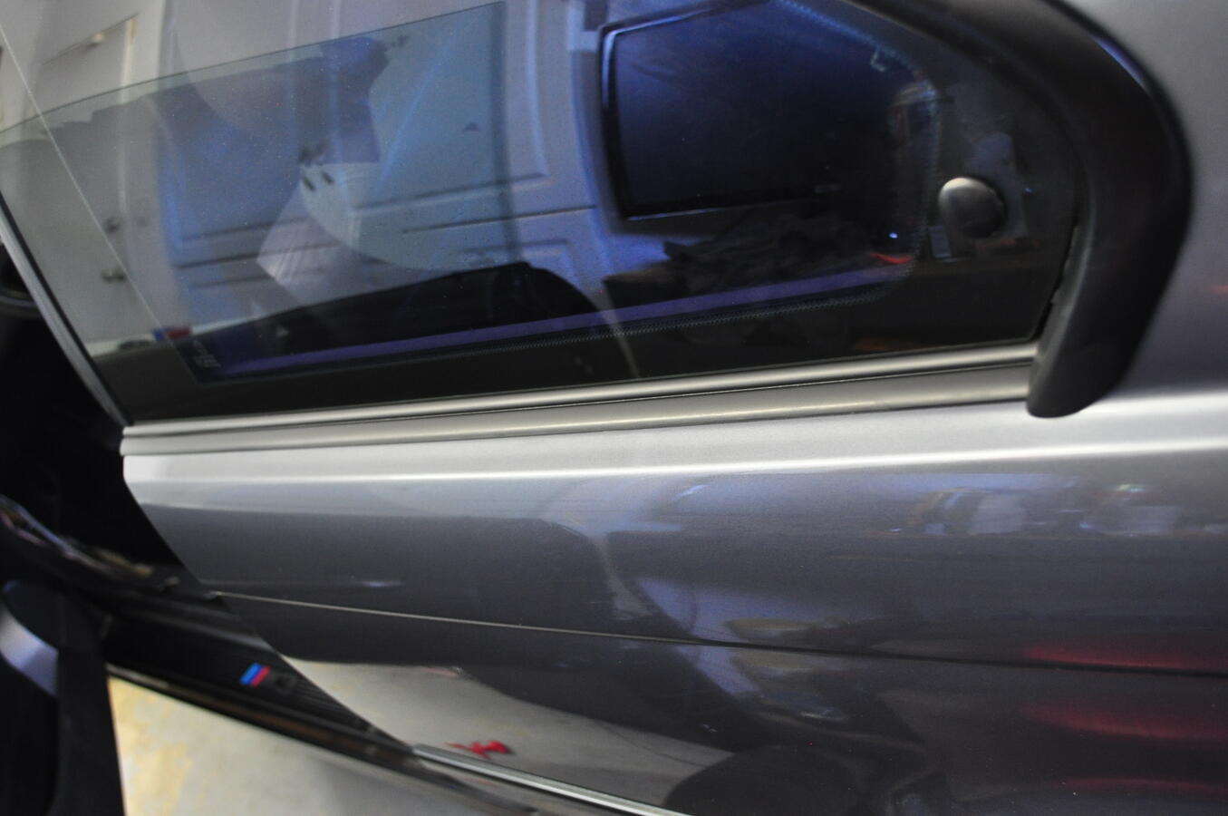

                      Ahhh, clean glass! Now both doors' glass is clear with the rear quarters and rear glass still to do.
                      Window and lock work properly now, though I did have to play with the adjustment of the window so check that (E6? socket, not large) before you put the panel back on. Outer trim piece was also replaced as you can see in a post above.

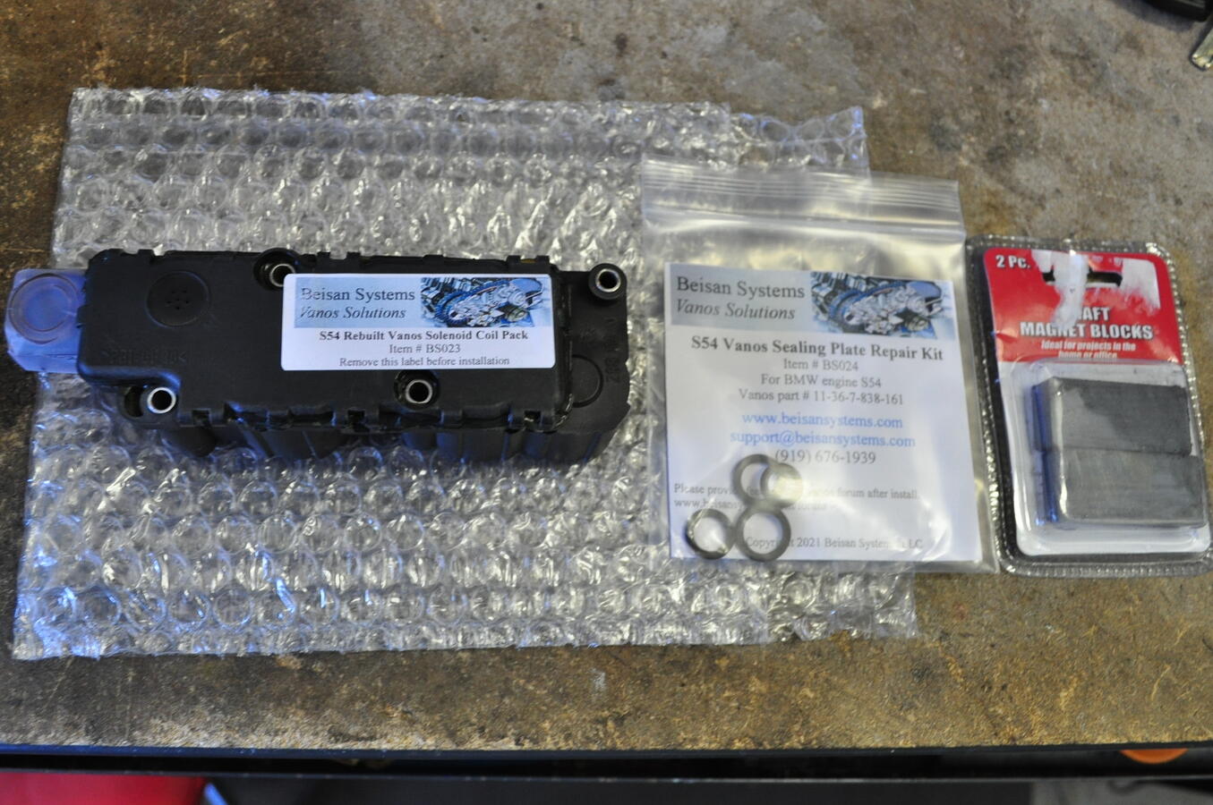

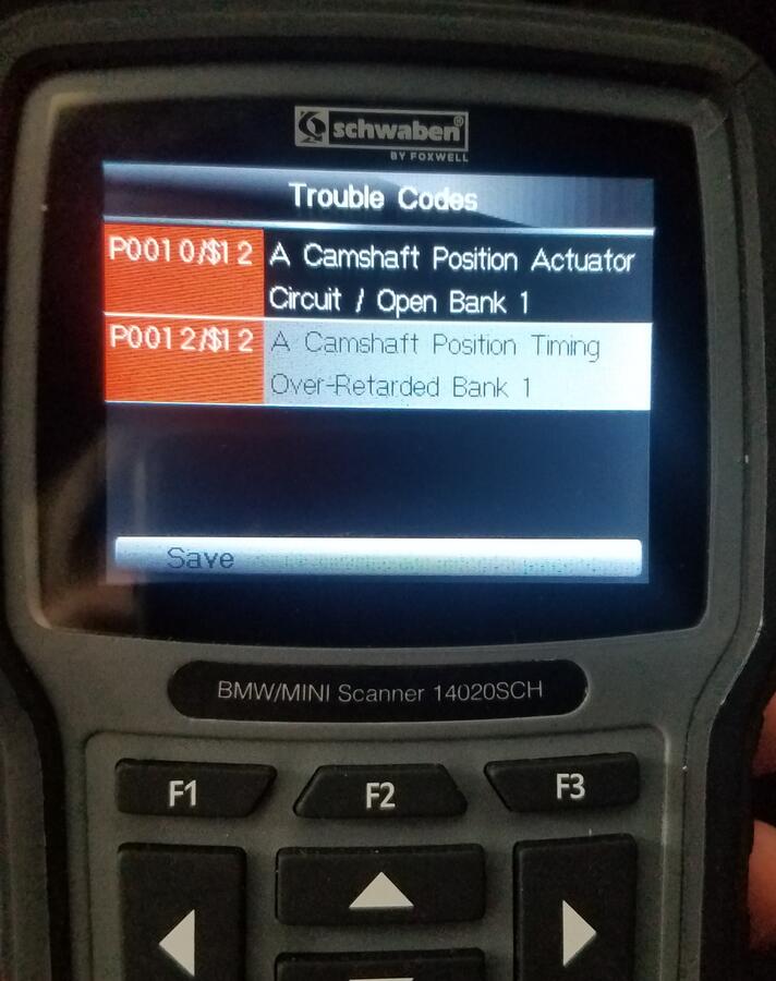

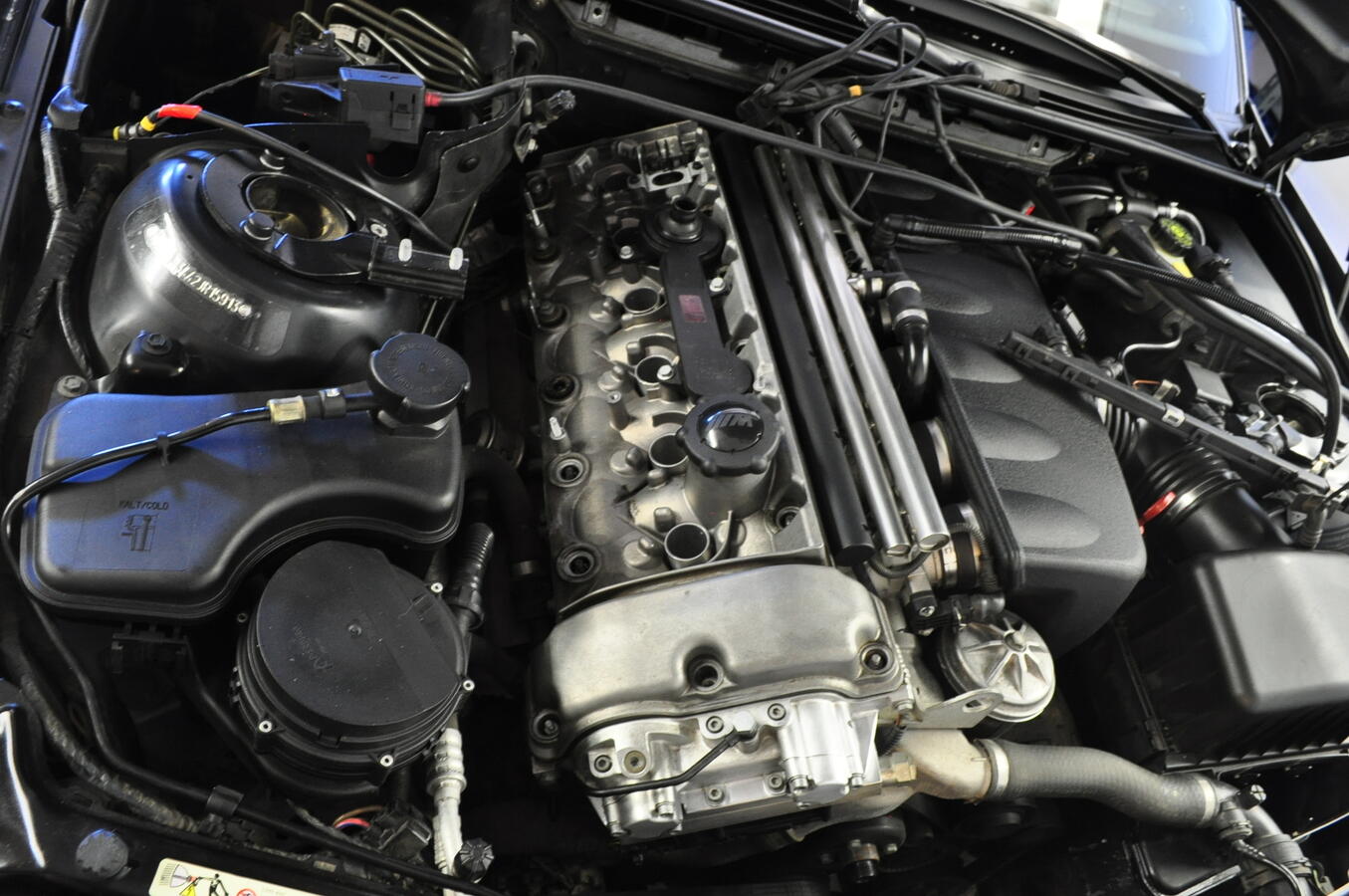

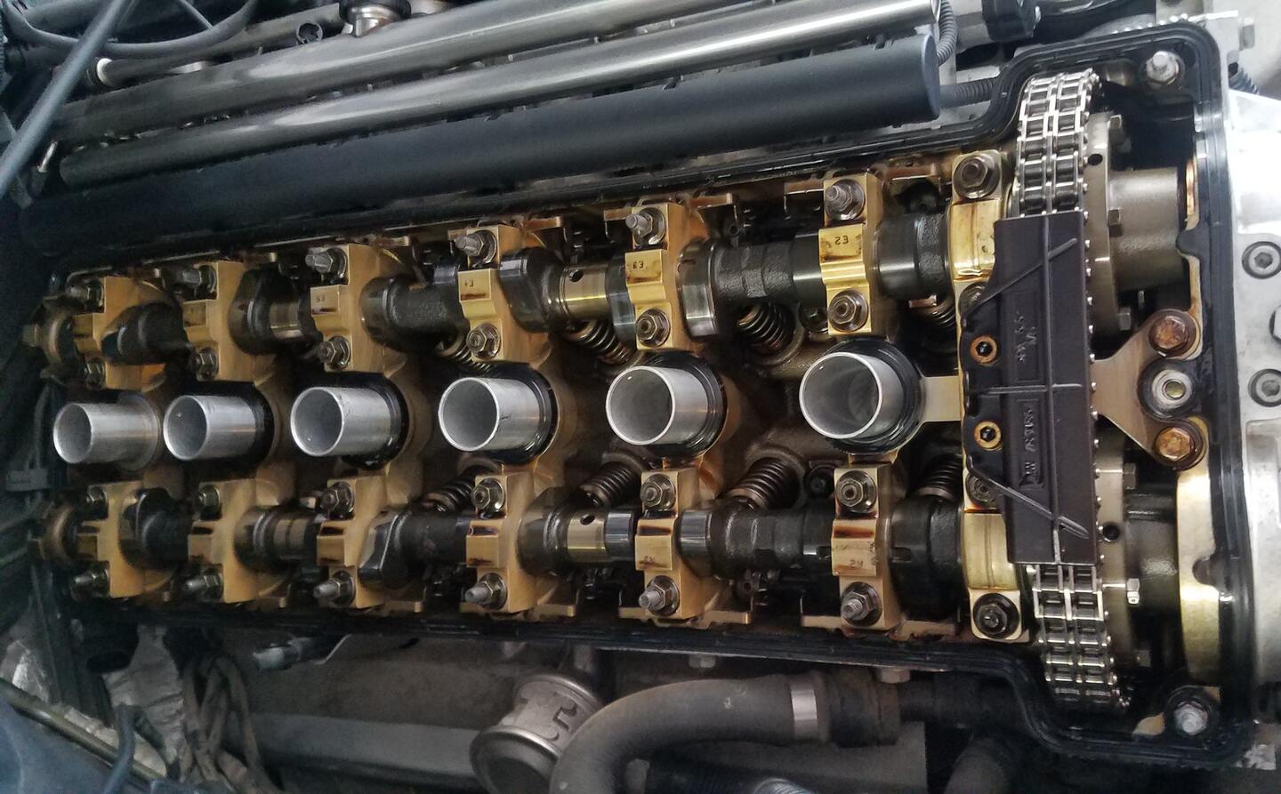

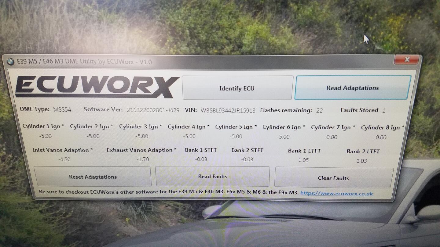

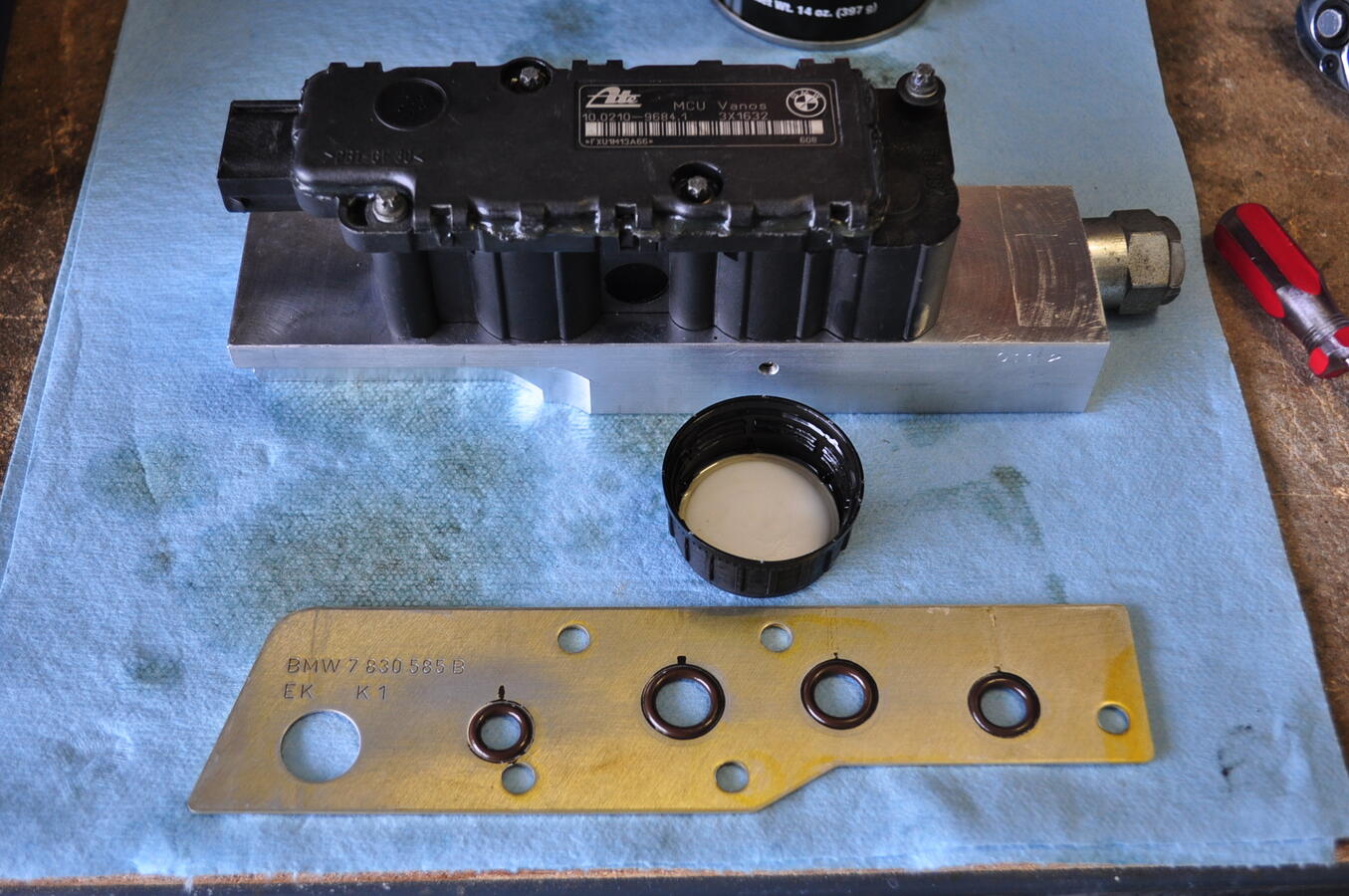

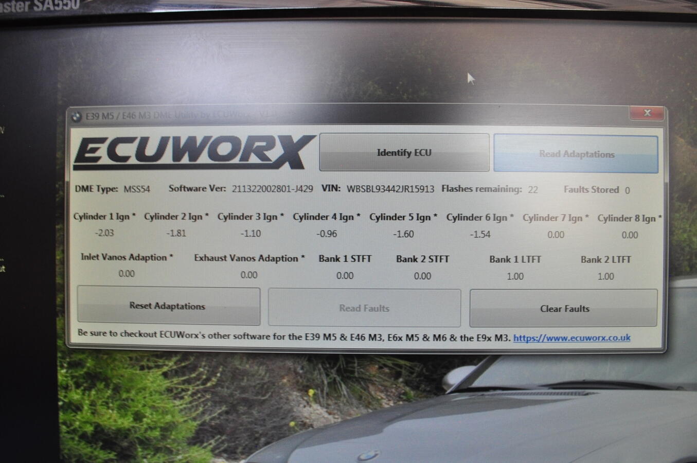

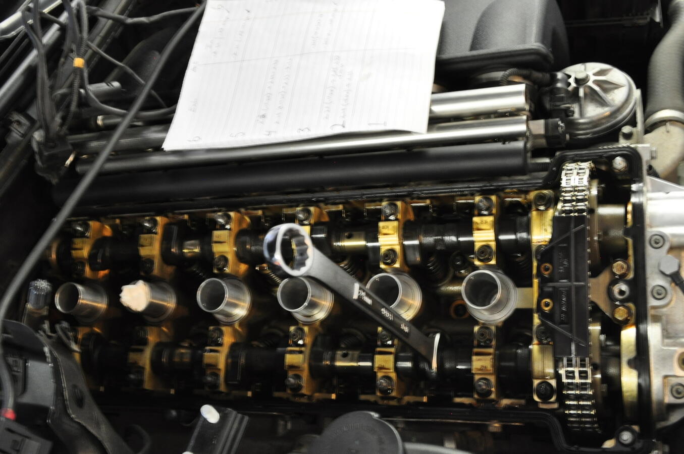

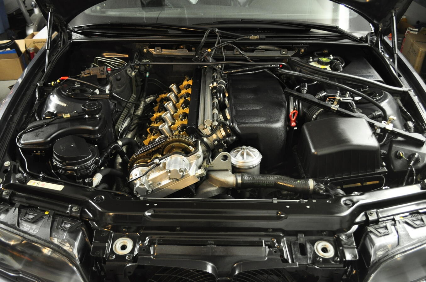

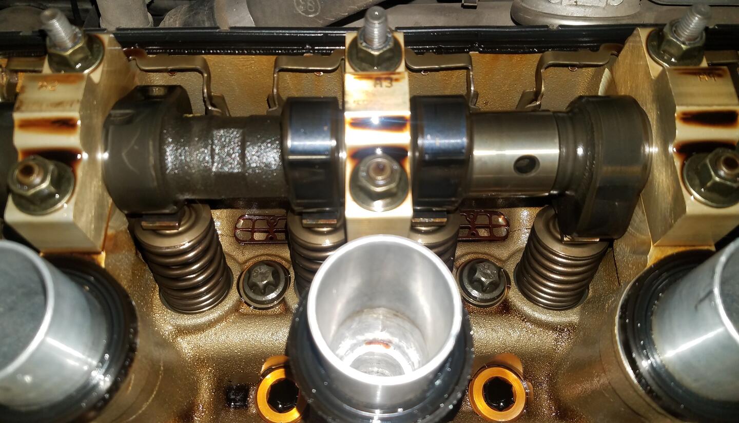

                        Got these codes that might make you think cam sensors, but they're actually indicators of a faulty vanos solenoid
                        Click image for larger version  Name:	vanos100.jpg Views:	0 Size:	69.8 KB ID:	121179
                        Got a refurbished solenoid and plate seals from Besian, as well as magnets to open the valves to clean the block
                        Completely forgot to get the chain tensioner guide
                        Click image for larger version  Name:	vanos101.JPG Views:	0 Size:	190.3 KB ID:	121181
                        As expected
                        Click image for larger version  Name:	vanos102.JPG Views:	0 Size:	85.9 KB ID:	121178

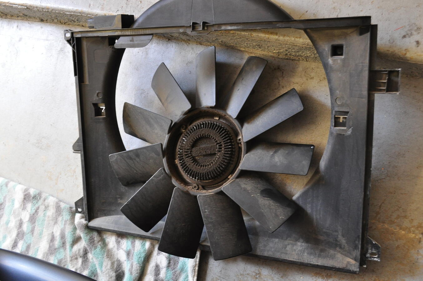

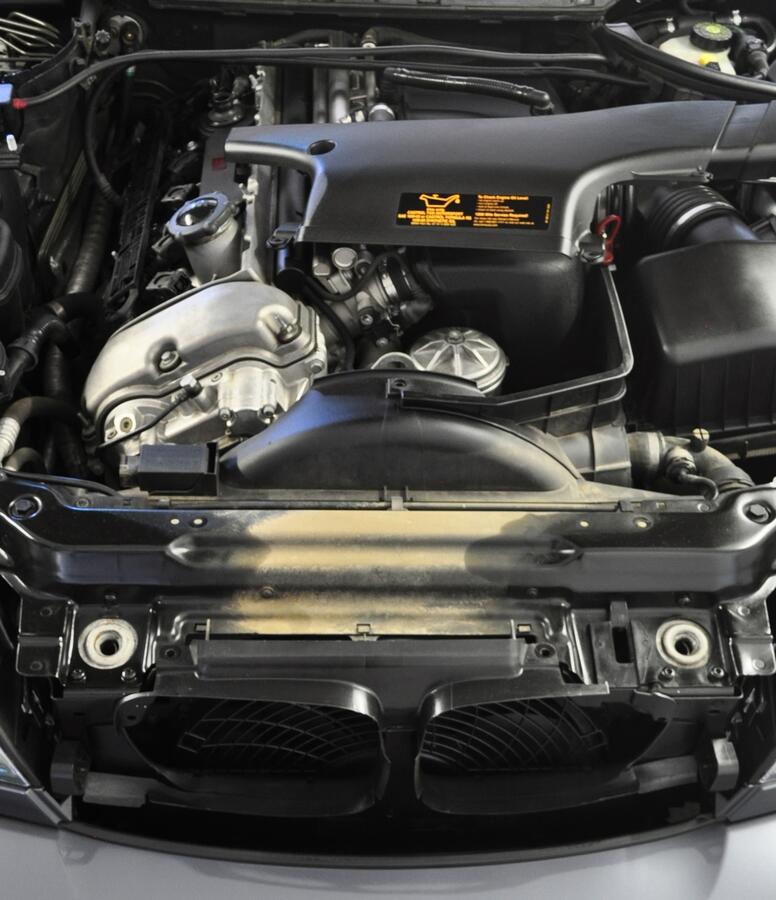

                        My crude fan tool
                        Click image for larger version  Name:	vanos105.JPG Views:	0 Size:	206.9 KB ID:	121180
                        So dirty
                        Click image for larger version  Name:	vanos106.JPG Views:	0 Size:	154.1 KB ID:	121183

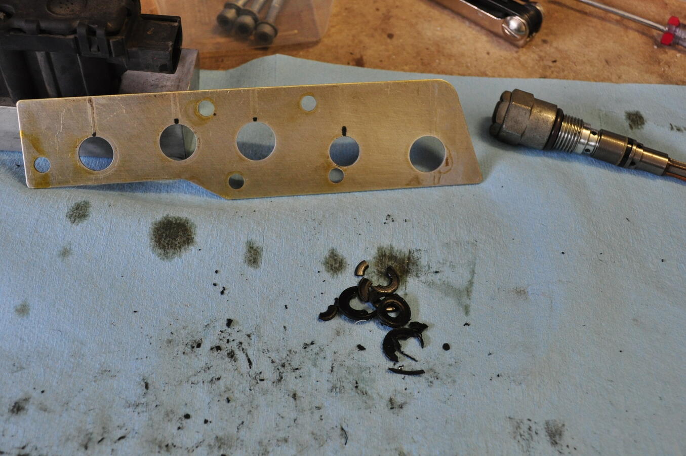

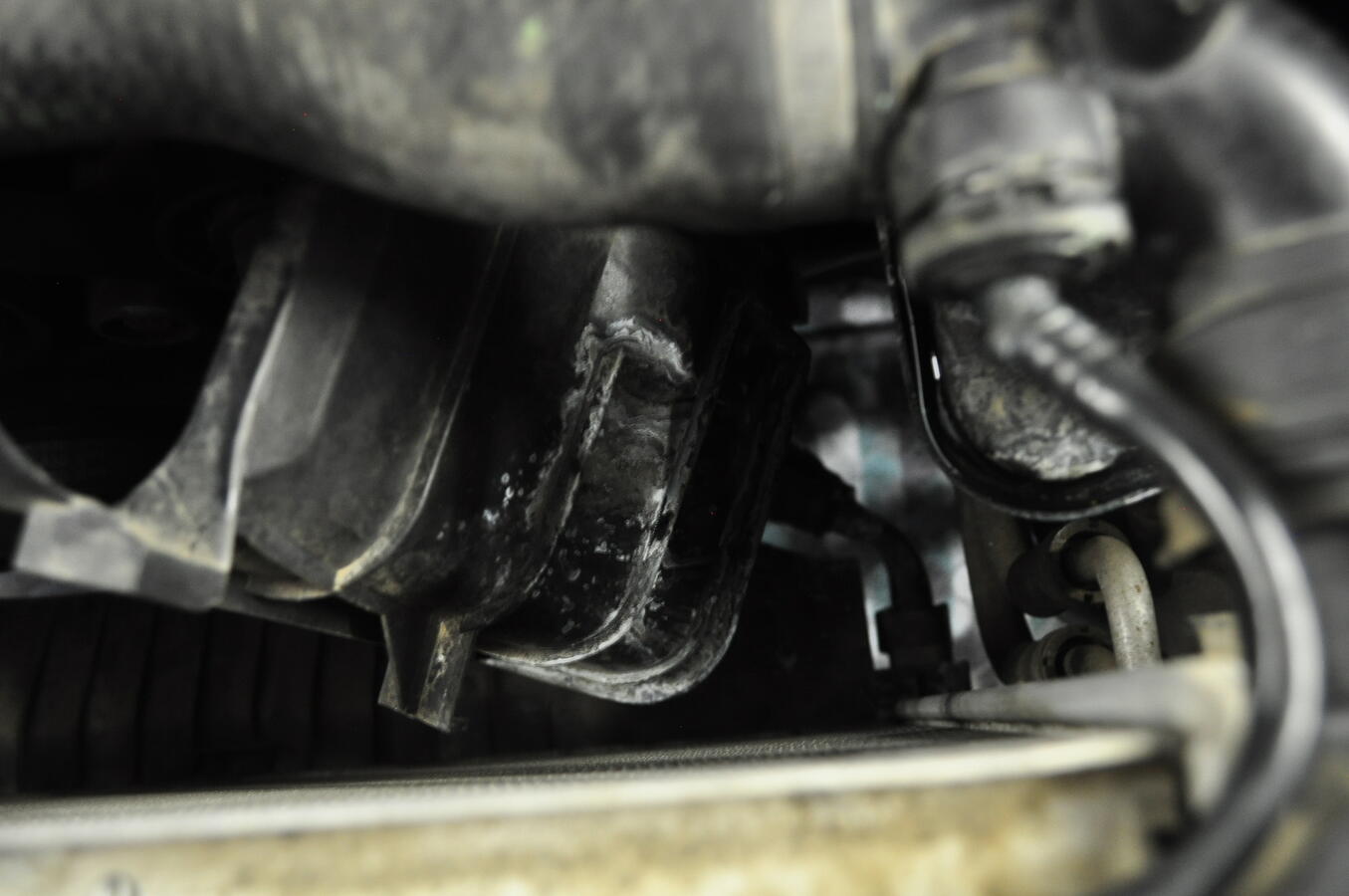

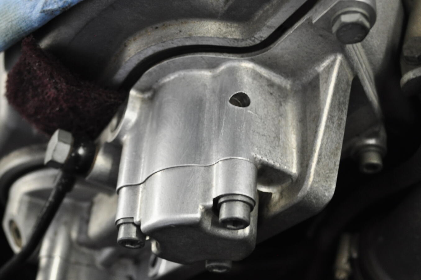

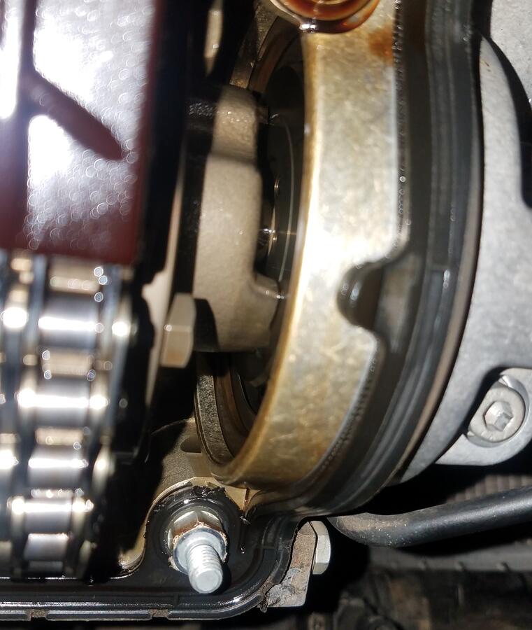

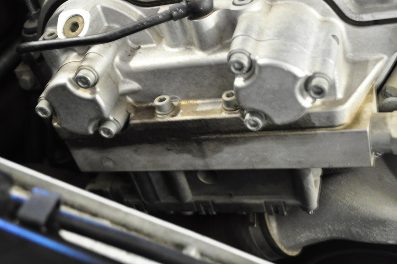

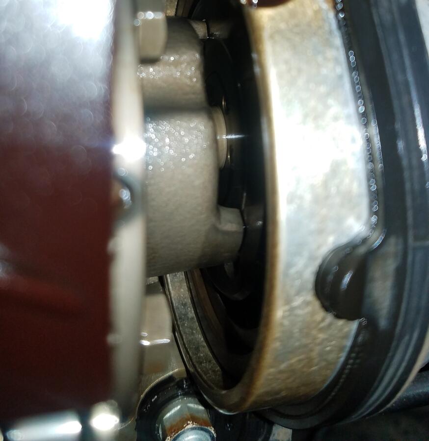

                        Look at the oil seepage on the vanos sealing plate - ya they're donzo
                        Click image for larger version  Name:	vanos109.JPG Views:	0 Size:	101.5 KB ID:	121184
                        Coolant's spraying out of the exp line. Gonna do cooling soon anyway
                        Click image for larger version  Name:	vanos108.JPG Views:	0 Size:	80.5 KB ID:	121182

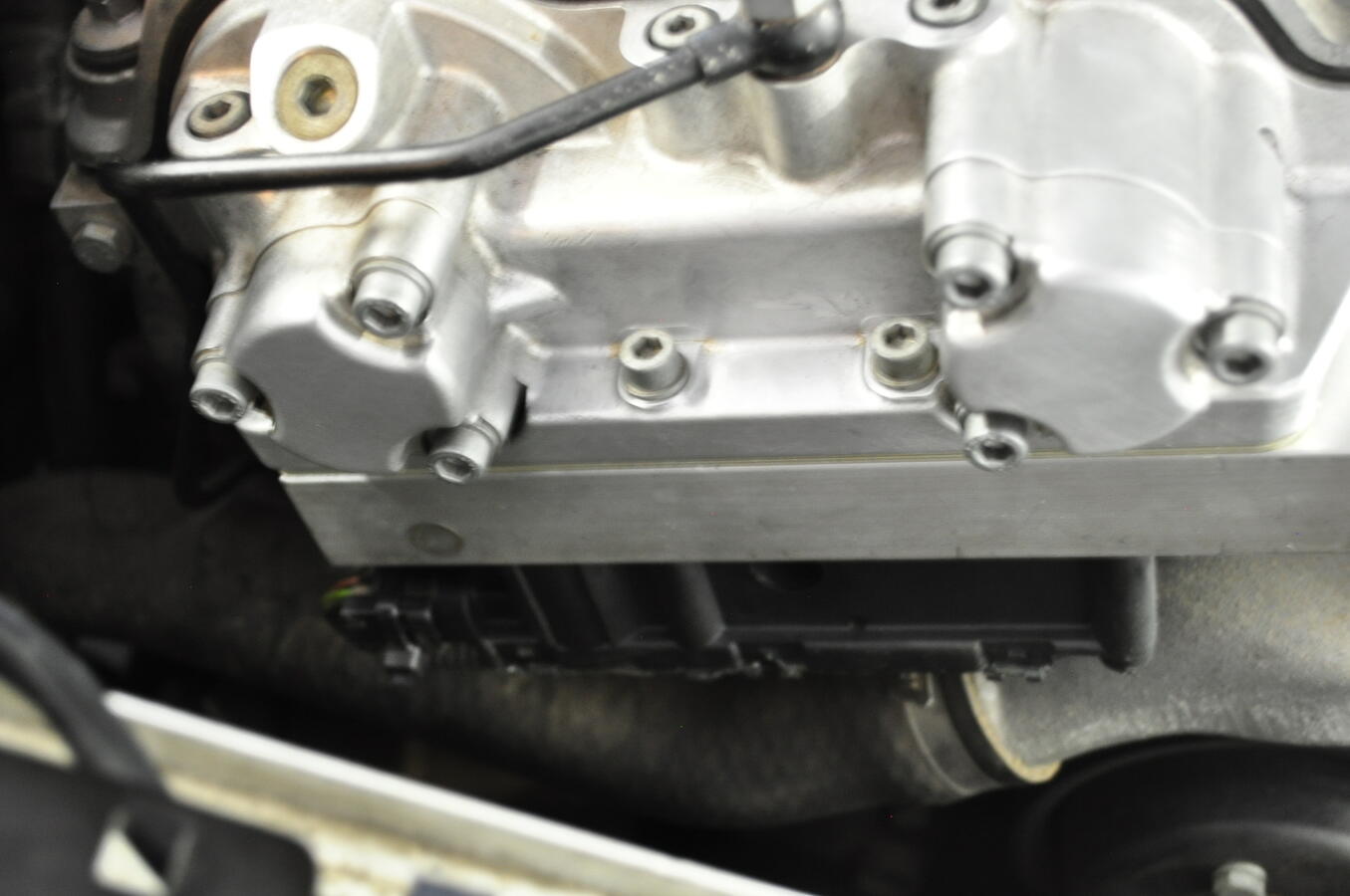

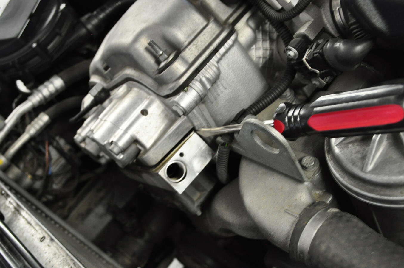

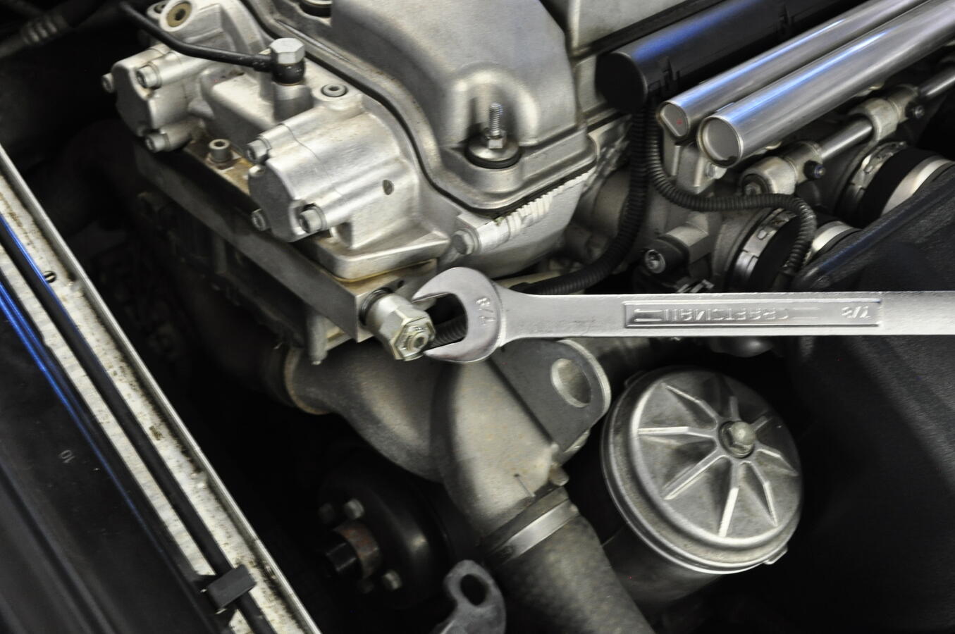

                        As Raj says, loosen the pressure actuator before removing block
                        Click image for larger version  Name:	vanos110.JPG Views:	0 Size:	129.7 KB ID:	121187
                        I needed a little help cracking it loose
                        Click image for larger version  Name:	vanos112.JPG Views:	0 Size:	117.0 KB ID:	121185
                        Flat as my 1st girlfriend
                        Click image for larger version  Name:	vanos113.JPG Views:	0 Size:	108.6 KB ID:	121186
                        Cut 'em out.
                        Click image for larger version  Name:	vanos114.JPG Views:	0 Size:	156.6 KB ID:	121188

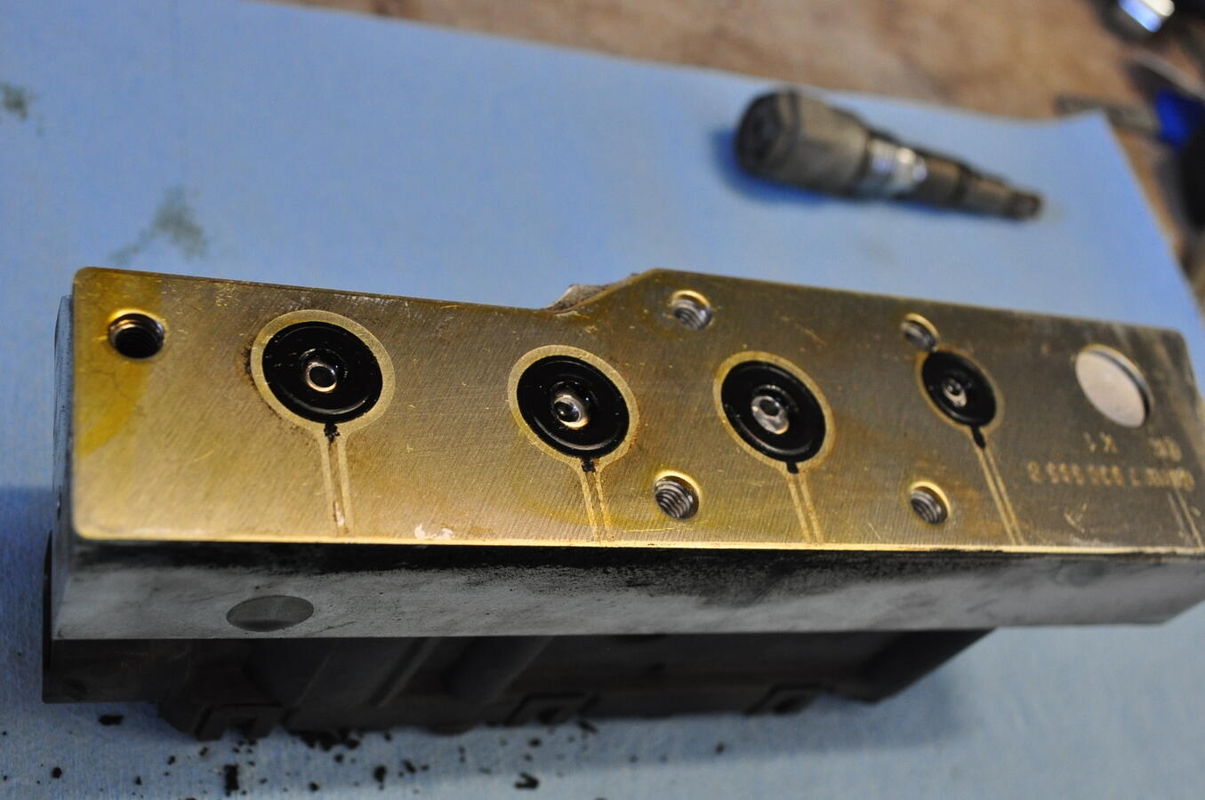

                        Separate solenoid and block (tiny e-torx). Seeing the "VANOS" written is pretty cool
                        Click image for larger version  Name:	vanos115.JPG Views:	0 Size:	161.9 KB ID:	121190

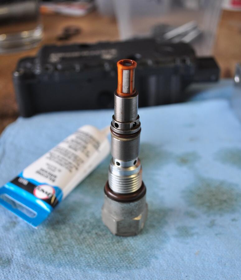

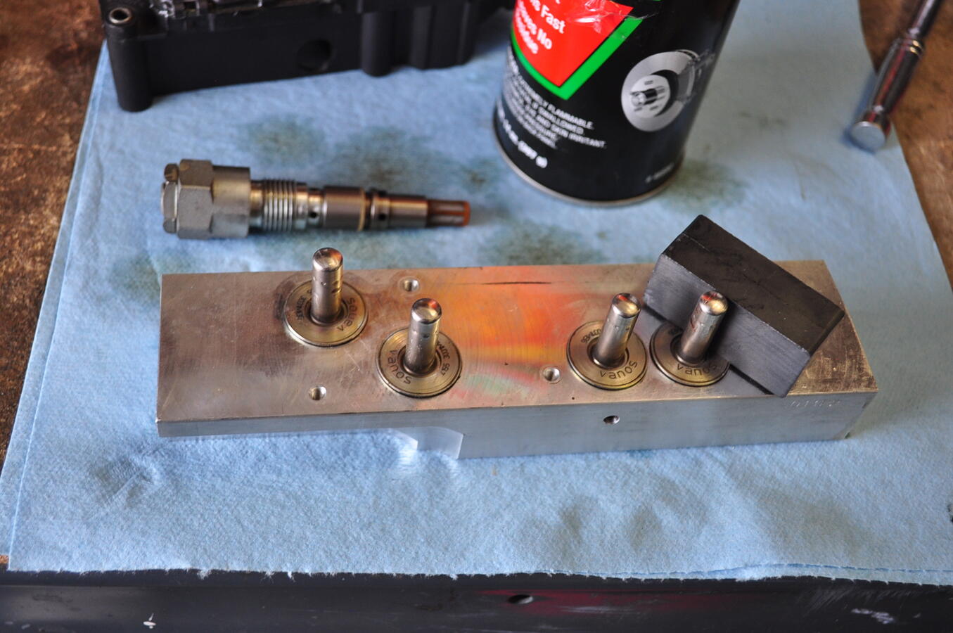

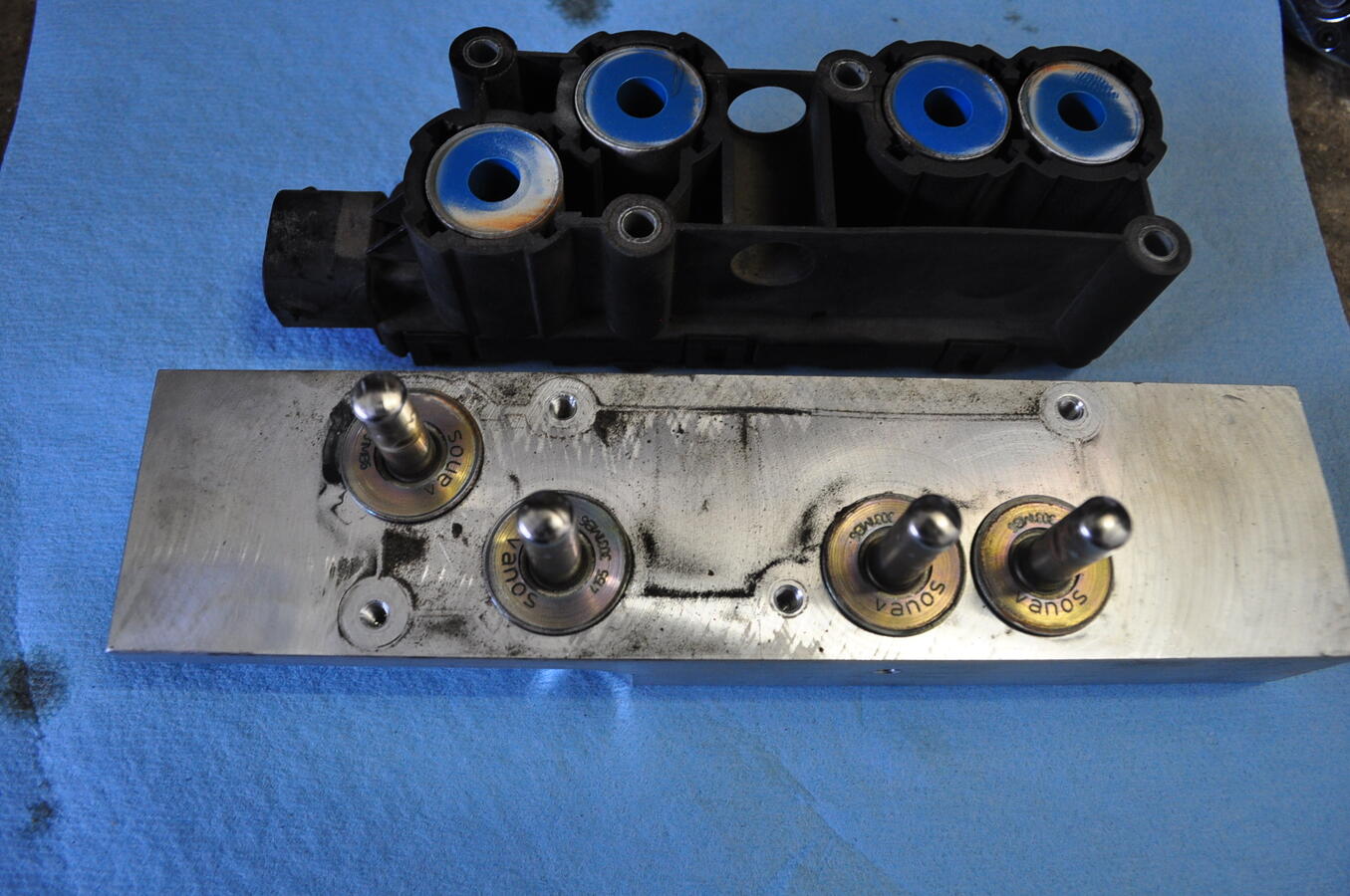

                        Use a strong magnet to open them, and spray brake cleaner through the orifices. O-rings removed from actuator (in background)
                        Click image for larger version  Name:	vanos117.JPG Views:	0 Size:	143.0 KB ID:	121191
                        Lubed new o-rings supplied with solenoid, and rolled onto actuator. Spray out the filter. I replaced it on my other car, but there's no need if it's in good shape with no chunks of metal
                        Click image for larger version  Name:	vanos118.JPG Views:	0 Size:	53.5 KB ID:	121189
                        Lubed and installed o-ring. They don't fit too well. You just have to center them as best you can. They'll get squished fine if you tighten the e-torx bolts evenly.
                        Click image for larger version  Name:	vanos119.JPG Views:	0 Size:	182.7 KB ID:	121192

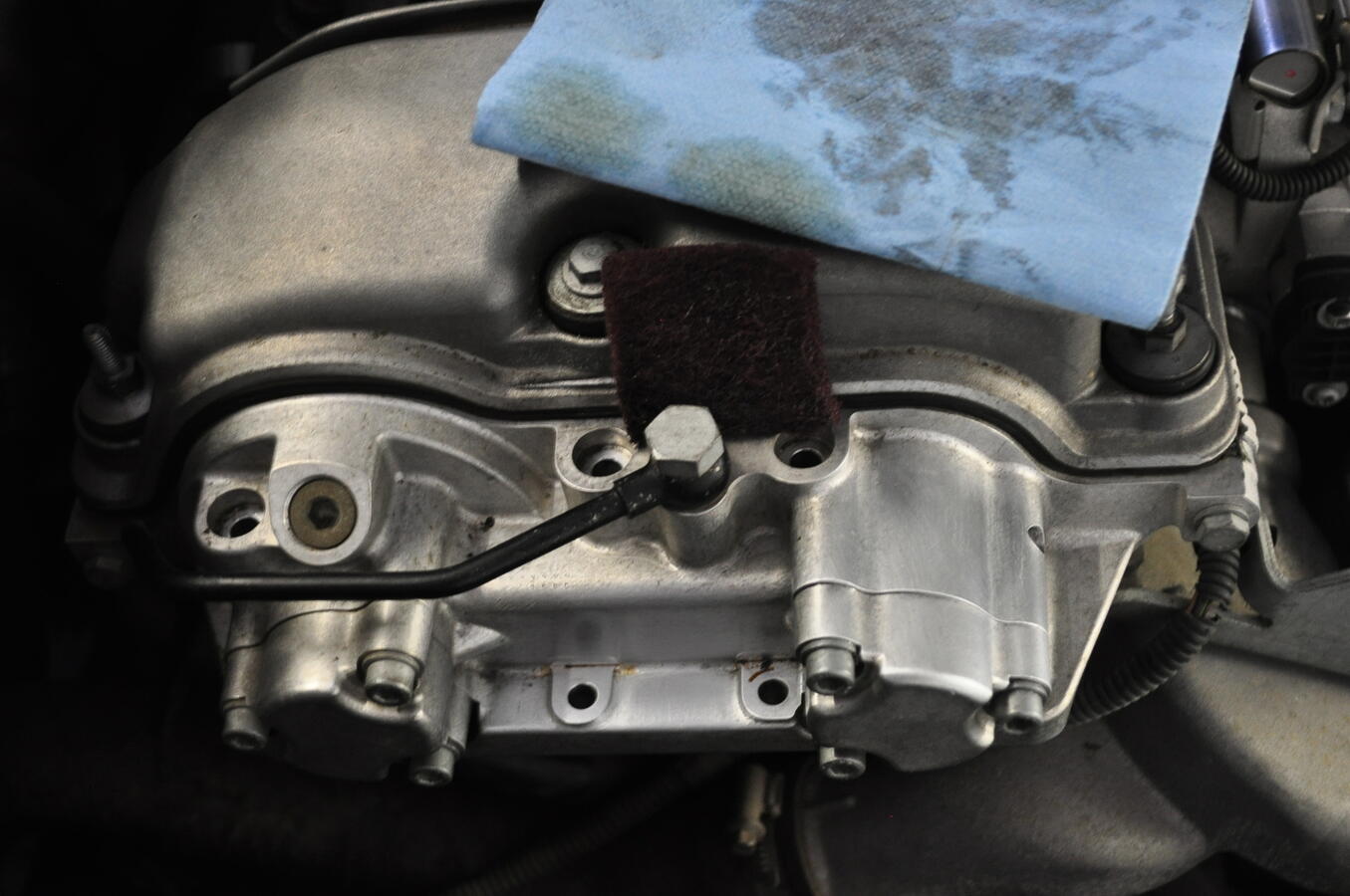

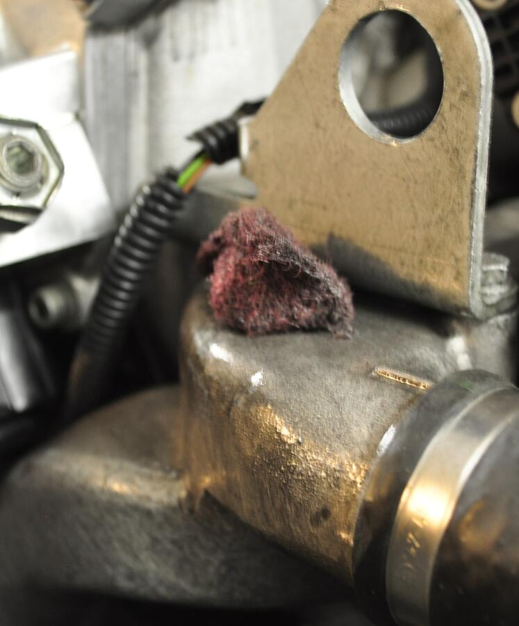

                        Decided to clean the vanos unit with my go-to red pad and wd-40. I polished it on my other car, but wanted a different look befitting a car that isn't as special/modded. This results in a brushed look more or less.
                        Click image for larger version  Name:	vanos120.JPG Views:	0 Size:	116.5 KB ID:	121193 Click image for larger version  Name:	vanos122.JPG Views:	0 Size:	91.8 KB ID:	121195
                        Solenoid and block back on, connector zip tied
                        Click image for larger version  Name:	vanos126.JPG Views:	0 Size:	84.3 KB ID:	121196
                        Did the oil filter housing cap and hook as well
                        Click image for larger version  Name:	vanos206.JPG Views:	0 Size:	68.9 KB ID:	121194
                        Click image for larger version  Name:	vanos207.JPG Views:	0 Size:	60.0 KB ID:	121197
                        Click image for larger version  Name:	vanos208.JPG Views:	0 Size:	93.6 KB ID:	121198
                        Alright, time for valve adjustment. Cover ready to be removed - moment of truth - is my hub fuxd?
                        Click image for larger version  Name:	vanos209.JPG Views:	0 Size:	167.0 KB ID:	121199
                        Okay okay this is a good sign! Super clean, low varnish for a 2002 w/ 124k. Feeling good here...
                        Click image for larger version  Name:	vanos210.jpg Views:	0 Size:	178.1 KB ID:	121200
                        Everything looks great. Cam lobes are smooth, no spit shims (would have heard it tbh), plastic gulley guards are present and not cracked.
                        Click image for larger version  Name:	vanos211.jpg Views:	0 Size:	174.7 KB ID:	121203
                        Here we go. First tab that's visible
                        Click image for larger version  Name:	vanos212.jpg Views:	0 Size:	62.0 KB ID:	121201
                        Yes! And I'm not seeing ANY evidence of hammering
                        Numero dos
                        Click image for larger version  Name:	vanos213.jpg Views:	0 Size:	79.2 KB ID:	121202
                        Fuck ya. Still no evidence of any hammering whatsoever I'm not even exaggerating. I've done my own car and plenty of others' cars and I've never seen it this perfect.
                        Almost every valve needed a thicker shim. Think it was every exhaust valve and 9/12 intakes. I used so many 2.28s, 2.32s and 2.36s, I had to stop and go to the dealer who luckily still had their box of shims. I was worried when the parts manager said they hadn't adjusted an S54 in a long time. I was able to reuse some old shims, but they were all like 2.16-2.20.
                        Click image for larger version  Name:	vanos306.JPG Views:	0 Size:	144.7 KB ID:	121204
                        All done
                        Click image for larger version  Name:	vanos311.JPG Views:	0 Size:	190.2 KB ID:	121205
                        No, I didn't bother with the undoing timing and the cam bolts. IMO/experience, it's the 05s/06s that really had those issues. I also was trained to not fuck with something that's performing beautifully. My 2004 has 180k with original bolts as well, just a besian disc. I believe the vanos stuff is over blown. I believe rod bearings are more like a 150k item, not 100k (many more 200k+ cars on original bearings than 50-100k cars that spun one - also look at the showcase thread where most had more life to go). RACP tears are the only thing I think are a very widespread, almost inevitable issue, but that's a slow moving problem.

                              Upgrading the taillights really wasn't on my mind. I even thought I'd keep the car period correct with the pre-facelift, original parts, but, one day, I pulled up behind my friend's '05 CB and the LEDs just looked so damn good. Yes, my 2004 has LEDs, but with the CSL parts, the whole rear end looked different. My friend's '05 is bone stock, so almost exactly like the steelgrey, and it just struck me so.
                              Didn't look for very long and happened upon an original set from a 2006 325ci on ebay for cheap. The outer tails' grey inner clips and backings (interior light portions) were not included, but I didn't care (don't even use them in my 2004 car). The LEDS all worked and the condition was very nice, so I just bought 'em. Didn't do any research, and got lucky that my LCM (02/02) is new enough to simply flash (think it's after 09/01?). Bought the OE harnesses for $30.
                              There had been some water getting behind my originals, turns out the foam gasket had split - easy enough to glue back together. Good time to clean the body.
                              Click image for larger version  Name:	LEDs01.JPG Views:	0 Size:	127.6 KB ID:	122216 Click image for larger version  Name:	LEDs02.JPG Views:	0 Size:	117.2 KB ID:	122217
                              After install, I polished them with an aggressive pad, but mild polish. Love 'em!
                              Click image for larger version  Name:	LEDs03.JPG Views:	0 Size:	82.1 KB ID:	122215
                              Click image for larger version  Name:	LEDs04.JPG Views:	0 Size:	174.3 KB ID:	122218 Click image for larger version  Name:	LEDs05.JPG Views:	0 Size:	170.2 KB ID:	122219 Click image for larger version  Name:	LEDs06.JPG Views:	0 Size:	177.2 KB ID:	122221 Click image for larger version  Name:	LEDs07.JPG Views:	0 Size:	150.9 KB ID:	122222
                              Still haven't coded them to get rid of the dash lights - I'm a lazy kunt when it comes to DIY work I don't enjoy.
                              Das grau boyz together
                              Click image for larger version  Name:	LEDs08.JPG Views:	0 Size:	217.4 KB ID:	122220

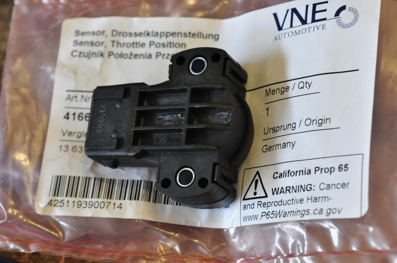

                              The car still felt pretty lumpy engine-wise. I've done the plugs and coils, I've run a couple tanks of gas through, fuel filter, air filter, new MAF. The Vanos solenoid made a nice difference, but something was still missing. I knew I wanted to do pre-cat O2s, and how important they are, but I wanted to time that with a header job (more on that later ).
                              There was no CEL and no codes (well, one for something stupid, but nothing important to the engine), so I pulled the adaptations to see what's going on.
                              WTF is this? 5s across the board???
                              Click image for larger version  Name:	TPS01.jpg Views:	0 Size:	156.7 KB ID:	122226
                              Hmm strange. I didn't think I needed to do the cam sensors, and certainly not the crank or knocks. The only other things I could think of were TPS & fuel injectors. Didn't really think injectors would be too bad at 124k (I did them at 160k on silvergrey iirc), and I could swear I could still hear them ticking away a little (new injectors are very loud). So, I looked into the TPS for the actuator and the front of the throttle rail. Checked FCPeuro, and they do a great job of carrying the OES - the supplier's version of the original part.
                              Click image for larger version  Name:	TPS02.JPG Views:	0 Size:	123.1 KB ID:	122223
                              Sure enough, these are genuine TPS, with the brand and BMW logo ground off. Save your $!

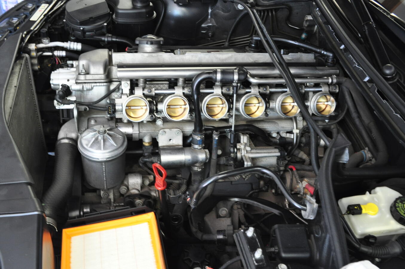

                              Gained access, also cleaned out the CCV/Idle control valve. TBs look great. Its funny how dirty and neglected the car is, yet it's a wonderfully original, clean car underneath!
                              Click image for larger version  Name:	TPS03.JPG Views:	0 Size:	160.8 KB ID:	122224
                              Installed both TPS, and lubed the actuator/TBs' springs and rail (Tri-flow ptfe)
                              First startup, it already had a smoother idle with not much dipping at all - not sure if that was the ICV cleaning or the TPS though.
                              Click image for larger version  Name:	TPS04.JPG Views:	0 Size:	117.7 KB ID:	122225
                              Alright alright. MUCH better, the car feel smoother and more responsive! Ignition #s is what I was paying more attention to, but very interesting that the vanos #s went to 0 from -4.5/-1.7. I'm hoping new pre-cat O2s make ignition timing perfect!
