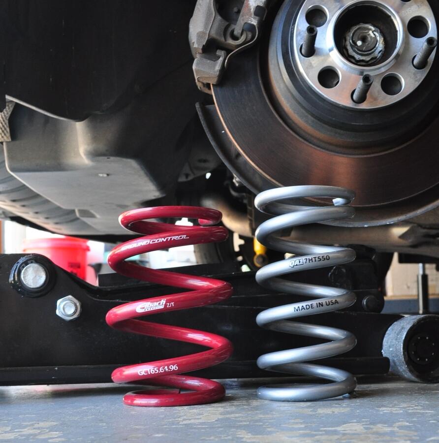

    The rear was a little low (under 13") even with some extra rubber shims, so I swapped rear springs from my favorite 6.5" GC eibach 550lbs to some QA1 high travel 7" 550lb (both 2.5" ID). I removed the extra rubber shim (only using stock lower spring pad and GC top nylon cone), so the car has now settled at 13.25" rear ride height which gives me a little rake which I like. I also like the car being a little higher since this is my daily.
    Click image for larger version  Name:	steelrearspring.JPG Views:	0 Size:	92.1 KB ID:	125894

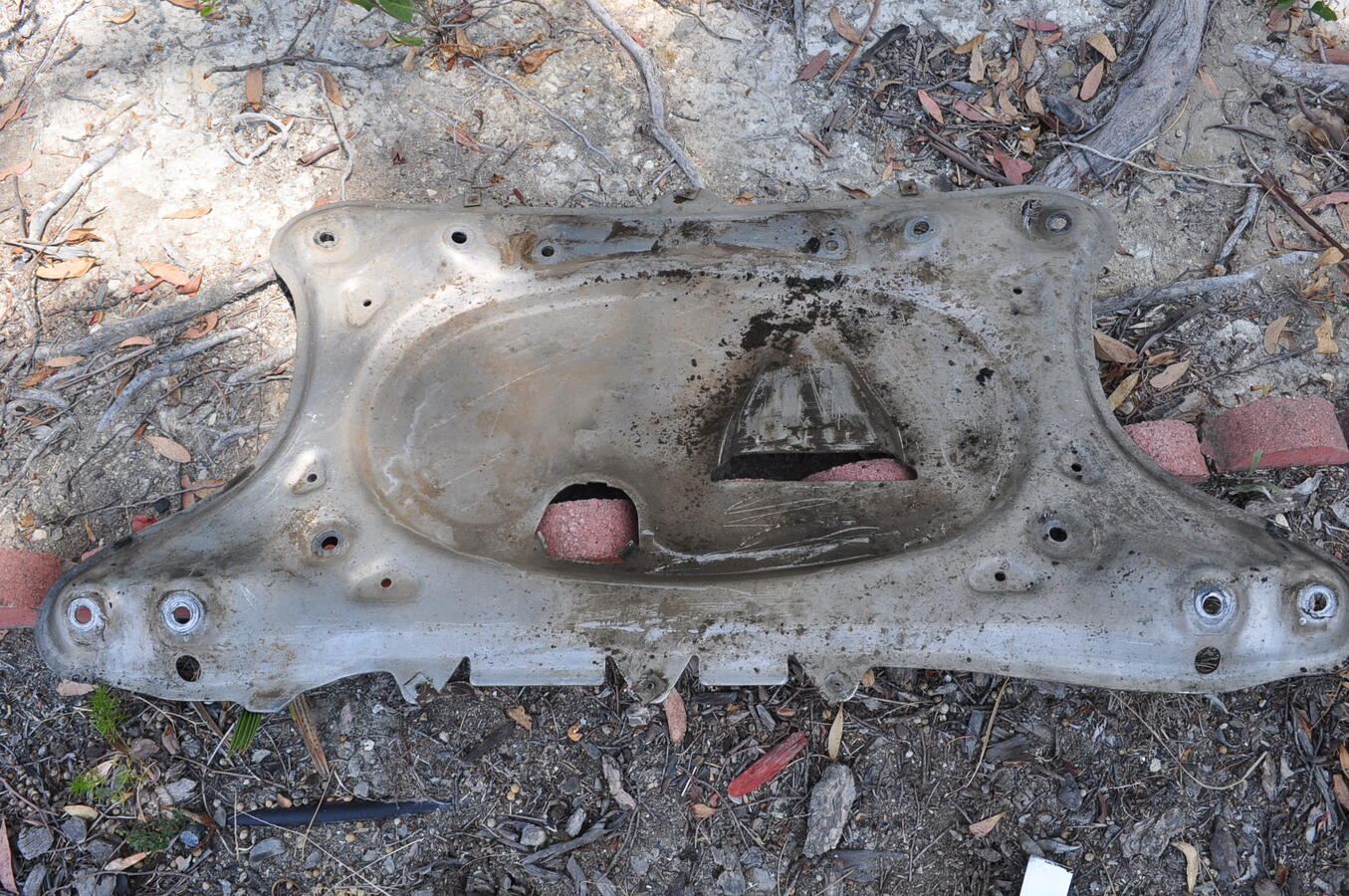

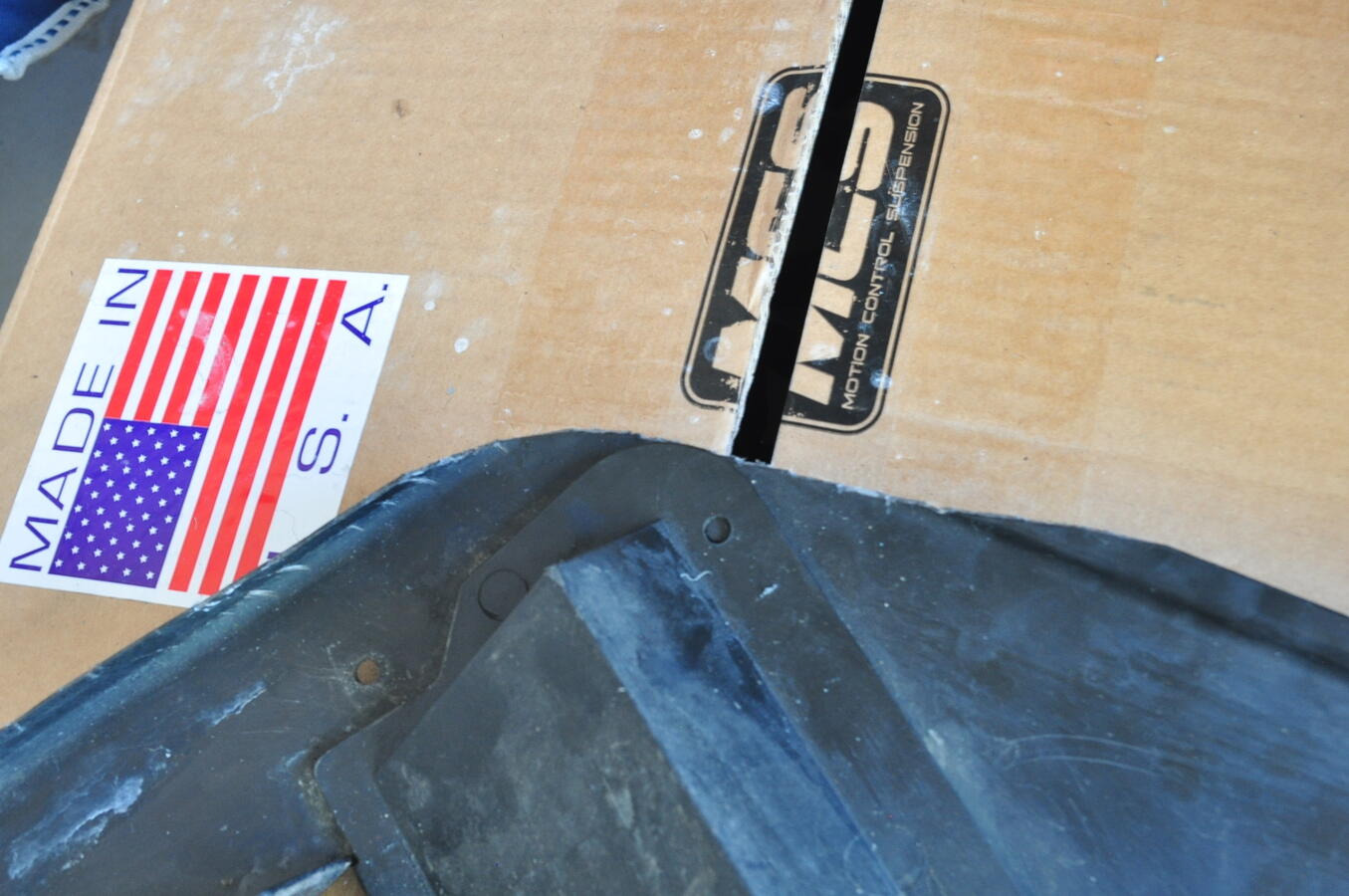

    Took off the front reinforcement plate and cleaned it:
    Click image for larger version  Name:	fcab1.JPG Views:	0 Size:	321.8 KB ID:	125895
    It was missing the oil drain cover, so replaced that:
    Click image for larger version  Name:	fcab2.JPG Views:	0 Size:	228.0 KB ID:	125897

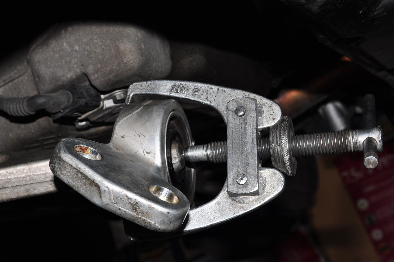

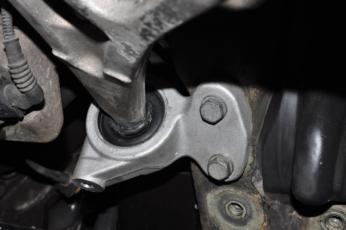

    With that out of the way, I could finish my suspension refresh with OEM FCABs. Originals actually looked ok, might have been replaced at one point, but doubtful.
    Click image for larger version  Name:	fcab3.JPG Views:	0 Size:	105.8 KB ID:	125896
    New. Nothing like fresh FCABs!
    Click image for larger version  Name:	fcab4.JPG Views:	0 Size:	132.8 KB ID:	125898
    Why did I wait to drop the reinforcement plate? Because I wanted to put these in!
    Click image for larger version  Name:	Fabbies6.JPG Views:	0 Size:	153.3 KB ID:	125899

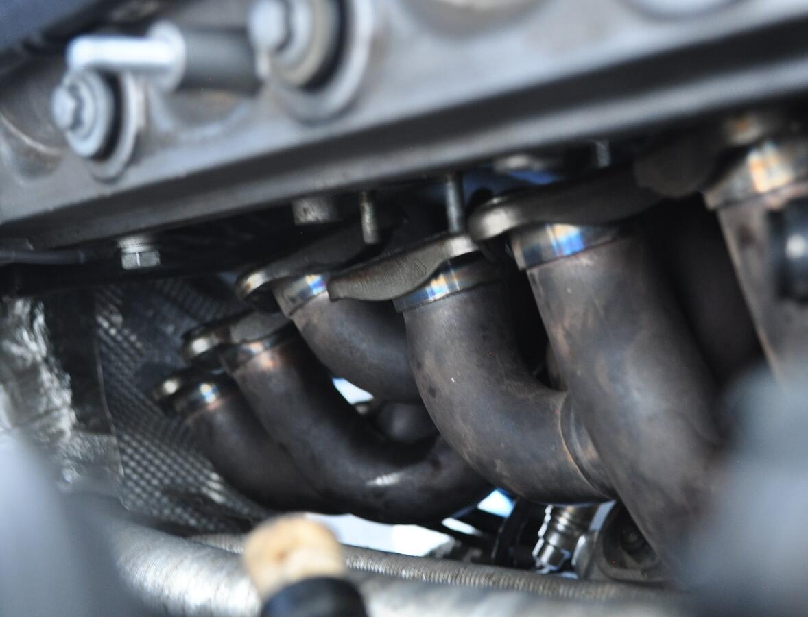

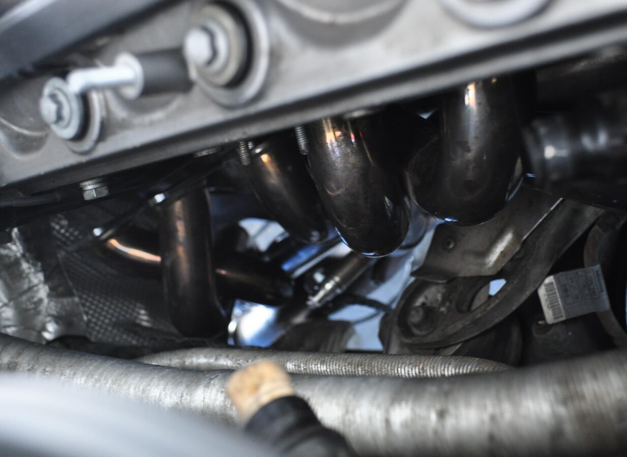

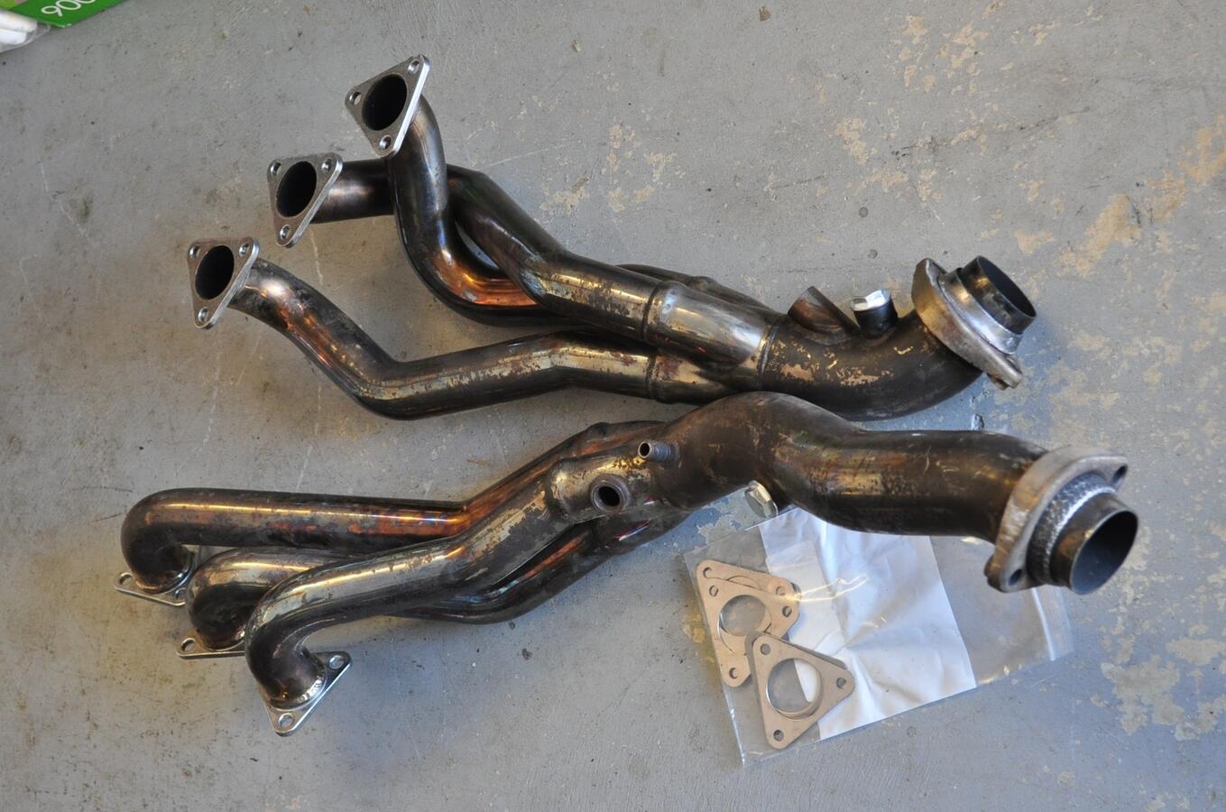

    Randomly perusing Ebay, I found a used set of Fabspeed headers for $300 lolwut. They had a dent and were kinda dirty, but so what?
    All but 1 of the aftermarket headers for our car are replicas of Supersprint's long tube "tubulare" header that was the upgrade for euro or csl guys (before stepped existed). Or they're a rep of euro/csl. IMO, Fabspeeds are the best, truest replica made. Best sound and power. Lightweight, perfect fitment, thin flanges. Just perfect.

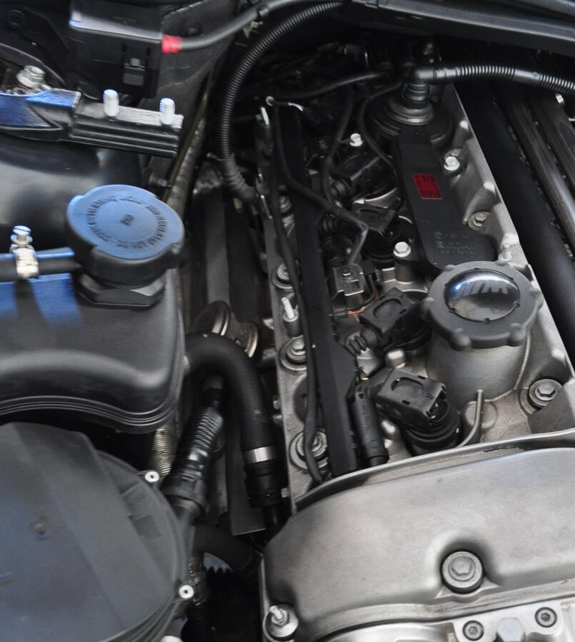

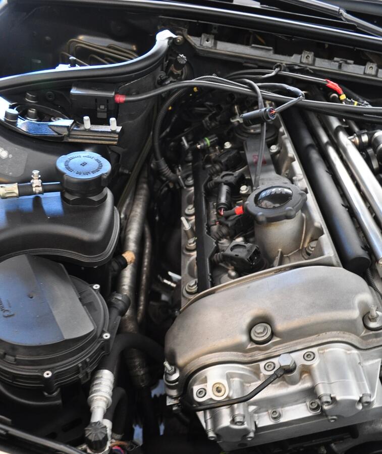

    Took the strut bar off. Already had the beauty cover off. Undid the SAP and the coolant exp line - I plug the tank and hardline with cork or rubber stoppers so I don't lose much coolant. Heat shields and o2/egt connections and you're ready to remove the manifolds.
    Click image for larger version  Name:	Fabbies1.JPG Views:	0 Size:	97.1 KB ID:	125901

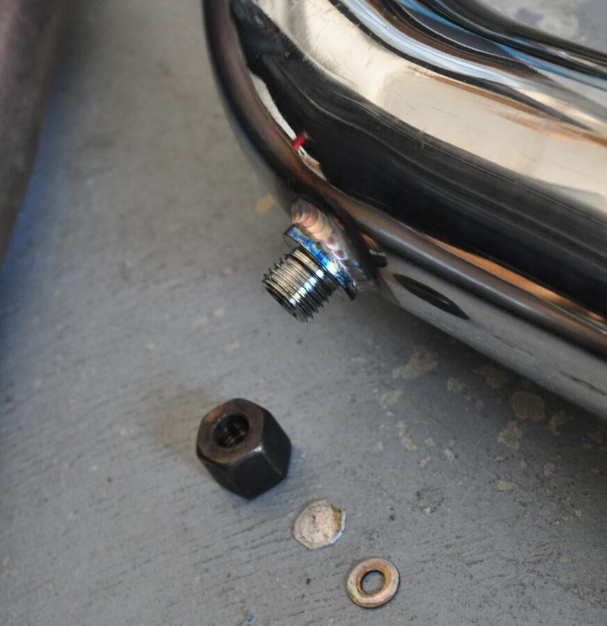

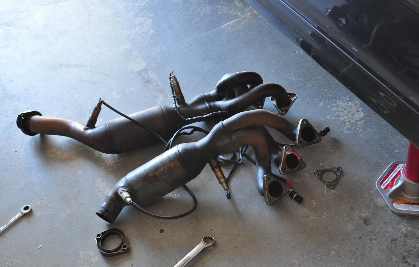

    Car has been in Socal for 17 of its 20 years, so removal was easy. Only one stud came out with the nut!
    Click image for larger version  Name:	Fabbies2.JPG Views:	0 Size:	77.6 KB ID:	125900

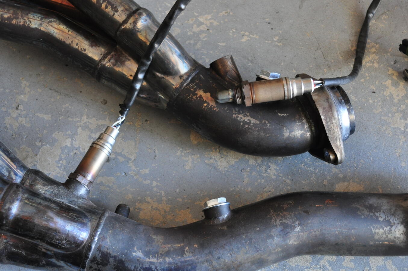

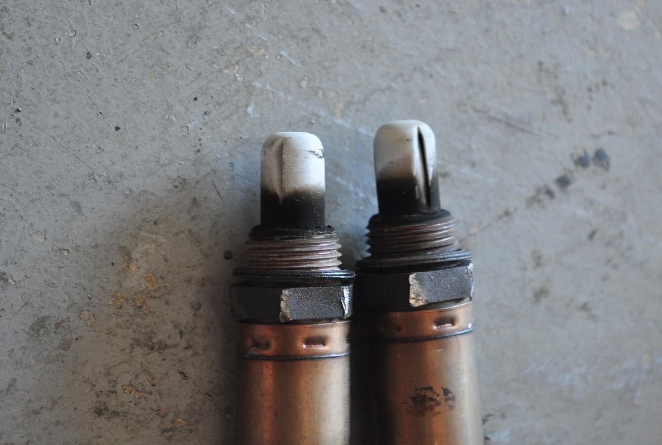

    Be gone with you. Got new o2s as well. Will reuse EGT.
    Click image for larger version  Name:	Fabbies3.JPG Views:	0 Size:	133.2 KB ID:	125902
    Precats were done lol
    Click image for larger version  Name:	Fabbies4.JPG Views:	0 Size:	104.1 KB ID:	125903

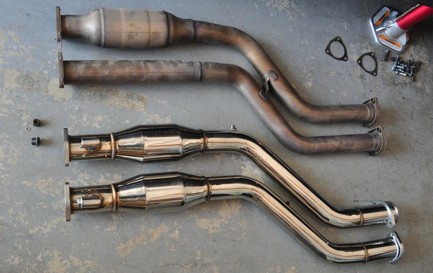

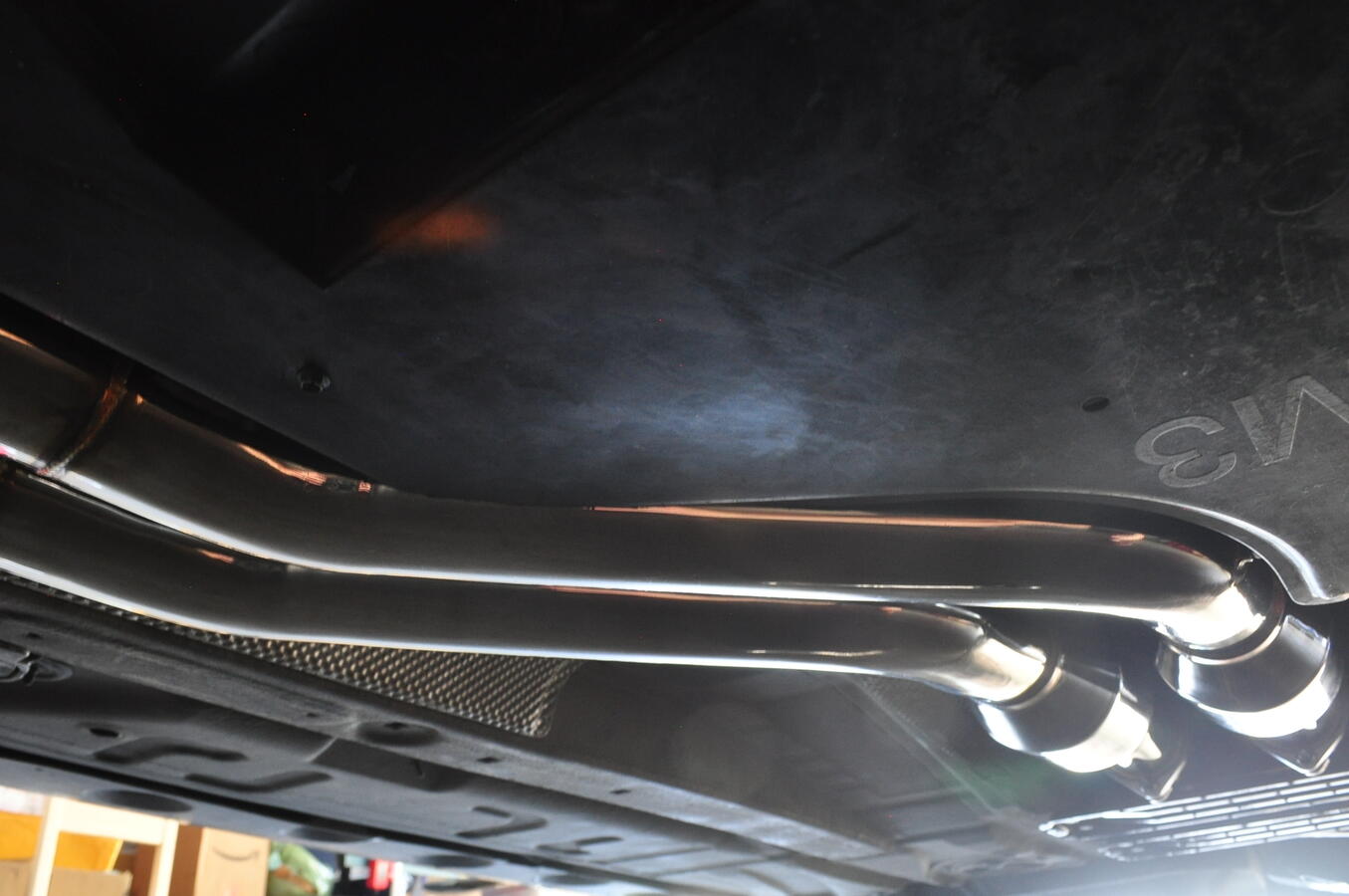

    Catted sect 1. Euro cats got harder to find and more expensive. I wasn't gonna spend $2400 on SS HJS sect 1. I found a listing on ebay from a German company who fabs up 100 & 200 cell metallic race cats in 2.5" piping for Sect 1 for only $400! ($100 shipping)
    Link: https://www.ebay.com/itm/23335313314...53.m1438.l2649
    Let's check them out!
    Click image for larger version  Name:	cattedsect1steel02.JPG Views:	0 Size:	186.7 KB ID:	125906

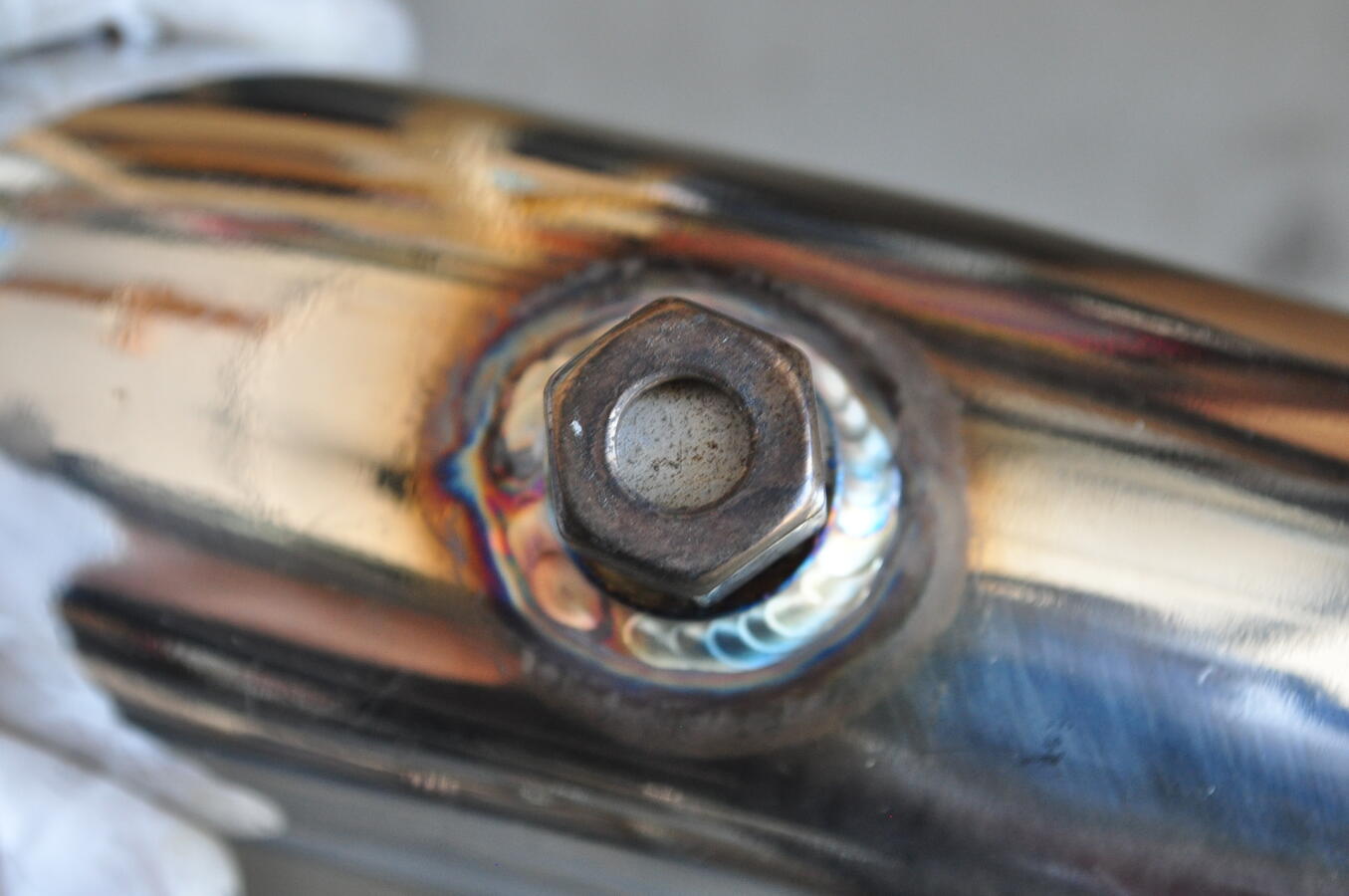

    Initial quality looks nice. Clean welds, everything is straight and smooth. post cat o2 bungs and egt just like factory euro setup. They didn't come with bung caps, however.
    Let's look closer:
    Click image for larger version  Name:	team2fast4.JPG Views:	0 Size:	103.4 KB ID:	125908

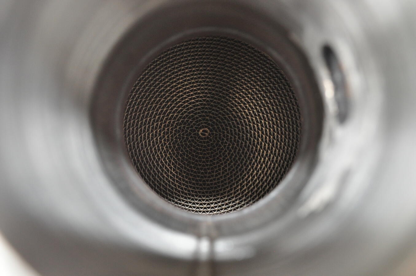

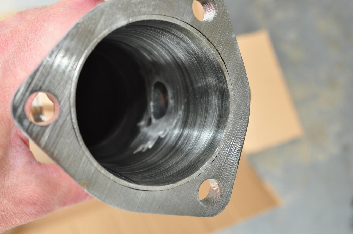

    Cat looks good. They were very clear about the cats being metallic, not ceramic. These are the 200 cell. My goal was to cut the smell almost completely, but retain half of the gains of removing stock cats (400 cell). I also love that they did these in 2.5" (63.5mm) instead of typical 2.25" or 2.365" (60mm) - there's a fair amount of power to be had here - I want to say Hassan demonstrated an 8whp gain here.
    All the insides have been smoothed out. Very nice. Overall, very very pleased for $500 spent!
    Click image for larger version  Name:	team2fast5.JPG Views:	0 Size:	105.7 KB ID:	125907

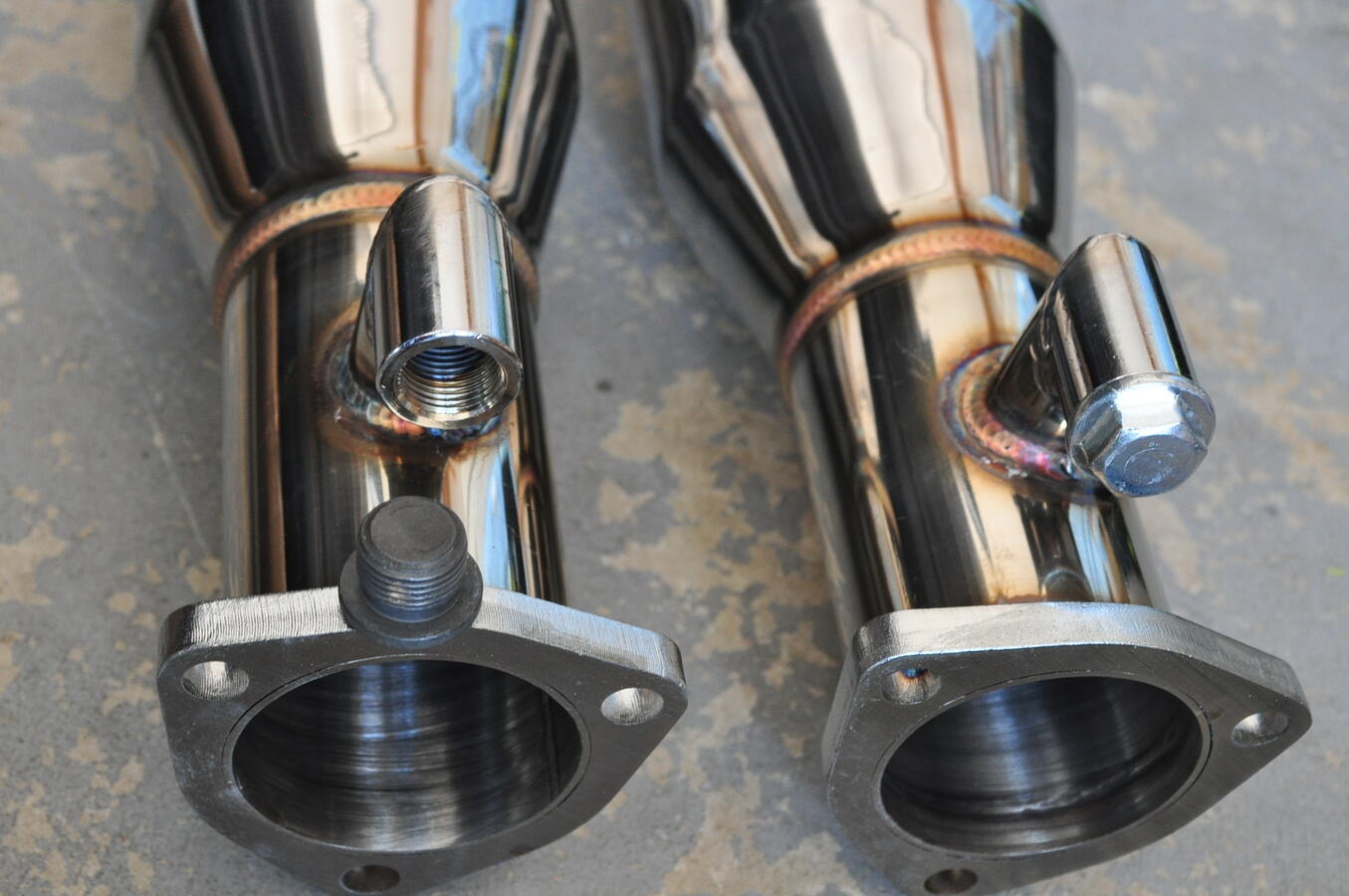

    I mentioned EGT earlier. I already installed the sensor in the header location, so I'm capping this location. I couldn't be arsed to extend the egt and o2 wiring down the driver side tranny tunnel since I wasn't bothering with post cat o2s at this time.
    Anywho, luckily, I keep things, and have an extra EGT sensor that I could cannibalize to make a bung cap.
    Click image for larger version  Name:	cattedsect1steel04.JPG Views:	0 Size:	71.2 KB ID:	125909
    The spacer is so the cap doesn't bottom out on the pipe before sealing. The solid, thin piece of metal is used since there's a hole in the sensor's nut.
    Click image for larger version  Name:	cattedsect1steel07.JPG Views:	0 Size:	87.1 KB ID:	125911

    Headers went in pretty easily. First bank slid on, second took a little effort. Got the sect 1 pipes up, but their increased size caused the tranny cover to make contact.
    Click image for larger version  Name:	cattedsect1steel10.JPG Views:	0 Size:	127.6 KB ID:	125912
    Just nipped off some of the plastic at the bend:
    Click image for larger version  Name:	cattedsect1steel11.JPG Views:	0 Size:	134.1 KB ID:	125913
    All done:
    Click image for larger version  Name:	cattedsect1steel13.JPG Views:	0 Size:	91.6 KB ID:	125914
    Click image for larger version  Name:	steelfabheaders24.JPG Views:	0 Size:	81.0 KB ID:	125916
    All done! Heat shields back in, SAP and exp line back in. Added a little water back to the tank. Removed the post cat o2 plastic holder. If you slide a little nylon washer over the beauty cover studs, you can replicate that plastic sensor cover's thickness so that you don't over tighten the little chrome nuts at the end.

      How’s the smell vs stock for the cats ?
      Has the rasp decreased / increased ?
      Also, which header is not based on the SS tubulare version (aside from stepped)?
      Great build thus far!

          Ya sorry, forgot to put my impressions!
          So the fabspeeds are incredible. Immediately more power everywhere. Incredibly torquey. No tune. I truly don't remember being this impressed when I did euro headers years ago or even ss stepped v1s in 2017. This car pulls so hard. I dare say it's stronger than my 2004, which is saying something 'cause that car runs like a top. The 2 cars feel equal in power even though this one only has the headers whereas my 2004 has the airbox, stepped, tune, pulleys and is quite a bit lighter. The 2004 did get slower when I went from 20lb 18"s to 24lb 19s, though.
          Rasp is pretty well controlled by the catted 2.5" pipe, but still there. Smell is as expected. There still a bit, but not enough to make anyone think it's catless. Similar to how eurocats smell, though once warm, euro cats (200 cell as well, but higher quality and longer) do a little better job at killing the smell imo.
          I'm looking forward to putting the OM scorza on.
          The one header that isn't a rep of SS long tube or euro/csl is the ARH, though those appeared much later, well after stepped and customs ones.
