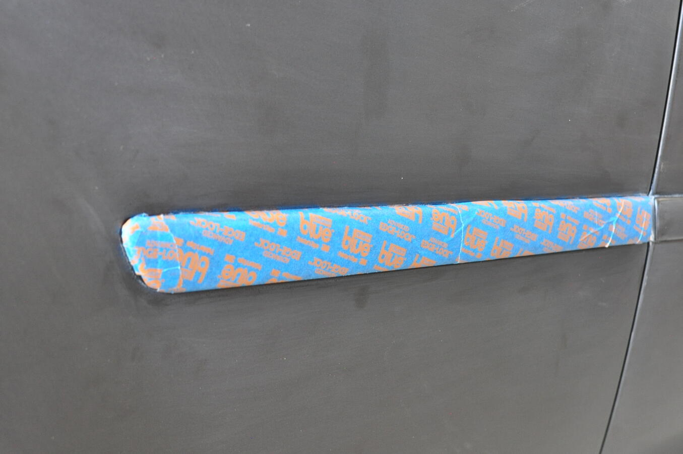

                    I decided to start on a less important part of the car, the resprayed door molding. The goal was to see if I could match factory orange peel, and then bring the paint back to life with rubbing compound. Of course that's how it's done, but I had never done it before. If successful, I'd make my way from front door to driver side rear bumper. I actually didn't know how massive of a project this was going to be.
                    I think it took about 3 weeks from start to finish! That's only like an hour or 2 of work a day, but still. That's also not including the front bumper or top pillar of QP where it goes over windows, which I'll do later.

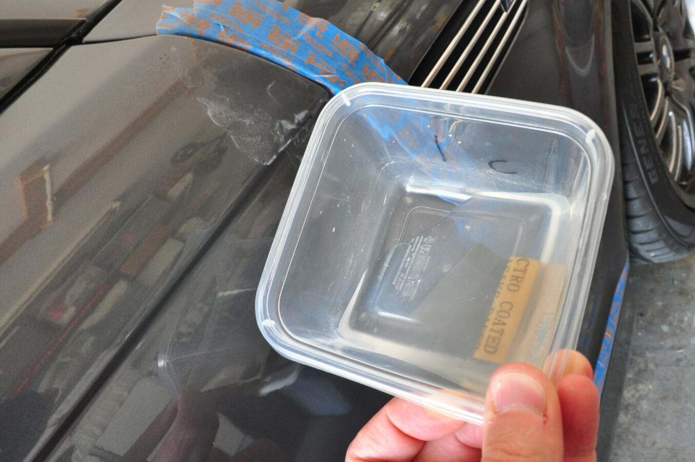

                    I think I have like 200 pictures from this job as I was uploading them to my Instagram stories everyday. You can see all of them in my Instagram highlights ("SG Redux"). But I'm only going to post a fraction of them here, just the ones that tell the story the best, with some captions or explanations.
                    I used 2k grit for most of it, finishing with 2500, but did have to use 1500 in the worst areas. After some sanding, the paper gets dull; effectively a higher grit. You sort of learn how hard to push as the grit gets weaker, and when to move to a new piece of paper. I would have a couple of pieces soaking at a time, labeled "2k" or 2.5k," in sharpie, to help me remember.

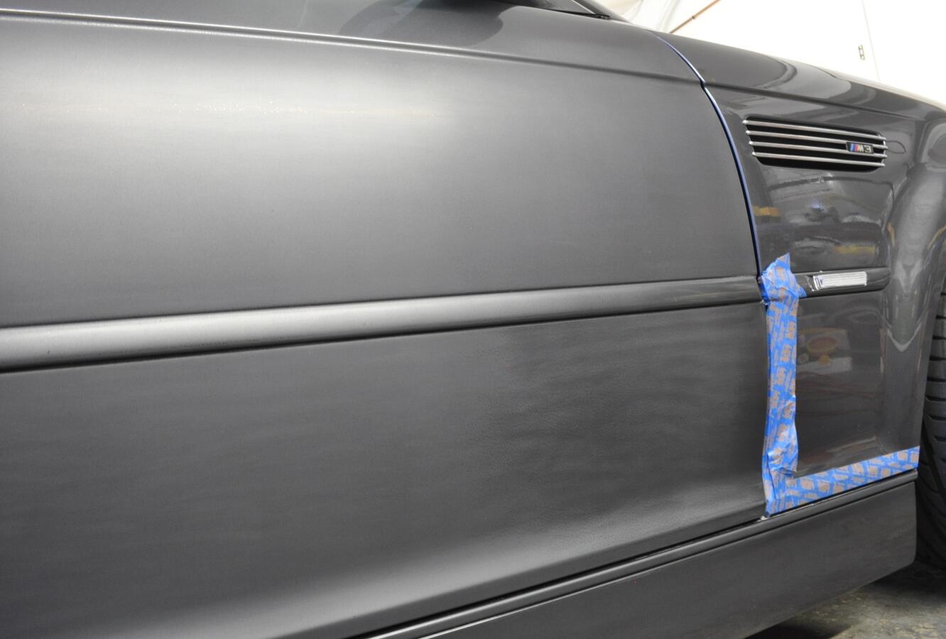

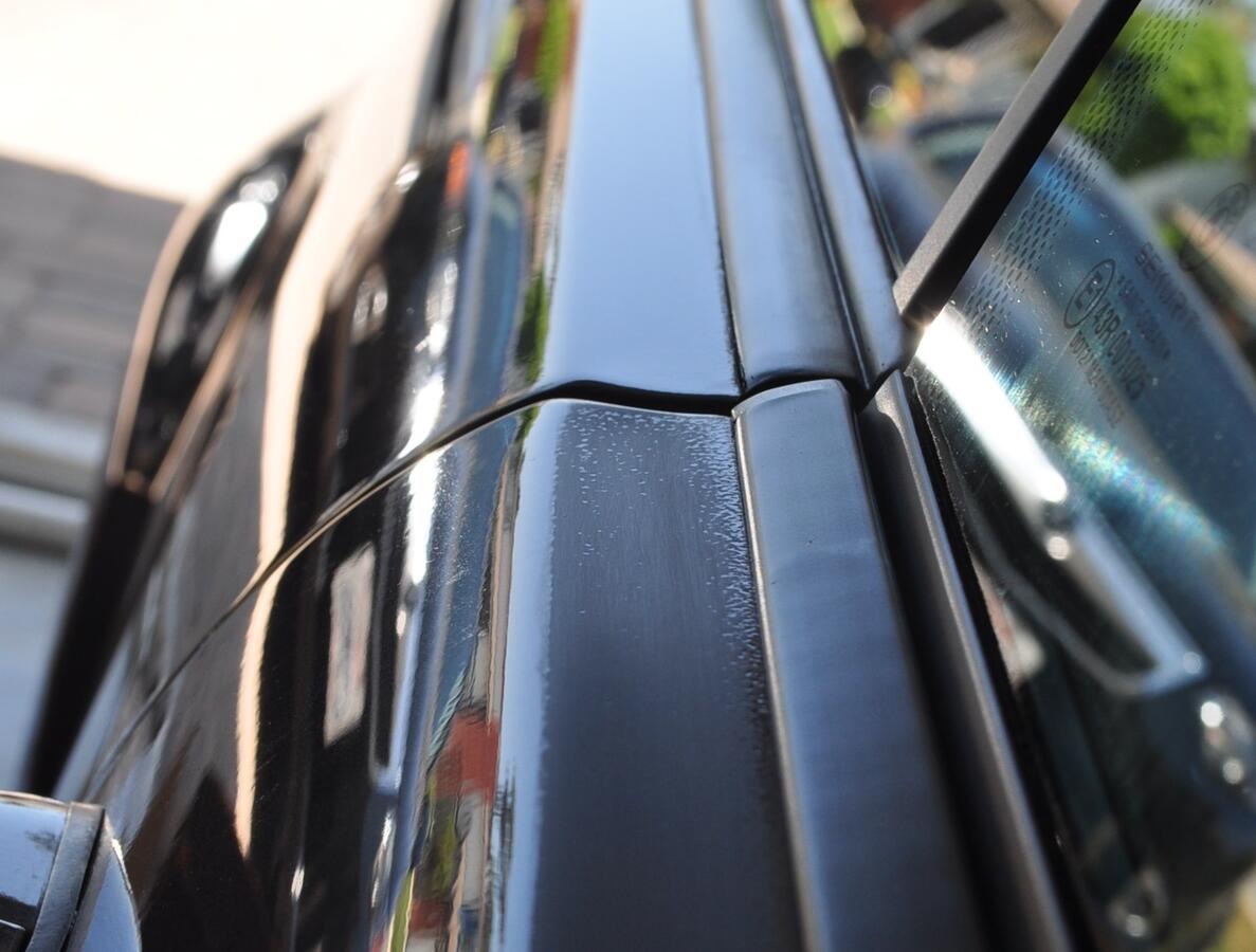

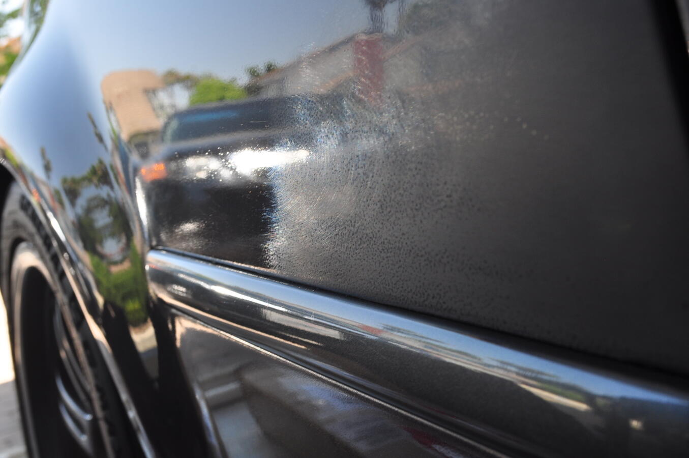

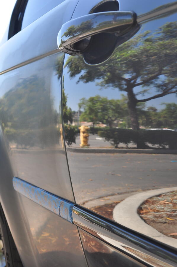

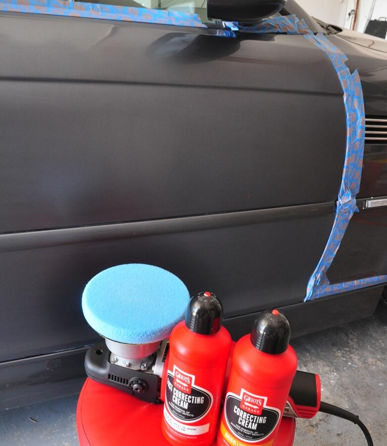

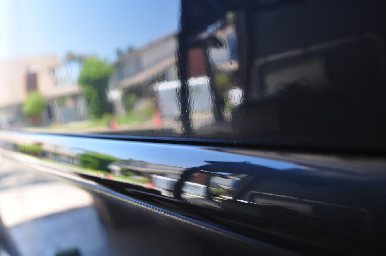

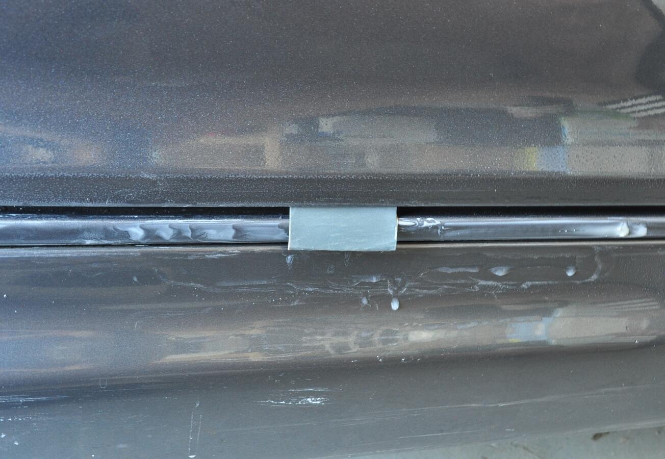

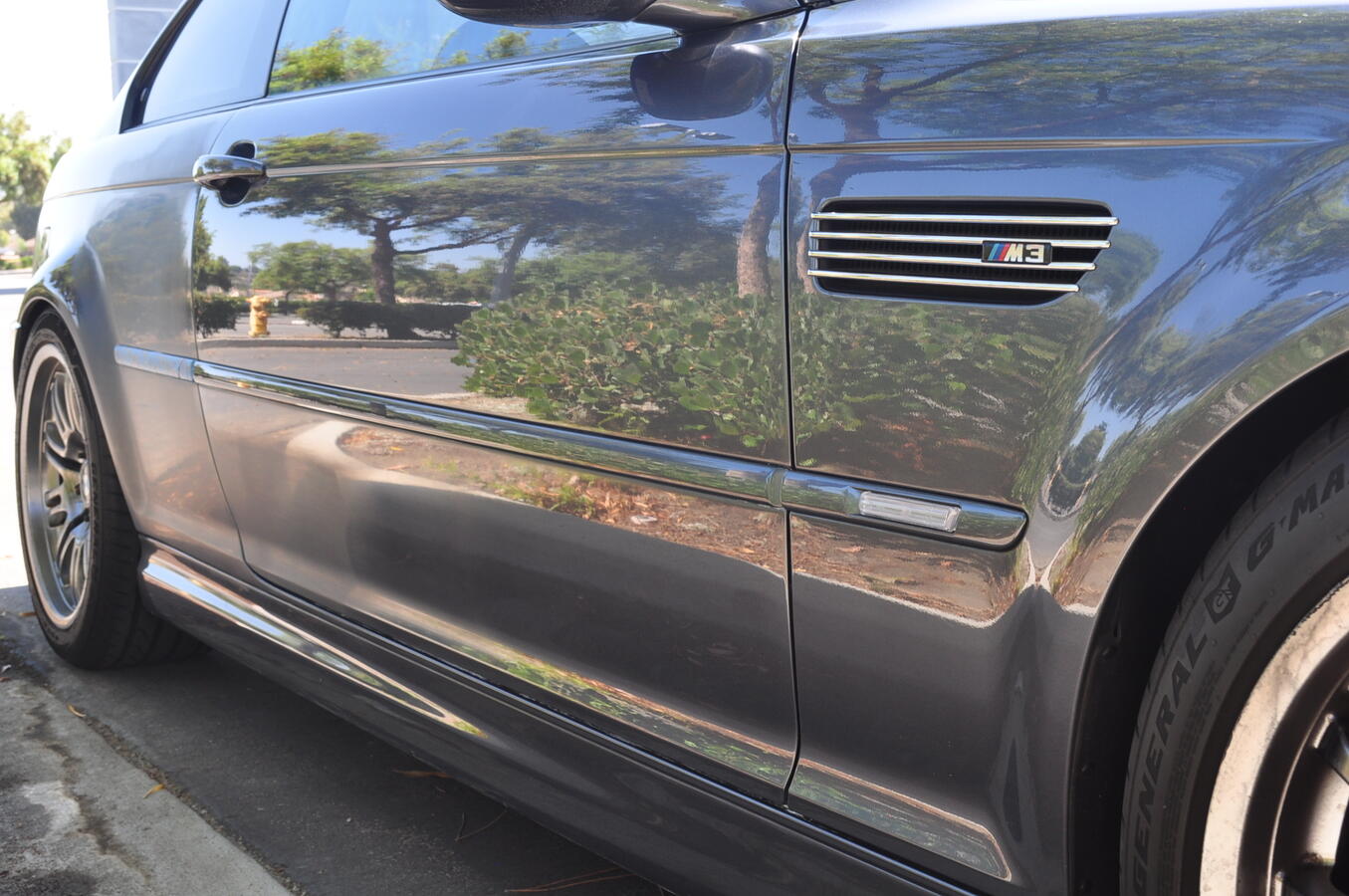

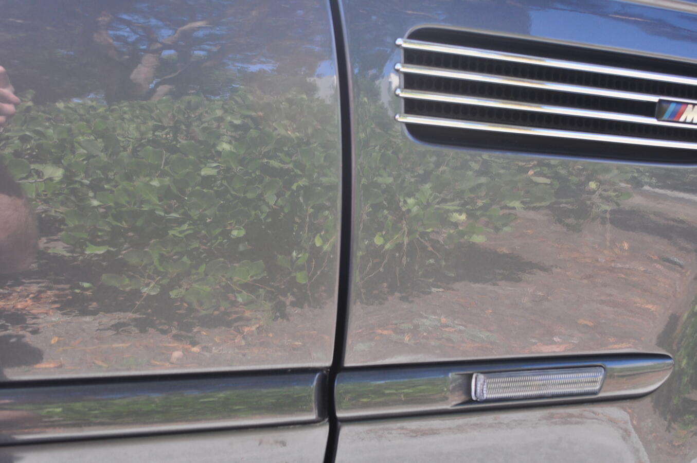

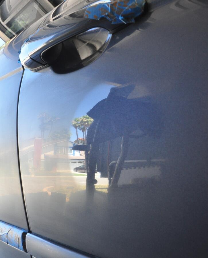

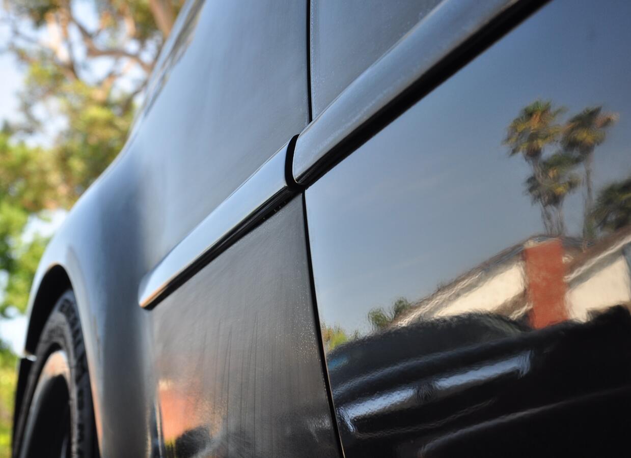

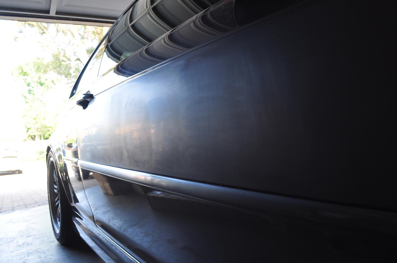

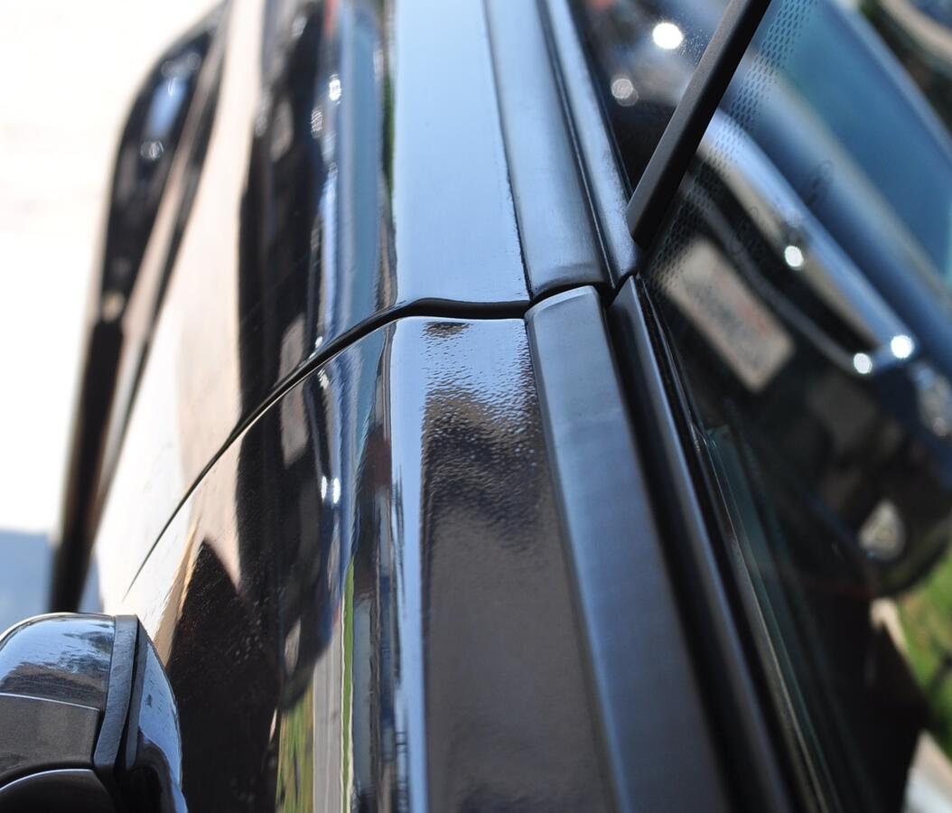

                    Here's a good pic to show you how unfinished the respray was (molding is factory). Literally pebbled texture. I don't think saying "unfinished" is an exaggeration. It's like, "oh shit, the owner's here, send the car out" "but it's not ready jefe!"
                    LoOkS GoOd tO Me

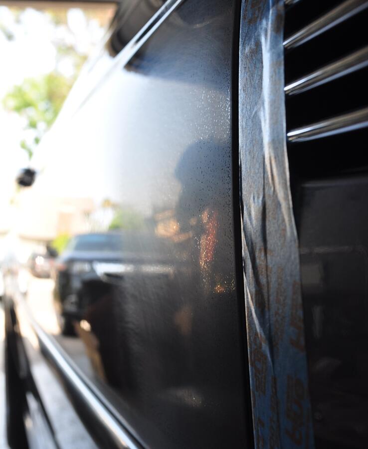

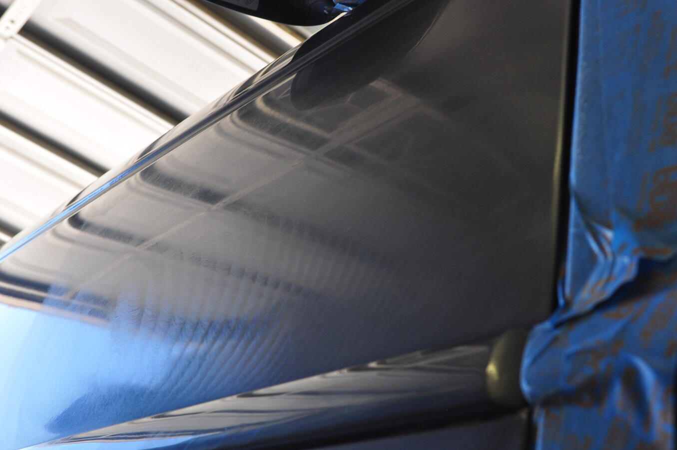

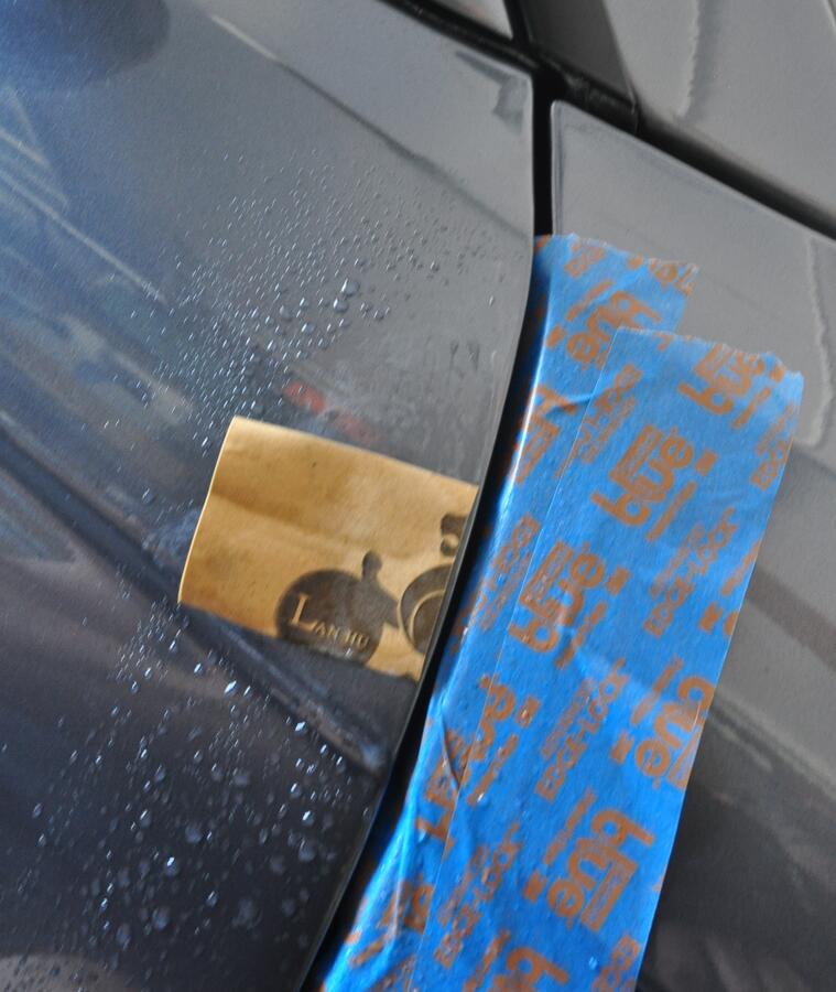

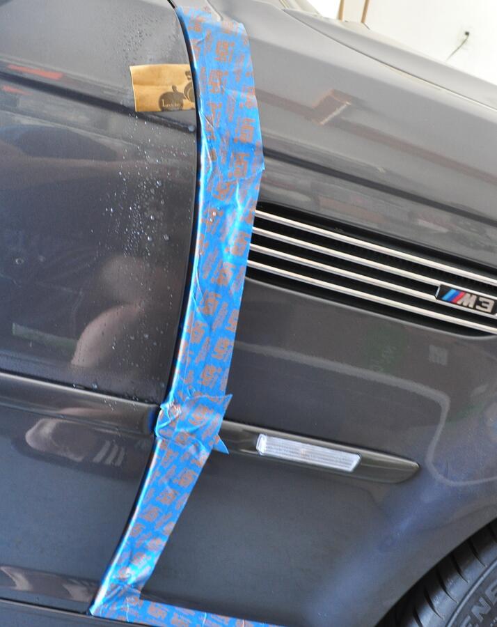

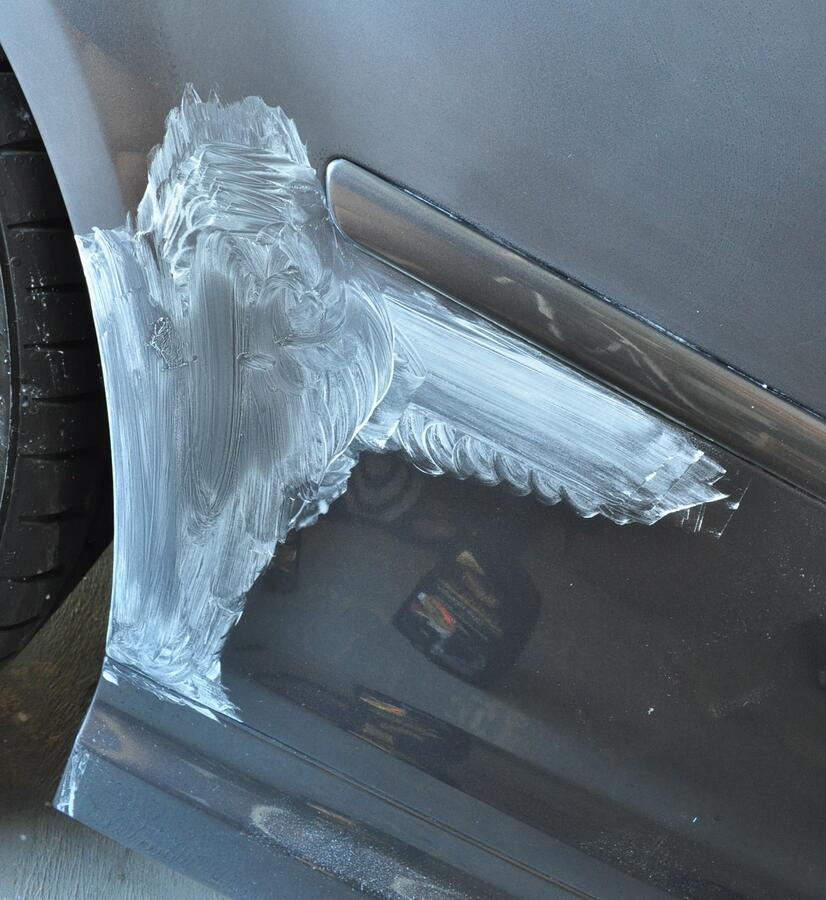

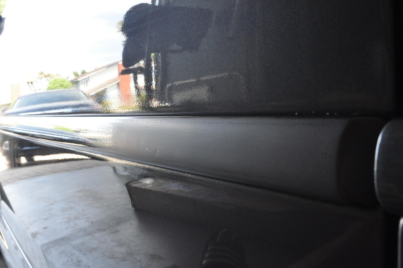

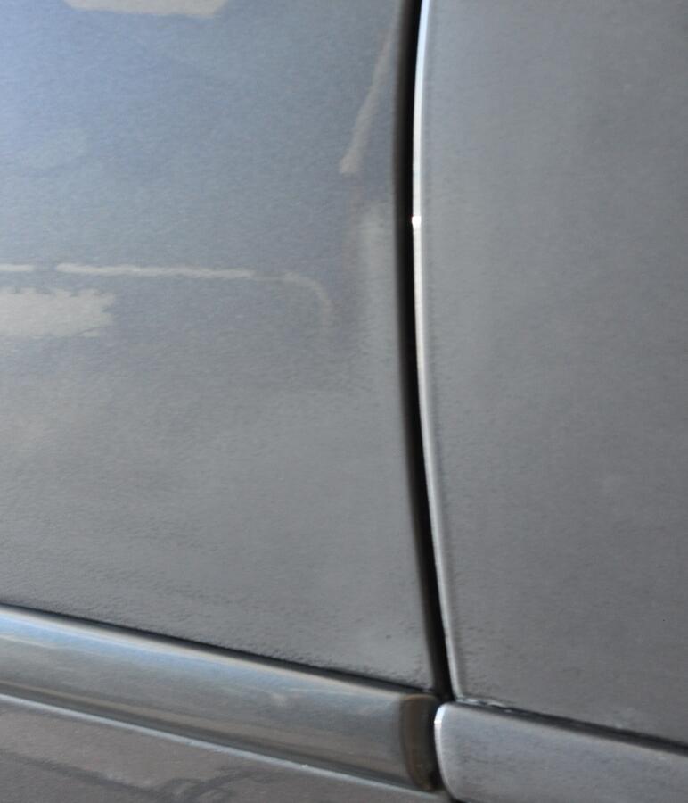

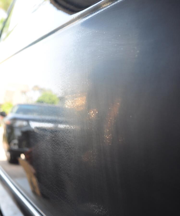

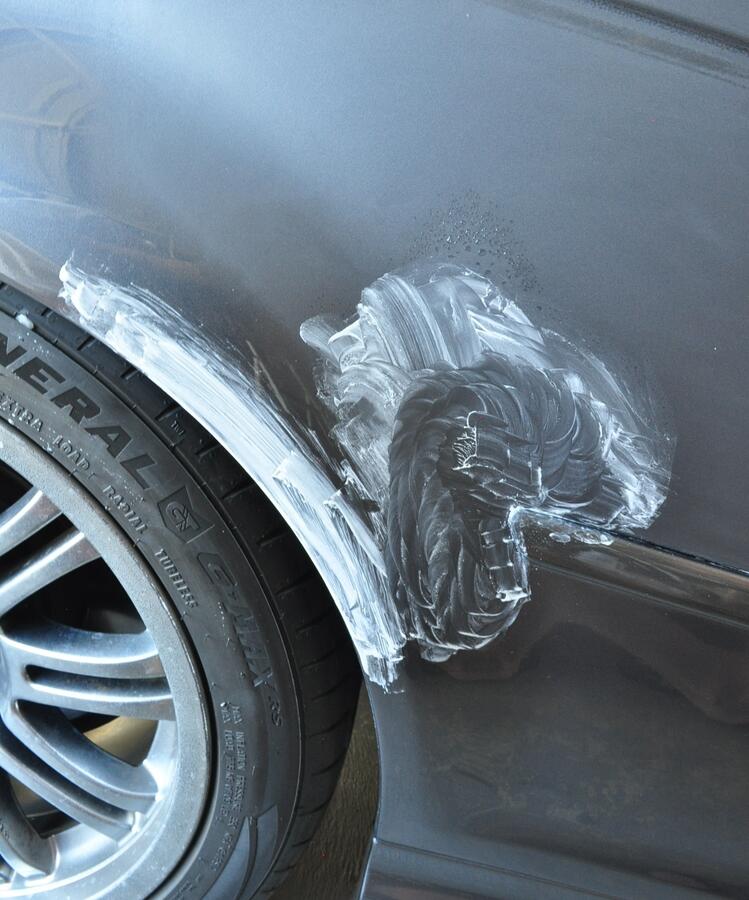

                    Ok, let's go. Test spot on door molding where it meets fender.
ID:	128474 Click image for larger version

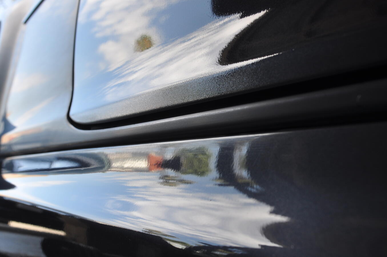

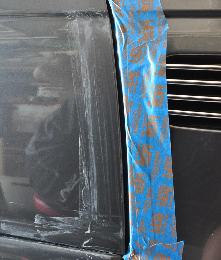

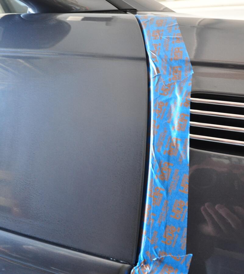

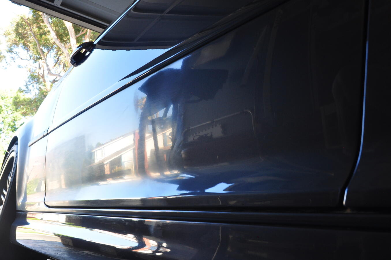

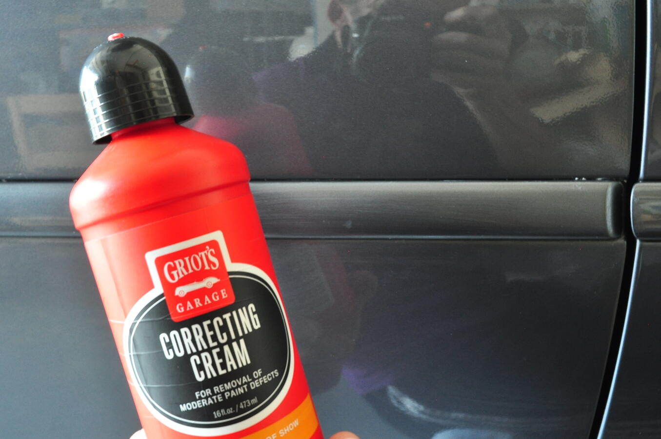

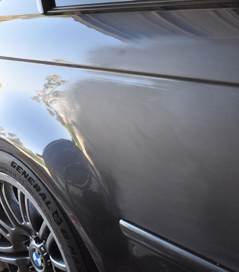

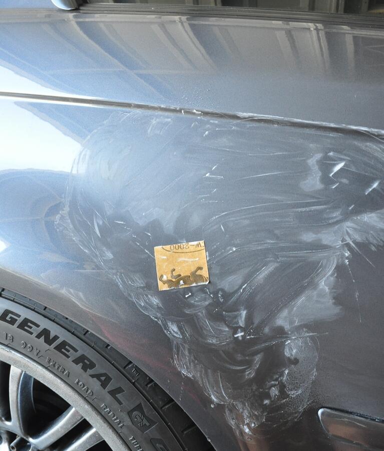

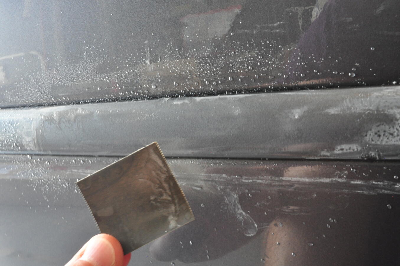

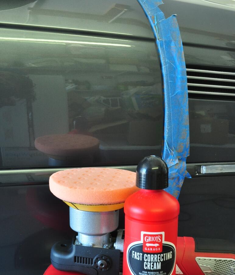

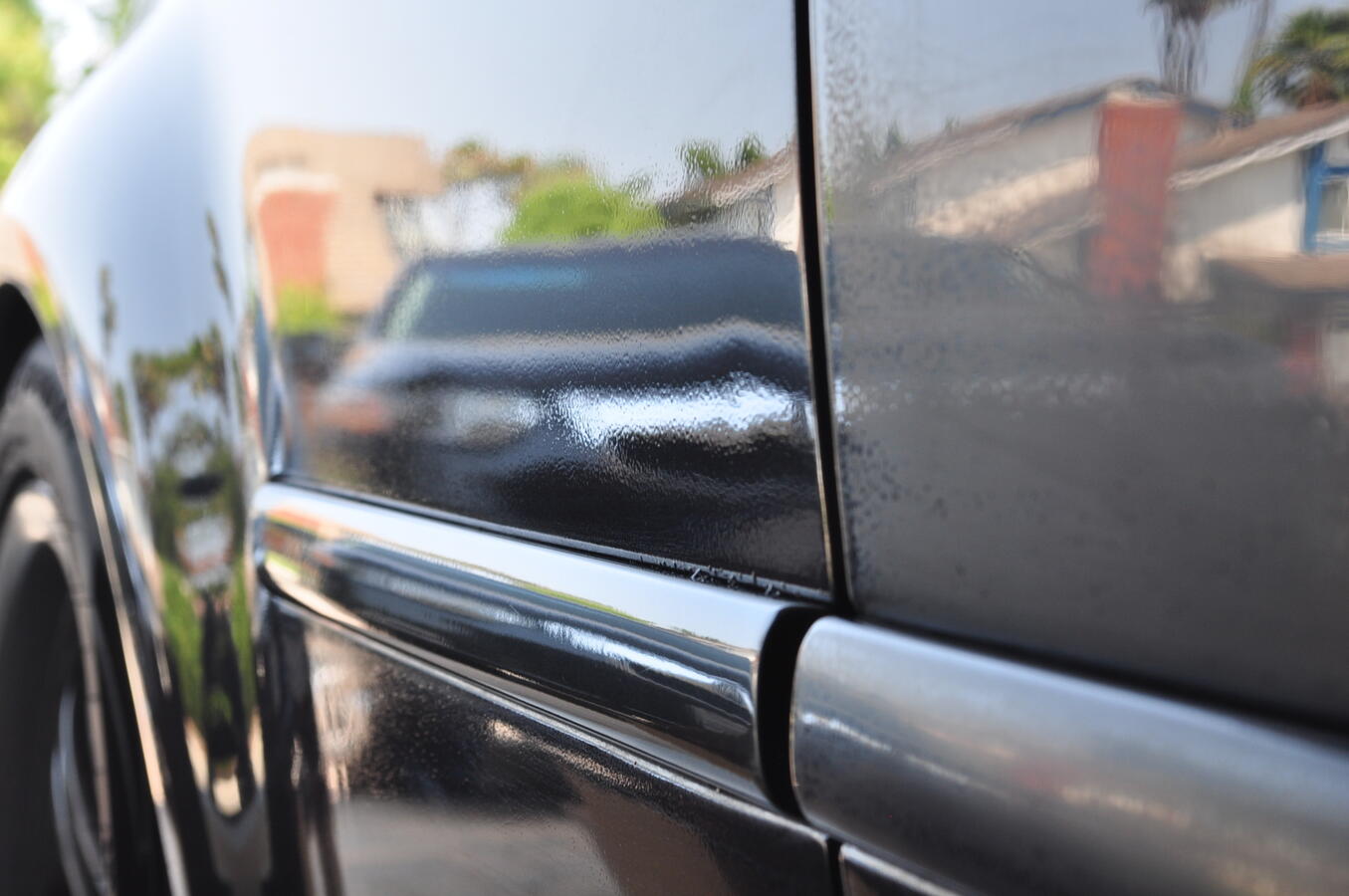

                    Now let's bring it back (I ended up moving down to the Griot's fast correcting cream [1000 grit], because the medium correcting cream only goes down to like 2-2500 grit, and there were still some fine sanding marks left.
ID:	128478 Click image for larger version

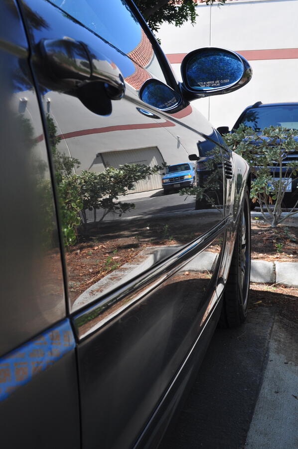

                    Hey alright, this might work! I didn't try to perfect the paint clarity here - just wanted to make sure I was doing a good job of sanding plus I learned that I needed a stronger polish, true compound (1k-1200 grit). I also learned that 2k was probably a little too rough for the molding. I think I took out a little too much orange peel, here. Some sections only needed 2.5k, maybe even 3k with enough effort/time. It was a challenge to match everything given that some sections were fine, some were a little too textured, and many sections were horribly textured.
                    So I was confident and satisfied enough to keep going. I was very confident in my paint correction abilities, the challenge was going to be the actual wetsanding. I also felt like, "fuck it," it's a respray anyway. I wouldn't try wetsanding for the first time on factory paint (trying to remove defects). I could literally have removed most of the clear coat and all of the orange peel and it'd STILL look better than the Van Gogh textured paint the shop left the car with.

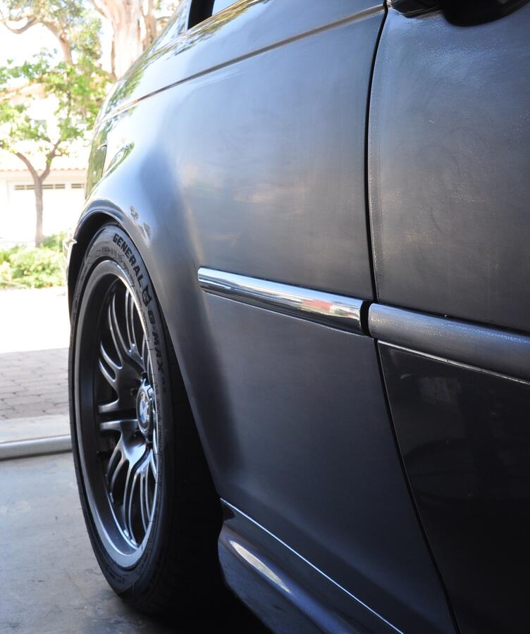

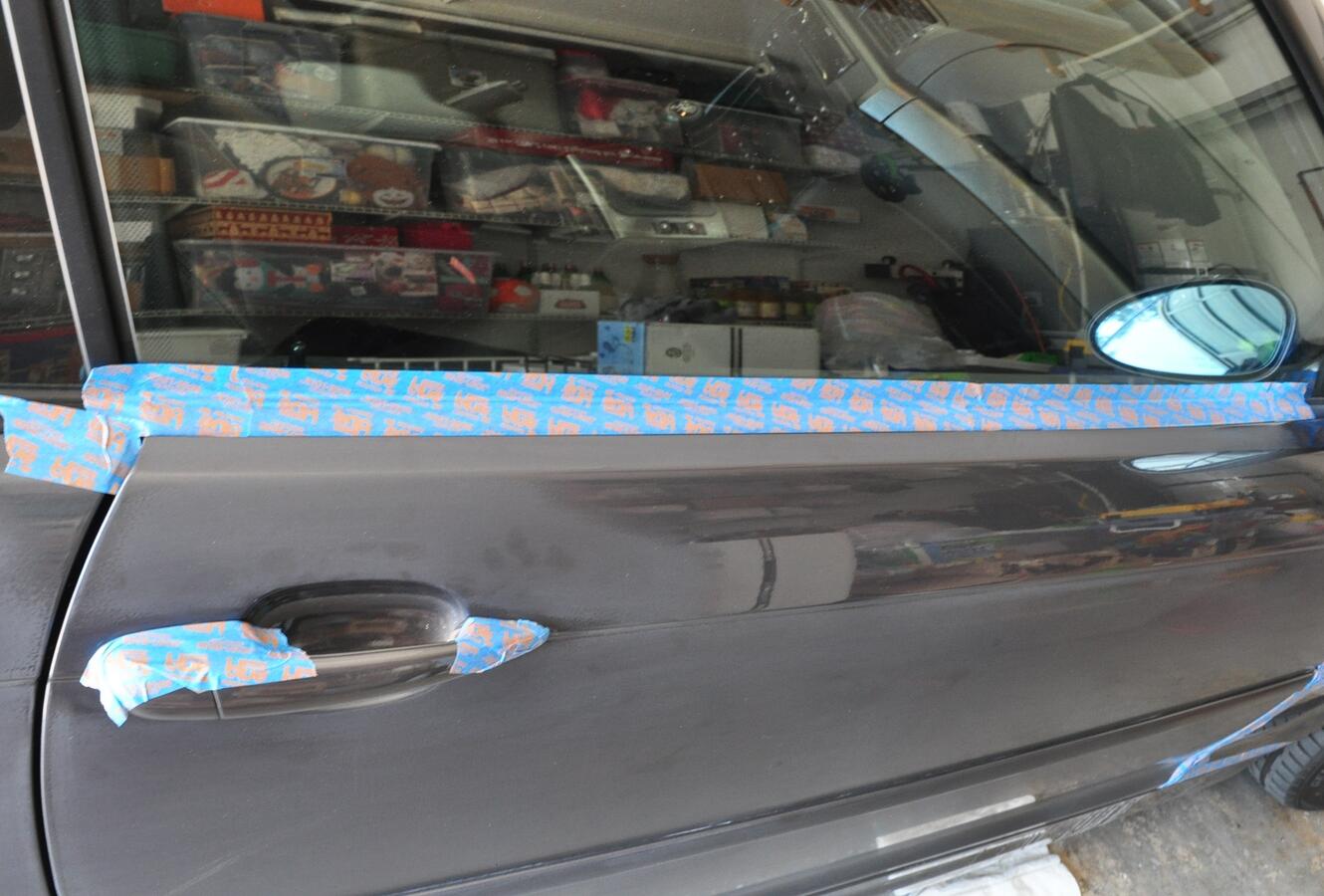

                    Ok, so now the door itself. I taped off the fender where they meet, just to be careful.

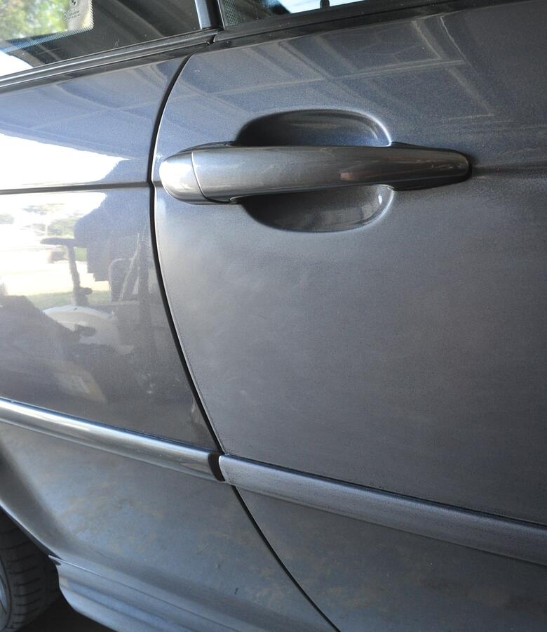

                    So the upper portion is the part where they seemed to have done a good job of matching factory orange peel. the part closest to the fender had too much texture, but after that, it was mostly perfect, with some areas having too little orange peel. I only used 2.5k up top here, but then when back down to 2k for the main sections of the door. I was moving so slowly, that I had to go down to 1,500 grit for the worst sections right above and below the molding.

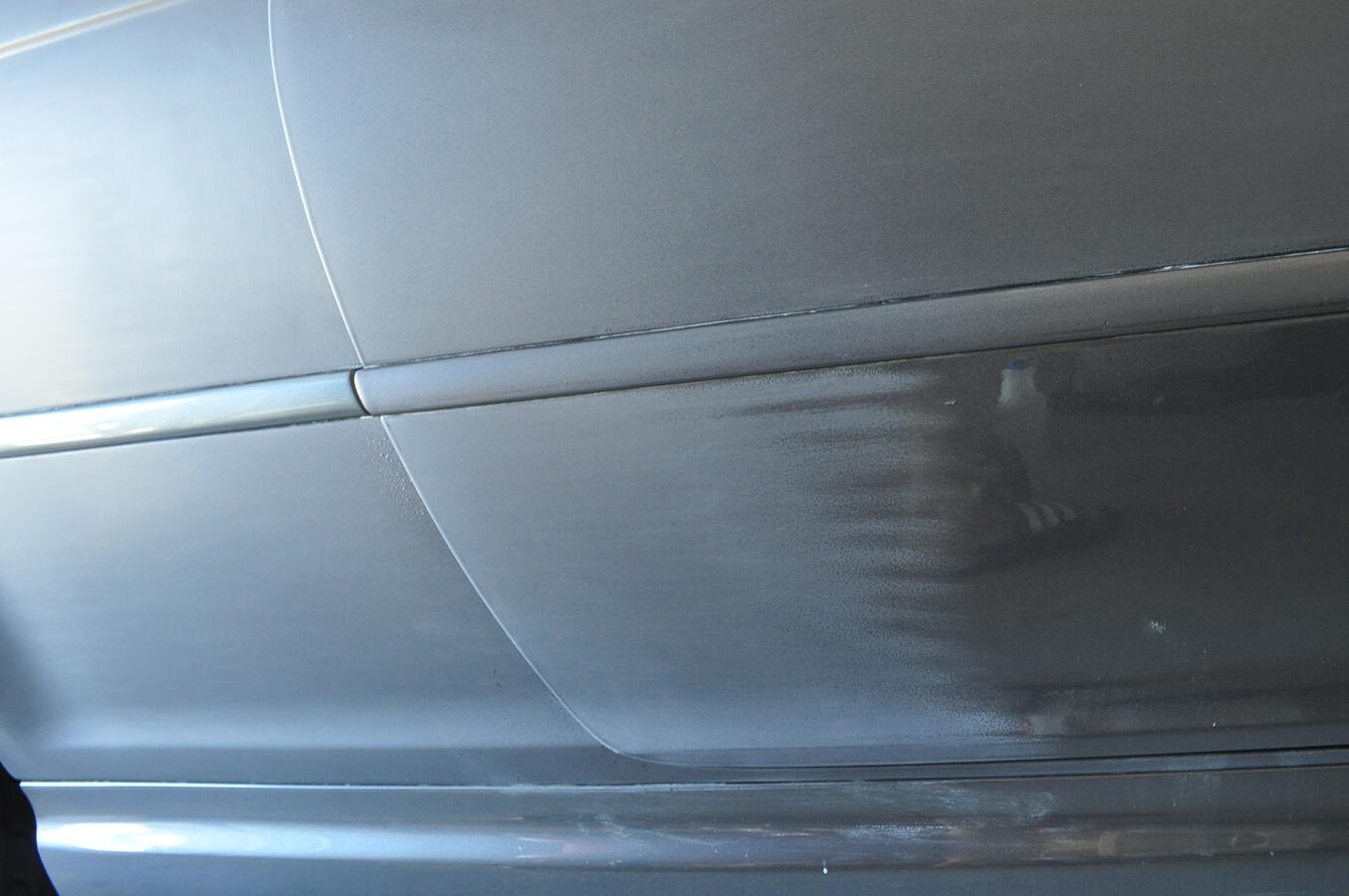

                    This is taking forever. What have I done? Oh well, onwards.

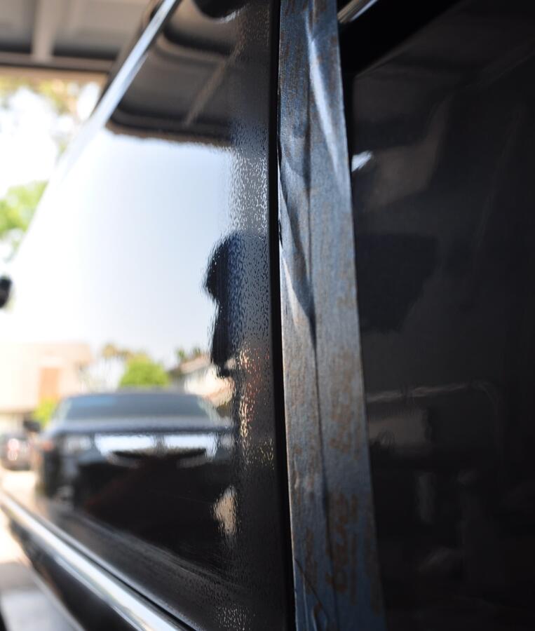

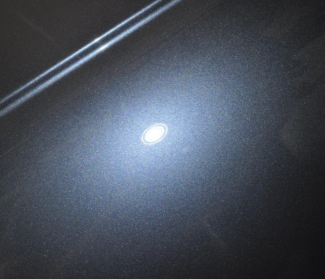

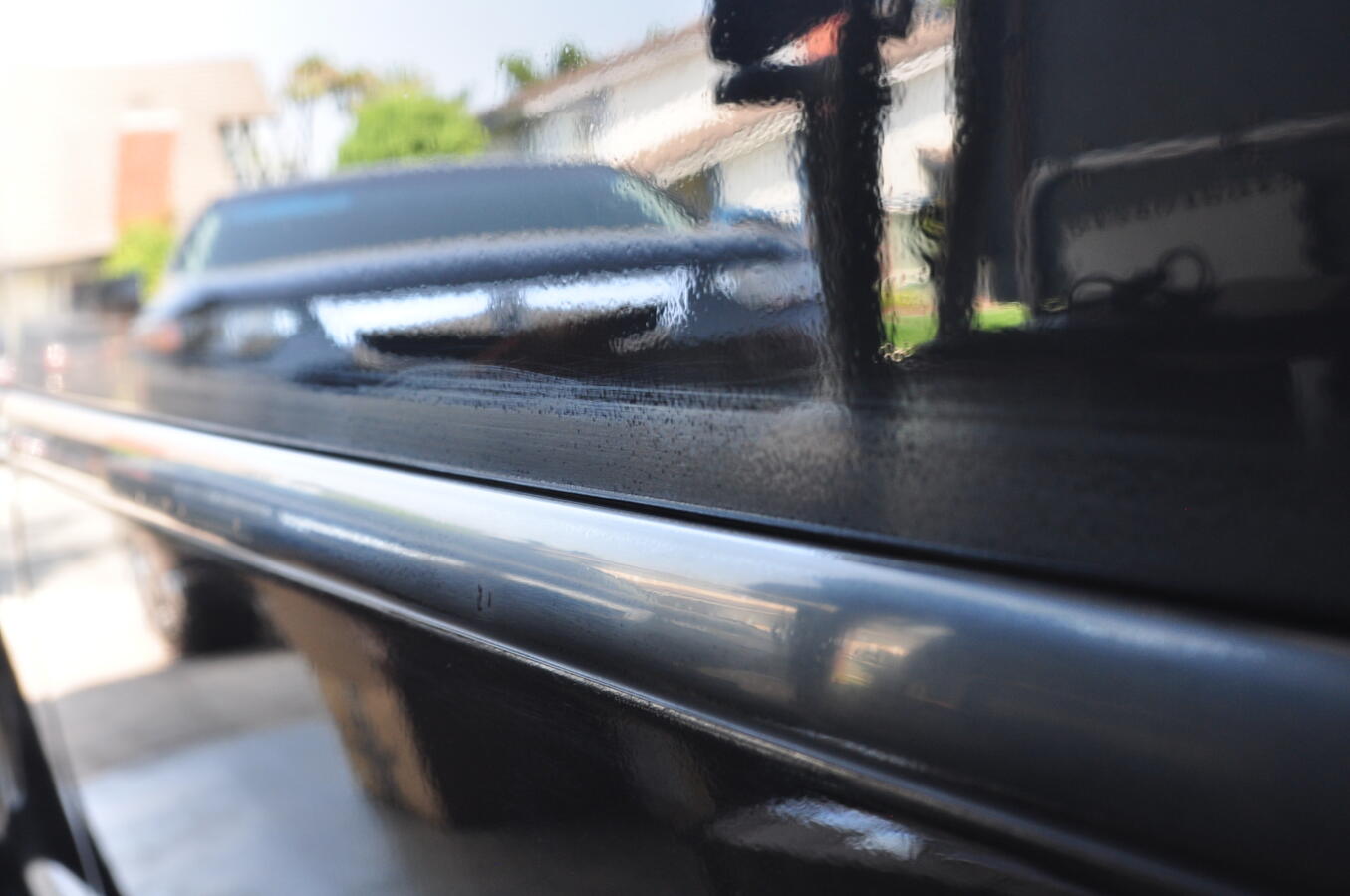

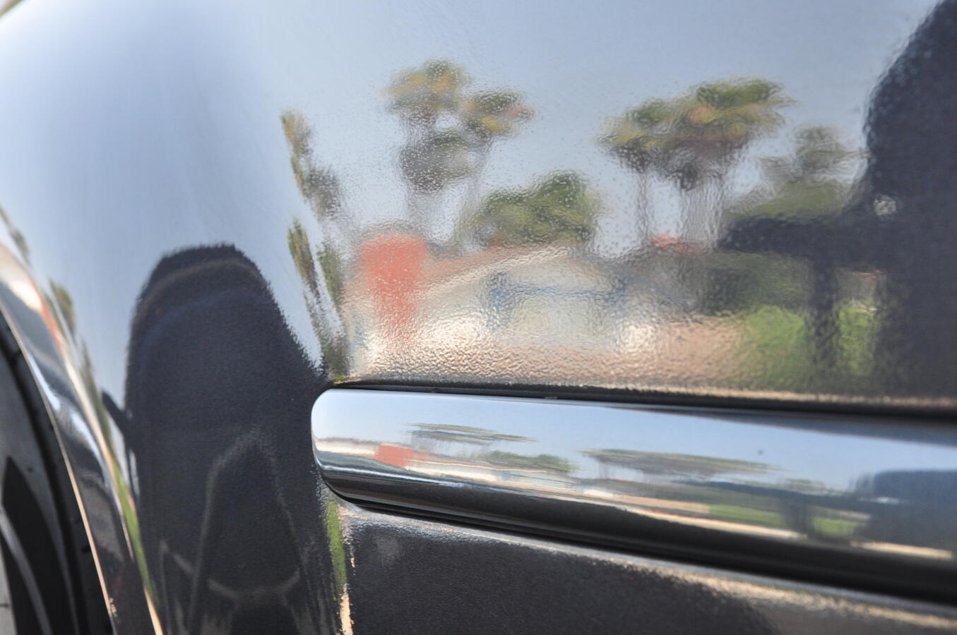

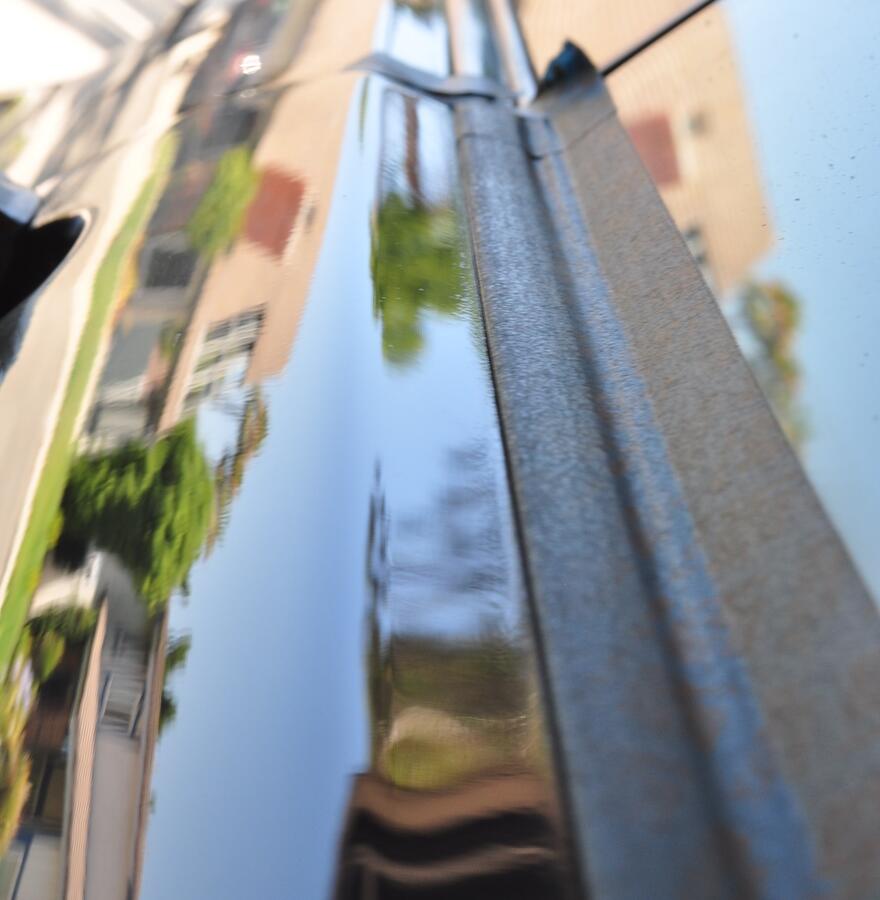

                    If you get close to the paint to create a very sharp, acute angle of view, even without buffing, you can see enough reflectivity to see if you're having the desired effect, the right amount of orange peel. To put it into words, I found that leaving just the faintest "dots" aka the valleys (peaks and valleys of the texture) was the right amount of orange peel (not even enough to feel with your finger). You don't want to sand it completely flat - it'll turn into a mirror-like reflection. Maybe you'd do that on an old classic show car or something, but it'd have to be the whole car, not just sections.

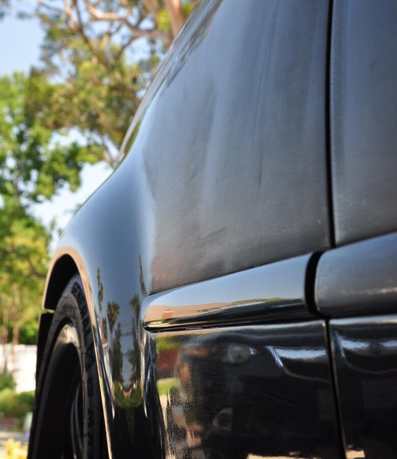

                    My fingers got so fatigued, that I started to move in vertical directions to do some of the heavier sanding, but I made sure to finish in tighter, horizontal movements. I don't get paid enough for this shit. I think you're supposed to use a block. I also could have used a machine and disc on these flat spots. Oh well. I usually do things the hard way.
                    The sections immediately above and below the molding were the most textured. I had to use 1,500 grit to make fast enough progress.

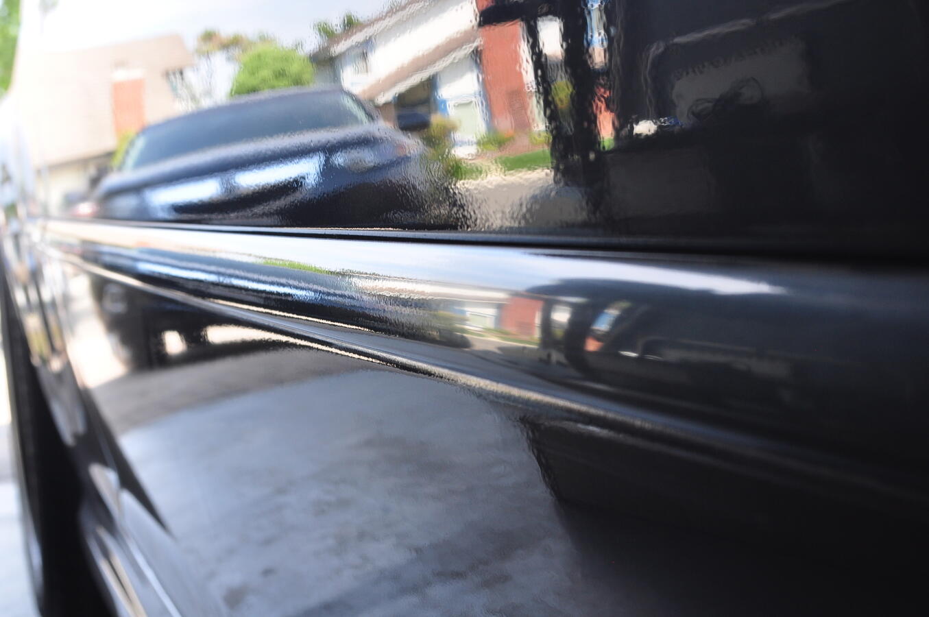

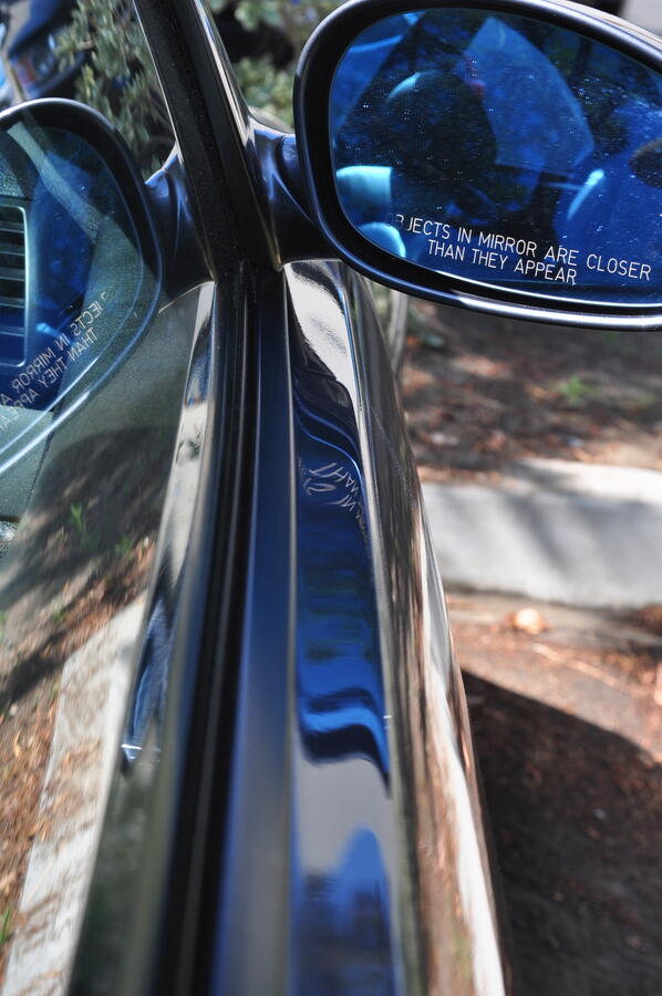

                    Whew, done with the upper section of the door. It looks a little uneven due to residue (paint dust). I didn't clean well as I made progress. This was taking so long, I knew I was going to have to wash the car before cutting and polishing the paint.

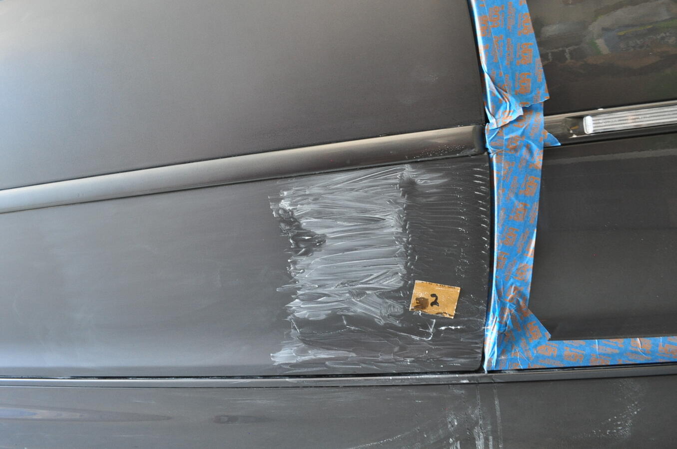

                              Test spot
                              Click image for larger version  Name:	wetsand038.JPG Views:	0 Size:	51.4 KB ID:	129340
                              Well, it made a big improvement, of course, but it didn't cut fast enough imo, still leaving a fair amount of haze and sanding marks. I finished with 2k grit paper and I don't think the correcting cream even gets that aggressive. I'd only use the correcting cream for light defects, like a one step on a car that's already in pretty good shape. I moved next to an orange (heavier cut, for foam) LC CSS pad and the strongest Griot's compound, Fast correcting cream (pic taken after correcting, new pad shown).

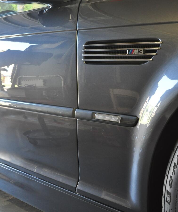

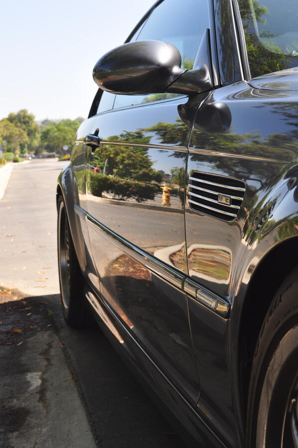

                              Let's compare the factory fender to the resprayed door:
                              Click image for larger version  Name:	wetsand046.JPG Views:	0 Size:	63.1 KB ID:	129348
                              This is only after compounding, no polish, but still very very clear. Polish will only reveal that last little bit of clarity at this point. Can you even see a difference in color match (moldings too, not just panels)? I talked a lot of shit about this respray - it really was a poor job overall, but the actual paint job was very very good. Basically identical color match and metallic "flop." As far as orange peel, it's very very close. I matched what the upper sections were, for uniformity, and I'd say it's just a little less orange peel than factory. Certainly not quite as tight of a "knit" for lack of a better term. Even the average "enthusiast" wouldn't have a clue it's a respray. You'd really have to know what you're looking for to tell it's a respray imo.
