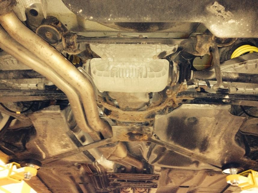

              Started out looking similar to this.
