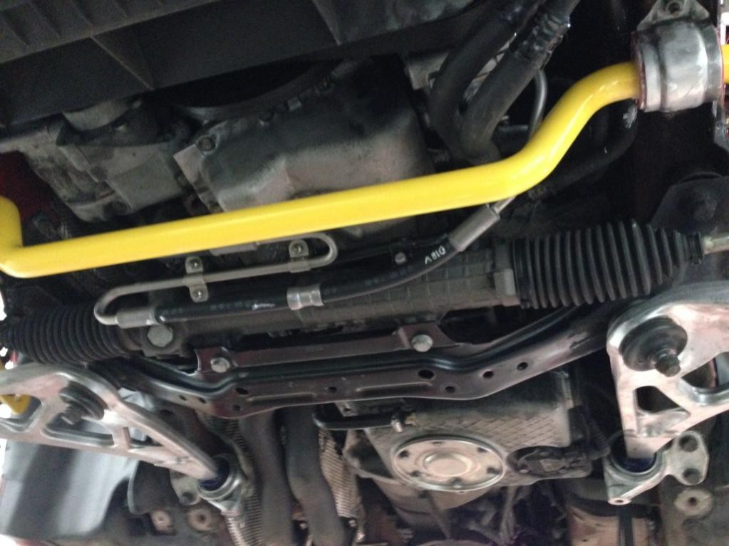

        I then fitted the castor bushes to the front arms, fitted the front roll bar, cleaned up the wishbones, fitted new engine mounts, fitted new PAS pipe. New track rod ends and tie tods.

              BTW... is this (pic below) the infamous PAS pipe that's know to fail on the E46 M3s ?
                Good job Shane :thumbs: you planning on injecting the structural foam into the cavity to stop the flexing ?
                Yes, injecting foam after I get strut brace welded into floor.
                And yes that's the very pipe Matt. Prepped 3 m3 for track work recently and they all needed that pipe.
                      I'd better check mine as it's still the original one.
