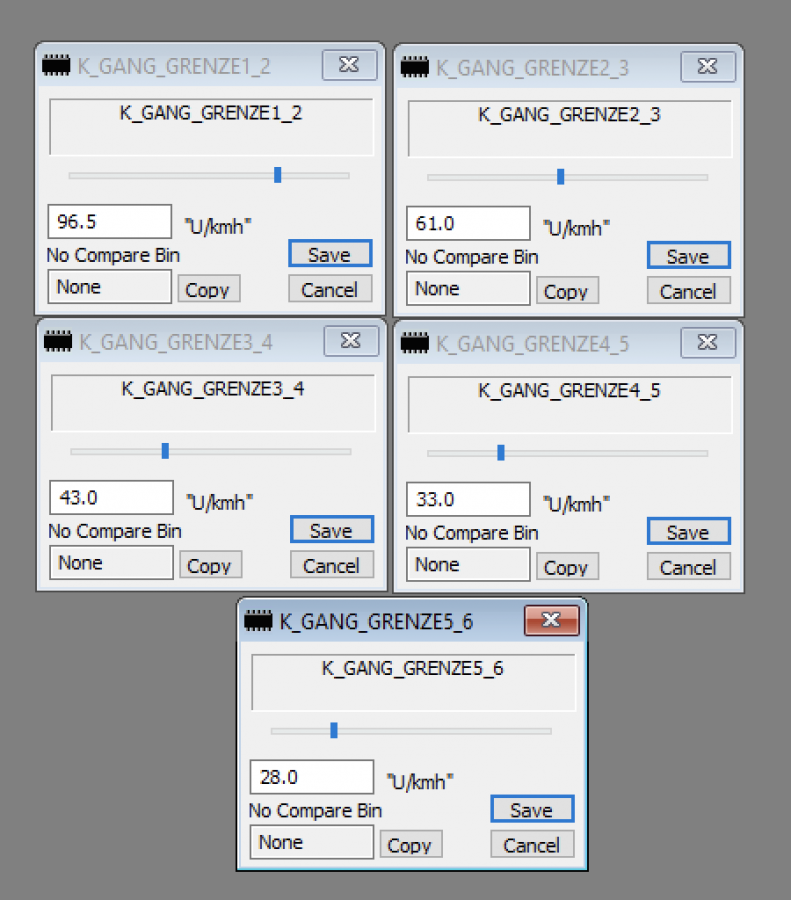

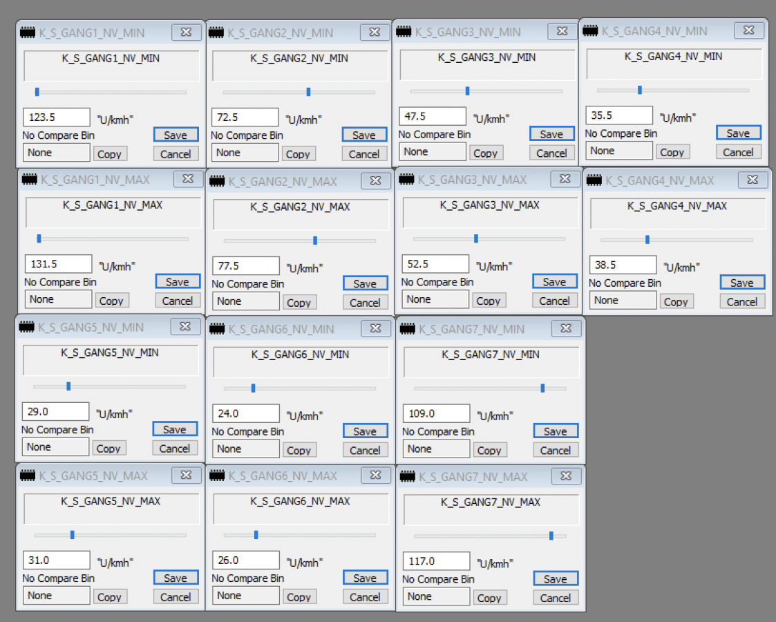

    Has anyone tried this combo? I'm particularly interested in the coding side since K_SMG_I_HA only goes up to 4.25 (FF).
    Also, would anyone happen to remember how these are used? There are scalars for every gear.
    K_GANG_GRENZE1_2
    K_S_GANG1_NV_MIN
    K_S_GANG1_NV_MAX
    I remember Terra posting an explanation on the old forum, but that's gone now.
    Shortest differential gearing may only be 4.25 due to BYTE limitation in ECU IE FF=255. DME Calc is X/60. 255/60=4.25

                    The gear ratio parameters above only really apply to SMG cars. The parameters seem to mostly impact how well auto mode works, but there might be other subtle effects I'm not aware of. I'd have to see how the data flow works, but I suspect there isn't much room for change there without also modifying the SMG computer program since the data is communicated over the smg can-bus.
                    The various _NV value are used for the DME to detect what gear it's in for manual cars. That can be corrected fairly easily for different diff ratios (though naturally for a ZF8, the car's program is not designed to be aware of 8 gears)

                        These are the values you're interested in. Attached an excel sheet to help calculate the correct values
                        Click image for larger version  Name:	Screen Shot 2022-08-13 at 3.19.40 PM.png Views:	0 Size:	299.7 KB ID:	180530
                        Click image for larger version  Name:	Screen Shot 2022-08-13 at 3.19.51 PM.png Views:	0 Size:	547.3 KB ID:	180529
                          Thanks. Now anyone putting a "race" gearset wouldn't be caring about auto mode anyway. In manual mode, first thoughts that come to mind are downshift overrun protection, and possibly rev matching.
