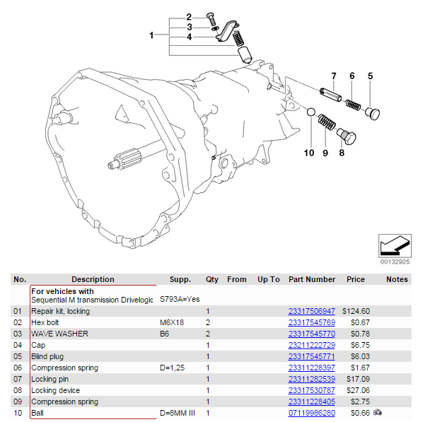

      I think I have the mechanical items sorted out. See the attached schematic of an SMG Tranny from realoem.com I bought items 5,6 and 9 from ECS Tuning. I think that is good enough for now.
      I think all my springs are intact. Its just a good idea to replace the two you can reach on the drivers side. They get VERY hot and age after 17 years. They don't cost much. I'll replace more items when I pull the tranny for a clutch and flywheel job next year.

            I bought items 5,6 and 9 from ECS Tuning. I think that is good enough for now..
            Why need new Blind plug? It's metal and if anything it's the aluminum hole that worn and not the plug.
            Also, #7 is the roller pin that worn and broke more often than spring 6 and plug 5.
              IDK. Someone recommended getting all three items. Unfortunately, I did NOT get the roller pin. I was feeling poor. It was something like $50. I will go ahead and buy that on your recommendation. Thanks.
              I HAVE heard of springs being broken.
              But from my symptoms, my main issue seems to be the GPS. HEAT and humidity trigger failure. But as long as I am in there I should replace some of the old springs and roller pin.
