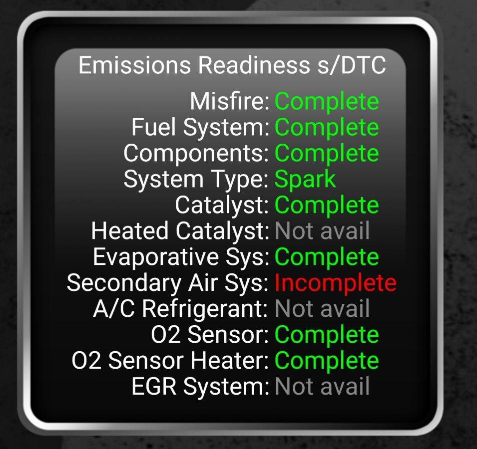

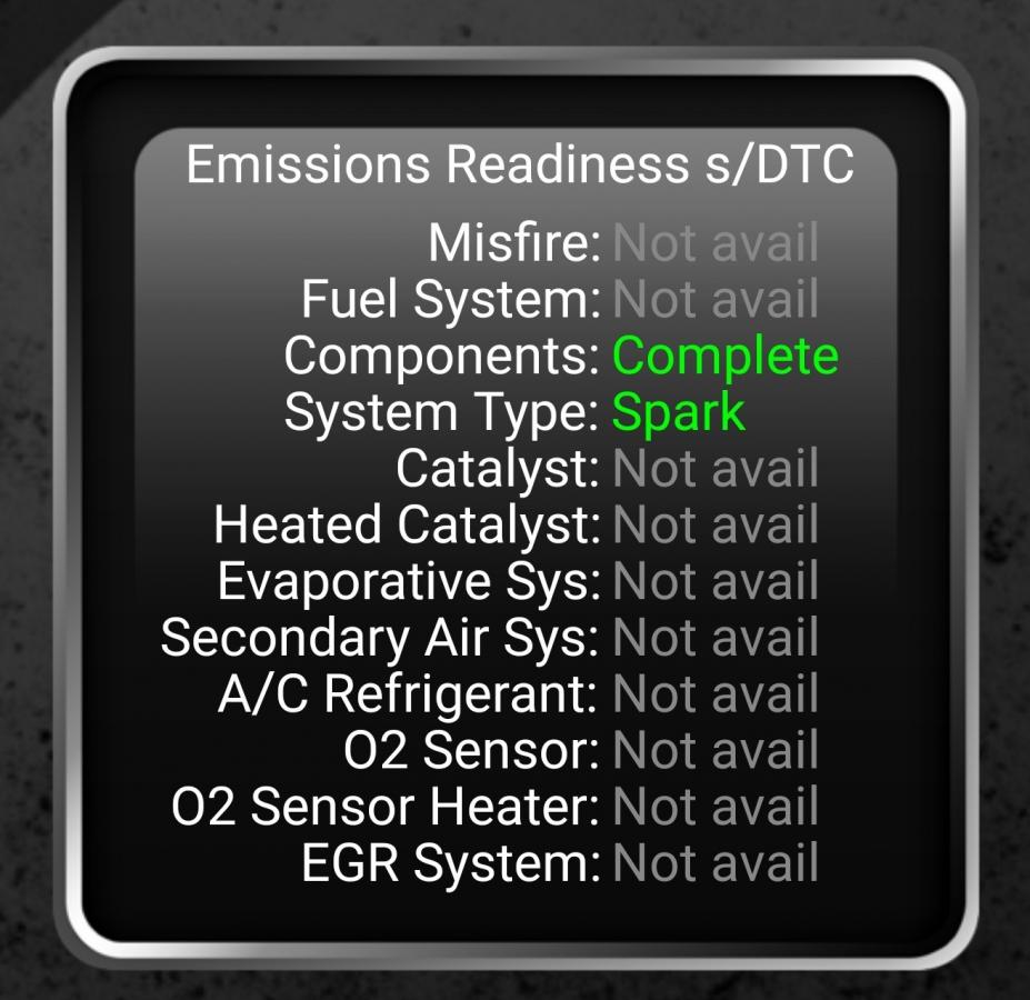

    However, a quick check of the emission readiness using the Torque app revealed some unexpected side effects where a number of items that normally should display as Incomplete after a fresh clear of emission monitors, now display as Unavailable. I don't think these items will ever be Complete since the ECU does not think they need to monitored. I would imagine the emission monitors are part of the Engine ECU program. It looks like some Engine ECU parameters have been modified while flashing SMG ECU.
    Before:

    After:

        thegenius46m , my concern was that the emission monitors that should have been displayed as "Incomplete", displayed as "Not Avail" after the SMG ECU flash.

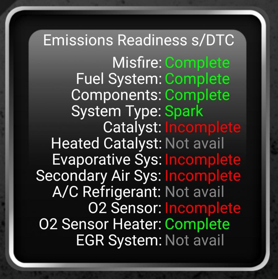

        I actually managed to resolve the issue. I reflashed a backup of my Engine ECU partial tune and the appropriate monitors now show as "Incomplete" as the following:
        Click image for larger version  Name:	After_Engine_ECU_Flash_Torque.jpg Views:	0 Size:	101.7 KB ID:	185371
        Now I can go ahead and complete the drive cycle.
        The confusing part was the Engine tune was not modified during the SMG ECU update. I was able to verify this by grabbing the Engine partial tune before reflashing my backup partial tune and comparing it with the backup. No diff whatsoever. Apparently, the Engine ECU for some reason was in a bad state or there were some undocumented changes during the SMG update, later the MSS Flasher tool was able to reset. Hopefully, this thread can help others with similar issue in the future.
