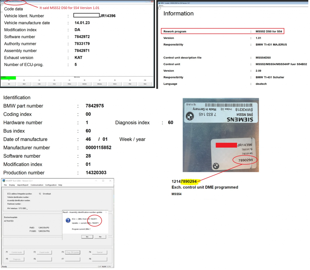

    I am working on reflashing the DME to erase the Build Journal Tune back to stock tune for my 01/11 production date M3. The sticker on DME matches chassis, so I am sure this is the original DME from factory.
    But the info in INPA and WinKFP seems contradicting to me.
    Why does it shows MSS52 DS0 in INPA? (Rework program MSS52 DS0 for S54 ??????)
    Many Thanks !

    Hi, I have a similar problem. Did you find any fix for it? Mine also shows mss52ds0 when I choose mss54 for s54.
      Perhaps the bootblock needs to be rewritten.
      How was the Buildjournal tune applied to the DME?
      Sent off or just programmed by OBD cable?
