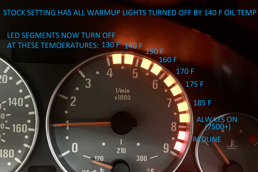

      These are the temps I have mine set to. Click image for larger version

          Fwiw it's always corresponding to oil temp, it's just that the stock values are set such that they're all out before the oil temp gauge even moves.
          I used the ecuworx tool to set them so they're only all out at operating temp, similar to above. Love the mod and the tool.
