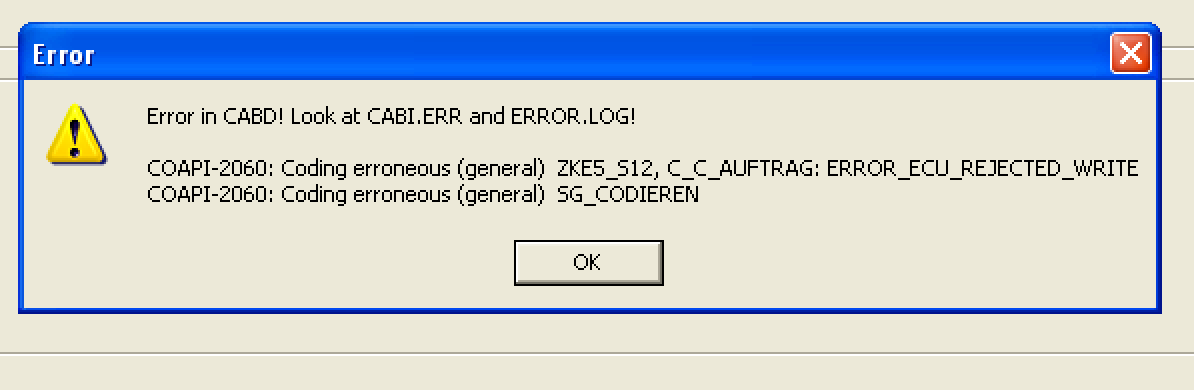

    Long story short, I have two spare 04+ GM5s on hand and am trying to swap one of them into my friend 02 (09/01 build) M3 who's gm5 is on the fritz. Process should be fairly straightforward where you just plug in the new module and recode the new module with a blank man file so NCS sets the module to defaults based on your car's VO. I did this exact process on my car a few years ago and it was effortless. Trying the exact process on my friend's car tonight yielded a failed effort. I kept getting the error message below where NCS reports that it can't write to the module. It can read no problem so we know the module is connected correctly. Also confirmed the uncoded module allows windows, wipers, central locking, etc to work prior to the recode.
    Error: COAPI 2060
    I looked up the code recommended disconnecting the battery for 15 min then retrying but nothing changed. Any ideas what could be happening here? Do I have a bad GM5 and just need to try another one, or is this potentially an issue with daten files?

    Did you get this code on each of your spare GM5s or did you only try one of them? Sounds like there might be something going on with this particular unit. I'd try the other spare before changing anything on your computer.
      Will be heading to my friend's in a few hours to give the spare a go as I only brought one of them last night. I'm thinking the same thing that the unit is faulty, as I've done this same process on my car with zero issues.

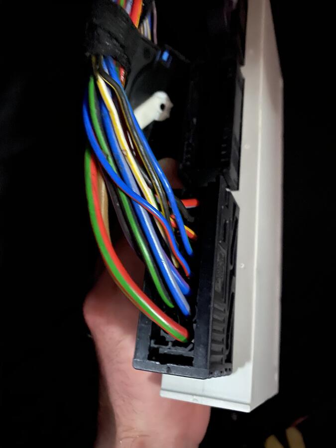

                    With that said, I resolved the issue last night. Confirmed both my spare GM5s were actually good after finding something interesting... the issue was indeed with my friend's car. Either someone did this prior, or one of us loosened a pin the slightest bit on right most connector of the gm5 harness. Didn't take a before pic but it was one of the inner blue wires that was ever so slightly loosened. I just pushed it back in and we were back in business.
                    My theory (without digging into the WDS) is that either that specific pin controls the ability to flash the module, or that harness connector acts like an open circuit when loosened and prevents any communication to the module for flashing. Either way, if you get the code I got above, highly recommend starting at the GM5 harness connectors and verifying all pins are seated in the connectors securely.
