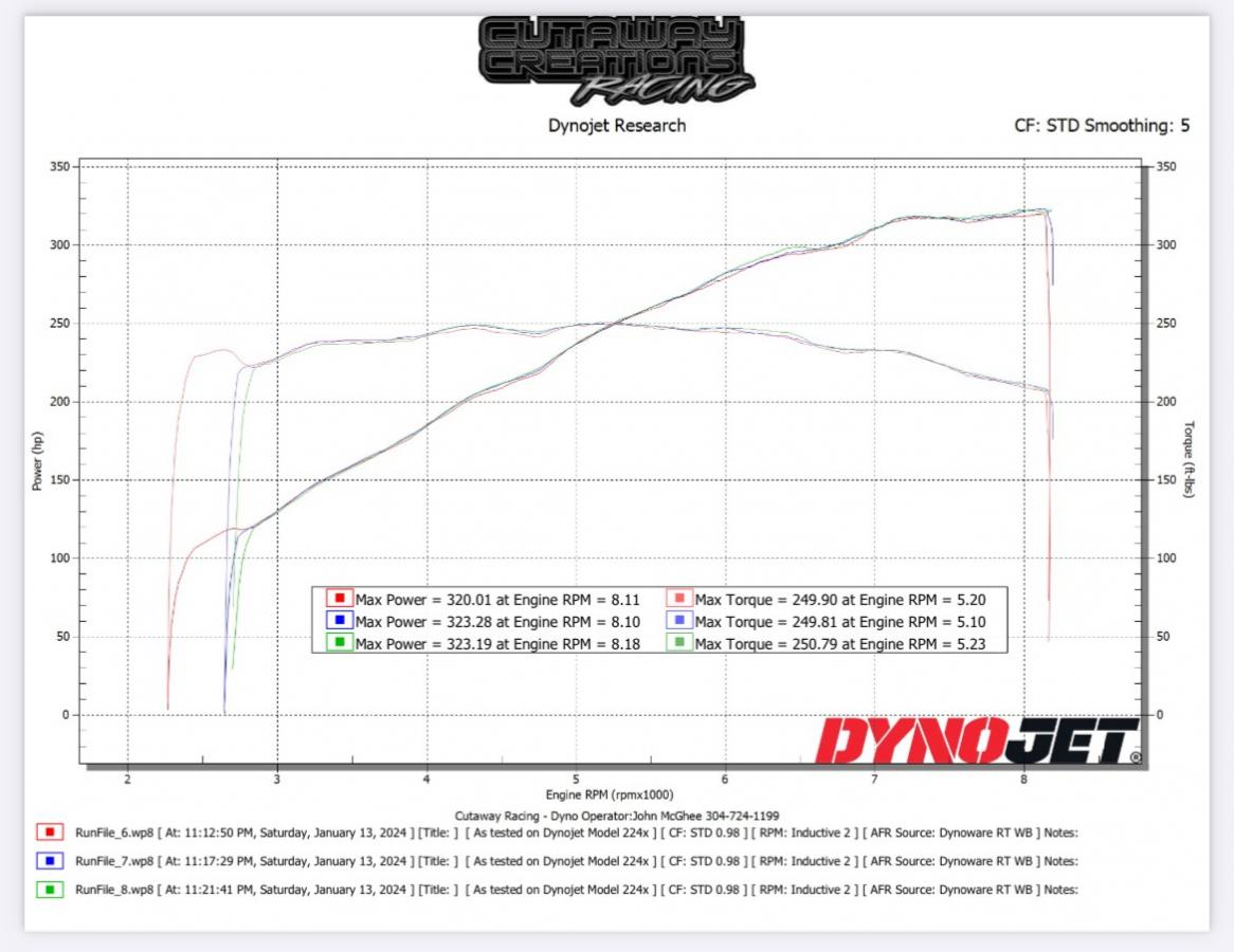

                    Thanks everyone - dyno time was well executed.
                    All of these recommendations helped.
                    1) Remove beauty cover to proved access to the coil harness
                    2) Know the part number for your IAT (CSL box-specific)
                    3) Bring a PC with you that has the tuner’s flashing software and Team Viewer on it. The Dyno shop may prefer their own, but Murphy will show up. Dont forget the cable!
                    4) If there is no S54 tuner involved, you may have to enable dyno mode yourself. This was not required for me.
                    5) it’s probably a worthwhile investment to replace the coils and plugs.
                    I did not need to provide anything to support AFR monitoring.
                      My dyno operator had to remove the rear jack pads to strap the car down. So might be worth checking on how they will strap the car down.
                      Might just be me but dyno runs are kind of unnerving. I hate watching someone run my car to redline...lol
