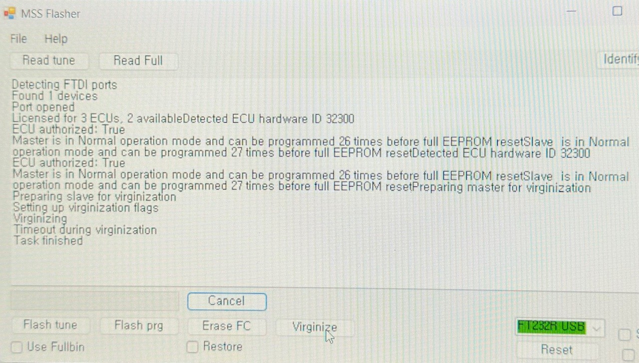

    Hello,
    Has anyone managed to resolve the sync issue with EWS after Full bin flashing?
    It seems like there are no issues with re-syncing EWS after flashing full bin with BDM,
    but since I don't have BDM, I used 'MSSFlasher' for flashing.
    I used an extra DME (MSS54HP) instead of the original DME.
    However, when I pressed the virginize button,
    the ISN information area did not reset, and instead, a timeout occurred.
    If anyone who has flashed CSL bin using 'MSSFlasher' has successfully re-synced EWS,
    I would appreciate hearing your advice.
    How can I make the DME (MSS54HP) virgin?
    The Virginize function of 'MSSFlasher' seems to erase VIN information,
    but it appears that the ISN information area does not reset.
    Is it supposed to reset entirely?
    Please help me ;(
