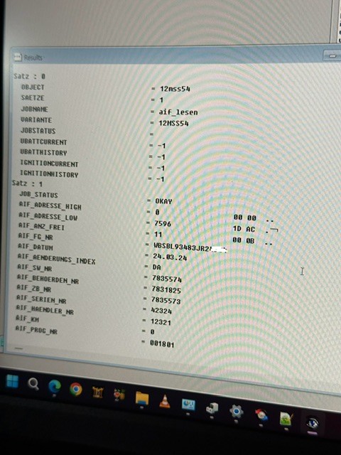

    I recently replaced the DME of my 2003 E46 M3 and attempted to update the VIN information using Tool32.
    In Section 1, the original VIN information was input, and in Section 3, AIF_Address_Low 7596, I inputted the new VIN.
    Although the command seems to have been successfully inputted, when I check in INPA, only the original VIN information, i.e., the value inputted in Section 1, is displayed.
    Is there any specific setting I need to adjust?
    When I try to overwrite the value in Section 1, I encounter an "Error_SG_Reject," making it impossible.
    I would really appreciate some guidance on this.​

    I've resolved it.
    After using the virginize feature of ‘mssflasher’ to delete all VIN information from every section, I successfully inputted the VIN information into Section 1 as per the previous command.​
