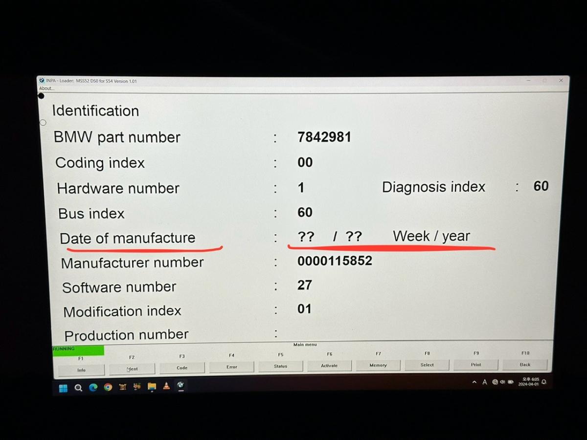

    Last week, I modified the VIN of a spare MSS54HP DME and reset the AIF field values.

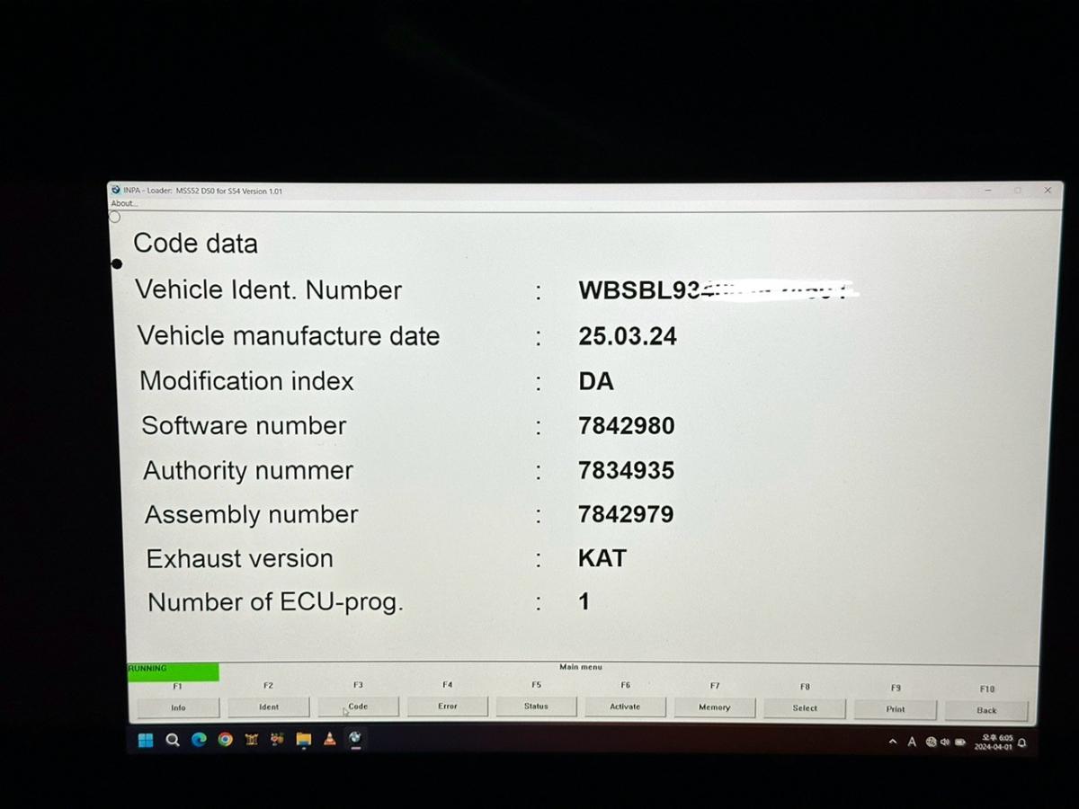

    I inputted the VIN, vehicle manufacture date, software number, authority number, etc., using Tool32,
    but I don't know how to input the 'Date of manufacture' field, so it appears as ?? / ??.
    Also, upon checking now, I realized that the Production Number has also been lost.
    I would like to know how to input it. ;(
    If anyone knows how to modify this field, please help me out.
    Thank you.​

      HoDoo can't help with your problem (hope you figured it out), but do you know what's driving the vehicle manufacture date under Code data? I checked mine, and it's 07.05.09 (I assume May 7 2009) and the "Number of ECU-prog" is 2. Date of manufacture under Identification is 05/06, which is accurate. Car is a 2006, and would have been under warranty still if there was something done on May 7 of 2009, but I don't have the records. Thank you!
        It updates whenever you update the software on the DME via the official tools. The last update to the MSS54 was in 2009 from memory, the emissions fix.
          Production date and serial number stored in bootlader are deleted when you recycle MSS54x
          but noone is looking for those, maybe the buyer if you sell the car
          You can't write those with BMW standard tools
