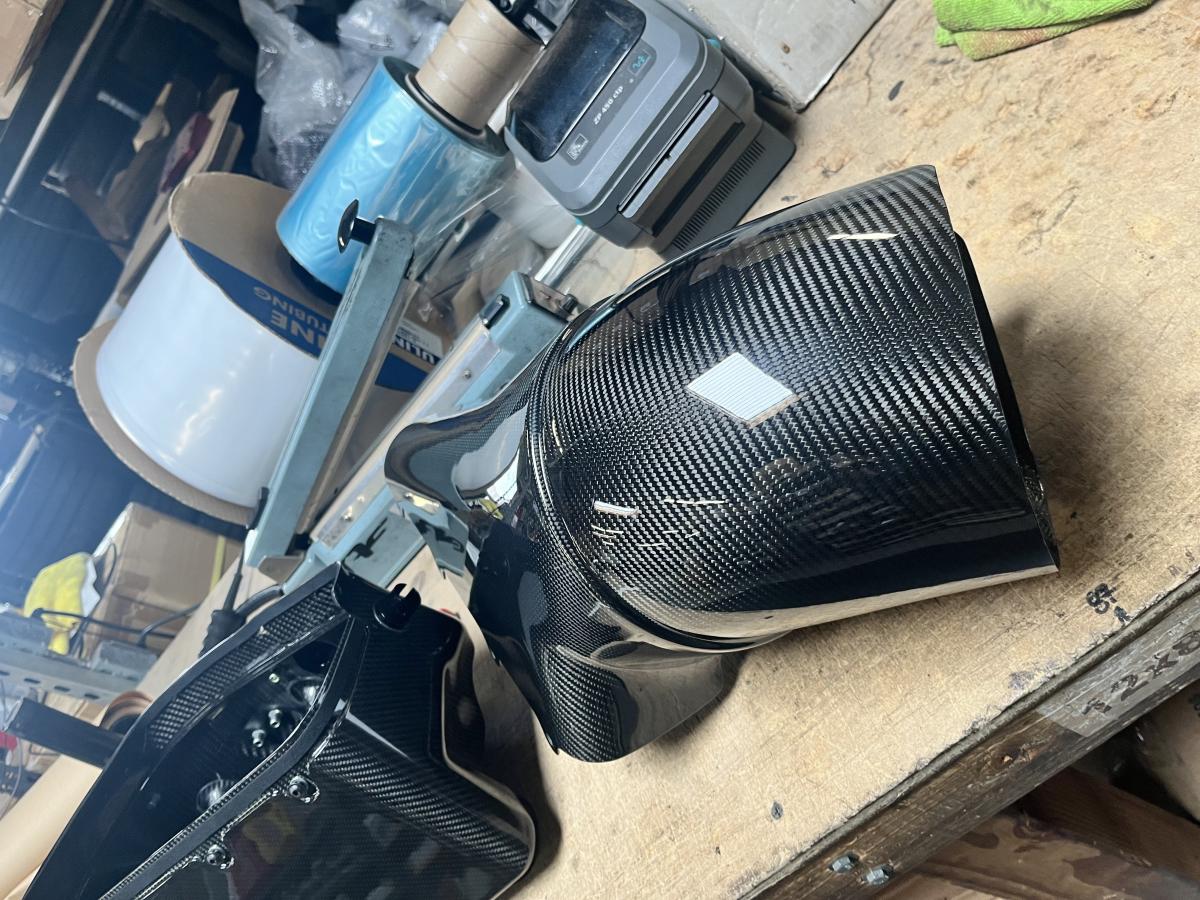

    I’m getting a Karb race csl intake installed and getting an alpha N tune from a company called HTE tuning tomorrow at EAS. I have a couple of questions.

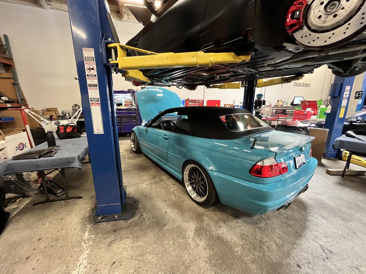

            she just went into surgery!

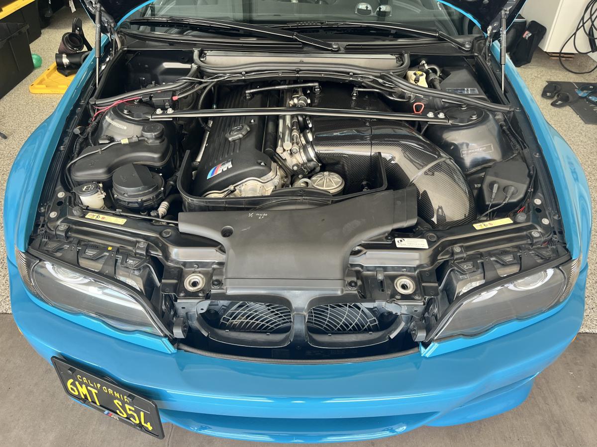

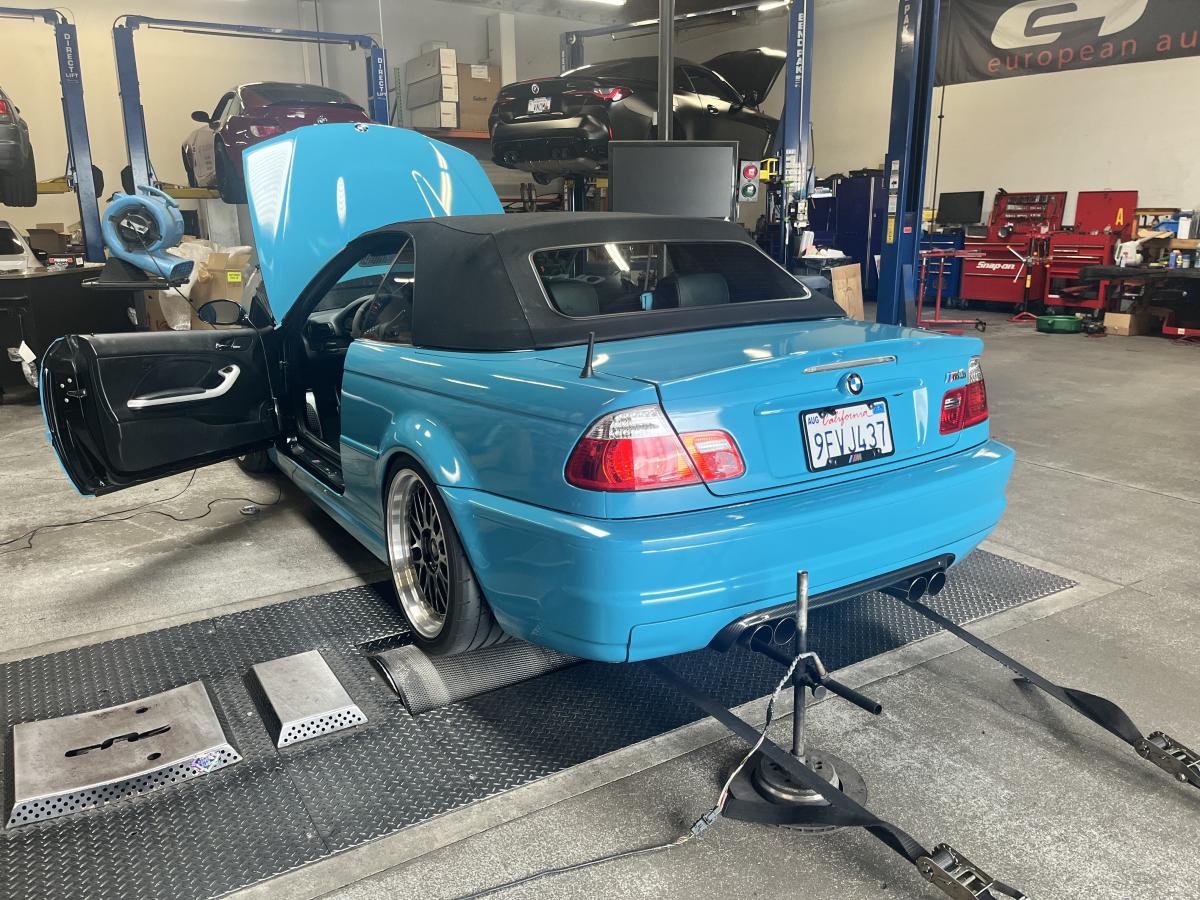

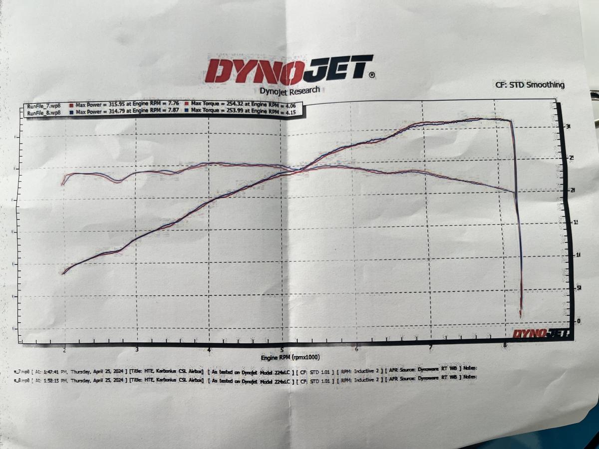

              Just drove the car for about 40 miles after getting the Karb box installed with the alpha n tune.
              Not sure what I was expecting but man the tune is great. Driveability is just as good as stock and heel toe works like a dream. Car is noticeably quicker and that intake roar is AMAZING. Had the dinan stage 1 tune on the car before and the alpha n tune by HTE is leaps and bounds better.
              car made 315whp on CA 91 octane
              i don’t think I need to get the map conversion unless I were to move to somewhere of a drastic elevation change, no?
              thoughts guys? What am I missing here?
              (PS I can’t stop driving like an arsehole hahah I keep wanting to hear the intake.)
              (PPS) for those with a regular cone intake, the csl intake is WAY louder and dramatic. I posted a question about this to see if the cost was justified and YES it is. If you are fortunate to have the disposal income to get a csl intake box, get one! When I stood next to the engine when they were dyno tuning it, I actually got startled at how loud it was haha.
