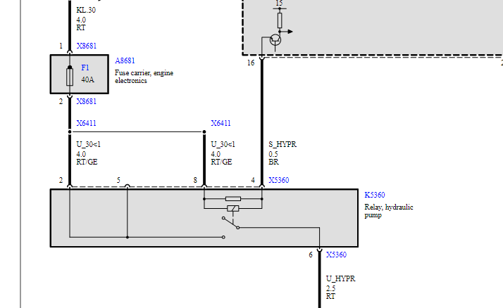

    If you don't make any headway on the coding, then you could potentially install a switch between the Salmon relay and SMG module that would prevent it from grounding the relay coil. I'm not sure if this would make the SMG unhappy as its trying to run the pump without pressure build up, but something to consider

      George thanks for the idea! I like this, and will most likely be option 2.
      I am certain the SMG unit would throw a fit with this, but potentially since the car would be off while the “issue” is occurring will stop it from throwing any false codes.
