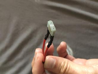

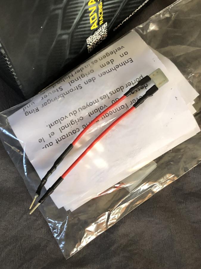

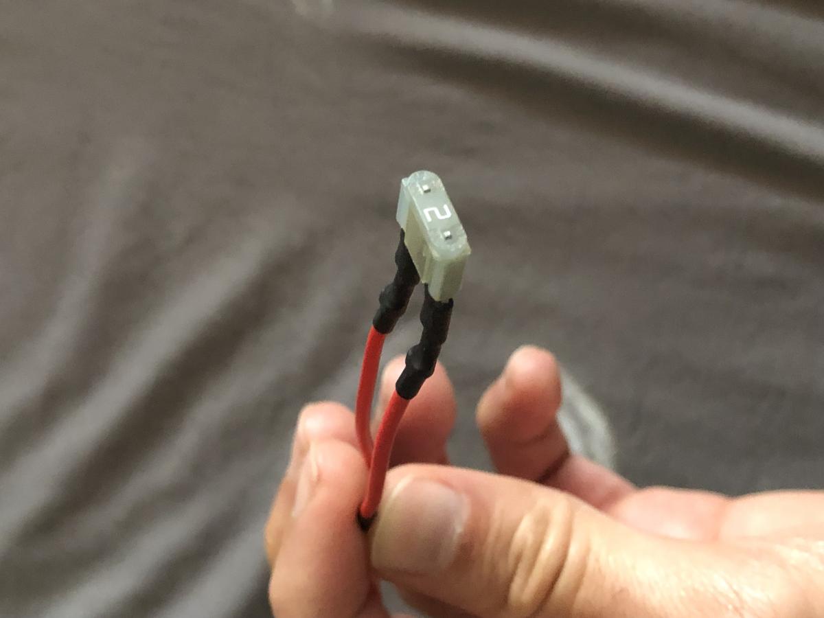

      The OMP wheel hub I bought came with w/ a resistor, but it looks like the E46 airbag has two plugs/connectors; do I need to get a 2nd resistor to make sure the srs light goes out? Or is the one resistor used to jump between the two airbag plugs? I dont have the airbag out yet so just going off pics/videos I've seen online.

        Yes, one per squib connection
          Thanks maupineda, found this on Amazon, looks to be exactly like the OMP provided one.
          While I dont need the 2 pack it’s reasonably priced only $15 with prime delivery arriving tomorrow

            Those will work. In fact you can depin the squib connector and transfer it to your resistors for a clean execution. Maybe from eBay or junk yard you can get a spare harness. That is how I would do it.
              Interesting, yeah i was already thinking to depin the two horn wires from the airbag harness since space in the wheel hub is so limited as it is (not running horn). And with both the squib wiring and the two resistors wires being so long too i might look into doing that. Thanks for that!

                  I believe both electrical plugs are wired in parallel, so only one resistor would be required. At least on my car they were when I probed them with my DMM, but worth double checking on your own setup. I just assumed this was for redundancy.

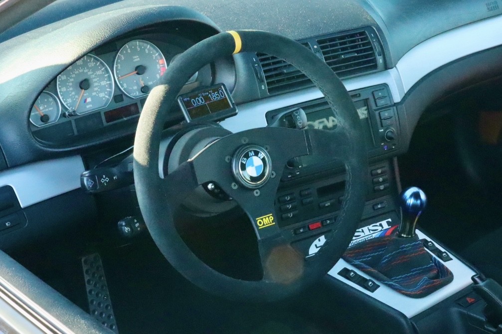

                    Hey sorry I did not follow up, I ended up running two resistors and worked perfectly, no SRS or airbag light. I just tucked them into the wheel hub and they're out of sight. The amazon $15 wasn't a 2 pack either, just came with one but had a pic of two lol.
                    Just a heads up for anyone in the future, the OMP wheel hub is trash and doesn't line up centered, I ended up returning it and went with a MOMO one instead and lined up much better.
