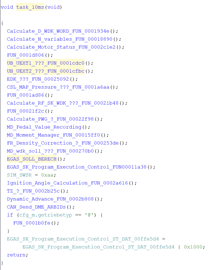

    Spent a little bit of time working through the 10ms task in the master binary to figure out what each of the functions it calls does. There's several still to work out but have made some pretty good progress. I've also figured out the inter-processor monitoring of the system timers and the EGAS Safety Concept Program Execution Control mechanism, as well as confirmed via the funktionsrahmen that the MSS54 uses dual-ported RAM to share variables between the two processors for non-critical purposes (which confirms my previous suspicion that that RAM space is shared). Also found in that same document that for sharing of variables for critical functions the IPK (inter processor communication) system is used. I'll try to find that mechanism in the code as well as would be useful to understand how it works.
Name:	Screenshot 2025-02-16 at 9.27.10 PM.png
