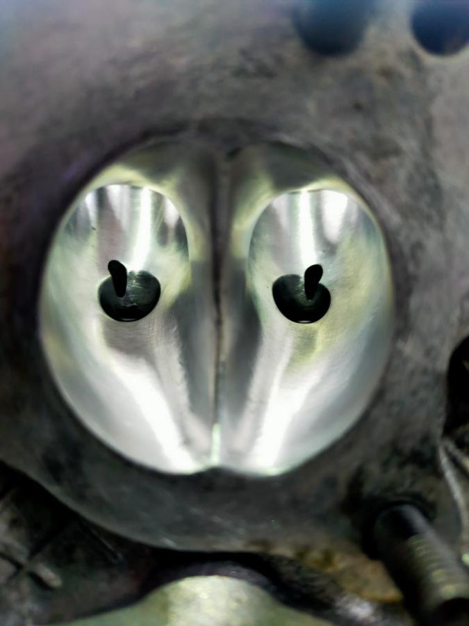

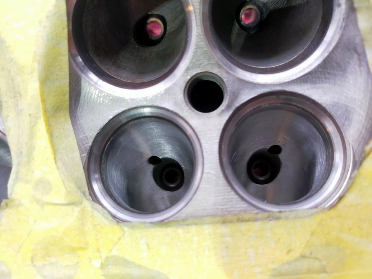

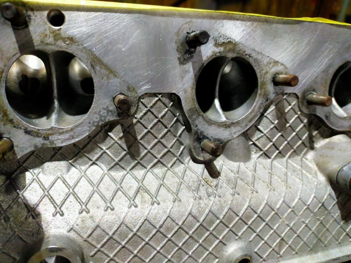

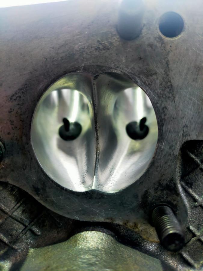

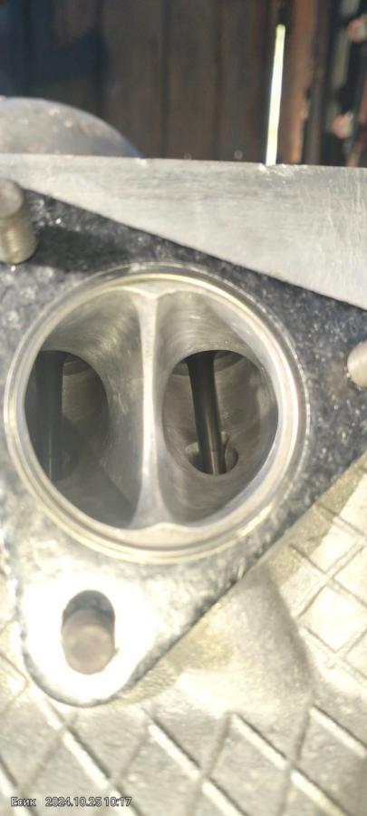

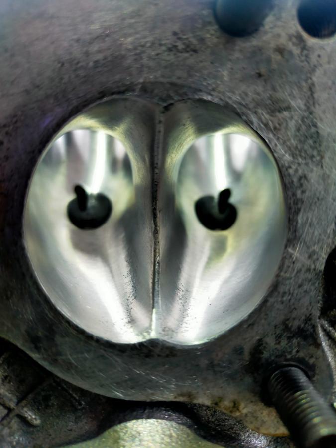

    After my last rebuild my engine builder adviced to do light porting of exhaust channels- for better flow and for soot does not accumulate on the walls of the exhaust port (there are factory-cast) i haven't tested in on dyno but after HTE retuned my cammed (288/280 schricks) engine- it seems like it really works, car is pulling very hard on high RPMs. Photos attached
