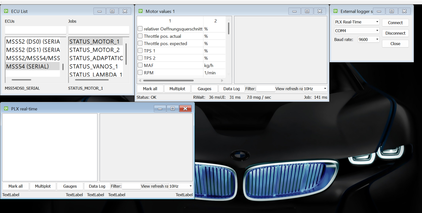

    Having some issues with Testo standalone and my plx wideband.
    I have an rs232 -> usb converter from the PLX to the laptop, which has worked in the past when i was using the older version of testo that requires INPA, which I had running on another laptop.
    I'm trying to get things set up again on a new laptop, this time using testo standalone, but the wideband is not showing any values that can be selected. The com port is correct and changing baud rates in either testo or device manager isn't helping.
    I have checked the cabling / interface from the plx unit to the computer and it *appears* to be ok.
    Any suggestions on what I'm doing wrong?

    Similar issues with my TechEdge wideband. Contacted creator of TestO and I doubt there will be software improvements for this. Would have been nice if the source code was available so someone else could improve it.
