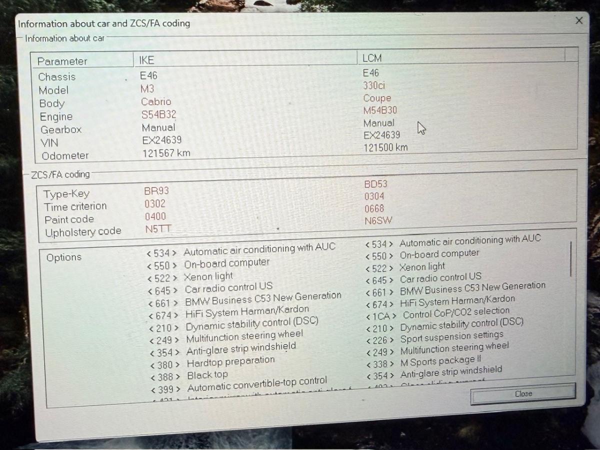

    Replaced LCM since I installed OEM LEDs in my 2002. I updated the vin and mileage using PA Soft without issue.
    Is there a way to update the vehicle info to match the IME to my new-to-me LCM?
    Edit: can be done with PA Soft.
