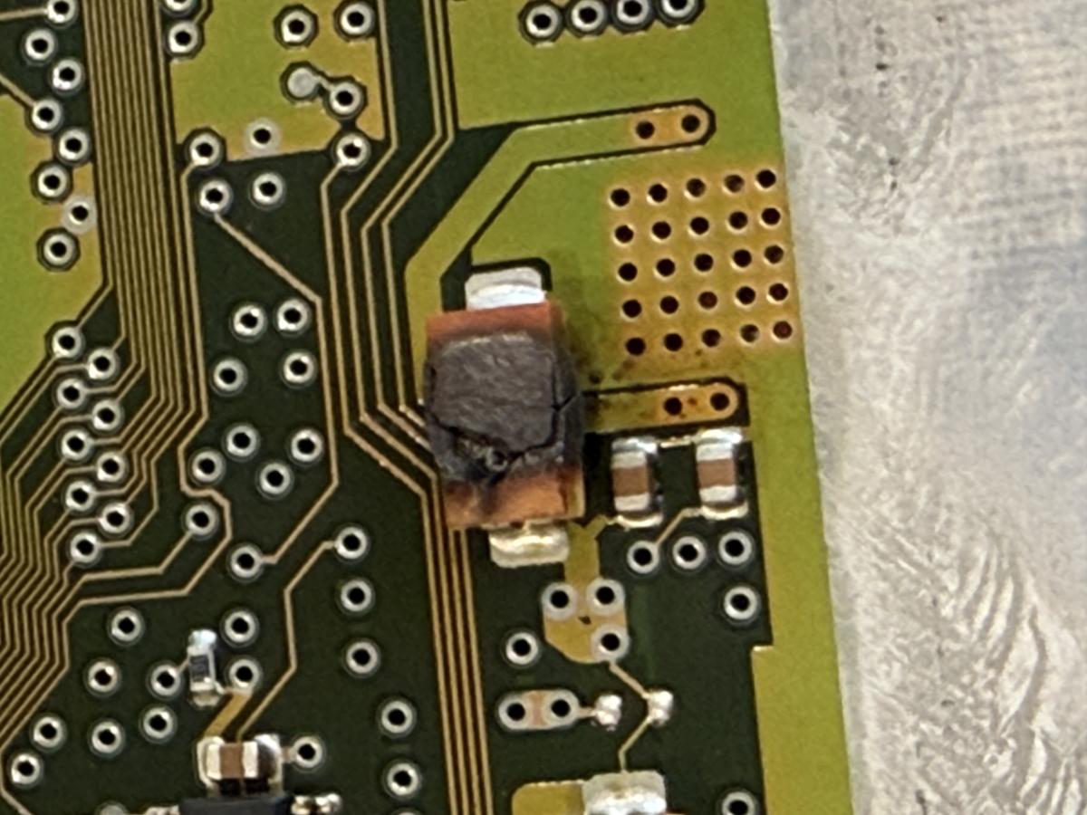

    I have a S54 Z3M and recently came across a no start issue. I sent the DME (MSS54) to Kassel and they found a blown capacitor. I ended up getting a replacement DME to install...

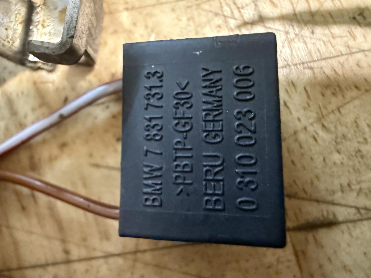

    Now comes the weird issue. When I go to crank, it blown fuse F201 in the E-Box, which is the fuse for the coils. New coils, still does it. Changed the ignition harness with another one... same issue... except now that harness back in a E46 M3 won't start the car...
    That tells me that it's likely blowing the suppressor capacitor... guessing here since it's completely sealed.

    P.S. the capacitor part number doesn't pull up anything anywhere but if anyone has a lead on that... please share!
    I think there are capacitors or inductors in the ignition harness. So perhaps they have been mullered. Ah, i just noticed your second picture.

      If F201 (coil power) is blowing immediately on crank, you almost certainly have a short to ground on the 12V supply side of that circuit. Since coils and harness have been swapped, I’d start isolating the suppressor capacitor they can fail internally and short under load. Try unplugging or removing it completely and see if the fuse still pops.
