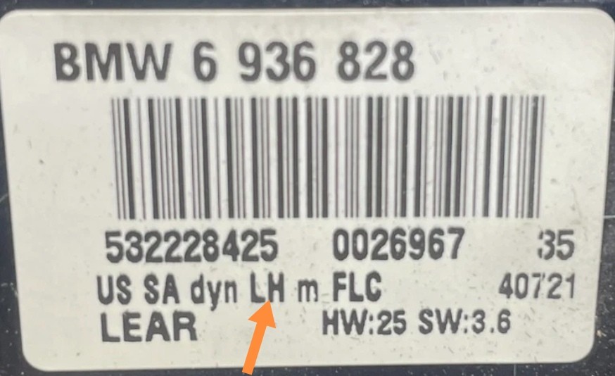

                What part number has your LCM? I don't know if this is your problem but the facelift sedan has a different lcm then the touring. The facelift sedan has two more rear light blubs, therefore the lcm has a different hardware. Do you have a LL or a LH lcm? FL sedan needs LH. Click image for larger version

                  What part number has your LCM? I don't know if this is your problem but the facelift sedan has a different lcm then the touring. The facelift sedan has two more rear light blubs, therefore the lcm has a different hardware. Do you have a LL or a LH lcm? FL sedan needs LH. Click image for larger version  Name:	Screenshot_20260218_032828_edit_546777892638440.jpg Views:	39 Size:	84.5 KB ID:	343781
                  Will take a look!
                    Is that H for HIGH like the GM5 module?
